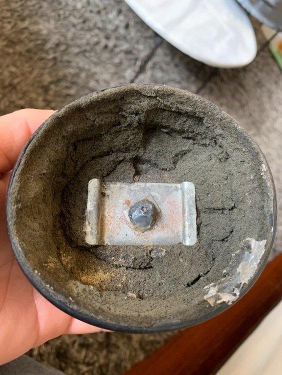

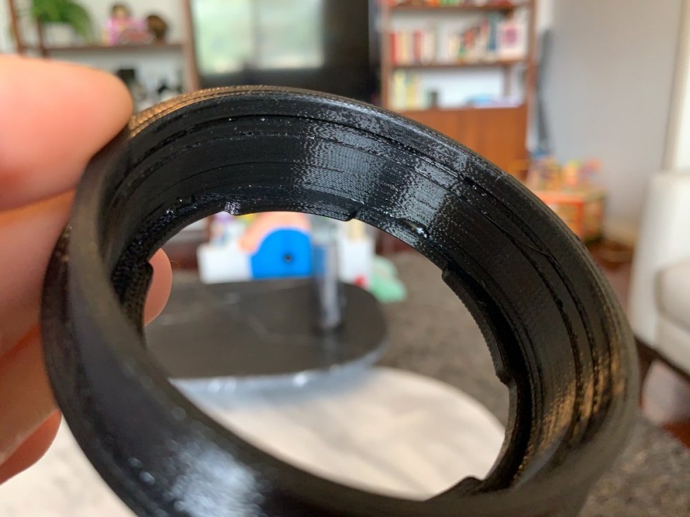

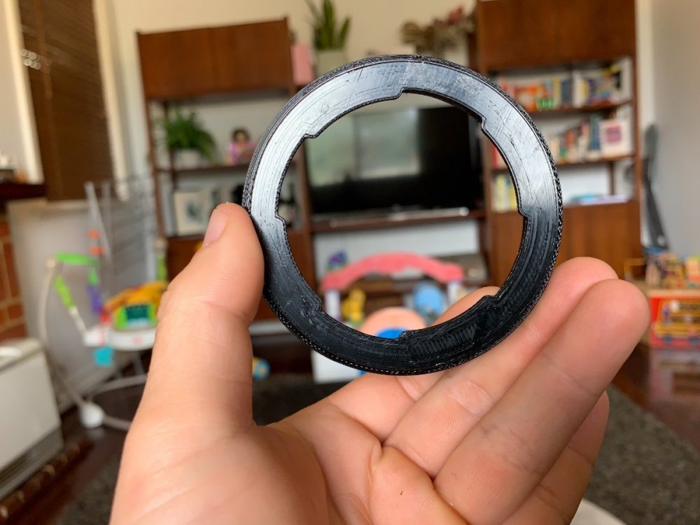

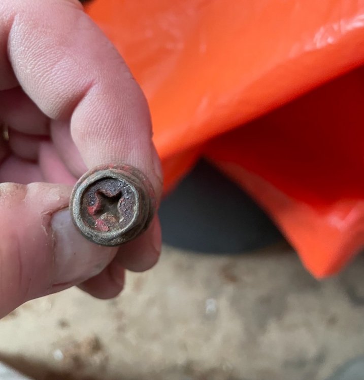

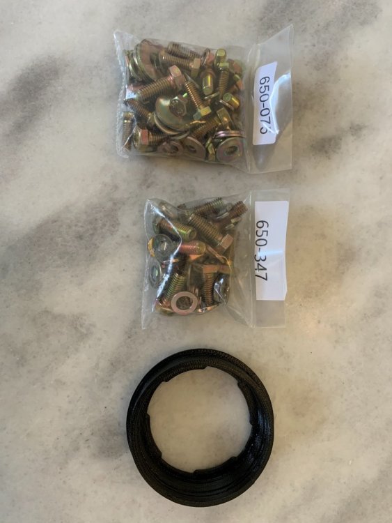

240ZBUILTBYME Posted August 26, 2021 Author Posted August 26, 2021 Received a couple of odds and sods from zcardepot. I had to buy some 280zx bits from them so thought I’d get some stuff I know I need for the 240z and save on shipping. bought one of their horn button backing rings, and yellow zinc bolt sets for the fenders and bonnet hinge assy as all my original fasteners were ruined or replaced with incorrect items. All fasteners are rated 8.8 for fenders and 10.9 for hinge assy this is what the rear of my horn button looks like backing ring fixes perfectly onto the steering wheel. I plan to use a combination of liquid nails from the new ring to the metal tab then expanding foam to fill the areas and hold the shape. few close ups of the ring, anyone know why they have the four cutouts there? Or is that just the original shape? Quote
NickF Posted August 26, 2021 Posted August 26, 2021 (edited) Horn ring looks same as original Wondering about bolts the some originals have an indentation in them and some a cross for screw driver do the bonnet hinge bolts have these? Edited August 26, 2021 by NickF 240ZBUILTBYME 1 Quote
240ZBUILTBYME Posted August 26, 2021 Author Posted August 26, 2021 yes pretty sure the bonnet hinge bolts had those for a screwdriver. The zcardepot kits are just a straight hex bolt. I’m not fussed, but good eye though! Quote

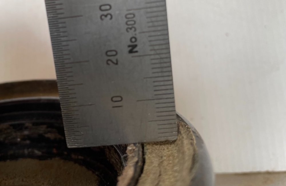

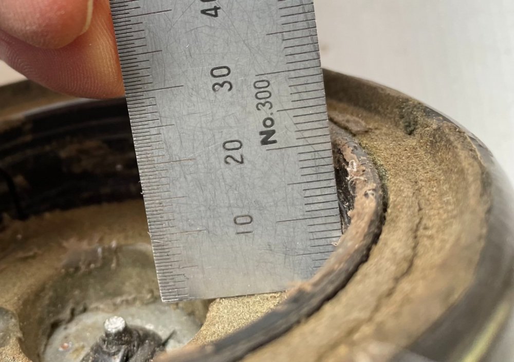

240ZBUILTBYME Posted August 29, 2021 Author Posted August 29, 2021 On 8/26/2021 at 2:11 PM, NickF said: Horn ring looks same as original Hey nick could you do us a huge favor if you have your horn pad accessible? Just want to know the rough depth measurement from edge of horn pad to the top edge of the ring? Basically how deep the ring is set into the pad? Looks about 3-5mm? Cheers Quote
