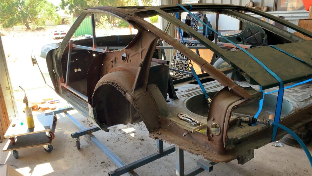

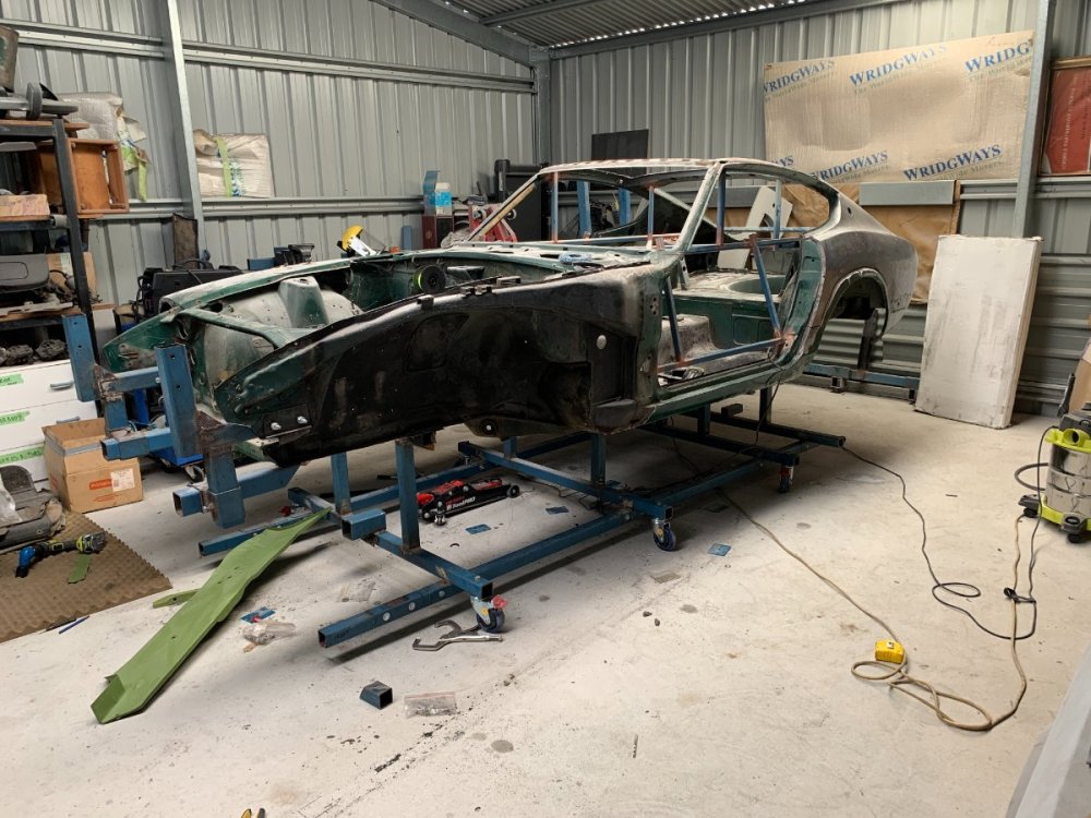

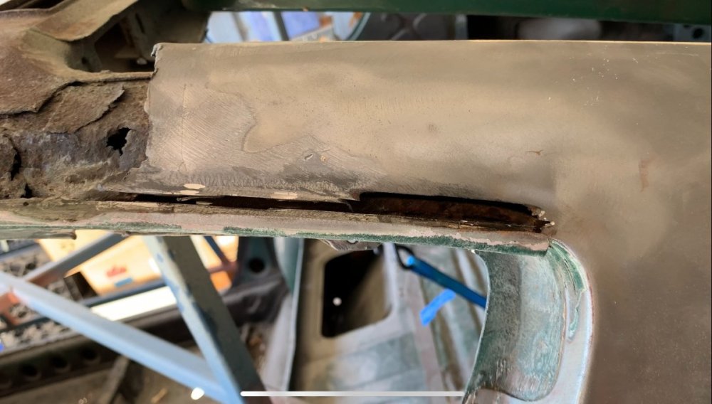

240ZBUILTBYME Posted September 19, 2022 Author Posted September 19, 2022 Another long day of drilling out spot welds on the roof skin. I can see why metal works are the most expensive part of restoring a car, it’s so time consuming. can anyone tell me about the joint between the rear quarter and roof skin? Mine seemed to be oxy welded or brazed together, is this factory? There was lead wiping which I burnt off, I ended up cutting the joint with a grinder but wondering if there’s a better way. I also found the front corners were welded in, there was no other way so I just cut joint and part of the skin with my 5 inch, I really must get so Roloc attachments and small cutting discs for my die grinder. I managed not to damage any structures underneath. i found the front and rear of the roof skin easy to unpick, the LHS was just cut as there was barely anything left, I found the RHS rain rail joint extremely difficult to unpick, I came close to just cutting it with a grinder on more than one occasion, but I persevered and I’m glad I did. There is just no room to work, I tried modifying my scraper blade so I could hammer it along as I went, but that wasn’t effective. In the end I used a sharpened flathead screwdriver to break the joints after drilling. there was a small amount of mangling which was unavoidable but overall very happy with how cleanly I was able to unpick the roof. I’m hoping to sell the skin to someone who needs to fill in their sunroof hole as the center of the skin is excellent. Was surprised to find the RHS to be very clean, some pitting at the rear quarter joint but overall a good result. the LHS is a shit show, as expected, it’s going to take a lot of work to rebuild the whole structure, rear quarter join is completely gone. next up rear quarters… gav240z, C.A.R., CBR Jeff and 2 others 3 1 1 Quote
C.A.R. Posted September 19, 2022 Posted September 19, 2022 I'd be quite pleased if that's all the rust I found in the roof frame! gav240z and 240ZBUILTBYME 2 Quote
240ZBUILTBYME Posted September 20, 2022 Author Posted September 20, 2022 10 hours ago, C.A.R. said: I'd be quite pleased if that's all the rust I found in the roof frame! Im quite pleased with the RHS side! the LHS will be a lot of work, all the structure is heavily pitted and holed, luckily my donor roof has what i believe to be clean structure so i will try and not mangle when unpicking and implant into my roof Quote

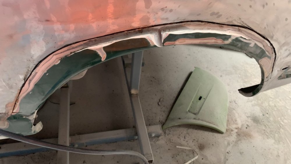

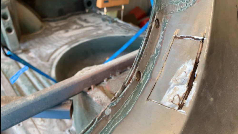

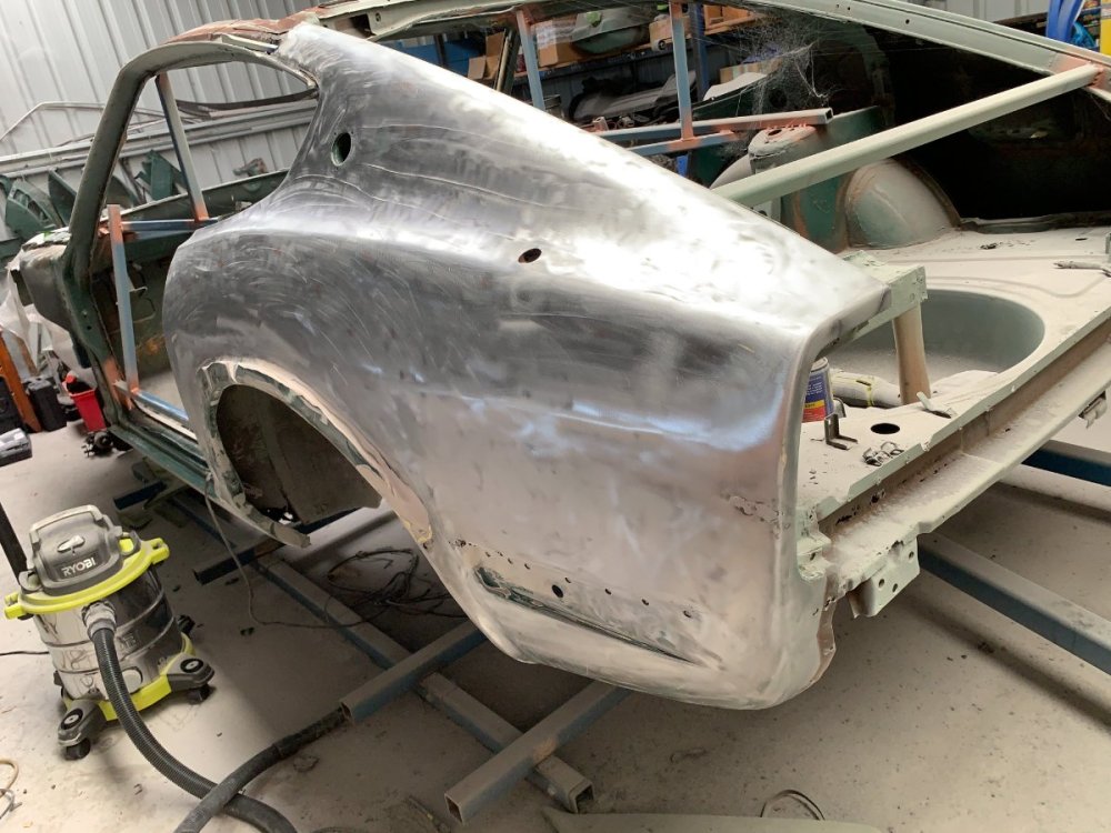

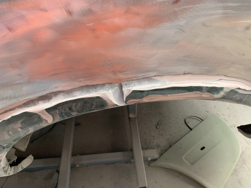

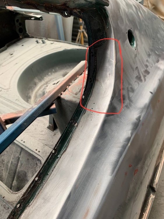

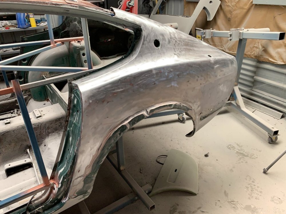

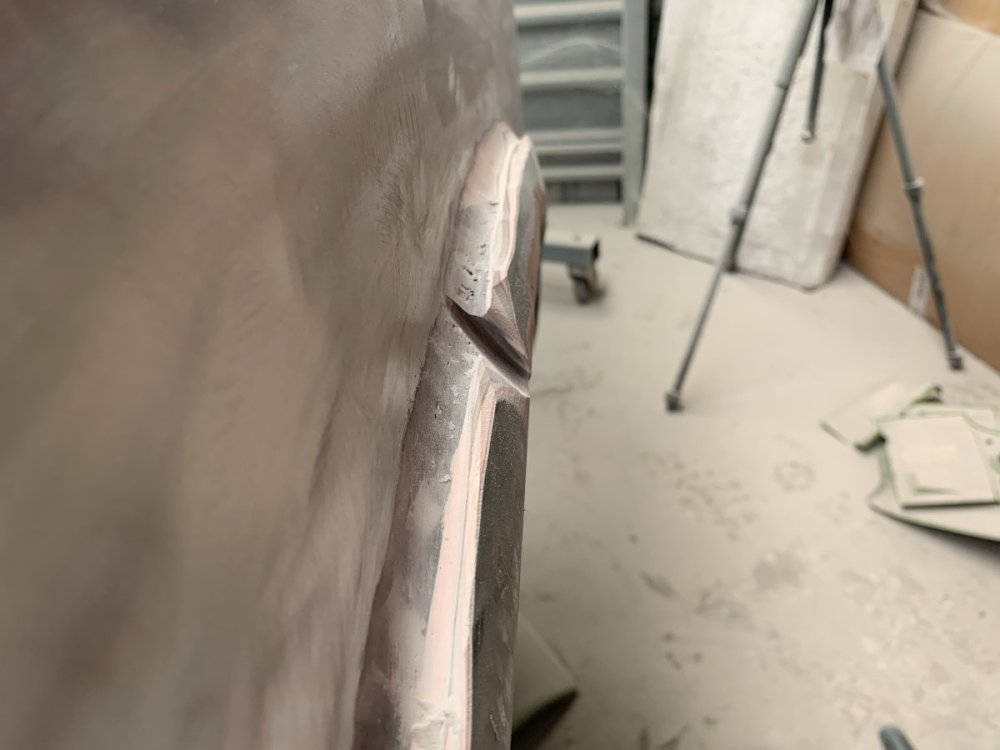

240ZBUILTBYME Posted October 14, 2022 Author Posted October 14, 2022 Continuing on with panel removal I started on the LHS rear quarter panel, before starting I decided to strip the paint, Im undecided if Im going to reuse this quarter panel, I have all the necessary replacement panels to patch it (tabco rear wheel arches, KFV lower rear section and my spare roof has healthy looking pieces around the rear quarter window i could use )but would be much easier to just replace the full quarter panel. Hopefully uncle lurches procurement skills make the cost more reasonable. Surprisingly besides the rooted doglegs, wheel arches and rusted out quarter window sections its a very clean panel, one minor bit of dodgy patching but otherwise clean. check out the more than inch worth of bog in the rear arch.... some real artisans worked on this car... The arches are pretty much non existant so i stripped until i found the rust and decided to leave the bog and cut around it, same with the dogleg. Ive drilled out majority of the spotwelds, only the C pillar/rear quarter window area to go. One question i have is does anyone know if there are any spotwelds in the below location onto the underlying panel that creates the curve of the rear window? Quote
C.A.R. Posted October 14, 2022 Posted October 14, 2022 14 hours ago, 240ZBUILTBYME said: Ive drilled out majority of the spotwelds, only the C pillar/rear quarter window area to go. One question i have is does anyone know if there are any spotwelds in the below location onto the underlying panel that creates the curve of the rear window? Yes there is. Have fun finding them 240ZBUILTBYME 1 Quote
240ZBUILTBYME Posted October 15, 2022 Author Posted October 15, 2022 3 hours ago, C.A.R. said: Yes there is. Have fun finding them YAY...... gav240z 1 Quote

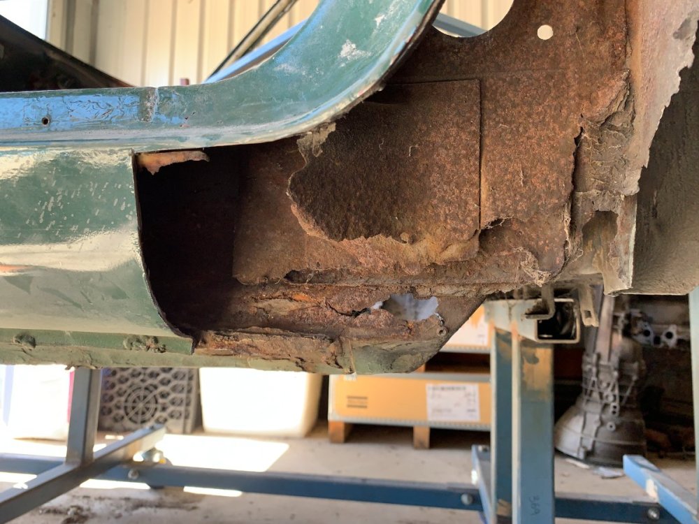

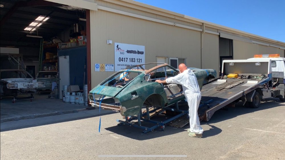

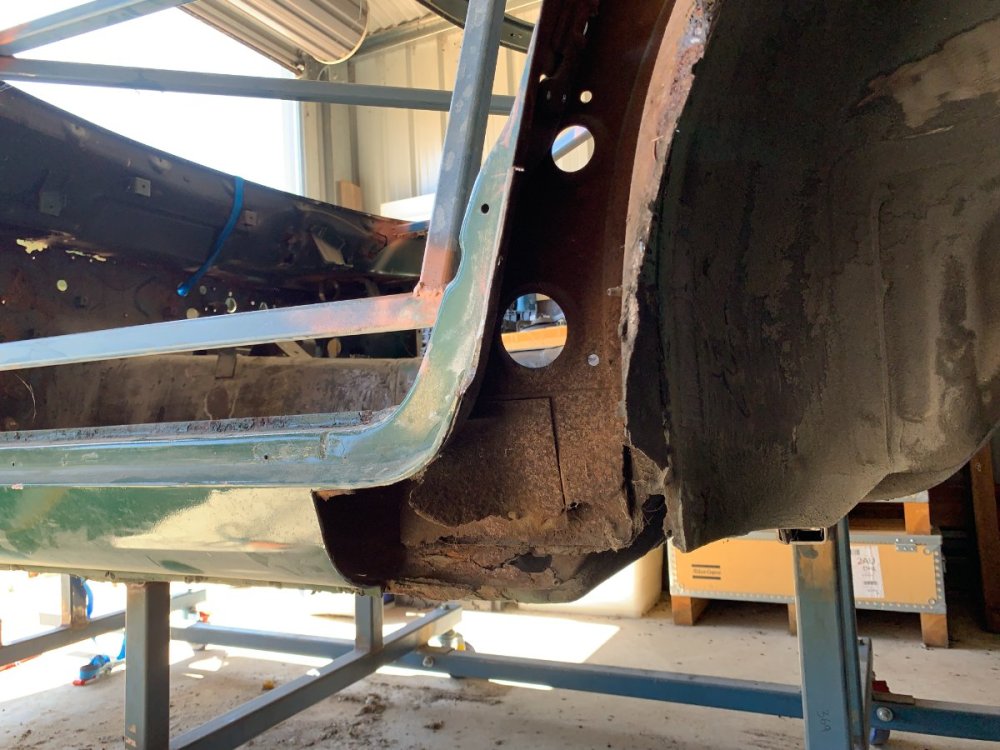

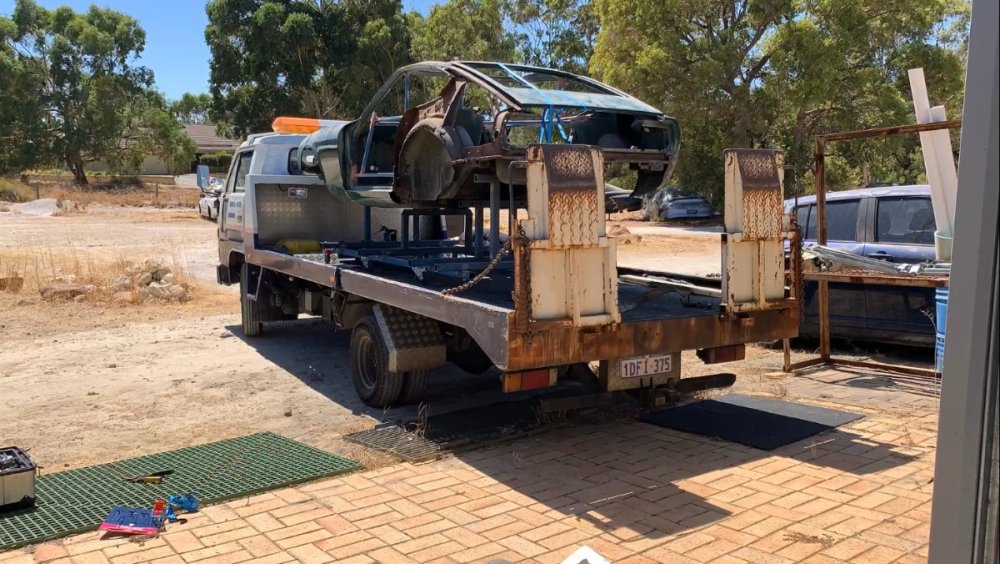

240ZBUILTBYME Posted March 8, 2023 Author Posted March 8, 2023 I ran out of time to get the RHS rear quarter off, just so time poor since my son started Kindy, his hours are half a day now instead of a full day at daycare, so Im no longer able to spend an entire day in the shed. Managed to remove the LHS quarter panel the morning the car was being collected, talk about cutting it close.... This side is much rustier that the RHS so im stoked i got it removed. I gave up trying to locate the spot welds as time was not going to permit it, I ended up cutting the area i knew the spot welds were in, I can patch the hole later. I ended up cutting where the rear quarter joins the rain rail due to time constraints and that section being completely rusted anyway found some crust behind the rear wheel arch which i knew would have some rot Car was loaded onto the truck and off at the blasters with no issues, Im both excited and nervous to see what comes back. Couple of weeks and it should be ready gav240z 1 Quote

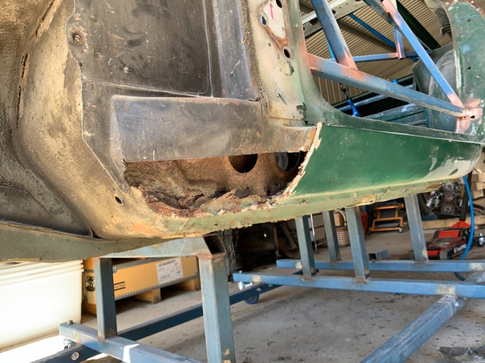

240ZBUILTBYME Posted March 8, 2023 Author Posted March 8, 2023 forgot a couple of pics, ended up cutting out the dog leg on the RHS and the front of the outer rocker as there was a huge hole anyway, this way the blaster will have better access Quote

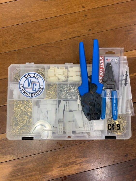

Administrators gav240z Posted March 10, 2023 Administrators Posted March 10, 2023 On 1/23/2023 at 8:25 AM, 240ZBUILTBYME said: Got a Full 240z kit from vintage connections to replace all the pins and terminals on my wiring harness Oh nice, they do a 240z kit? Quote
