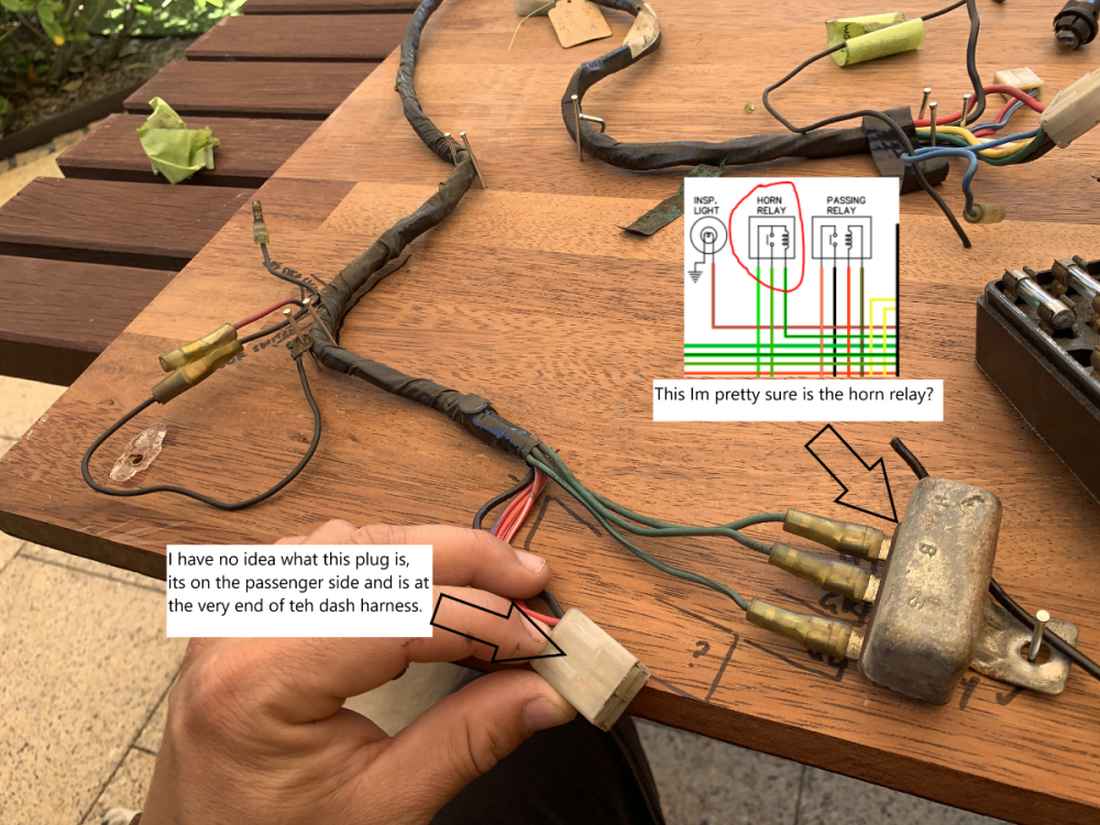

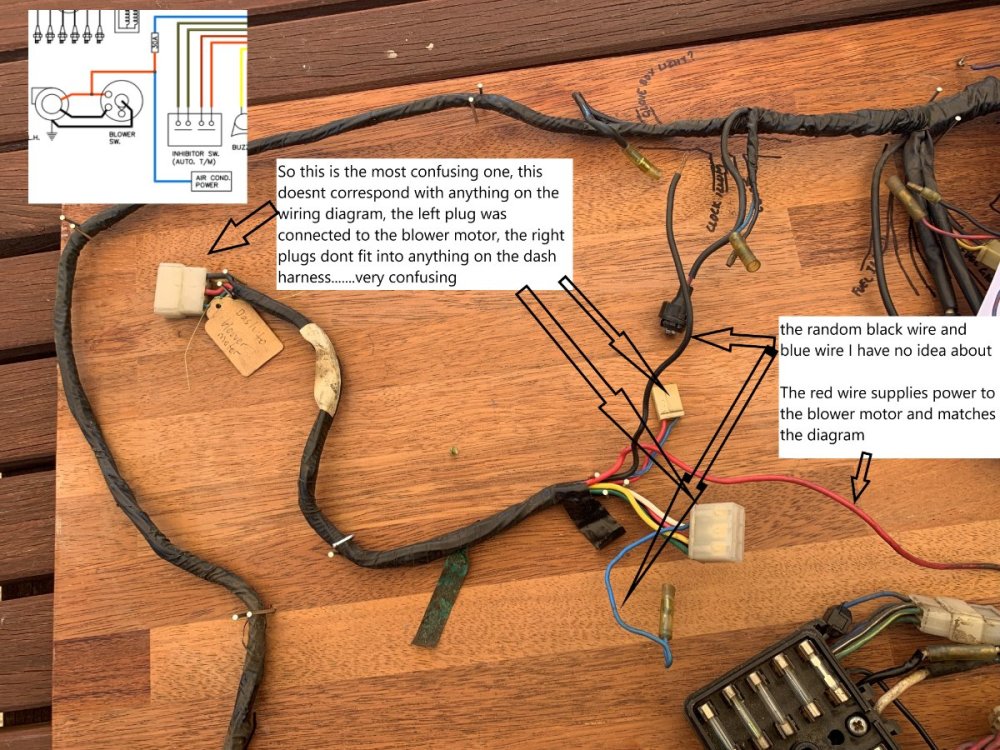

240ZBUILTBYME Posted March 24, 2023 Author Posted March 24, 2023 Martins giving me the hurry up to get my dash harness to him so he can install my gauges, I wanted to do an overhaul on all the terminals and plugs, so I first created a nail board and splayed out the harness. I then started studying the wiring diagram which to be honest at first look overwhelmed me, but once you have the harness splayed out and diagram in front of you it gets clearer. Then I marked out all the harness intersections on the board and began labelling each terminal using the wiring diagram to help me identify terminals or plugs that weren't connected to anything when i removed it from the car. Next I plan to strip the tape off the harness putting small bands of temporary tape to hold its shape and intersections, then Ill inspect and repair the wires, once I'm happy with the wires i will start depinning, replacing pins and plugs. before retaping I'm going to see if i can get it continuity tested or if i can do it myself. There are still some terminals I have not been able to identify, if there's any wiring gurus out there Photo 1 I think the plug might be the passing relay wire colors don't exactly match. I also have no idea what a passing relay is Photo 2 these two plugs weren't connected to anything and wires don't match anything on the diagram Photo 3 Photo 4 Photo 5 This one is really confusing, this short harness doesn't appear to be in the wiring diagram at all Quote
NickF Posted March 24, 2023 Posted March 24, 2023 Is the wiring diagram RHD there could be some differences if its for LHD? Nick Quote
240ZBUILTBYME Posted March 24, 2023 Author Posted March 24, 2023 24 minutes ago, NickF said: Is the wiring diagram RHD there could be some differences if its for LHD? Nick Haven't found a RHD one, i did a quick search on this forum but couldn't find anything usable, the ones on classic z cars are all LHD but in HD and have all wire colours marked out. I figured it would be a little different but not much Quote
NickF Posted March 24, 2023 Posted March 24, 2023 A coloured aus/euro spec would be great if anyone has one Quote
