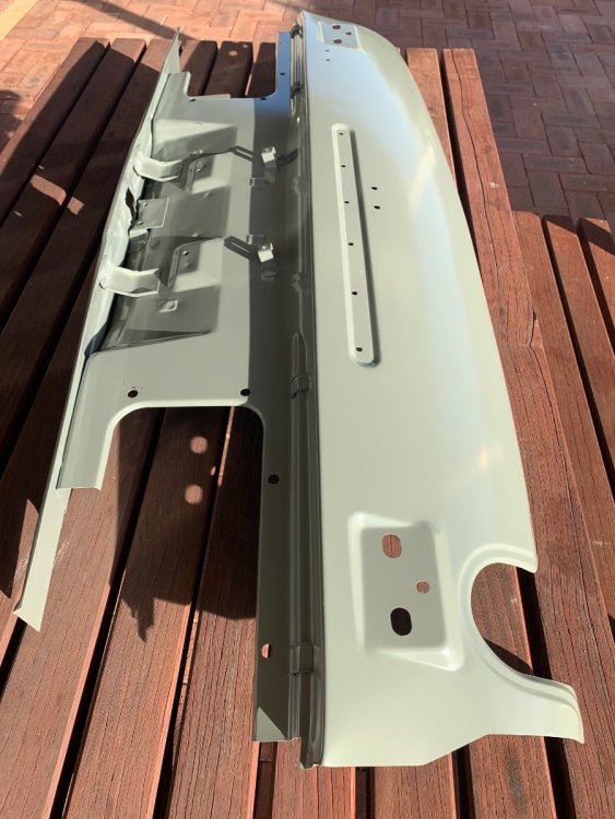

240ZBUILTBYME Posted May 31, 2022 Author Posted May 31, 2022 42 minutes ago, ND240Z said: How nice are NOS things! Did you manage to get a pair or just a drivers side? I have a NOS Passenger side, no idea how i'm gonna find a drivers side! So nice! But unfortunately super rare in perth. I got a pair! Yeah finding a single drivers side will be difficult. I follow a lot of middle eastern based Datsun parts pages on Instagram, I see a lot of NOS items come up on there but they’re very expensive and majority 280zx parts not S30 parts. But worth keeping an eye on. Quote

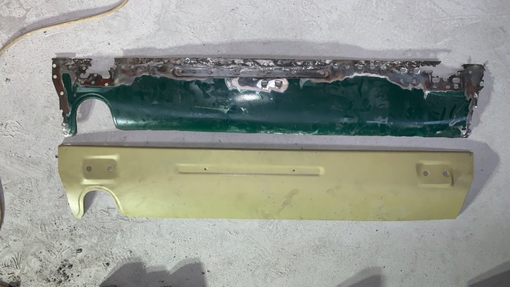

240ZBUILTBYME Posted September 14, 2022 Author Posted September 14, 2022 Progress has been steady lately, but the deeper I get into this the more I feel like throwing in the towel… you will see why shortly… unpicked the beaver panel today, all went well with no surprises. Now I will have good access to repair the box section behind it. couldn’t resist putting the replacement piece on to see moved onto the roof skin next. As I began I felt a sense of impending doom… wire wheeled the rain rail to reveal the spot welds. before after ah no, Your eyes do not deceive you, that is a giant frickin hole over the A pillar. Gazing into the darkness of this chasm I felt like my soul was being pulled from my body along with all my motivation for this project…. it was like gazing into the eye of Sauron himself…. Where the roof skin joins the rear quarter was also a huge hole. I’m yet to perform the archeological dig to extract the bog artifact from its resting place I didn’t even bother trying to unpick the spot welds, I just cut what little metal was left. Then I did a lot of swearing, bird flipping and inanimate object abusing. then I unpicked the rear of the roof skin. I used a 25mm scraper blade to help check if the panels were separated and to separate the last bits that were holding on, this allowed me to do minimal damage to either panel. I found it incredibly useful. I found the roof skin was tacked the roof structure in the corners where they couldn’t get the spot welder, I believe this is from factory if anyone can confirm. so halfway to having the roof off now, should knock it off next session, then start tackling the rear quarter panels. I feel like Captain America, I keep getting beat to the ground by this car, but somehow I manage to pick myself up and utter “I can do this all day….” But lately I’ve been getting ever so close to throwing in the towel. ND240Z, JDM-TOY and OdinZ 3 Quote
