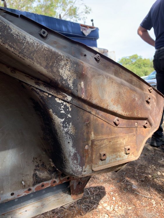

AndBir Posted April 20, 2021 Posted April 20, 2021 3 hours ago, NickF said: A lot depends on your aspirations for the finished car. Yep, and as almost all of this is hidden then as long as it is structurally sound then all is good. Maybe just cutting out the buckled sections and rewelding in sections is the best option. Likewise panel beating other areas and skimming with some filler will be suitable. 240ZBUILTBYME 1 Quote

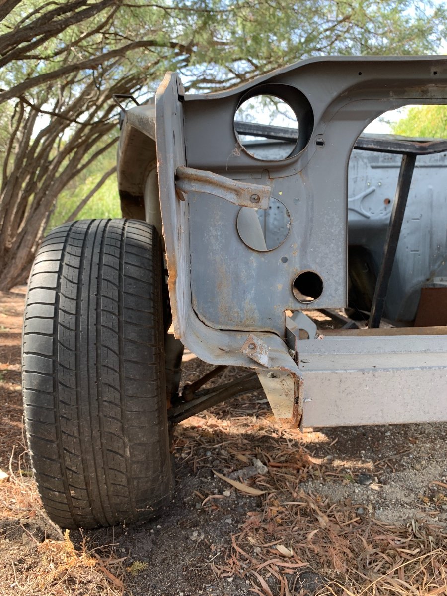

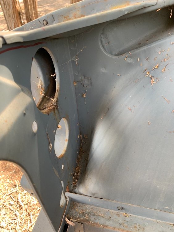

240ZBUILTBYME Posted April 20, 2021 Author Posted April 20, 2021 3 hours ago, NickF said: Hi Ryan That doesn't look too bad If the panel gaps were ok prior to pull apart then the damage might only be cosmetic. ( I'm sure people with more knowledge than me will give better advice) A lot depends on your aspirations for the finished car. These restorations are a journey of disappointments and great satisfaction Nick Yes the panel gaps were good but there many dodgy brothers alterations made. Front bumper was not able to be bolted in properly, Holes for sugar scoops slotted, front grille unable to bolted in properly. It’s certainly not going to be a show car, it is going to be driven and enjoyed. But I don’t think I can live with leaving it as is. Like my mama always used to say “if it’s worth doing, it’s worth doing right.” Quote
gilltech Posted April 20, 2021 Posted April 20, 2021 Quote I am now contemplating transplanting the front nose of a untainted car onto mine Good luck finding one! Better you fix what you've got rather than do a cut'n'shut anyway. And it's not like it's completely rotted out going by the photos. I suggest you measure it all up and compare to the factory specs to see if it's within tolerances or whether the basic structure has to be pushed/pulled on a chassis aligner to tweak it, before you lock it into your jig and rotisserie structure. But the way you're going with all this is a credit to you. 240ZBUILTBYME 1 Quote
240ZBUILTBYME Posted April 20, 2021 Author Posted April 20, 2021 1 hour ago, gilltech said: Good luck finding one! Better you fix what you've got rather than do a cut'n'shut anyway. And it's not like it's completely rotted out going by the photos. I suggest you measure it all up and compare to the factory specs to see if it's within tolerances or whether the basic structure has to be pushed/pulled on a chassis aligner to tweak it, before you lock it into your jig and rotisserie structure. But the way you're going with all this is a credit to you. I would normally be looking at repairing as I know how hard it is to find a front cut, but I am actually lucky enough have access to the sections I need from the car I got my roof cut from. Which is why a cut and shut is an option. Photos below 24 minutes ago, C.A.F. said: hahahaha come on @C.A.F. Your 2c would be appreciated here! gilltech 1 Quote
gilltech Posted April 20, 2021 Posted April 20, 2021 Quote I am actually lucky enough have access to the sections I need from the car I got my roof cut from ? ? ? (Confused). So you have two shells, is the grey primer one not the better of the two then? Quote
240ZBUILTBYME Posted April 20, 2021 Author Posted April 20, 2021 4 minutes ago, gilltech said: ? ? ? (Confused). So you have two shells, is the grey primer one not the better of the two then? No, the primered one is being wrecked near me. I haven’t got a price for the cut yet which will be what determines which way I go, I think... my uncle is a panel beater so he can assist in advising the pulling and repair. He is of the opinion that to repair what I have and to cut and shut are both equally a pain in the ass. either way my radiator support needs to come out. gilltech 1 Quote

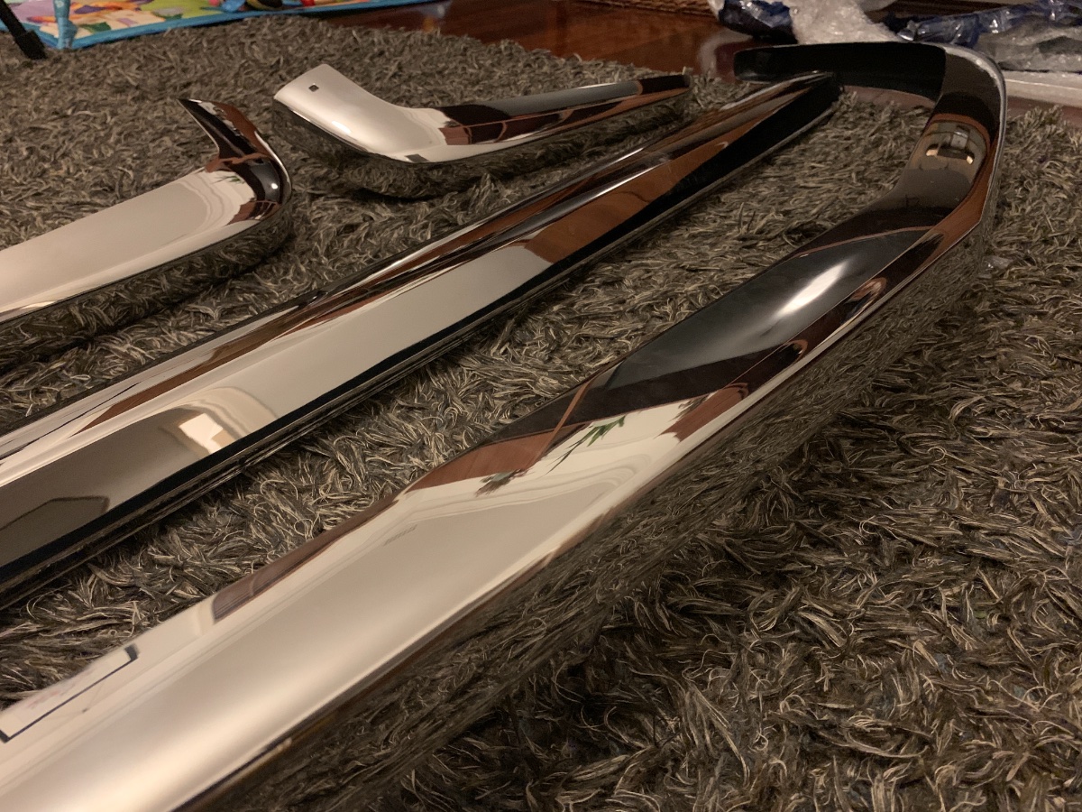

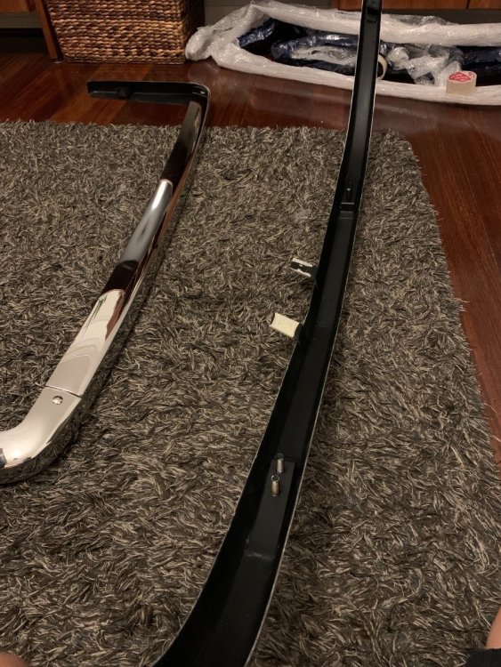

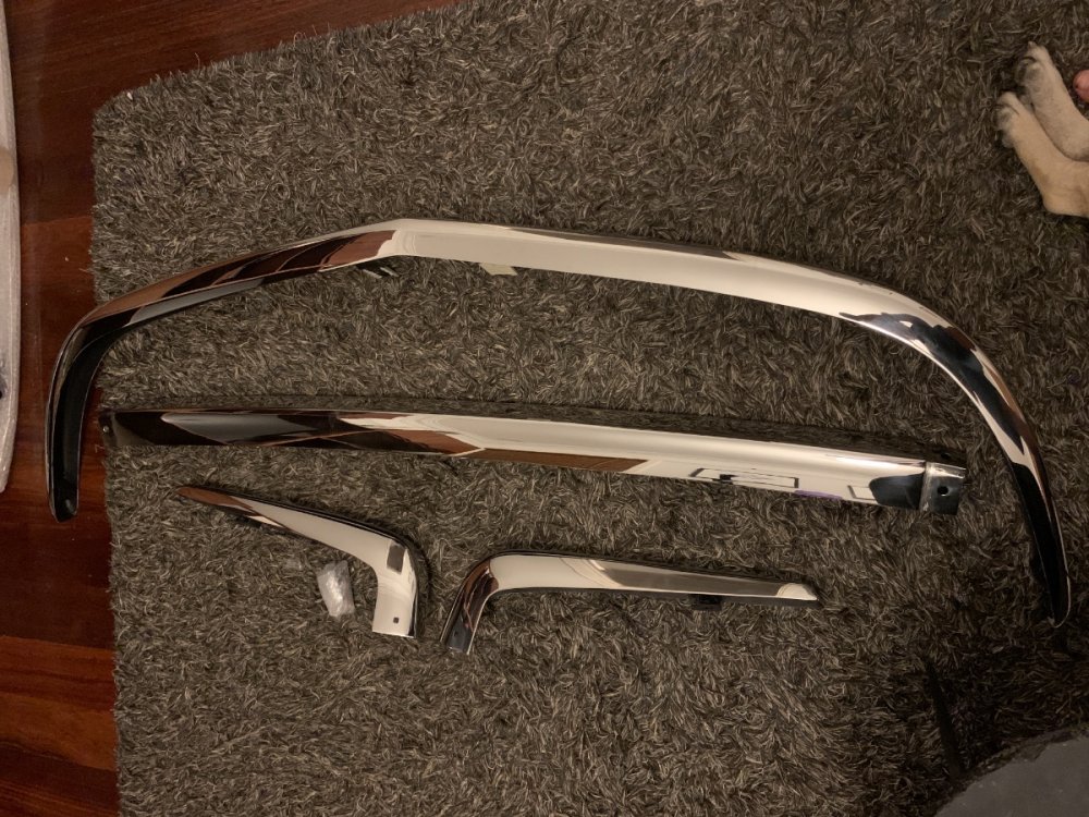

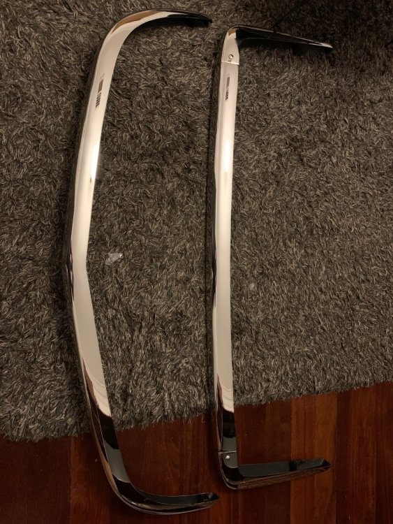

240ZBUILTBYME Posted May 18, 2021 Author Posted May 18, 2021 Also picked up some shiny new bumpers from bumper automobile out of Vietnam. Much cheaper to buy these than restore mine. Very impressed with the quality. gilltech, theremm, gav240z and 1 other 4 Quote
gilltech Posted May 18, 2021 Posted May 18, 2021 Good move. The quality of the original chrome wasn't particularly good. 240ZBUILTBYME 1 Quote
Administrators gav240z Posted May 18, 2021 Administrators Posted May 18, 2021 The test will be the longevity of it... re-chroming ain't cheap. But I was blown away by how good mine came back from AA Vinnies in Dandenong. https://www.vinneys.com.au/ Hopefully your Vietnamese ones work well. 240ZBUILTBYME 1 Quote
240ZBUILTBYME Posted May 18, 2021 Author Posted May 18, 2021 40 minutes ago, gav240z said: The test will be the longevity of it... re-chroming ain't cheap. But I was blown away by how good mine came back from AA Vinnies in Dandenong. https://www.vinneys.com.au/ Hopefully your Vietnamese ones work well. From all accounts they wear well, only issue is microscratches during washes etc but I’d say it would be cheaper to have someone buff and restore the shine than to rechrome. Not sure... my bumpers were rat shit so it would have cost an arm and a leg to get them to this standard! Quote

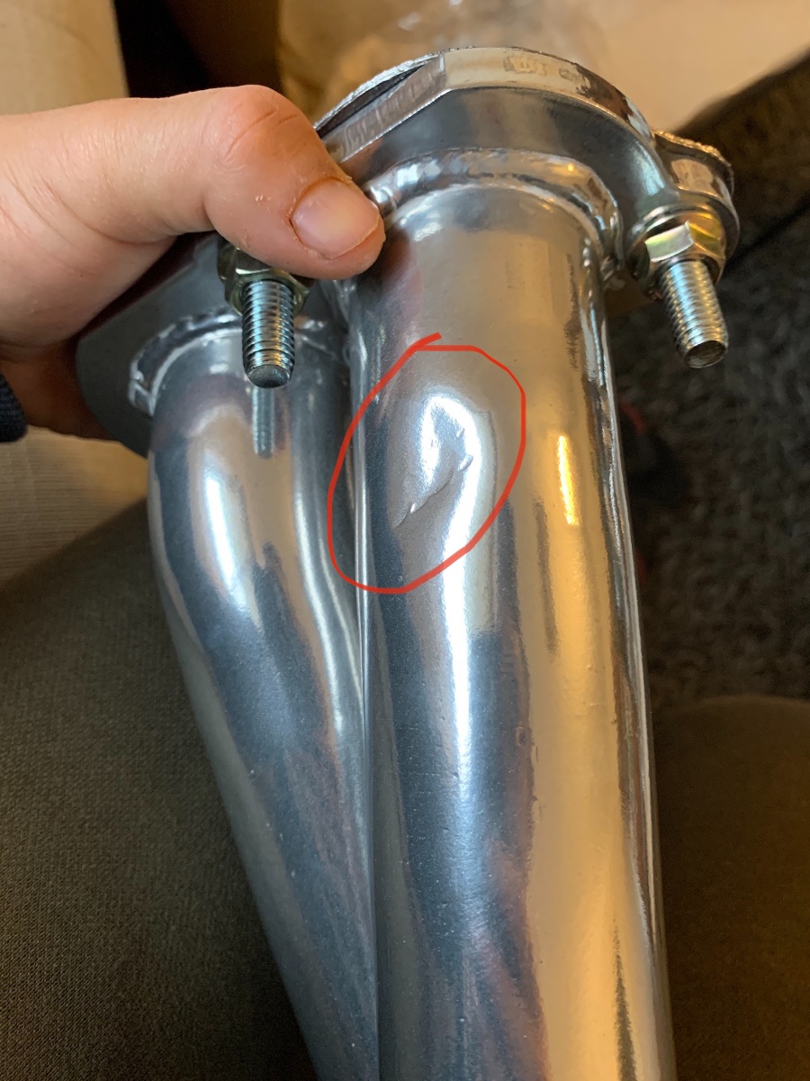

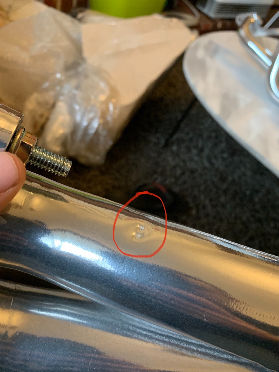

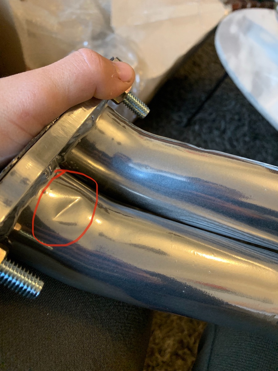

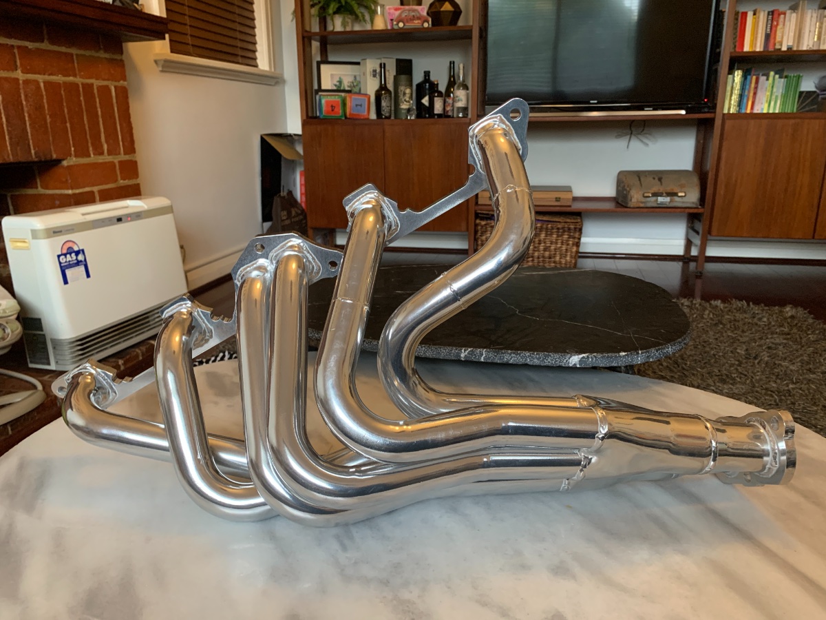

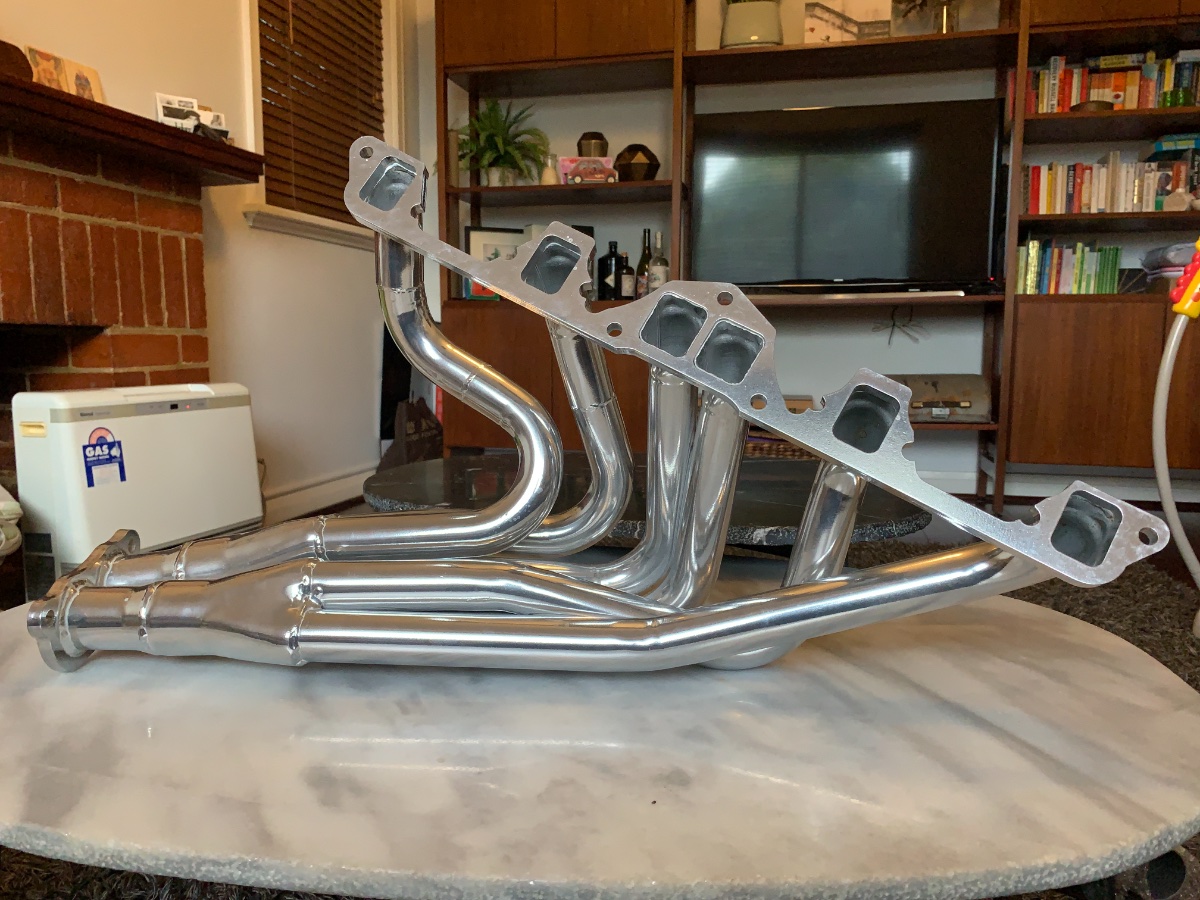

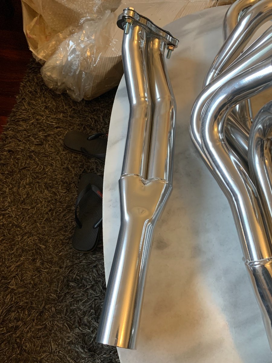

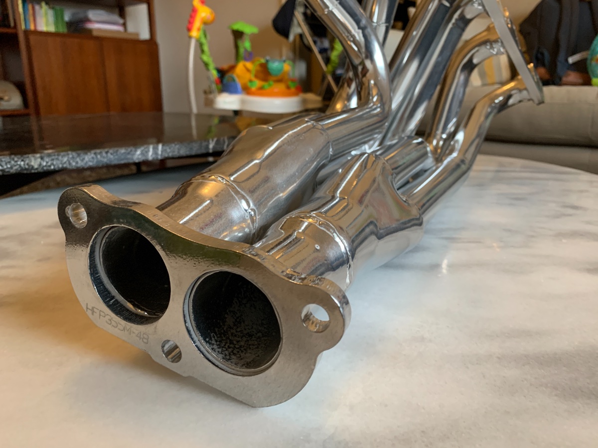

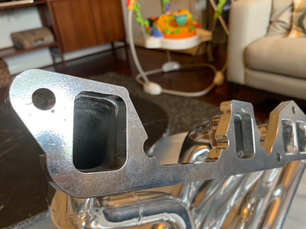

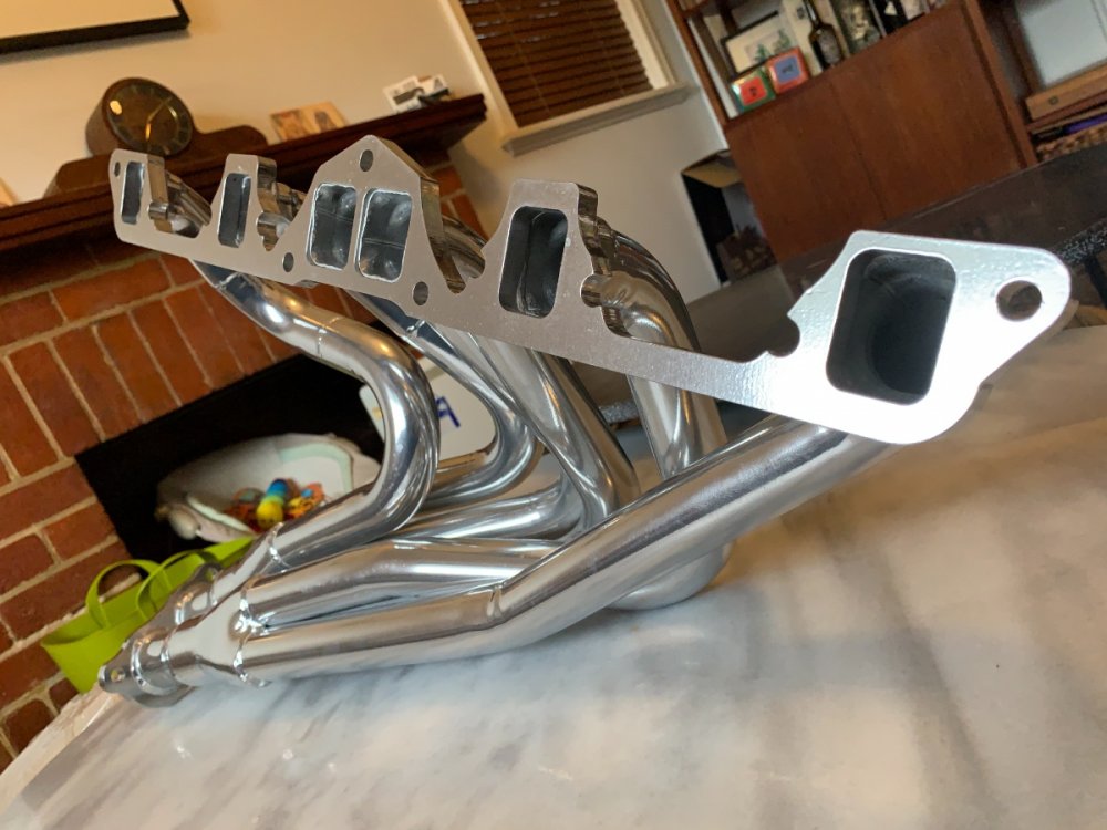

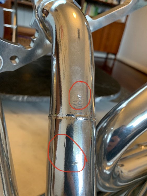

240ZBUILTBYME Posted June 9, 2021 Author Posted June 9, 2021 So going on uncle lurches advice I contacted Les Collins and ordered a set of his L series extractors. Les is great to deal with and very forthcoming with information. the extractors look great overall, had them ceramic coated too. However I was a little disappointed with the number of dents and dings and surface imperfections in the coating. I don’t know if I’m expecting too much and maybe this is a standard finish on extractors. Wouldn’t mind someone else’s opinion. I’ve never purchased extractors before. Quote
Administrators gav240z Posted June 9, 2021 Administrators Posted June 9, 2021 Hmm looks like someone was a little rough handed with them, did you ask Les about it? Might be worth a call to see if that's just part of the manufacturing process or if someone was rough at them during the ceramic coating stage? gilltech 1 Quote
