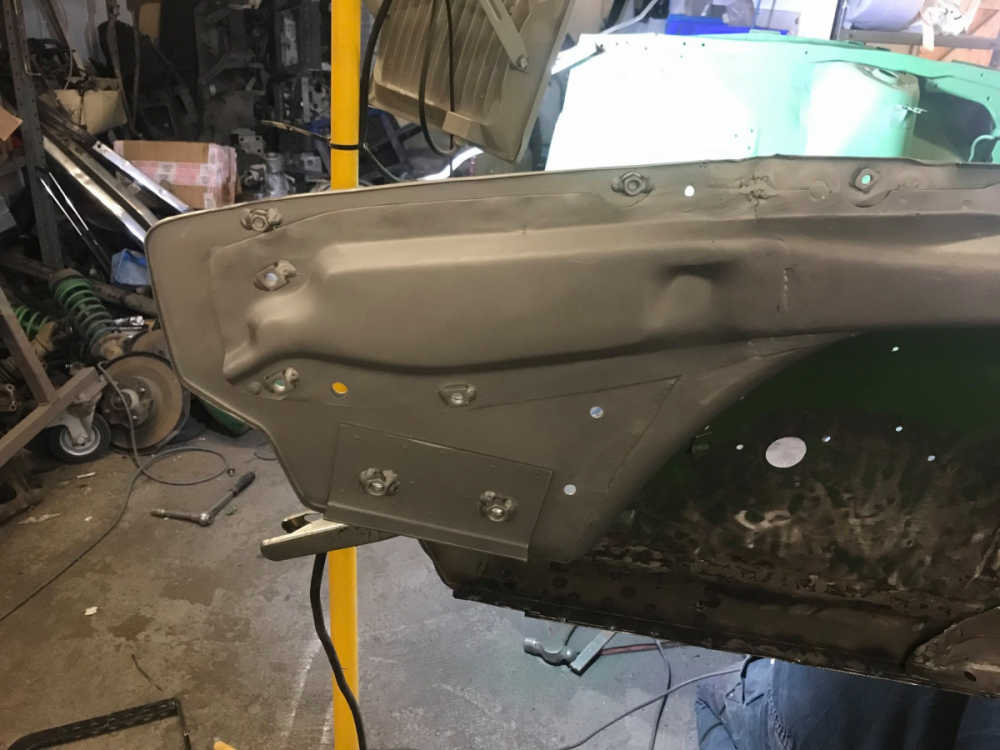

240ZBUILTBYME Posted September 2, 2020 Author Posted September 2, 2020 (edited) 51 minutes ago, daretobedifferent said: You can still cancel the order from MSA if you haven't paid. Even if you've already paid for KFM, you can get a refund for a part back easily as long as they haven't shipped it yet. Check this: https://www.jdmjunkies.ch/wordpress/2020-01-12/240z-rear-lower-valance-comparison/ (the main diff is the exhaust outlet between MSA and APS and the rear bumper holes are diff between APS and Original) Thanks mate, I really do appreciate the advice. I have emailed MSA to cancel the rear valance section. At first I thought "ahhh bugger it, its ordered" but I do want this car to be as good as it can be within reason. and if Im having to buy any additional panels from auto panel solutions it makes sense. Im going to just keep the rear slam from KF, not too fussed about that panel as no one but me will see it and its not a concourse resto. Edited September 2, 2020 by 240ZBUILTBYME Quote
daretobedifferent Posted September 2, 2020 Posted September 2, 2020 The upper fender rail section looks alright, you'll just need to grind down the weld and a bit of hammer work to straighten out that top edge near the weld. I don't think you'll need to find a new piece for that unless its rusted or beyond repair. Quote
240ZBUILTBYME Posted September 2, 2020 Author Posted September 2, 2020 2 hours ago, daretobedifferent said: The upper fender rail section looks alright, you'll just need to grind down the weld and a bit of hammer work to straighten out that top edge near the weld. I don't think you'll need to find a new piece for that unless its rusted or beyond repair. sorry thats not mine, just needed a pic of the part I was thinking of! Quote
