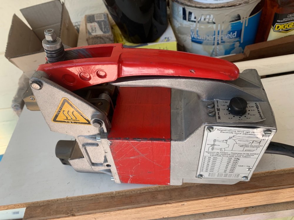

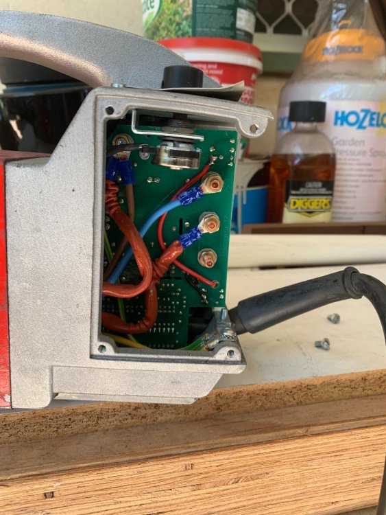

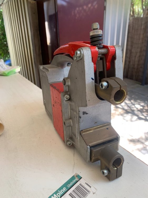

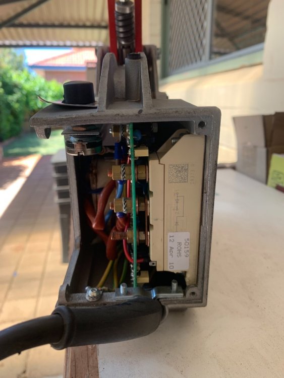

240ZBUILTBYME Posted October 17, 2020 Author Posted October 17, 2020 (edited) So not a great deal done on the car lately, had a terrible bout of influenza which took 3 weeks to kick. And had a week long course in between all of that... i did however get my hands on a second hand spot welder off scumtree! It’s had a fall and is missing some parts but it should do the job. Got it for $350. Missing arms/electrodes and a 15a power plug. So didn’t get to test it prior to purchase, but the guy seemed trustworthy and said he hardly used it and said to bring it back if it doesn’t work. Not too big a deal, I would have bought some longer arms anyway and Lurch has recommended I get some dog leg electrodes. Opened it up today to see if anything internal was damaged when they dropped it. All looks good inside. I’ll try straighten it up later. Plan to use this on frame rails, floor pans, rear hatch panel, rear valance, inner/outer rockers, a few other spots and roof skin replacement if I end up doing that on my own. I’m hoping it will save a lot of time and effort. Edited November 29, 2020 by 240ZBUILTBYME Quote

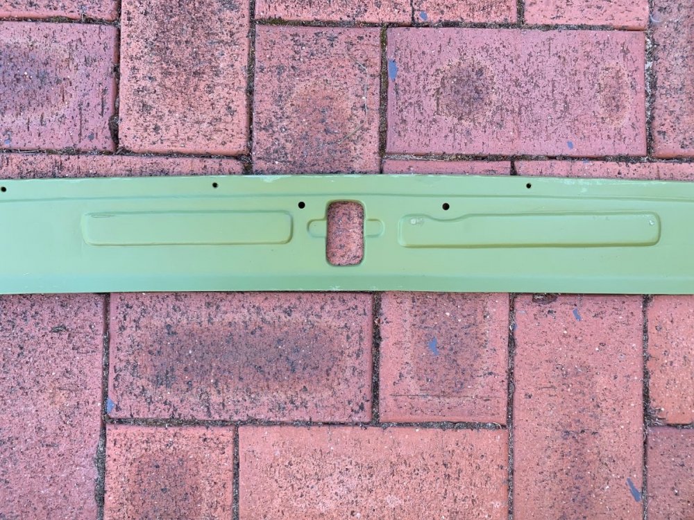

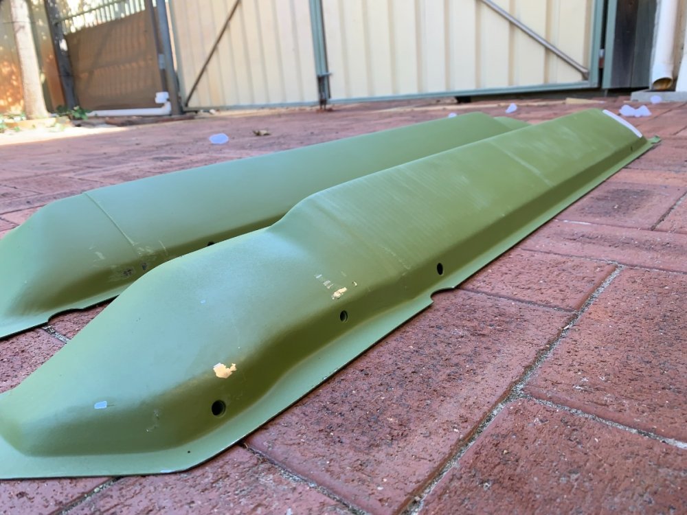

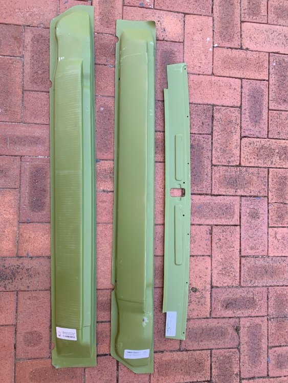

240ZBUILTBYME Posted October 17, 2020 Author Posted October 17, 2020 (edited) Also received the outer rockers and rear hatch panel from KFvintagejdm. Panels look really good especially rockers, very oem looking, I don’t know how they compare to tabco items. Even have the captive nuts for the front fenders. Rear hatch has a pressing that is not quite straight but I’m not fussed as no one will be seeing it. Edited November 29, 2020 by 240ZBUILTBYME gav240z 1 Quote

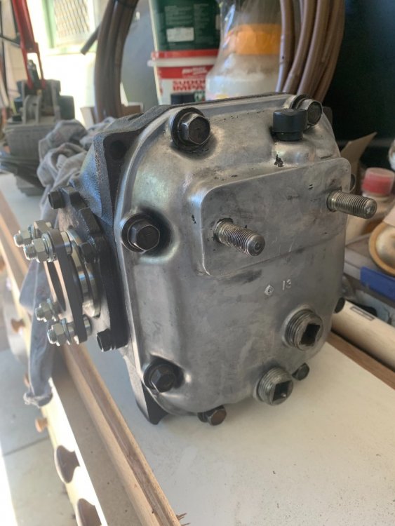

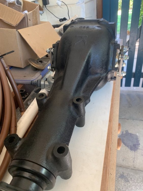

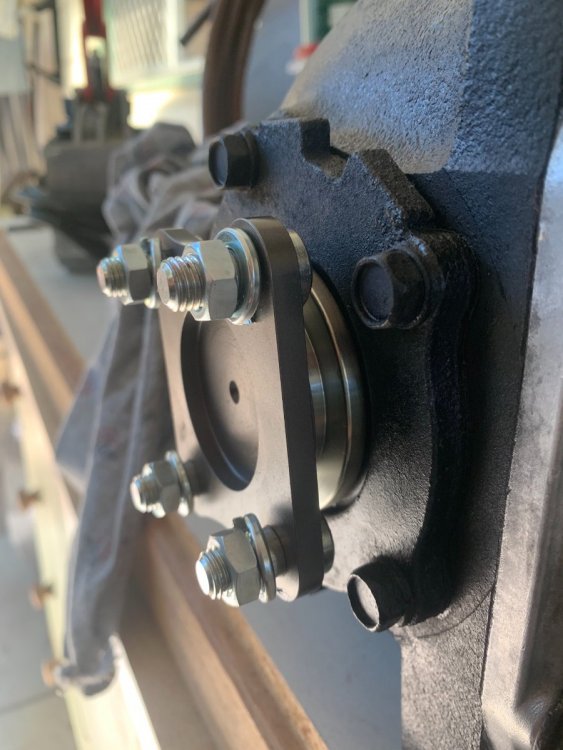

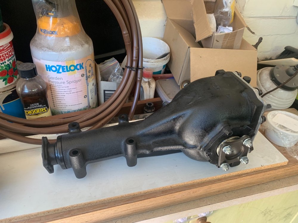

240ZBUILTBYME Posted October 20, 2020 Author Posted October 20, 2020 (edited) This week also swapped my diff for my new Subaru R180 LSD diff with kemeari flange adapters. Looks very nice... I will tidy up the back plate a bit more and throw some clear on at some point. This is officially the first completed part for the car! Unfortunately it wasn’t done by me but I’m celebrating nonetheless! LSD in a 240z for under 2k. Also picked up a second hand RHS door skin, it’s a rare spares but got it for 2/3s the price of a new one so that’s a win. Has surface rust but good otherwise. Also collected my steering wheel, might need a new horn pad but I’ll research how well they can be restored, it’s not really a circle anymore and internal foam is perishing due to age. Photos of these to come Edited November 29, 2020 by 240ZBUILTBYME CBR Jeff 1 Quote

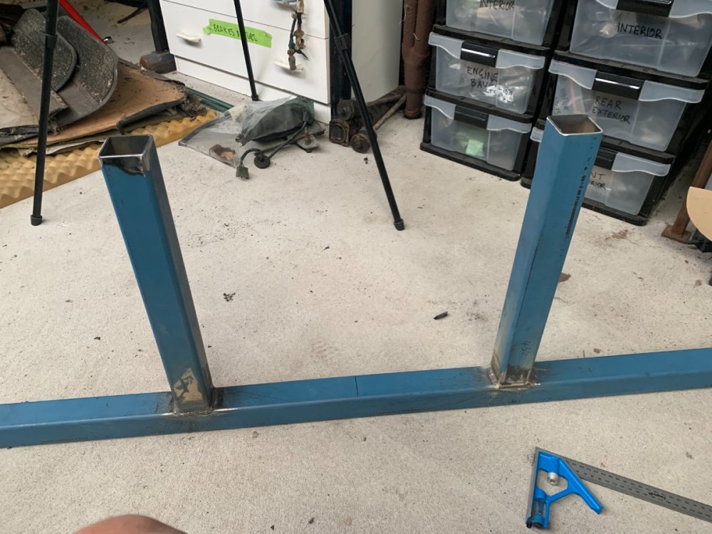

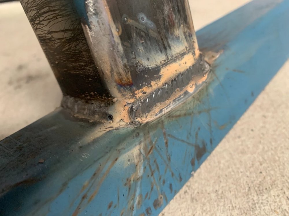

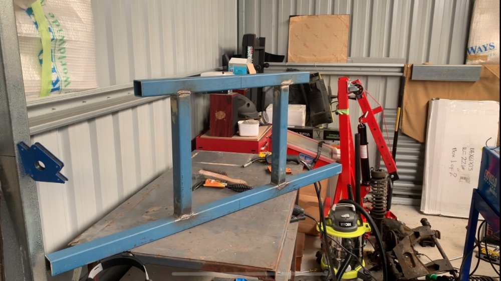

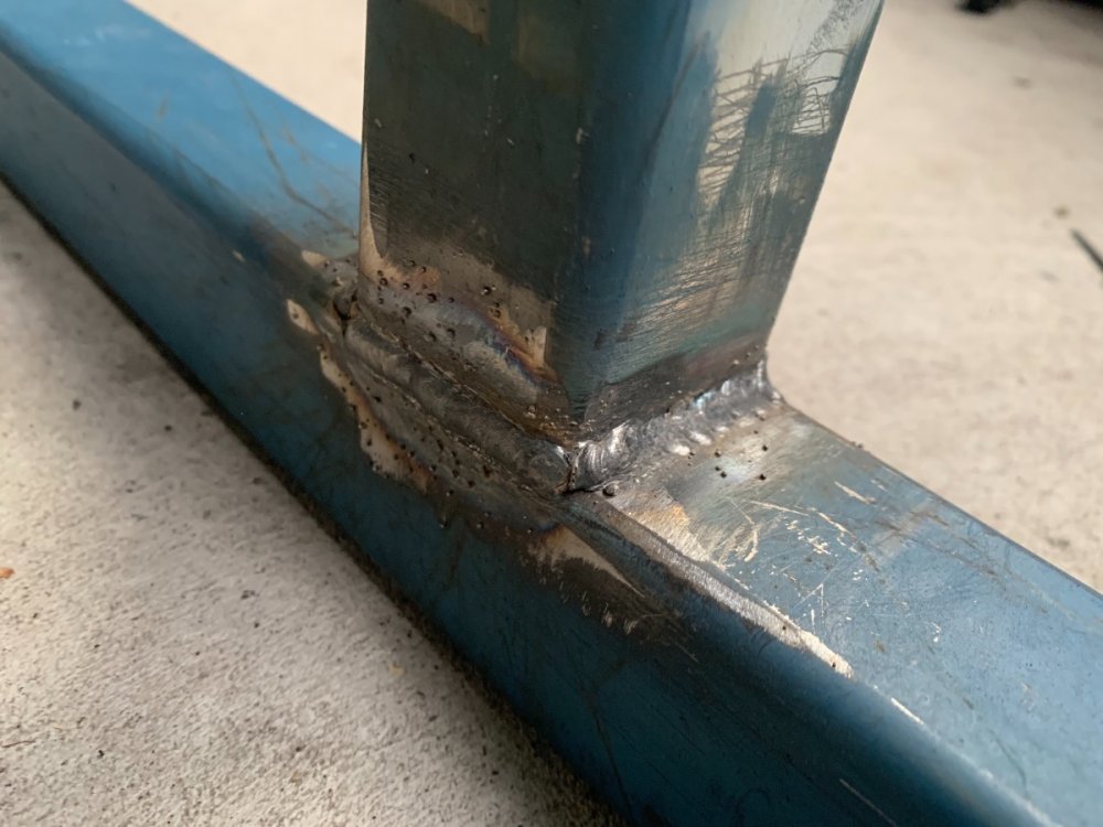

240ZBUILTBYME Posted October 20, 2020 Author Posted October 20, 2020 (edited) And here is the total progress for the week. First frame completed for the chassis jig, this will bolt into the front sub frame holes, still need to add some angle for the bolt points. This took me about 1.5-2 hours. It’s the second time I’ve welded and the first time I’ve done any metal fabrication on my own. My main goal was to keep it square. Had to cut out and reweld a few times due to welding/racking in the wrong sequence which pulled the frame out of square. What I learnt was: - tack on opposing sides so they pull against each other as they cool - weld the fillet weld t joins before you weld the flare bevel welds (where the beveled corner meets the cut edge on a t join) -when welding the flare bevel weld work mainly on the bevel corner edge and work back into the straight edge occasionally or you blow holes. Also lay flare bevel welds flat so they are facing up, so the molten metal falls into the gap. Not sure if this all makes sense, it does in my head... - tack the whole frame together before you do any full welds Came out square! I’m stoked, next few frames should go heaps quicker. Edited November 29, 2020 by 240ZBUILTBYME AndBir and Bruce 2 Quote

240ZBUILTBYME Posted October 30, 2020 Author Posted October 30, 2020 Completed the next frame which attaches to the gearbox support mounts in the trans tunnel. Drilled out the bolt holes and made sure it fit before welding onto the rest of the frame. My welding is getting better and quicker. But still slow as... this took me 5 hours including drilling. Came out square so I’m happy! next time I hope to finish the last 2 frames... Quote
