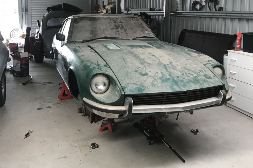

Really looking forward to getting this project moving and getting all of your input and advice along the way!
Names Ryan, I have been a lurker on here for a very many years now. I am the long time owner of a 1971 240z here in Perth. Vin is HS30-001063
I have owned the car for 10 years. When I bought the car it was in rough condition, tried to get it running to enjoy for a while but the previous owner had neglected it too much. So I decided not to waste money or time and wait for a ground up resto. Then it took me 8 years to find a decent space to start the resto (my dads new shed).
I started the tear down in late 2018 but then had my son so it went on the back burner for another 1.5 years. Now I am almost finished the tear down and excited to get some real work done. Unfortunately I have another baby due in November! Damn! Lol
I have also started a YouTube channel to document the restoration. At the moment they’re pretty boring dismantle videos but I plan to make them better quality and more exciting in the future. Your support would mean the world to me!
http://www.youtube.com/channel/UCHZhre0vm7sL2Kl7hUQFVkg
About the car:
History unknown, bought it from a very energetic guy who pretty much ran it into the ground, was completely neglected and unmaintained. I knew I wanted to do a full restomod however, so this was not an issue for me.
Car has a L20 engine and may be an originally automatic gearbox, hence the L20 swap and that the gear lever barely lines up with the hole in the trans tunnel. L20 will be thrown in the bin.
Car is green originally and has had a terrible quality respray.
Car had a relatively minor front end collsion, bent sugar scoop/front bumper support and some light repairs to radiator support
Basically everything on the car needs replacing/restoration, nothing is reusable in a sense I can just rebolt it on the restored car.
Plans for the car:
Due to the car not having the original engine I see no point in going back to stock original. may as well create the car I want, so many things will not be stock
- Color change, unsure as to color just yet but leaning toward original datsun white or a pearl white
- L28 stroked
- Triple Weber set up but thinking of keeping SU's initially to save some $$$
- BC Coilovers, techno toy tuning 3 point strut brace in front and 3 point strut brace in rear
- Initially all suspension components will be restores and reused to save $$$ (however I havent ruled out installing some pretty techno toy tuning/ apex engineering components at a later date)
- Brake upgrade to front and disc upgrade to rear. not going big brakes as I dont like big rims on the 240z
- Custom interior - I am an upholsterer by trade and am going to be doing the interior myself and upgrading it. Think Alcantara and leather
- wheels are undecided but something of the period, watanabes/rotas etc
- Fender Mirrors for that classic japanese sports car look
- Majority of the chrome will be painted in a satin black, I am not a chrome fan unfortunately.... (I know this will upset many of you)
94D3FAB1-5DA9-4F25-A743-55C3A6C02B82.thumb.jpeg.3bba79b381784da23ccd4662c420a787.jpeg21B38679-E37B-43CB-9DBD-1F48A7E21A1B.thumb.jpeg.e79b861cf73e6e69abe4680bc57019c4.jpeg

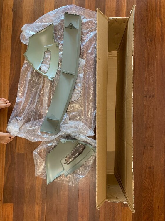

If rust has not been previously cut out then consider this new supplier for replacement panels etc : https://kfvintagejdm.com/product-category/datsun/https://kfvintagejdm.com/product-category/datsun/
Keep an eye out for feedback on a members order from this supplier :
Thanks for that AndBir, Lots and lots of rust. I saw one of your posts about these being really good quality. I’m thinking of getting a few of their panels as they have some that MSA don’t make. Such as the front and rear rocker reinforcement that sandwiches between the inner and outer, plus the full frame rail instead of just the straight bits.

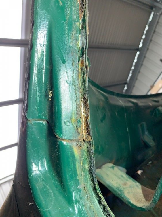

If you have a look at episode 4 I go through some of the rust in the roof. Has anyone repaired any rust in the roof like this? Ive seen a couple of roof reskins on this forum but nothing overly in depth on what is repairable and what is not. I also have rust in the A pillars at the end of the drip rail panel (photos below), I'm guessing its worse inside.....:'( Anybody seen rust in this area? I've tried searching but cant find anything on auzcar.
Im thinking about having a restoration shop do the repairs on the roof, pillars and cowl sections as they are quite complex and beyond the skill of a novice such as myself. I feel confident enough to do most of the other rust on my own.

Welcome Ryan.

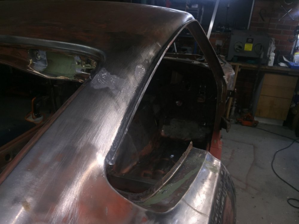

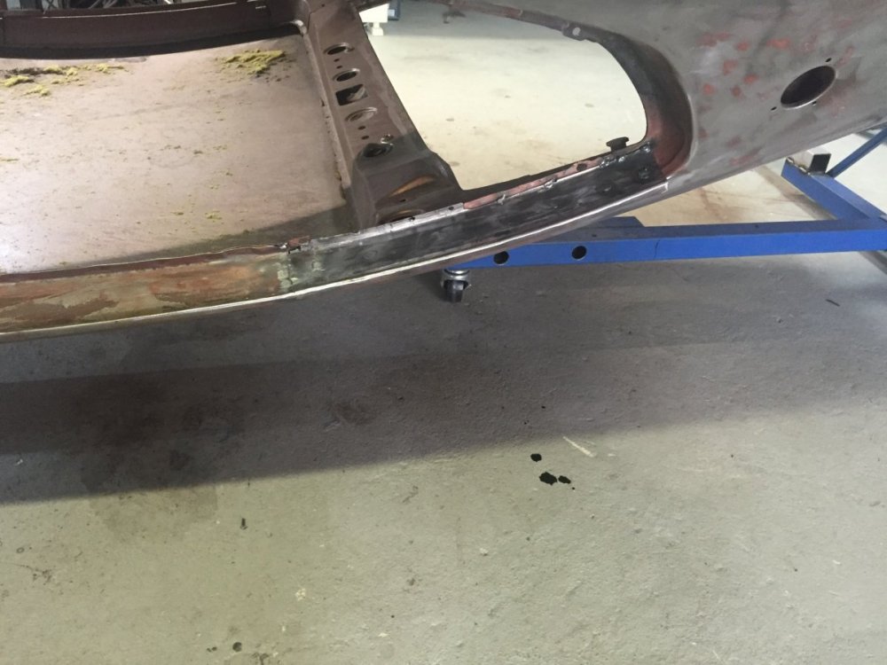

My car had a few rust spots along the passenger side in the turret. At the top of the A pillar I could cut it out and replace a section. Probably not as bad as yours though. Also the end of the gutters on both sides had some rust that I managed to cut out and replace sections. Rust was very localised. I borrowed an inspection camera and had a good poke around with in to make sure I had not missed any other spots. I also re soldered the body joints.
Jeff
AE9C6E29-EAE9-44AD-8749-B57CF0FD4643.jpegA6C19E7C-3B40-4909-B9B7-E2CD494A4B51.jpeg86997C7A-3CE6-455D-B333-5BD02BE52D84.jpeg
6 hours ago, CBR Jeff said:
Welcome Ryan.
Jeff
Thanks for the feedback Jeff. I have the same spots you had at the rear end of the drip rail too. Yeah I feel like my roof rust is pretty well spread, especially the LHS I showed in the vid. I feel like I need to strip the entire roof to ensure the rust is properly eliminated. Last thing I want is 5 years after shes painted bubbles start appearing.... I do have a clean roof skin donor to transplant if it comes to that.
Ryan
17 hours ago, AndBir said:
Thanks for thinking of me AndBir! I do indeed need these but ad says local sydney pick up... and also can get them half price from MSA! Im going to be purchasing a heap of panels  from MSA/KF very soon, just waiting for that little oz battler to get a bit stronger vs the USD$. I think I'll pull the trigger around 0.75c...8)

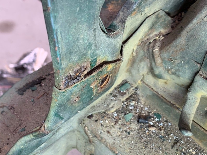

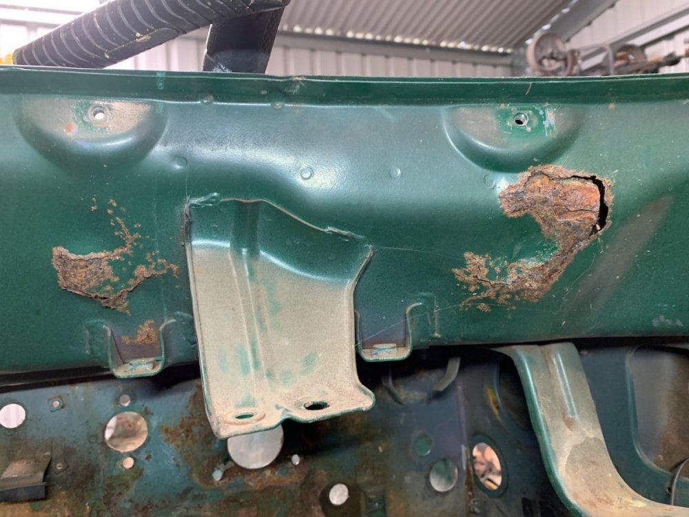

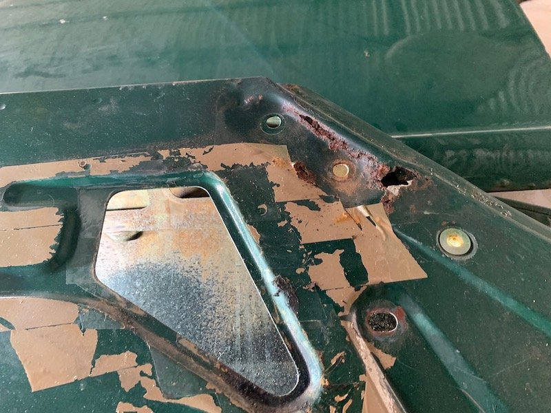

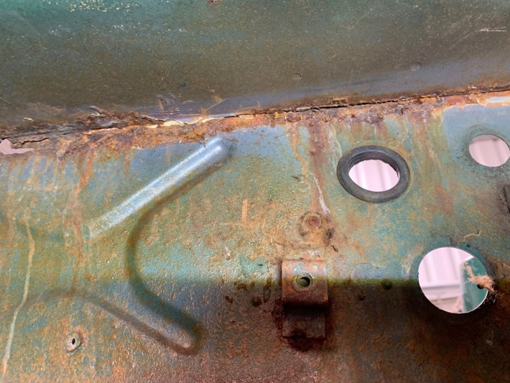

First cab off the rank is the cowl section. rusted all the way across where the lower cowl panel meets the firewall. Not sure how common it is for these to rust here

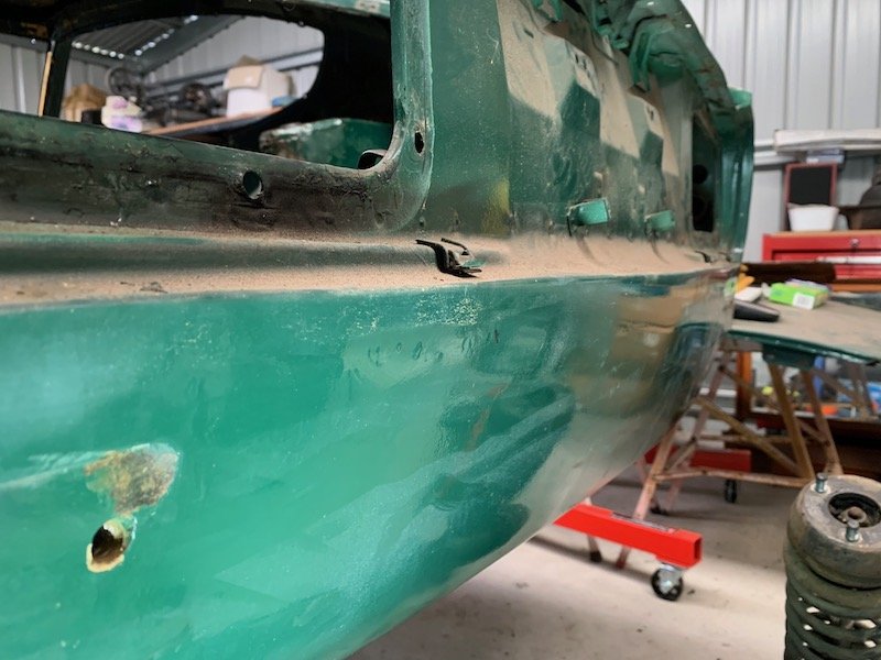

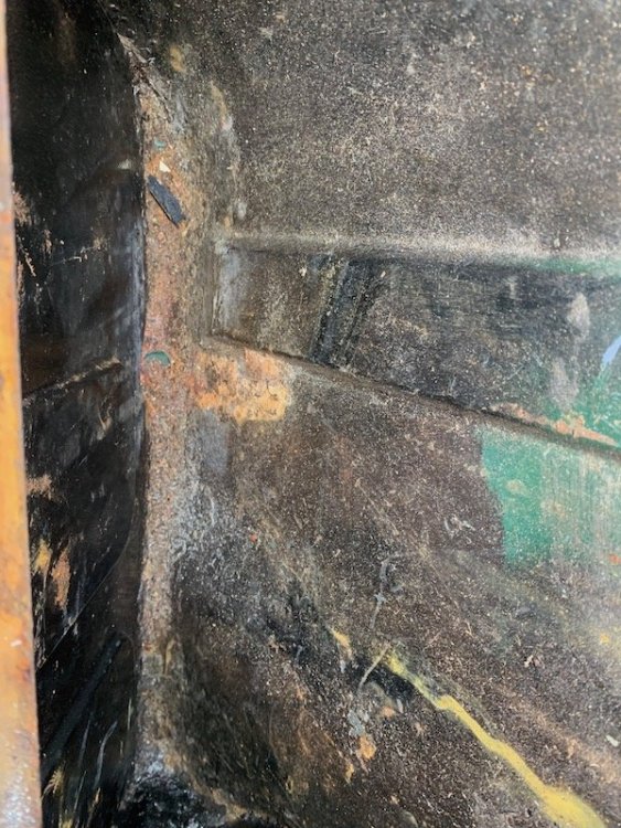

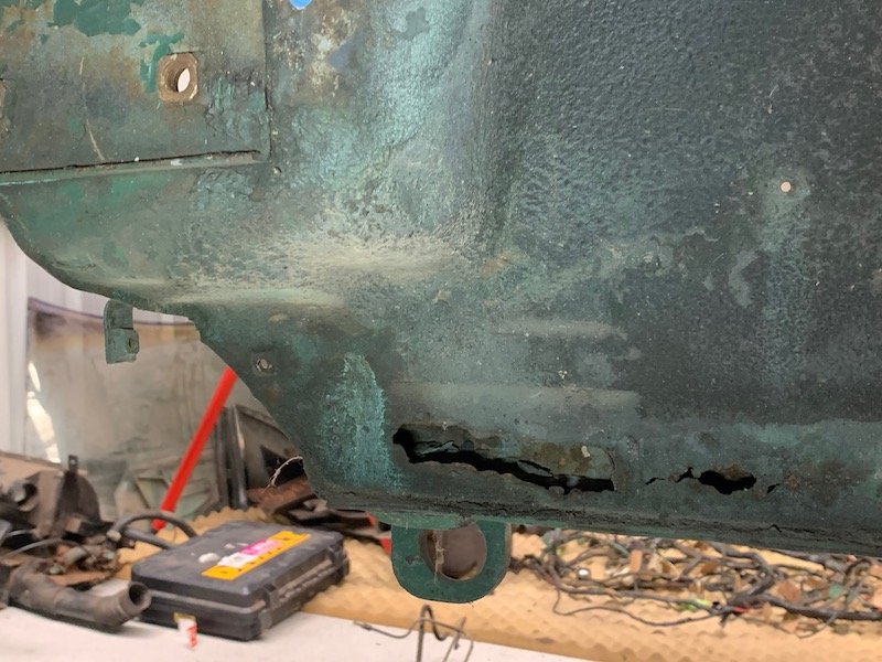

Posted (edited)

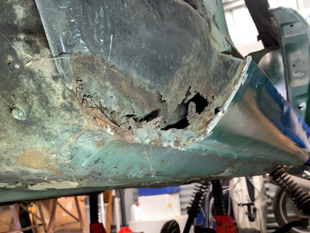

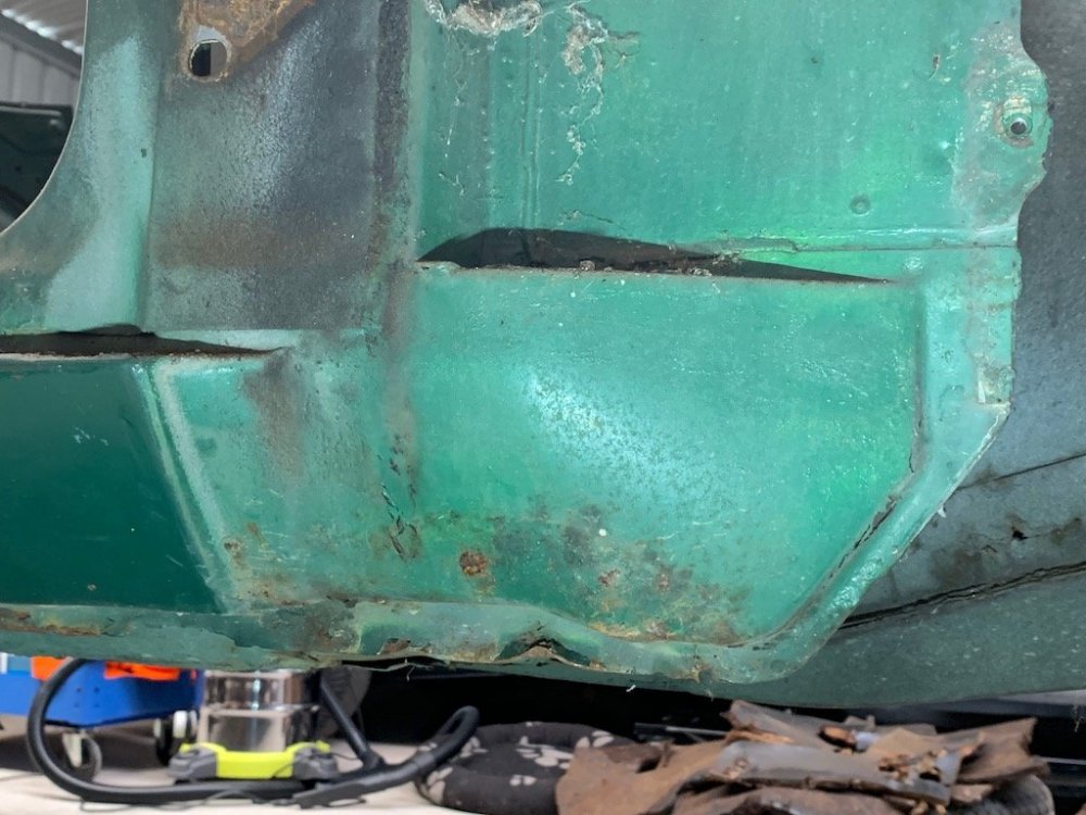

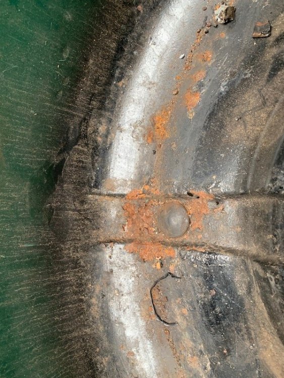

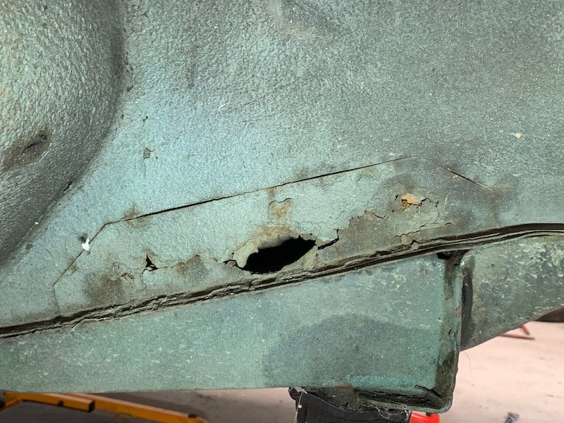

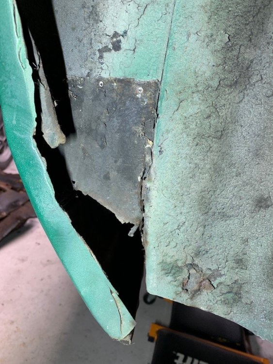

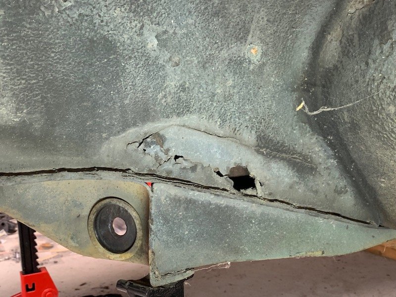

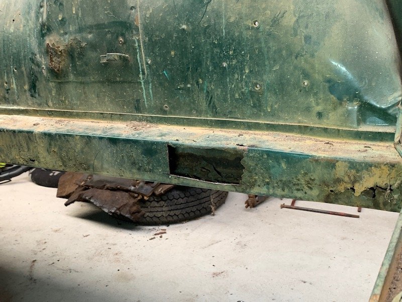

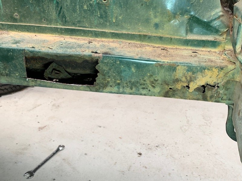

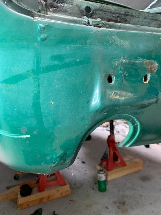

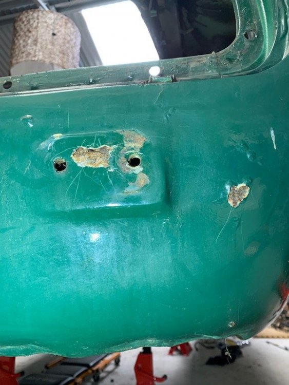

Next up we have the Dog Legs made of Bog, the outer sills that dont exist and rear arches that have all been very dodgily repaired by PO
Dog legs are made of bog on both sides
IMG_3874.thumb.JPG.027ba38fc8f87f016f11067d8c7e4334.JPGIMG_3885.thumb.JPG.7751f2791198461315ef8cbafe66c23b.JPGIMG_3860.thumb.JPG.e1bb5c5c6d1bd1d28574e342bde0ac5f.JPG

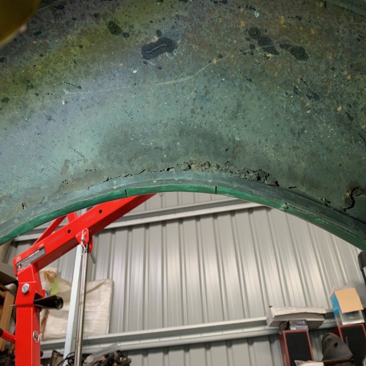

Rear Arches LHS and RHS, Inner and Outer are toast

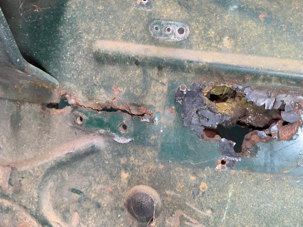

Found this nice little panel at the front end of the LHS rear wheel arches....
removed and found a nice little portal to another dimension, the dimension of rust....
Inside view, looks like lots of bog and dodgy panel work (not really visible in the photo)
I will finish off sharing the rust demons tomorrow, I need sleep....
Edited by 240ZBUILTBYME

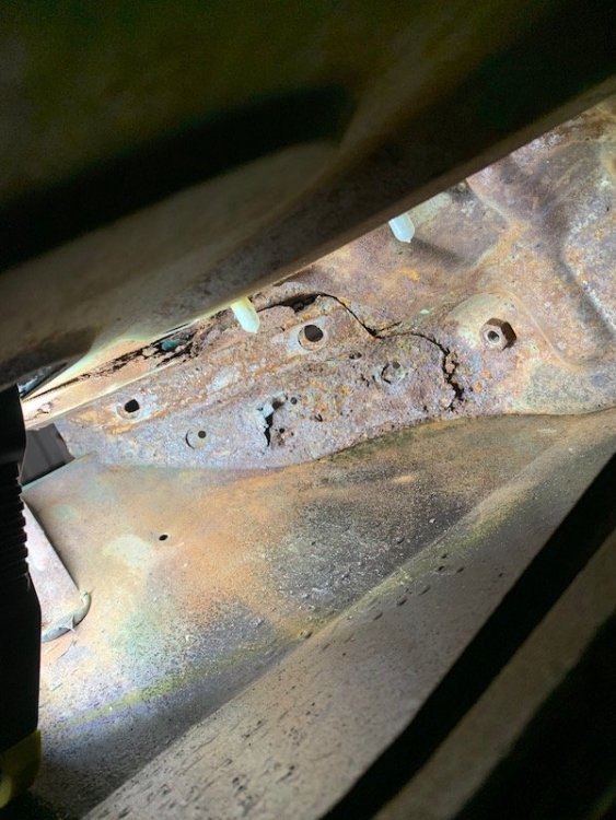

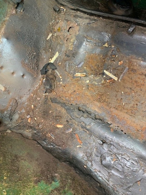

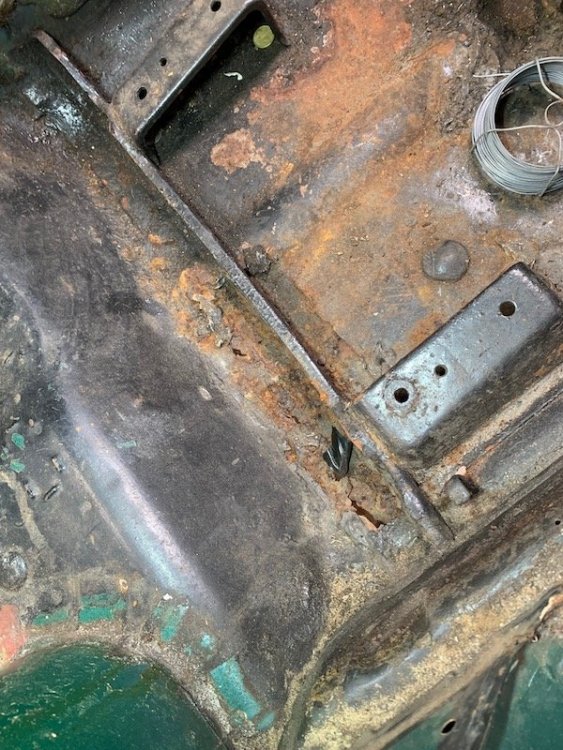

Posted (edited)

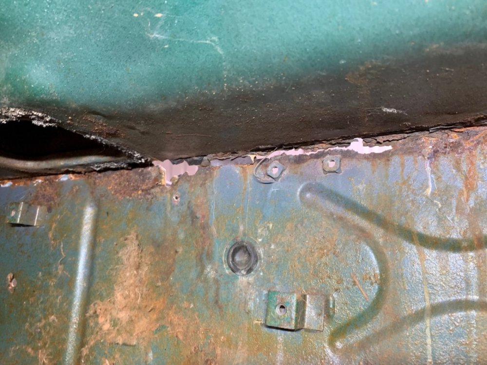

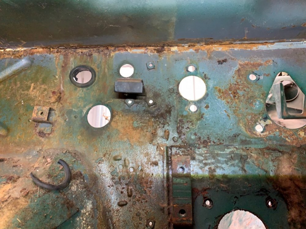

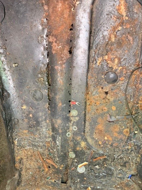

So round 2 of my rust reality...

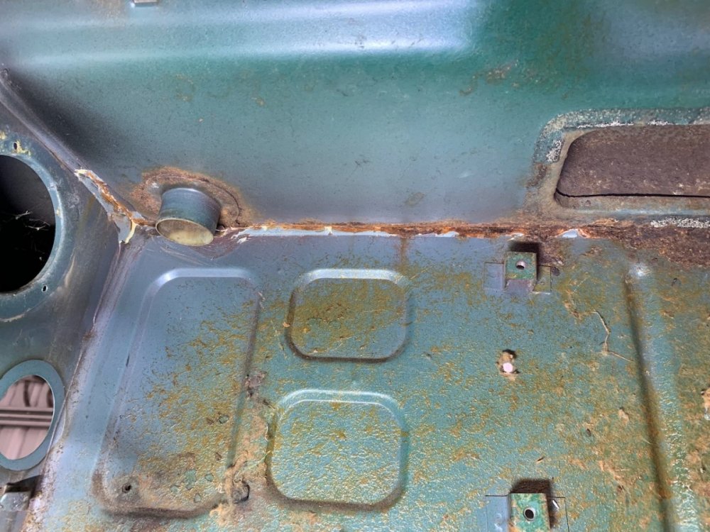

Floors are really bad, PO just kept adding new layers and filling it with silicone.
IMG_3864.thumb.JPG.c6e9a9da508e5060fa7ce3f55a11eed1.JPGIMG_3863.thumb.JPG.c0191c15b733981710999e66f0af8ff8.JPGIMG_3896.thumb.JPG.9cf930f0c8c694df51c041d7af87aeab.JPG

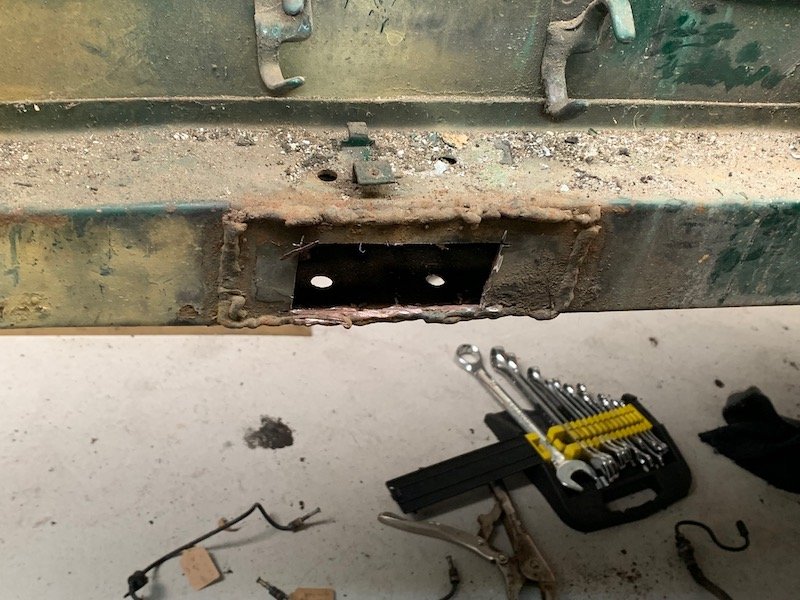

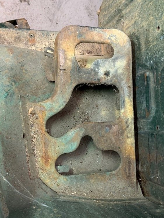

Tool storage compartments also have rust. Maybe I should have just listed the places that dont have rust? Would have been quicker
IMG_3870.JPG.971e517aafd80f577e1743393f2a6f59.JPGIMG_3925.thumb.JPG.b89695eac988750abd1f0976c0690792.JPG

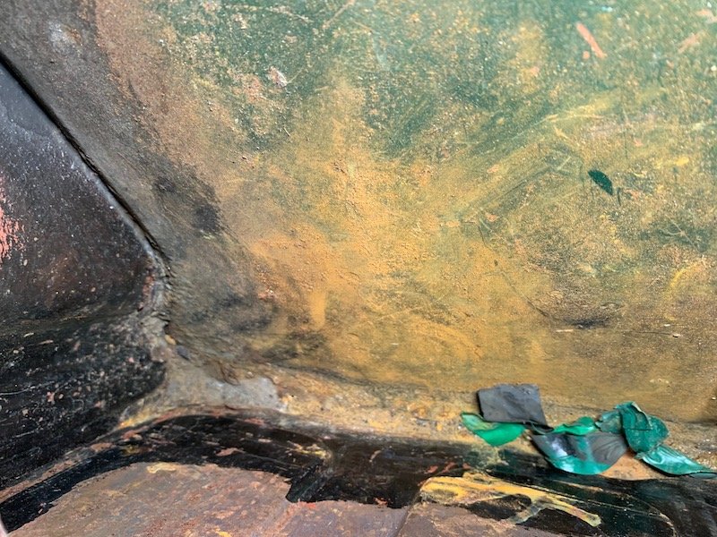

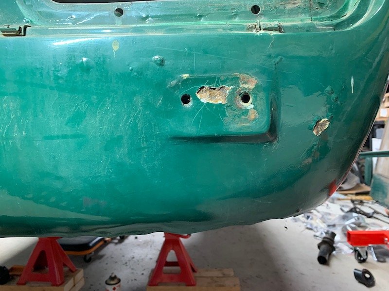

Posted (edited)
All the joins along the rear valance panel is starting to bubble....
IMG_3911.JPG.0f7e4ced464b29992c0903923b87109b.JPGIMG_3912.thumb.JPG.07302d235074daa75d349ad39c8a32d9.JPGIMG_3913.JPG.0c9504ca76ca78298c0933f63e10f475.JPGIMG_3914.JPG.4c49a88deab68c5062582a5b8a7464e7.JPGIMG_3916.thumb.JPG.401470dbbd22456d46e364e547ec6a71.JPG
As per usual on z's the rear slam panel has disintegrated...
IMG_3872.JPG.eb5669d7d4c81e90434e55abb9c5e903.JPGIMG_3927.JPG.f33347101ff88b44468c8eb0597f247c.JPG
small amount of rust in the tyre well

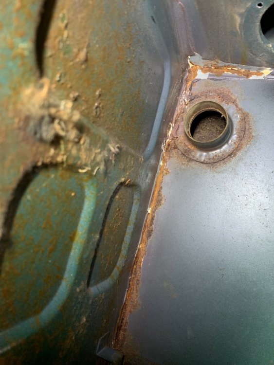

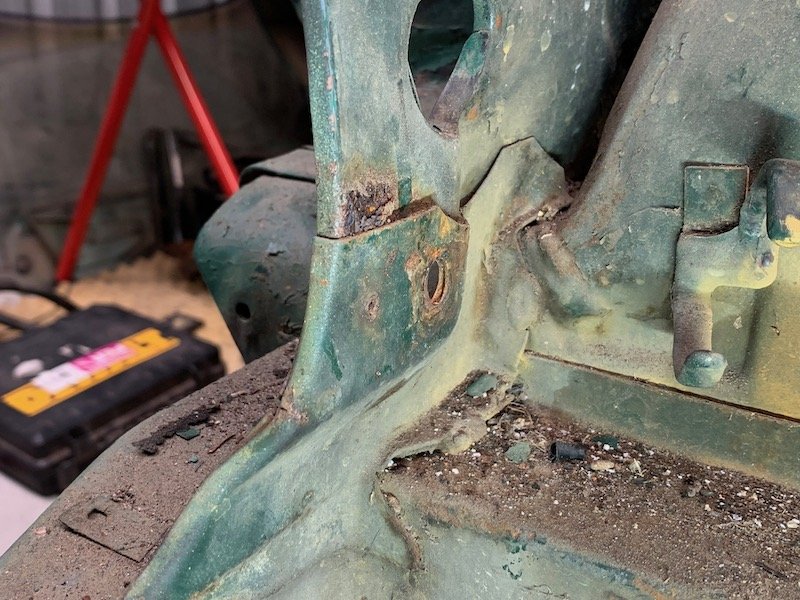

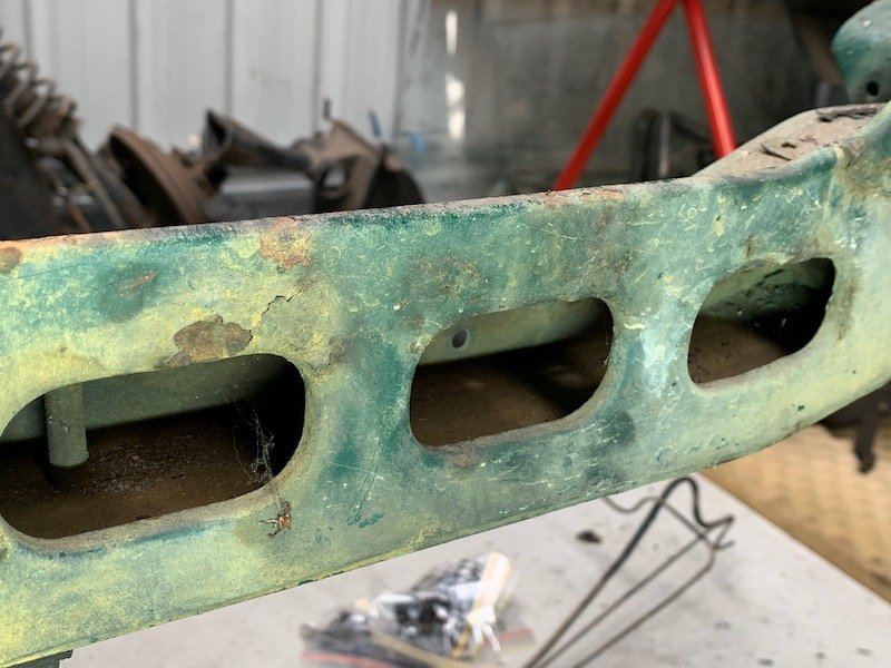

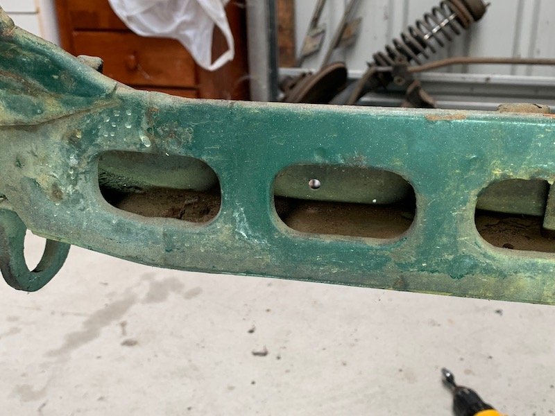

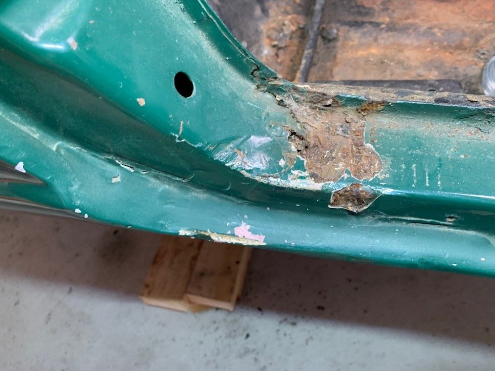

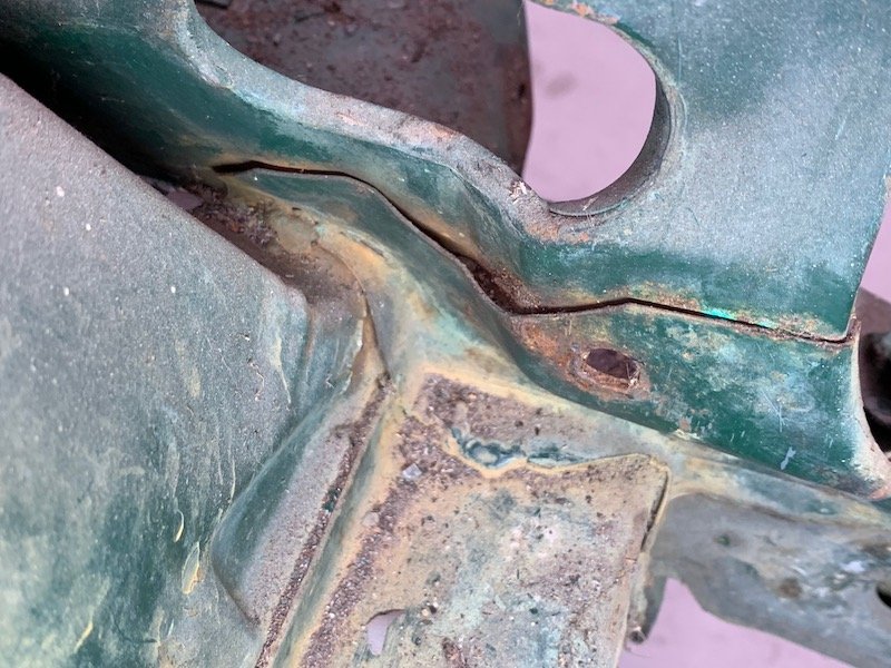

Posted (edited)

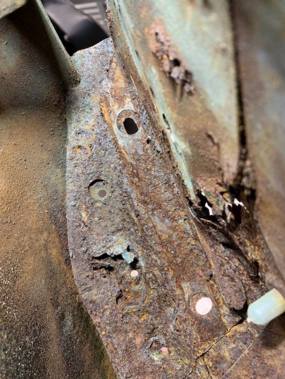

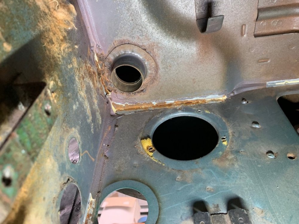

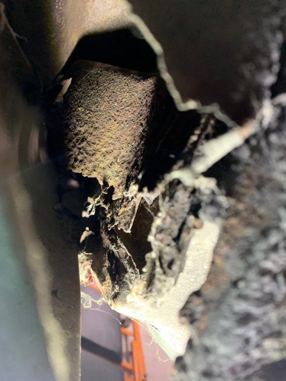

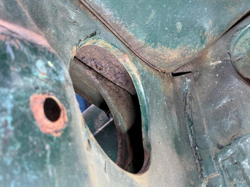

 Frame Rails on both sides will need replacing, LHS is significantly worse
IMG_3876.JPG.14282db72bd24e88fdb849f134296503.JPGIMG_3875.JPG.9ce5254ed1d57eccc08974546666138f.JPGIMG_3881.JPG.20257fcc0ca87fad368952ee56370c2a.JPGIMG_3883.JPG.dad592ce6e2f200959417ba143c24b5a.JPGIMG_3884.JPG.24ef9f86772370bed74122d111c02c5f.JPG

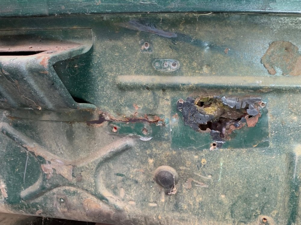

There was already a big rust hole there, I cut the hole bigger to take a peak inside, was surprised to find.... lot of rust inside.....;D
Also take note of the nice rust spot on the shock tower panel!
Battery tray area got off scott free, few little spots but nothing scary.

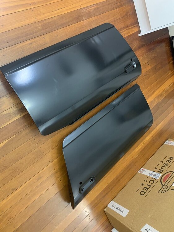

Posted (edited)

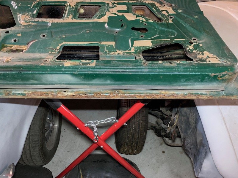

So if you havent already noticed the LHS of the car is wwwwwwaaaaayyyyyy worse than the right, and the doors are no exception, these photos are only the LHS door as RHS only needs a patch panel at the bottom like most doors.
IMG_3934.JPG.e96c7d4b48de9c35a53f92710199cc4c.JPGIMG_3935.JPG.06ebef1b54761c7d594119f27b1c7f3d.JPGIMG_3936.thumb.JPG.69c5e876338b757b8841c366460785a9.JPGIMG_3939.JPG.4b8e899cb3a8399ec8f8b7772717492e.JPGIMG_3940.thumb.JPG.596e185a7552bb8a9bb65ad86922054e.JPGIMG_3941.thumb.JPG.d6bacf28db9a5a385d1465cc1b44fe12.JPG

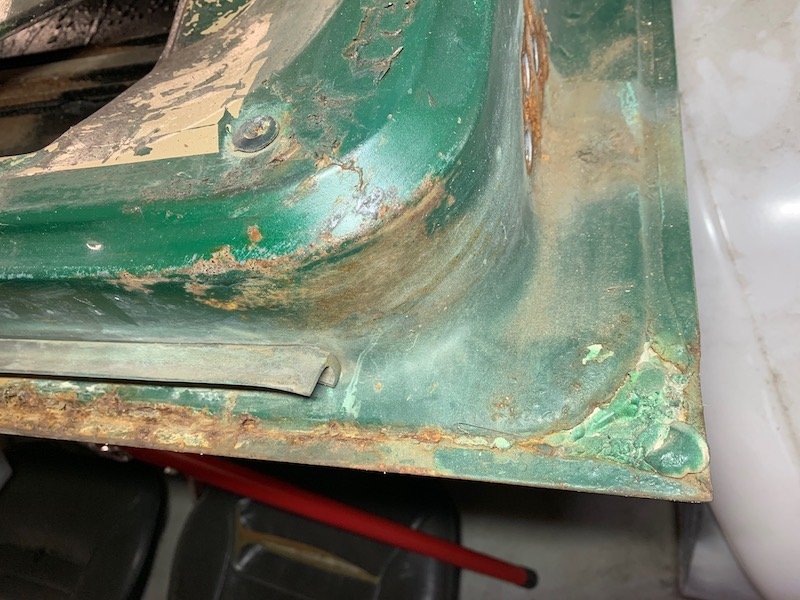

Nice bit of silicone in the corner, courtesy of PO
this door will be completely replaced with a new door from all muscle car parts

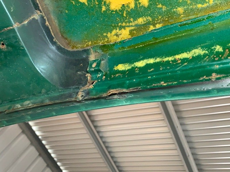

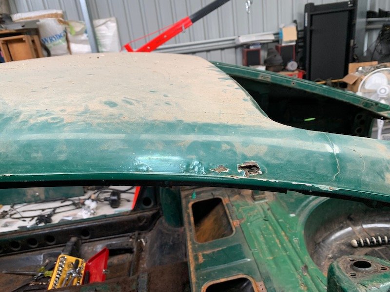

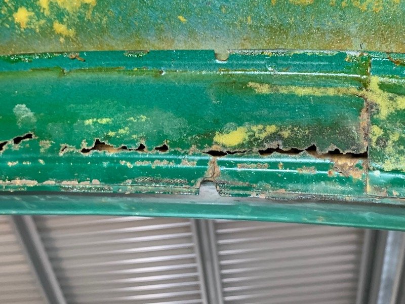

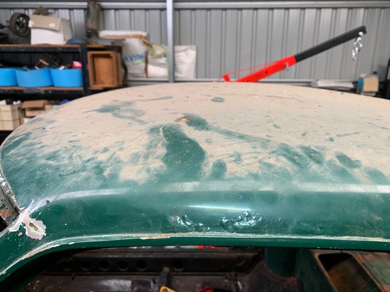

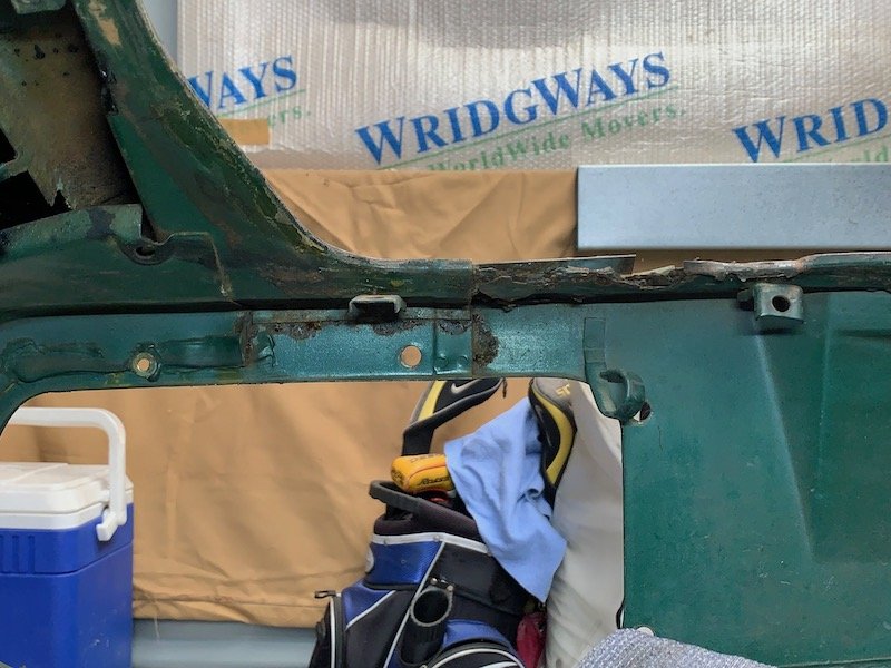

Posted (edited)

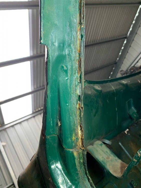

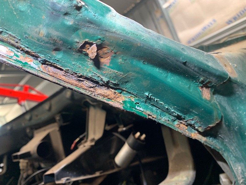

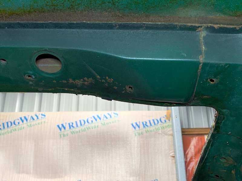

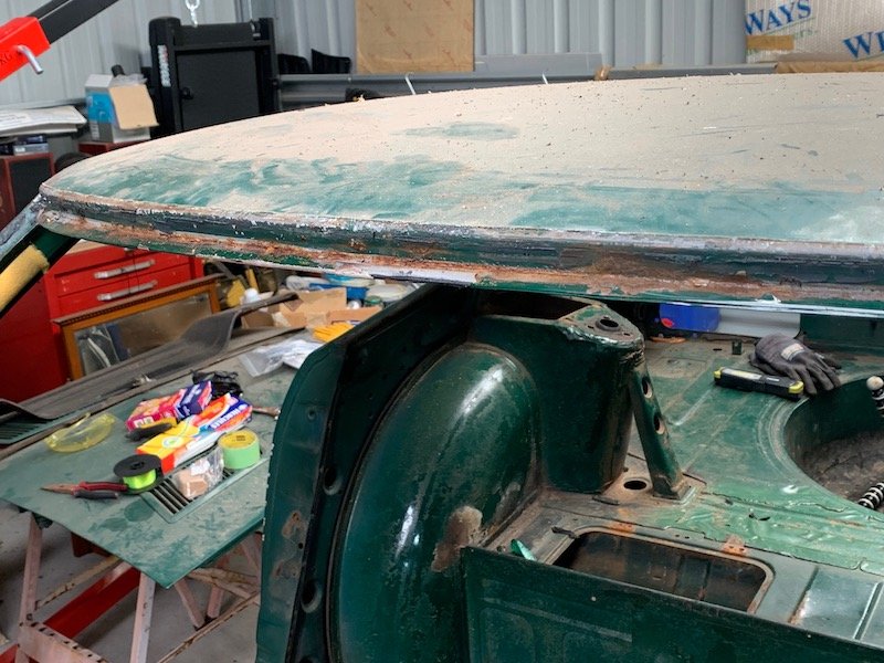

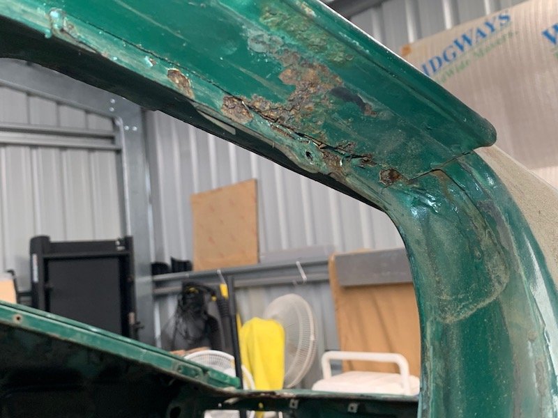

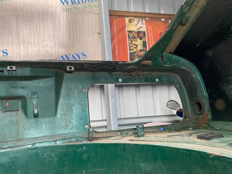

Just when you thought, Surely he hasnt got anymore rust.... This is the scariest bit for me. THE ROOF....
LHS (at least its consistent...) of roof is pretty bad all along rain gutters
IMG_3922.JPG.329d2f0798e5a19e0a92d209412d1771.JPGIMG_3924.JPG.dad08fc73aab19ff742e9b2202f31e9f.JPG
Unfortunately LHS roof frame has been badly rusted.
IMG_3902.JPG.7e5ff732f15ae646c03d2bf3986fcfda.JPGIMG_3904.JPG.1703cc017da47dd0ac147f1c3a8ec3dc.JPG
small amount of rust on LHS of rear roof support coming through
Rust forming all along the top windscreen lip, Im unsure as to whether this is surface rust or coming from the inside.... anyone care to comment?
top of rear quarter window on LHS is pretty bad

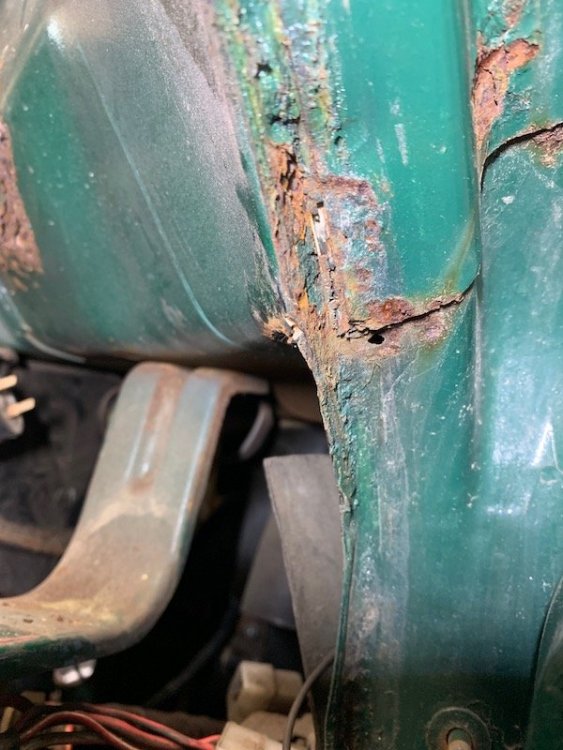

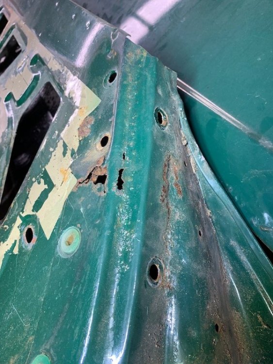

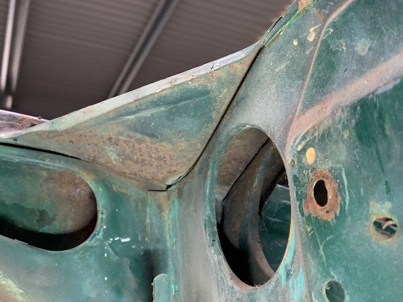

A Pillars appear to be rusting from the inside. this is really scary stuff, if anyone has repaired rust in the A pillars please let me know how it went for you?
IMG_3451.thumb.JPG.3c96b3793cd706e93c48bf49612ee933.JPGIMG_3452.JPG.5e67c45dfb5ab8030a27461e046ec482.JPGIMG_3918.thumb.JPG.5243c64aafbc47a0cf371f78bee0e7c7.JPGIMG_3921.thumb.JPG.76fba868281c41288f71d23034915d2a.JPG

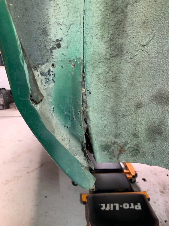

Posted (edited)

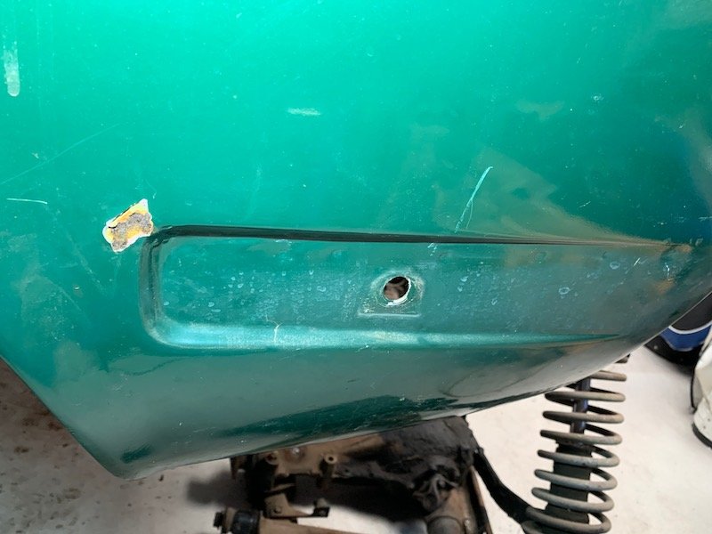

So thats all so far. Oh I also have rusty front fenders in the usual spot at the bottom, nothing crazy. Most of these I knew about already, the ones that I didnt know about till after stripping the car were the Cowl rust, A pillars and Roof support structure. And they just happen to be the scariest parts... Not going to lie its pretty demoralising knowing how bad this car is...
