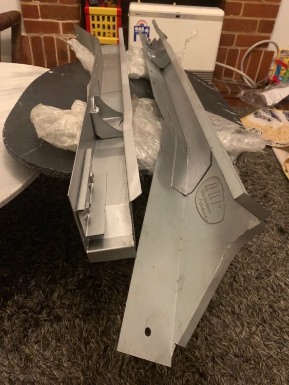

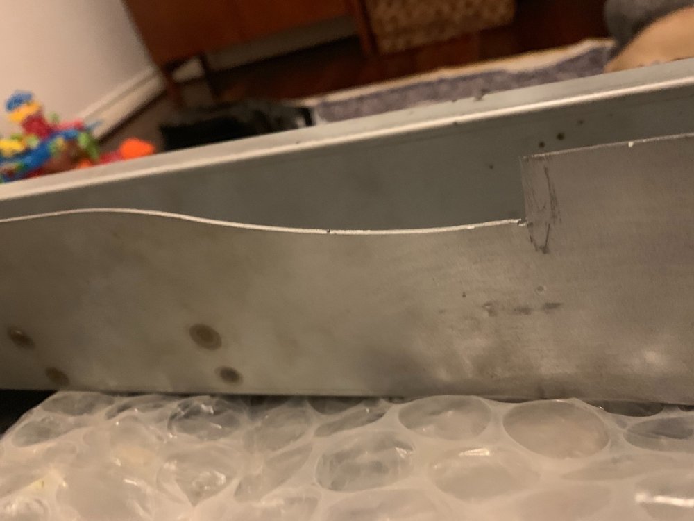

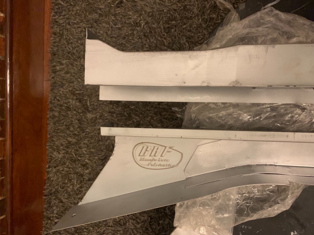

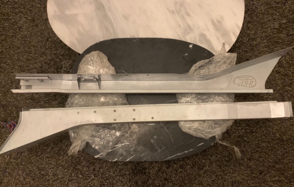

240ZBUILTBYME Posted November 11, 2020 Author Share Posted November 11, 2020 (edited) Received some goodies in the mail... really glad I was able to support an Australian supplier instead of send money to the US. Thanks Lurch I have to say quality is fantastic. Fitment is unknown but I am highly confident they will fit well. Two questions for the maestro of metal @C.A.F. 1. What is this cut out for? Is it the tie rod brackets? I was trying to look through my photos to work it out but didn’t have a underside shot of my rails. 2. I won’t be installing these for a while, do you recommend I chuck some easyphos or something for protection in the meantime? ryan Edited November 29, 2020 by 240ZBUILTBYME CBR Jeff and AndBir 2 Quote Link to comment Share on other sites More sharing options...
C.A.R. Posted November 11, 2020 Share Posted November 11, 2020 That notch will need to be cut back to match the inner skirt. It'll become clear when you offer it up into position. If you are not installing them soon, a coat of silver gal or cold gal is advisable. Also before you install them, paint the inside with KBS/POR15/Rust Bullet. Quote Link to comment Share on other sites More sharing options...
240ZBUILTBYME Posted November 11, 2020 Author Share Posted November 11, 2020 2 hours ago, C.A.F. said: That notch will need to be cut back to match the inner skirt. It'll become clear when you offer it up into position. If you are not installing them soon, a coat of silver gal or cold gal is advisable. Also before you install them, paint the inside with KBS/POR15/Rust Bullet. Ok no worries yep was planning on a inner coat of kbs, no worries I’ll throw some gal down. Cheers Lurch Quote Link to comment Share on other sites More sharing options...

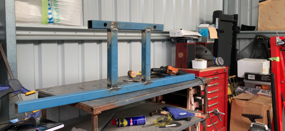

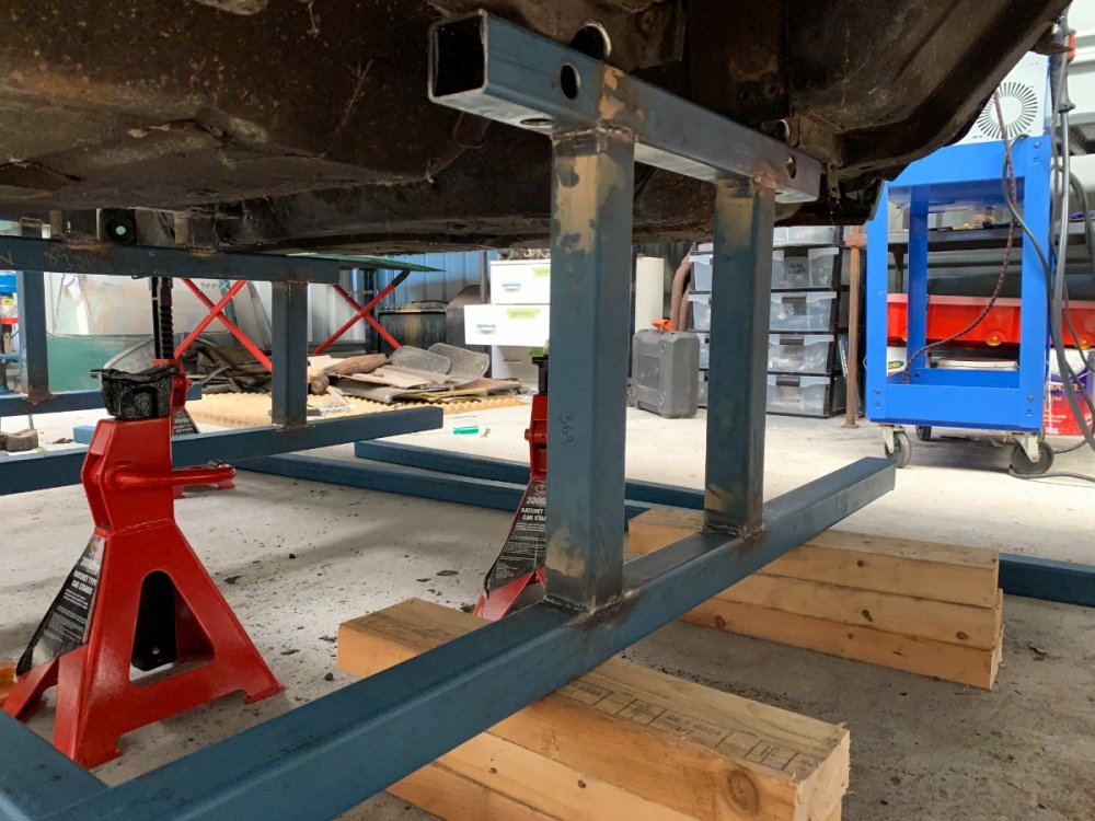

240ZBUILTBYME Posted November 28, 2020 Author Share Posted November 28, 2020 Front diff carrier frame all welded up and bolted in place... one more to go! Quote Link to comment Share on other sites More sharing options...

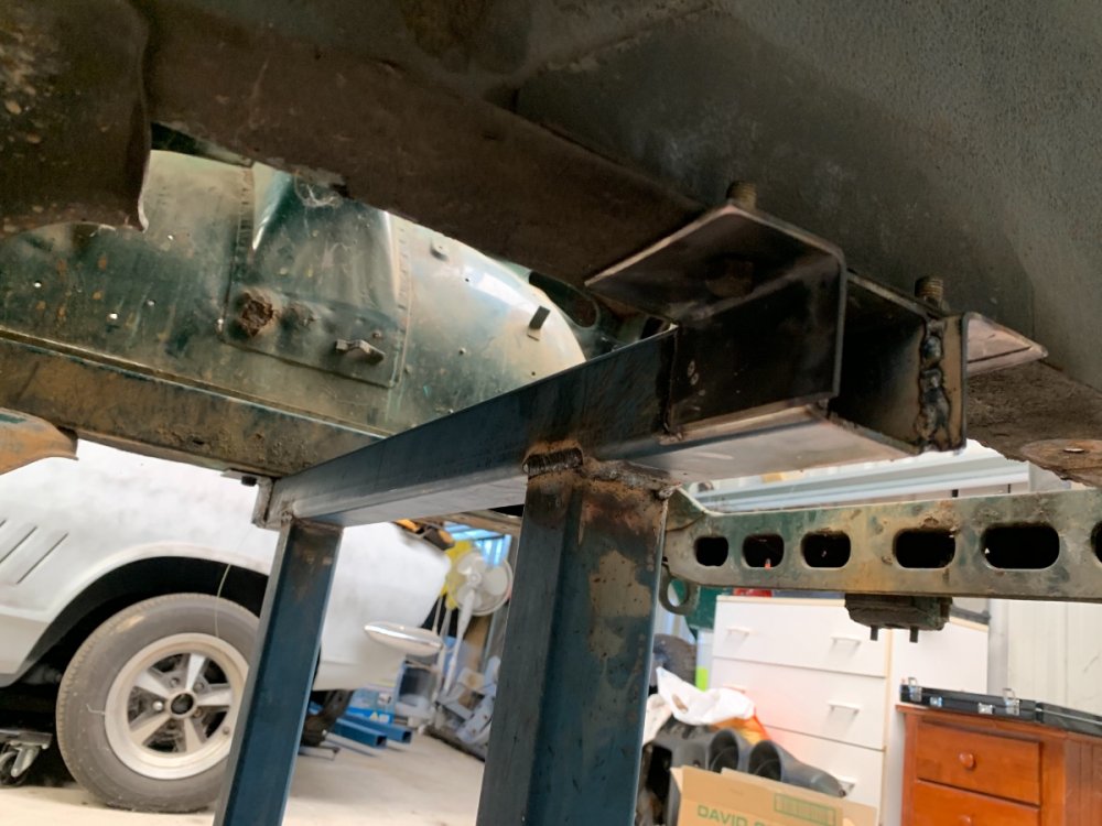

240ZBUILTBYME Posted November 28, 2020 Author Share Posted November 28, 2020 Angle welded onto the front cross member frame, holes drilled and bolted up into place Quote Link to comment Share on other sites More sharing options...

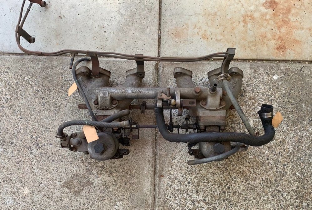

240ZBUILTBYME Posted December 2, 2020 Author Share Posted December 2, 2020 So I’ve decided to start doing some small parts restoration at home. As anyone who is following along knows, the car is not at my place but about 35-40 mins away. I only work on it once a fortnight, basically a day of my R&R. So to keep motivation and progress rolling I’m doing these mini projects. First Mini Project is... Quote Link to comment Share on other sites More sharing options...

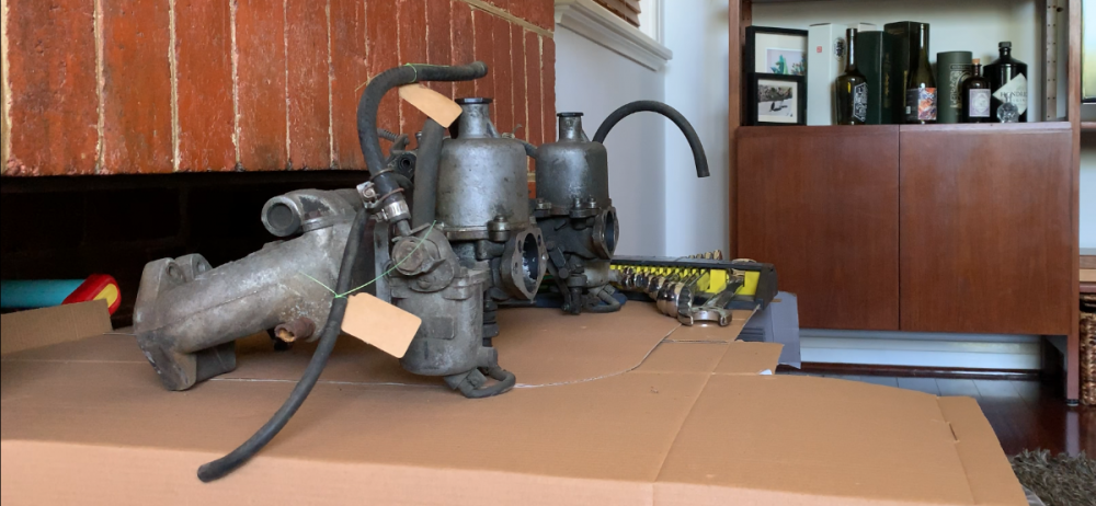

240ZBUILTBYME Posted December 2, 2020 Author Share Posted December 2, 2020 As you all know I’ve never done any of this before so I’m relying on you wise sages to correct my mistakes and give your worldly advice... I was thinking about doing one SU at a time just to have one to reference off when rebuilding but I’ve taken a lot of photos and feel confident I can put them back together using those. Let me know your thoughts. Planning to: -order a Ztherapy rebuild kit -vapour blast intake manifold, bodies and dome -replate hardware -new hoses let me know if I’ve missed anything critical few photos of dismantle on front SU Dragonball240z 1 Quote Link to comment Share on other sites More sharing options...
240ZBUILTBYME Posted December 2, 2020 Author Share Posted December 2, 2020 Anybody got any advice on getting the needles out of the piston? They seem pretty stuck in there. The Ztherapy rebuild kit will have new needles but I’d rather not damage anything just in case. And before you ask yes the grub screw is out... Ryan Quote Link to comment Share on other sites More sharing options...
Administrators gav240z Posted December 2, 2020 Administrators Share Posted December 2, 2020 Getting the needles out can be a pita. I was gonna check you removed the grub screw. Basically what's holding it in is a bunch of carbon build up (probably from the PCV being fed into the intake). You could try soak it in kerosene or use lots of carb cleaner on it and let it sit for a while. I butchered my needles getting them out (with pliers) because I ran out of patience. I kind of regret doing that too! Z-Therapy will give you new needles but the original L24 sized ones are hard to find now and generally the Z-therapy ones are SM needles which are a bit rich..from what I've seen. You won't regret getting Z-therapy rebuilds. I had a bunch (4 sets) done a while ago. I think I sold 2 sets and kept 2. Can get a little expensive. 240ZBUILTBYME 1 Quote Link to comment Share on other sites More sharing options...
240ZBUILTBYME Posted December 2, 2020 Author Share Posted December 2, 2020 26 minutes ago, gav240z said: Getting the needles out can be a pita. I was gonna check you removed the grub screw. Basically what's holding it in is a bunch of carbon build up (probably from the PCV being fed into the intake). You could try soak it in kerosene or use lots of carb cleaner on it and let it sit for a while. I butchered my needles getting them out (with pliers) because I ran out of patience. I kind of regret doing that too! Z-Therapy will give you new needles but the original L24 sized ones are hard to find now and generally the Z-therapy ones are SM needles which are a bit rich..from what I've seen. You won't regret getting Z-therapy rebuilds. I had a bunch (4 sets) done a while ago. I think I sold 2 sets and kept 2. Can get a little expensive. Thanks gav! I’m not in too much of a rush with this as I just I’m just doing these mini projects when my 2 year old is napping. He loves waking up to find tools on the coffee table.... I’ll try the kerosene and carb cleaner soak and see what happens. I have read your SU rebuild thread over a few times so knew you had troubles too. Can I ask how much a restored set up retails for nowadays? Ball park figure? I’m still undecided on if I am running SUs or going straight to Weber’s, I think it will depend on if a decent second hand Weber set up comes available before the decision needs to be made (which will be a couple years away....) I’m not willing to buy new, cost is insane.... Ryan Quote Link to comment Share on other sites More sharing options...
Administrators gav240z Posted December 2, 2020 Administrators Share Posted December 2, 2020 I can't recall the cost now for the Z-Therapy rebuilds. It wasn't cheap though. They should be able to quote you, but shipping there and back gets expensive. I bought a bunch of cores in the US and sent them direct that way. Problem is getting stung on import duties on the way back. Depends on what you want from the car, but I am a big fan of Triple Mikunis. Weber's tend to be a mixed bag based on when and where they were cast. Mikuni really improved the Solex design over the years.. but they are not cheap either (for good reason). https://www.hemmings.com/stories/article/mikuni Quote Link to comment Share on other sites More sharing options...
240ZBUILTBYME Posted December 2, 2020 Author Share Posted December 2, 2020 44 minutes ago, gav240z said: I can't recall the cost now for the Z-Therapy rebuilds. It wasn't cheap though. They should be able to quote you, but shipping there and back gets expensive. I bought a bunch of cores in the US and sent them direct that way. Problem is getting stung on import duties on the way back. Depends on what you want from the car, but I am a big fan of Triple Mikunis. Weber's tend to be a mixed bag based on when and where they were cast. Mikuni really improved the Solex design over the years.. but they are not cheap either (for good reason). https://www.hemmings.com/stories/article/mikuni Ahhh sorry I meant I’m going to do the rebuild myself, using the Ztherapy DIY kit they supply. I know they do roller bearings etc but I’m not convinced it’s essential. You mentioned to me you thought the rebuild you did yourself was nicer than the Ztherapy rebuild you had done, so I’m going DIY. Will probably be half the price of sending them to Z therapy to do. As you say shipping and import duties are killer. What I meant was you said you sold a couple of pairs, how much does a rebuilt SU setup sell for these days? I have heard 1500-2000$ Unrestored but haven’t seen anything myself. Quote Link to comment Share on other sites More sharing options...
240ZBUILTBYME Posted December 10, 2020 Author Share Posted December 10, 2020 Well sorry it’s taken time to get back to updating the needle sitcho. but this little thing has been keeping me busy, she arrived last week. But I did get round to trying to get the needles out, I decided to first try some rubber and some vice grips as it was the easiest to conjure. And long story short it worked! Just needed the grip of the rubber to apply enough torque to twist it free! The second needle came out by hand. One of the needles had N27 on it, the other had nothing. I believe these are 240z needles? Ryan gav240z, AndBir and Ponyo240z 3 Quote Link to comment Share on other sites More sharing options...
