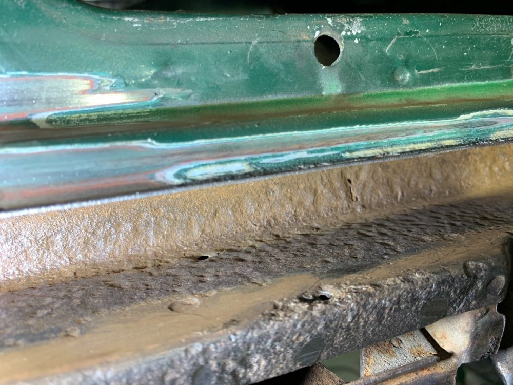

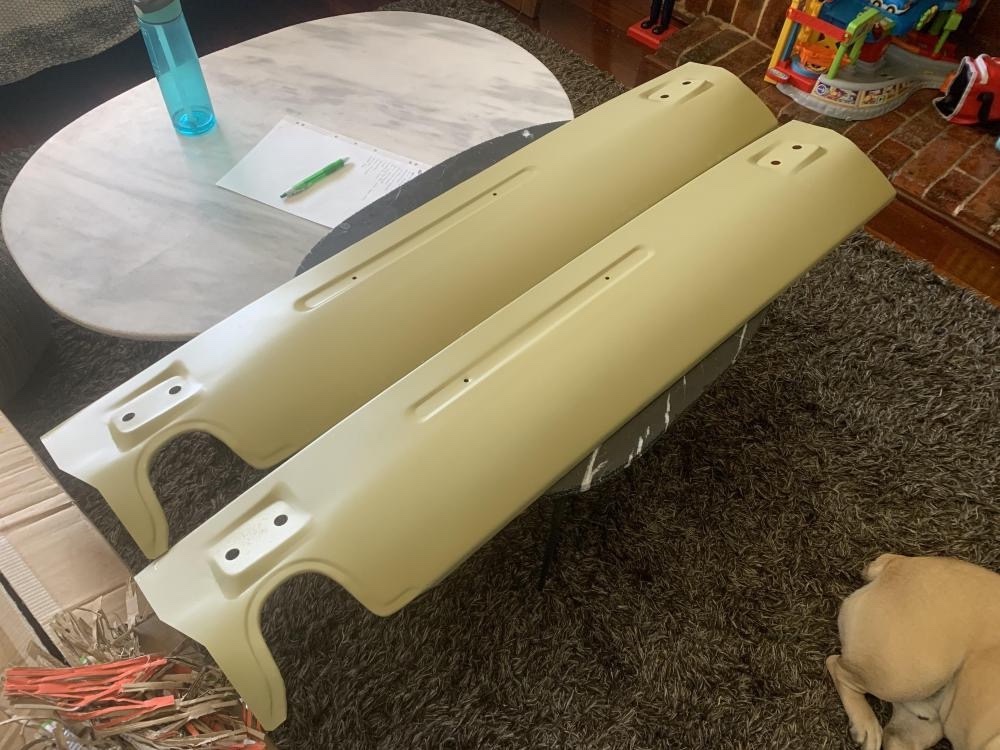

Hmm looks like someone was a little rough handed with them, did you ask Les about it? Might be worth a call to see if that's just part of the manufacturing process or if someone was rough at them during the ceramic coating stage?
I’ve sent him an email asking about it. I mean I know this will never get seen but I feel like if you’re purchasing a new item it should be relatively blemish free. I’m certainly not demanding perfection.
Posted (edited)
Well whichever party was responsible IMO the outcome is just not acceptable. Those are major defects.
PS: if I were you I wouldn't accept it, those are more than a minor surface defect or two. Send it back and demand a refund, or an undamaged replacement, either of which I expect you would surely be entitled to under Australian consumer law.
I emailed Les, he gave no explanation or apology, but he’s sending a new secondary section which had the bad dents, there are imperfections on the main headers but I think I can live with them. Still a slightly annoying experience.

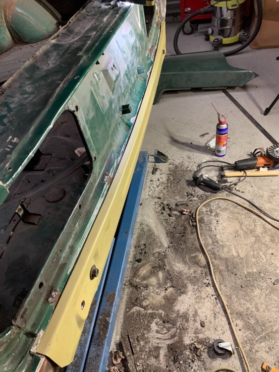

I’ve been a bit slack with updates of late, more because it is demoralizing how slow progress is lol
front section of the rotisserie finally complete and I can move onto the rear of the car, mounts should be much quicker to make on the rear
new mount design all welded up, added further support to the main L shaped section which will be taking the weight.
added supports to uprights
should be well and truly strong enough

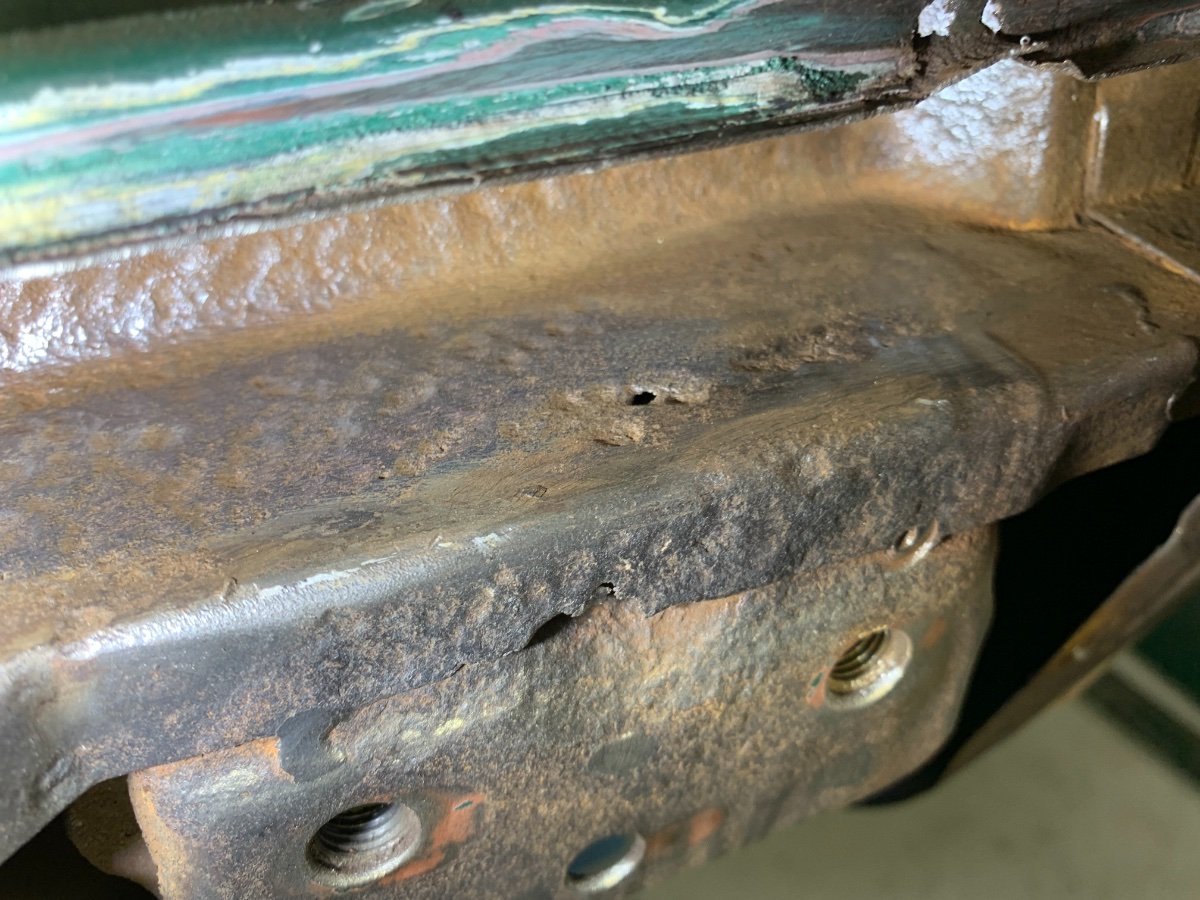

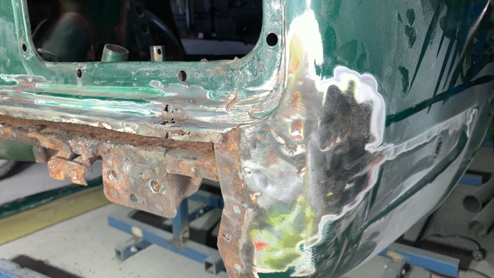

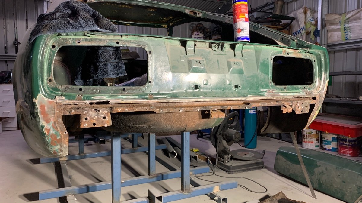

After completing the front section I moved straight on building the rear mounts. As I was working out what sized tubing to use for the direct mount, I noticed the rear bumper mounts were not flat. There was a few small rust bubbles around the mounts and along the rear valance. So I though I would begin a investigatory expedition into their origin.
UH OH!
well it didn’t come out as polite as that... my exclamation rhymed with DUCK, except with PH on the front.... the bog monster had reared its ugly head...
not knowing if this was from accident damage, which I didn’t think it was, as behind the valance looked undamaged. Or if it was bad rust repairs I decided to press on with my expedition
BIG UH OH! Again not the phrase I used...
At this point, I considered taking a Lurch parody video with lots of grunts and fingering of holes. Lol
The suspense to find out just how PH$#*€D my rear valance is was killing me. So I kept going....
At this point I felt I could not continue with the rotisserie build until this was repaired. The massive holes I feel would affect the structural integrity of the rear end. Plus I’ve kind of been dying to sink my teeth into some rust repairs.

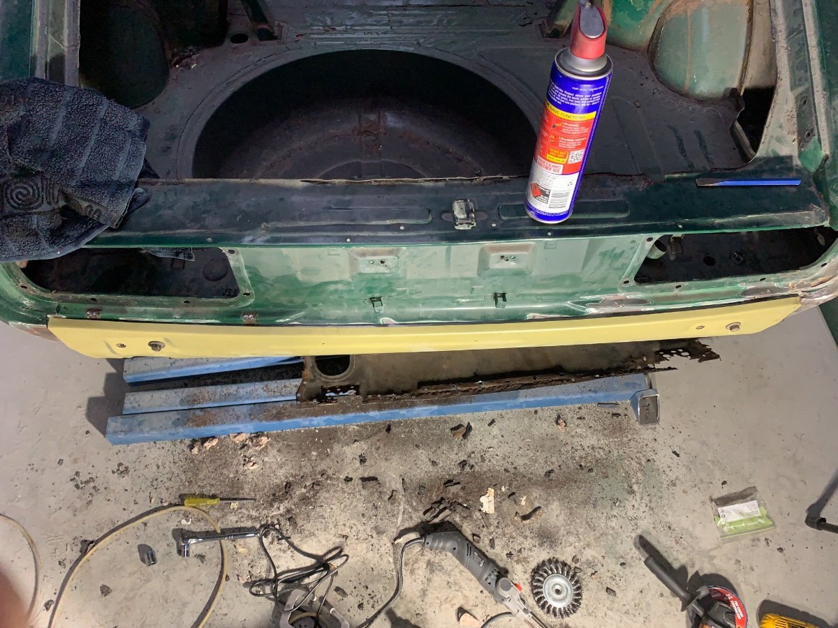

So got a little bit done this week, was distracted by the company of @AndBir and @RestoZ. It’s amazing how 4 hours can disappear just talking about z’s!

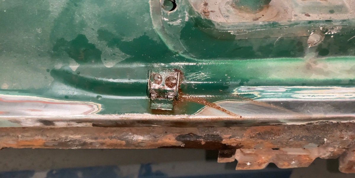

Managed to remove the rear valance panel! Great Success!  0AC382A8-A9EF-483C-9124-4D6AB4E48228.thumb.jpeg.8fbb1cb7fef4ebf388849aed5b55d3bd.jpeg
Used a combination of methods. These are the first spot welds I’ve ever removed so wanted to try them all. Used the rotabroach cutter style, the specialty drill bit type and the finger file sander.
This is what my experience was with each:

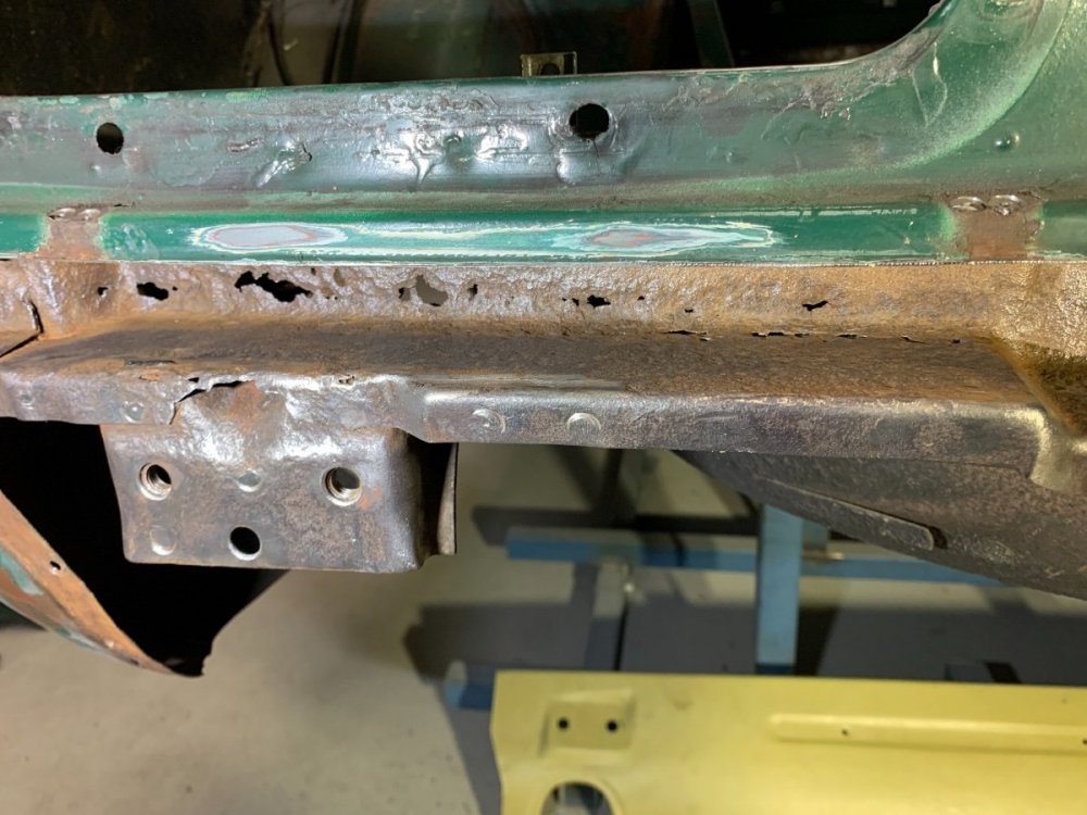

Had to remove the clips that hold the.... I’ve had a mental blank.... rear dress up panels that go around the tail lights. As I will be using the whole of the repair panel which will require a cut along the top edge where those clips sit.
As expected it’s rather rusty in the box section behind, some rust has made it all the way through.

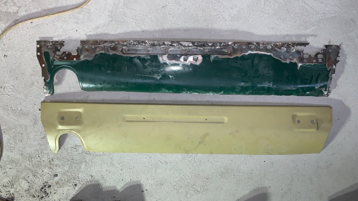

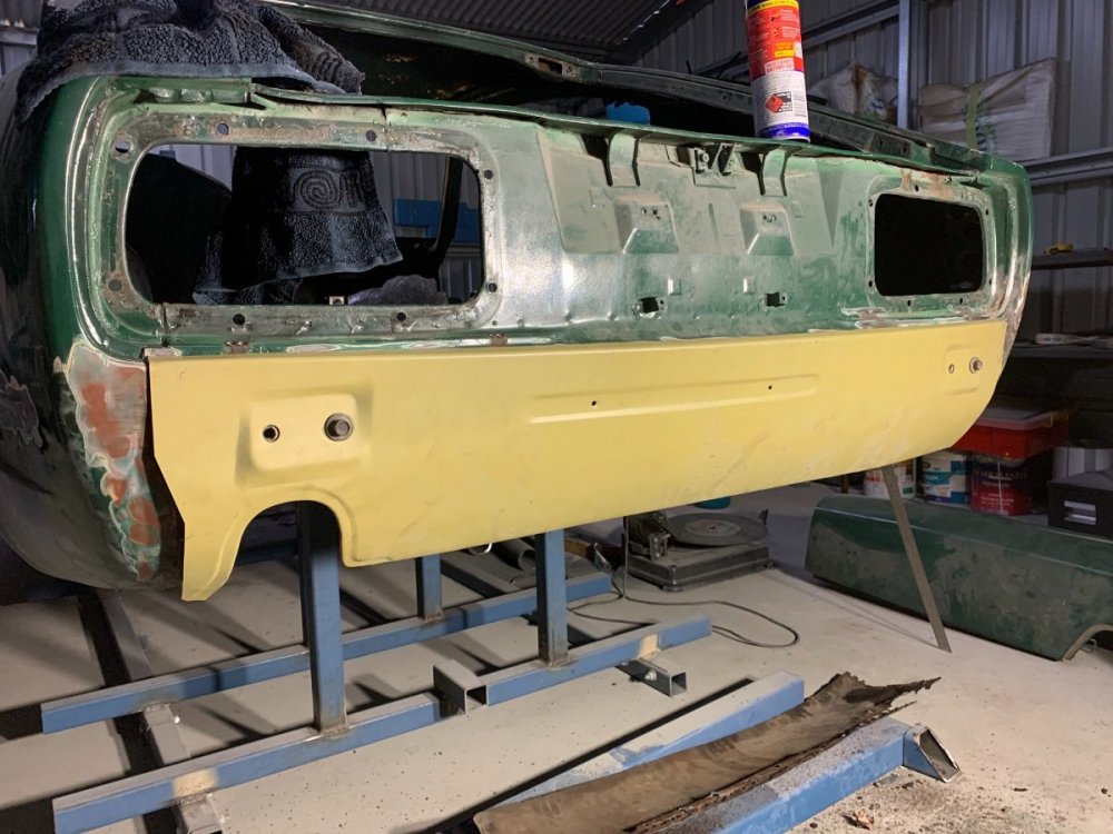

comparison of stock valance vs Auto panel solutions repair panel. High quality product.
RHS looks like it has a minor nudge. Some rudimentary measurements show it’s out by 3-4mm. Not too bad. I’m thinking a big hammer should convince it.
First mock up of the panel. Need to buy more vice grips for convincing it into position.

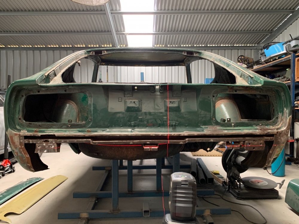

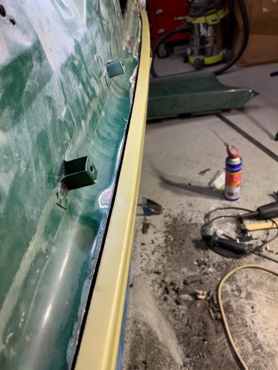

Didn’t get a great deal of time this break, only managed a few precious hours with Sheena. I’ve lost a tonne of sleep lately, tossing and turning in bed scheming and stressing about how I’m going to do this job! Anyone else do that? I’m sure I’m not the only one...
I ground down all the proud spot welds and gave the front face and what I could reach a good wire wheeling.
I bolted the repair pane in, marked the cut line and made the finaL cut. All the while shitting myself...
cut was good

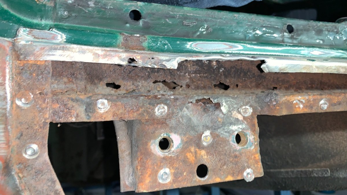

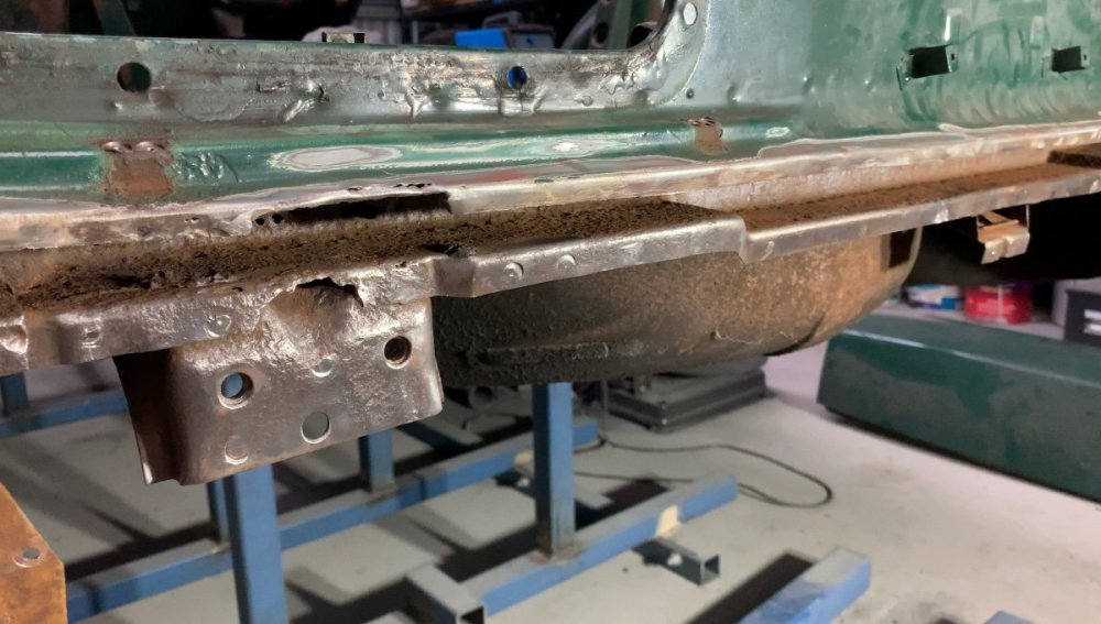

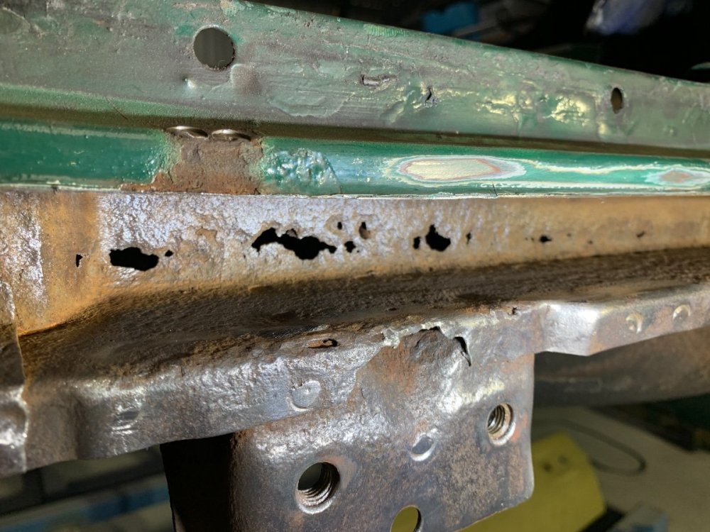

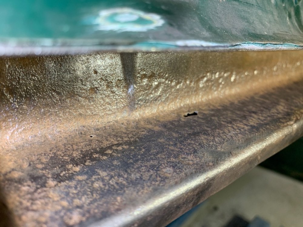

with more room for access I went to work cleaning the box section as best I could. Came up ok and revealed many new holes where rust had eaten through.
3473DE16-B761-4D86-BE36-4CAF94E11DD7.thumb.jpeg.8fa4b9f752525c35f3699a4d4b0ca302.jpeg9A12B4D3-3FC1-4FA5-80F1-1C5C2886E606.thumb.jpeg.eb201fbd4dd88560a4d11947216fcaaa.jpegEF89FAF9-FA1D-4EB9-9662-AE0532929A45.thumb.jpeg.cb68ff4028339e0ae605ca81fb6ff2da.jpeg5BB5CD02-4B2B-42BA-966D-1426F02C6947.thumb.jpeg.61649b2760f469e04db7d6eb4d0076f6.jpegFB77D6B2-4138-4B2F-93EA-AEECFB562DB4.thumb.jpeg.a4121e507b55b4f9509fb3f1b95f304c.jpeg
Question. Can I just fill any small holes with the mig? Given I use a rust converter and ensure the welding surface is free of any rust?
I was keen to get a coating on the box section but with the rust that needs repairing I figured I would save it for once those were done.
I was thinking of trying a spot blaster to further tidy up the unreachable areas in the box section. Has anyone used something like these? I know they’re generally crap but  are they good enough to do some small areas?
next time I plan to:
- repair rusted through areas on the box section (I think I’ll be lucky to get through this as will be my first time welding in patch panels....wish me luck....)
- hopefully get some kbs rustseal in there

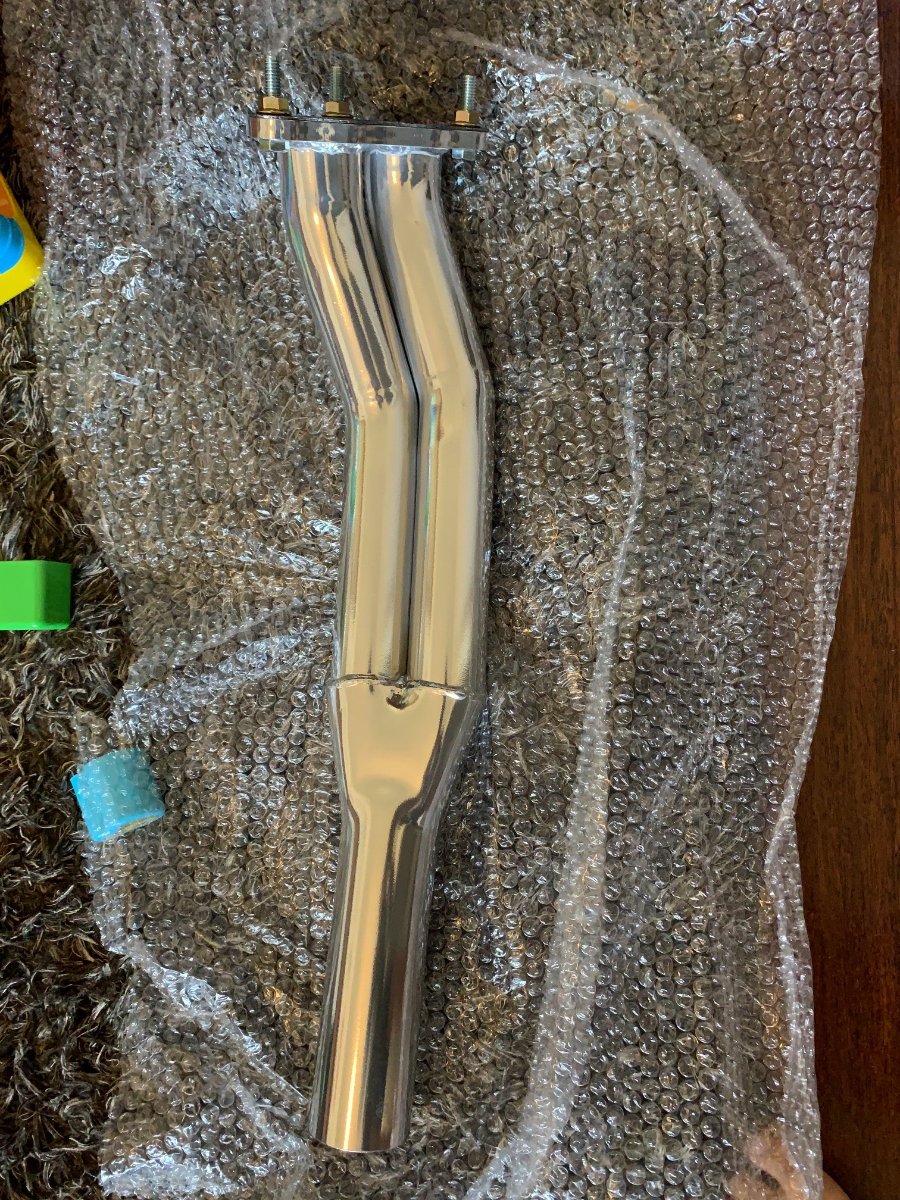

Also update on my bashed up headers. Les sent me another set of secondaries as they were the ones that were badly dented.
just be advised if you purchase headers from him that you will need to specify that you want them undinged. He does not treat these as a cosmetic part and he states that the dents happen during manufacturing and do not affect the function of the header. Make of that what you will...
I also got the laser level out and checked the level of the bumper bolts and surrounding structure. All looked good from a level perspective.

Looks much better and in lieu of using HCl acid to dissolve any remaining rust, liberal application(s) of rust converter should complete the prep for cutting out the badly rusted areas and welding in new patch panels.
I have seen videos of other 240z restos filling rust through holes by welding but I presume you would need to be sure you would not just enlarge the holes due to the metal being so thin.
I'm sure others can provide better advice.
I have . Put a piece of copper behind and weld away works pretty good not sure about welding to rust converter?
Yes, in my tafe course we used a heat sink (thick bit of metal behind the weld) to try and absorb the heat of the weld and prevent blow through. In my experience if the metal is thin enough, it will just blow a bigger hole and you'll chase your tail.. especially when using Oxy/Acetylene and a filler rod. If would often be better/quicker to just cut a section out and weld fresh metal in. By the time you mig up an area, sand/grind it's similar time invested.
I don't know about welding to rust converter, but once you've cleaned rust away (wire wheel or similar), then you can spray down some weld through primer.  (such as uPol Weld-through, zinc-rich primer).
Maybe a Needle Scaler would work for the hard to reach areas (where a wire wheel cannot get to)
Something like this : https://www.totaltools.com.au/137658-tti-straight-grip-needle-scaler-st2558
A large one being used in one of our "favourite" resto channels *wink* : https://youtu.be/UAzQfd9VPtg?t=146
Edit : On second thoughts, if you can find a good spot blaster (if there is such a thing), then that would probably do a better job.
Edited by AndBir
Thanks for the feedback guys
I think whatever converter I use I will wash off and weld on clean metal, don’t want to risk contamination in the weld.
yes I’m going to invest in one of those magnetic clamps that holds a piece copper onto the panel.
I will give filling a try just to experience how it is, but I will be patching most of it as it’s badly pitted.
I thought of a needle scaler but I feel a spot blaster will be less harsh. I will try to find one and test it.
