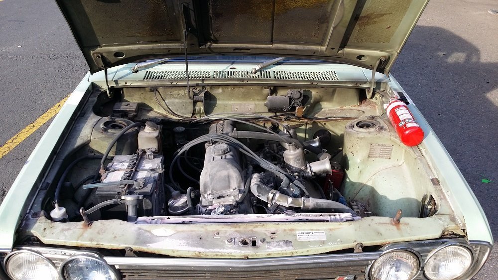

Yeah, just stick a fuel hose into a jerry can or mower fuel tin and away you go. If it has twin carbies, I'll assume they are SU's. Two types - early ones with float chamber separate and off to the side of the carb, later ones had an integral float chamber that you don't see. 260Z typically would have the later ones but heaps of cars had them converted to use the early ones. Not much in the way of seals and diaphragms in the earlier SU carbs (assuming that's what it has). Small fuel line from float camber to carb could have hardened and cause the choke to stick, rubber tip on the "needle" in the needle and seat that keeps float level correct could be perished but it should still fire, may leak fuel if anything is perished but should run briefly even if you have to shut it down to prevent it spewing fuel everywhere. It may take a bit of cranking at first, the pump will have to fill the float chambers first, its not like a car with an electric pump - fuel only gets pumped while the engine is being cranked over as the pump runs off an eccentric on the end of the cam. Bit of "Start ya Bastard" down the throats of the carbs will get it to fire sooner and fill the float chambers. Disclaimer-I've never pulled the later "flat tops" carbs apart to see exactly how they work, may be more rubber "workings" that can deteriorate in them. You're not missing anything, fuel and spark and it should at least fire and try to run.
If you think its a fuel problem, keep the troubleshooting simple. A mower tin of clean fuel, stick a length of fuel hose into that to feed the mechanical pump and then send that straight to the webers. Plenty of Datsuns didn't have a return line from factory and run fine (my 1600 for instance). If it runs OK like that, start working backwards to see where the problem lies in the fuel system. Also, a tip - if that's how you intend to leave the fuel lines set up, be very careful routing them around the front of the engine like that. I did at one stage and suffered an engine bay fire when things came slightly adrift and the radiator fan put a cut in the fuel line.

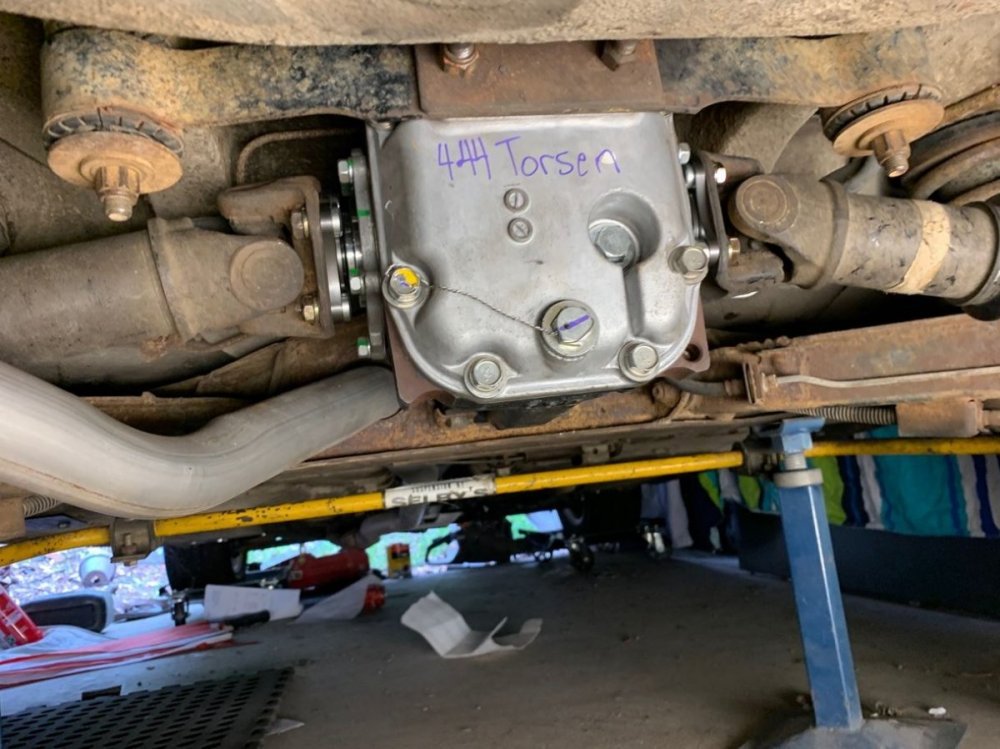

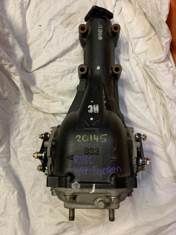

Yep, I'm up to $600-odd for diff and adapters. If I break another diff, just go to a Subaru wrecker, grab another one and away I go again. I'm probably going to grab another one anyway just to have "in stock" while they are readily available. Wish I'd bought a few RX turbo diffs when I had the chance. 4.44 is also a perfect ratio for me, I don't have the power to pull a 4.1 or taller gear. This is what's left of the LSD centre in the old R160, crownwheel flange splitting off nearly half way round after a bolt backed out. Made a few decent bangs, then locked up completely and skidded to a stop, luckily while I was heading back to the pits. 60 seconds previously, I was doing 180 down conrod straight, not sure I want to think about what would have happened if it locked both back wheels then.....
I guess I should have said "The ones you need if you want a Torsen are labelled HC" - I don't claim they are "better", but they are way cheaper and more available. I've run a plated R160 in the same ratio for the last 10 years, and would have gone with another one if I could find one, sadly not too many Subie RX turbo's around anymore to raid for the rear diff. Even if I did find a plated R180, I'd have to buy the adapters anyway. The diff was $125 so if it works, great, if not I can go on the hunt for something better down the track and still use the adapters I bought. Car is only used on the track, hillclimbs and motorkhana's on the SMSP wet skidpan (when we don't get evicted by V8 Supercars taking over the track like the last two motorkhanas I've been involved in organising ). Anyway, it will be a good comparison between Torsen and plated, I'm running the same ratio I always have, only difference will be the type of LSD centre. Or I just break out the welder.......
Incredibly easy to find in Torsen 4.44, I haven't seen a 4.11 R180 (other Subaru ratio seems to be 3.9, mostly in clutch pack LSD's). When I was looking before Xmas I had a choice of half a dozen ranging from $125 up to $600. $250-400 seems about average to buy from a wrecker, from what I can see manual WRX's from 2007 onwards seem to have them, at least the 2.5l engined ones did, not sure about 2.0l ones. The ones that you need are labelled "HC" - although as always, do your own research...
