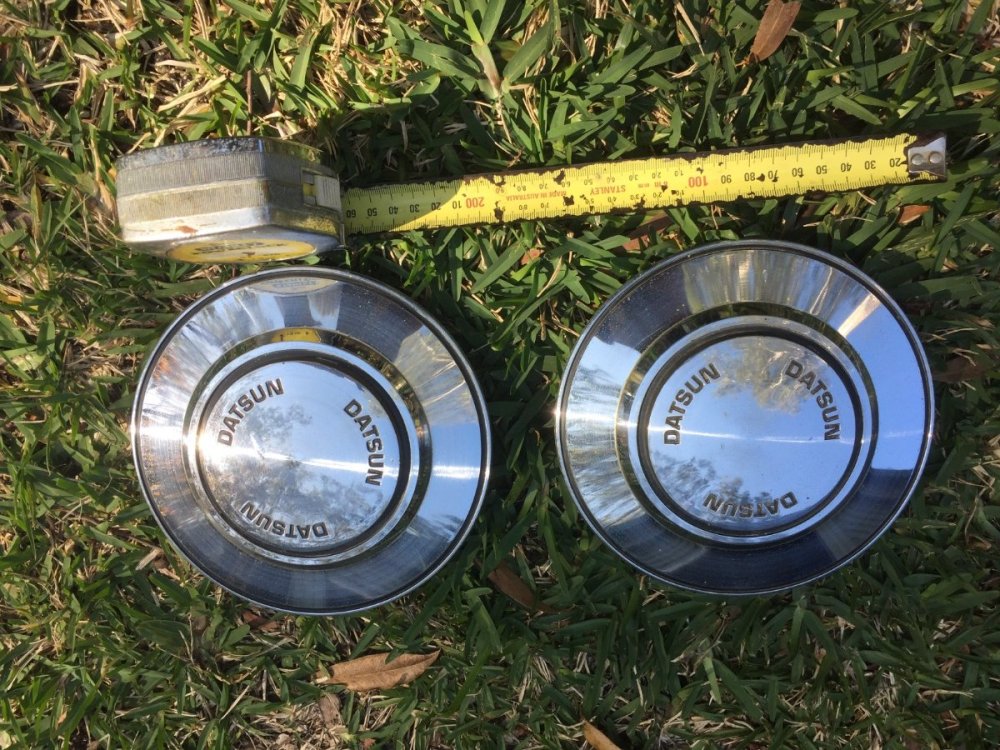

  3. I found these two hub caps in the shed today. Checked all over the net but can’t find a Datsun model that had them. Can anyone identify them?
