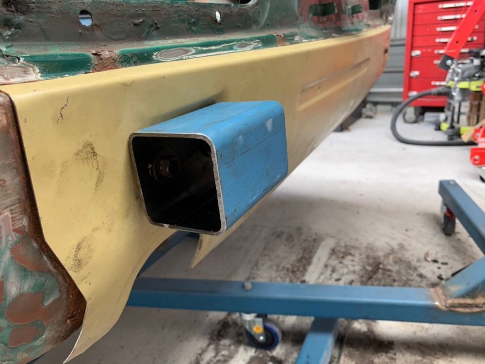

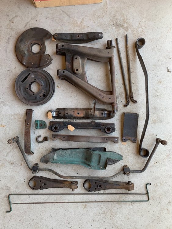

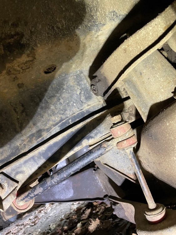

240ZBUILTBYME Posted January 26, 2022 Author Posted January 26, 2022 So finally got back to the shed after a long hiatus. It’s very hot here in WA, 40’s as far as the eye can see…. And it’s about 20 degrees hotter in the shed so I have started coming early in the morning and leaving by midday. managed to cut all the 65mm tubing for the rear rotisserie and drill holes in preparation for castors and captive nuts to be welded. so all left to do next time is weld everything together. I still have to work out tying in the rear strut towers but will need to purchase some plate to make up the mounts. shot of how I will mount to the rear bumper mounts also put together a first run of things to bring to the powder coaters, front subframe and front/rear hub/strut housings are missing from the photo but they will go too. pulled all the bushings and finished little bits of disassembly those with a keen eye will notice I sourced a curved moustache bar and transverse link for the later diff position wasn’t sure if there was anything that shouldn’t be powder coated? And is there places that powder coat should not go? I know threads are a no no but wasn’t sure about inside of bushing holes Mike_F 1 Quote

C.A.R. Posted January 27, 2022 Posted January 27, 2022 I will never help you again if you powercoat the suspension parts. 2K ONLY! Oliphips and OdinZ 2 Quote
240ZBUILTBYME Posted January 27, 2022 Author Posted January 27, 2022 (edited) 1 hour ago, C.A.R. said: I will never help you again if you powercoat the suspension parts. Well this is an unexpected reaction indeed… I feel like the powder coat vs paint on suspension parts is in the same category of age old arguments such as epoxy vs etch primer…. Are you able to eloborate on the reason Lachy? I spoke to a high end car restoration shop here in perth and he used powder coat due to efficiency and cost. He stated the cost for him to paint would be 2-3 times and be the same results Edited January 27, 2022 by 240ZBUILTBYME Quote
240ZBUILTBYME Posted January 27, 2022 Author Posted January 27, 2022 I’ve read arguments that if powder coat chips it’s more difficult to repair which is a question I posed to the restoration shop guy and he said he just touches up with paint. majority of the builds I’ve gone through have used powder coating which is a reason I decided to go with it. Now the majority are not always correct. But I’m interested to hear all opinions and reasons why I shouldn’t use powder coat! Quote
1600dave Posted January 27, 2022 Posted January 27, 2022 (edited) I'm sure Lurch will chip in, but my only experience with powder coating was on a vintage bike frame. Thought I'd try powder coating on a BMW as I was sick of the acrylic lacquer I'd previousy used on bike restorations chipping and getting scratched over time. It came back with the coating so thick that it was difficult to get bolts and swinging arm bushes thru some of the the holes in the frame and it cracked when I tightened up things like engine mounts. I ended up stripping it and giving 2K a go (my first attempt at using 2K, it was still fairly new at the time). Much better. I've never been tempted to try it again. Was 20-odd years ago, who knows, maybe powder coating has improved since then ?? Maybe I got someone who wasn't very good at it ? Edited January 27, 2022 by 1600dave C.A.R. and 240ZBUILTBYME 2 Quote
C.A.R. Posted January 27, 2022 Posted January 27, 2022 (edited) No high end restoration shops I know, use powdercoating anywhere on their restorations. Powder coating is not durable. And if you get a chip - which is easy with powder coating - it's bare metal underneath, and rust starts very quickly buy moving UNDER the powder coating. Next thing you know, a chuck of powder coating comes off to expose a rusted suspension member underneath. 2k is far harder and more durable, and wont be as easily chipped. Edited January 27, 2022 by C.A.R. Oliphips, Wags and 240ZBUILTBYME 3 Quote
240ZBUILTBYME Posted January 27, 2022 Author Posted January 27, 2022 8 minutes ago, C.A.R. said: No high end restoration shops I know, use powdercoating anywhere on their restorations. Interesting. This guys doing some seriously valuable Aussie muscle cars here in perth. 10 minutes ago, C.A.R. said: 2k is far harder and more durable, and wont be as easily chipped. Well there goes that plan…. I was quite excited about getting this crossed off the list but looks like it’s back to the drawing board. I don’t want Lurch giving me the cold shoulder for eternity…. OdinZ 1 Quote

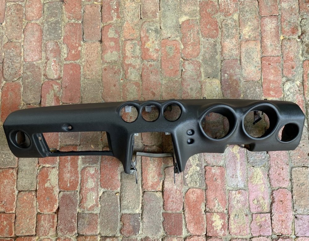

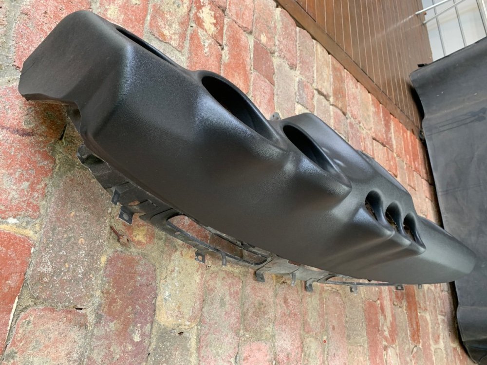

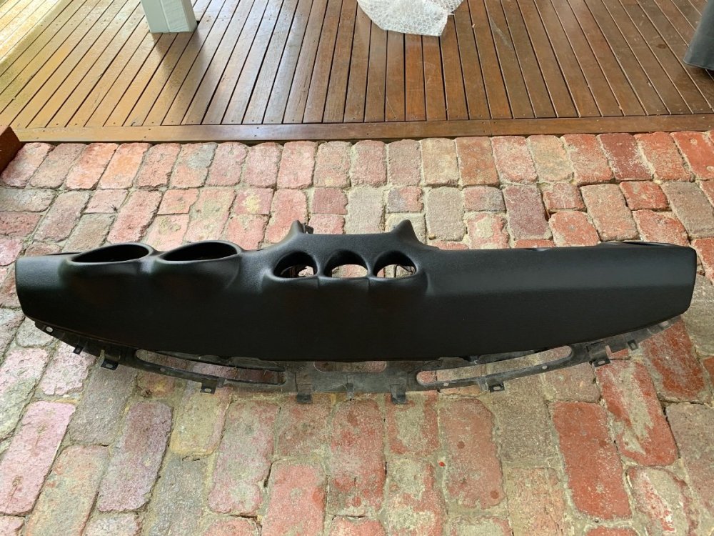

240ZBUILTBYME Posted April 26, 2022 Author Posted April 26, 2022 Got the dashboard back from rare parts here in perth. Wow! What an amazing job they did on the dash, well the worth the cost. I’m stoked with the result. now I need to clean up and check the gauges and remaining components as well as have Martin run his eye over the dash loom. CBR Jeff, Oliphips and gav240z 3 Quote
