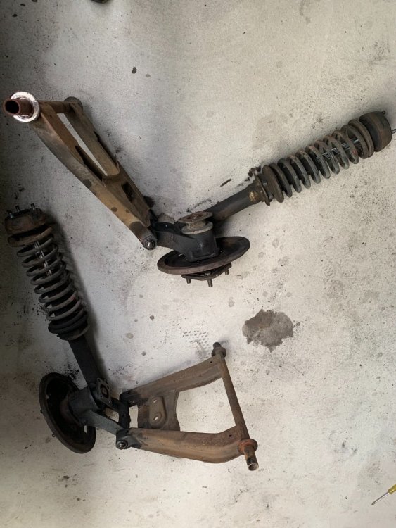

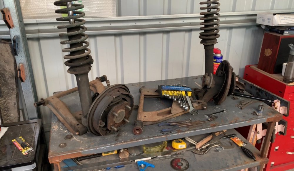

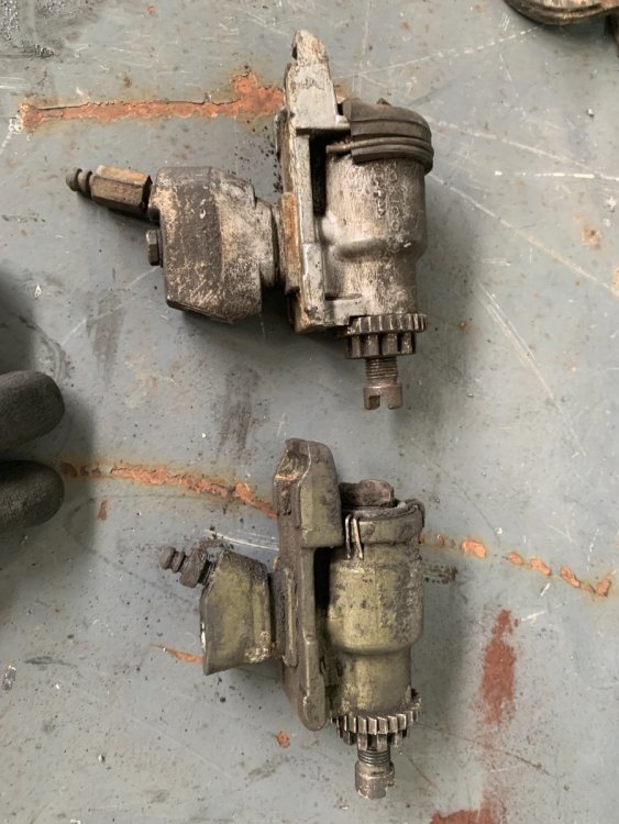

so despite my daughter arriving I managed to make it to the car to do a bit of spannering, stripped the drum brakes and gave them a clean out, also got the front suspension assembly broken down and ready to bring all components in need of a press to my mates shop.

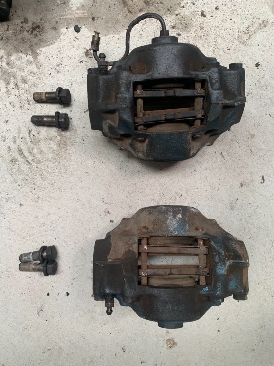

I still haven’t decided if I’m going to rebuild drums or go straight to discs. Any thoughts or opinions?

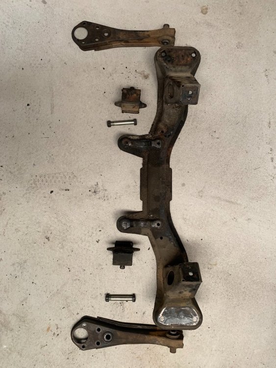

AB295B08-2257-46AF-8E8F-0E5AEC9639F1.thumb.jpeg.c79cc6e24fa8c63be3dce1ea0e86d6ff.jpeg0B8BBC6B-A745-471A-A036-305EFDFEB1A7.thumb.jpeg.3ccda6fbad1b4a0b7a36429f2720657a.jpegFC0578FA-F300-4BC8-972F-3ADD152D28AC.thumb.jpeg.2461552bcfa46e3fb48374bf26db4380.jpeg
not sure which is an original 240z cylinder, anyone know off hand?

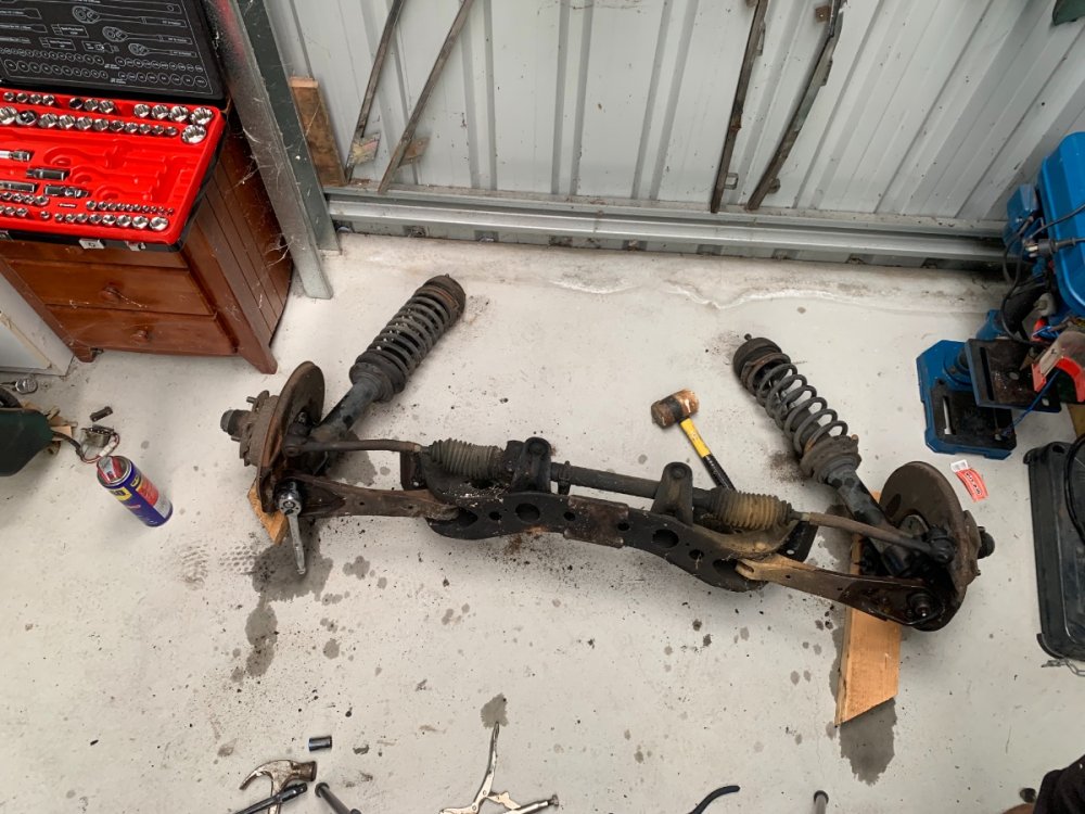

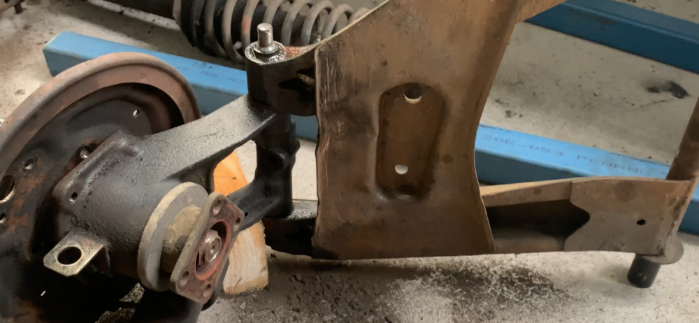

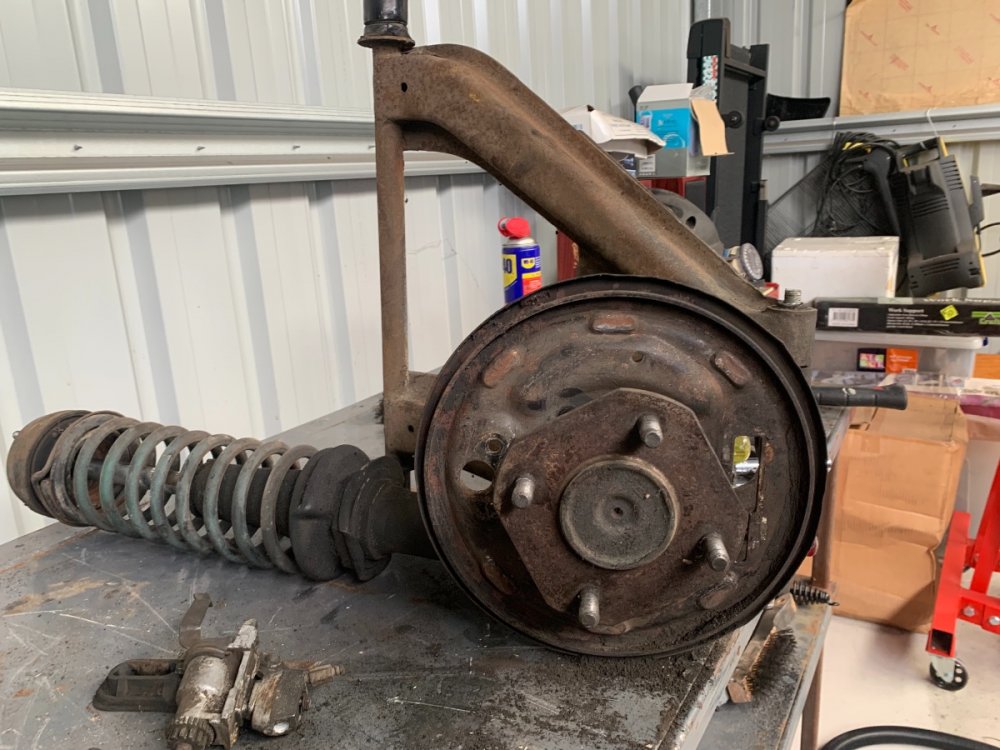

After wire brushing the crud off the rear control arm looks like some smart fellow tried to put a jack stand under it. I was thinking I would just finesse the dents straight if I can.
Outer tie rods were jammed in tight, haven’t tried heat yet but figure I’ll just press them out along with everything else. So just dismantled steering rack at the knuckle.

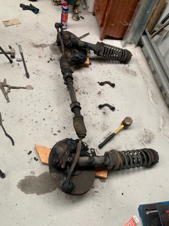

9B65D334-56E5-46D9-B847-F8B194C39E0E.thumb.jpeg.21b26c5f6d306f10bf5697bfade3af66.jpeg6C8E4E20-0EA8-429C-84B0-3D2BFA7CBBDF.thumb.jpeg.c6b4c0a66463a01289da8f55a2524dd1.jpegF5BCE06A-D794-48FC-B66D-37E12432F846.thumb.jpeg.6ab2cab6f01d9feaf4dec2887feafa9a.jpeg

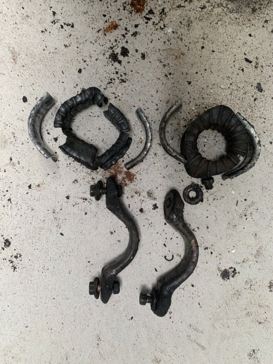

anybody know if the silver brackets from the steering rack bushes are meant to be there? They looked like diy aluminum shims  made up.
Quote
Haven't seen those before, if they look DIY then they must be. Go for the aftermarket urethane bushes, and the steering coupler as well, really improves the steering feel.

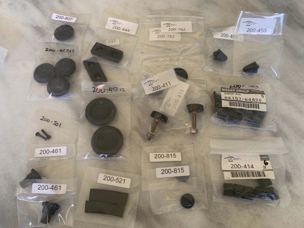

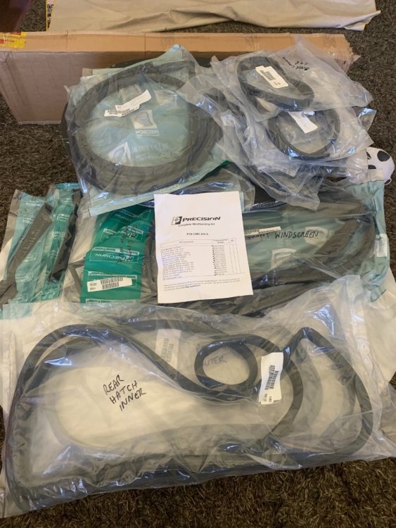

weatherstrip kit arrived along with rubber and grommet kit all from z car depot. I am 90% confident that the zcardepot kit is straight up the precision kit. All parts are corresponding to precision’s part numbers, arrived in a precision box, some parts did not come in precision branded packets but upon watching some of the precision installation videos on YouTube some of the packaging looks unbranded. Also came with a precision kit packing list. So unless z car depot goes through the trouble of  restickering all their kit with precision part numbers. I’m pretty sure I have a precision kit. What I don’t get is the 200 USD price difference? Zcardepot 289 USD and from precision 468 USD!
Rubber bumper and grommet kit was a bit of an impulse buy, but contains a lot of parts I assume I’ll need at some stage.

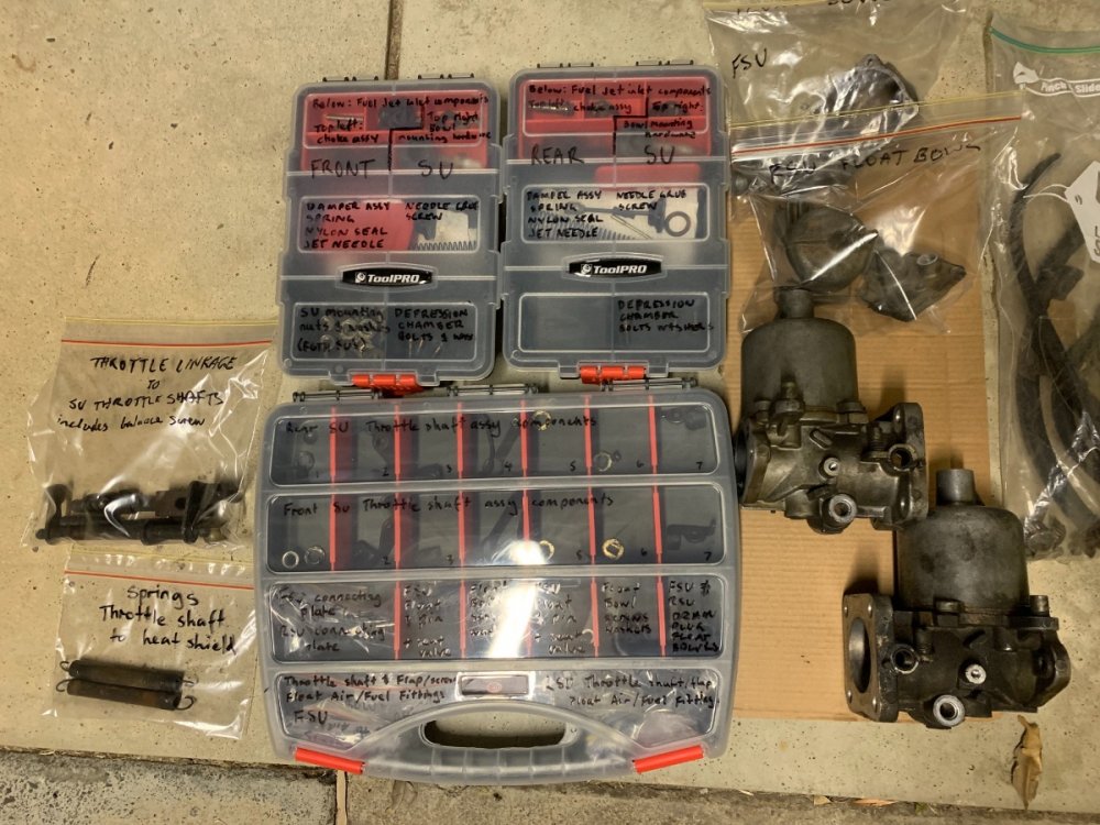

I managed to strip my rear SU, so plan is now to buy a parts washer and clean everything in prep for replating and vapor blasting. Can’t believe how many individual parts make up a set of SUs! All parts very thoroughly catalogued and organized.

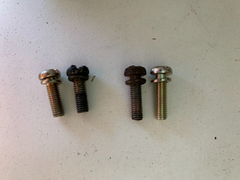

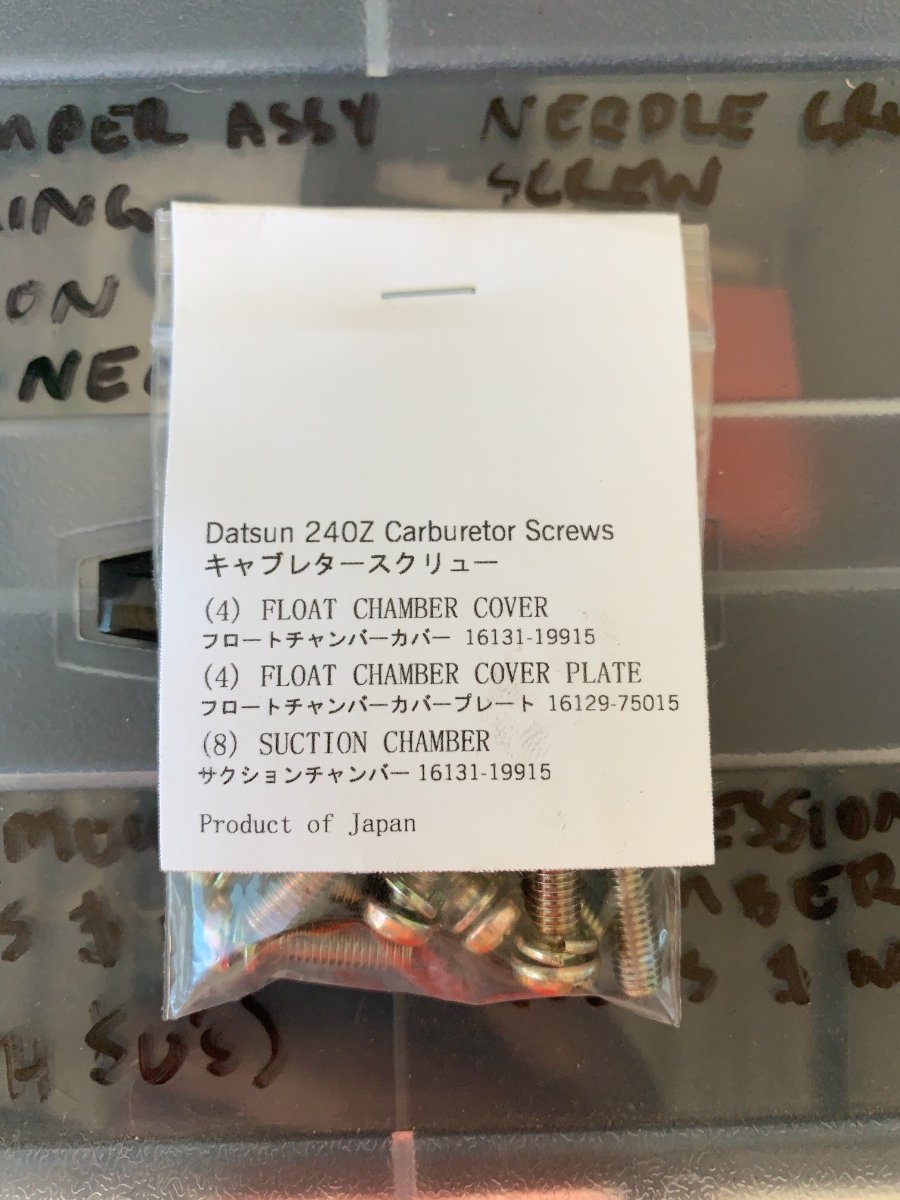

Does anyone know the best place to source oem or equivalent fasteners for SUs? I have some screws with stripped heads etc

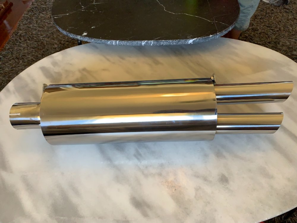

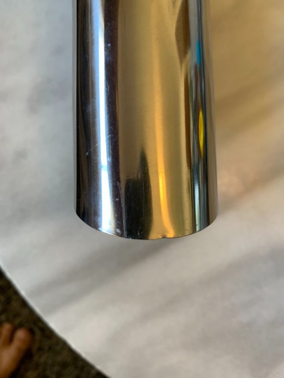

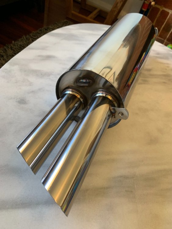

I did receive my blemished zstory jdm muffler. Which is a very nice unit, and for 260$ aud shipped I couldn’t resist. I don’t know what my plan is to minimize the blemish just yet. slight damage during shipping but nothing unfixable, may just need to have a machine shop shave the tip.

Dam man that's a killer price for the muffler!
So how much of that price was shipping for the muffler?
I feel like a Turkey... I got a Genuine Fujitsubo LegalisR MUFFLER  For my car from japan... it was $1000 after shipping....
( Mind you this was 8 or so years ago and these copy's weren't around then )

Not sure the breakdown on the muffler, was just a set price. I’d say at least half of it was shipping. But you don’t have a perfect product. I still think it’s great value, and my car won’t be a show car so not fussed on the blemish.
I payed 150-160aud for shipping. It was a largish and heavy box so I thought that was good value. Wow 120$ for some gaskets and badges! I think I will have paid more in shipping at the end of the build than I spent on buying the car!

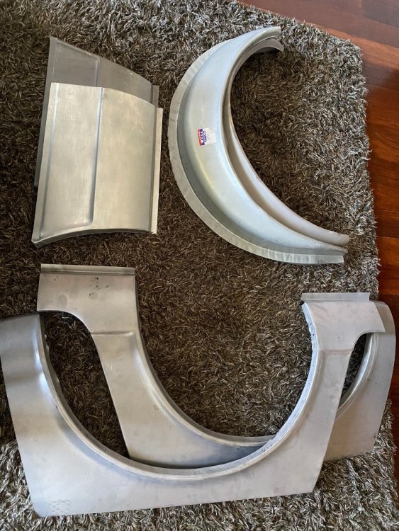

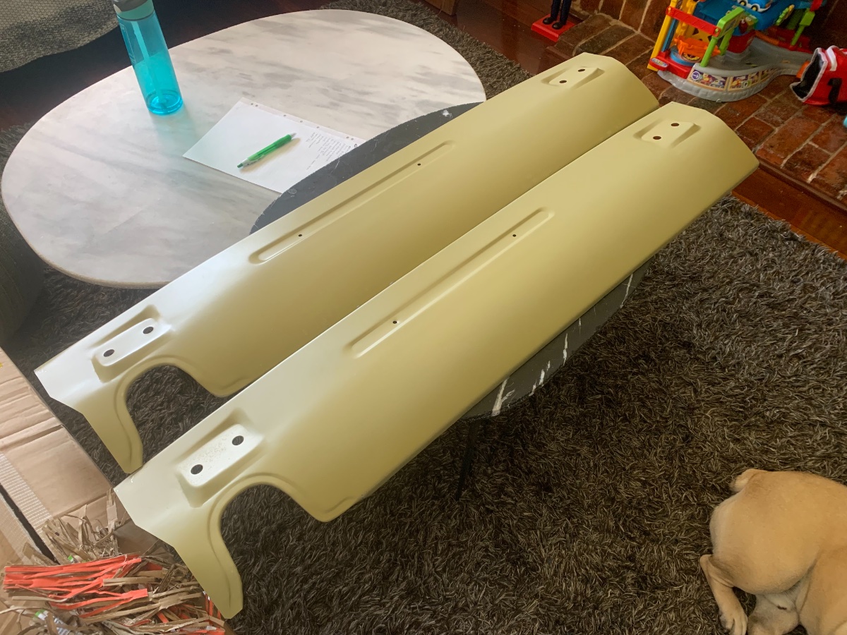

More pieces of the jigsaw puzzle arrived this week. I can’t wait to get stuck into the rust repair.

I'm chasing left and right lower front panel sections as per those Ryan ordered above, and was wondering if anyone can recommend a good fabricator/supplier locally.
Know I can get them thru Rare Spares and will do that if that is the only choice I have.

Mate I’d go with the KF vintage jdm ones they make them now, when I ordered my ones from MSA, KF were not yet making front fender panels. If they were I would have ordered through them, the quality is miles above tabco or rare spares. Even comes with the inside panel. Check them out.
I never paid any import duties or tax on any of my panels.
I personally haven’t heard anything good about any of the rare spares panels beside the door skin. By the time you buy L&R panels from rare spares you’re paying $330. I dare say including shipping KF would still be better and cheaper. Just email them to see how much shipping is.

Thanks Ryan, I'll check them out. Yea, wasn't keen on the Rare Spares option, so having an alternative is really helpful. Cheers

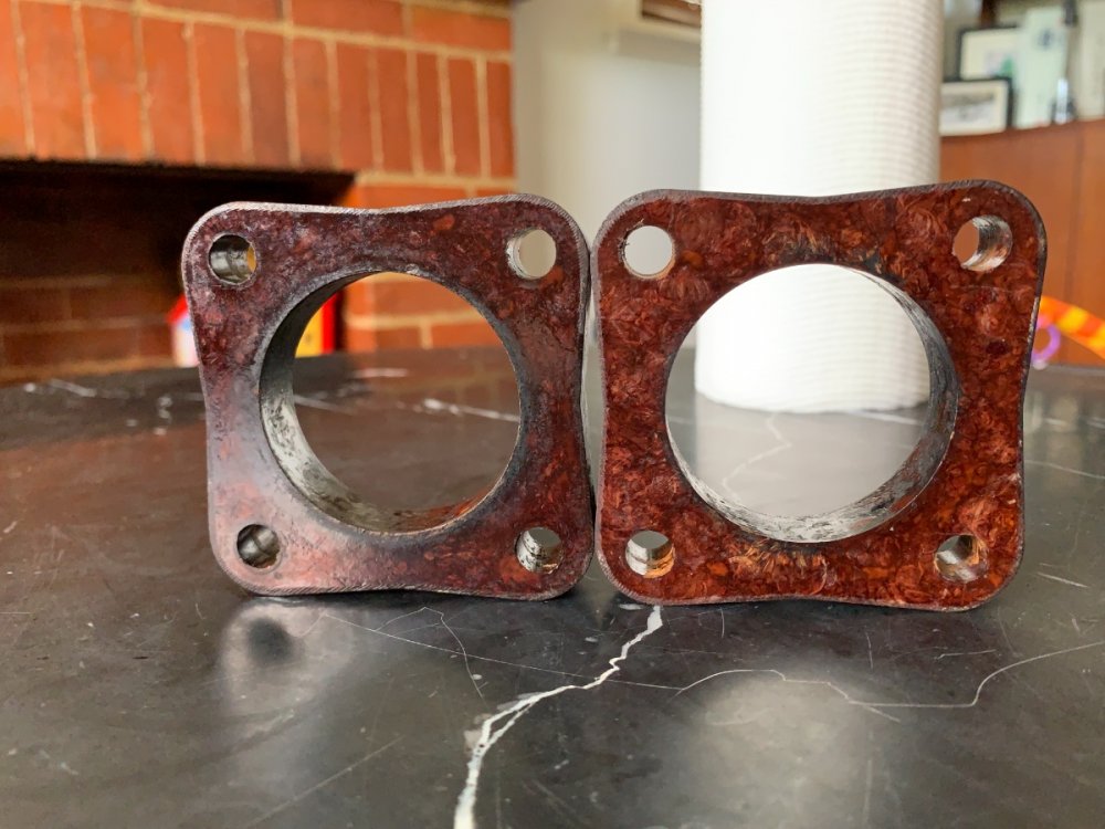

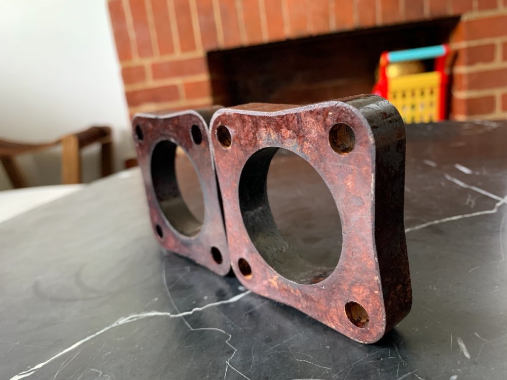

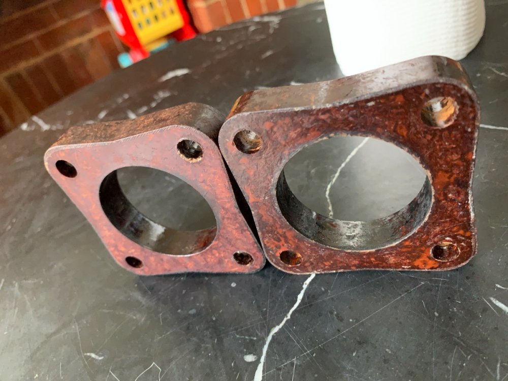

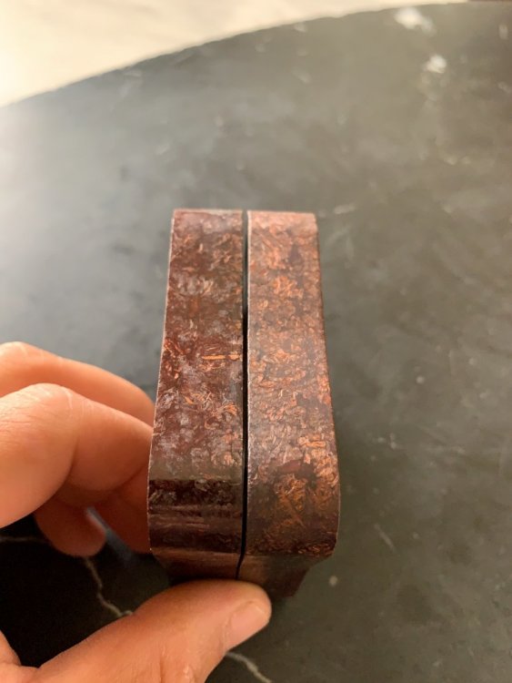

I managed to free my carb insulator blocks from the intake manifold with a razor blade and cleaned them up. The gasket was pretty much glued to one of the blocks, attacked it with the razor blade and was careful not to inflict any damage. cleaned up further with paper towel and sugar soap.  Came out pretty good!
Question: are my blocks ok to reuse and do people normally recoat/varnish these blocks before reusing? If so what product would one use?
AC0393F1-1147-4DFF-B413-66EA23FF9739.thumb.jpeg.85502f36fd5eac4adc83294f87acef08.jpegD56540DC-32F7-4506-88E4-B722291DD93A.thumb.jpeg.1208fd22cfbf79f2ba9a6ca677d756c3.jpegC3A69282-85F7-417F-9C9E-E7D054A98921.thumb.jpeg.0c536f54081fd4cabef3214f826aa486.jpeg670BEB58-7CBD-47C7-9883-6AFEC35D771C.thumb.jpeg.c498a1a7b7710138b0c6e226dce27fc2.jpeg
