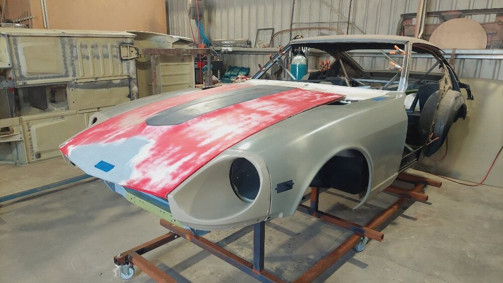

Well, it's time for an update! Picked up the Z for C.A.R over the weekend, they're done a great job! Overall I'm really happy with how the car is turning out. I ended up purchasing a set of Resurrected Classic doors as the ones I have will not be economical to fix. The doors fit okay but they will need some work. I've also got Resurrected Classics guards too, but to be honest, they don't fit well at all. I've found a set of NOS front guards in the states that i'll probably import instead. Next step is to get the car on my rotisserie and see what happens with the front guards. The paint shop was booked in for the next few weeks, but they may have to be put on hold pending on what happens with the guards. Definitely getting closer though!

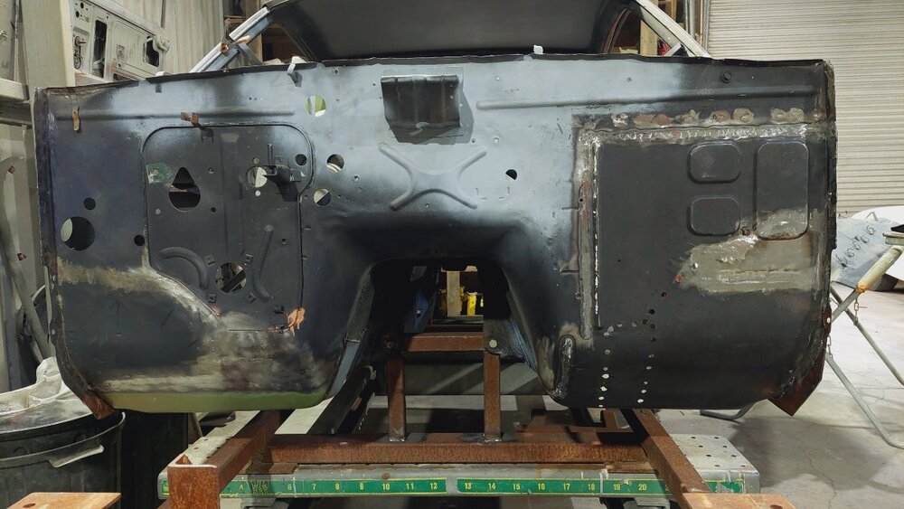

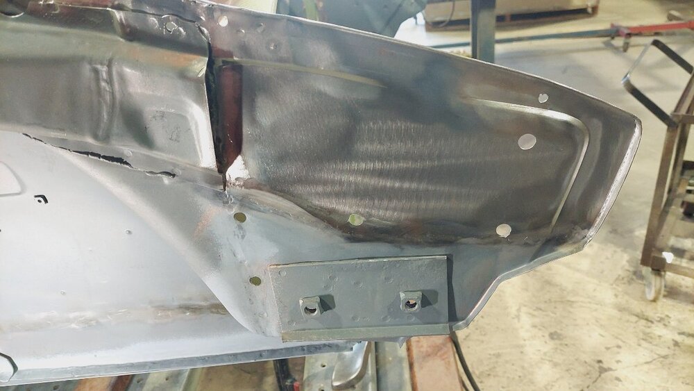

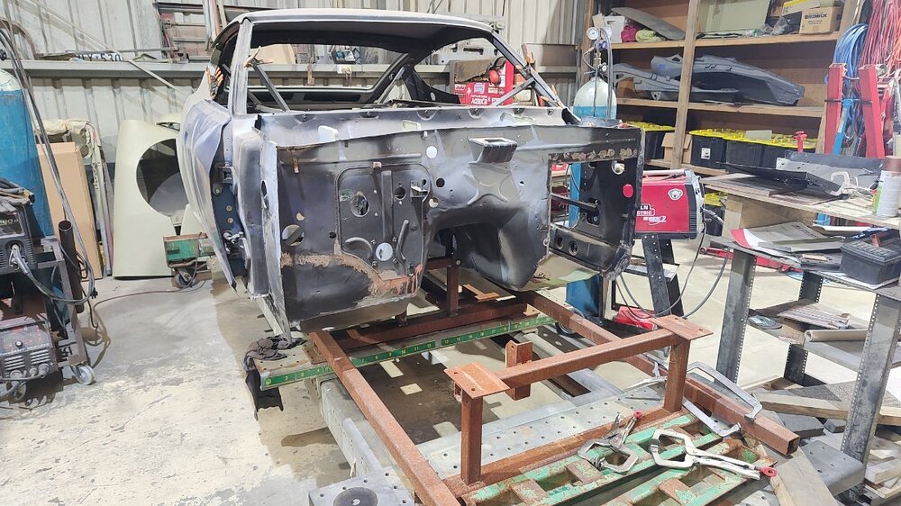

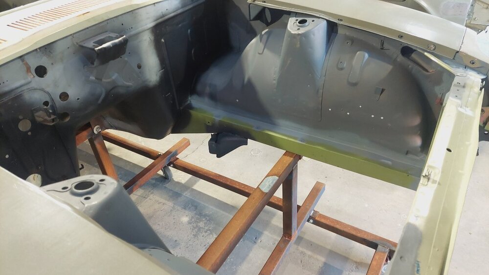

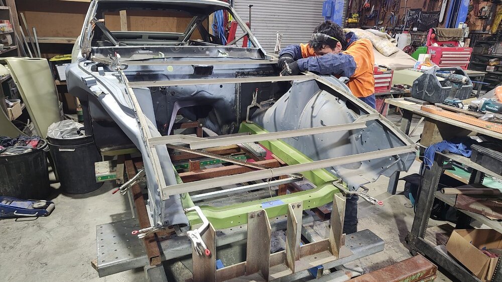

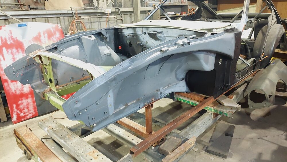

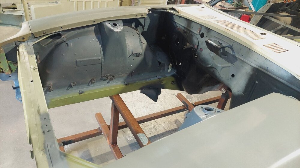

...and suddenly we're nearly half way through 2024. Where does the time go? Thought I'd chuck a little update on here. The boys down at C.A.R have been hard at work over the last month. How they received my 240z: First step was to get the Firewall all repaired and patched up: Then was to trail fit everything to see how it went: The driver side front inner skirting panel was down around 10mm, so they fixed that too. Chassis rails being prepared to be welded on: All front end panels permanently welded in: There was some rust behind the drivers side bonnet hinge which they repaired: Which brings us to how she sits right now as of the 9th of March: What a job they've done. Motivation for this car went from an all time low to an all time high due to the front of this car being completely straight ready and welded on properly. Obviously the next step is to do the remaining 50% of the car - the rear end. Luckily, this should be relatively straight forward for the boys. All parts that'll be welded on are either NOS or reproduction. I know the Resurrected classics Beaver panel needs some work done to the top slam panel positioning though!

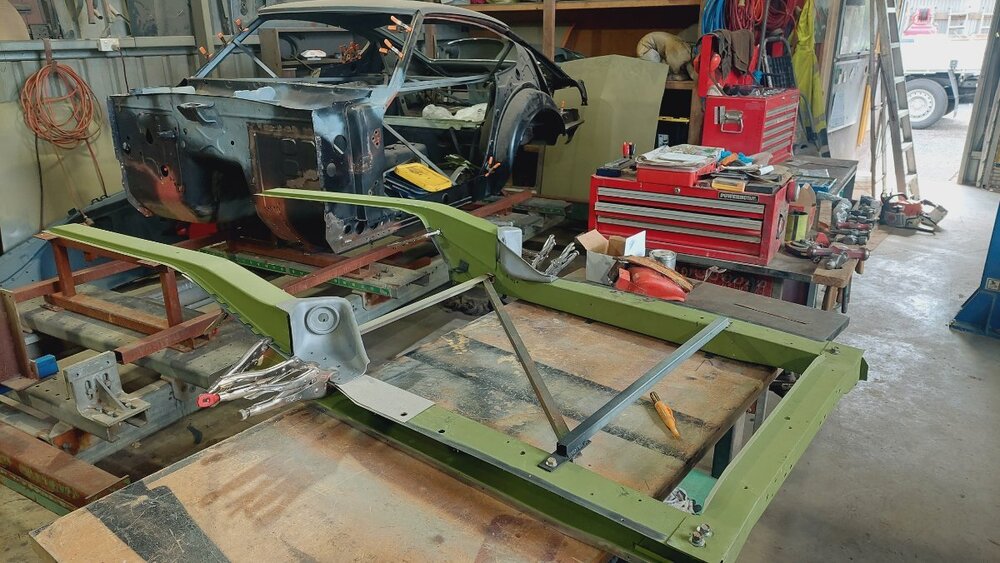

Got a start on preparing the front clip for sandblasting and repairing today - Drivers side was the start. Rough cut to get the old chassis rails off. Unearthing all the hidden surface rust - something to note, the Chassis rails seemed to be significantly heavier than the 240z versions. Possible heavier gauge? Only took about 2 hours to get the old chassis rail off as gently as I could. The KF vintage rail lined up perfectly with the existing engine crossmember bolt holes.. But something else seems to be happening. In this position, the new Chassis rails are hard up against the firewall (where they are supposed to be) The guard to door gap is not too bad, and the guard holes to front skirting panel area mounting points are nearly centred. Which indicates to me that the front clip/chassis rail is in the right position somewhat. (All panels are only mocked up at the moment, but bare with me) Now, i'm finding that there is a 10mm~ gap between the firewall and the surround skirting panel. This should be flush to the firewall like how the chassis rails are. I'm scratching my head over what could possible be wrong in this situation. If the chassis rail is too far backwards, and if it were modified to go forward for the skirting panel to be pushed back flush against the firewall, then the door to guard gap would not existing anymore. This gap also seems to be too big going off existing photos of non-crashed Z's. It's like the clip needs to move back 10mm, but the chassis rails and guard doesn't. Are the engine crossmember holes in the chassis rails in the wrong position? Do the door hinges need to be adjusted back? (Still unadjusted from factory) Quiet a strange one!

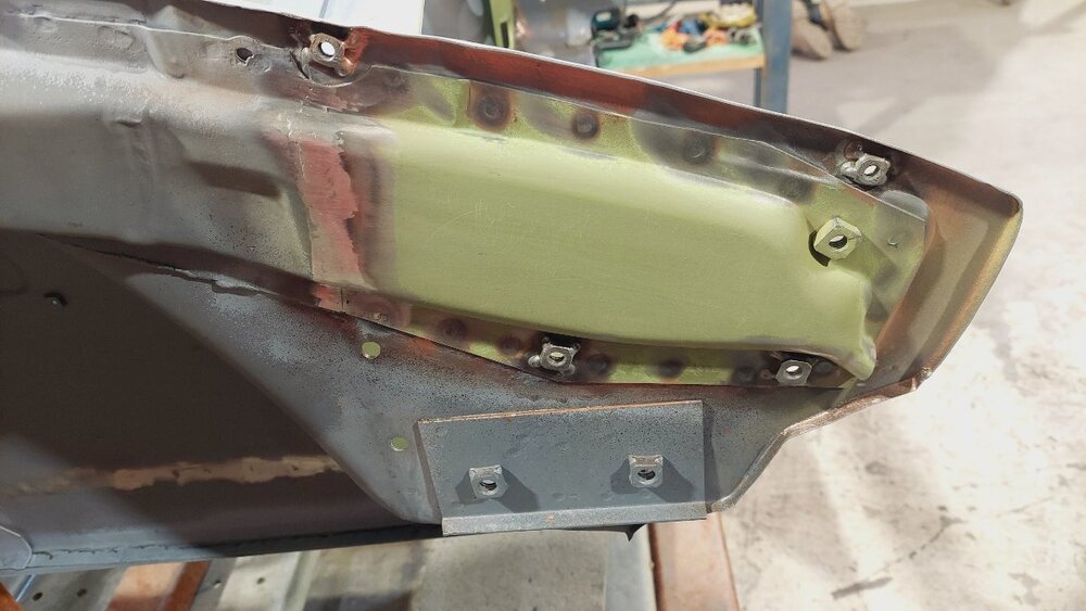

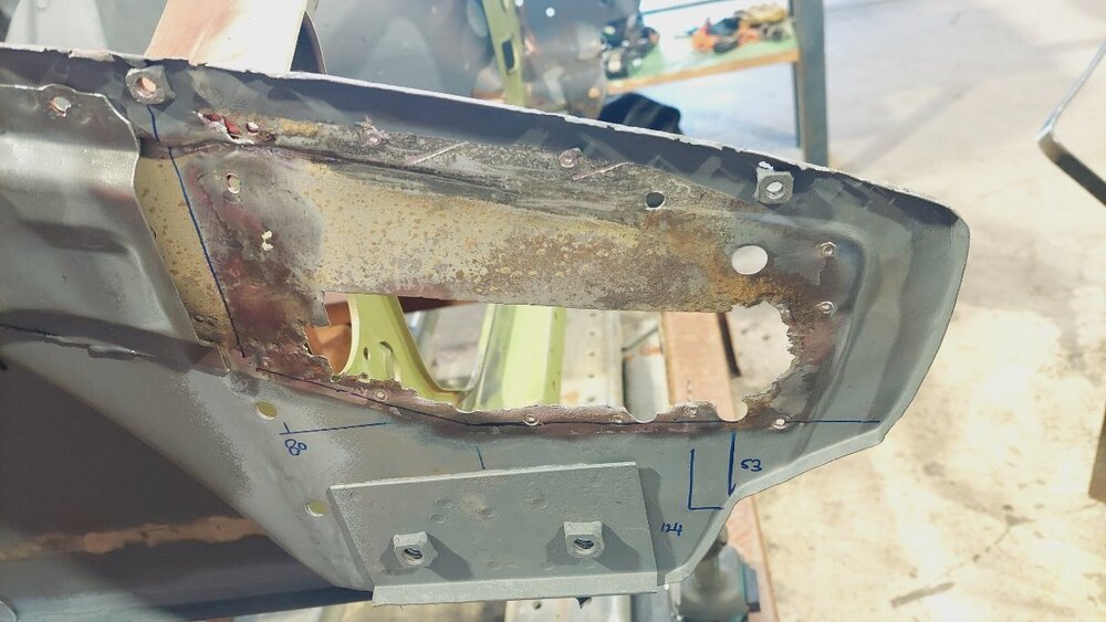

Well that explains that then! With these parts comes a whole new batch of motivation. Removed these two parts that came on the R/H side quarter panel. And as always, bare metal on metal parts without any primer. No wonder why these cars died to quickly. I won't be using these parts. Message me if you need them. Once trimming was complete, I put the quarter on for a quick mock up.. and for the first time in what seems like along time - It now resembles a 240z again! (well, somewhat)
Had to trade some of my NOS parts + Cash his way. Got quiet frustrating at times because the seller wouldn't reply to messages for weeks at a time. But it's done now, and they're here. I couldn't be happier. They are US spec quarters, so the indicator hole needs to be filled in. The drivers side could be early 260z 2 seater - There is a few extra holes around the bumper area which will need to be filled in. Factory rust. This is the behind the 260z quarter where the extra bracing/holes are. I won't be using these brackets behind here anyways. I also picked up a pair of lightly used rear tail lamps. They're immaculate and could come off as New old stock. NOS Front headlight buckets/scoops Replacement centre console. Mine was snapped, picked up this very nice piece. Pool noodles done a great job protecting it during shipping lol Very happy about them! (clearly) I've got a pair of Resurrected classics front guards and hatch coming. I do need to still get a bonnet, there is a NOS piece available but the seller doesn't like responding to messages often! whats with that? Then the only thing left will be doors. I do have a pair of them now, but they need work (2 skins). I would much prefer to get a set of perfect second hand doors, or possibly some NOS pieces - but I don't think that will happen. Maybe I should just put skins on the frames I have already. Not sure.
