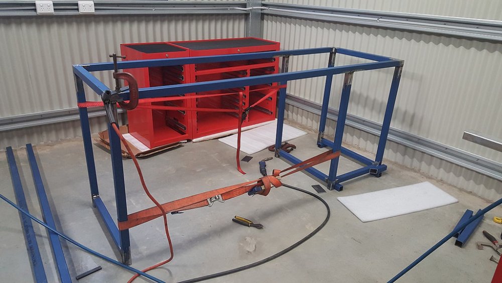

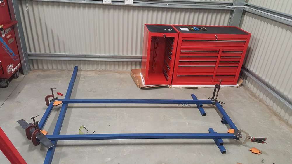

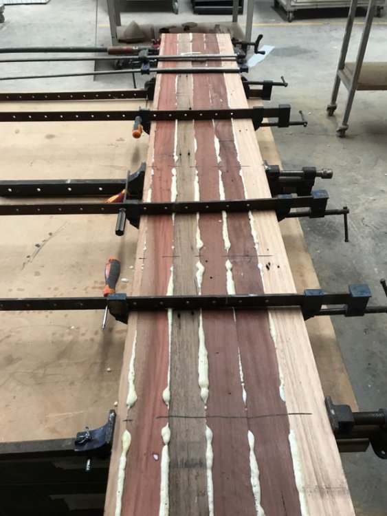

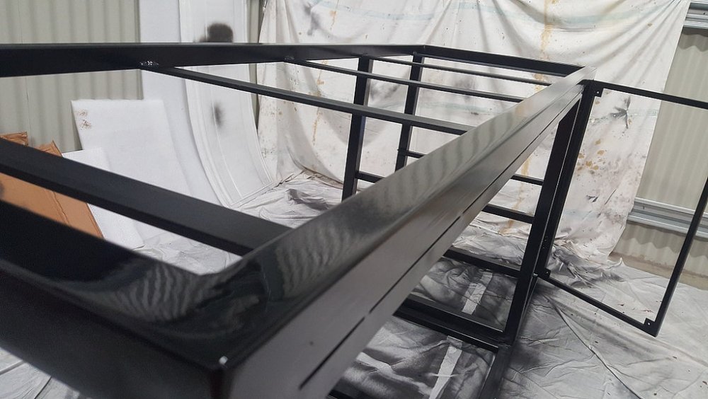

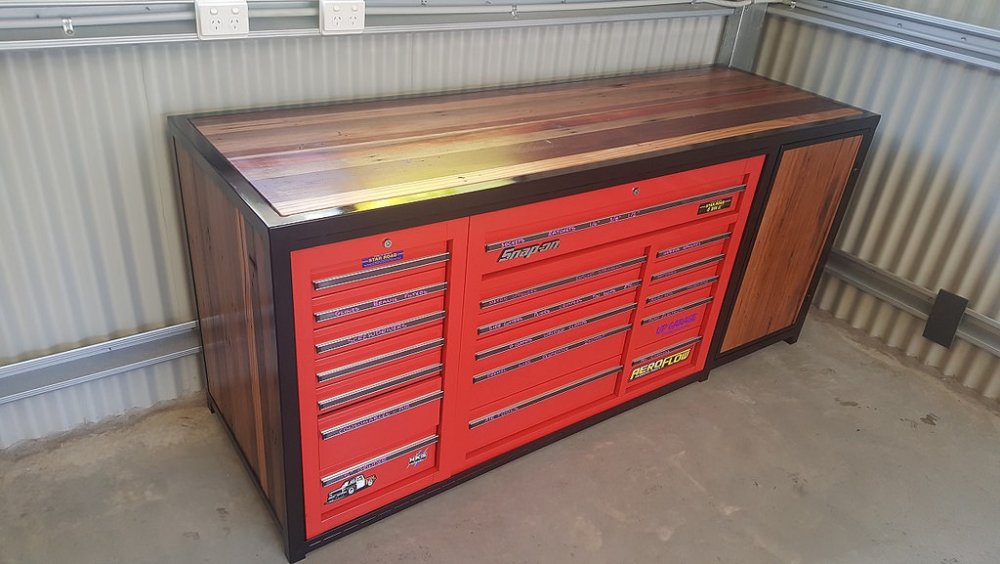

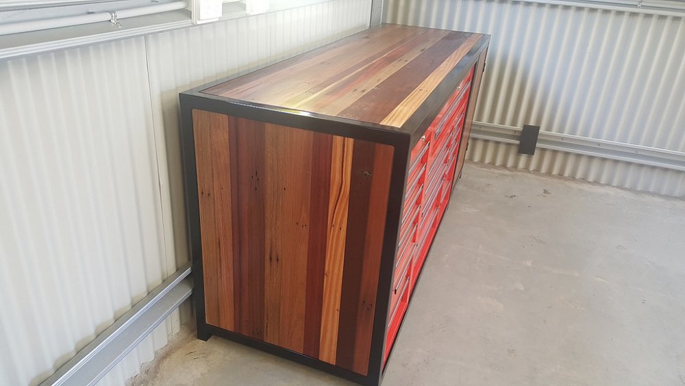

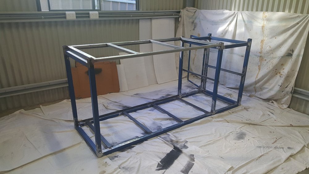

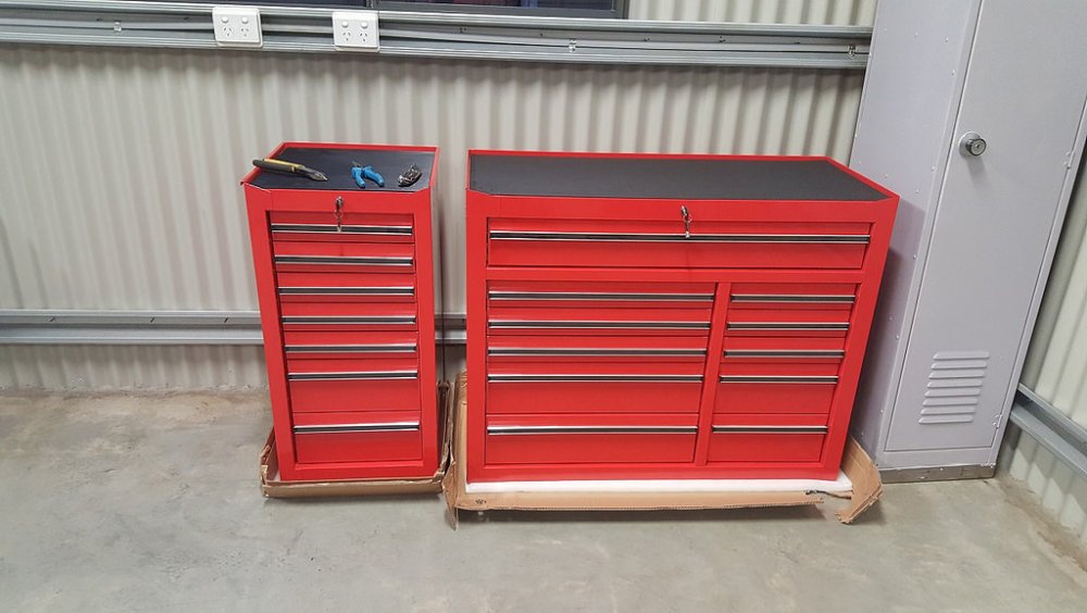

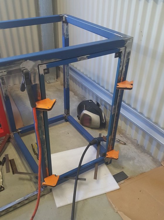

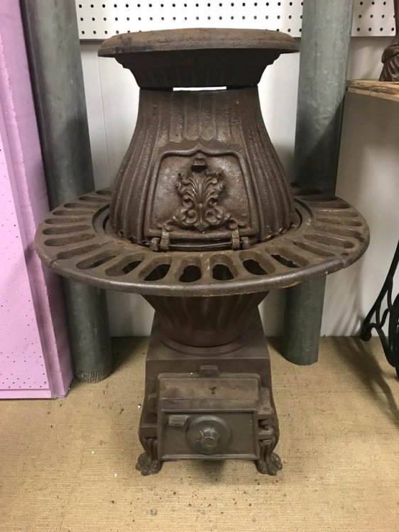

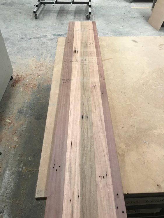

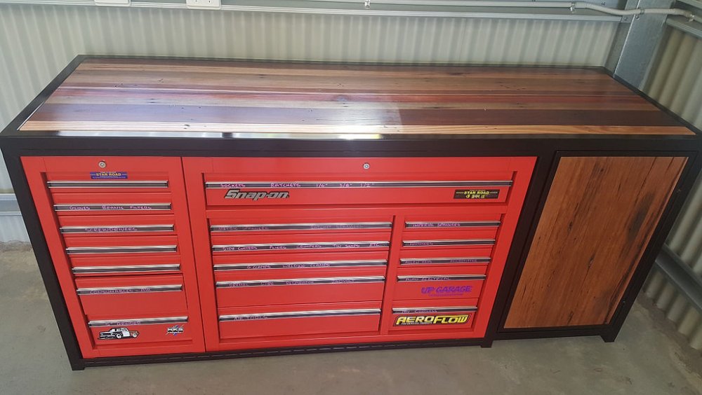

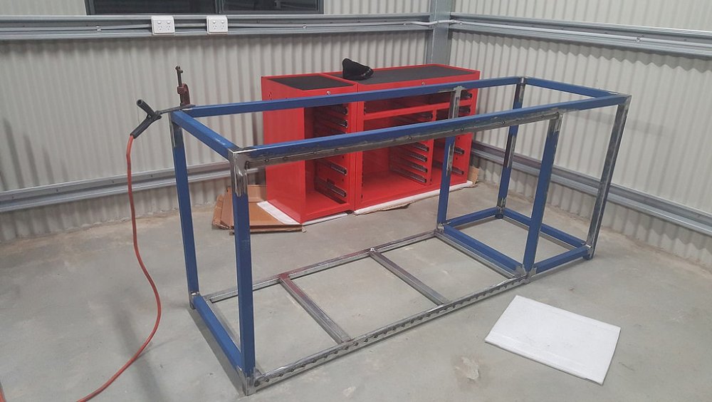

CroS13 Posted July 22, 2017 Author Posted July 22, 2017 Update 22.7.17 - Second workbench done... and a stove? Lots, lots, LOTS been happening in the shed over the last month!Where to begin? I made my second workbench with the help of my mate, who is a extraordinary carpenter. Firstly... acquire toolboxes...... (not that i need anymore...) Start building up the framework: . The basic frame is now complete: Adding some doors, because why not: . Now while this was all happening..... remember this image from a few posts back: . Well my mate helped me pull down the framework, and he took it all home. I only asked for him to make my bench tops and what not from some of the old shed.... So once i had finished the basic framework, he came, took some measurements... and started on his own little woodwork project for me, and started sending me progress pictures: . . And i continued work on my side of things..... getting it ready for paint: . Nice and slickkk! . And today... he came round with the finished wood work... and we got it all put together: . . . And that's the second project done and dusted!! now.... about that stove...... Its very very cold in the garage... much too cold to be working on zeds at night..... i needed some heating. i needed heat... but im a idiot... so what does that mean? No, don't do the sensible thing and go to bunnings and buy a electric heater for $30 and call it a day. No.... go and buy a 80 year coal burning pot belly stove to restore.... which i did....... and after about 6 hours work with a wire wheel: . And then i got a interesting phone call a week after i bought the pot belly stove.....From Perth......So this old bloke rings me. He saw the advertisement on Gumtree, rang, was told the stove had sold to me, and he promptly asked for my number. Turns out he is restoring a vintage 1930's Western Australia State rail caboose. Apparently this pot belly stove is actually out of a caboose. It is a van guards stove.And he happened to offer me 8 times what i paid for it not 1 week after i got it. His sister lives in Sydney, and came and picked it up the following day, and my wife couldn't believe what the hell just happend! neither could i!And i was left stoveless! but RICH! So i hopped back on Gumtree again, and with 8x the cash i had out layed previously, i found myself another pot belly stove, a GRAND POTBELLY STOVE: And I'm currently working on this little project.I've milled down the un even mating surfaces, cut back all the rust with a wire wheel brush on a drill. Un-froze the front ash door and air control knob. Used a Oxy torch to remove all the snapped bolts that held it together (which was all of them) Last thing to do is make a top hat and chimney spout out of some thick plate steel, and go buy a flue kit!Once that project is done, and im nice and toasty warm in the garage, i might get back onto the zed. But i must admit, I have been having a blast building everything to deck out the garage!Rudi. blu260z, 260DET, potter260 and 3 others 6 Quote
Enzo Posted July 22, 2017 Posted July 22, 2017 Rudi, I don't know you , but you are the man. What a brilliant shed. It's a piece of art in itself and I am jealous as hell. I can see that you will be spending too much time in there once completed. Keep up the good work and most of all, be proud of your achievement. It will look great once it has a Zed in residence. Regards David gav240z and CBR Jeff 2 Quote

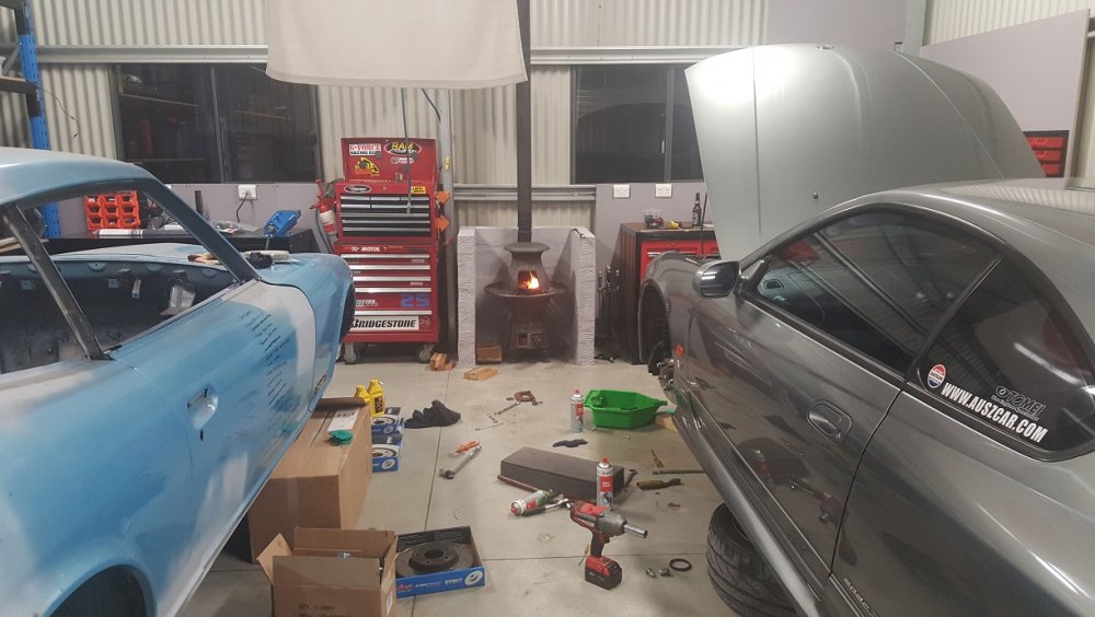

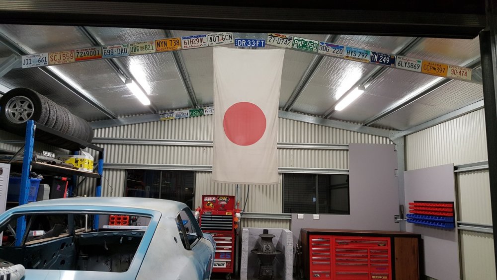

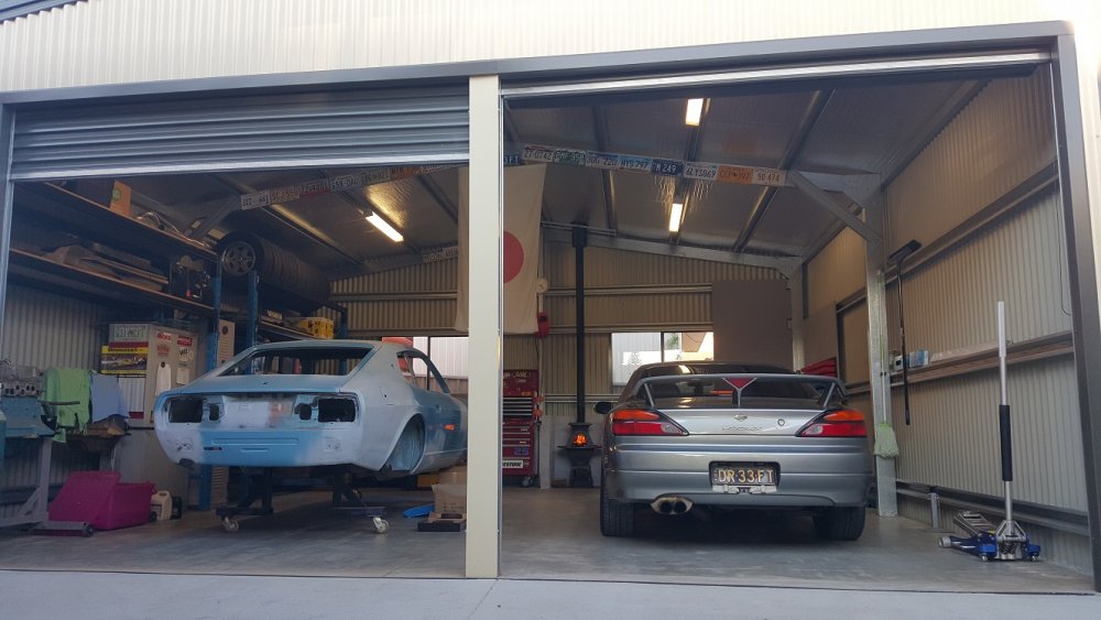

CroS13 Posted September 10, 2017 Author Posted September 10, 2017 (edited) Update 10.9.17: Shed done!So i reached a milestone last week. I have finally finished the shed... for now....I celebrated by hanging some memorabilia i had lying around for the last few years, waiting for somewhere to put it.The final piece was the old Japanese flag i have. I scored it from work when it was being replaced by a new one. It had been sitting under my computer desk for around 3 years, waiting for somewhere to go. . As you can see, i also built a brick surround for my Pot belly stove. I also got a custom flue kit made for it, and installed that a few weekends ago.So last week, on a cold Friday night, i celebrated and christened the garage, by cranking up a fire, cracking a few beers and getting some work done, replacing the brakes and coilovers on the silvia.And boy, does the stove throw out some heat! i ended up being in a T shirt and having the windows open it was so hot in there!! . . And here is a photo i took today, with both cars finally resting in their new home:. . The only job left to do is re build the back of the carport. Once that's done, its back onto the zed!Rudi. Edited September 10, 2017 by CroS13 KatoKid, potter260, 260DET and 4 others 7 Quote
potter260 Posted September 10, 2017 Posted September 10, 2017 I'm in the same boat, spending way to much time building a place to work on the cars. But it sure does make it a more enjoyable environment to be in! Great workplace but That timber work is to nice for a workbench !!! Quote
daretobedifferent Posted September 10, 2017 Posted September 10, 2017 Your garage space is sick! Quote
Cozza Posted September 11, 2017 Posted September 11, 2017 Yes, very nice Rudi. Do you spend anytime in the lounge room these days? I see a 2 post hoist in your future. Quote
CroS13 Posted September 17, 2017 Author Posted September 17, 2017 That timber work is to nice for a workbench !!! Tell me about it. I find myself laying down drop sheets over it when im working on cumbersome heavy parts! I've been told many times... that belongs in the house, not the garage! Yes, very nice Rudi. Do you spend anytime in the lounge room these days? I see a 2 post hoist in your future. Hehe yeah i can be found inside the house.... at dinner time! And you would be correct, a hoist was always planned since the begining! Hot diggity dog that looks good! cheers! i got a lot of ideas and inspiration from the garage journal forums. It also depressed me, making me realise how poor i actually am! ha! gav240z 1 Quote
Moderators PB260Z Posted September 23, 2017 Moderators Posted September 23, 2017 Hi Rudi Very nice work indeed. Love the toolbox bench, absolute first class effort there. cheers PB Quote

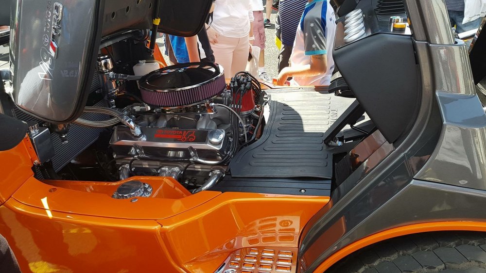

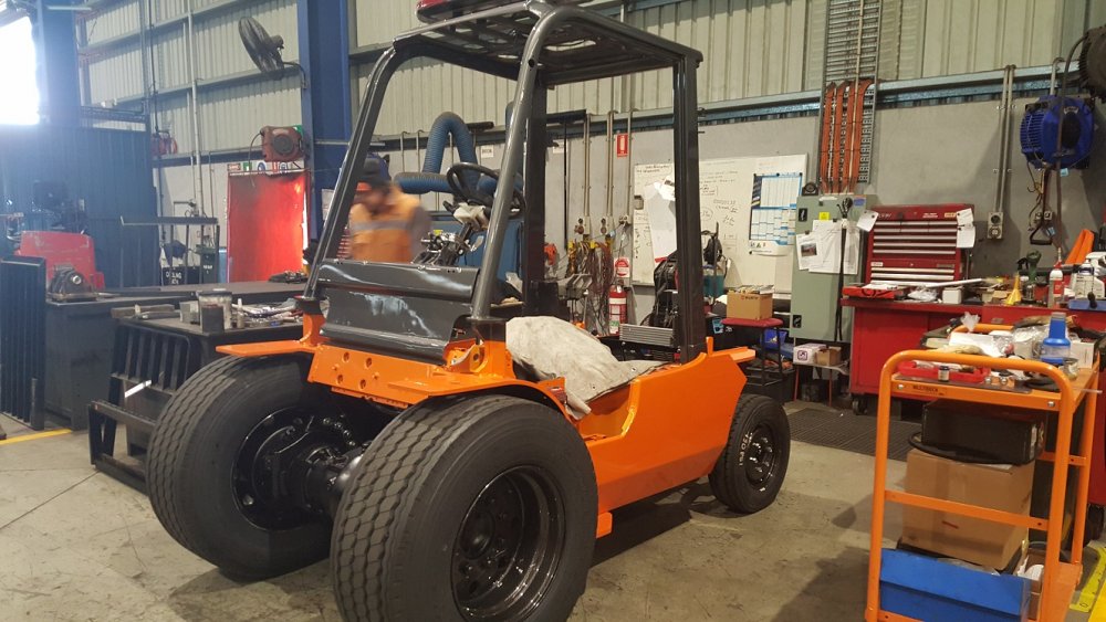

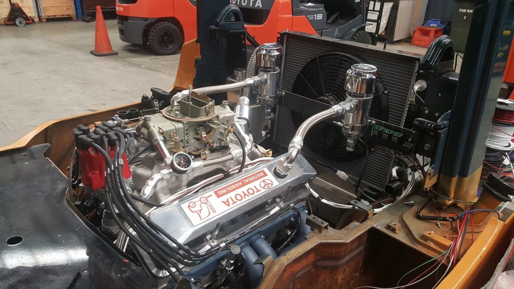

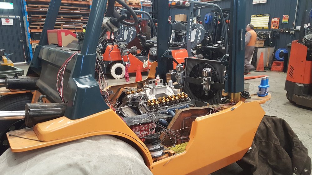

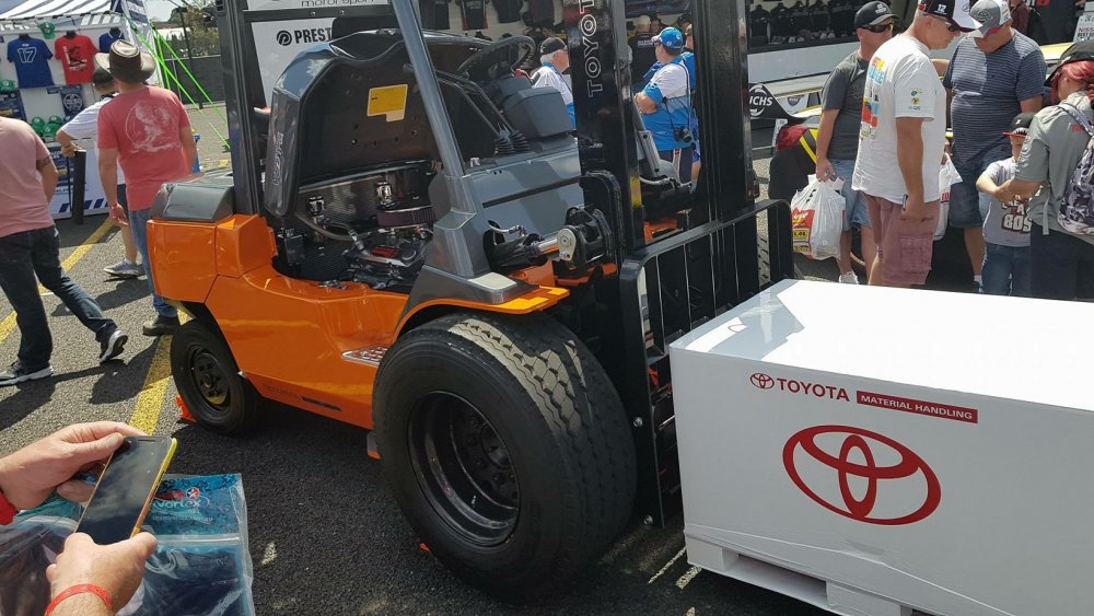

CroS13 Posted October 6, 2017 Author Posted October 6, 2017 Update 6/10/17 - Building a V8 Forklift!!!! Now for something a little different, here is something out of left field i think you will all be mildly interested in.For those that don't know, I'm a forklift mechanic. This project build started about 3 years ago when one of the managers at work decided they needed something new to promote the business. What to do... shove a 450hp, 383 stroked Chev V8 into a forklift and use it as a promo vehicle!I can't lay claim to doing much on this build, they pretty much lumped it on our fabricator and he had been chipping away at it very slowly over 2 years. a few hours here, a few hours there. They missed 2 deadline years for Bathurst and said right, this needs to be done this year, so our fabricator spent the better half of the last 4 months straight working on this.383 stroker matched to the factory running gear through a custom adaptor plate. Rear end conversion to Disk brakes to make it do burnouts. My input on the project was getting underneath it and fitting the mast caps because no one else could squeeze under the chassis. That's my pathetic claim to the job haha! Engine: Blueprint engines 383 stroker - 420hp . . Getting close - this was about 2 weeks ago: . And here it is unveiled at bathurst: . 1 I will have to make a video on this thing. Have to gather all the video's from all the boys during the build. Have a few clips of it ripping skids and nearly flipping on its first test run too!Rudi. 260DET, KatoKid, MATTY and 2 others 5 Quote

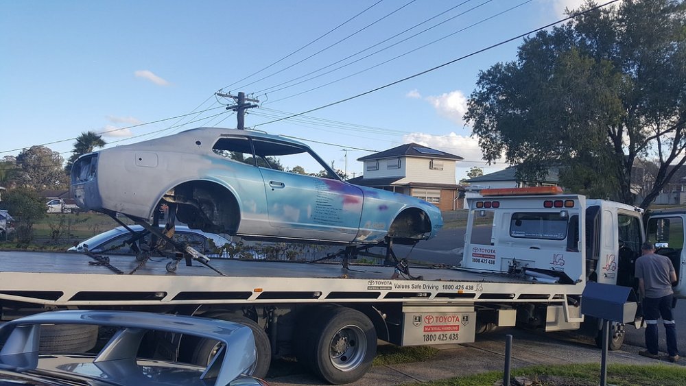

CroS13 Posted June 11, 2018 Author Posted June 11, 2018 (edited) Update 11.6.18 - Off to get blasted Sim's metal gave me a good price for the shell... see ya later! Edited June 11, 2018 by CroS13 RAP260, CBR Jeff and George 1 2 Quote
Moderators PB260Z Posted June 11, 2018 Moderators Posted June 11, 2018 Awesome work, that is a major milestone. Guessing you “borrowed” a work truck ? Ponyo240z 1 Quote
