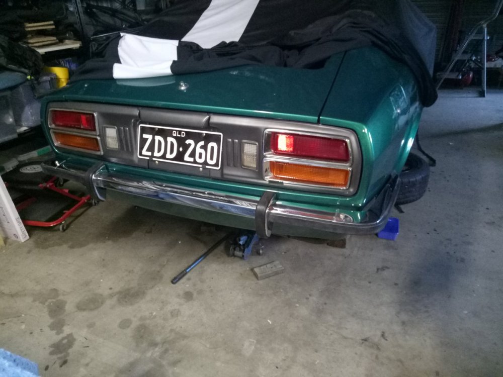

CroS13 Posted February 2, 2022 Author Posted February 2, 2022 Video Update 26: Fitting the LS motor! In Todays episode I paint and fit the engine to the car, and I Finally received my tail light bezels from the chrome plater, after waiting 7 months! So I also re assemble the rear light assembly. Rudi. JDM-TOY and gav240z 2 Quote
