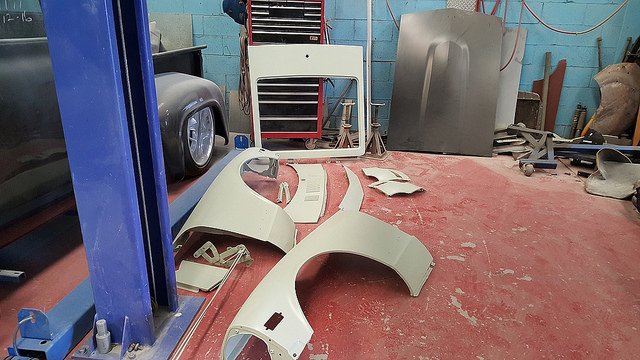

CroS13 Posted June 11, 2018 Author Posted June 11, 2018 (edited) 3 hours ago, PB260Z said: Awesome work, that is a major milestone. Guessing you “borrowed” a work truck ? Cant you see that's just a 2019 model forklift getting delivered to site? because that's all i can see on the back of the truck! And Yeah Jeff, the list is finished! So to elaborate a little. The shell is getting blasted, and put in Epoxy primer. I'm also getting either stone guard or raptor liner sprayed on the underside while they have it on the rotisserie. If we don't find anything, I'll get a quote for them to bog it and spray it. If we do find something major, I'll probably take it home, do the repairs, then send it back to paint, and during that time, I'll at least get it back on the ground as a rolling shell. Rudi. Edited June 11, 2018 by CroS13 Quote

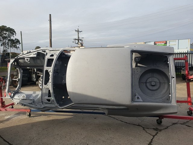

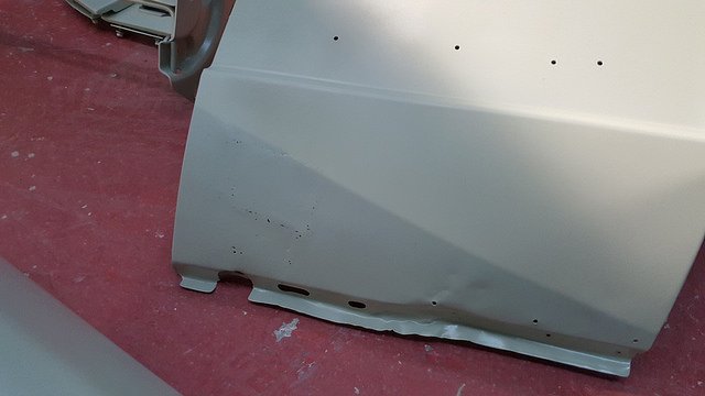

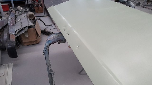

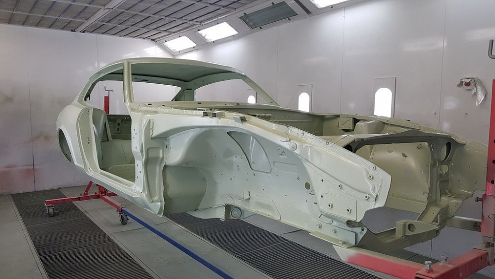

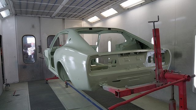

CroS13 Posted June 21, 2018 Author Posted June 21, 2018 UPDATE 21.6.18 - SHELL BLASTED! I got a call today that the shell had been blasted and put in epoxy primer.... and i got sent this photo...... so i took a little drive after work......... It was put in epoxy today. The Shell is perfect... Not a single extra spec of rust on it. And it had no additional dents or dings hiding anywhere . 90% of the hanging panels are perfect too, the bonnet, perfect, the rear hatch, perfect. . We did however find some rust..... In the drivers door. the other door was fine. Funny enough, the one spot i didn't bother to buzz down when i had the car. I did the corner of the door, i did the rocker panel and they were fine, and the door looked fine from the inside... so this was the only spot. I really cant be bothered any more, ill let the smash shop patch these holes....... And on the drivers guard, here looks to be a average repair, and a dent or two... but that's literally it! Cars underbody will get done in Raptor Liner early next week while its still on the rotissarrie, Marcel is making me up 2 paint cards for me to see when i get there too. He is busy... he said he has 3 or 4 cars that need to be done before mine, but he said mine was no issues what so ever. Hoorah! Rudi. gav240z, RAP260, GongZ and 3 others 6 Quote
Moderators PB260Z Posted June 21, 2018 Moderators Posted June 21, 2018 Hi Rudi That looks amazing - a real credit to you. Cheers PB CroS13 1 Quote

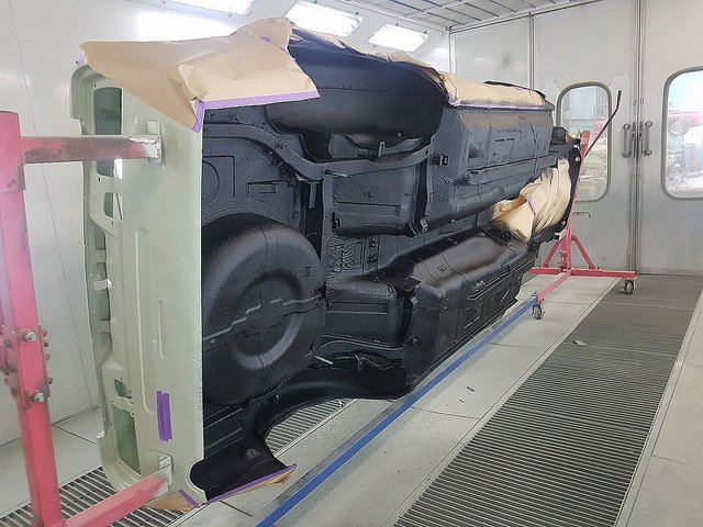

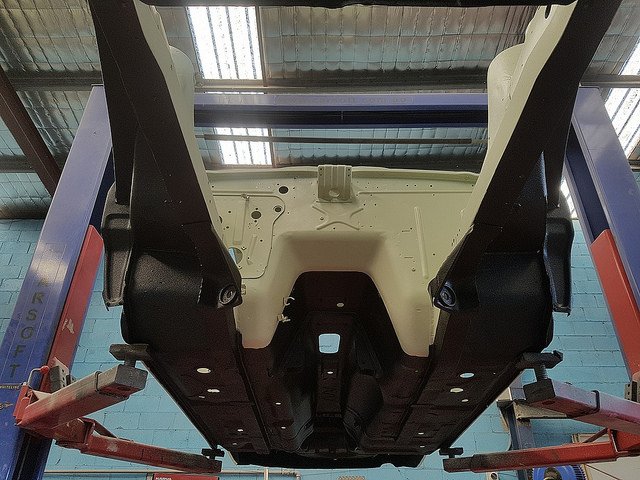

CroS13 Posted July 3, 2018 Author Posted July 3, 2018 Update 3/7/18 - under body coated! So i was sent a few more photo's today of the zed. Under body has been put in raptor Liner. . . Painter said it might be 1 month before he can start work on the car. Rudi. George, HKSZ, gav240z and 2 others 5 Quote

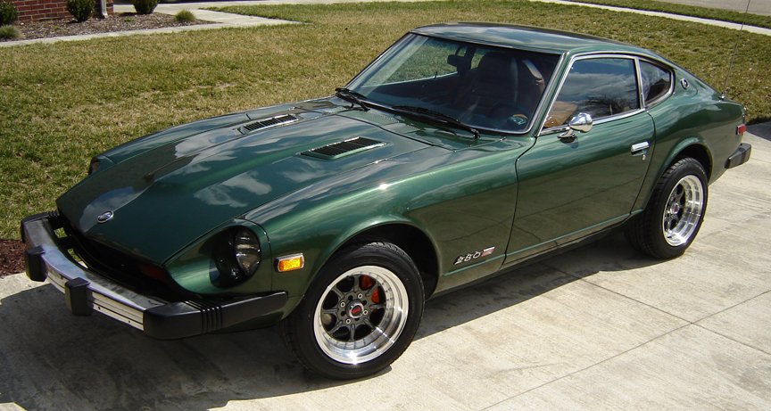

Brabham Posted October 14, 2018 Posted October 14, 2018 Good stuff Rudi, hope the new place has a massive shed, if not I'm sure you'll build one. I am definitely a fan of the Emerald green, one of my favorite zed colors so I vote for that. Is it #303? Not a fan of the lighter leaf green. Cheers Quote

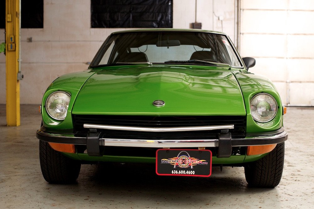

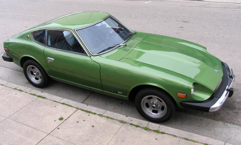

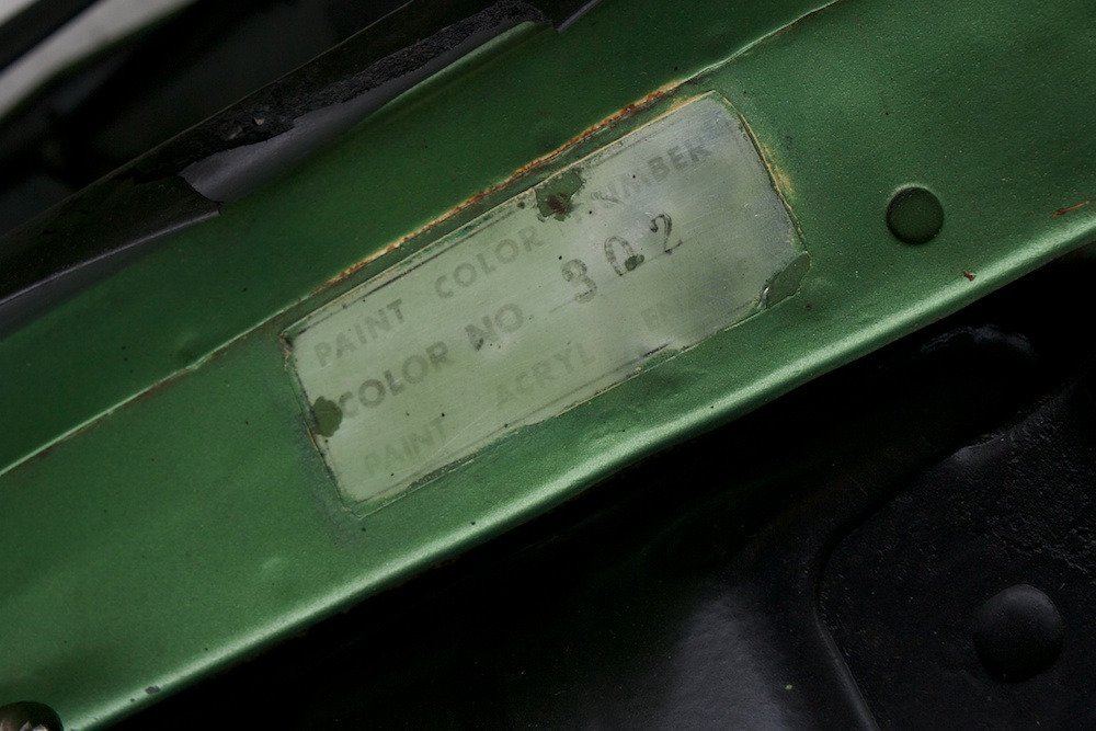

Administrators gav240z Posted October 14, 2018 Administrators Posted October 14, 2018 Hey Rudi, Here is the lighter green. I really liked it. Very rare to see this colour on any S30Z these days. https://bringatrailer.com/listing/1974-datsun-260z-22-2/ However I much prefer the darker more metallic looking green. It looks even better in person. However I like the factory blue your car was originally too! Like @PB260Z's car. However I also really like the darker blue colour on 2+2's and I don't think it's listed on the Zhome.com page (seems a few differences in markets). Same colour as the Benalla Barn find. Just to throw you a curve ball.. https://photos.app.goo.gl/CWdhoXxY9WjdXoKE2 Quote
Brabham Posted October 14, 2018 Posted October 14, 2018 I thought the lighter green was #302 or #113 like Andy's car Gav? I like all the colours you posted above. Quote
Administrators gav240z Posted October 15, 2018 Administrators Posted October 15, 2018 I'm not sure if the "240z" green was carried over from the 240z to 260z years? I think part of the problem is that sites like Zhome.com are not entirely accurate with their colour palettes. I also think there was some variance between markets. Not to mention that matching a colour of a car in certain lights may make it appear lighter or darker and the colour on a monitor doesn't matter what it looks like in person. All of which make it really hard to verify colours easily. Hence why photos of original colour code stickers are useful or dealer delivery sheets. But how many people still have those documents with their 260z's these days? Especially 2+2s? I have definitely seen the dark metallic green like in the Wasabi Green video above, and it's lovely in person and really suits the 2+2 shape. If I was to pick between the different shades of Green that's the 1 I'd go for. But my favorite is the Blue above. Quote

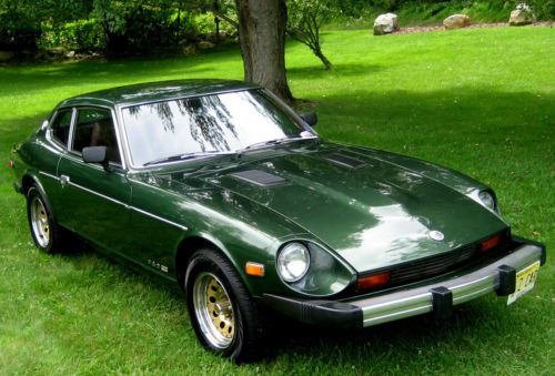

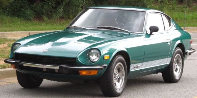

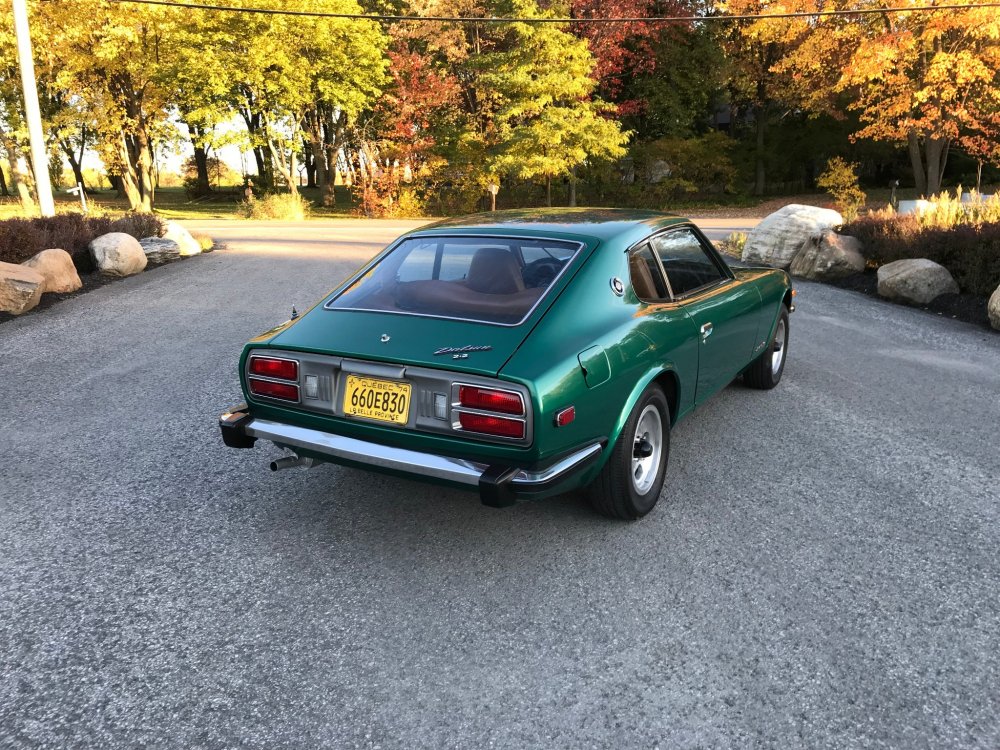

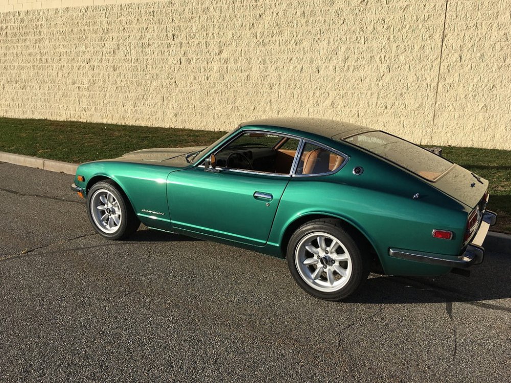

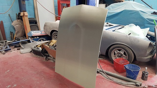

CroS13 Posted October 15, 2018 Author Posted October 15, 2018 (edited) Ok Gav... I Have been meaning to rack your brain about this paint because you would be quite qualified on the subject! So where to start? Firstly... i LOVE the colour of that wasabi cars 2+2. THAT was the colour i wanted to paint my zed, but i was not sure if it was a factory colour, because in the sun, man did it Pop and lighten up. So you seem to think that its 240 racing green metallic? because it looks way to light compared to the colours I've seen of it, and even my spray out card. I got all my information on colours from: https://zcarguide.com/datsun-280z-stock-paint-interior-colors-us-canada/ Is it correct? who knows, but it was the only site i found that had colour codes and photo's of cars in them with what it "should" look like. Now... According to that site, the dark green is 240 racing green metallic, only offered in the US market 280z. The photo they supply is as follows: . Now I have seen conflicting images of so called 240 green racing metallic, specifically in how much gold there is in the paint when it flops. However, all of the supplied photo's of cars in that green, don't show it with the sun hitting the paint and making the metallic flop. It only shows it in the shade. My spray out card, i gave the painter the code, 240 racing green metallic from a datsun, and thats what it spat out. And boy does it have a tonne of gold metallic through it. I was trying so hard to make it pop in the video but no dice, but on a bright sunny day the spray out card turns nearly gold as you rotate your view over it.... I was after a more subtle green... My Second choice... well... i like this just as much, is this photo. i have no idea if its 240 racing green metallic or not: It seems to have alot more shine, and a deeper green than 907 racing green off a 240z that i thought it might have been. And lastly, yes, the emerald green is 303 emerald green metallic, Those photo's you posted Gav are sweet, ive never seen a 2+2 in the colour. The car that made me fall in love with that colour is this one: with a album found here: https://www.classiccarratings.com/auction-results/datsun-240z-1973-hls30-136419-bring-a-trailer---week-46-2017-2877 but once again, it has sooooo much silver metallic in it, which i'm unsure if i like it. I've seen another photo of what i think is the same colour in the light, and i hated it: r That can be found here: http://uniclassiccars.com/datsun/165558-rare-all-original-1974-datsun-260z-in-prestine-condition-.html So yeah.... very confusing! Rudi. Edited October 15, 2018 by CroS13 Quote

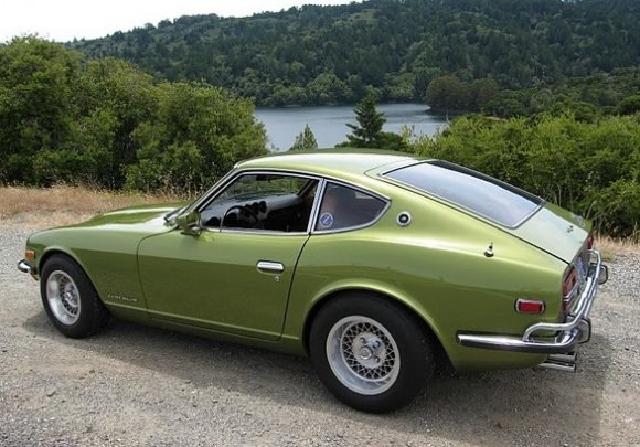

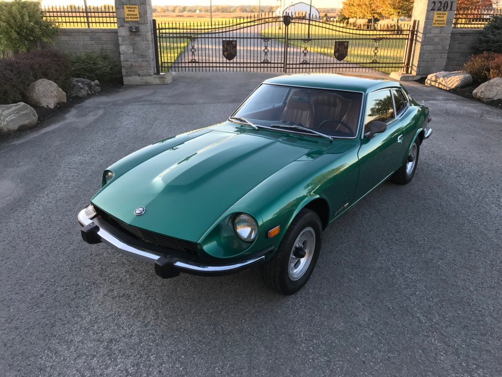

Administrators gav240z Posted October 16, 2018 Administrators Posted October 16, 2018 On 10/14/2018 at 9:37 PM, Brabham said: I thought the lighter green was #302 or #113 like Andy's car Gav? I like all the colours you posted above. I believe 113 Green like @andyk_79 240z looks like this. I also believe it was a "240z" colour only (for 1973). https://bringatrailer.com/2010/10/18/2-owner-1973-datsun-240z/ 23 hours ago, CroS13 said: Now... According to that site, the dark green is 240 racing green metallic, only offered in the US market 280z. Keep in mind that our later year "260z's" were often specified similar to later 280z's. Since really they are S30's just different variances in years as they went along. Some colours got changed over the years I guess to keep the cars "fresh". This to me looks like the Green metallic I've seen on some S30Z's over here. (#240 Green Metallic) But I think it's highly subject to change in appearance given lighting and shade / camera etc..I think the Wasabi cars (car) is this or a variance of it. I think @NZeder's car was this colour. http://nzeder.net/blog/?p=40 #302 apparently looks like this. A better example of #302 http://www.zcarparts.com/gallery/displayimage.php?album=2&pid=376 Again the lighting, age of paint etc.. all have an impact on the way these Green's look. I'm not sure if the below is also "leaf green" but I think it is the same as #302. https://www.sunvalleyautos.com/1974_Datsun_260Z_Hailey_ID_15863000.veh# *Edit found the old eBay listing (beautiful machine). Definitely #302. http://260zforsale.com/1974-saint-louis-mo/ http://vi.vipr.ebaydesc.com/ws/eBayISAPI.dll?ViewItemDescV4&item=381182574120&t=1425692417000&tid=10&category=6187&seller=motoexotica&excSoj=1&excTrk=1&lsite=100&ittenable=false&domain=ebay.com&descgauge=1&cspheader=1&oneClk=1&secureDesc=0 Quote

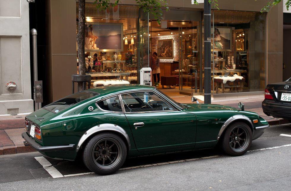

Administrators gav240z Posted October 16, 2018 Administrators Posted October 16, 2018 22 hours ago, CroS13 said: My Second choice... well... i like this just as much, is this photo. i have no idea if its 240 racing green metallic or not: That car looks like it's 907 Green to me (early 240z colour) again just the lighting that makes it change like that. More 907 Green 240z's here. https://goo.gl/photos/LdN9LBLf4h3x4TU56 22 hours ago, CroS13 said: I've seen another photo of what i think is the same colour in the light, and i hated it: Yeah pretty sure it's 303 Metallic Emerald Green. I don't think I've seen that colour on AU market cars. https://saleofcar.com/datsun-z-series/0102564 If you want to be a bit flamboyant I think #302 is awesome. If subtle is your thing..240 Green metallic which is darker. Quote
