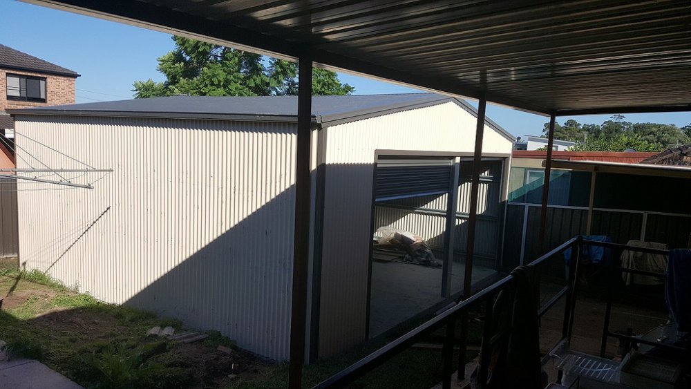

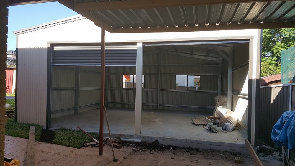

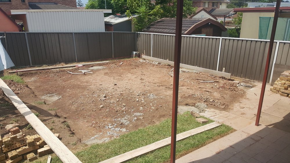

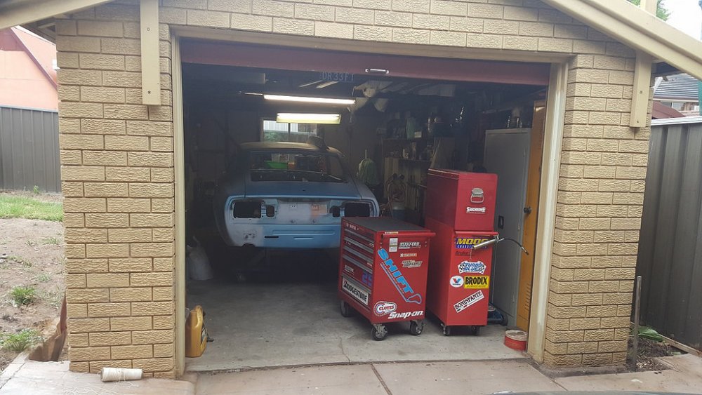

CroS13 Posted May 14, 2017 Author Posted May 14, 2017 (edited) Update 14.5.17: Garage done! Finally! the garage is built! But i still have a while before work continues on the zed.Things to do: 1. Finish building my pallet racking storage, possibly getting another one 2. Build 2 work benches, spanning the full length of the back wall. One to hide my air compressor, 1 for working on and sinking a toolbox or 2 into. 3. Get a hoist put it 4. Maybe start working on the car again? Here she is! Plenty of room to store more zeds! . I went and got about 40 meters of box steel. Should be enough to make all my benches. Also scored the old dexion racking out of the scrap bin at work. have to narrow it down from standard pallet size to about 600mm wide. So yeah, I haven't stopped working.I really need to come out on another cruise, and no George, no mini Rudi's yet! Rudi. Edited July 10, 2017 by CroS13 gav240z, Rickers, PeterAllen and 2 others 5 Quote
Administrators gav240z Posted May 14, 2017 Administrators Posted May 14, 2017 Epic man cave bro! I'm so jealous... Sorry to hear about the Silvia blowing a gasket, damn unreliable piston motors. Should have got a rotor! Life seems full of set backs, shame they make it so hard to build something in your own yard. Quote
Cozza Posted May 14, 2017 Posted May 14, 2017 (edited) Wow, that looks fantastic. Definitely get storage sorted or it may end up looking like my shed. Any plans for Insulation and lining? My shed has brick walls and tin roof and gets very hot in summer. Insulation in the roof would make a massive difference. Looking forward to some updates or a cruise!! Edited May 14, 2017 by Cozza Quote
PeterAllen Posted May 14, 2017 Posted May 14, 2017 Always admired your work ethic - well done, again. Quote
Moderators PB260Z Posted May 14, 2017 Moderators Posted May 14, 2017 Hi Rudi Love it, much jealous. Lucky score on the Dexion racking, that stuff is great and normally expensive. Cheers PB Quote

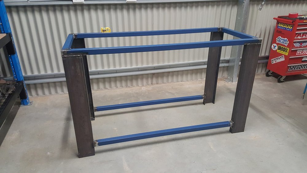

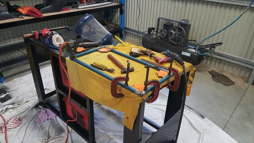

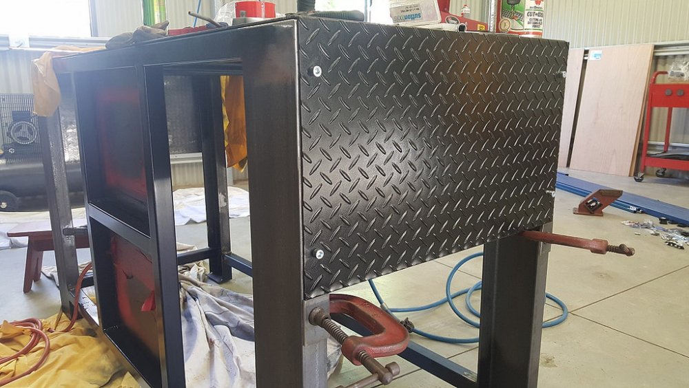

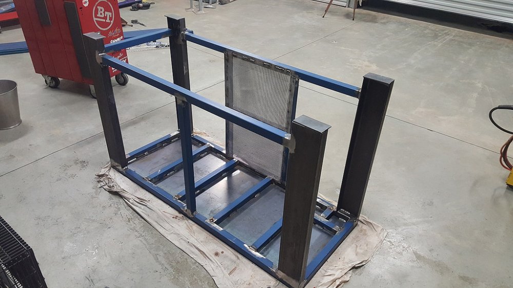

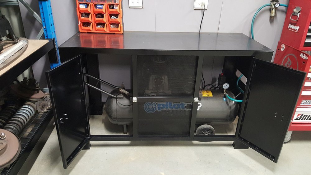

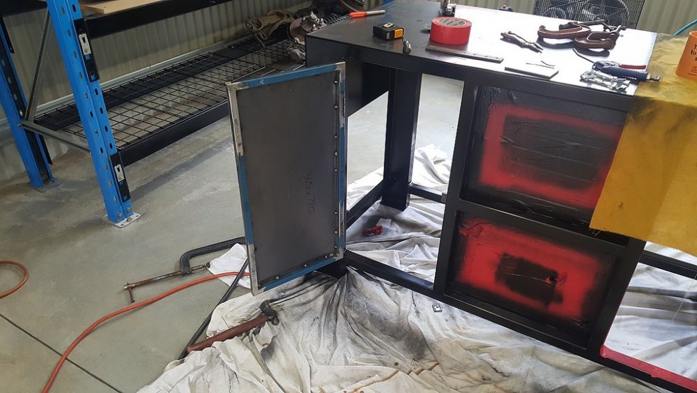

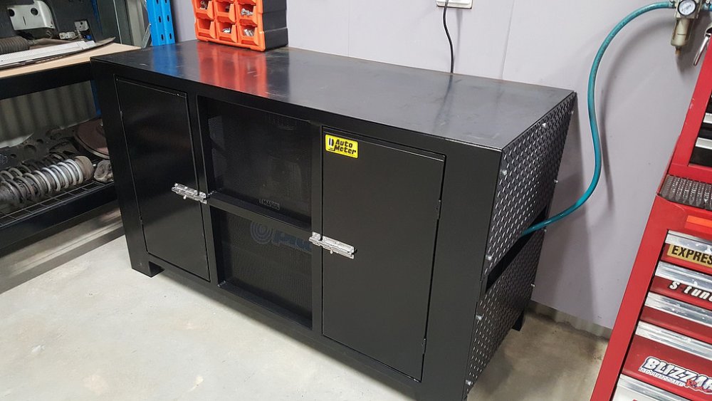

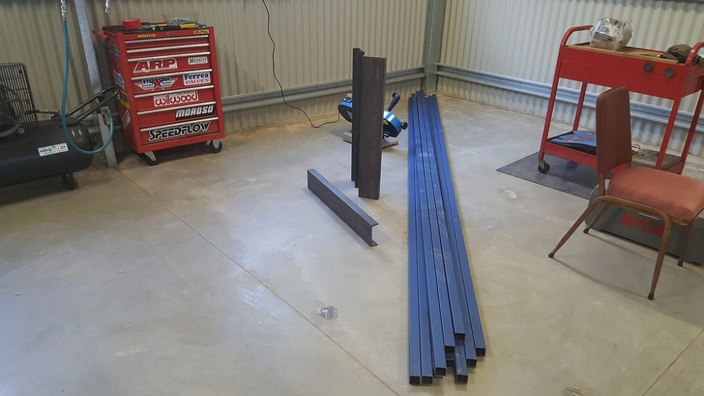

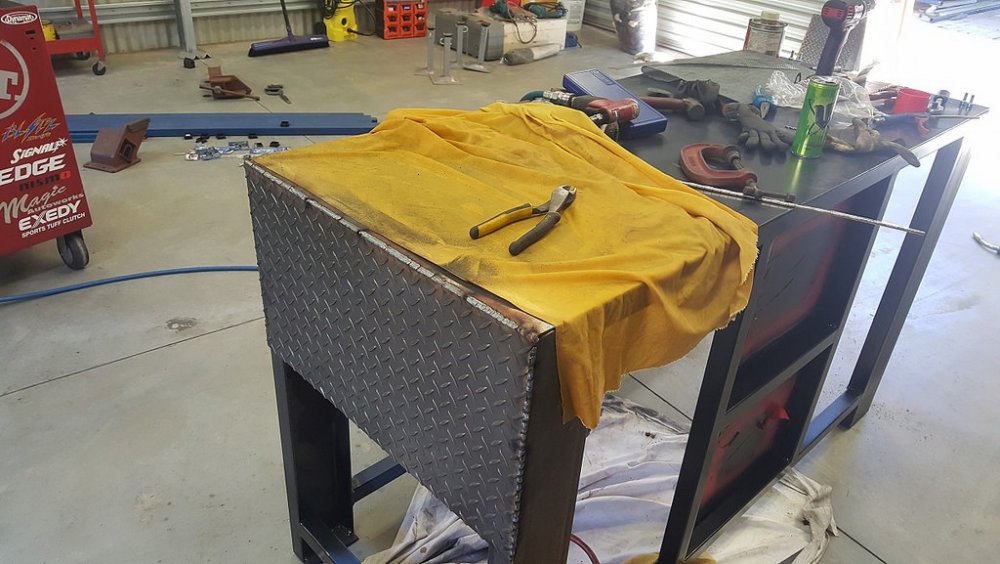

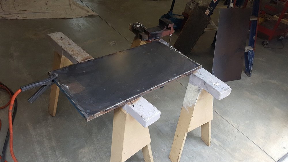

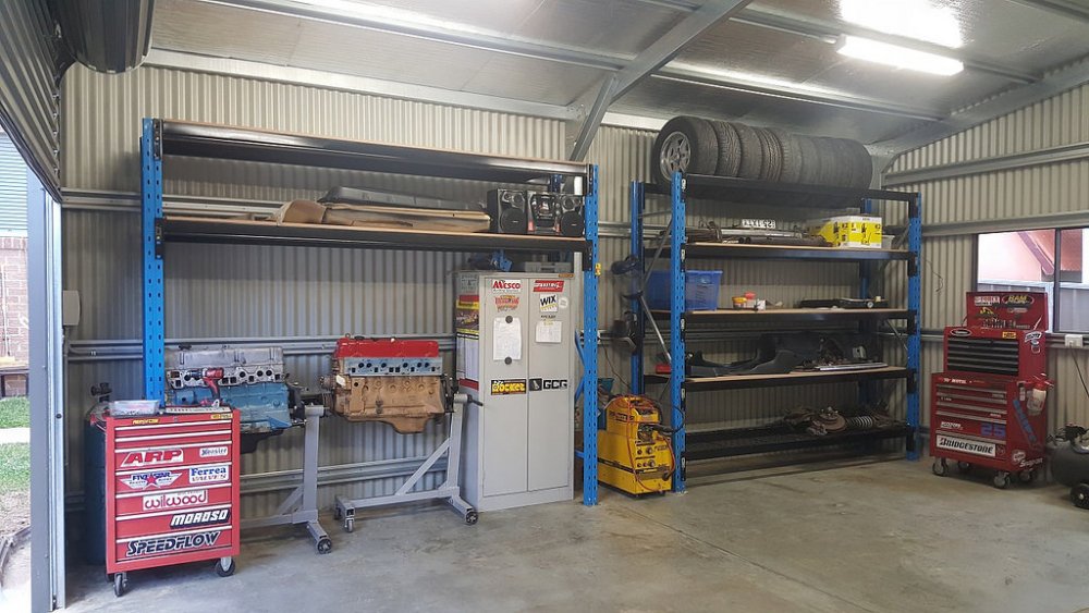

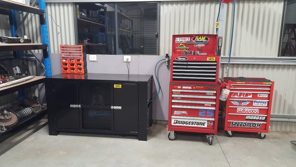

CroS13 Posted June 18, 2017 Author Posted June 18, 2017 (edited) Update 19/6/17: Pimp my shed... then... maybe... the zed! So its been a very very busy month for me.I've been decking out the shed, spending usually a hour or 2 every afternoon chipping away at it. And now i'm about 60% complete. Firstly, i sorted out all that racking: Then on to the first major project. Building a workbench that would also hide my air compressor, saving some room.First step is get some metal, Its a mix of stuff i had to buy and steel i scored from work: building up the frame: Welding on the bench top and adding bracing underneath it: Welding on the side plate: The right hand side needed to be removable, so i could wheel in and out my air compressor, So i drilled into the C channel and tapped the holes, and made a removable plate: building up the frame for the doors: welding on the door skins, i scored the 2mm plate out of the scrap bin at work: door mounted and welded up on the hinges: finished and painted: . . So this was a major hurdle completed. I didn't really know which direction i was going with the bench when i started, i just winged it and went with the flow. Really chuffed how it turned out. It was about 3 weeks of work, 2 hours every day after work and 2 saturdays straight.Next on the list is building another bench for the right hand side of the garage. It will have toolboxes sunken into it, and i plan on inlaying wood into the sides, and into the bench top.My mate is a cabinet maker, and a dam fine one at that. When we knocked down the old garage he took all the 60 year old hardwood framework from it, and said he will make my bench tops out of it. Plenty of work getting done here! Any plans for Insulation and lining? My shed has brick walls and tin roof and gets very hot in summer. Insulation in the roof would make a massive difference. and: Looks great and so much room! I put up the blue foil paper (sizilation?) in my tin shed last year. I just used 3M brand foil tape to fix it on and also fitted a whirly bird. It was 46 degrees in there on a hot day during my engine rebuild with just the bare tin roof and walls. Now with insulation on the roof and walls it's fine on a hot day, the concrete is even cool to walk on. I was amazed at the difference. It's fairly cheap, but a two person job and will take a little time to do. Yeah, i do have insulation / Sarking in the roof, and i plan on getting something for the walls too. Rudi. Edited July 10, 2017 by CroS13 gav240z, CBR Jeff, blu260z and 2 others 5 Quote
Cozza Posted June 18, 2017 Posted June 18, 2017 Looking great Rudi!! I wish I could get my shed organised like that. gav240z 1 Quote
