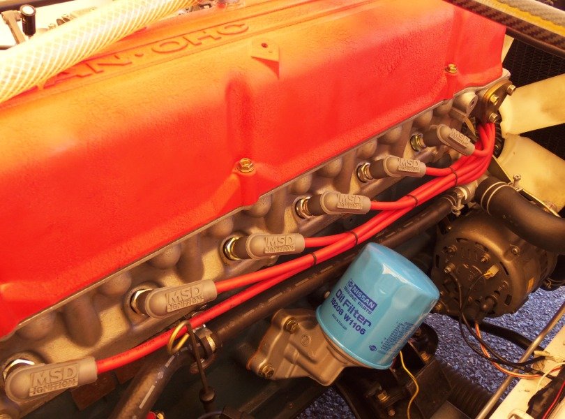

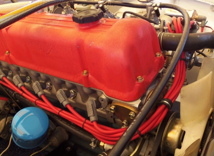

Administrators gav240z Posted November 13, 2013 Administrators Posted November 13, 2013 Hey dude, Loving the Red Rocker cover, was it painted or Powder Coated? RE: Water Pipe looks good, albeit a major hassle it sounds like? Mine appears to just be a long hose. I think the approach of focusing on the engine bay first, then interior, brakes, suspension and so forth is a good way to tackle restoration. In terms of engine bay colour, I'm not usually a huge fan of different engine bay colours to exterior colour. However that shade of grey would look good with the orange exterior (depends on the shade of orange). I also actually like what this guy did on Jay Leno's garage. (GM Spatter Paint) Your engine bay is going to look great, but you're gonna hate me, cause I think it would look even better with the spark plug wires re-routed lol.. I also dig the clear PVC hose for crank case ventilation. (seen at top of pic there). Quote
CroS13 Posted November 13, 2013 Author Posted November 13, 2013 yeah that 510 engine bay looks heaps nice. The rocker cover was just painted, and as for the engine bay wires, i like them over the rocker cover, its growing on me. I do like the clear hose for the breather, and yeah that's next on the list of things to do. Hows things going getting your Rx7 in? Rudolf. Quote

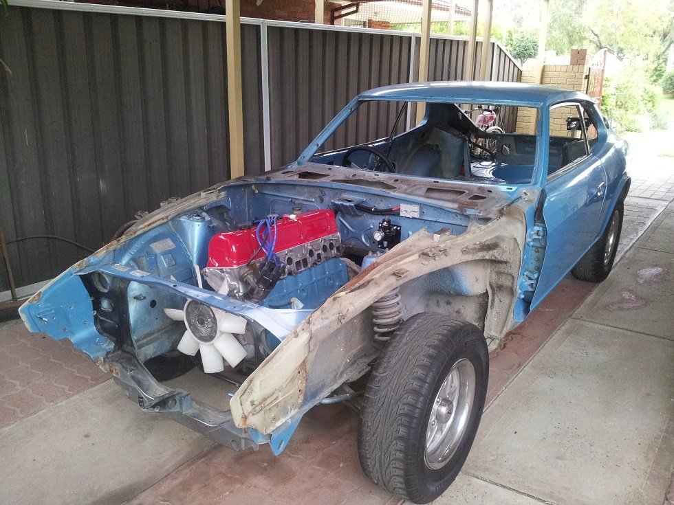

CroS13 Posted February 27, 2014 Author Posted February 27, 2014 UPDATE 27/02/14- Where to draw the line..... So its been maybe 3-4 months since my last update, and all was going well to get the car running on the motorbike carbs, and well then it just went down hill. So i had purchased some KBS Rust seal with the intention of sanding down and painting the scuttle plate/air box, as it had surface rust there. Once i took off the scuttle cover, and had a proper look, i thought to myself, well, might as well take off the front guards to get down the side with the KBS. I had not realized that by the time i had the guards off, the whole front of the car had been removed. Then i was thinking to myself exactly what another member had said to me But then you have to decide where to draw the line...... (guilty) well.... yeah, might as well keep going, and 3 months later, chipping away, now we are here: Now in the back of my mind, with everything i was doing, i still thought that at the end of the day, im doing all this work, and 2-3 years down the track ill be pulling the whole car apart for a full rebuild anyway, and that all my work will be essentially wasted and id be doing things twice. So i said stuff it, she will get torn down now, and ill be doing a full nut and bolt restoration. In the mean time i also got myself a new air compressor, which will more than handle anything i throw at it. I could even paint the car with this bad boy. Next step is to dust off the welder, and brace the supershit engine stand i have, because with the spare motor on it, it leans over quite a bit, so ill reinforce it for some extra piece of mind, and buy a second one, ready for when i pull the motor out of the car. Rudolf. Quote
Riceburner Posted February 27, 2014 Posted February 27, 2014 And so it begins! The old girl looks pretty solid underneath. Quote
Moderators PB260Z Posted February 27, 2014 Moderators Posted February 27, 2014 Hi, Not sure I would say it has gone pear shaped, more just a little carried away Looks like a really tidy example and gotta say I am big fan of that colour. Looking forward to seeing your project progress. Cheers Quote
George Posted February 27, 2014 Posted February 27, 2014 haha. I love it! It all starts with one bolt, and another... All the best Rudolf. Quote
Administrators gav240z Posted February 27, 2014 Administrators Posted February 27, 2014 Oh dear this is how it starts. Just don't get too carried away with the rest if you want it on the road again. It can be a slippery slope. Let me know if you need a hand with anything also? Quote

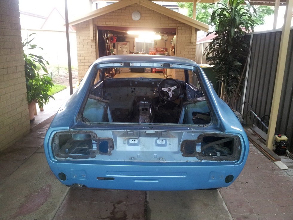

CroS13 Posted April 3, 2014 Author Posted April 3, 2014 Update 3.4.14: Building a rotisserie. I have made some progress, cutting my footings and making mounting brackets for the car. And really only getting the boiler makers to show me how to set up the welder and show me a few techniques. Im doing most of the welding at home, and just cutting up offcuts at work and using those. So far everything has been for free. The footings: The rear mount, not pretty but should do the job: The front taking shape, i wasn't really confident using only the bumper bar supports, so i also went down to the chassis rail: tacked it all up, removed it then ran some weld: Then gave it a lick of paint: I might have to buy the thicker box ill use for the uprights, as we don't have anything long enough at work, but so far so good it hasn't cost me a cent. Rudolf. Quote
Agno Posted April 3, 2014 Posted April 3, 2014 Nice looking welds for a beginner Rudolph! Are you using a MIG? Quote
Administrators gav240z Posted April 3, 2014 Administrators Posted April 3, 2014 Good work, are you planning to take this car back to bare metal? Quote
CroS13 Posted April 3, 2014 Author Posted April 3, 2014 Nice looking welds for a beginner Rudolph! Are you using a MIG? yeah sure am! Using a 250a mig at home, once again borrowed from mate. I have had some time on the gun at work, however that welder is pretty much set up to weld anything, so its just turn it on and go. And the advice i got was pretty straight forward, for a 90 degree joint do "C's" and push dont pull. I must say the biggest thing to improve my welding was using a good quality welding helmet, It helps when you can see what your doing, and not having to worry about flipping down a visor. I also took about 10 "ruler length" worth of offcuts of flat bar and small box steel home. And i use that to try and set up the welder, it took me about 30 minutes today to get the settings down right where i was happy and it felt smooth, then i attacked the project. Good work, are you planning to take this car back to bare metal? Yeah that's the plan Gav, probably sent it to a media blaster first once i get this mini project done. Rudolf. Quote
