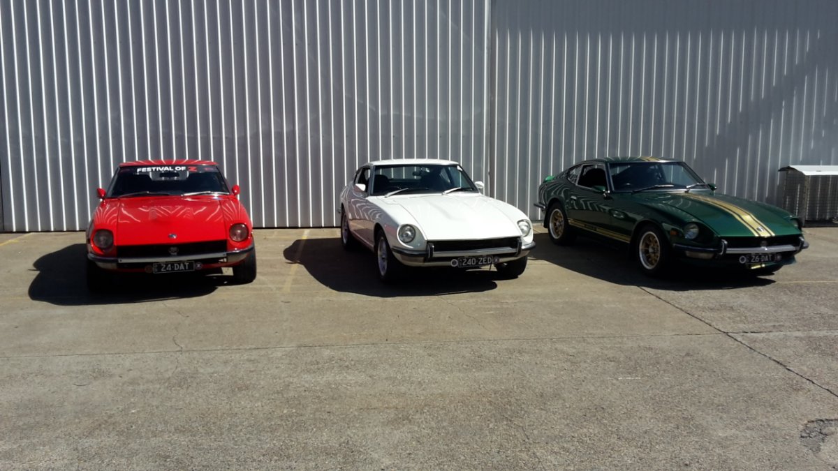

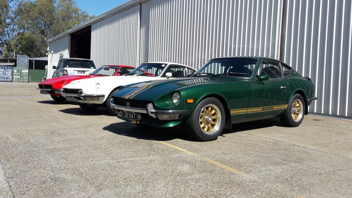

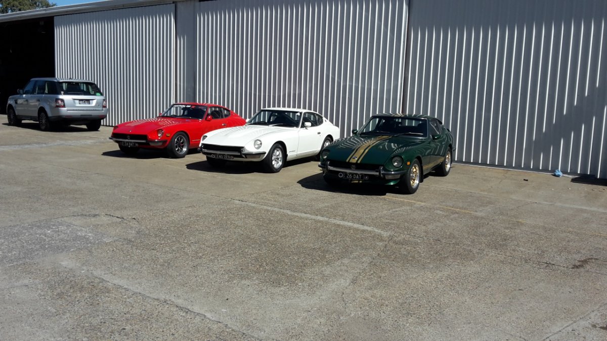

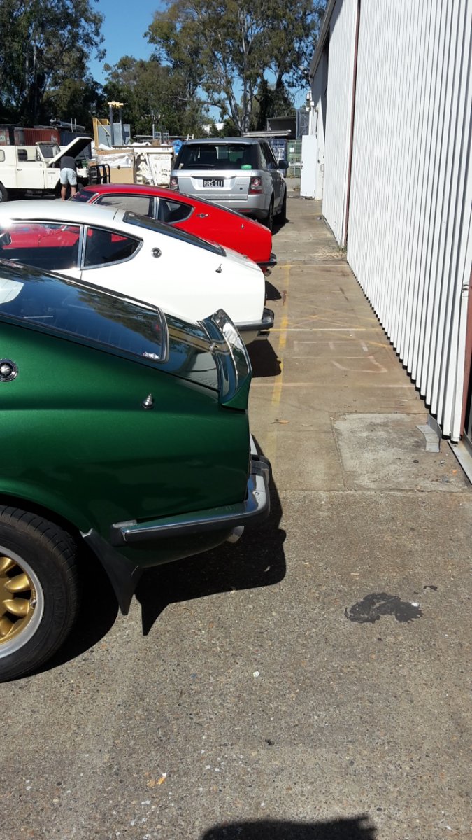

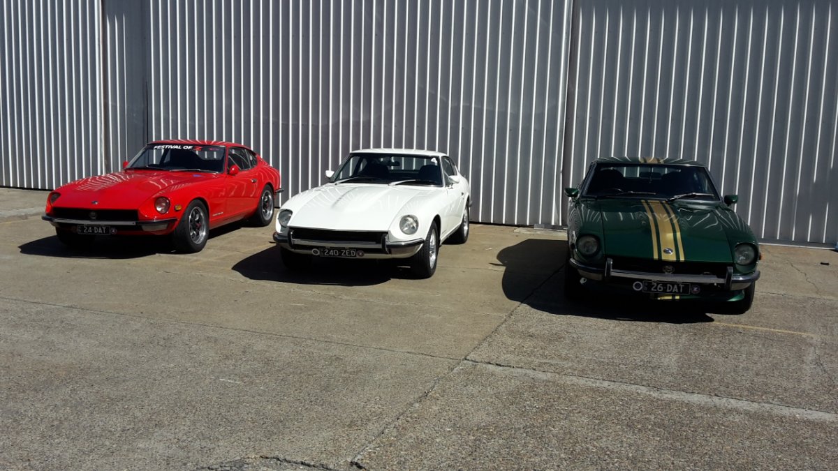

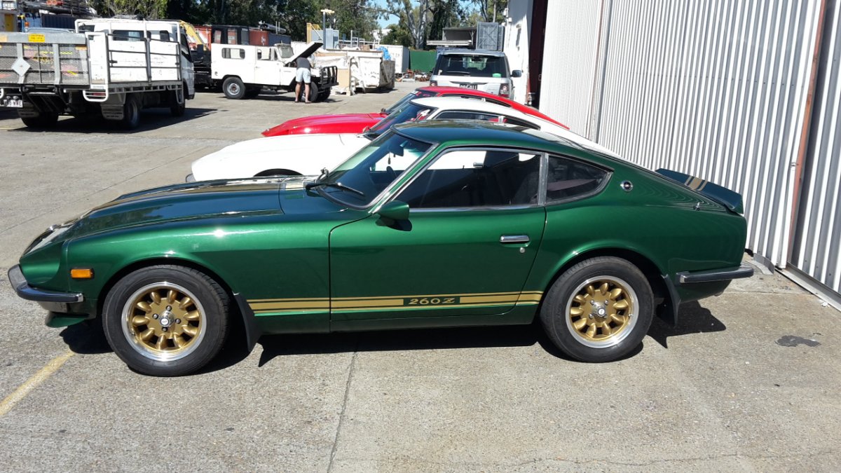

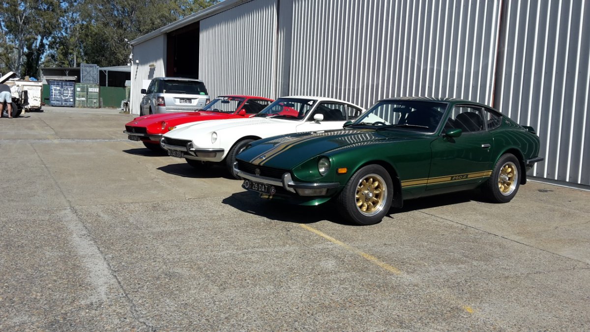

24 Dat Posted May 2, 2020 Posted May 2, 2020 Had a good morning, with our restrictions being slightly lifted in Qld, i got 3 of the girl's out and took them for a quick run for fuel and checking tyres etc, that's about all we can do atm up here. Looking forward to being able to do more in the coming months, we all just need to keep our distance and wash our hands and do all the things they asking us to do and remain patience, i would rather have a couple of extra weeks of restrictions so that we can be sure we are totally onto of this rather than have it all fall over and we have to start again Nice to get them out of storage as they haven't been touched for months, the wonderful sound and Power of a L6 in a Zed and yes i'm still smiling gilltech, Enzo, ScottyD and 3 others 6 Quote
Linton Posted May 2, 2020 Posted May 2, 2020 Hi Dave what colour and code is the Green ? they all look great Quote
24 Dat Posted May 2, 2020 Posted May 2, 2020 (edited) Hi @Linton thanks, When i got my green car repainted back in 09 I had always loved the colour of the Racing KPC-110 GTR Skylines especially the green version see below. I had seen somewhere it was called Nissan Racing Green Metallic. I couldn't find a code for it and i asked my great painter to see what he could come up with, he produced a colour pot sample to as close to the photos i had shown him on the KPC cars , i didn't need to see it sprayed out, i knew on the spot that was the colour i wanted, even though i don't think it is exactly the same as the GTR https://www.google.com.au/url?sa=i&url=https%3A%2F%2Fwww.nissan-global.com%2FEN%2FHERITAGE%2F067_skyline_2000gt-r.html&psig=AOvVaw0LqgjawKQSEkaO1r88h_9v&ust=1588483631576000&source=images&cd=vfe&ved=0CAIQjRxqFwoTCLiA_ea4lOkCFQAAAAAdAAAAABAD Edited May 2, 2020 by 24 Dat Quote

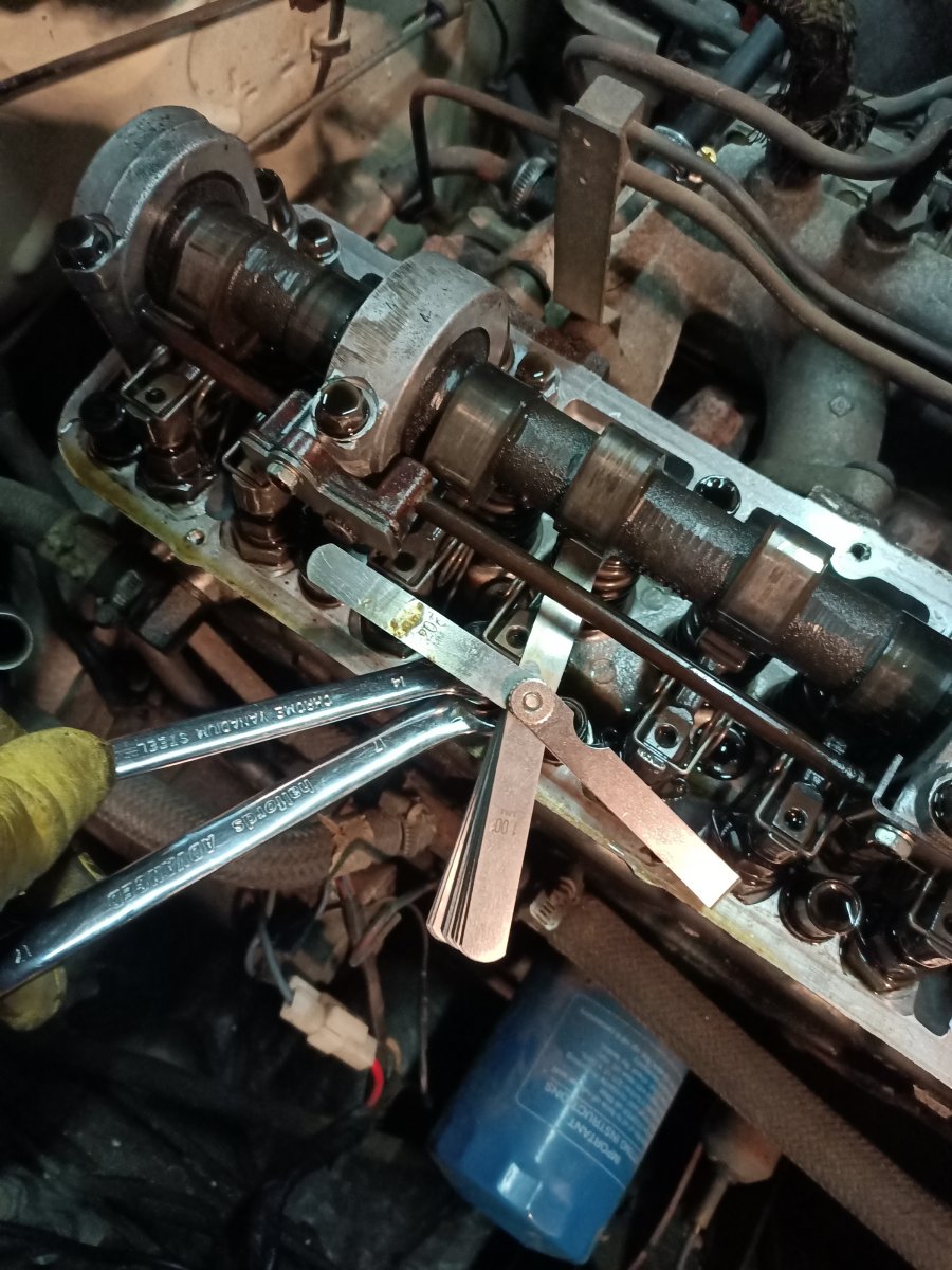

Administrators gav240z Posted July 12, 2020 Administrators Posted July 12, 2020 Since it's lockdown in Victoria. I decided to do a long overdue job. Valve clearance adjustment on the white 71. They were nearly all too tight. Exception of 1 or 2 valves. I did them cold, because doing them hot is tricky because them motor can cool down quickly. I also had a hell of a time getting #4 exhaust but undone. Since it has limited room for adjustment and you don't wanna bust ya knuckles on the sharp edge of the engine head. The benefit though is the engine sounds much nicer and quieter. For those doing it. Intake is 0.20mm clearance. Exhaust 0.25mm. Turning top nut anti clockwise will tighten the gap, turning it clockwise with open the gap. I used cardboard to check off the valves as I did them and turned the motor from the cam sprocket (with plugs out). hmd, AndBir, CBR Jeff and 1 other 4 Quote

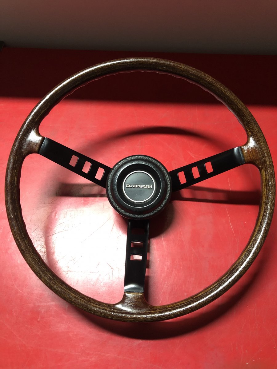

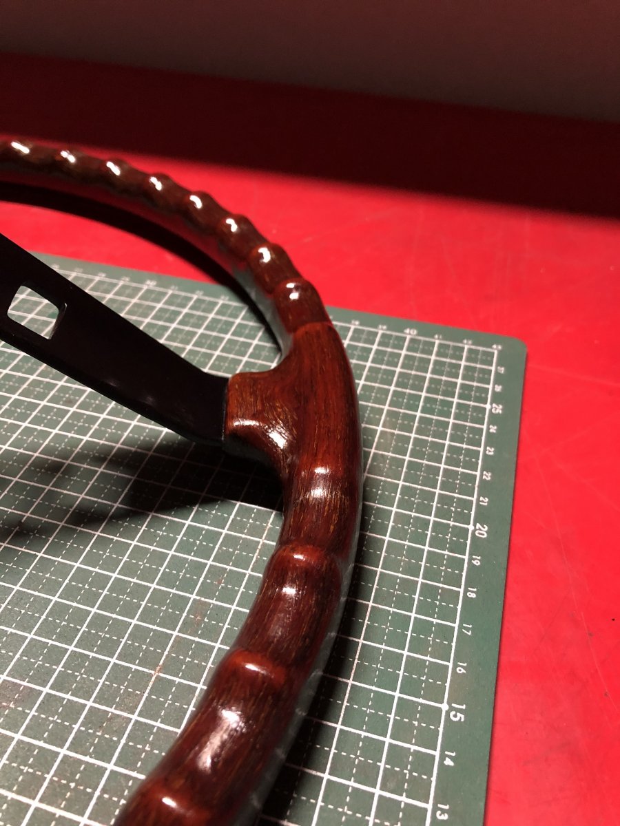

Ponyo240z Posted July 20, 2020 Author Posted July 20, 2020 Restored my brothers wheel over the weekend. This is the 5th or 6th one I have done, each time getting better. I used a stainless steel wool ball to clean up the wood part, not sand paper which could get rid of the texture of the grain in I went overboard. I used floorboard polish to seal, Only 1 coat to keep the texture. I have done with 2 before, however I prefer a little texture. Dragonball240z 1 Quote

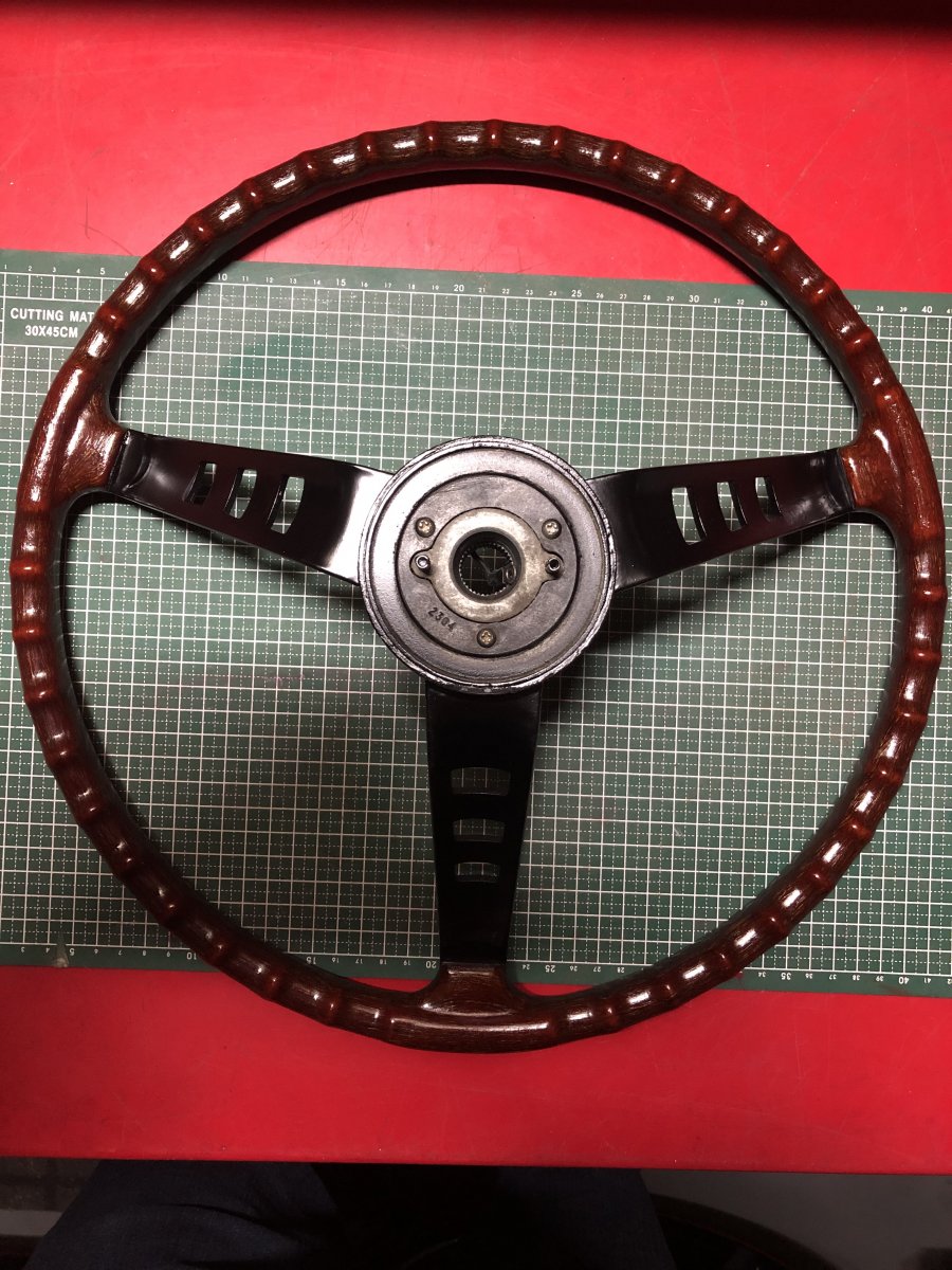

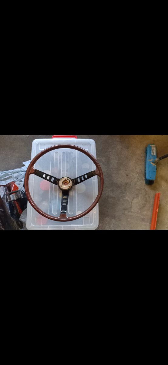

Administrators gav240z Posted July 20, 2020 Administrators Posted July 20, 2020 I'm also working on a wheel. But I may need to redo the rim. C.A.R. 1 Quote

Dragonball240z Posted August 5, 2020 Posted August 5, 2020 Thanks Jonny! Came out On 7/20/2020 at 6:41 PM, Ponyo240z said: Restored my brothers wheel over the weekend. This is the 5th or 6th one I have done, each time getting better. I used a stainless steel wool ball to clean up the wood part, not sand paper which could get rid of the texture of the grain in I went overboard. I used floorboard polish to seal, Only 1 coat to keep the texture. I have done with 2 before, however I prefer a little texture. great! Quote
