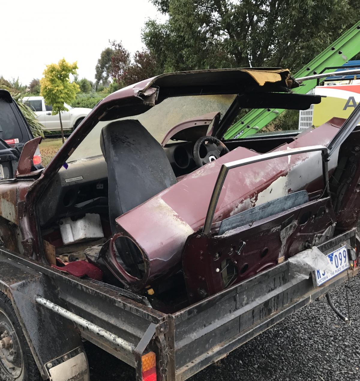

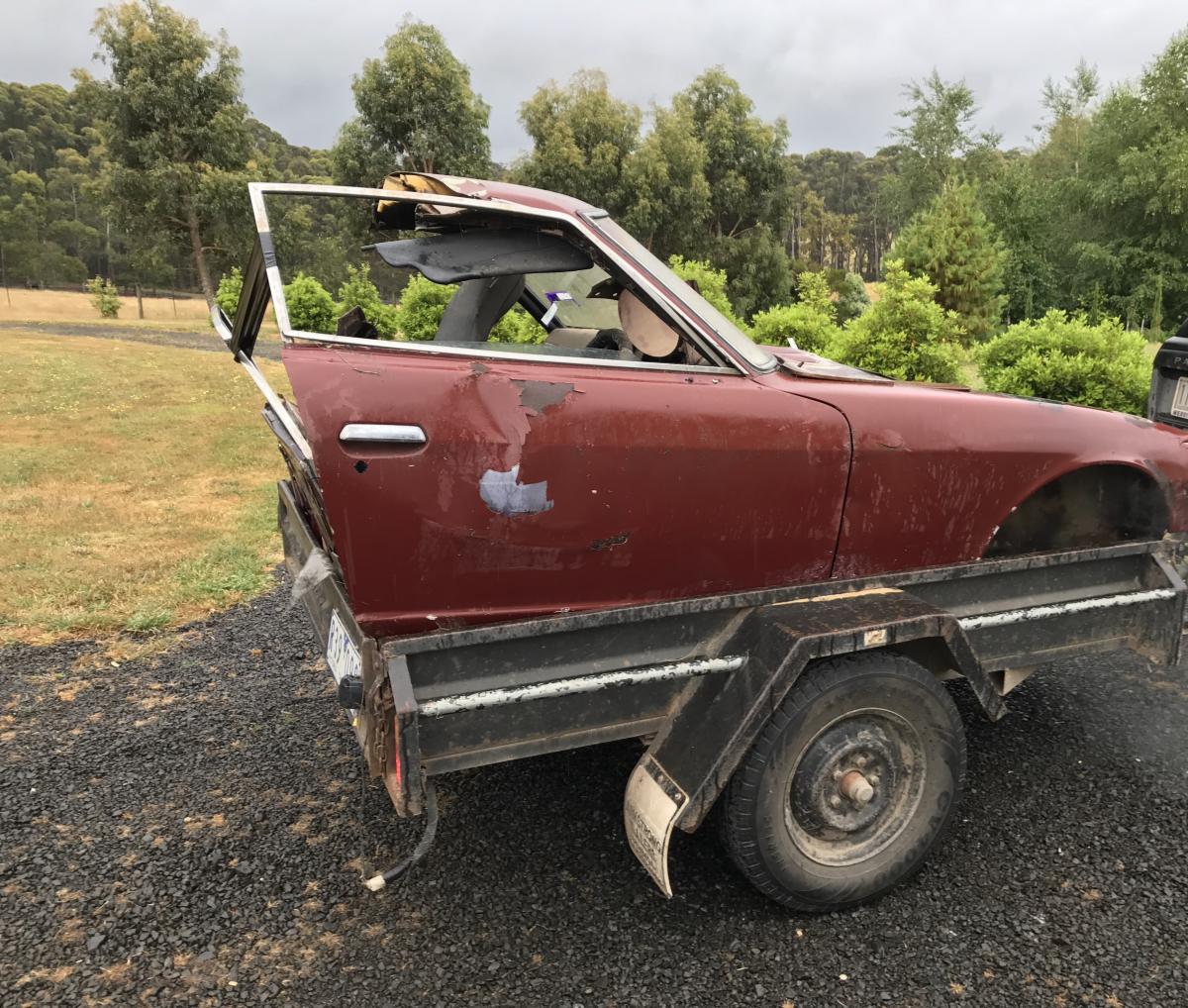

Riceburner Posted January 20, 2018 Posted January 20, 2018 Got rid of the JDM 2+2 parts car, had it for 10years and got more than the $400 It cost. Rotten shell and parts severely UV damaged. Quote
Administrators gav240z Posted January 20, 2018 Administrators Posted January 20, 2018 Oh noes, could have used the windscreen pillar sections.. Quote
Riceburner Posted January 20, 2018 Posted January 20, 2018 I've never seen rot in a Z like this, it had bog everywhere even the A pillars. gav240z 1 Quote

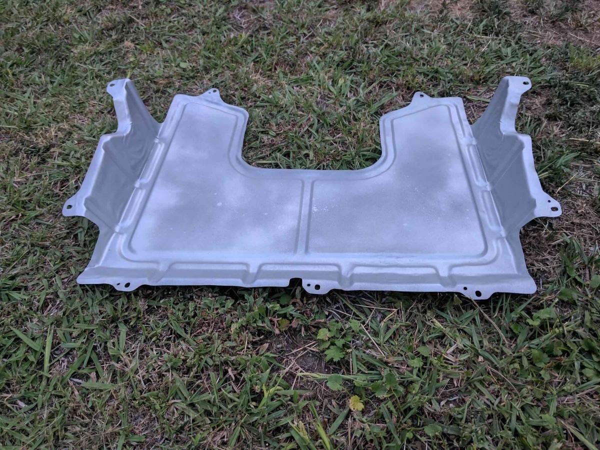

Administrators gav240z Posted February 20, 2018 Administrators Posted February 20, 2018 Not today, but the other day.. I painted my undertray in a grey-ish colour. It's a little bit too reflective (glossy) but I actually think will look fine once fitted and I'm still not 100% sure on the OEM finish anyway. This will go on my 72 240z I think. Ponyo240z and MikeZ 2 Quote
GregTas Posted February 20, 2018 Posted February 20, 2018 (edited) Wow an under tray and in good condition too. Got my new brakes sorted. 324mm skyline rotors machined and fitted into a 16" wheel. I bought some smaller 296mm rotors a few months back and machined them up to fit my 240 hubs, but was not happy with the caliper mounting. The larger disc allows the caliper to be mounted further out and worked out much better. The photo shows the smaller 296mm rotor and the larger 324mm on the strut. Edited February 20, 2018 by GregTas Ponyo240z, MikeZ and KatoKid 3 Quote
Administrators gav240z Posted February 20, 2018 Administrators Posted February 20, 2018 Wow an under tray and in good condition too. It didn't start in good condition (it actually got panel beating and heat shrinking lol). before. Nice brakes, but won't fit under my steelies! Quote

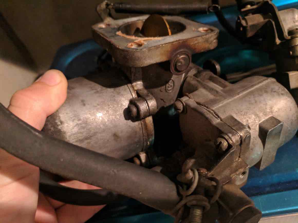

Administrators gav240z Posted February 21, 2018 Administrators Posted February 21, 2018 On the weekend I bought more garage shelving to store stuff. Removed the old work bench as it's in the way and too wide and plan to buy a tool chest from Bunnings with a work bench on top that can store all my tools and roll out of the workshop when needed.For ages I avoided spending money on this stuff but it has got to the stage I spend ages trying to find my tools now.Tonight I'm trying to cook my Hitachi SUs in a ultrasonic cleaner using dish soap. Not sure how it will turn out yet. I'll try truck wash on the weekend if it doesn't work well. Still a bit of an experiment. *Edit have some before and after pics, bearing in mind I didn't disassemble these or remove the oil from the dashpots (forgot about those lol). The magic degreaser! and after they have come out... It hasn't removed the harder baked on stuff, that needs some mechanical action or longer (It was in an hour in total 2x30min sessions) and there is various stains on the metal that don't come out. The gold passivate plating looks loads better (not seen so much in photos). I imagine fully disassembled and using carb cleaner or another better cleaning agent would be far more effective. Vapor blasting is probably superior in many ways, but this is good for cleaning small items at home and getting grease / crud off them. The domes on the SUs have some light scratches etc.. and I'd love to retain the factory fresh look but it is also tempting to polish them. Ponyo240z 1 Quote

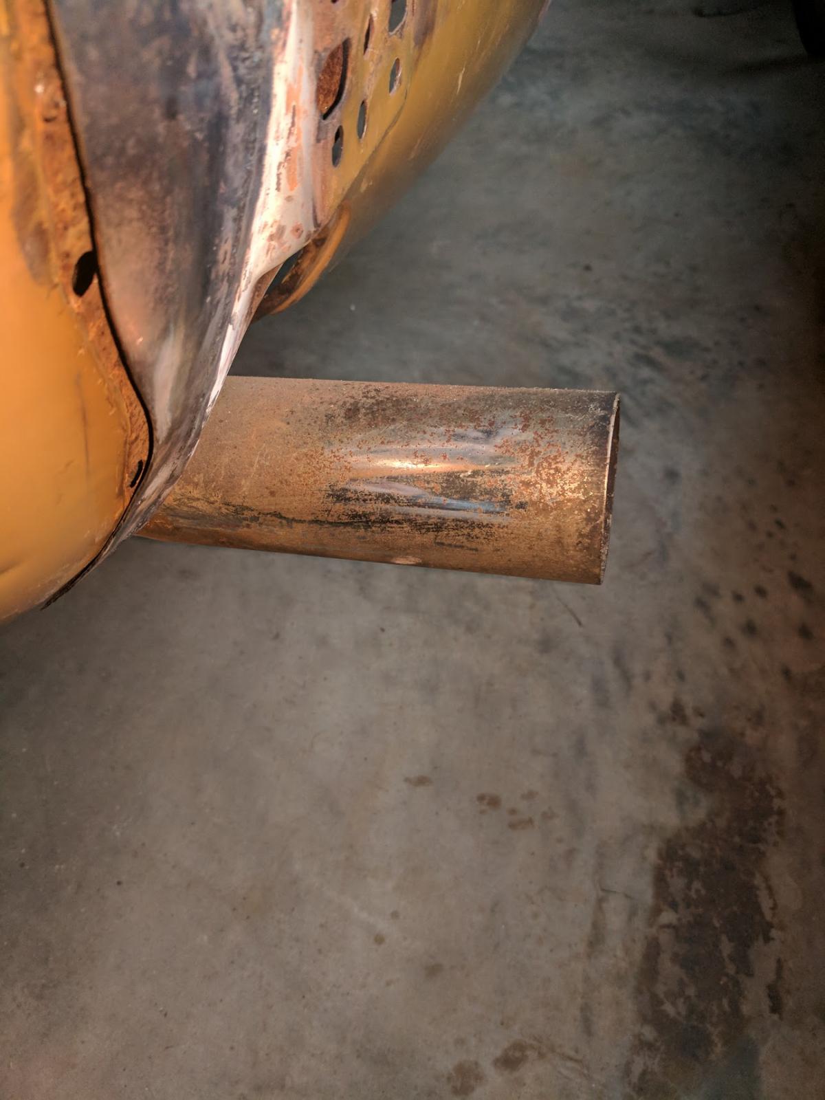

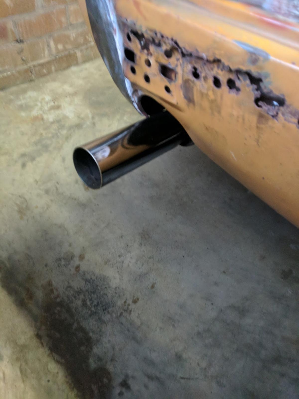

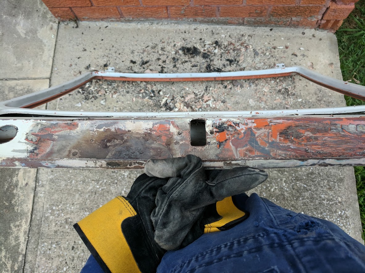

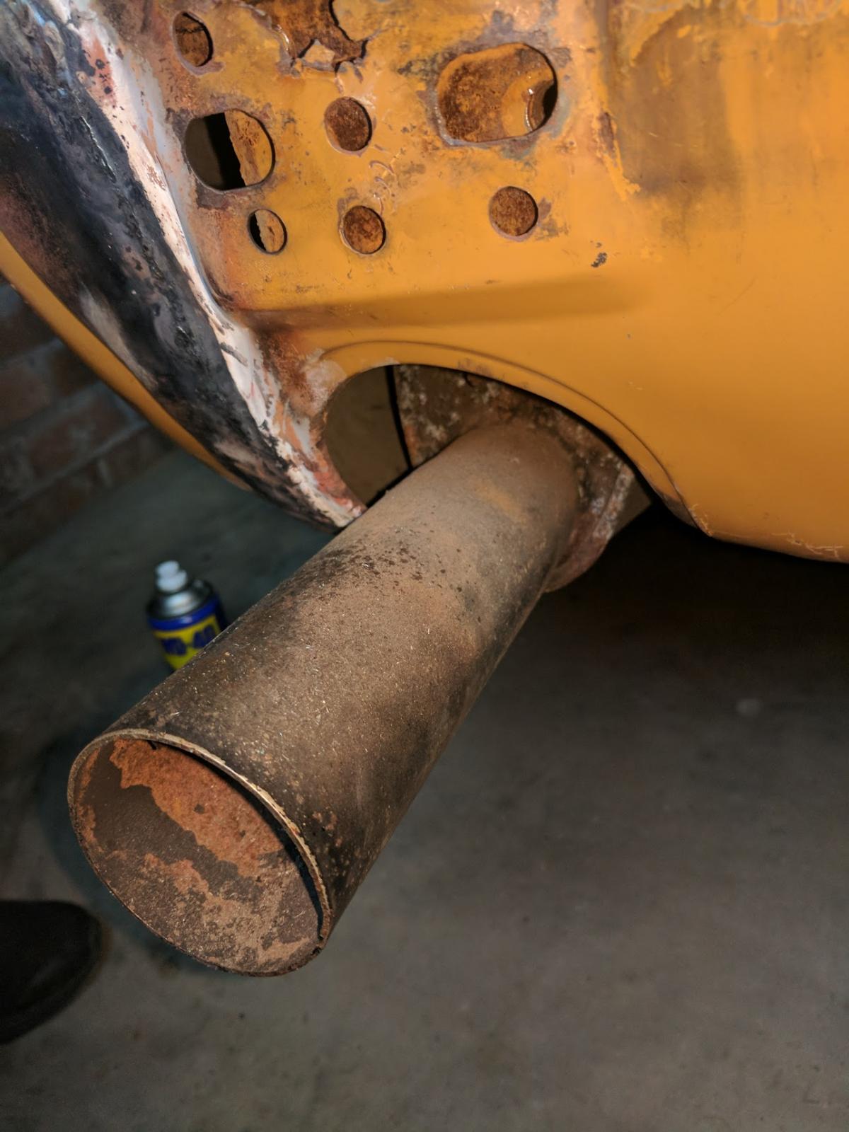

Administrators gav240z Posted February 27, 2018 Administrators Posted February 27, 2018 Check this out... bit of steel wool, WD40 and elbow grease.. (15 mins or so of work) but at least I did something! Before: After: The rest of the exhaust system is actually not in too bad shape, so I might sandblast it and then coat it with VHT (high heat) silver paint. The exhaust headers I might have HPC coated (provided not full of pin holes). Ponyo240z and 240z71 2 Quote

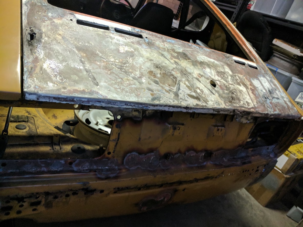

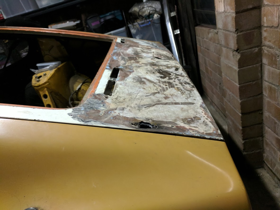

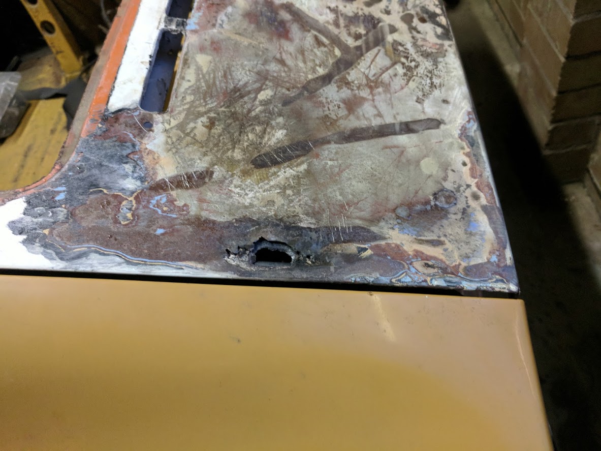

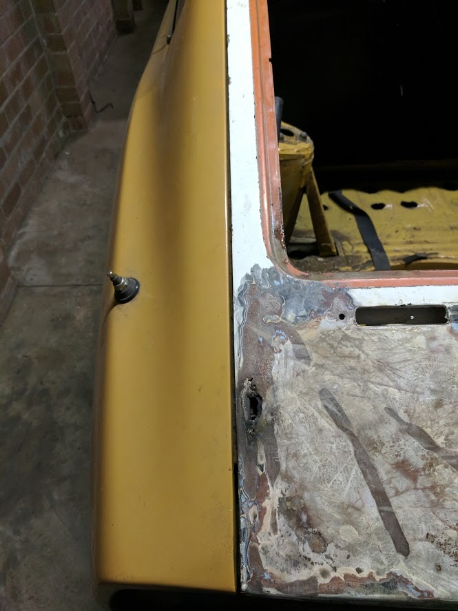

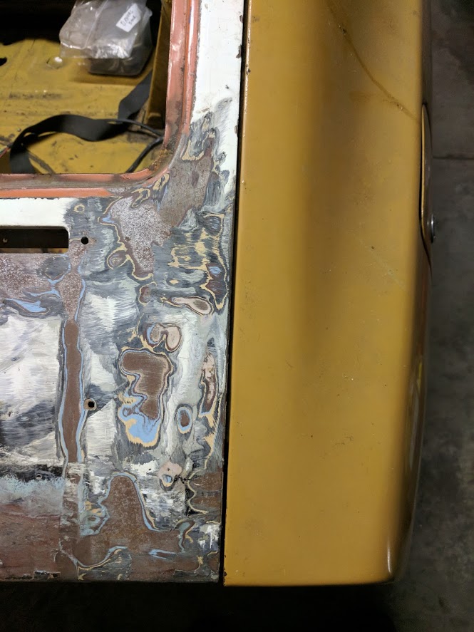

Administrators gav240z Posted March 25, 2018 Administrators Posted March 25, 2018 Decided to try and remove the bog from this hatch I've had a while now.. There is bog on the underside too.. So I used a propane torch and burnt it off (lots of ventilation), but I didn't want to use a flap disk or kick up lots of dust. It wasn't quite so bad underneath...I was expecting more rust, but really just bad dents. The 1 spot of disappointment was near the edge on passenger side. I could see bog in it before stripping it, but it appears that instead of actually try and patch it, they just filled this rust hole with bog on both sides and called it a day! I test fitted on the car to see how the panel gaps are (very good). Panel gaps. This will be a side project I work on in my spare time, I'll undo the spot welds and try and separate the skin and frame, then panel beat and shrink it where applicable, patch the rust and put it back together... I've already put together a hatch, but this is more about improving my skills. Ponyo240z 1 Quote

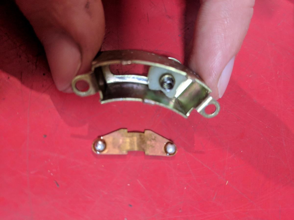

Ponyo240z Posted April 7, 2018 Author Posted April 7, 2018 So, I finally went out to the Feb Yarra valley chrome bumpers meet, almost solely to see KATOKIDS car and it was glorious! Only issue was my left inicator stopped working on the way there. Yesterday, I removed the unit, cleaned and put back on and still couldn't get it to work reliably. I decided to desemble where the contact point at; solder some new points on and slightly stretch the spring. I also regreased certain parts. it worked a treat and now the indicator stalk is changing smoother than it ever had MikeZ and OdinZ 2 Quote

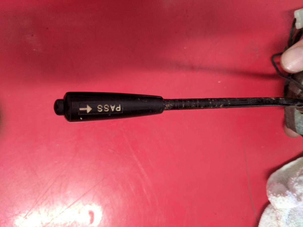

Ponyo240z Posted April 7, 2018 Author Posted April 7, 2018 I also came across this indicator stalk in a box of spares which is slightly different to the early 240 one. It has the additional 'push' button. Is this a 260 part? What does the push button do? Quote
