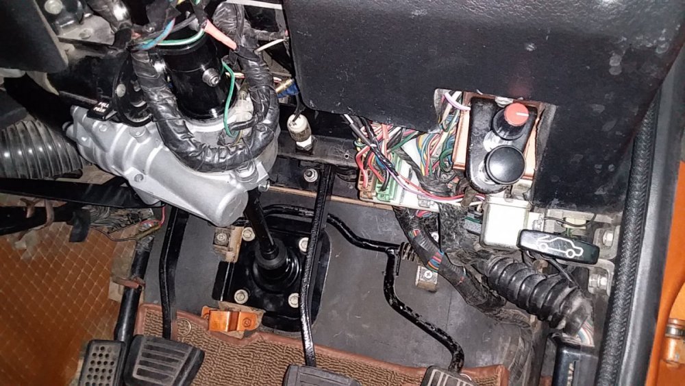

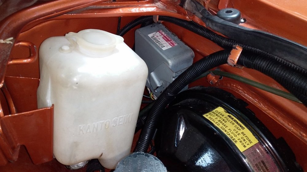

Linton Posted March 8, 2019 Posted March 8, 2019 this week I fitted one of Justins electric power steering kits and must say it is a fine piece of work, well done Justin MikeZ and GongZ 2 Quote

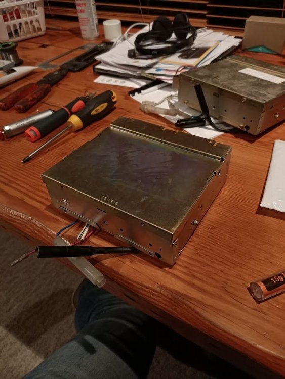

Administrators gav240z Posted April 19, 2020 Administrators Posted April 19, 2020 Should change this thread title to, "What have you done to your Z since Covid-19 Lockdown?" I disassembled an AM radio a while ago that was damaged in transit (seller only put it in a cardboard box and the chassis took a good hard beating on the way over from Europe). Whipped the PCB off a corner. Which I repaired. To remove the chassis from the circuit board you have to de-solder a few points (sadly). Which makes this tricky and time consuming.. Video of it working here. https://photos.app.goo.gl/VonPvkZ95MR1McA46 I still need to find the RF Choke which goes in the fuse holder, order a new fuse holder assembly and OEM plug (http://www.vintageconnections.com/Products/Detail/66) and re-apply the model sticker/decal. Greg Hassen I believe made reproduction labels here. https://www.classiczcars.com/forums/topic/53334-wtb-hitachi-radio/?do=findComment&comment=502985 Condition of radio before. After... If there is interest in creating a step by step guide on how to disassemble these and re-assemble let me know? I have more radios to restore... MikeZ 1 Quote

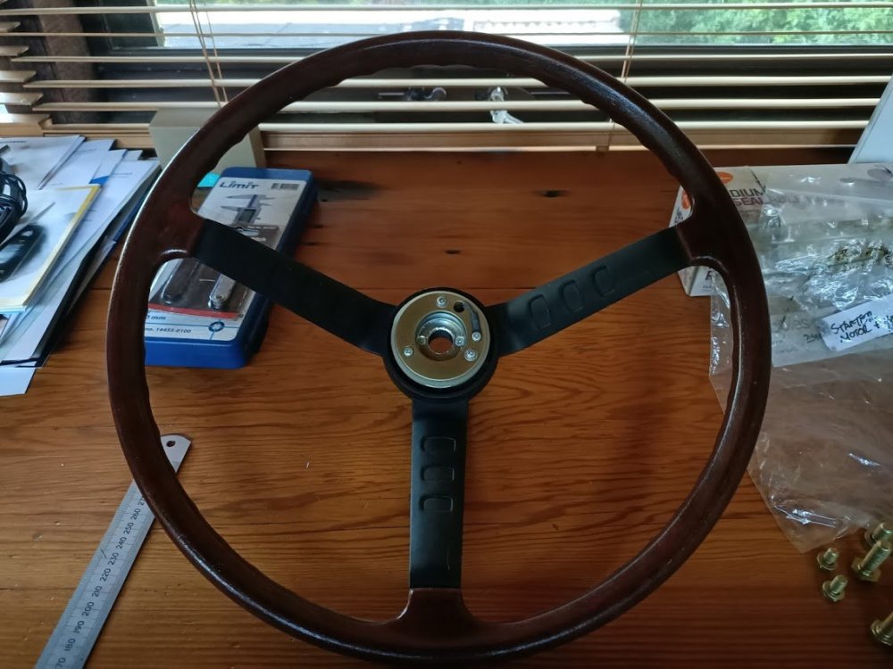

Administrators gav240z Posted April 19, 2020 Administrators Posted April 19, 2020 I had nearly finished this steering wheel a couple of years ago and it's been sitting collecting dust. Until I got the hardware back and installed it and WOW, it just adds a new level to the restoration! Especially considering how poor the wheel looked before. I got this wheel cheap off a friend in San Francisco (think it was $100 USD). And I put about $300 USD worth of effort into restoring it. :). This is for #51 when the time comes. Ponyo240z, MikeZ and GregTas 3 Quote

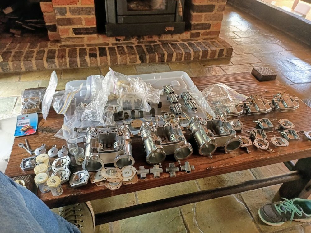

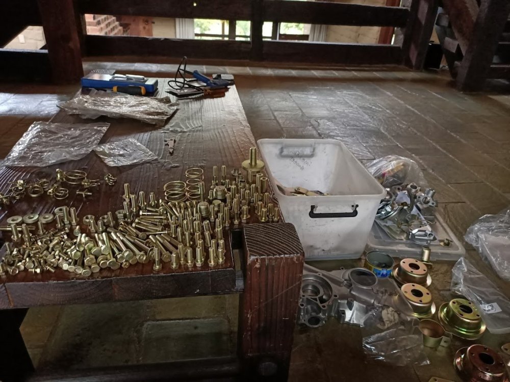

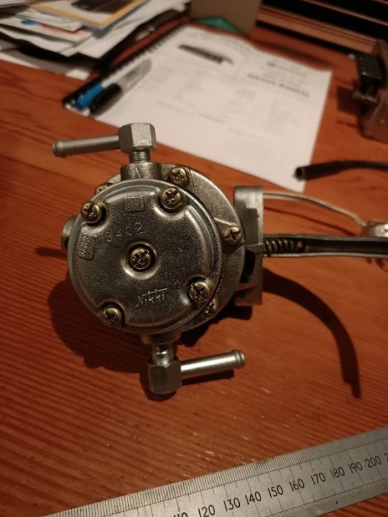

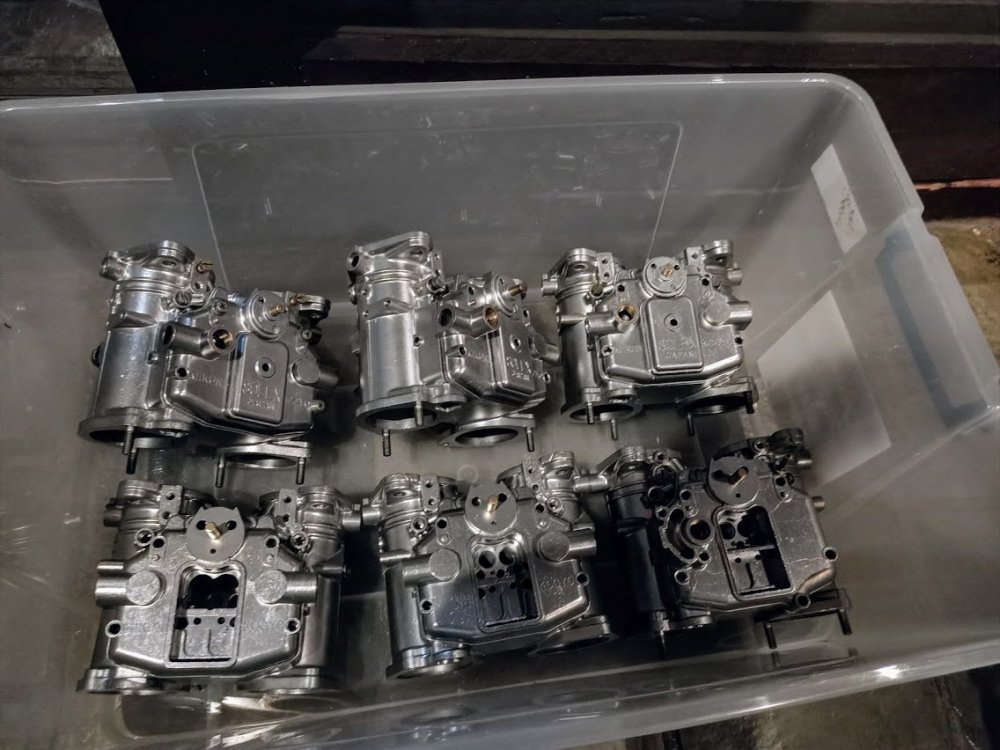

Administrators gav240z Posted April 19, 2020 Administrators Posted April 19, 2020 This has been a multi-day effort, sorting through fasteners etc.. was the first step, which allowed me to finish the radio and the fuel pump and begin the rebuild on the Mikuni/Solex carbs and of course find the hardware for the steering wheel. Sorting through replated bolts is not fun. I can thank Covid-19 for giving me idle time... Nikki Fuel Pump is now rebuilt. Mikuni/Solex carbs and associated parts are much better sorted now. I bought half of them in bits and with spares etc. so half of what I'm doing is sorting through what I do and don't have. Even that is a pain. With half my jets floating around in plastic bags. I have a few gasket kits but it turns out they are for the 5 screw lid, not 4 screw. There is likely a few hundred dollars of parts to order but since I'm not working I'm trying not to spend money on non-essentials at this point. So just doing things that have 0 cost. I'll order gaskets and jets and parts missing once the economy looks better and I've got some work again. I've also been messing with the Antenna for the radio, putting power to the unit I can hear the motor, but the antenna mask doesn't extend, no idea why yet. It seems fused. Like corrosion is stopping it move. JDM-TOY, XIV280, MikeZ and 1 other 4 Quote

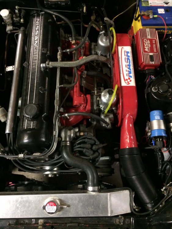

Enzo Posted April 28, 2020 Posted April 28, 2020 Well I finally got the MSD 6AL fitted on the weekend. I also removed and sorted out a sticky choke tube on the front SU carb. Now that I have a Hall Effect dizzy and the MSD ignition I can say the car starts easier and idles much better and sounds crisper. I haven't had it out on the road yet, but soon. Getting a bit crowded under the bonnet now. Ponyo240z, AndBir, gav240z and 1 other 4 Quote

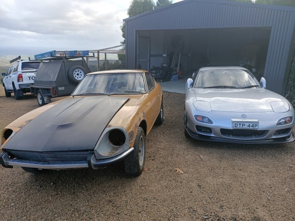

Administrators gav240z Posted April 28, 2020 Administrators Posted April 28, 2020 Not strictly an update for my Z's, but I had to move the Gold car in order to get the RX-7 out of mum's garage to install some electrical points and lights, so I'll have tool power in there in future. Sadly the RX-7 failed to start. She blew a coolant seal a few months ago and I last started it late last year and now it just won't quite start. It runs for a second or 2 on 1 rotor then stalls. So I really have to remove the motor sooner rather than later to prevent internal damage from water inside it. Problem is that the twin turbo's are also shagged and so going single turbo makes 100% sense... but will also cost a small fortune..I really miss driving it now. Especially with the COVID-19 restrictions in place. I'd have a lot of fun driving it on some nearby country roads.. OdinZ 1 Quote

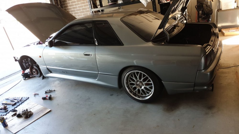

Dionysus Posted April 28, 2020 Posted April 28, 2020 I'll add to the 90s goodness.. Raised up my r32 suspension because I'm getting too old to deal with a super low car.. Raised it an inch and its still low. Now I have to consider whether I want to do it all over again.. Apart from that did a heap of maintenance to get it ready for a haltech ecu install. OdinZ and gav240z 2 Quote
