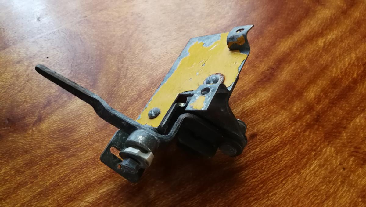

GongZ Posted April 7, 2018 Posted April 7, 2018 It's a headlight flasher switch, aka as a passing switch. More info here; http://www.viczcar.com/forum/topic/11855-high-beam-flasher-operation-help/ OdinZ and Ponyo240z 2 Quote

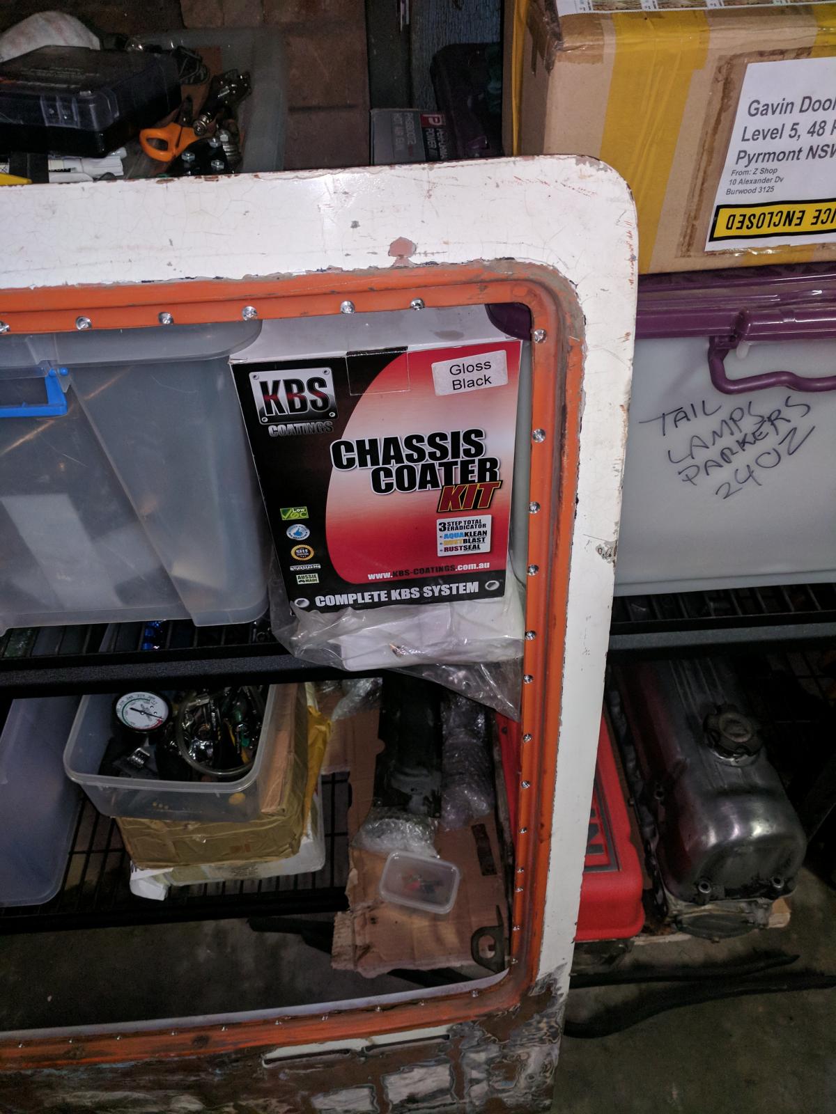

Administrators gav240z Posted April 9, 2018 Administrators Posted April 9, 2018 Drilling out spot welds is such a chore.. was messing with my early hatch over the weekend. Preparing to separate frame and skin. Ponyo240z and OdinZ 2 Quote

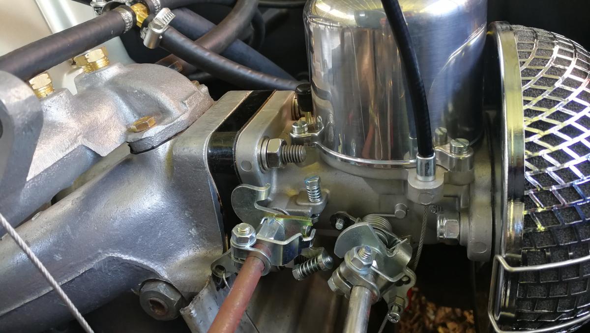

RAP260 Posted May 5, 2018 Posted May 5, 2018 Finally got my choke working again... Yea. The bracket setup works a treat. Because I'm running HS6's, I took a different approach. Used braided line, instead of solid core, as the HS6's have a return spring. Plus I only need one line, as I have fitted a linkage between the two carbs. Having the choke not hold its position isn't an issue, as I never drive my car on choke. Ponyo240z and PB260Z 2 Quote

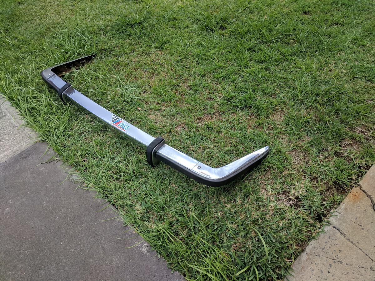

Administrators gav240z Posted May 13, 2018 Administrators Posted May 13, 2018 Finally attached new rubbers to my rear bumper off #150 but going on #10552 for now. I got these strips from Lindsay at Zshop who was kind enough to donate them after I helped him source some early Ashtrays. They are 2+2 in length so need about 2 inches chopped off. You will need to figure out a way to attach the threaded metal bracket for the hole at the end where the overrides are. I tried windscreen sealant (since it hardens like rubber) but not sure if it's longevity. Also they didn't come with the nuts but I found some suitable ones at Bunnings M5 nuts. I tried to cut the rubber to accommodate the metal brackets using a Stanley knife / razor but it wasn't that effective. Much better to use a Dremel tool with cut off wheel and that burnt through it fast and smoked like burning tyres. ? Lindsay sells these relatively cheap around $40-$50 which is quite good and apart from missing the part no cast on the rear of them I can't tell the difference between these and OEM. RAP260, CBR Jeff, OdinZ and 1 other 4 Quote

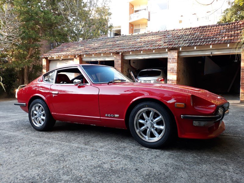

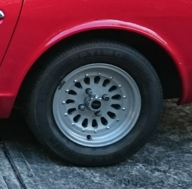

Kuba Posted July 1, 2018 Posted July 1, 2018 Finally got to change my wheels and tyres, soo much better than the old tyres! Now I have wheels to sell, I wouldn't think they are worth much but maybe the old spare is? RAP260 1 Quote
Moderators PB260Z Posted July 1, 2018 Moderators Posted July 1, 2018 Hi Kuba The Z looks fantastic with those wheels, great improvement. Cheers PB Quote
Administrators gav240z Posted July 1, 2018 Administrators Posted July 1, 2018 Wheels would look even better in black! OdinZ 1 Quote
