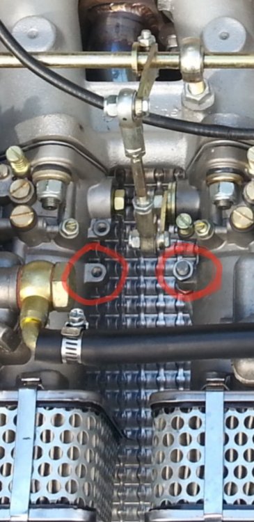

I'm interested in how Peter solved this problem also. But I'll share my solution. The heat shielding looks very similar to what I used when I had triples . ACL Heat Shield. http://www.autoxcel.com.au/product_info.php?products_id=140 I made use of the existing holes in the webers to basically suspend mine below the carbs. I used threaded rod, worked a treat. Refer to the attached picture. Had it fixed at 3 points. Hope this is of some help.

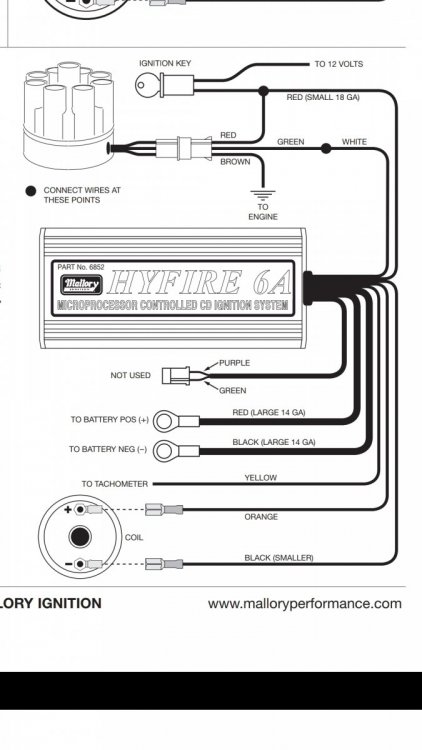

Howdy All, So, rather than making anymore assumptions, I'll just ask. Googling myself in circles. Hardware : 1977 260z / Unilite Distributor / Mallory e-series coil Details : Haven't had a functioning tacho for a few years, due to having a 6al controller. 6al died, so I've returned to the standard coil / distributor wiring setup. So far, only connected black/white tacho wire to the coil positive. And as the title suggests, it's only working when its being supplied 12v. With the car running I can get it to work, by simply turning the key ( without engaging the starter). Looking for input. Is this a signalling or a tacho power supply issue?. Or am I supposed to something with the handful of other wires dangling under my bonnet... Lol Cheers, Rob

Problem solved. One dead 6al. Rewired the coil / distributor , fired straight up. Time to go buy a ballast resistor and bin the 6al. -

Tried the white wire test procedure, per msd instructions. Definitely not working. So it's either the coil or the controller, just don't won't to start replacing parts ad-hoc. Don't have a spare coil unfortunately and I really wanted to avoid rewiring the ignition system, just to check the coil. Any one got any other suggestions for testing a coil, other than resistance? -
Afternoon all The distributor ( unilite ) is getting 12v. And I've tested the resistance on the coil, which seems to be within the recommended ranges. Was warming the car up to go for a run, and it just stopped, very suddenly. Fuel pressure is good. Checked all the fuses. Cheers, Rob
