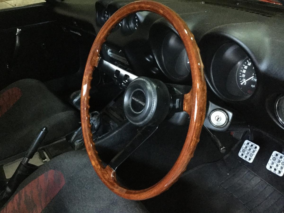

ScottyD Posted April 8, 2017 Posted April 8, 2017 (edited) So happy with how the steering wheel turned out. Makes a great car better. Now waiting for the thread reducer to turn up for the new gear knob. Edited April 8, 2017 by ScottyD CBR Jeff, gav240z and Ponyo240z 3 Quote
Administrators gav240z Posted April 8, 2017 Administrators Posted April 8, 2017 Started re upholstering the original seats a few weeks back. Planning to finish 1 this weekend What are you going to do about the foam part? Going to replace or patch up? So happy with how the steering wheel turned out. Makes a great car better. Now waiting for the thread reducer to turn up for the new gear knob. Yeah I miss the wood wheel a bit in my car after installing the Datsun compe wheel. It offers a nice contrast to the interior. Quote

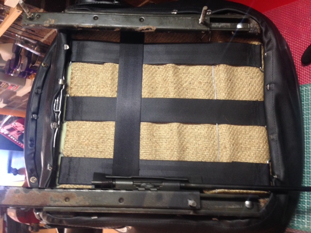

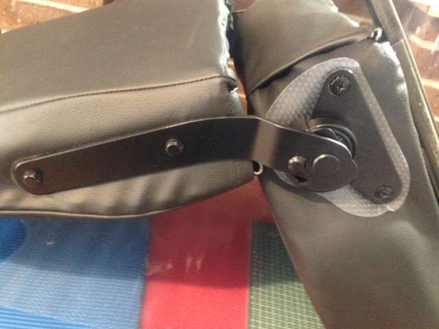

Ponyo240z Posted April 8, 2017 Author Posted April 8, 2017 Drivers seat finished today. I lined the back with a yoga mat to give some extra cushion. Took out for a drive a very comfortable. I left a tad of slack in some areas to let it settle with weight, I'll see how it'll settle ScottyD and krizza 2 Quote

Administrators gav240z Posted April 8, 2017 Administrators Posted April 8, 2017 Looks great, where did you get the vinyl material from? Rob at Z-Factory? Oh and those support straps under the seats look like seat belt material? Quote
Ponyo240z Posted April 8, 2017 Author Posted April 8, 2017 (edited) Looks great, where did you get the vinyl material from? Rob at Z-Factory? Oh and those support straps under the seats look like seat belt material? Seat vinyls came from Warren at a great price, quality is very good also.Support straps are made from a role of seat belts. My mother in law used to work at a seat belt factory before it closed down 10+ years ago, I knew a few role would come in handy. My dad stitched them with nylon thread for strength. Edited April 8, 2017 by Ponyo240z Quote

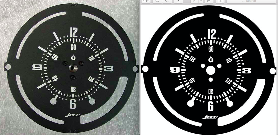

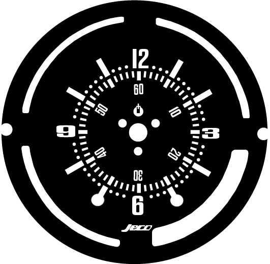

Administrators gav240z Posted April 25, 2017 Administrators Posted April 25, 2017 Long term project here, but trying to reproduce the Rally Clock face. Once I get this right I'll move onto some other gauges I've been wanting to do (mostly ones only found in works rally cars). I can't for the life of me determine the typeface used by Nissan in the 70s for early S30Z gauges. Ticketbook Poster Sans Steelfish Album Cover JNL Ristretto Pro As a side note I believe Nissan used "microgramma" in the 80s and appears to be used for "SEIKO". Ponyo240z 1 Quote
Administrators gav240z Posted April 26, 2017 Administrators Posted April 26, 2017 More progress on Rally Clock face, but had to use a substitute typeface. Someone suggested Churchward 69. Churchward 69 is a ten weight typeface family originally designed during the late 1960’s by the late type designer Joseph Churchward. It's very close in terms of design aesthetic, but only problem is like any good typeface has a cost associated with it. If for any reason someone has a copy of this typeface please let me know? I may have to fork out for it, but not 100% sure it's "exactly" spot on yet.. On it's own. Comparison with original. Quote

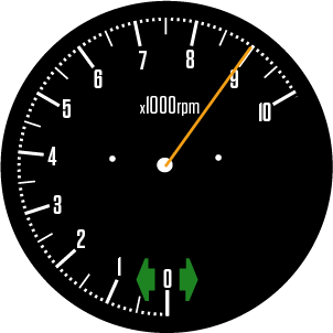

Administrators gav240z Posted April 26, 2017 Administrators Posted April 26, 2017 Works Tach..very rare... Just a start... going to take some work to get this 1 right.. The Works team rally cars had some cool and unique gauges I've never seen on other S30Z's. *Edit update, a bit closer now. When the type face is correct I think it will look far nicer! I should probably start a new thread for gauge design? Or add to this thread? http://www.viczcar.com/forum/topic/6719-factory-10000rpm-tachometer/ CBR Jeff and Ponyo240z 2 Quote

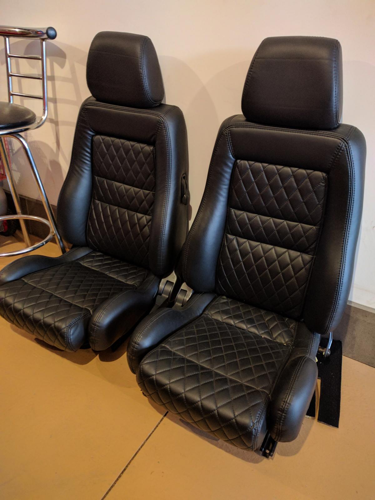

Ponyo240z Posted September 25, 2017 Author Posted September 25, 2017 (edited) The first 2 images are the seats that were in the car and I will be going up for sale Edited September 25, 2017 by Ponyo240z OdinZ and gav240z 2 Quote

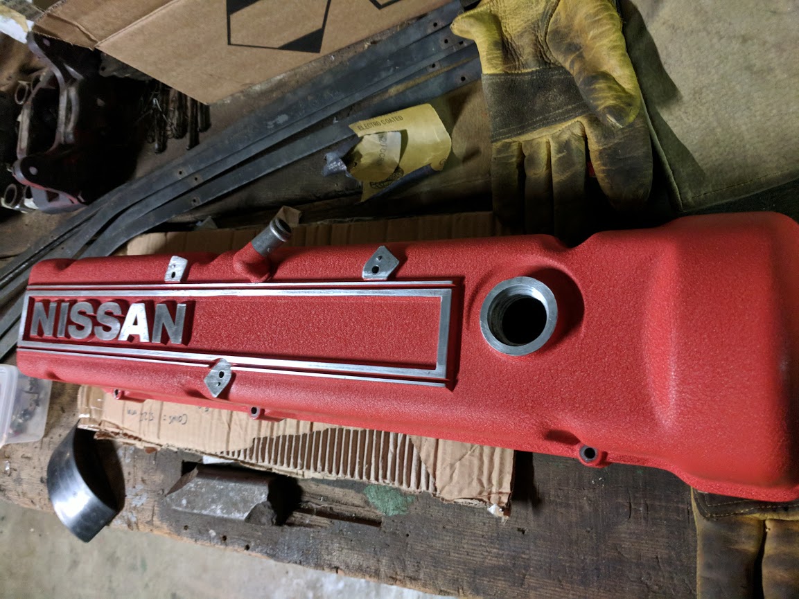

Administrators gav240z Posted September 25, 2017 Administrators Posted September 25, 2017 I continued on with my valve cover repaint. Sanding down the letters and the outline around it. It's turned out better than I expected to be honest. The photos make it look more "pink" than it is in reality, but it certainly makes a statement. Ponyo240z 1 Quote

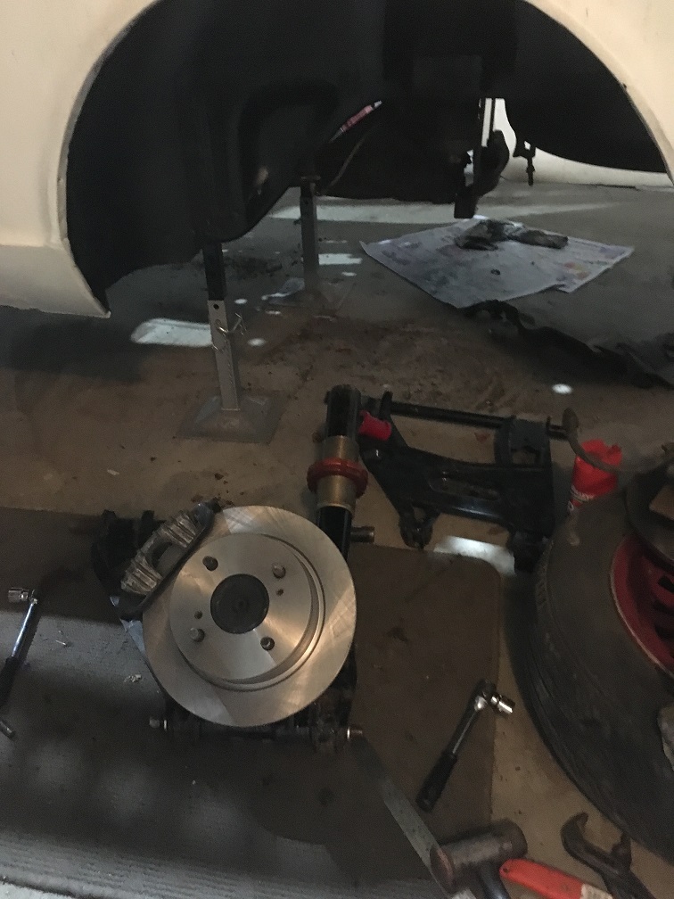

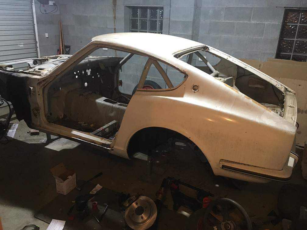

GregTas Posted September 25, 2017 Posted September 25, 2017 (edited) Done well with that. Wrinkle finish sometimes comes out well and other times not so. Got the inner guards painted on 741 ready to start putting suspension and brakes back in. Replacing bushes with nolathane. I've still got to get the outer rubber bushes out of the lower arms. I made a little press, but that didn't work. I might have to drill out rubber and cut from the inside. I think it may be a painful job A few little jobs left on the car. Edited September 25, 2017 by GregTas Ponyo240z and gav240z 2 Quote

Ponyo240z Posted September 26, 2017 Author Posted September 26, 2017 That came up a treat, I like the red I continued on with my valve cover repaint. Sanding down the letters and the outline around it. IMG_20170925_210821.jpg IMG_20170925_210905.jpg IMG_20170925_210910.jpg It's turned out better than I expected to be honest. The photos make it look more "pink" than it is in reality, but it certainly makes a statement. Quote
gilltech Posted September 26, 2017 Posted September 26, 2017 I might have to drill out rubber and cut from the inside. That's the way I did it. I also tried a press but no joy. So my back-yard method was to destroy the integrity of the rubber first by heating the inner bush up with a gas torch (sparingly!), then when enough rubber was dug out to expose the outer bush I very carefully cut it not quite through with a hacksaw and was able then to collapse it inwards to extract it, managing to not damage the arm. But it took me a fair while to do all four. Quote
