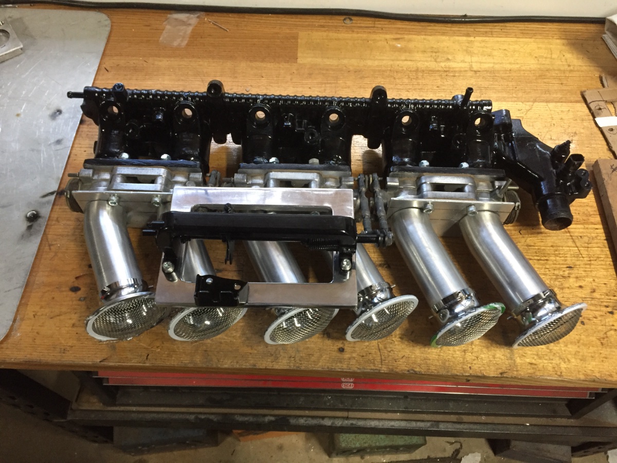

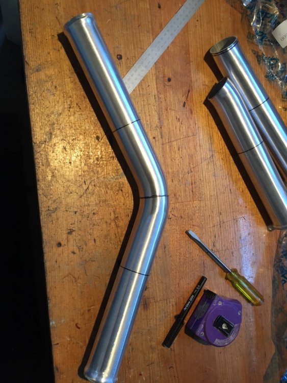

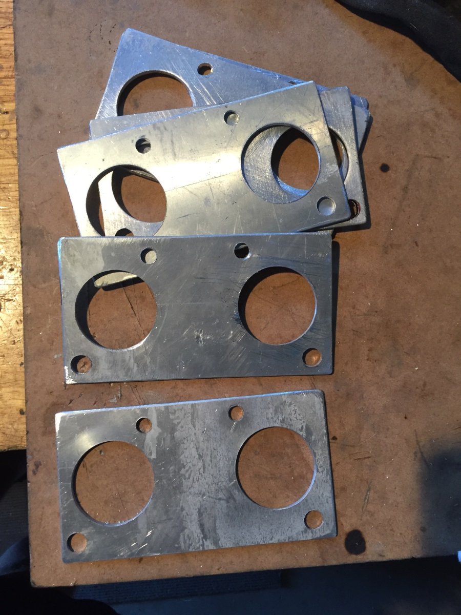

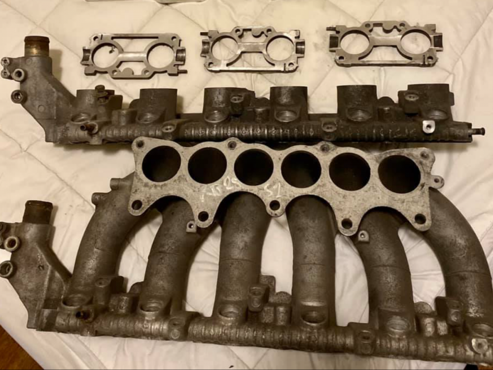

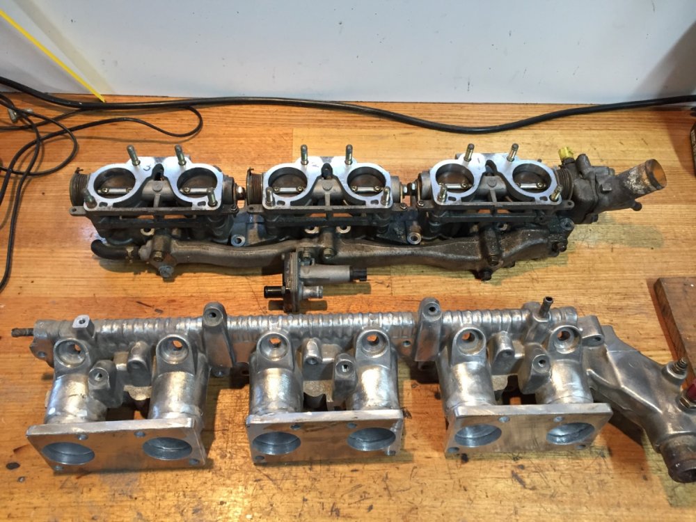

ScottyD Posted June 1, 2021 Posted June 1, 2021 (edited) I’ve been working on some itbs for the RB for the last month or 2, using a cut down RB25 inlet manifold. Tig welded on some extensions to match the RB26 throttle bodies then welded a 10mm plate on to bolt the tbs to. Made up the linkage support from 10mm plate. Then cut out some thinner plates, cut some bent alloy tubes and purchased the trumpet tips. My welding isn’t neat enough to finish the trumpets so I’ll have to pay a pro. Should be on and retuned in a few weeks. Edited June 1, 2021 by ScottyD Ponyo240z, Millerman, hmd and 2 others 5 Quote

Administrators gav240z Posted June 2, 2021 Administrators Posted June 2, 2021 @ScottyD- where did you source the mesh filter covers for the trumpets? I've got some here (I got with a job lot of Mikuni stuff I bought) but they don't fit over my Trumpets I'm afraid. Quote
ScottyD Posted June 2, 2021 Posted June 2, 2021 1 hour ago, gav240z said: @ScottyD- where did you source the mesh filter covers for the trumpets? I've got some here (I got with a job lot of Mikuni stuff I bought) but they don't fit over my Trumpets I'm afraid. eBay gav240z 1 Quote
ScottyD Posted August 26, 2021 Posted August 26, 2021 Finished the ITBs IMG_2526.MOV Ponyo240z 1 Quote
ScottyD Posted August 26, 2021 Posted August 26, 2021 Finished the ITBs IMG_2526.MOV JDM-TOY, gilltech, CBR Jeff and 7 others 10 Quote
zedls1 Posted October 11, 2021 Posted October 11, 2021 (edited) On 8/27/2021 at 7:00 AM, ScottyD said: Finished the ITBs IMG_2526.MOV 22.33 MB · 0 downloads Great job, looks great ScottyD, great to see the engine bay still looking clean. How she been running? Regards John Edited October 11, 2021 by zedls1 Quote
zedls1 Posted October 11, 2021 Posted October 11, 2021 Just now, zedls1 said: Great job, looks great ScottyD, great to see the engine bay still looking clean. How she been running? Regards John Quote
ScottyD Posted October 15, 2021 Posted October 15, 2021 On 10/11/2021 at 7:51 PM, zedls1 said: Great job, looks great ScottyD, great to see the engine bay still looking clean. How she been running? Regards John Thanks John, It’s going Very well mate. zedls1 1 Quote
