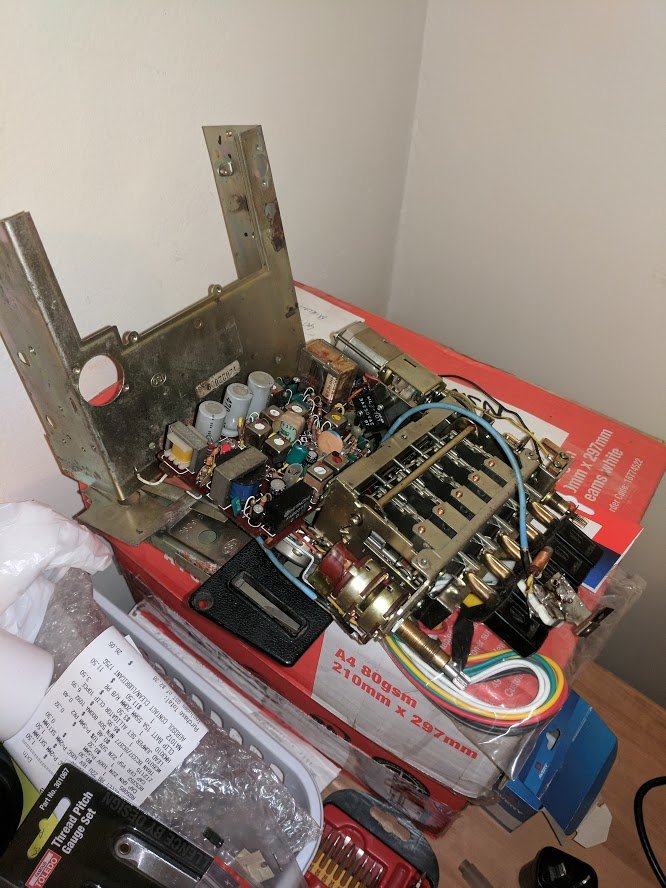

Administrators gav240z Posted September 20, 2018 Administrators Posted September 20, 2018 I'm in the middle of a TM-1081ZB(S) Radio restoration. This particular radio was packaged badly and upon arrival had been bashed in (on 1 corner). Part of the circuit board had been snapped. More photos here. https://photos.app.goo.gl/AvuUP6gMXZW9qMKL7 Radio seems to work fine, despite it's rough transit. I am going to re-plate the housings, might repaint the black parts and the signal seek needle (orange) and I'll try and glue down the missing bit of the circuit board and rejoin the break with solder or similar (bridge it). I'm hammering and dolly the chassis back into shape as best as I can (straighten it out). Might try repair the chipped corner on the faceplate (see how well it holds up). Last part will be the pig tail wiring harness / fuse holder etc.. I decided to try restore this 1 since it was already damaged and if I ruined it, I wouldn't have to hate myself. Quote

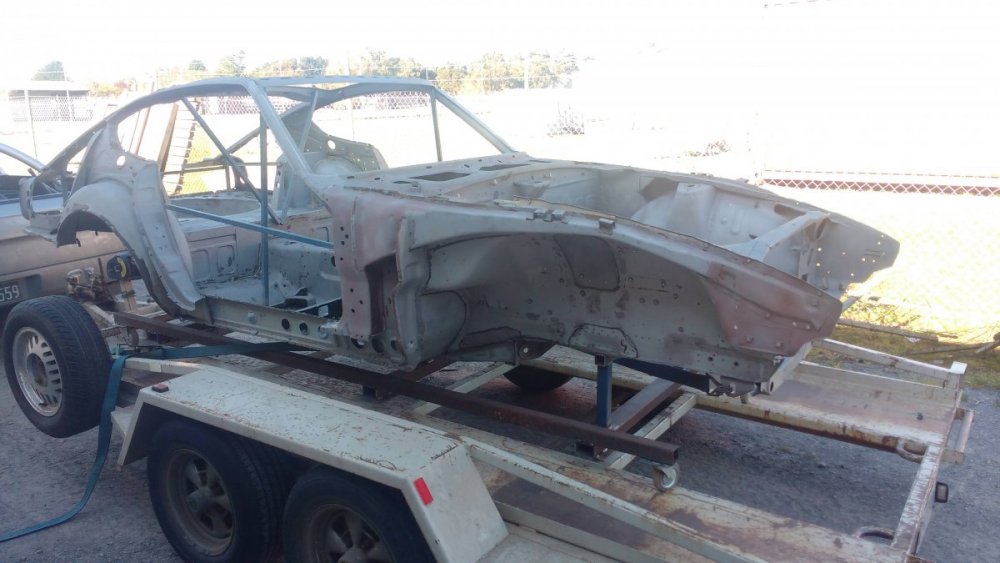

C.A.R. Posted October 8, 2018 Posted October 8, 2018 (edited) I picked Adam's (Hokin's) Z up from the media blaster, so now we can get stuck back into the rust repairs! Edited October 8, 2018 by Léon Hokin, MikeZ, Rickers and 2 others 5 Quote

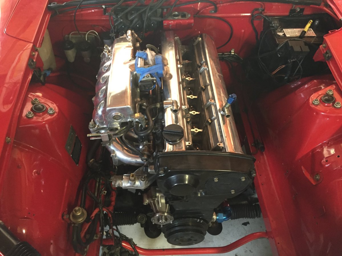

ScottyD Posted October 14, 2018 Posted October 14, 2018 Picked up my engine on Saturday, installed it yesterday and hopefully have it all wired and ready for a retune and run in next weekend. Retro Z, OdinZ, RAP260 and 3 others 6 Quote

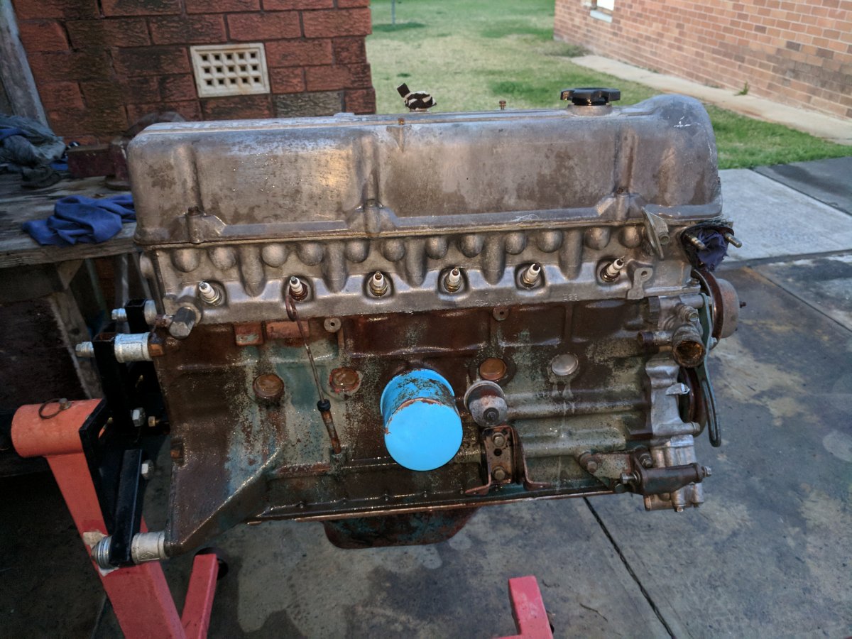

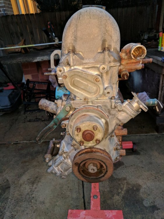

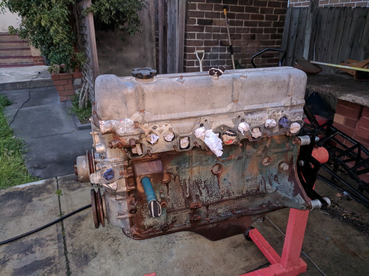

Administrators gav240z Posted December 30, 2018 Administrators Posted December 30, 2018 Last few days I've spent hours going through the external engine fasteners which I wish to get yellow cadmium plated along with some items vapour blasted for the engine out of #150. I basically took photos, measured thread pitch and bolt length of each item and put them into a bag. Knowing that when I get them back they will be in a messy disorder. https://photos.app.goo.gl/tgZBfcXupb7BPvT19 Photos in the album above for anyone who is interested. I'm also plating some odds and ends like radio casing, steering wheel bits and bobs and any other bits I could find lying around as spares. I had success with my SUs last time and am contemplating sending off another set for the same treatment this time. I also spent time degreasing an old sump which doesn't have any major dents in it (quite rare these days), but what a disgusting / messy job that is. I discovered the factory sump colour must be black with blue overspray. *EDIT - Please ignore numbers in the brackets of the first few images eg: 22x0.5 (1.0). Ignore the (1.0) part. I was misreading the chart on the back of my thread pitch tool box. Some FYI"s to the legend I used. 1. I measured the height of the bolts in mm and rounded up or down when they were not quite a rounded number. 2. TP = Thread Pitch and they are all metric 3. For large lots of the same size I counted number of fasteners. 4. Some parts I think may not be OEM, I added some misc fasteners I had in storage and odds and ends were thrown in, because it makes sense to do this stuff in bulk. 5. Refer to photos for reference of what bolts go together etc.. Hopefully someone finds this useful. I plan to do more of these collections for other bolts/parts on an S30Z. But given that platers mix all of them in together I don't want to do them all in 1 hit. Quote

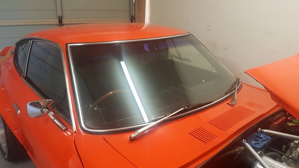

Retro Z Posted January 10, 2019 Posted January 10, 2019 Finally got around to installing the chrome mouldings for my windscreen and hatch. After several attempts (and cut fingers) trying to install the factory chrome mouldings i gave up and purchased the Rarespares chrome mouldings that comes in a roll. It is much easier to fit and very forgiving in terms of installation. Whereas the stock datsun trim needs to be installed with the windscreen out this can be done with glass in place. Total Installation time for front and rear= 20 mins, and looks alot better than the datsun trim. MikeZ and Ponyo240z 2 Quote
Administrators gav240z Posted January 10, 2019 Administrators Posted January 10, 2019 I understand why you did it and it looks great. But for a purist it just won't do for me! haha. However with a screen already installed, it would be a massive pain to have to remove it, install the trim and then the screen again. I'm still not sure how to remove the old trims without damaging them! Retro Z 1 Quote
