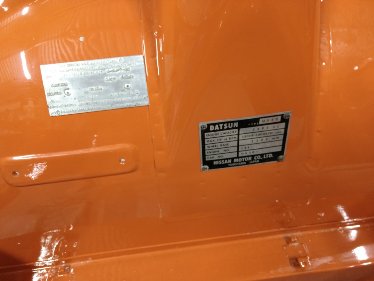

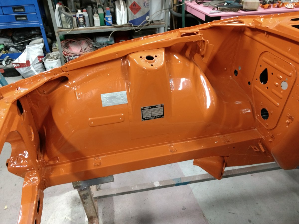

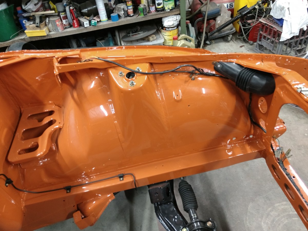

jeff43 Posted October 27, 2018 Author Posted October 27, 2018 3 hours ago, JDM-TOY said: That looks MINTTTT Thanks Youhan, It has been a bit of a wait just like yourself. I dropped her off to the painter just before Easter and he said about a month. It has been a long wait since then. I was surprised when he called me yesterday as the way things were going I expected not to see it finished this side of Christmas. Pretty exciting I must say when it is finally done. The rest of the panels are just about done, I will pick them up mid week. Cheers Jeff Quote
JDM-TOY Posted October 27, 2018 Posted October 27, 2018 28 minutes ago, jeff43 said: Thanks Youhan, It has been a bit of a wait just like yourself. I dropped her off to the painter just before Easter and he said about a month. It has been a long wait since then. I was surprised when he called me yesterday as the way things were going I expected not to see it finished this side of Christmas. Pretty exciting I must say when it is finally done. The rest of the panels are just about done, I will pick them up mid week. Cheers Jeff Seriously congrats Jeff its a step closer to turning the key and driving. I agree, its not easy waiting for something you really want to enjoy. Hope you are going to put some fender mirrors lol Looking forward on the progress Youhan Quote
jeff43 Posted October 27, 2018 Author Posted October 27, 2018 15 minutes ago, JDM-TOY said: Seriously congrats Jeff its a step closer to turning the key and driving. I agree, its not easy waiting for something you really want to enjoy. Hope you are going to put some fender mirrors lol Looking forward on the progress Youhan Fender mirrors are a definite, the original holes in the guard were already there so I felt somewhat compelled to go that way for originality and I like the look. I will only have cheap ones until I can afford the good reproduction ones. JDM-TOY 1 Quote
Riceburner Posted October 27, 2018 Posted October 27, 2018 Awesome Jeff, can’t wait to see it with the panels hanging on! Quote
CBR Jeff Posted October 29, 2018 Posted October 29, 2018 Looks seriously good Jeff. I do like the colour......... Jeff Quote
jeff43 Posted October 29, 2018 Author Posted October 29, 2018 1 hour ago, CBR Jeff said: Looks seriously good Jeff. I do like the colour......... Jeff Thanks Jeff, I expect you might be a little bit bias on the colour!!!! Quote

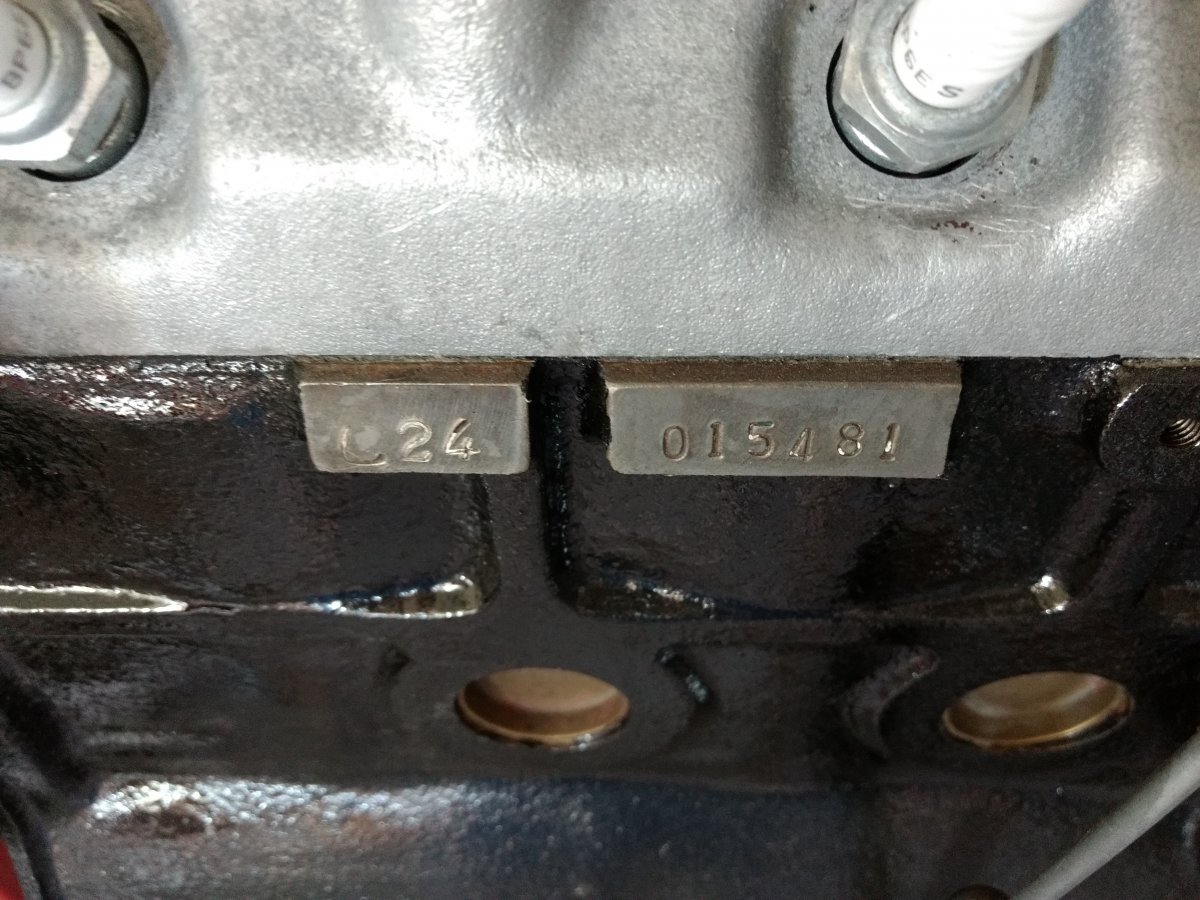

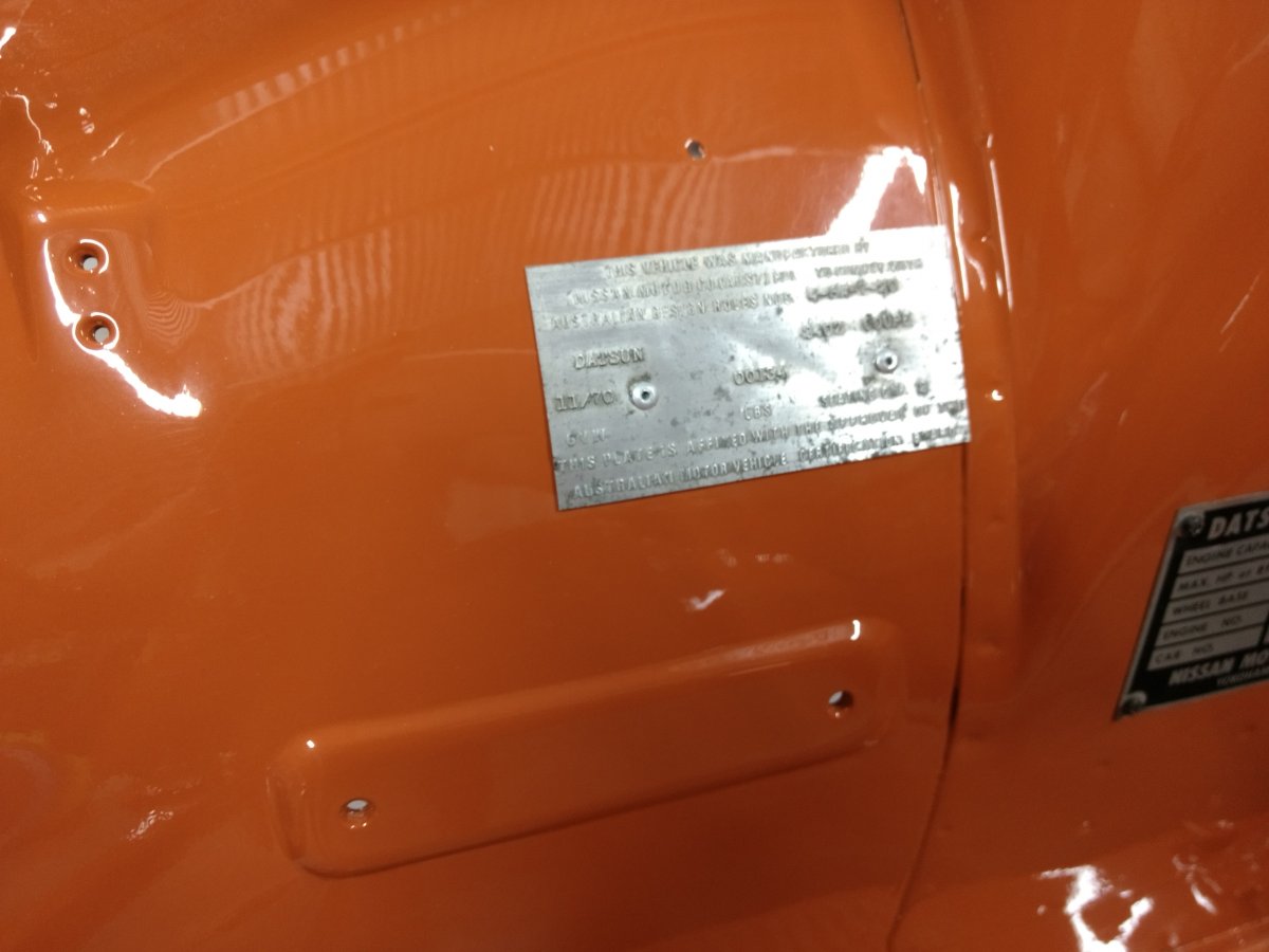

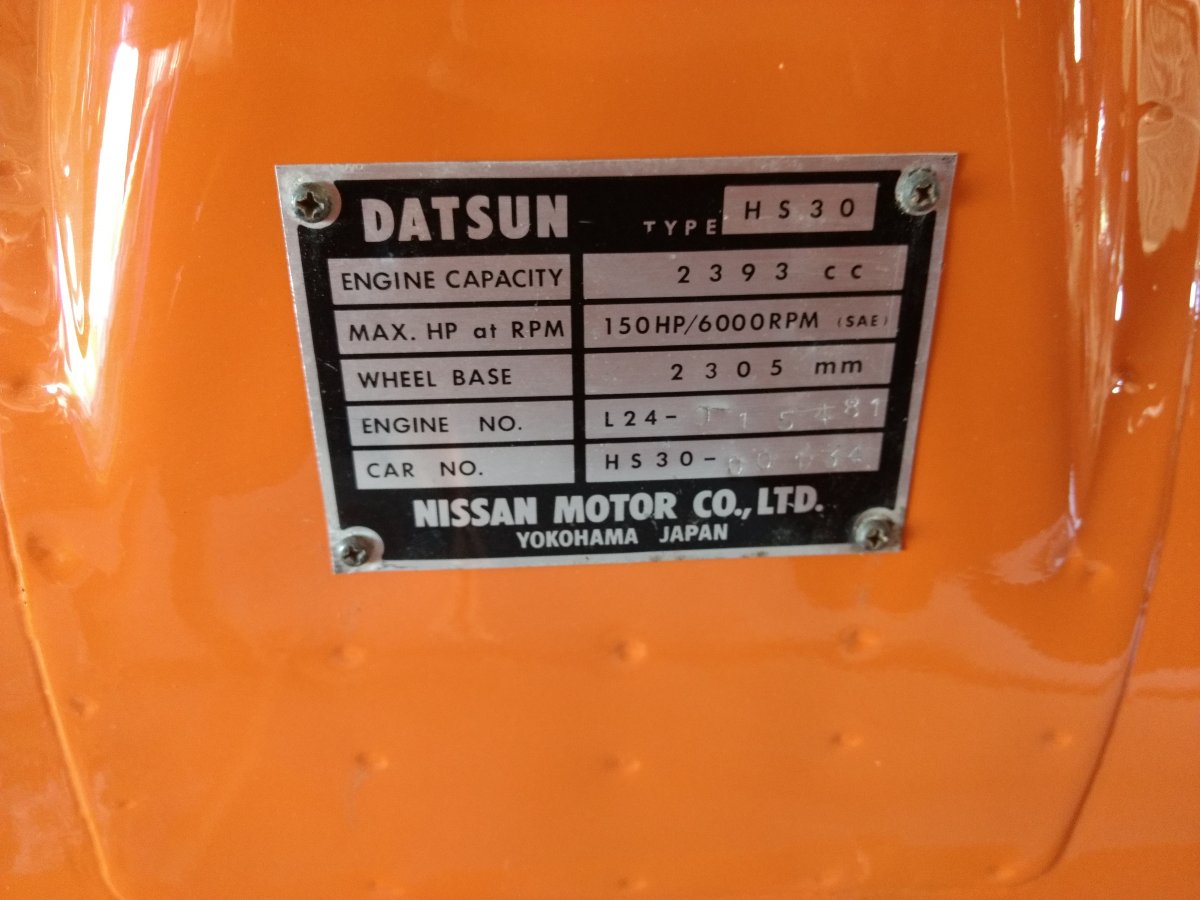

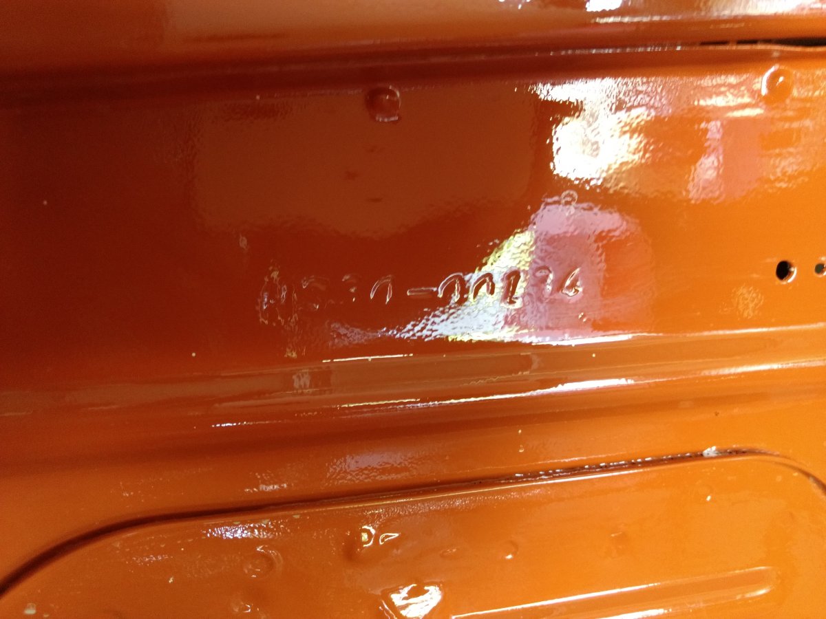

jeff43 Posted November 15, 2018 Author Posted November 15, 2018 Hi All, Not a lot has happened since the car has been painted. I thought I would post a couple of pics of the first bits to be refitted to the car. I'm pretty happy to have matching numbers. Cheers Jeff Zedhead, gav240z, RAP260 and 1 other 4 Quote

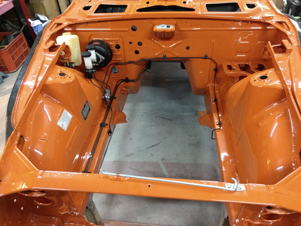

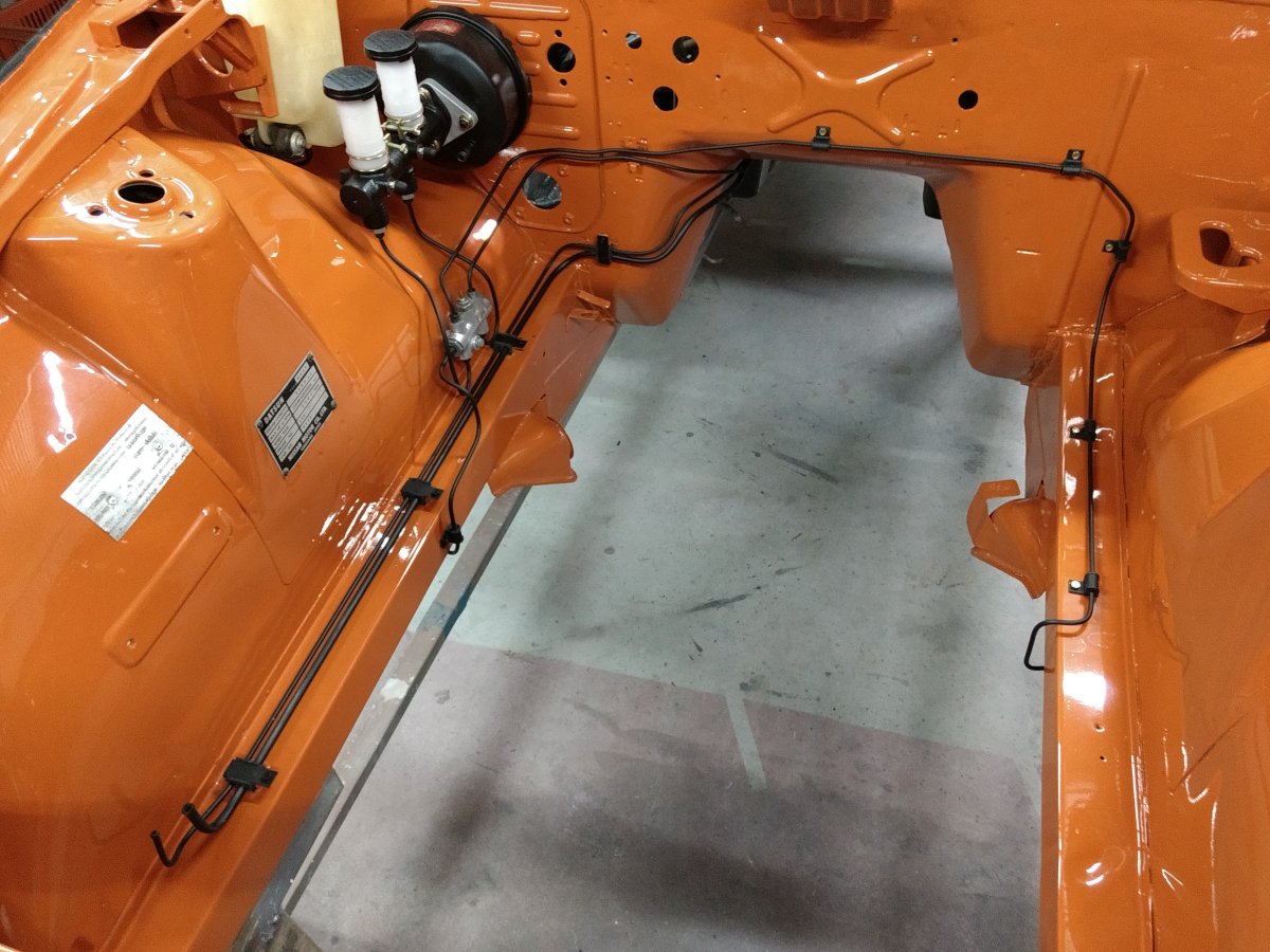

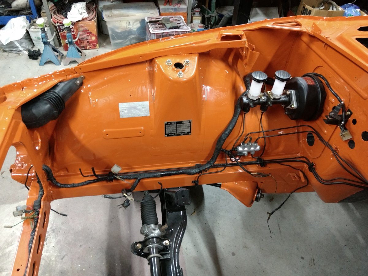

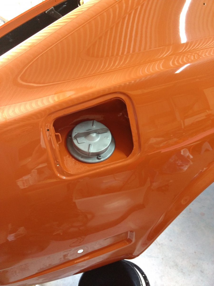

jeff43 Posted December 1, 2018 Author Posted December 1, 2018 Hi All, quick update on the reassembly process. All small steps but very satisfying all the same. I just can't bring myself to put dirty old looking parts back on a freshly painted car. The brake and fuel lines took a lot of time to clean and I had to resort to sand paper to clean all 48 yrs of grime and rust from them. I feared after cleaning them up that they would just rust if I left them the way they were and I liked the look of "Katokid's" black fuel lines on his safari gold car, so matt black painted lines was the go. I'm very happy with the way the engine bay is coming along, I cleaned up and painted the brake booster the same and the new master cylinder came black already so that worked out well. I decided against the rubber in the fuel filler area as I prefer the clean look and will just be super careful when I will up. Zedhead, Ponyo240z, JDM-TOY and 1 other 4 Quote

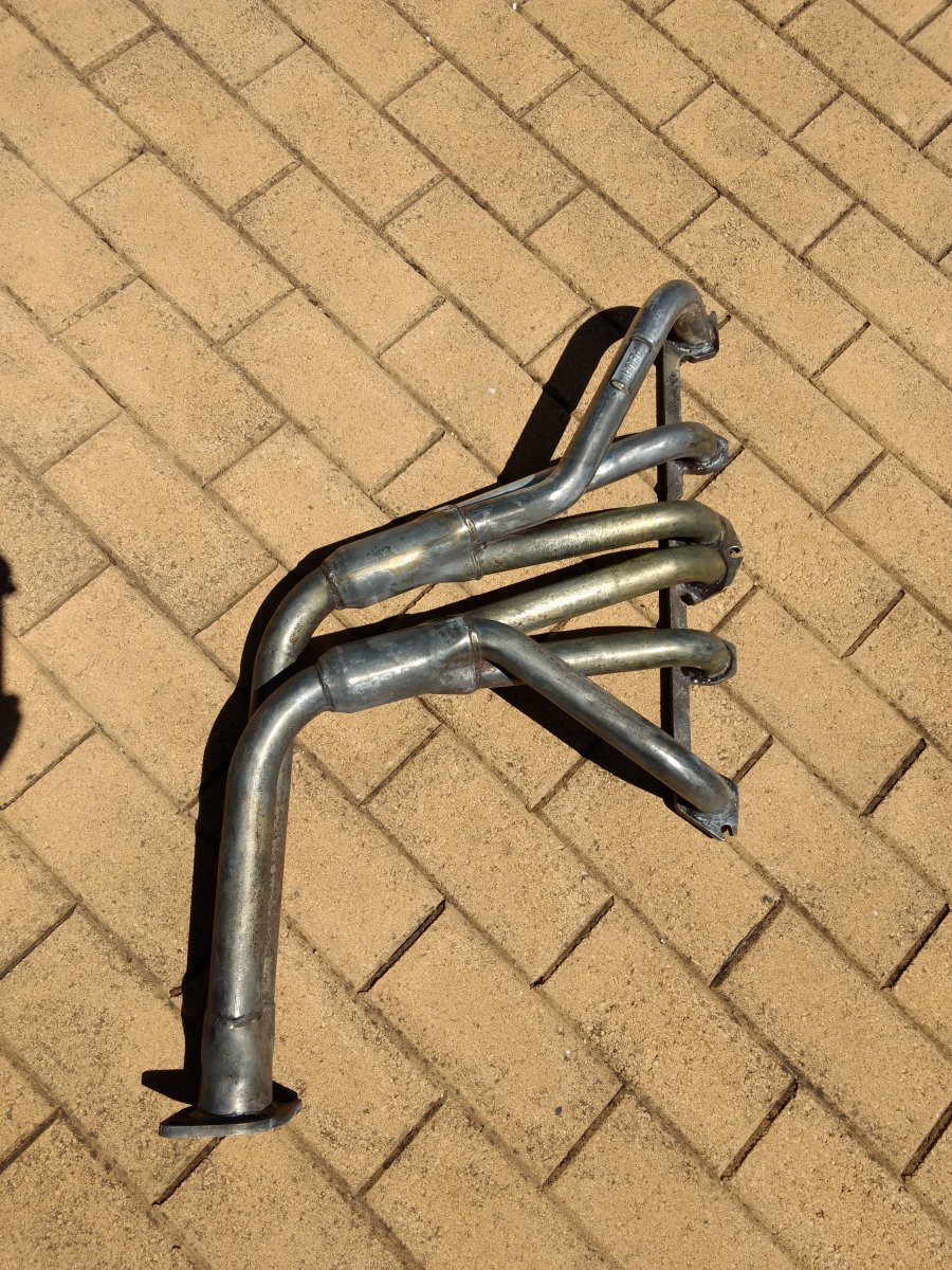

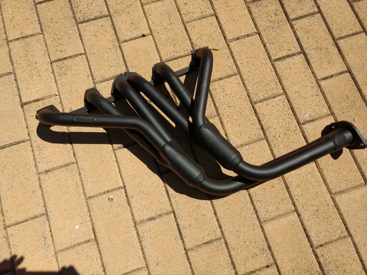

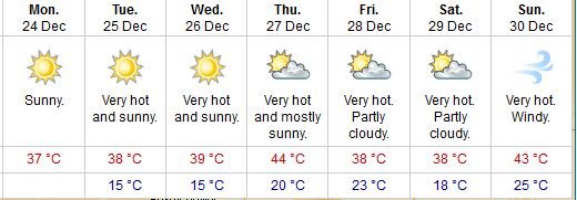

jeff43 Posted December 24, 2018 Author Posted December 24, 2018 I needed to paint my extractors, the product instructions said to bake after painting @ 200 Deg C for 1hr. I don't have an oven big enough to do that and I'm sure the wife wouldn't be happy with that. So when I saw the weather forecast for the next week I decided it was now or never and prepped the extractors for paint. I figured a week of baking on the pavers in the sun will have to do. gav240z and Gtv240z 2 Quote
Administrators gav240z Posted December 24, 2018 Administrators Posted December 24, 2018 Nice 1, I am considering HPC coatings for mine however. But need to do more research before I fully commit to it, vs say high temp paint like this. Quote
jeff43 Posted December 24, 2018 Author Posted December 24, 2018 1 hour ago, gav240z said: Nice 1, I am considering HPC coatings for mine however. But need to do more research before I fully commit to it, vs say high temp paint like this. It all came down to price for me Gav, $20 and a bit of hard yakka vs the cost of HPC coating - which in the hundreds. gav240z 1 Quote
KatoKid Posted December 24, 2018 Posted December 24, 2018 4 hours ago, jeff43 said: I don't know how you Radelaideians survive the summer.....sure breed em tough over there. Kudos for getting anything done in a tin shed! Quote
jeff43 Posted December 24, 2018 Author Posted December 24, 2018 This is why I put a pool in the backyard. I'm not sure how much work will get done in the tin shed over the next week, maybe a bit late at night when the sun has gone down. I prepped the extractors with the wire wheel in the cool of Sunday - only 35 ish. Quote

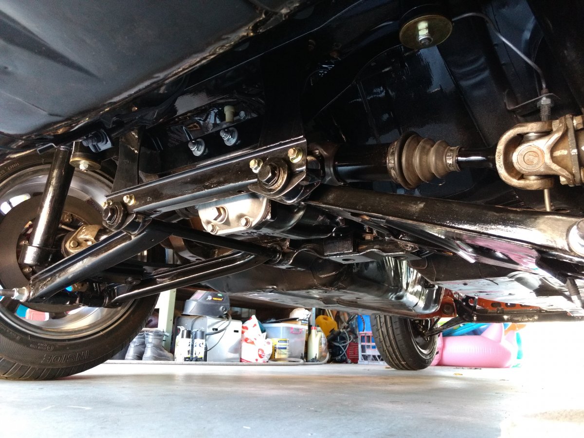

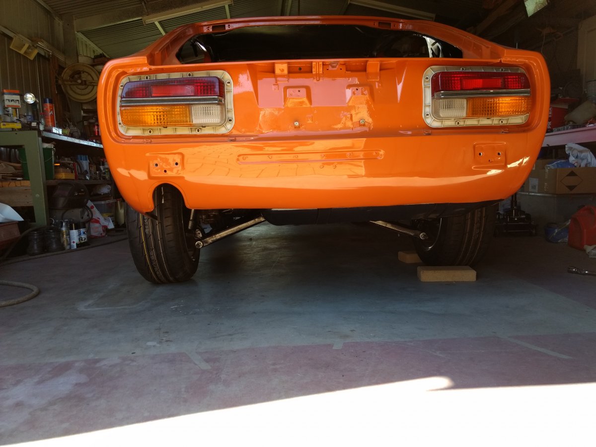

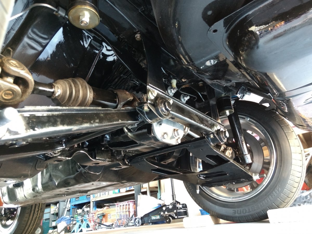

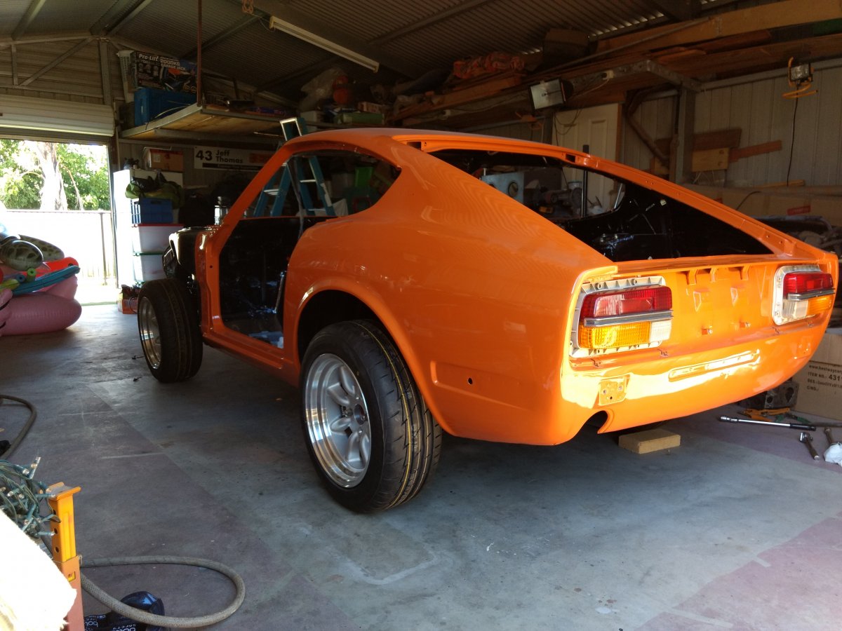

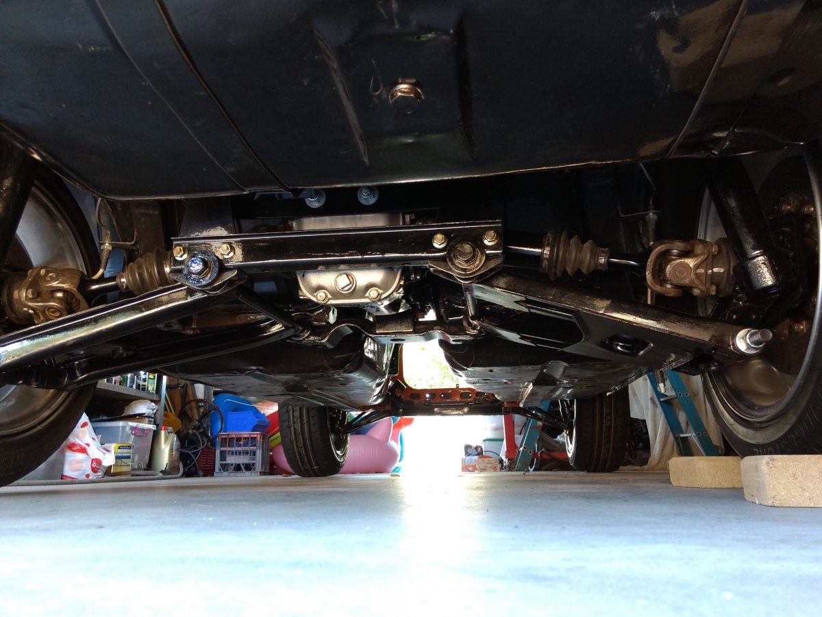

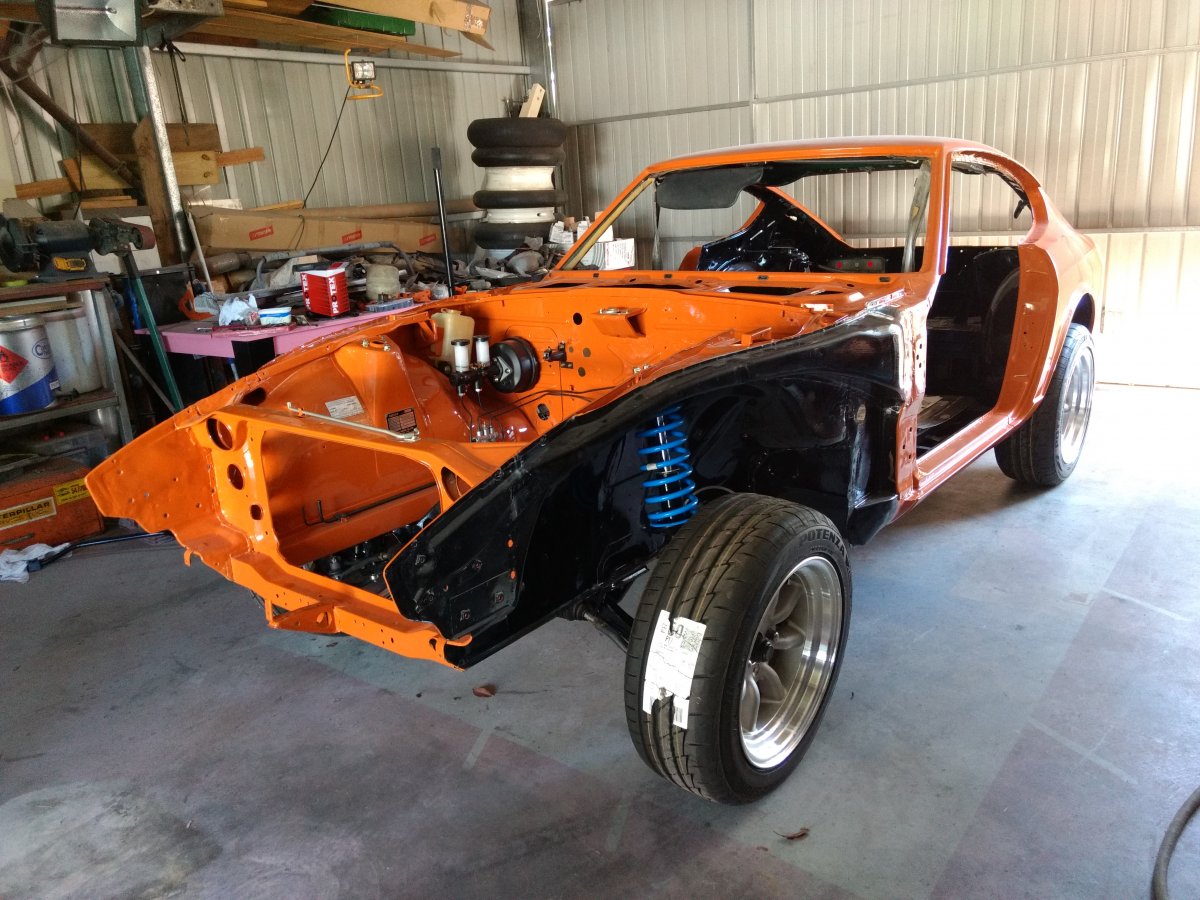

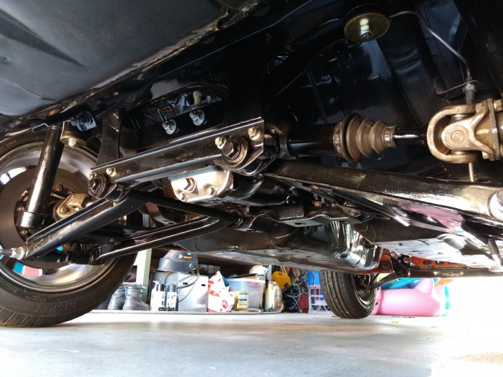

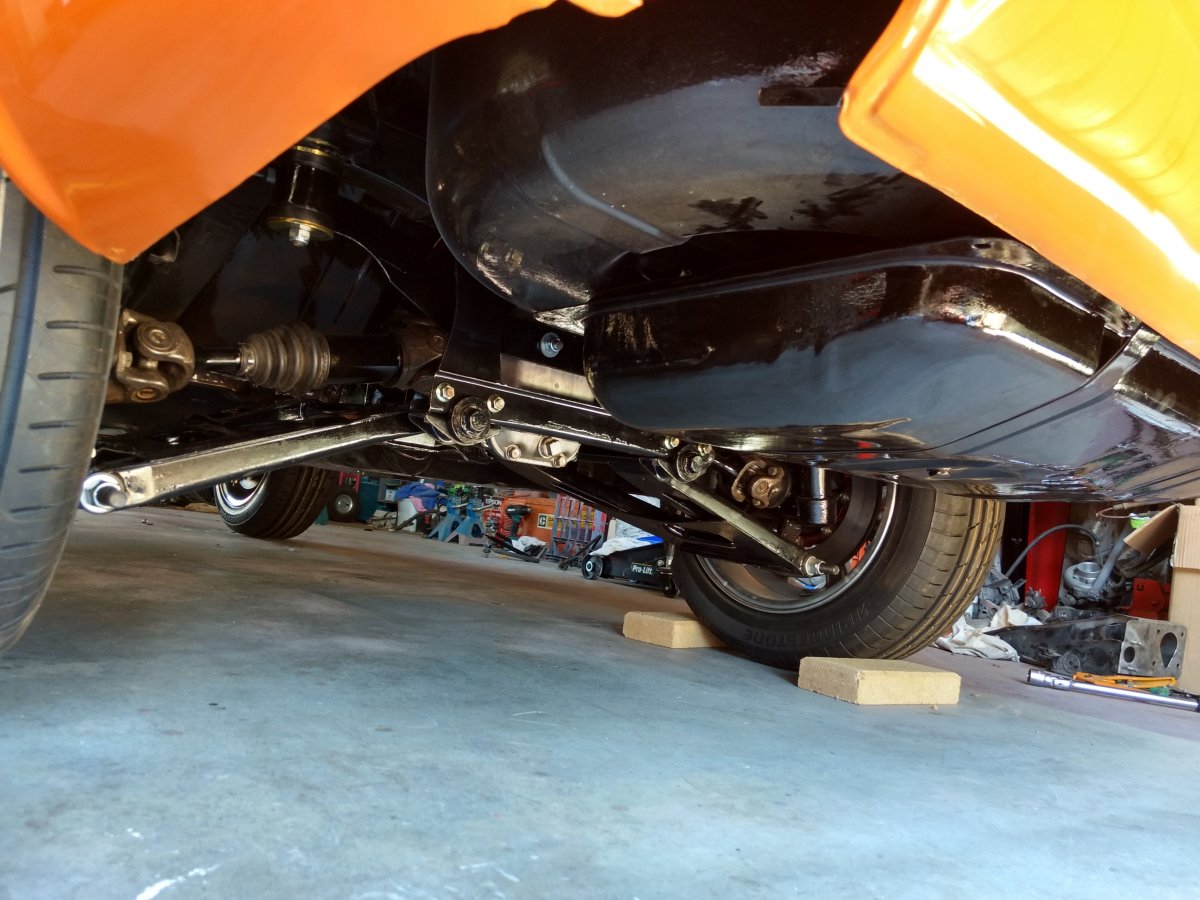

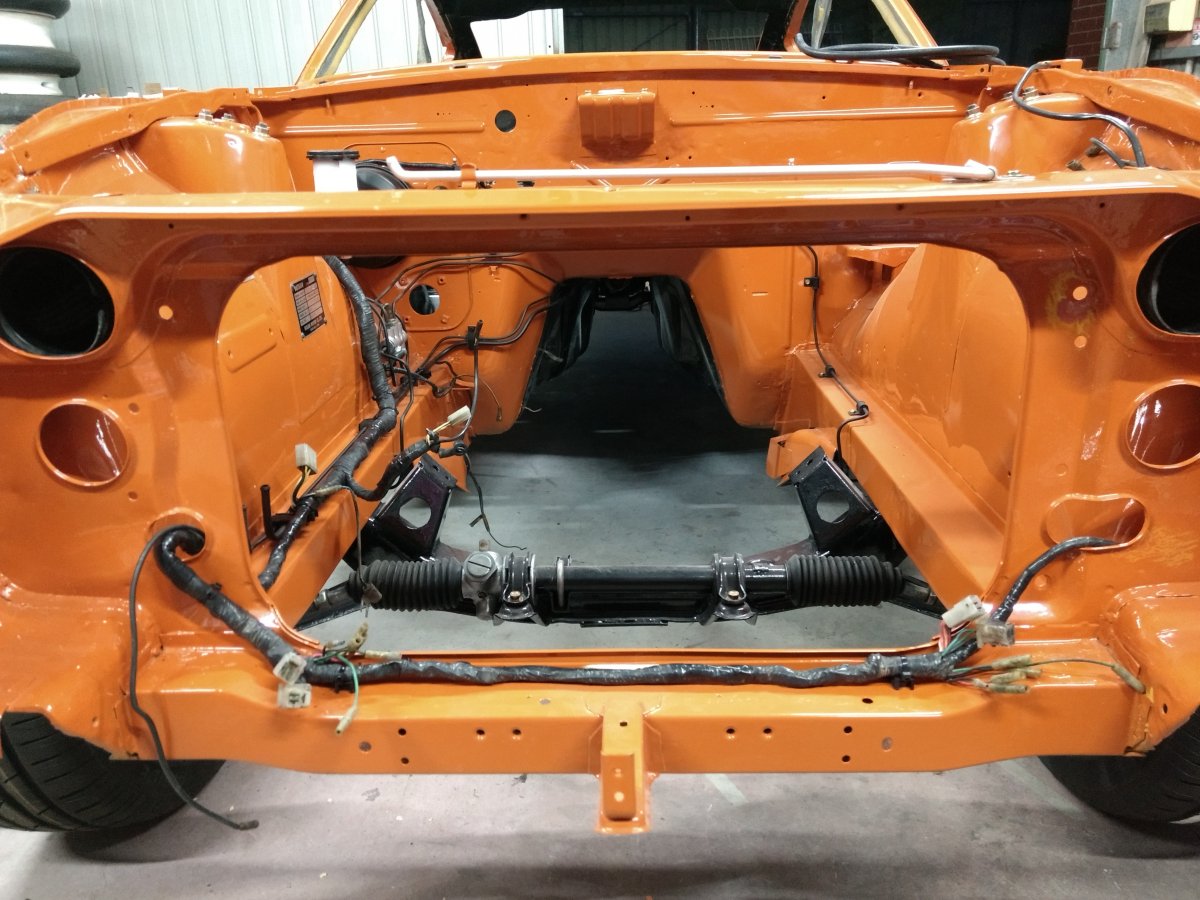

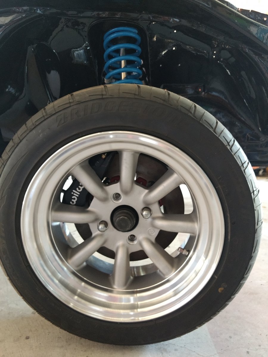

jeff43 Posted January 2, 2019 Author Posted January 2, 2019 Jan 19 update - this is the year, we will drive this car this year!!!! For the first time in 7 years the old girl is back on it's wheels - a bit of a milestone there. I will let the pics tell the story. Cheers Jeff Enzo, AndBir, OdinZ and 2 others 5 Quote
RLY240 Posted January 2, 2019 Posted January 2, 2019 Looking fantastic Jeff, can’t wait to see it on the road. jeff43 1 Quote
jeff43 Posted January 4, 2019 Author Posted January 4, 2019 On 1/2/2019 at 9:49 PM, RLY240 said: Looking fantastic Jeff, can’t wait to see it on the road. Thanks Roger, you and me both - I can't wait to have it out on the road. Quite enjoying this part of the build. 7 hours ago, Chassis254 said: Looking great Thanks, I'm very happy with how it is coming along. Quote

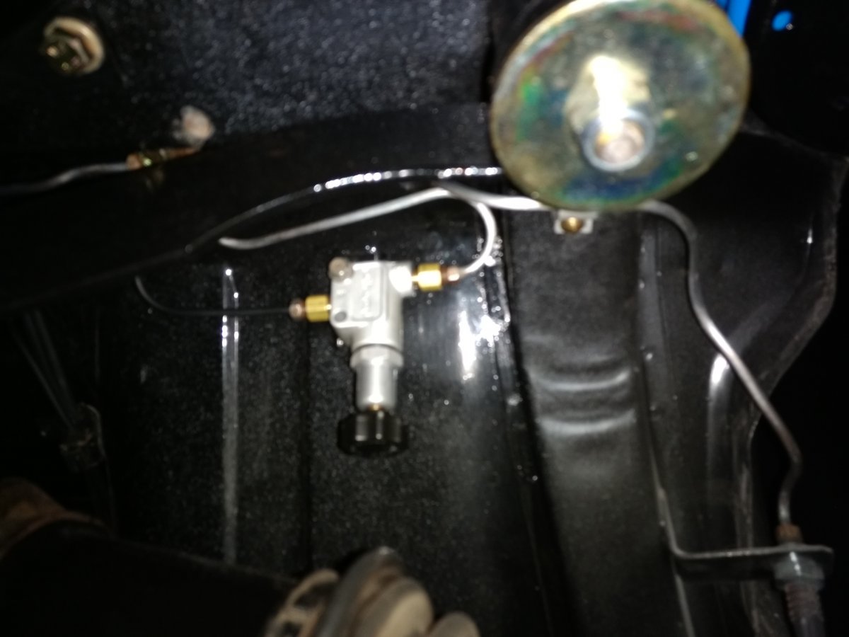

jeff43 Posted January 4, 2019 Author Posted January 4, 2019 Just a few pics from today. The engine wiring loom has had a clean and been fitted, along with the air intake ducts. I also finally fitted my wilwood proportioning valve in the stock location ( for an early car) at the rear underside above the RH half shaft. Just a quick note on the Wilwood brakes and the proportioning valve fitment etc. Wilwood do not make a proportioning valve with the correct thread and flare to fit directly to our Datsun's. After a lot of searching I did manage to find a set of adaptors which allowed me to fit the valve without needing to change brake line fittings and redo the flare on the brake line. I have added the ebay link below, I hope it can help other people in the future. Cheers Jeff https://www.ebay.com.au/itm/Brake-Line-Thread-Adapter-Male-M10-x-1-Bubble-Female-M10-x-1-Inverted/391200008314?ssPageName=STRK%3AMEBIDX%3AIT&_trksid=p2057872.m2749.l2649 Retro Z and KatoKid 2 Quote
