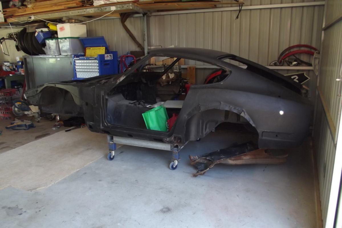

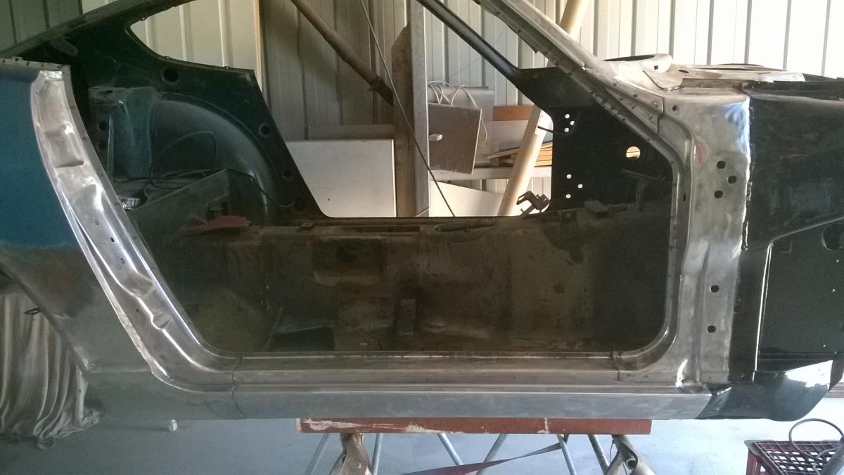

jeff43 Posted January 3, 2016 Posted January 3, 2016 (edited) Hi All, I have noticed it has been fairly quiet on the site over the Christmas/newyear period so I thought it was about time I posted my project up. I have owned this car since mid 2006 (nearly 10 years - seriously were did that go) and began work on it around Nov 2011. I have had a fair few 240/260 2 seaters in the past but this is the one that I chose to keep for the long term. I did have a total of 3 240's and 1 260 2 seater in the shed when my 2 daughters came on the scene. Reality kicked in pretty soon after the birth of my first daughter and the culling began ( you can't save them all). Being a 1970 240Z early build number with a matching number engine the choice was reasonably easy except for the slight ding in the front end. The interior is in pretty good condition with the seats having been redone by the previous owner. So the plan was to fix the crash damage and get it driving. Well one thing led to another and with my mate Vorn getting into a full on resto with his 240Z (see his build here - http://www.viczcar.com/forum/topic/11151-vorns-920-gold-240z/ ) I was slowly but surely heading down the path of a full resto. Nov 2011 I began in earnest by stripping the car down to a bare shell, geez thay come apart fast, pity they take so long to put back together. Stay tuned for the next instalment. Cheers Jeff Edited January 3, 2016 by jeff43 Classicman, George, locklock and 3 others 6 Quote

jeff43 Posted January 4, 2016 Author Posted January 4, 2016 Looks pretty good Jeff, nothing that cant be fixed!!! Yeah it is a pretty good shell except for the battle scars. It can definetely be fixed, in fact it has been fixed but we will get to that in a future update. This car was sold locally to me not long before I got it from a damaged auction. I have spoken with the previous owner and he told me he sold it to a young guy who had plans for an RB25DET etc, when he checked the odometer he reckoned it had done barely 150 miles since he sold it. It appears that the young guy struggled with the power of an L24 so maybe the RB25DET may have been a litttle to much. Quote

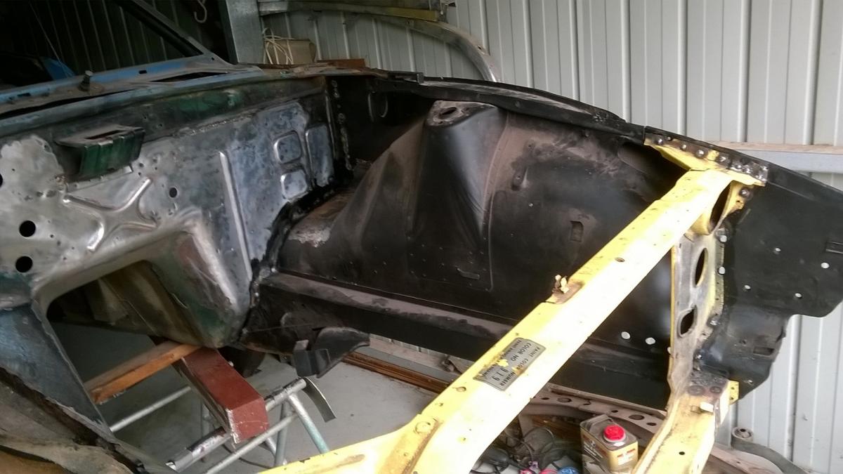

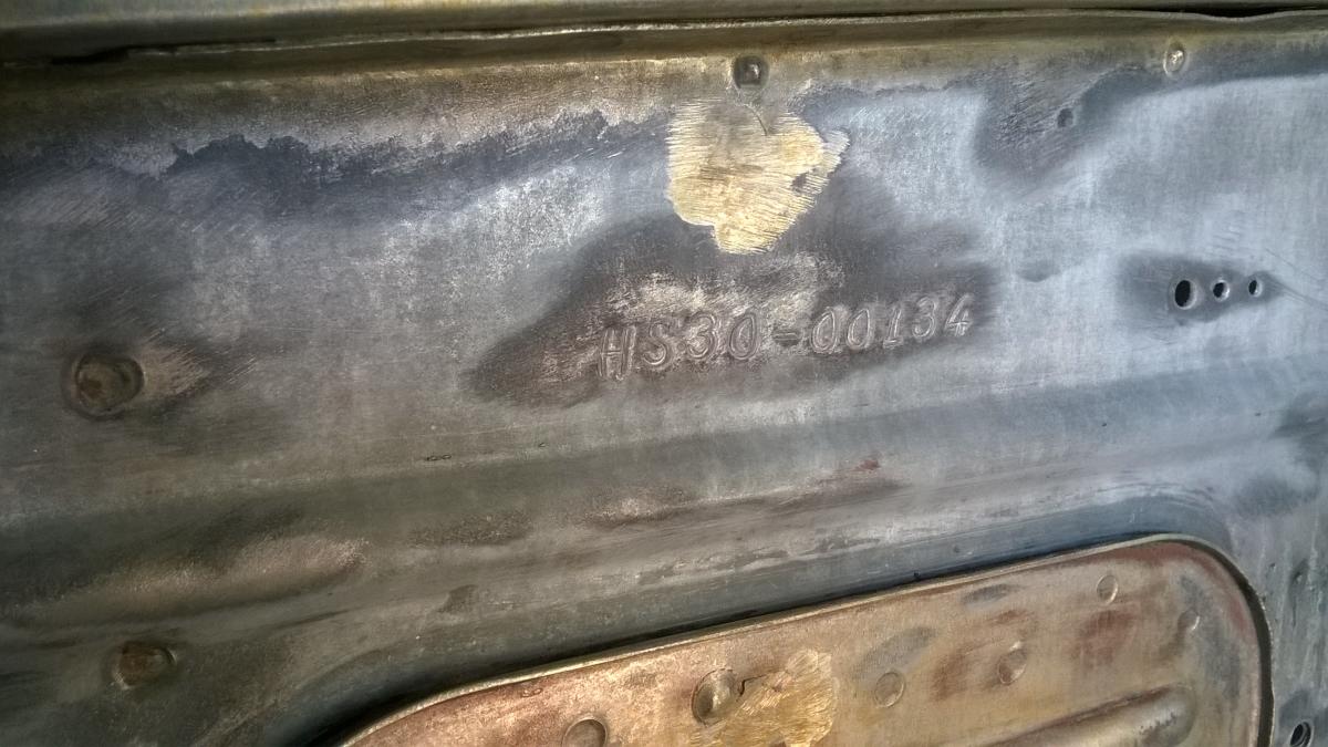

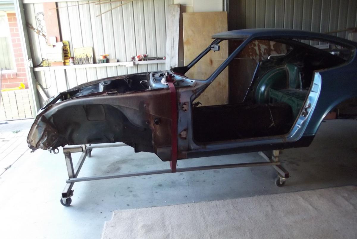

jeff43 Posted January 6, 2016 Author Posted January 6, 2016 So once the shell was stripped we get a better look at the extent of the front left damage By this stage I had manage to source a donor shell HS30-00288 (thanks Mossy) to provide the left front corner from the firewall to the RH side of the radiator support where it joins the RH front inner guard. Getting the radiator support panel out of my car was challenging due to the damage but I got there. LH inner guard was then removed from the firewall Then the complete LH inner guard and radiator support from Mossy's old shell was removed and temp fitted to check for fitment onto my shell Starting to look better already. Cheers Jeff oldmates260z and vorn70 2 Quote

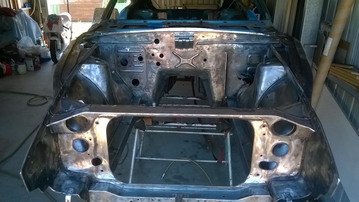

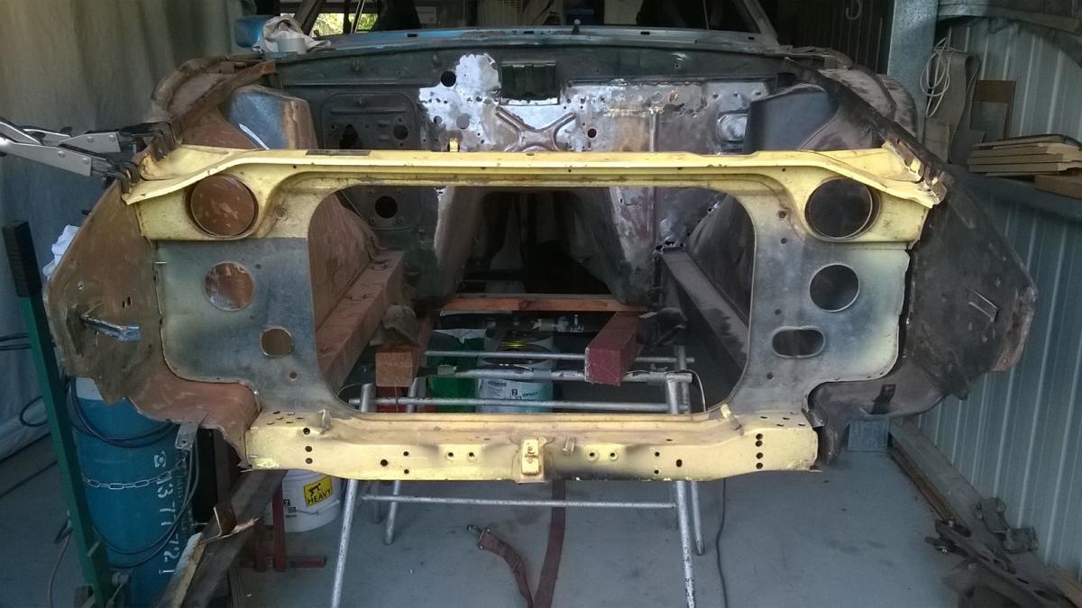

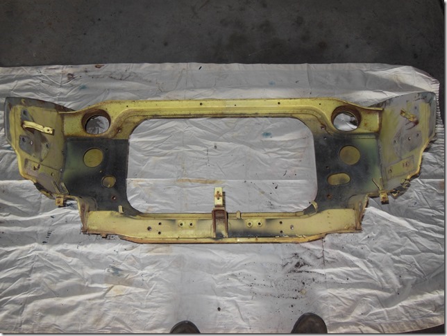

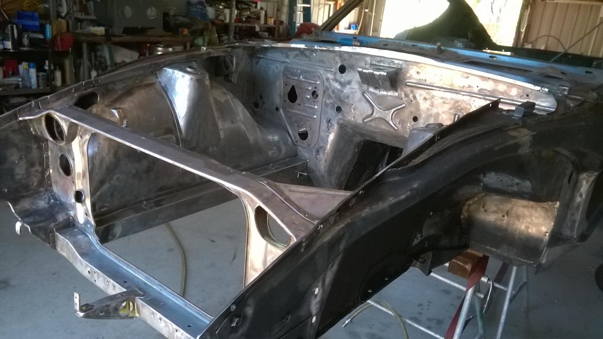

jeff43 Posted January 10, 2016 Author Posted January 10, 2016 Thanks Vorn, I will call in a favour or 2 when I need it. I wasn't happy with the radiator support panel as it had had a hit a some stage in a previous life and needed a few rust repairs as well. As luck would have it I managed to source this piece of Datsun "UNOBTAINIUM" from a gentleman on this site. So I got to work and drilled out the spot welds to remove the old radiator support panel and fitted the new rust free one in it's place. Everything was measured and measured and checked before the new front LH corner and rad support where welded in place. oldmates260z 1 Quote

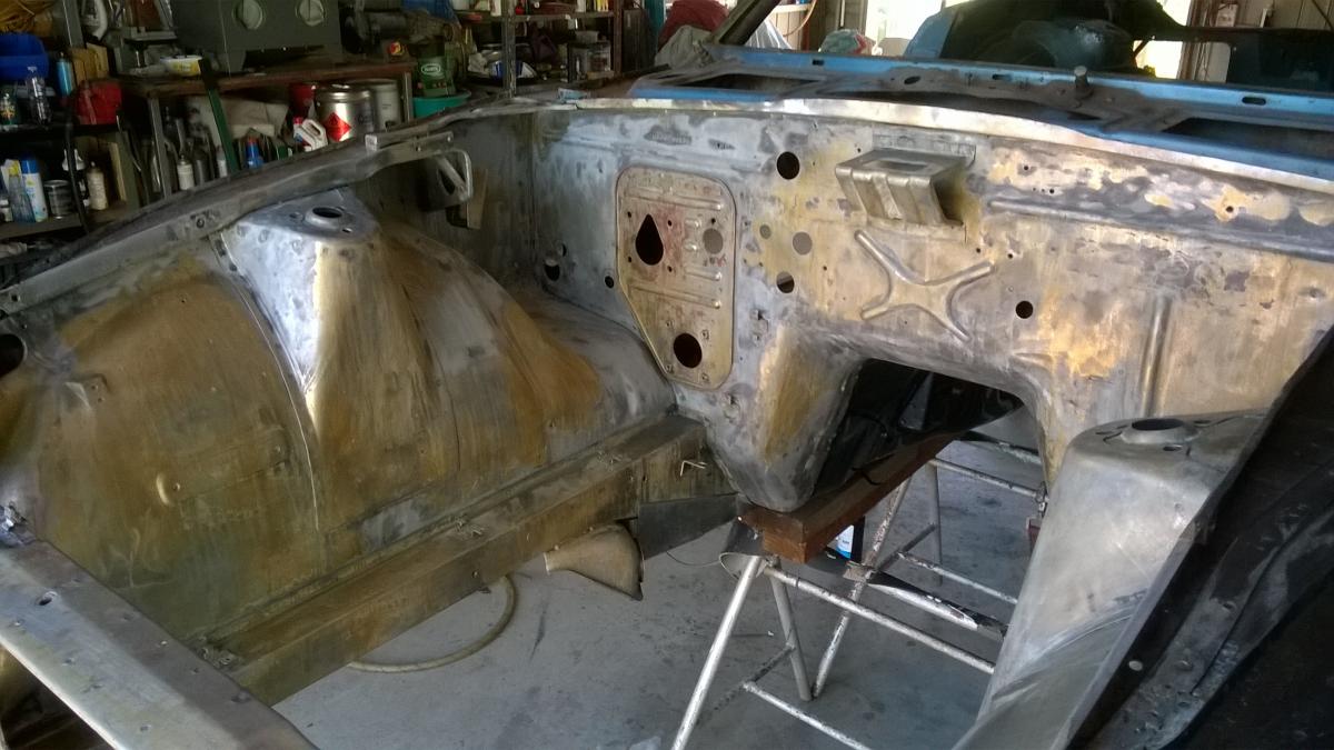

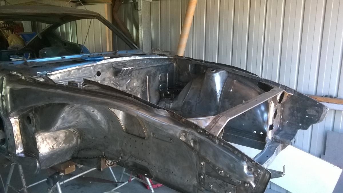

jeff43 Posted January 10, 2016 Author Posted January 10, 2016 The whole frontend was then prepped for paint. gav240z, Classicman and mother240 3 Quote
CBR Jeff Posted January 10, 2016 Posted January 10, 2016 Impressive Jeff. A few hours work have gone into that. What did you use to prep the metal? Looks like you used a caustic wash or something? Jeff. Quote
jeff43 Posted January 10, 2016 Author Posted January 10, 2016 Impressive Jeff. A few hours work have gone into that. What did you use to prep the metal? Looks like you used a caustic wash or something? Jeff. Thanks Jeff. You are right, there was a few hours work there. I believe all the hard hours will pay off in the long run. The metal was prepped with deoxidine Cheers Jeff Quote

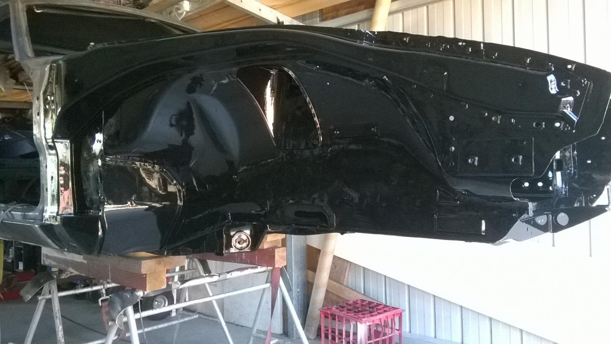

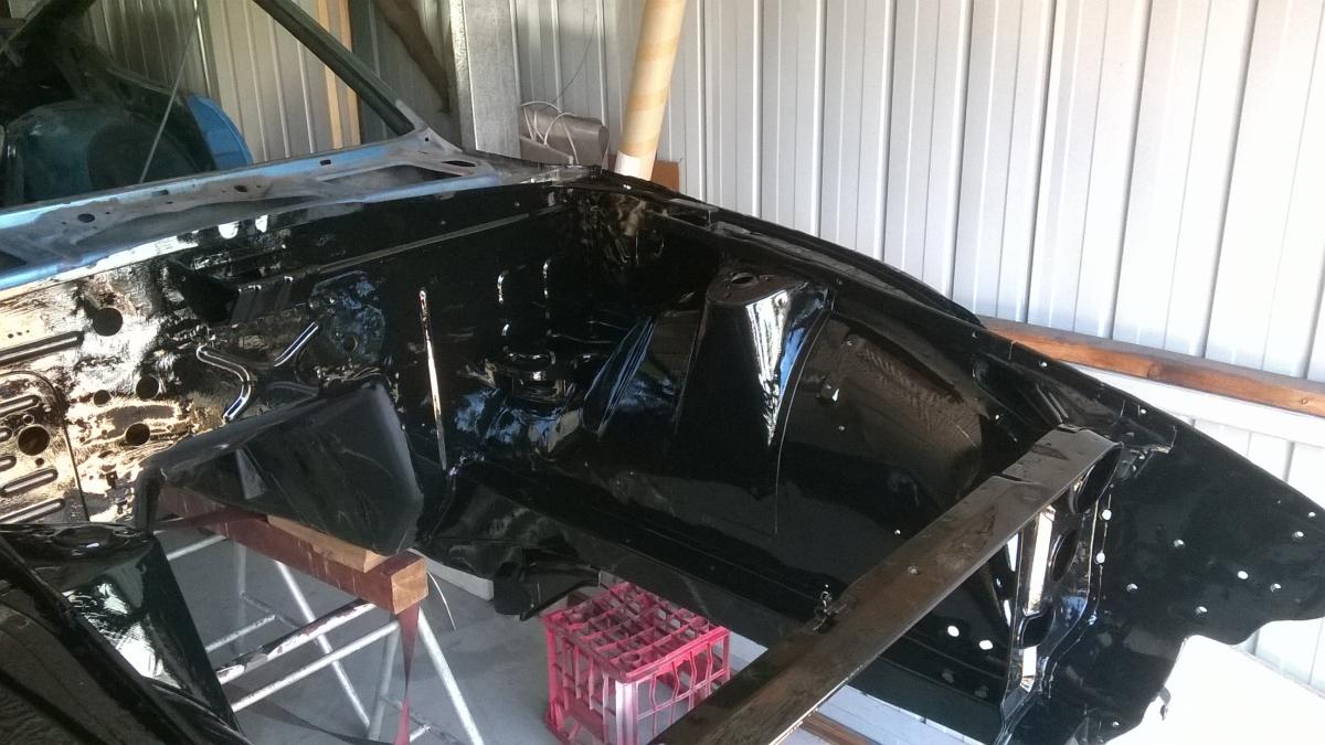

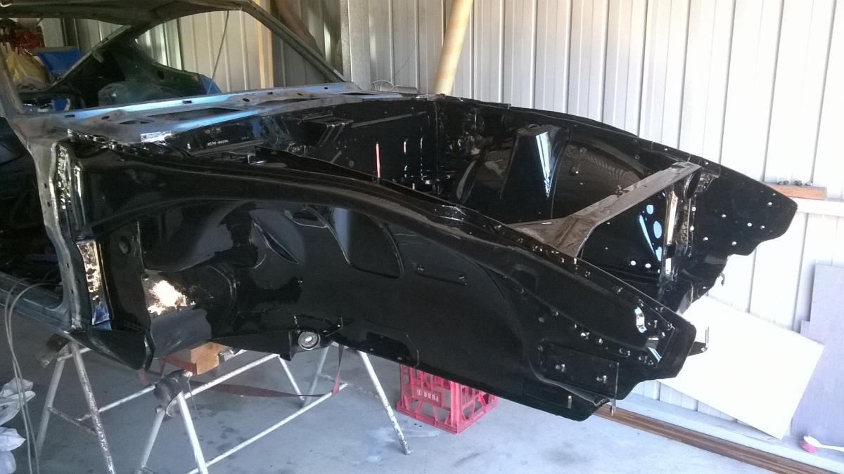

jeff43 Posted January 12, 2016 Author Posted January 12, 2016 Thanks for the kind words. Thanks again for the shell Mossy. The best thing is that your old shell is going to be saved by a guy from Vic that bought it from me. That shell sure has done some kms on a trailer. So from here on you will see a lot of KBS rust seal used. It might look like an ad for KBS, but the truth is I researched it, tried it and I liked it and seem to now want to use it almost everywhere. Well not quite, I am using it in the rust prone areas and the underside mainly. I will let the pics do the talking. gav240z 1 Quote
Administrators gav240z Posted January 12, 2016 Administrators Posted January 12, 2016 I quite like the look of the KBS rust seal finish, do you hand brush it on? How is it applied? Quote
red76z Posted January 12, 2016 Posted January 12, 2016 Nice work. Do it once and do it well. This is a quality job keep up with the post's. Quote
jeff43 Posted January 12, 2016 Author Posted January 12, 2016 I brushed it on but can be sprayed. For the diyer I recommend brushing it on and with a bit of practice and learning to get the consistency right you can get a pretty good finish. I will be painting the engine bay in body colour but the underside and wheel arches will be staying as they are. I have done 2 coats on the underside of the car, the whole front end, the wiper box inside and out, drivers door all except the outer skin with 2L @ 77 dollars per Litre. I reckon that is pretty cheap considering the protection it provides. It can be painted over with any paint system as well. Quote

Retro Z Posted January 13, 2016 Posted January 13, 2016 I used to brush KBS rust seal and also had the same problem with the bubbles and dust. I now spray it with my HVLP gun with a dash of the KBS thinners and no more problems. I painted my whole engine bay with it and it looks like glass, ill try post a pic of it tonight. Quote
Sirpent Posted January 13, 2016 Posted January 13, 2016 Jeff Sensational work, great to see the level of prep and execution in this build ;-) Cheers John Quote
jeff43 Posted January 13, 2016 Author Posted January 13, 2016 I used to brush KBS rust seal and also had the same problem with the bubbles and dust. I now spray it with my HVLP gun with a dash of the KBS thinners and no more problems. I painted my whole engine bay with it and it looks like glass, ill try post a pic of it tonight. Good to know. I had read of people having trouble spraying KBS rust seal, I would love to see some pics. I was tempted to leave the engine bay black myself but have decided to keep it pretty original and do it in body colour. Quote
