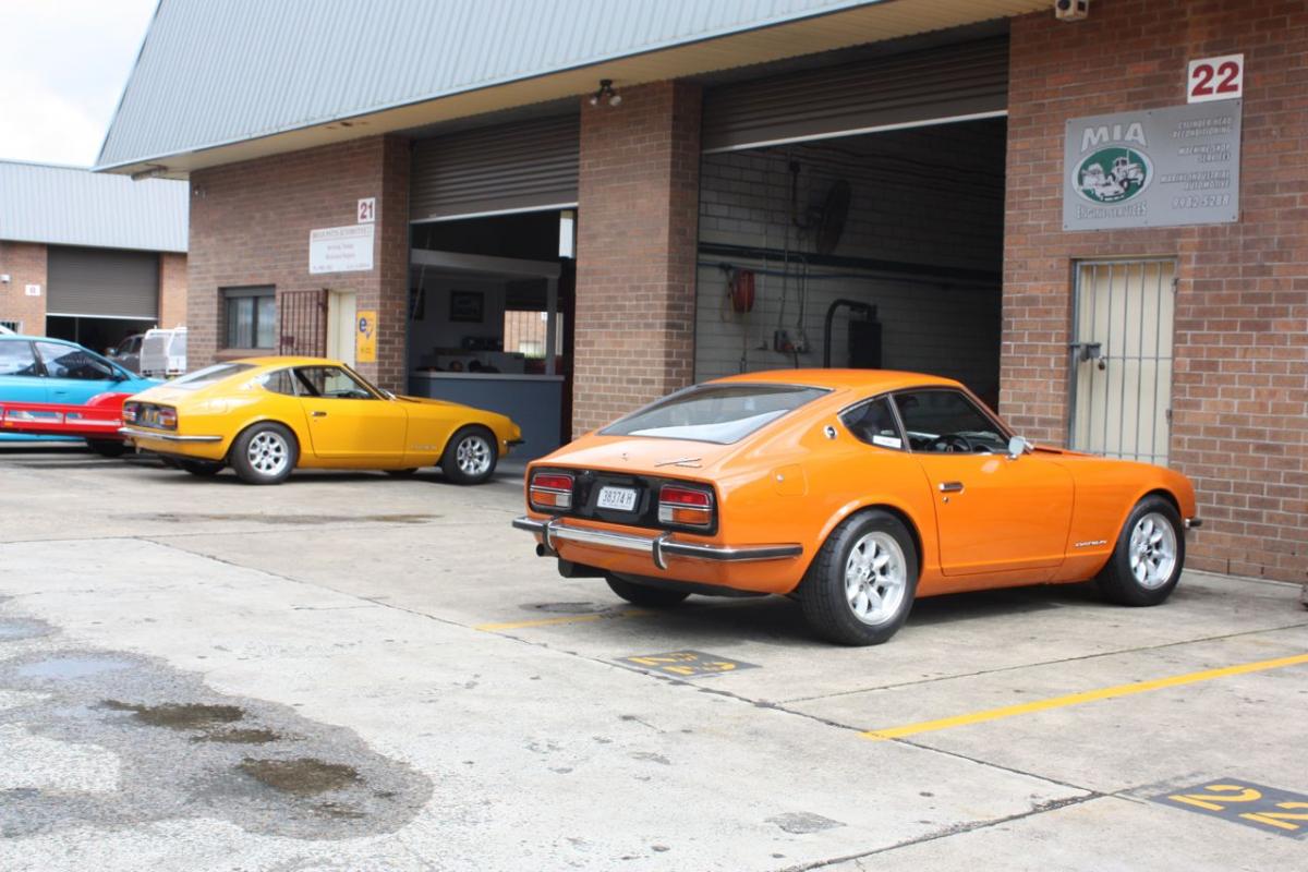

Looks good Jeff. Very similar to the McLaren papaya orange, nice 70's color.
Hi Brabham, I agree very similar, hopefully a little more orangey. I have not seen the colour in real life. It does depend a lot on camera and lighting in the pics from the net. Here is a lower light shot of a different car.
And McLaren Papaya orange on adam's old car vs I believe 918 orange.

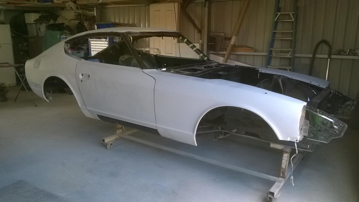

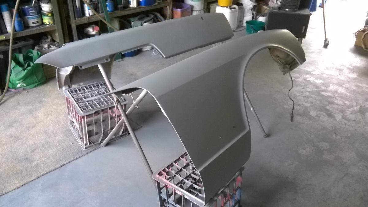

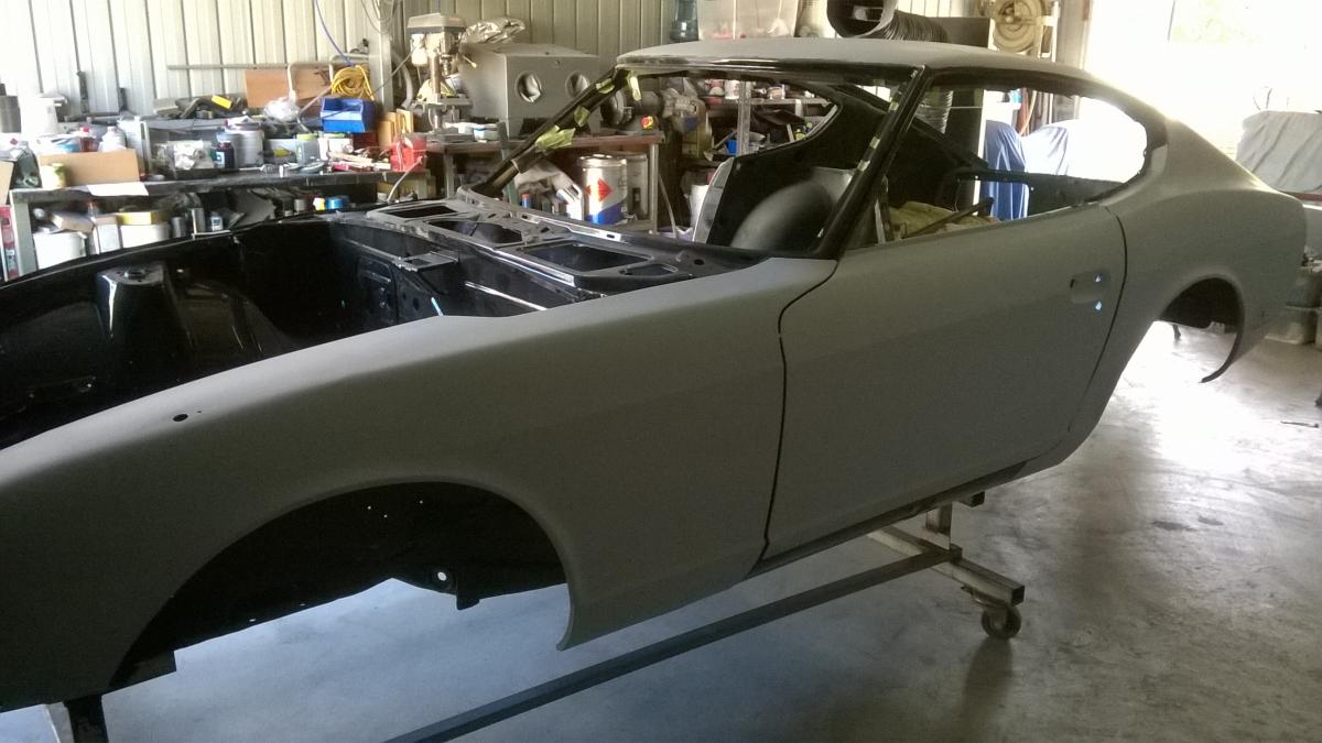

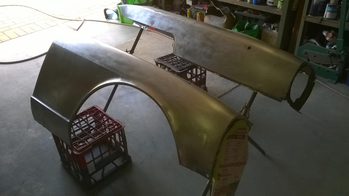

So I spent the weekend getting the front guards ready for primer and then primed them up.
I then mounted the doors and front guards up to see how the body alignment looks. Things aren't looking too bad, but I will work on the body alignment once all the hanging panels are in primer.

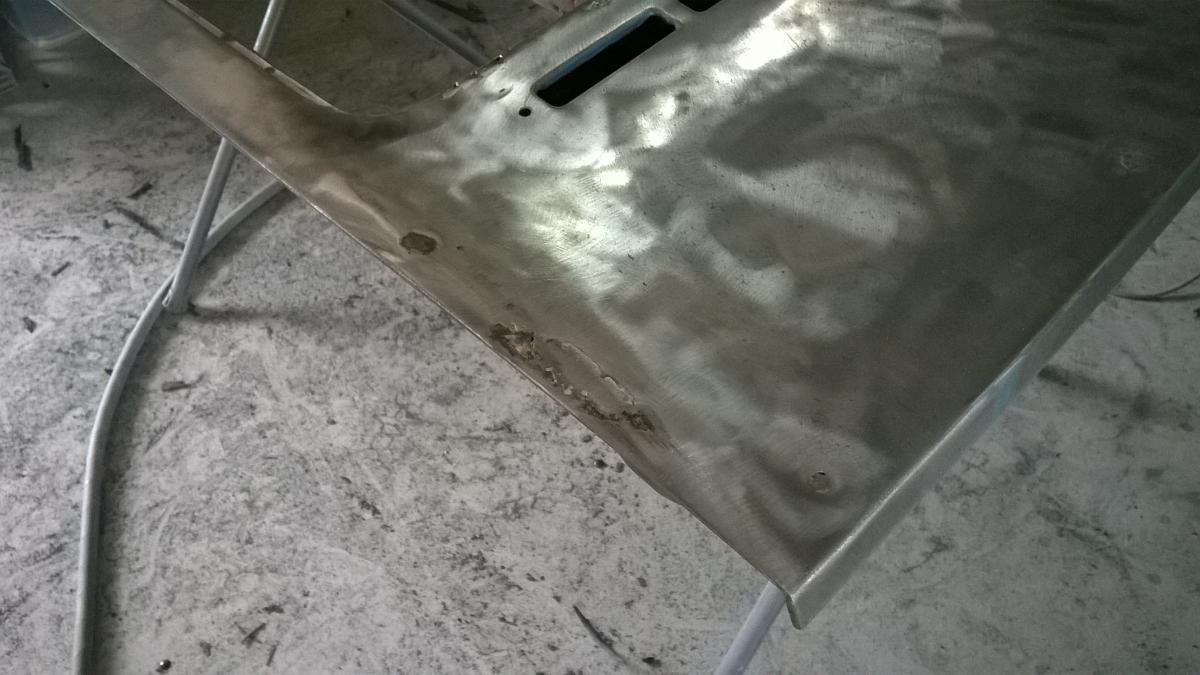

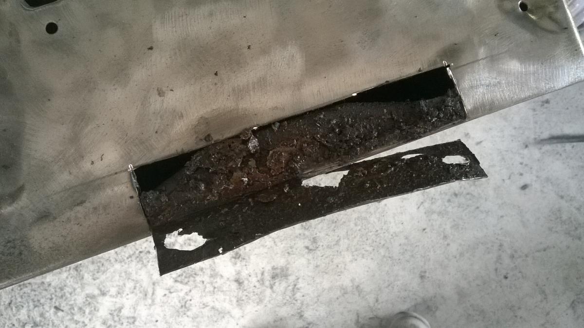

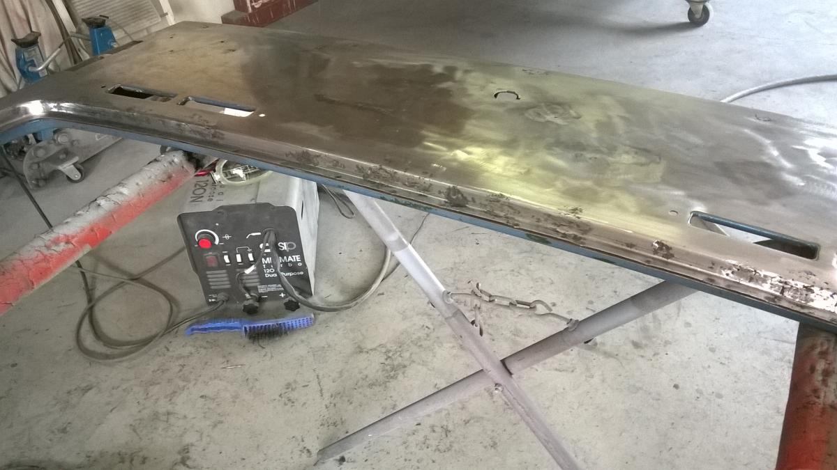

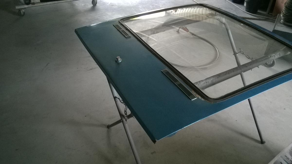

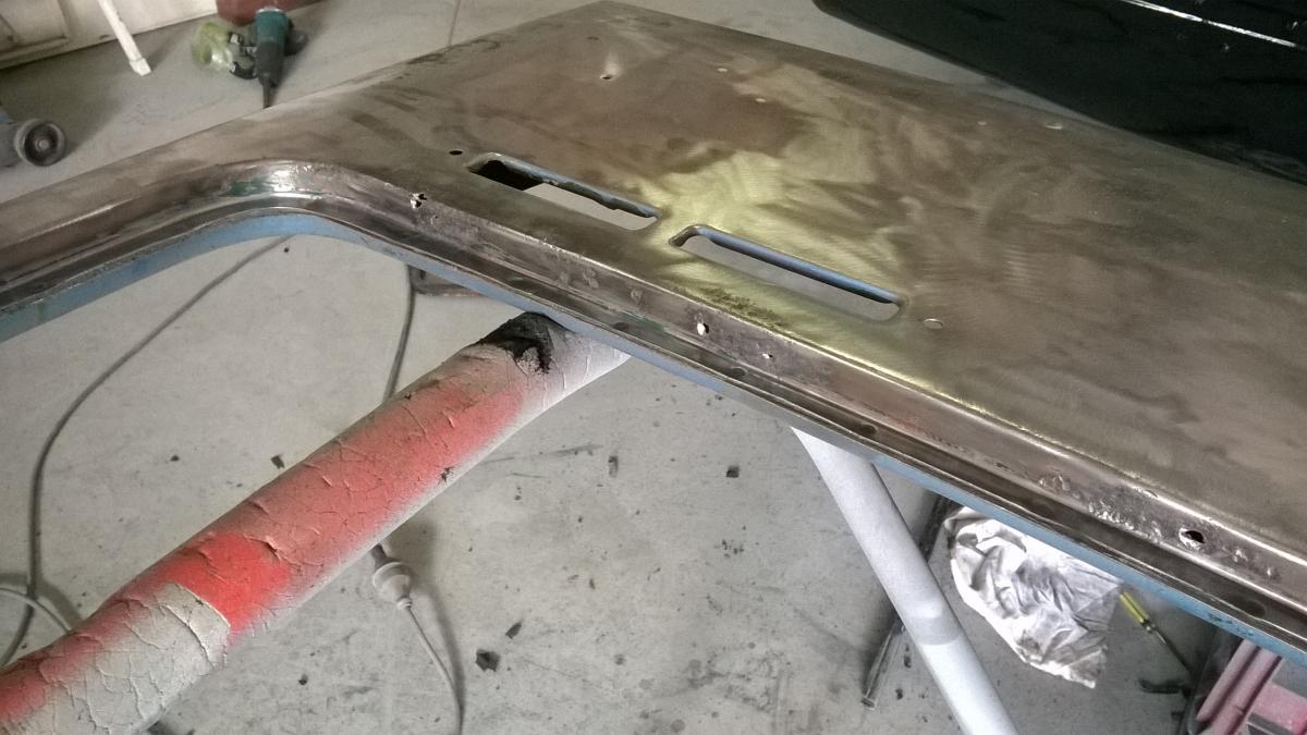

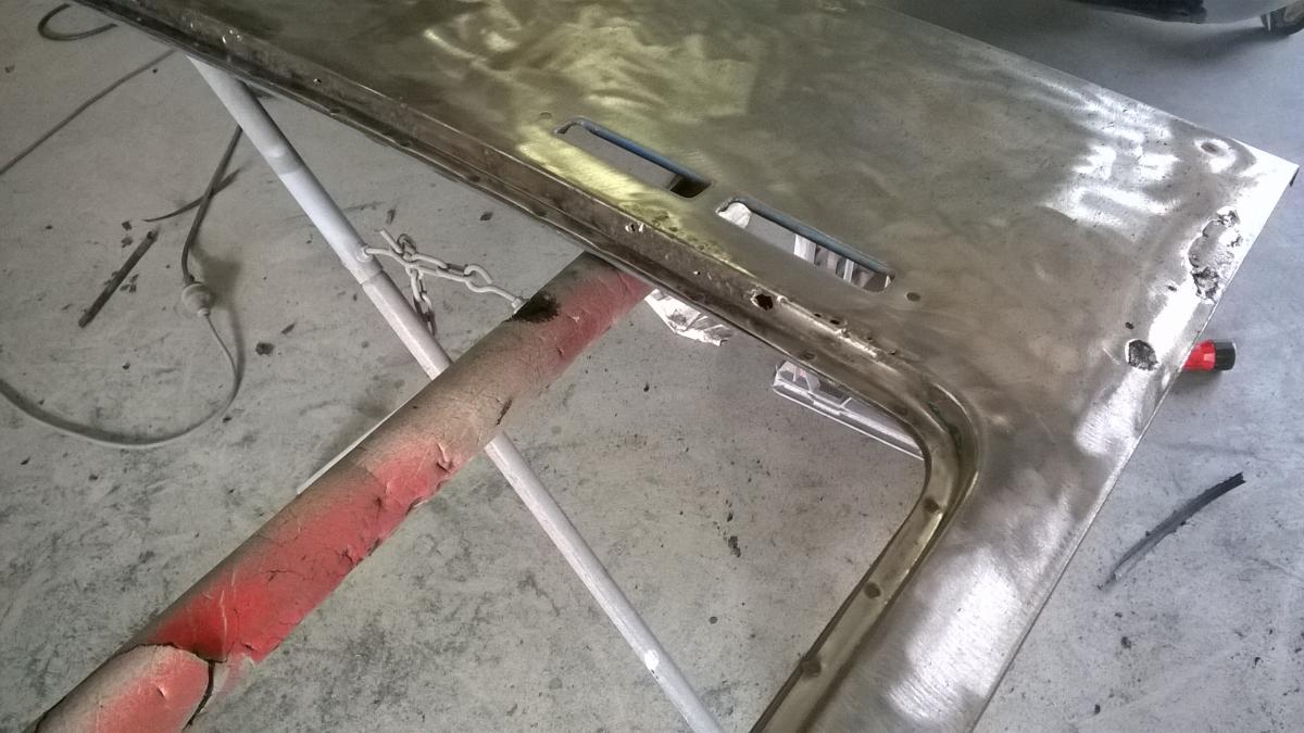

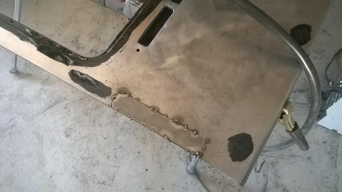

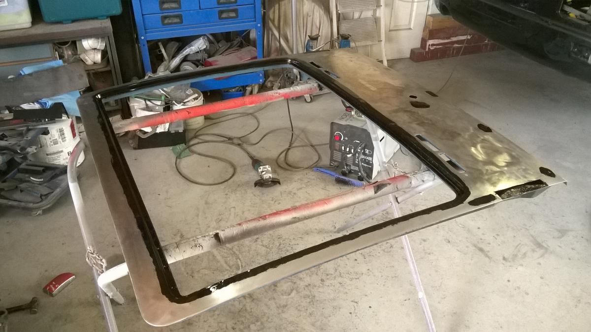

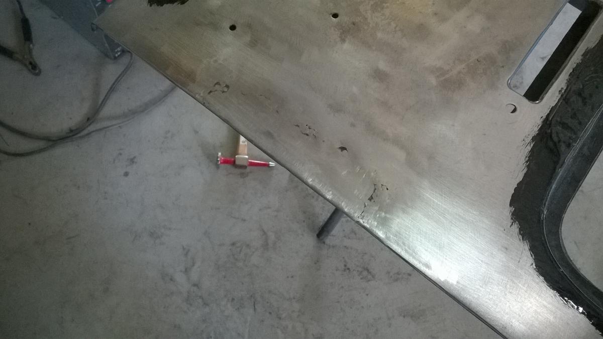

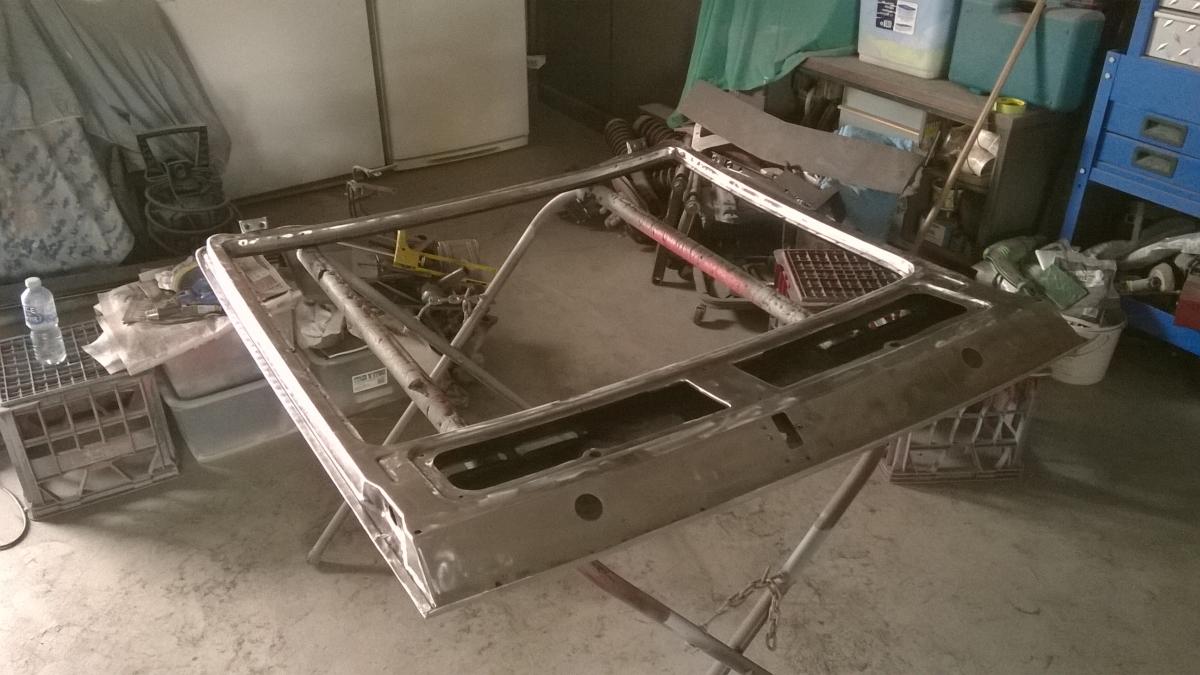

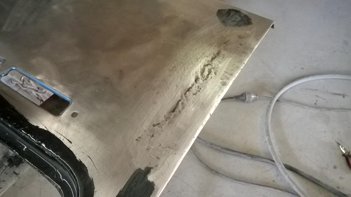

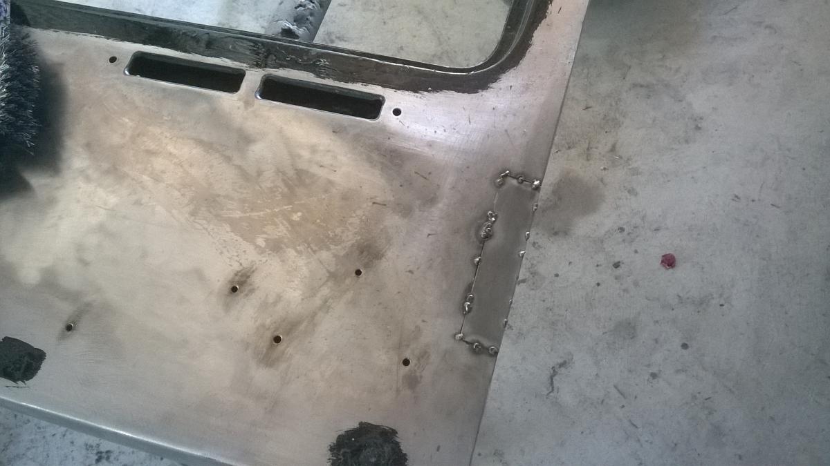

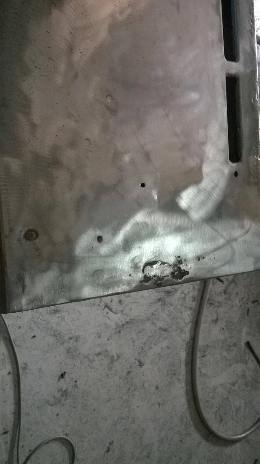

Okay update time. I'm onto the rear hatch. Who would of thought a series 1 hatch would have some rust issues, surely not. It would have been nice to do a Gav style repair on this hatch but some of us don't have the same tooling that is available in a TAFE workshop, Ha ha. So I gave it a Jeff style repair which should see it last my lifetime I expect. If it took 46 years to get like this I reckon it will last another 40 years being pampered from here on in. I will let the pics do the talking.
Haha way to make me feel like an OCD nut. Your hatch looked relatively good to start with compared with mine. I've got 4 early hatches all of them have taken some form of beating...filled with bog etc.. Your rubber seal must have been stuffed at some point to get the rust under the seal like that.
The hatch I'm repairing was all distorted on the bottom edge hence the decision to fabricate the lower edge. As much as it's taking me time, I have to say I enjoy learning this stuff. Get a lot of satisfaction out of it.

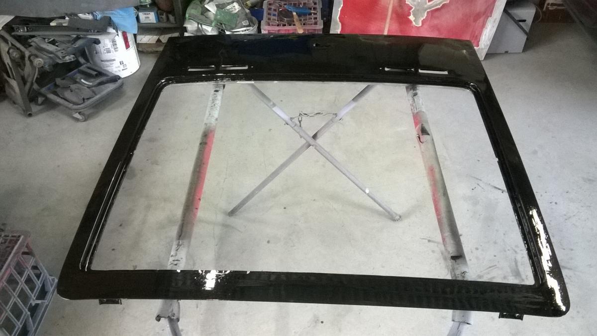

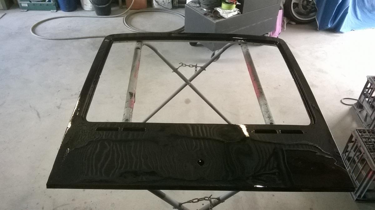

I had some family duties to attend to today, however I still managed to get a coat of KBS on the outer surface of the hatch late this afternoon. I plan on getting the rest of the hatch painted in KBS this week.
You do like that KBS!! Might start using some my self soon.
Must have been a day for gathering brownie points.
Jeff
Any part/panel that I'm worried about maybe rusting again I like to lock up in KBS. To be honest it also saves me having to get the spray gun out until later on as well, so good on that front as well. Brownie point day!!!! too true
Good to see you making more progress.
Sorry Gav, just a bit of tongue in cheek humour, you will have to forgive me. I find I have to draw a line on how far I go with body/panel repairs. It's hard because I really don't want to revisit any of these repairs in my lifetime, however I do want to drive the car and enjoy it in my lifetime - double edge sword really.
No hard feelings, Cheers Jeff
No hard feelings at all, my OCD is my own making. I have to try and stop myself sometimes. I totally understand and want to drive my car in the not too distant future also. But I also know that if I don't fix things a certain way and paint goes on the car I'll always look at the flaws. :).

MmmmmmBEER! My car was an 1800 can car, not that I was counting, what's yours going to be? Looking good Jeff, the hatch is not so easy is it because the metal stretches when you weld it causing the skin to bow requiring shrinking and you can't get to the back easily. You make it look easy but I reckon you would have had to stuff around a bit to get it back into shape after welding the patches in. Keep up the pace mate and you'll have it done before those ankle biters start Saturday sport. Ahhhhhh!
