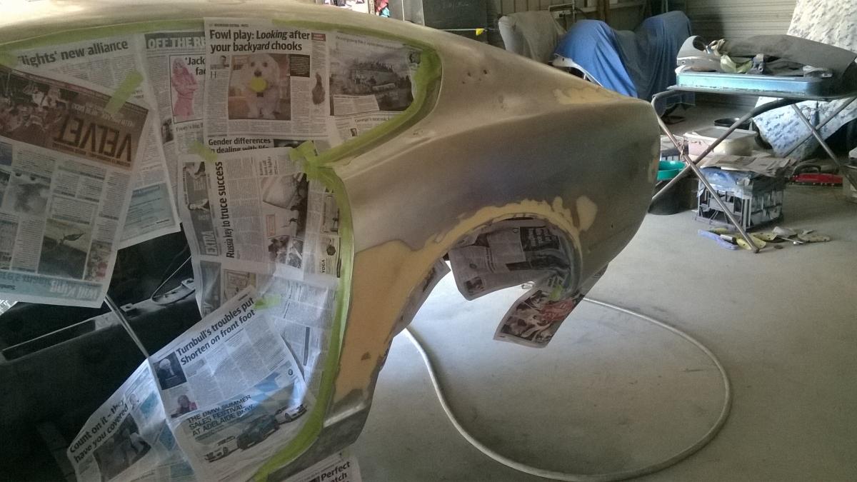

Been a bit slow on the car of late as I have been doing some painting on a friends motorcycle parts to get some gun practice in preparation for painting the Zed.
I got a free afternoon on the weekend and spent the time filling in the hole where the radio antenna goes. There was also 6 drill holes in the LH rear QTR that I needed to fill in. They are in a straight line but I have no idea why they would have been there. Anyway they are welded up now.
No idea what those other holes were for, definitely not standard. Good work on filling them though.

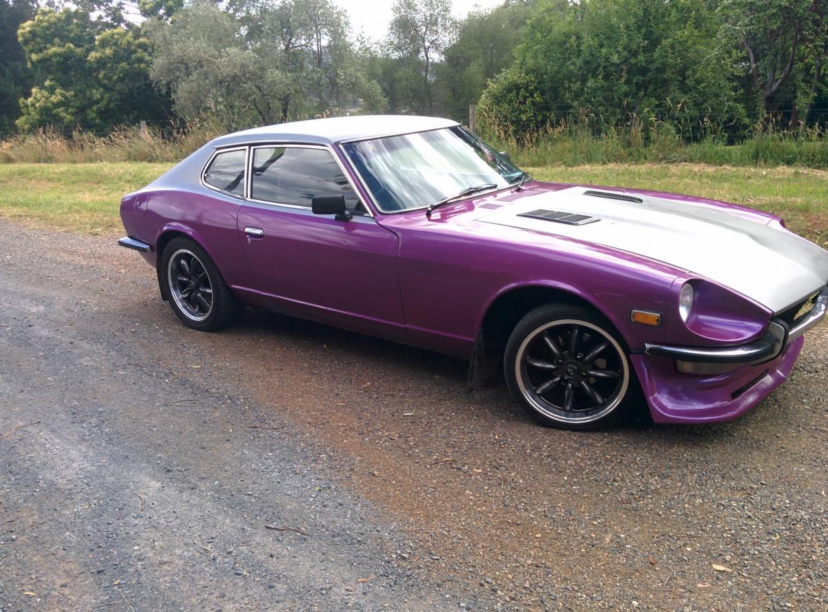

Thanks for that, you are a genius Taylor. I had never seen one with a vinyl roof before but google was my friend and you are absolutely right.
Looks like there was a couple of styles as well
So horrible, I once looked at a wine red 260z 2+2 with a black vinyl roof. About 16-17 years go now. The car was ok but the reason we didn't buy it was because of the vinyl roof :). I wonder which dealer was responsible for it.

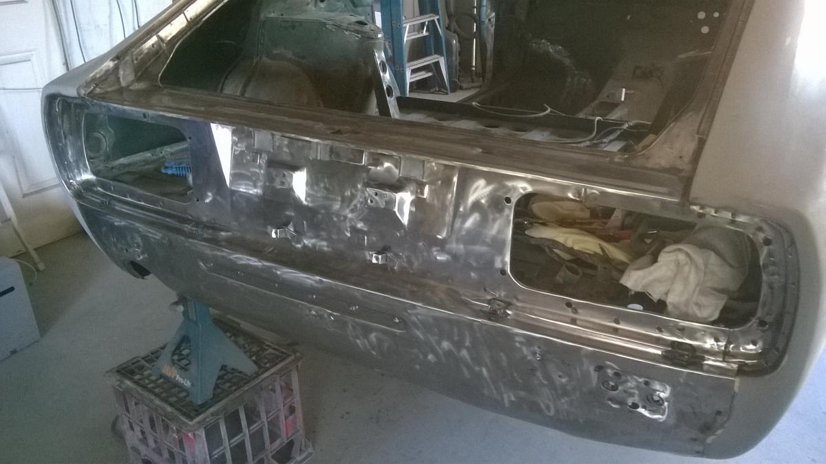

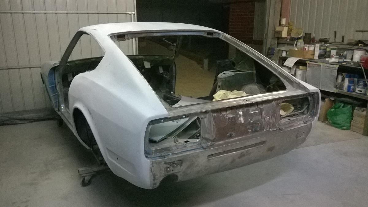

Hi All,
I like to think I've had a productive week on the car. I  will let the pictures do the talking.
Finished the day off on a good note.
It's looking fantastic Jeff! If it was me and had my z down to bare metal like that I'd probably just clearcoat it so I could truly enjoy that rust free goodness

Hi Jeff
A most productive week indeed, and heading in the right direction.
The body is looking good.
PB
Hi Jeff
PB

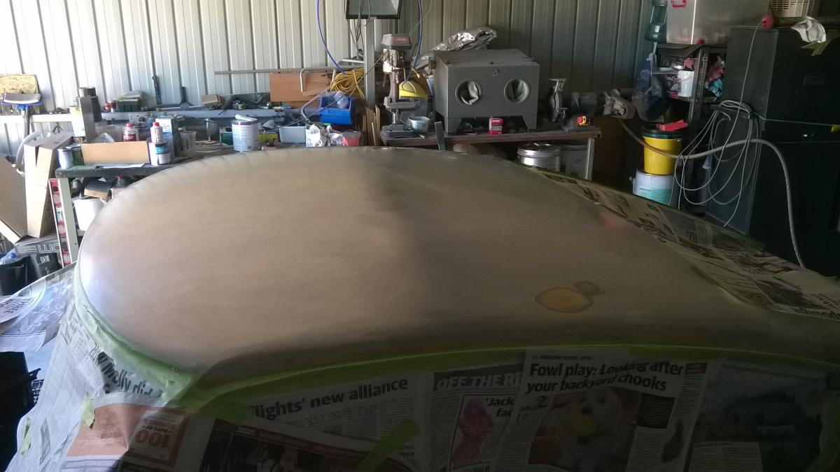

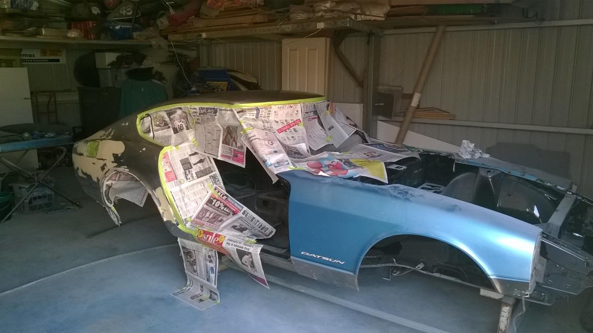

Thanks PB, feeling pretty good about how the body is turning out.

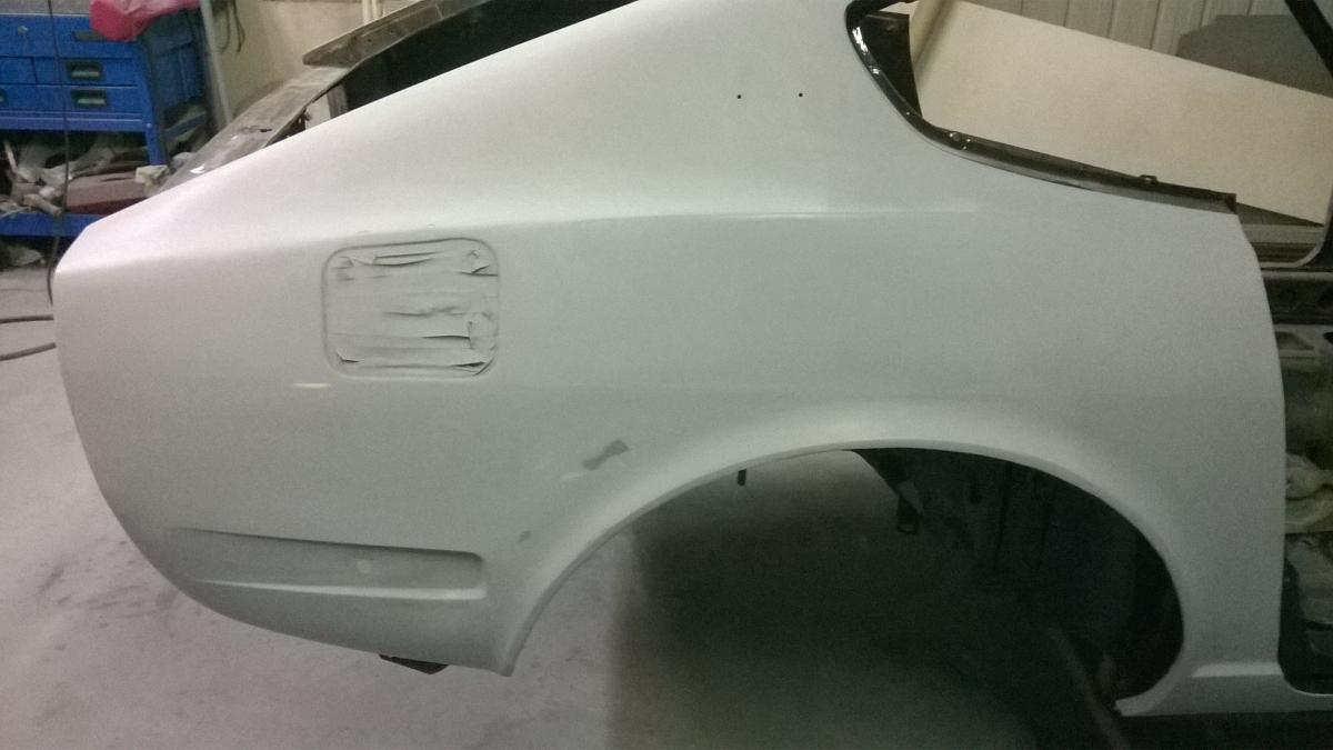

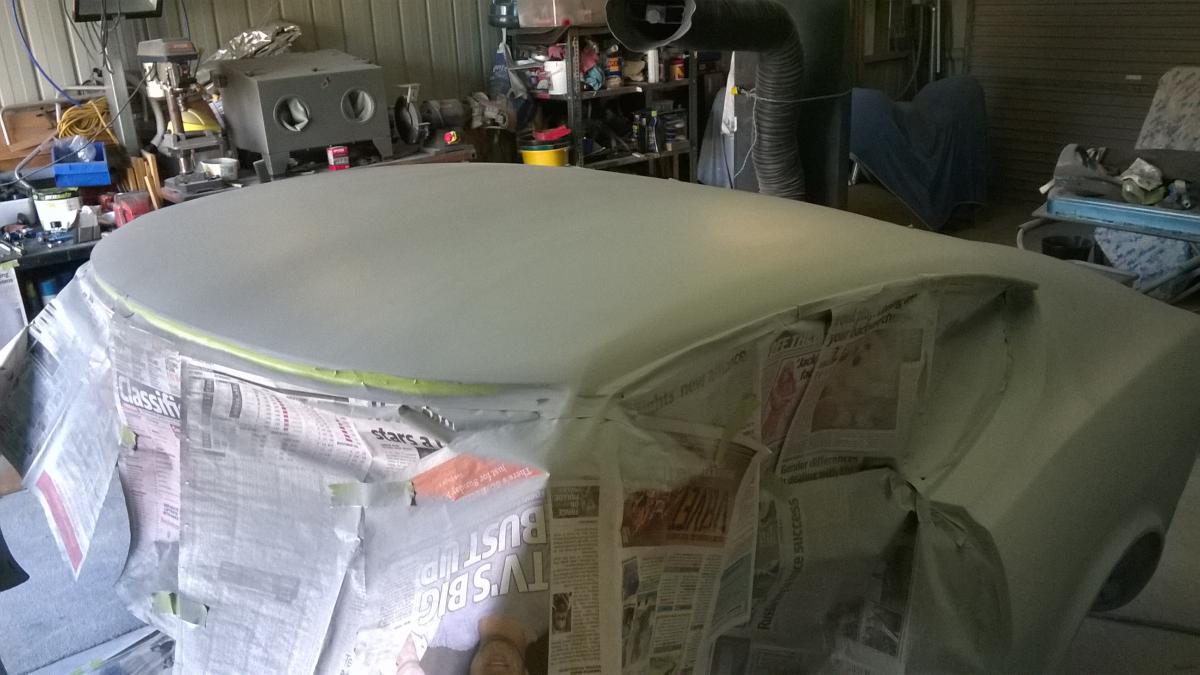

I took all of the taping up newspaper off tonight and gave it a quick block down rub where I have a few imperfections and it looks like 90% of the imperfections will block out in the DTM primer I am using.
I will try and get all of the seam sealer work around the hatch slam panel and roof seams, then finish all the metal prep work around the tail lights and hatch area and hopefully prime all that this weekend.
the LH rear quarter lines are nice and sharp as it was in good condition under the previous paint. The Rh rear quarter is not so good and it will be a challenge to get the body lines just as sharp.
Jeff
Nice work Buddy, to get the lines right, load up more primer on the lines, afterwards, triple tape below the line and use a black guide coat and at 45 degree strokes towards the tape line block the primer back.
Then tape above the line again and again 45 degree block stokes to the tape line.
Once you are done you should end up with a black guide coat pencil like line.
Gently work over it with a soft block and you should end up with a perfect line that you can feather to the correct contour.
Jeff
Thanks for the tip John. I will try it out shortly and let you know how I get on.

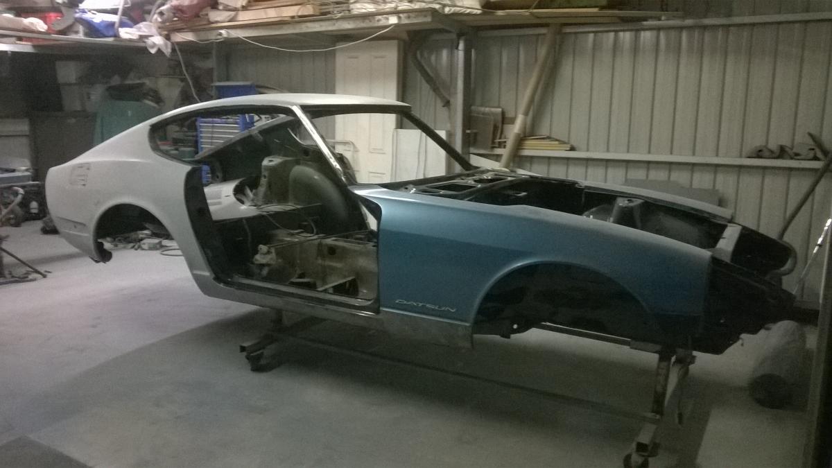

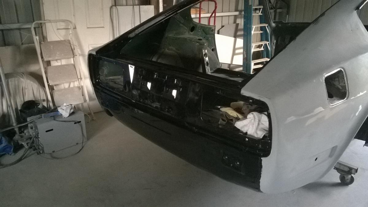

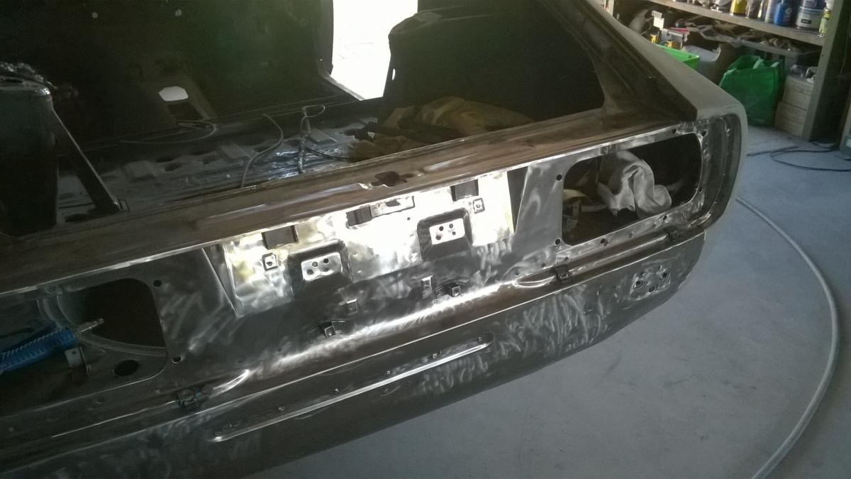

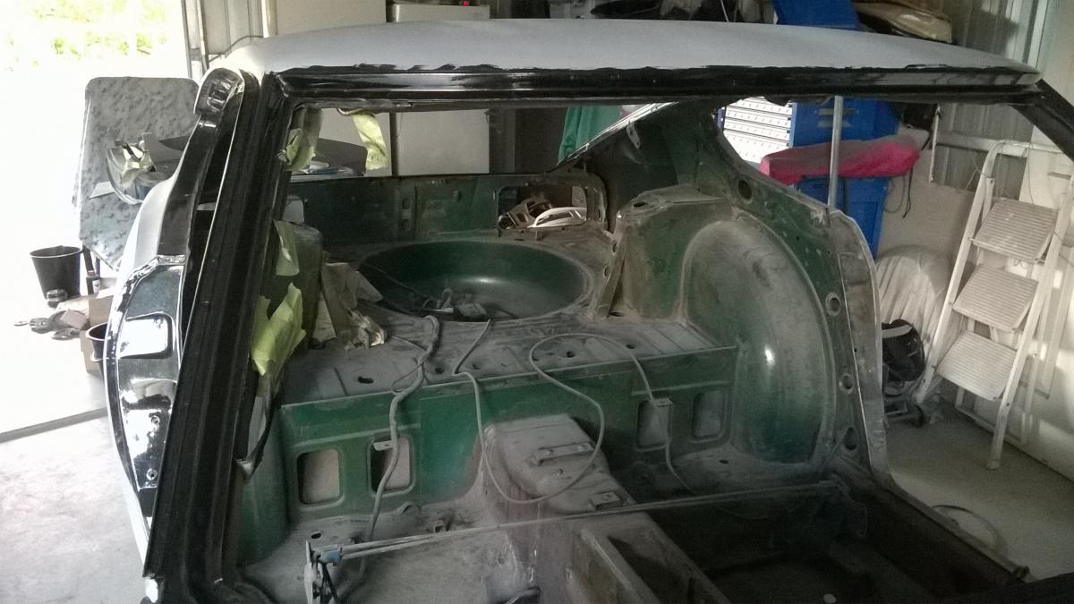

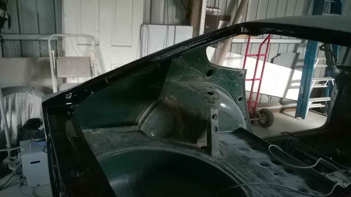

Update time. So I have been getting the hatch area, the rear valance and tail light area, the area around the front windscreen and  the roof channels all back to bare metal and prepped for paint.
Then I got a chance to put a coat of KBS rustseal on those same area's. Did I mention I love KBS rustseal.

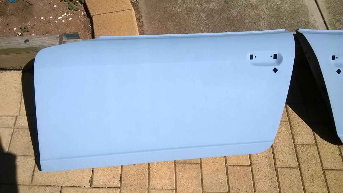

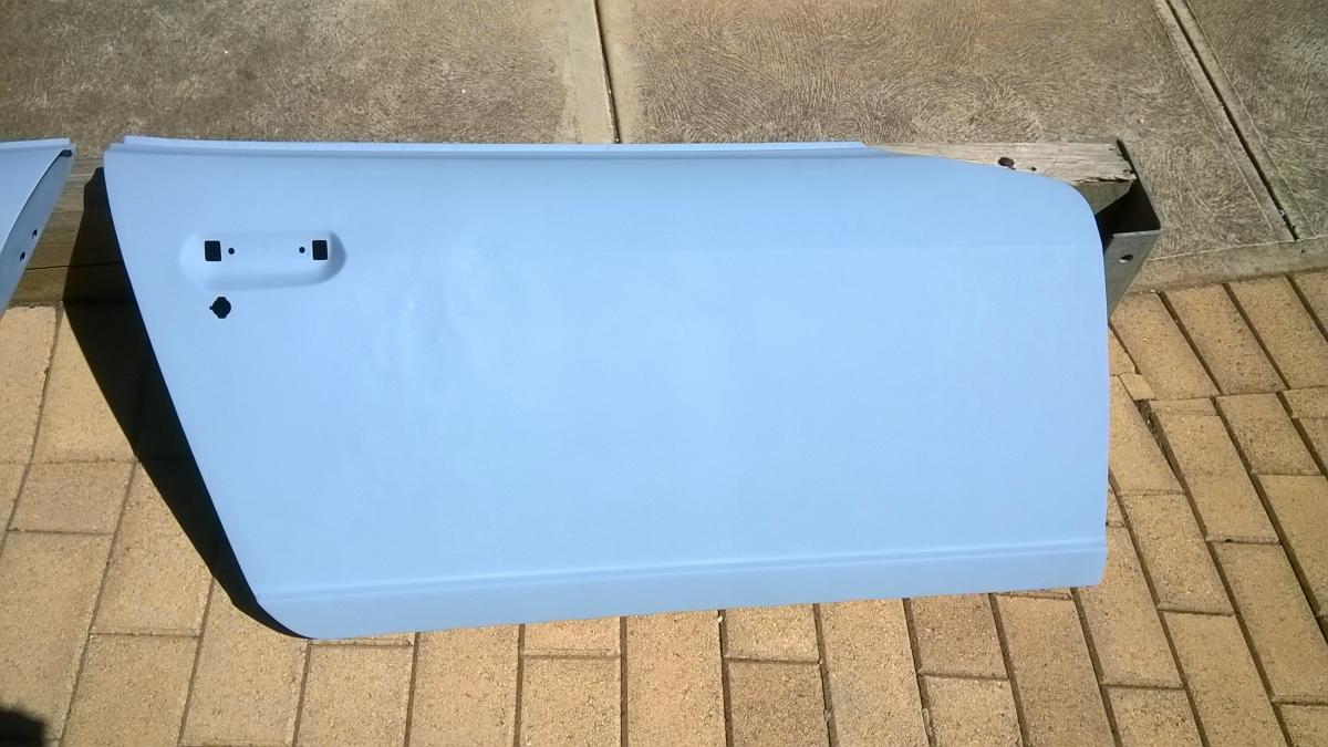

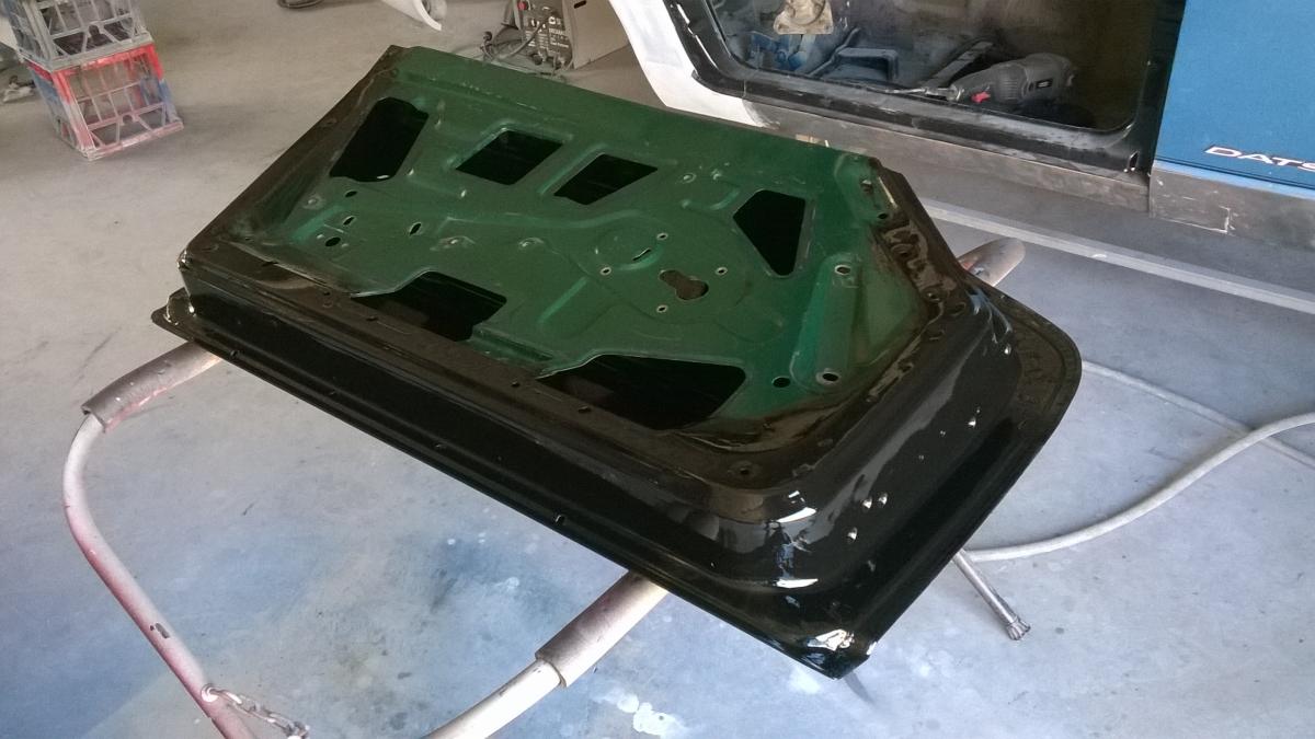

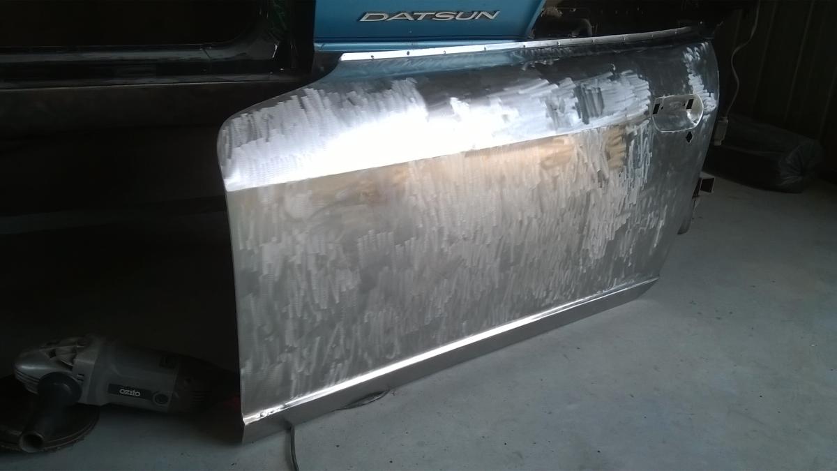

Hi All, It has been a while since anything of note has happened on the car. Last weekend I got the passenger door all prepped for paint inside and out.
I then painted the inside and frame in KBS rustseal.

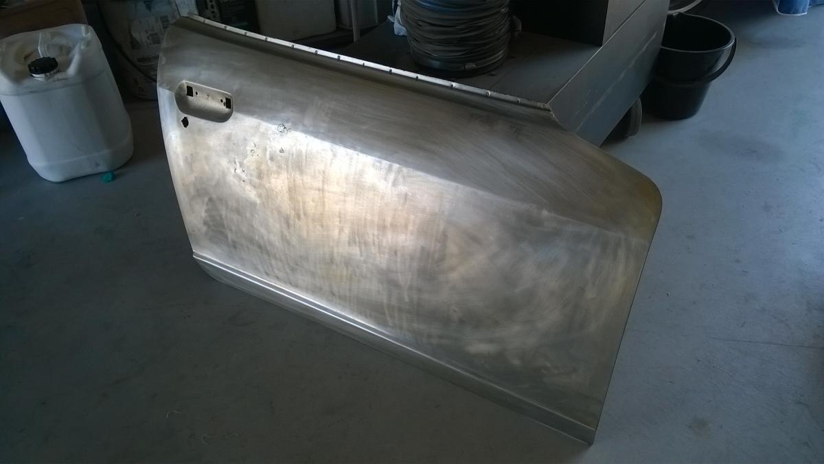

Then today I got both door skins prepped for paint.
Then primed them both up.
