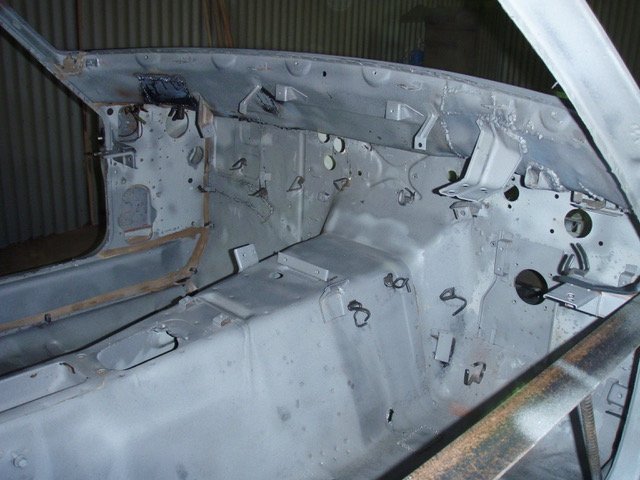

Andrew_L26 had the most liked content!

  • Birthday 11/07/1997

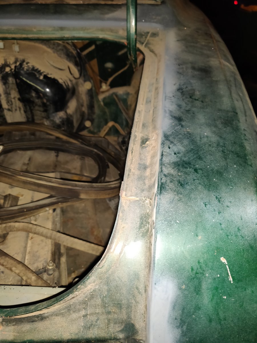

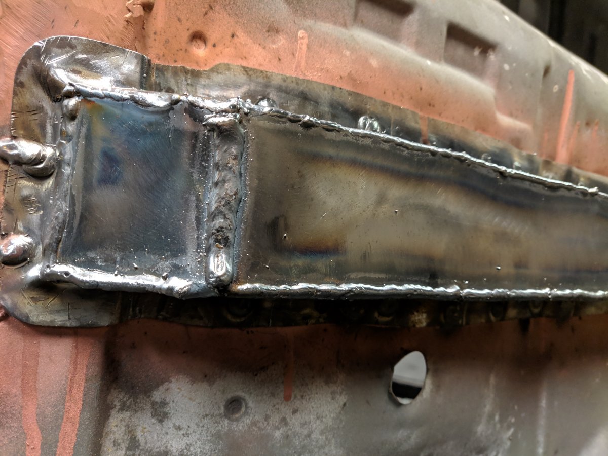

    That Purple Zed

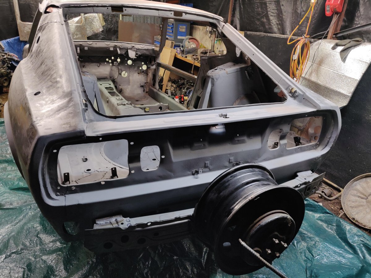

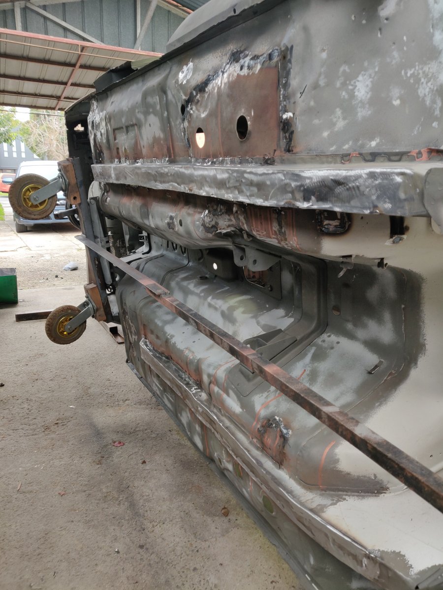

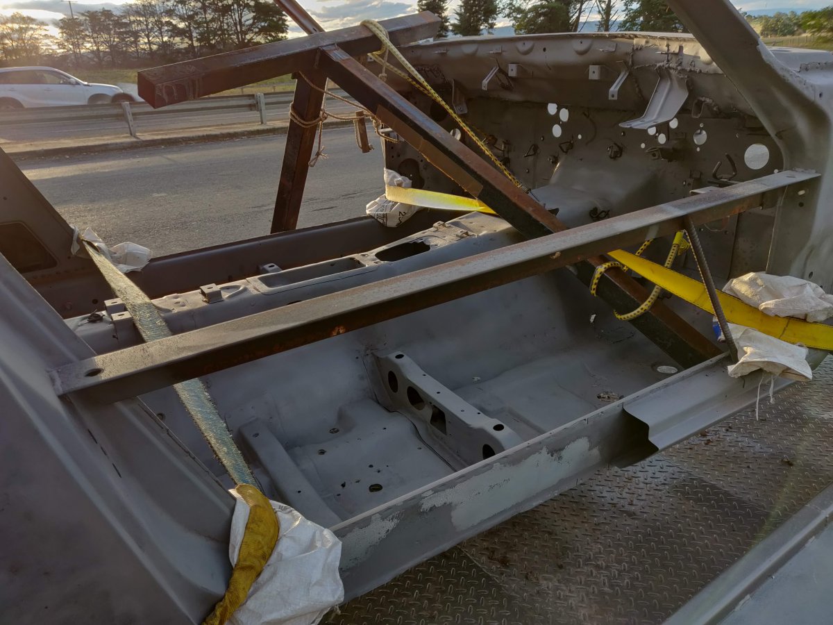

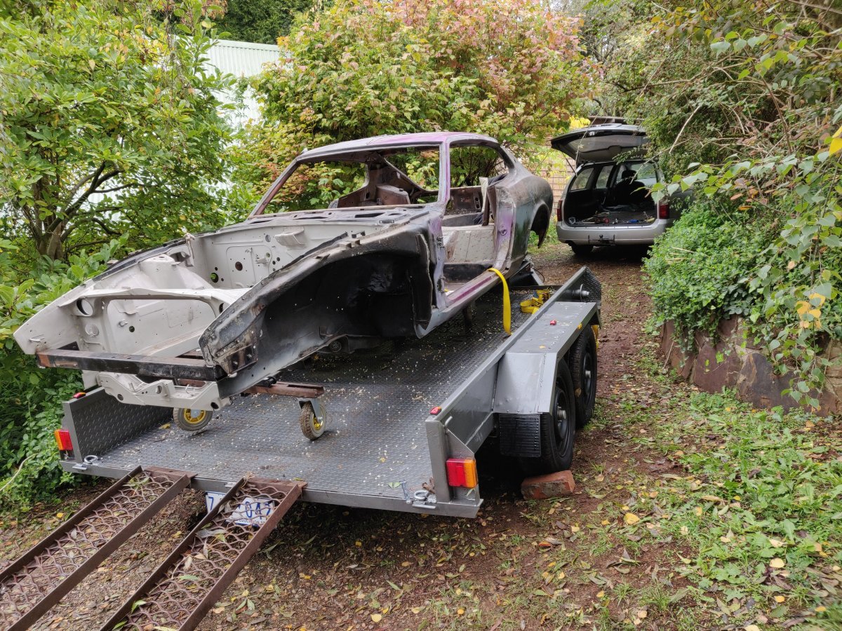

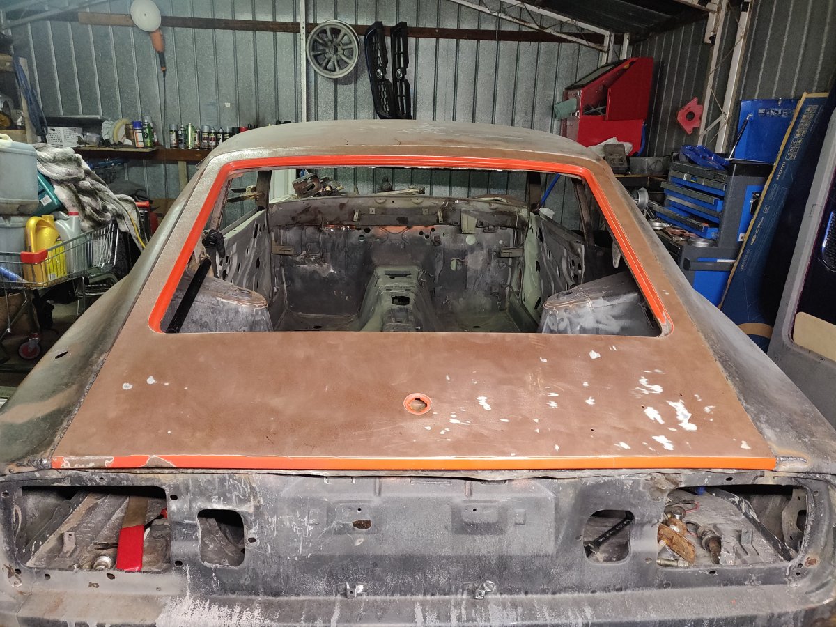

  1. So it's been a long time since my last post but the good news is that there has been an incredible amount of progress on the car. A few years ago I decided to outsource the body work as time and motivation wasn't on my side. Thanks to @datsunrally for the suggestion of Laurie Wilson, he has spent a vast amount of time on the old girl and has got her ready for final blocking and paint. There were a lot of issues with the car that I hadn't picked up on, the majority of which were introduced by previous bodgy repairs as well as a few that I created myself. A new (to me) bonnet, guards and doors moved the project along significantly! Nevertheless, after many hours from Laurie, the car is looking very sharp and is booked in for final blocking and paint in Feb of 26. In the meantime I'm doing the things I enjoy on the car, I've got a CD00X gearbox from a 350z that I'm rebuilding in preperation for the Godzilla Raceworks adaptor kit to allow me to run the newer, stronger 6mt behind the L28ET. I've got the dash booked in to get reskinned next year through dash doctor and I'm currently in the process of stripping down the suspension for powder coating, including redoing the front suspension, the septone chassis black did not hold up well after 8 years in storage. Plenty of other things have happened in the last 5 years, I've managed to establish myself in the automotive engineering field working on some pretty exciting projects, my partner and I purchased a house about 18 months ago (in similar condition to my old datto with it taking up most of my time!) and I've had a bit of fun with other cars (and a tractor!) She's ended up with a bit of filler in her but nothing too crazy, very keen to get her back on the road and put some down some KMs. Also, by chance I met up with some friends at Lindsay's old warehouse which is now a brewery, I was shocked that there wasn't even 1 hotwheels S30 sitting around!

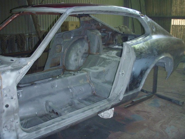

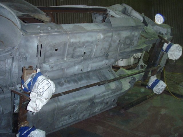

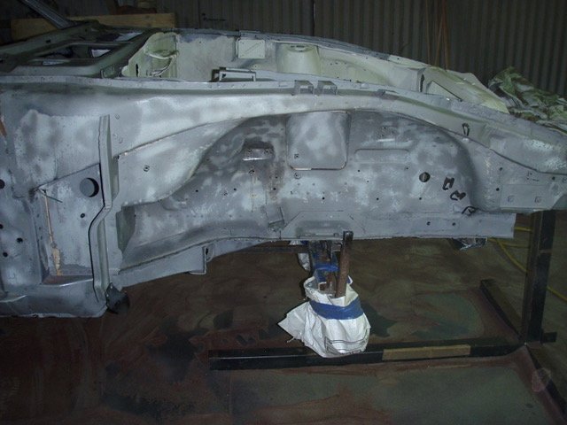

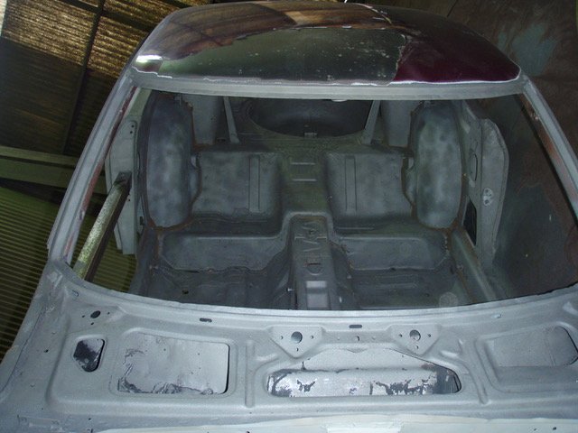

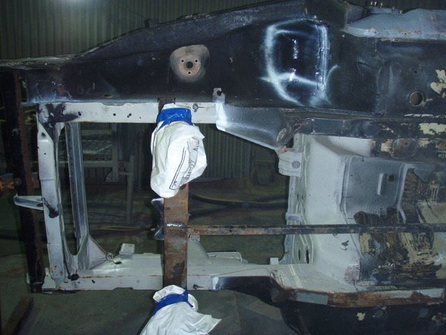

  6. Hi all, I've been working on my zed for many years and I have finally decided to outsource the final bit of work to a workshop/individual. Unfortunantly I don't have the time or motivation to finish it off and would rather just drop the cash to get it done. She is currently in bare metal with the floor pans all sorted (car has been on a rotisserie & sandblasted inside and out, doglegs, lower rear 1/4s all repaired. The doors have also been repaired however they had been absolutly caved in and warped badly, I did spend a lot of time straigtning them out but they still need work, some of the rust repairs are a bit hows it going too. The hatch is about as good as they come, one minor ding on the outside, hardly any rust showing through but a bit of the flaky stuff on the inside. There are some areas that will probably need to be redone/touched up. The rear roof frame has been completly replaced however the hatch alignment needs work with some shims etc. to get it to align perfectly. I am hoping to keep the cost of the work under 15k, I am just wanting to get the body painted and returned to me on a stand (the same way it was delivered but just painted) I'm not after a concourse resto but I also don't want something that I look at and can see sanding scratches under the paint, low spots etc. The guards are fiberglass which have been gapped (roughly) amd repaired. I plan on purchasing either a composite bonnet or a repro one as my current one is full of bog and I don't even want to deal with it, plus I want to keep it for my wall! I have attached some photos of the state of the car as it is at the moment. Not wanting for people to shit on the repairs I have done over the years either, I understand that some will need to be redone but you do have to remember that this was a 3500$ car when I got it and I was just a broke teenager trying my best. The worst of the repairs are up under the dash, the back of the roof is slightly warped, mostly from a previous repair attempt by the previous owner. I would also like to work with a workshop/panel beater if possible, helping out where needed.

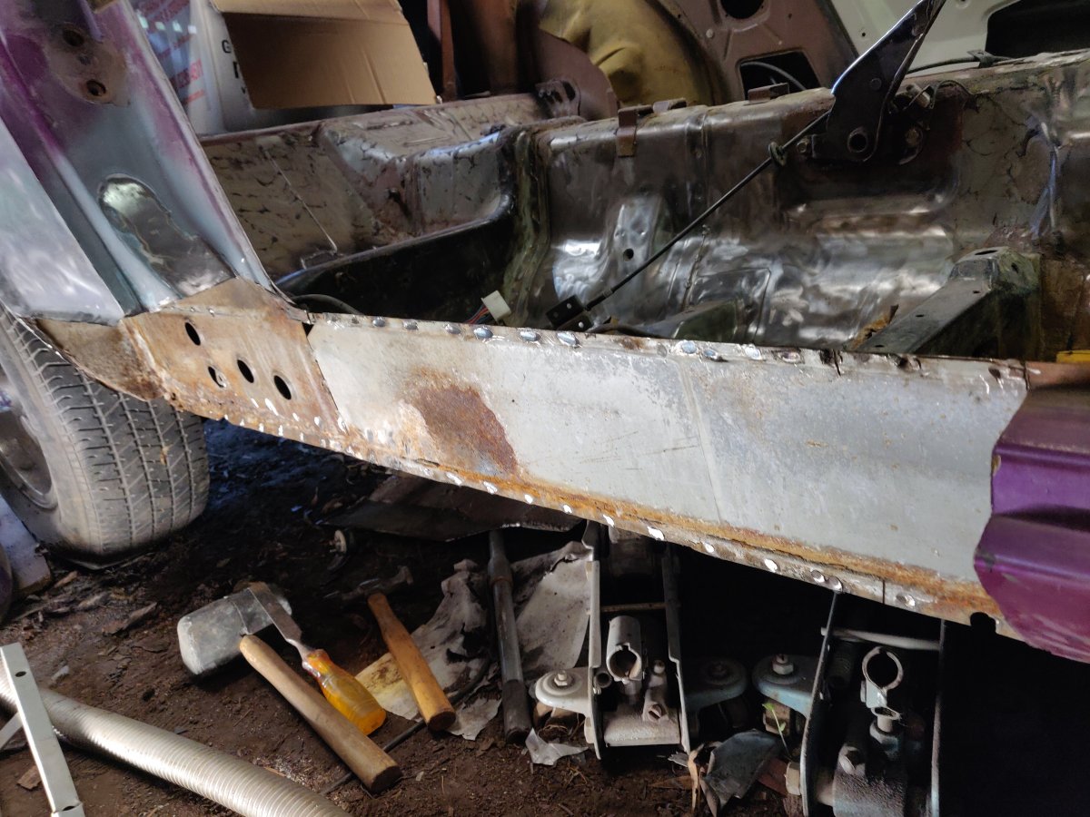

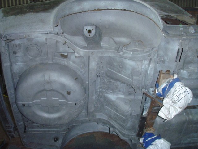

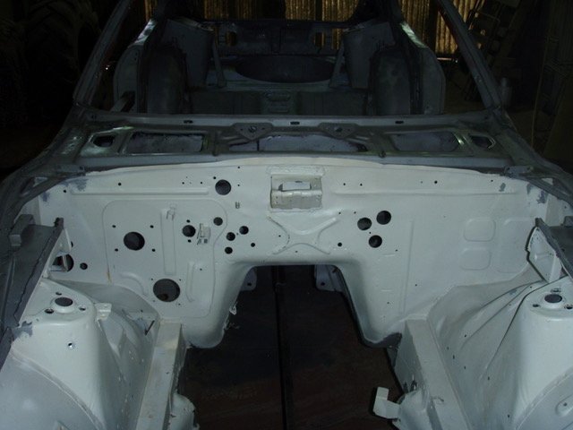

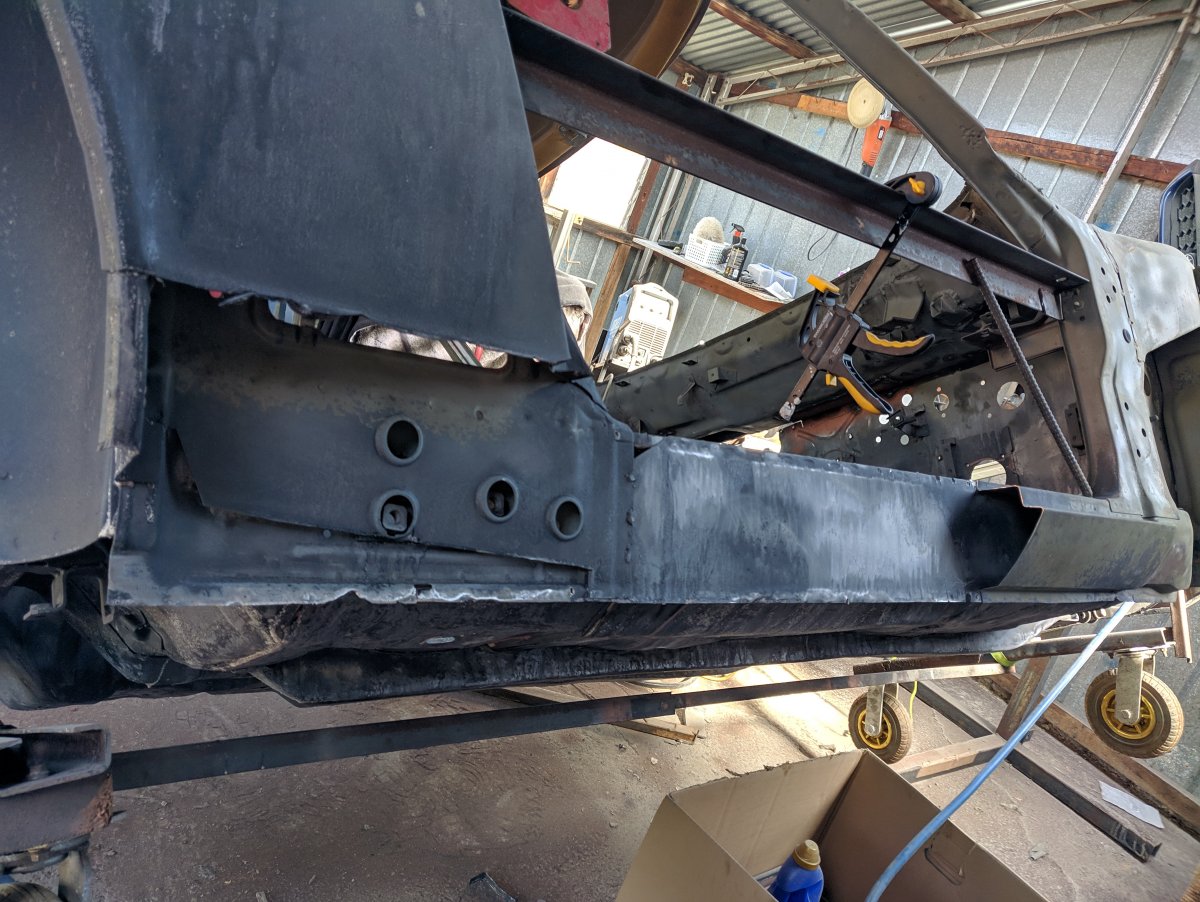

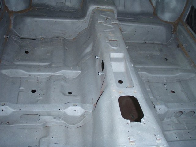

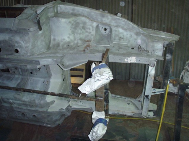

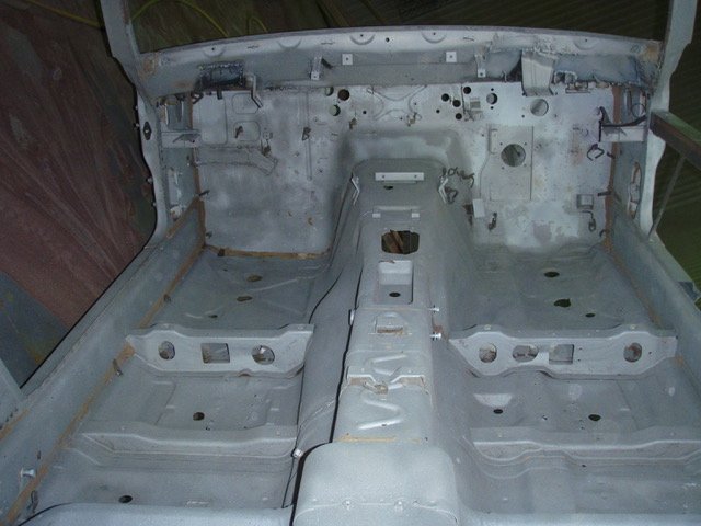

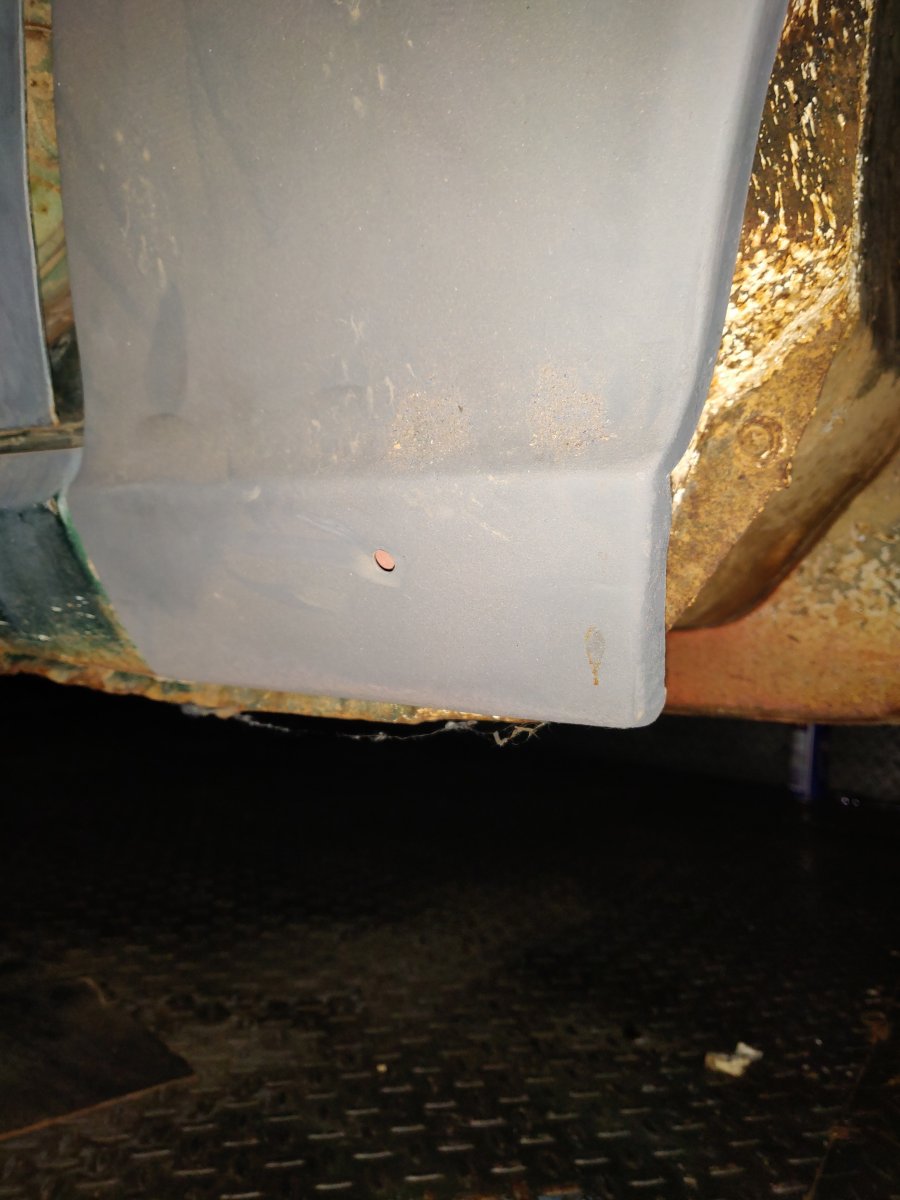

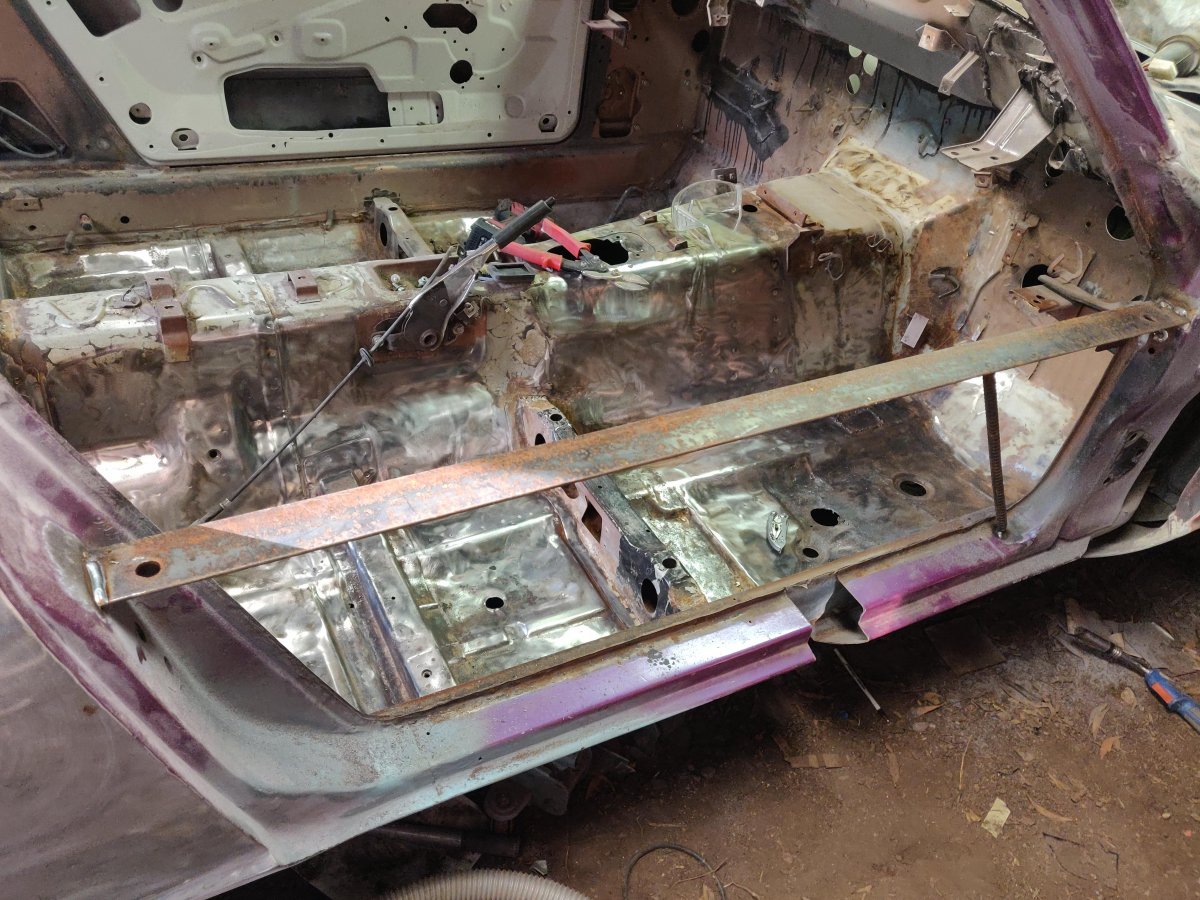

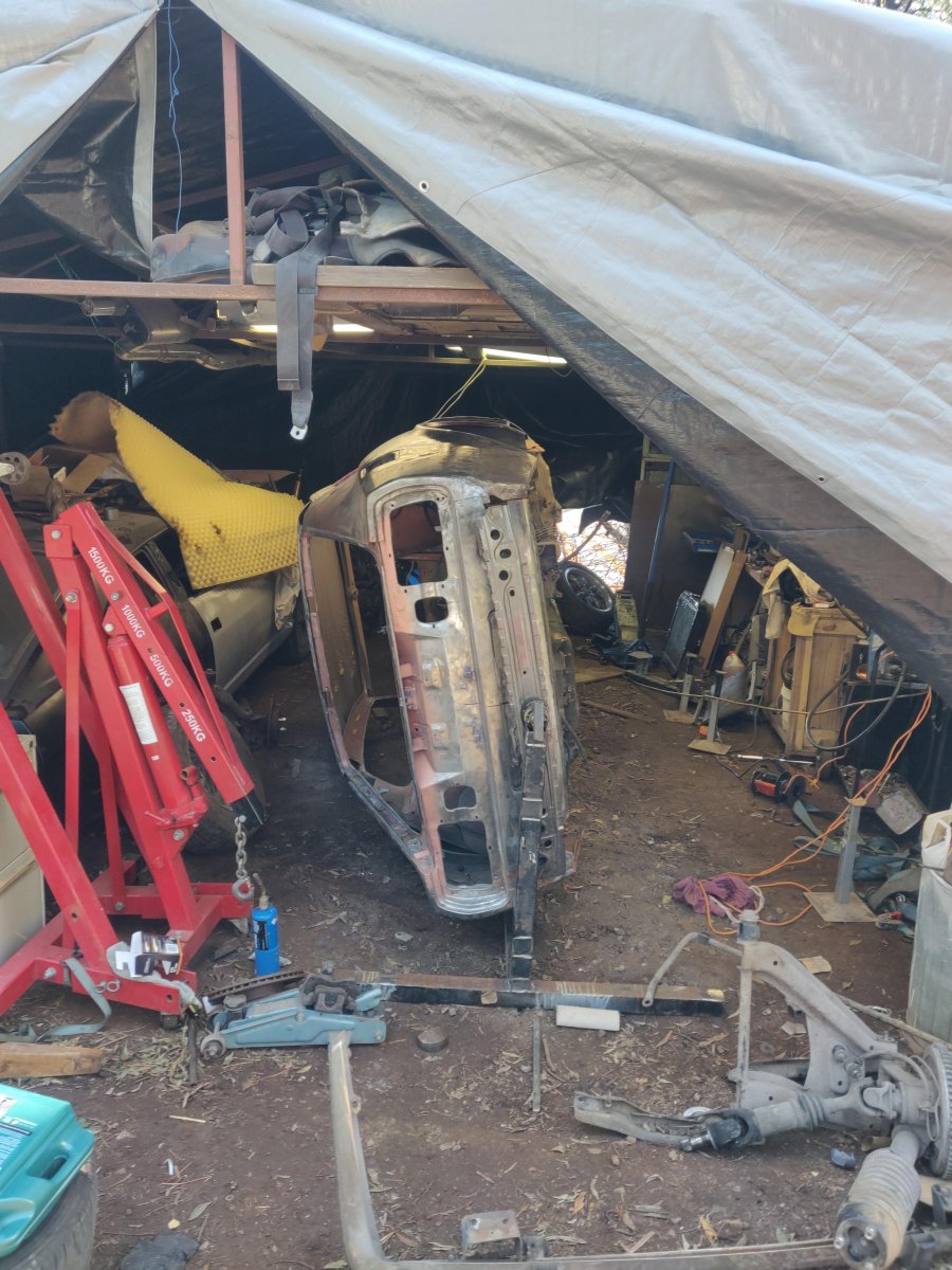

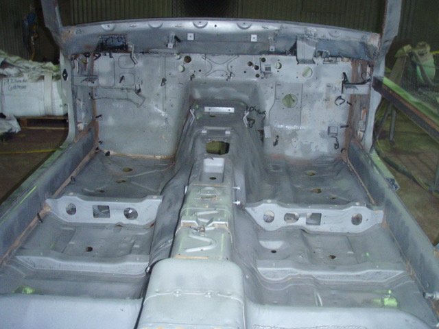

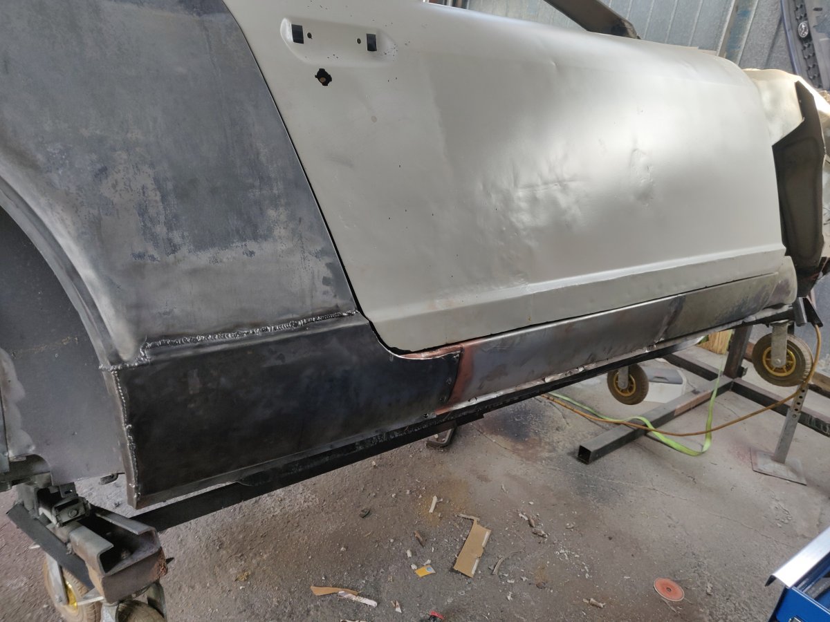

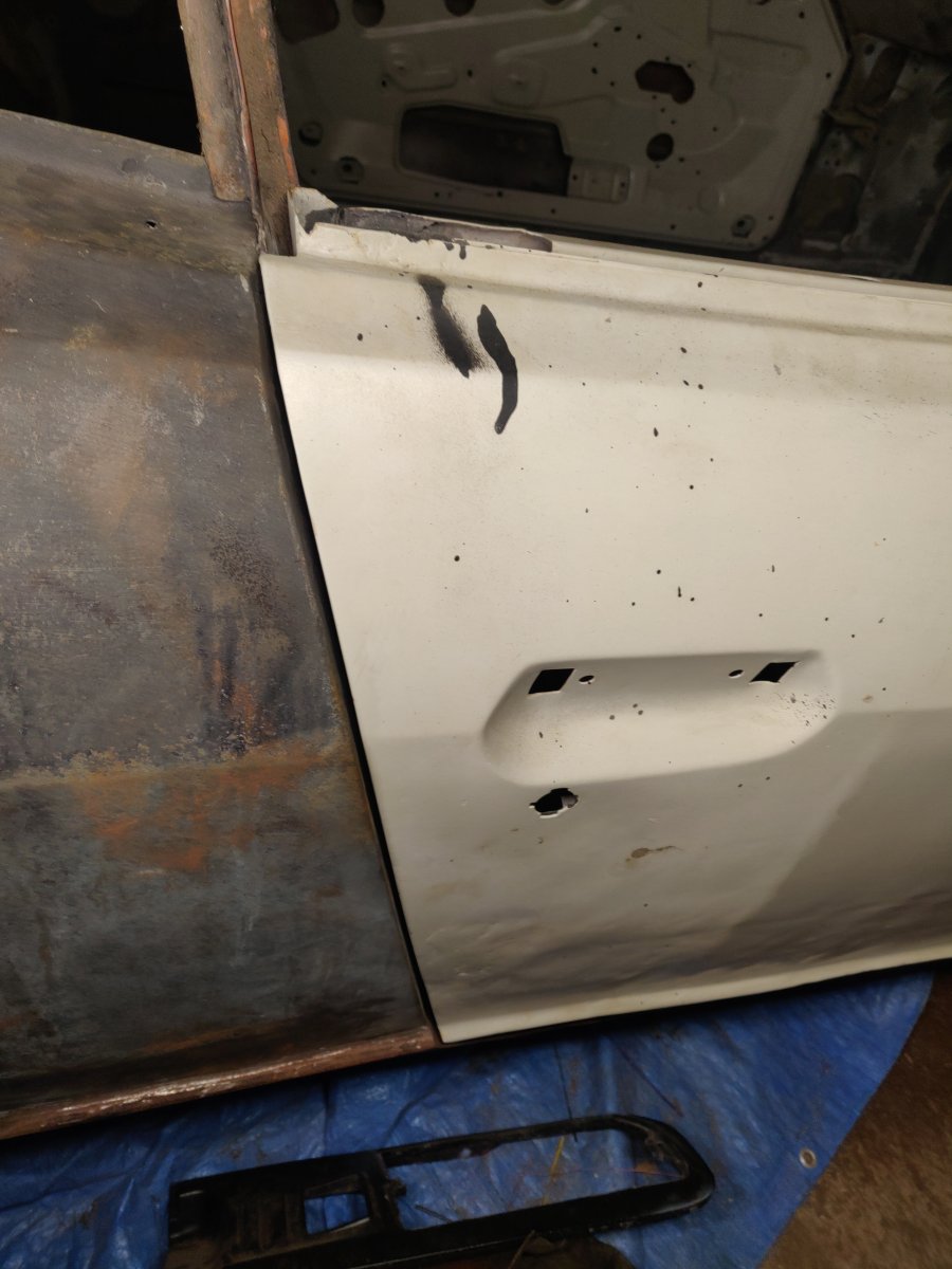

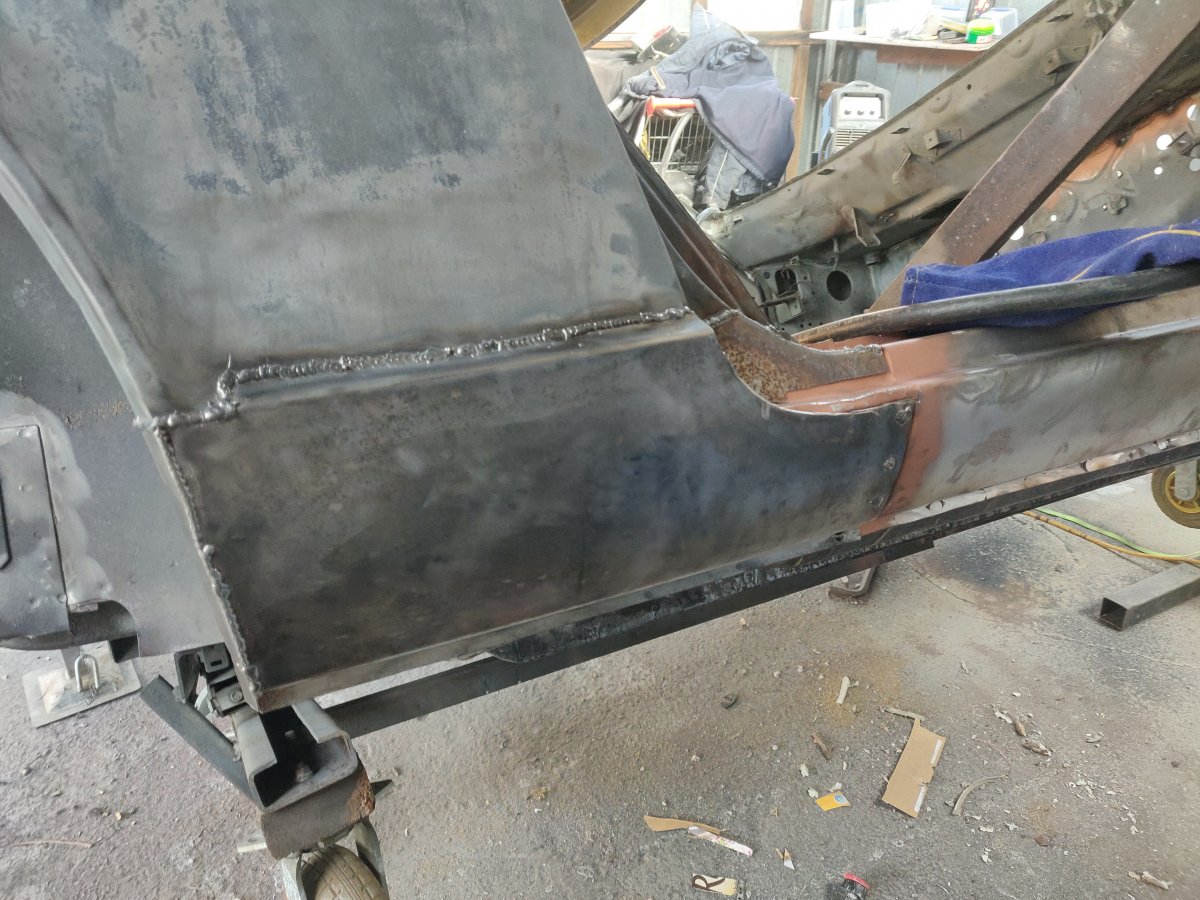

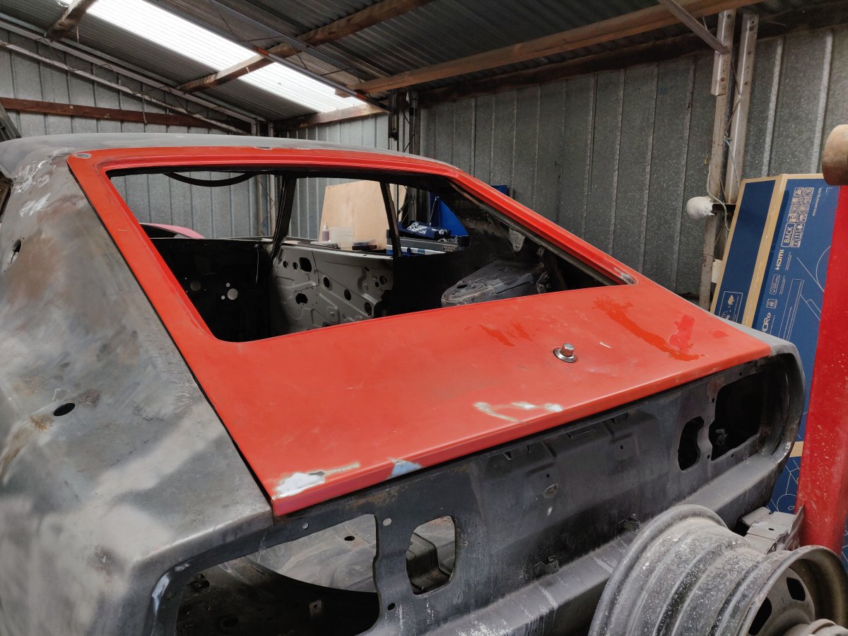

  8. So not going to lie I've been distracted with 90s jap cars, sorry but they dont rust and they are dirt cheap in comparison what can I say Anyway, I have done a bit in the last 12 months but not a whole heap. That being said, the car is pretty well as rust free as I'm going to get it. Floor pans are done, Floor supports are done, sills are done as are doglegs. Since my last post I've moved out of home into a propper shed (and a house of course!) On top of Uni I've been working a lot more than I have in the past leaving a bit less time to work on cars. (I'm lying and making excuses for not knuckling down and getting her done) Possums had decided to live on my doors, so I took them to the new place... Back to the zed! Got my mate around to smash out a bit of work! Got me back on track! Now I started to test fit doors to start ensuring that all the gaps were perfect (as perfect as they can be on these cars anyway) A bit of work was required around the dogleg area as it had been reconstructed from scratch. Scored myself a excellent condition hatch for $100, I knew it had a little rust and dings but it was in original paint so there were no surprises, which is rare with these cars The next major task was to get the hatch to line up correctly due to the MAJOR surgery where the hatch mounts and the fairly major work that has been done around the tail lights, remember this? I regret not making up a better jig before cutting out the roof frame but with a bit of pulling and beating the hatch fits nicely. I also had to adjust the corner of the 1/4 panels slightly with the welder. So as I said she has been a little niglected the past 7 months especially, I feel that I needed a break from the seemingly endless project so I decided to do a few smaller "builds" to get the satisfaction levels up and get away from the grinding and welding. This is what I've been up to! Purchased a 1999 WRX for a parts car to do a WRX conversion on my partners car (once mine and one of my best mates cars which we have a huge attatchment to) Engine is getting a full timing belt kit and seals etc. before going into the other car! Managed to fully strip it, keep the entire interior, all wiring and driveline (including suspension etc.) and still make $100 off the leftover parts! The shell was sold off to someone to re-use so it didn't even go to scrap! The next side hussle was a clean 1974 TA22 celica. The prices have been going up like crazy lately (not as much as the S30s but still a fair bit). I decided to get this one as it was the right price, only has very very minor rust (which I now know how to spot) but a bit of panel damage from being hit. Originally it was between a 260z 2+2 and a TA22 Celica, now I have both! Considering it has no engine I'm planning a high budget twin charged K24 honda engine, Failing the twincharging system if it proves to be too difficult I might go just supercharged but we will see. This will be my next major project after this zed is done and is currently in storage, I only cataloged the parts, gave it a good clean out, stripped the areas prone to rust and only found very minor rust. Toyota's designs were far superior in terms of water drainage etc. as well as a higher carbon steel being used so less rust!!!! The next car on the list was the old family car, 2008 toyota corolla with 330,000km on it (now my sisters) It hadn't had any of the suspension touched on it since new. So a full rebuild was in order, fresh bushes throughout, new balljoints, sway bar endlinks, brakes, wheel bearings, shocks etc. Drives like new! This was pretty much every bushing in the car, pretty rough for a 12 year old car! So the corolla was done! Next was to get my 1999 N15 Pulsar SSS Turbo engineered so I can actually drive it! After getting it defected driving it on my P's it had been sitting for about a year and a half. She was cleaned up and prepped for an engineering cert. The car was then dropped off at the engineer and $850 later all legit! Car was then re-registered and it is now my daily, boost controller and a few other mods to make it go like the clappers. My guess is probably 170kw at the wheels, enough to chop standard V8 Commo's and Falcons which is all I want from this nana car! Finally got the chance to properly decontaminate the paint and cut her back properly the other day. Came out pretty good for a total of around $4k including engineering. Also how good is this sticker! 5 stud conversion, R32 GTR brakes and genuine white TE37s. Just got to machine up a few custom parts before it's ready!. So after the Pulsar was engineered, a cheap 1998 WRX came up for sale, not running, the original plan was to part it out as the advert stated it had 370k on the clock. Well, turns out it actually only has 270k on the clock and it just needed the fuel system cleaned out and a fresh pump as it had been sitting for about 5 years. Decided not to part it out, pull the engine out, reseal the entire thing with a fresh timing belt kit etc. I'll eventually sell it but I'll get it registered first and enjoy it for a bit! The rexy is back up and running, just waiting for COVID to piss off before I can get it registered. The last vehicle I purchased was a ride on mower for $50, goes great! Also purchased a bigboy air compressor. I'm wanting to do my own sandblasting and there is nothing worse than running out of air! 42cfm! Runs a 3/4" airline to the sandblaster. Should be able to do whole cars myself now! And back to the zed if you're still with me! I appreciate it if you are! (yes it looks a little sad but the gaps are spot on!) I've finally got my motivation back for the Purple Z, apart from doing a few things on the Pulsar and getting the WRX registered, this will be my focus! Hopefully it will be done one day?!

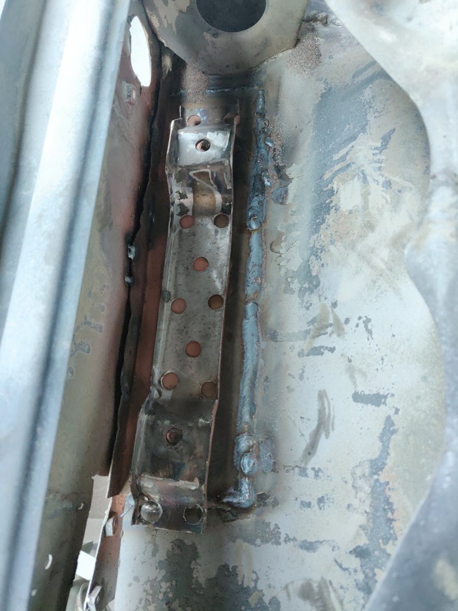

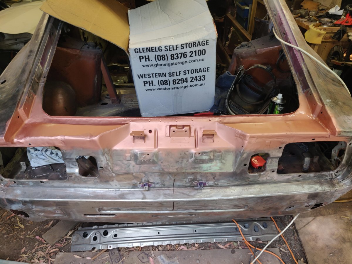

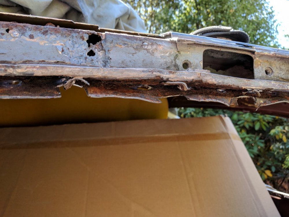

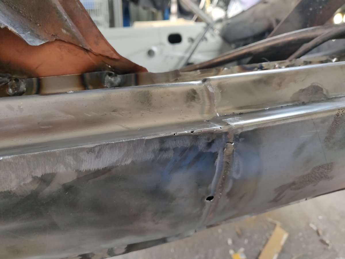

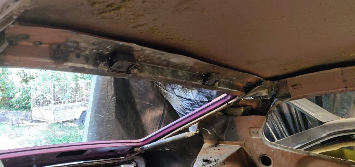

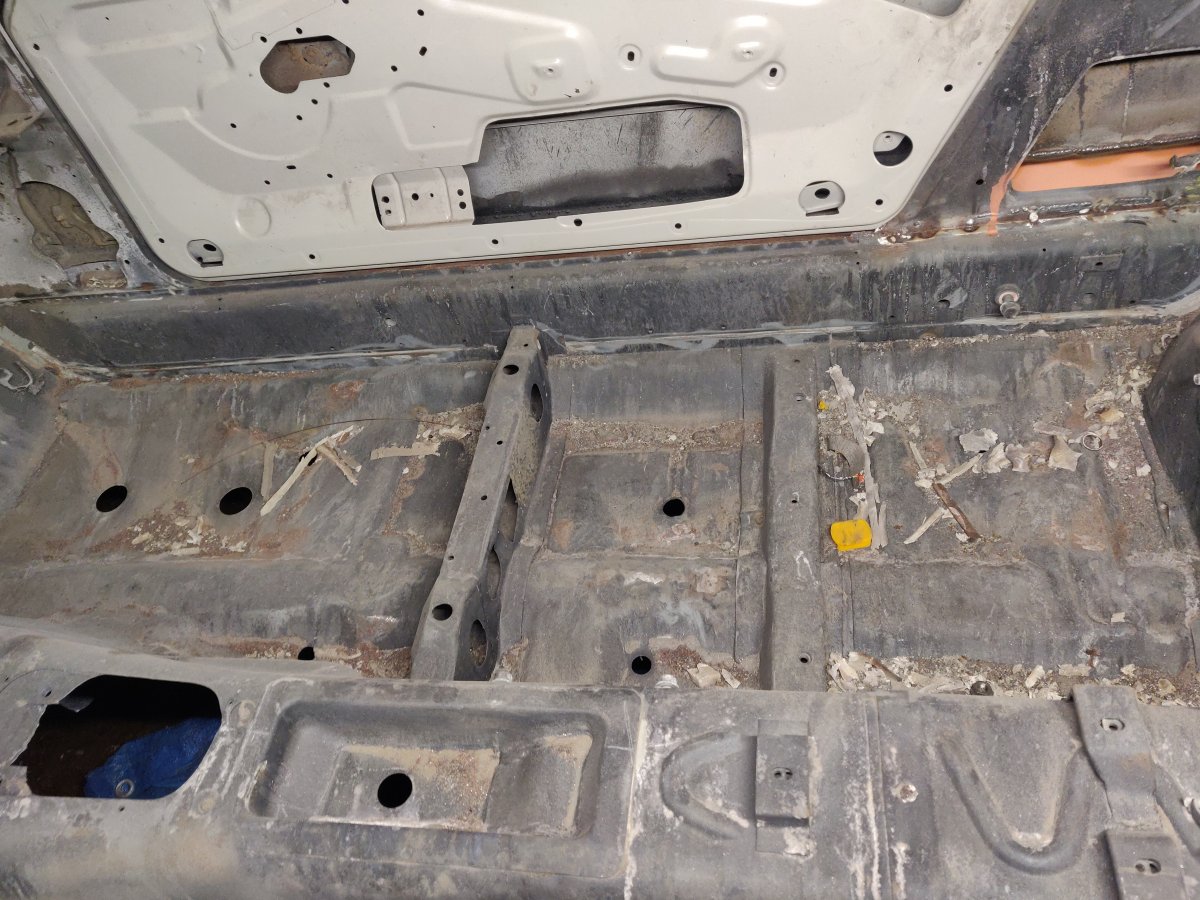

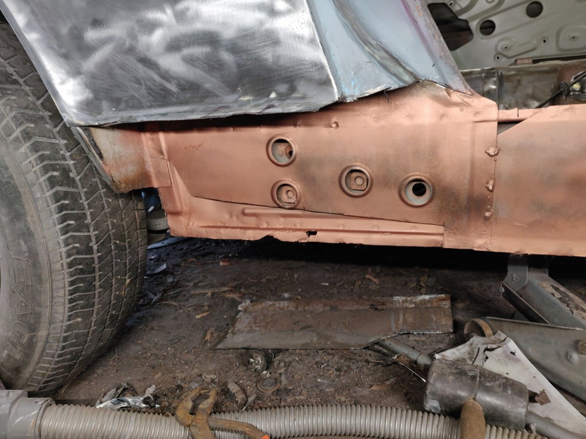

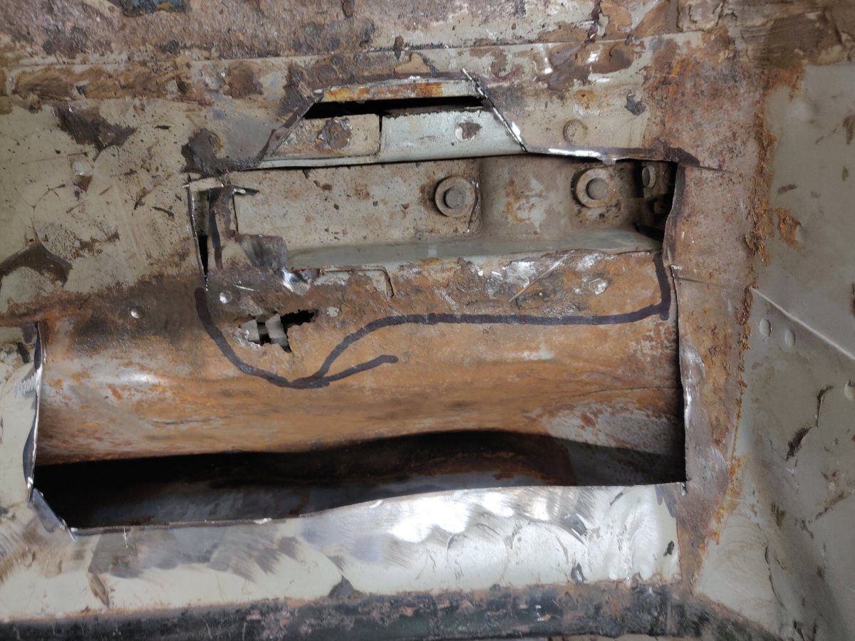

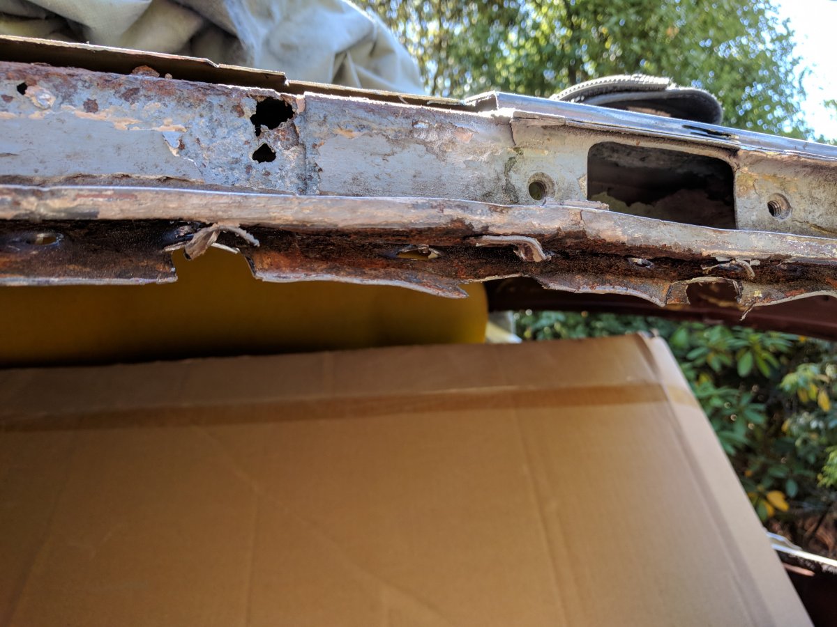

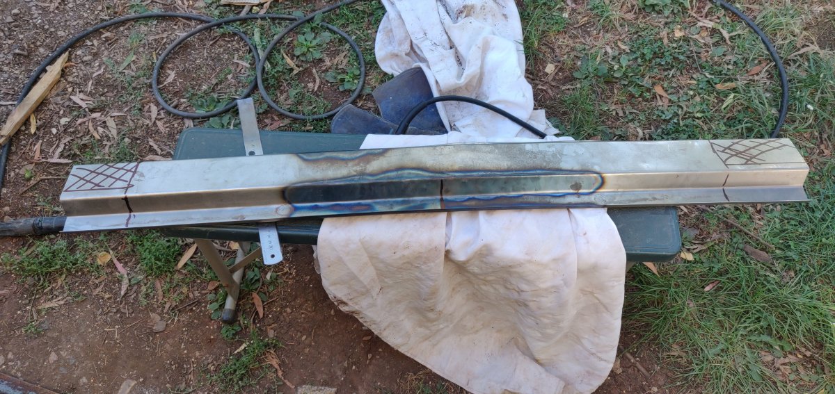

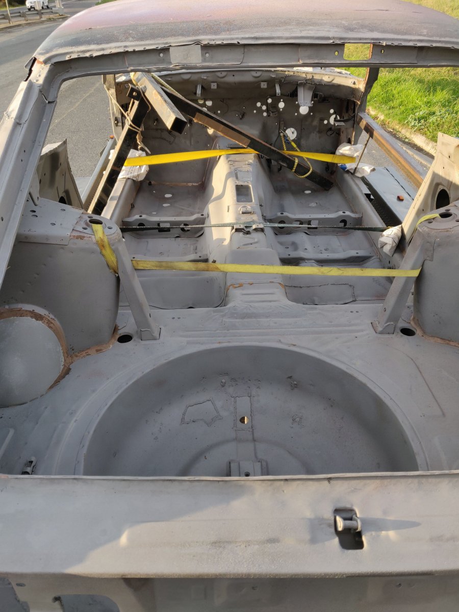

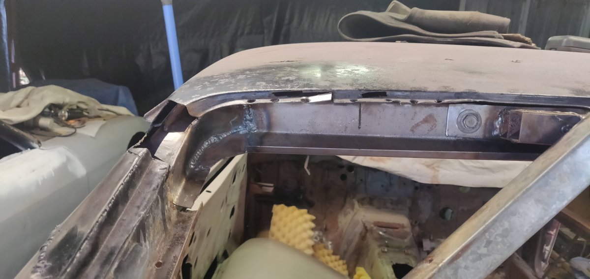

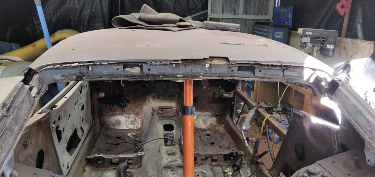

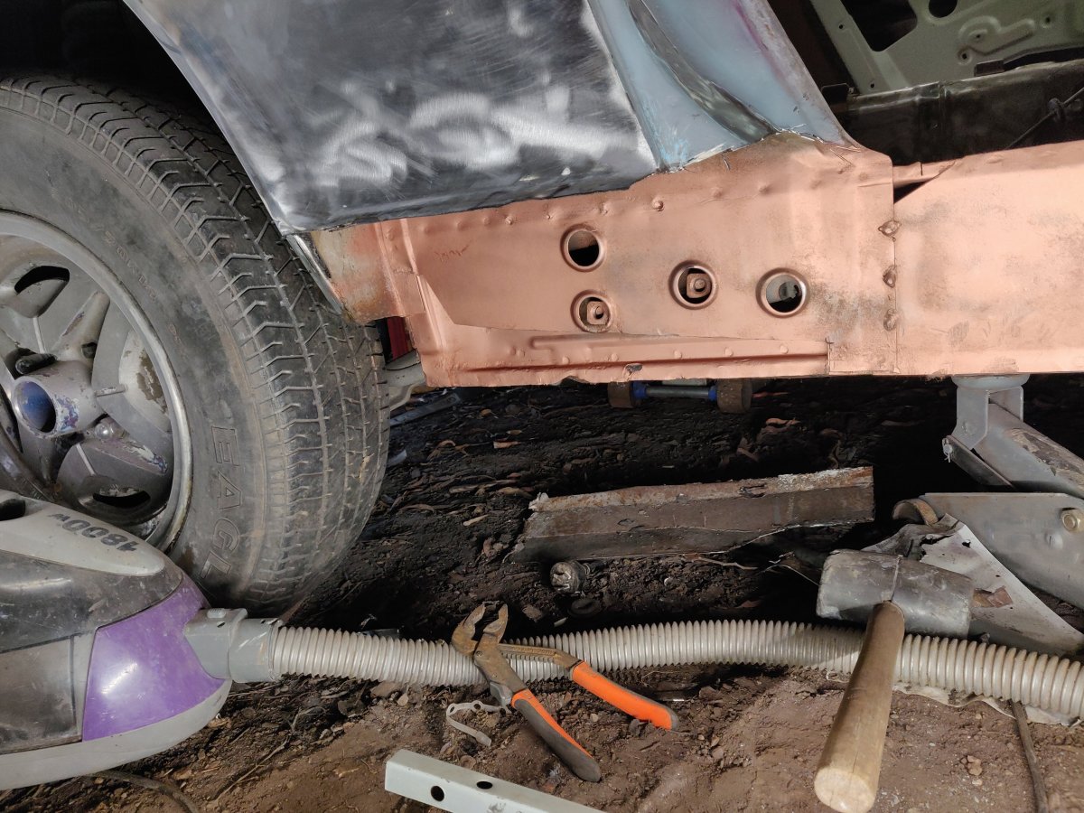

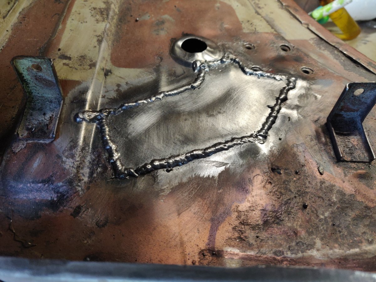

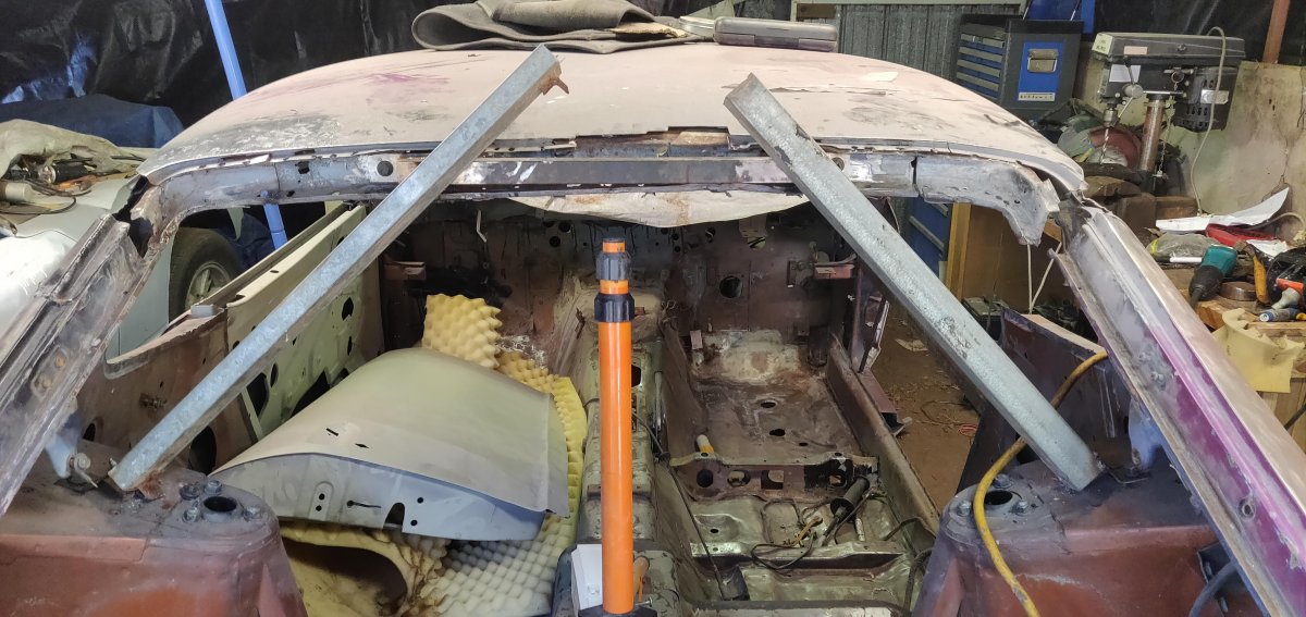

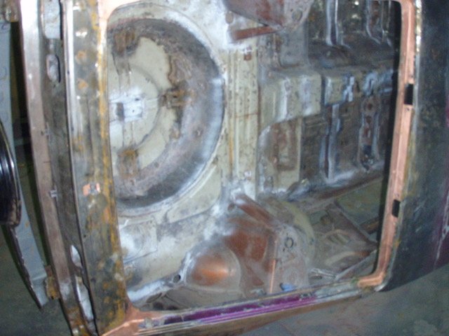

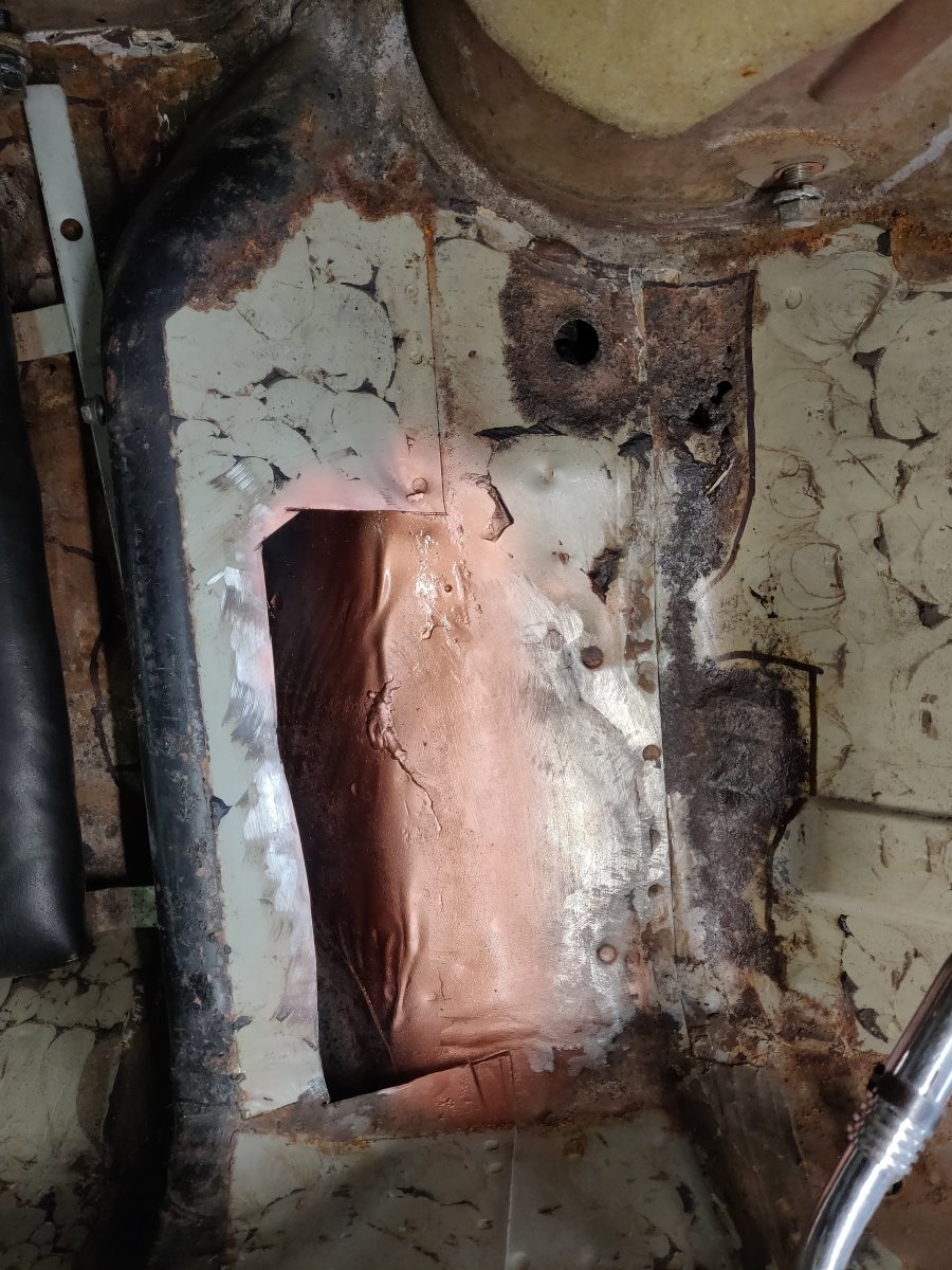

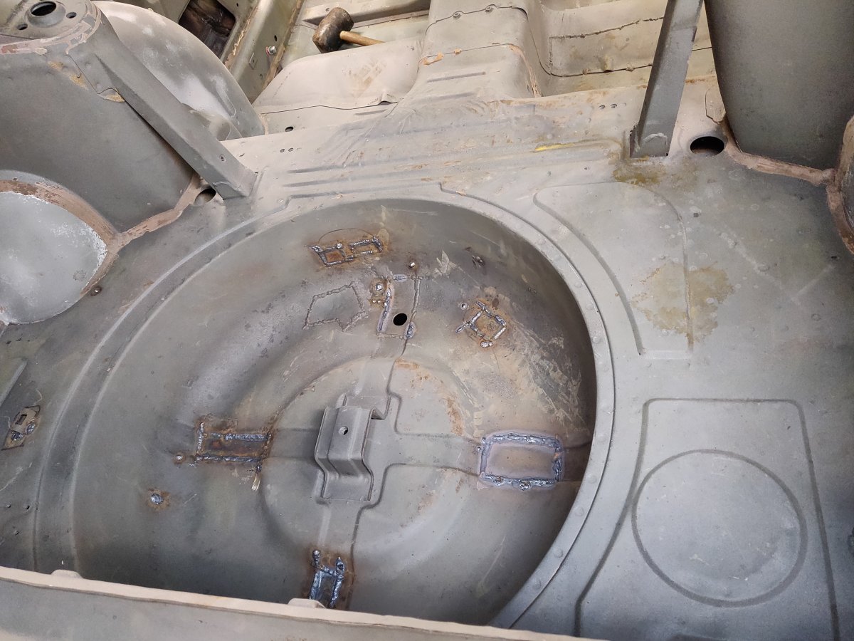

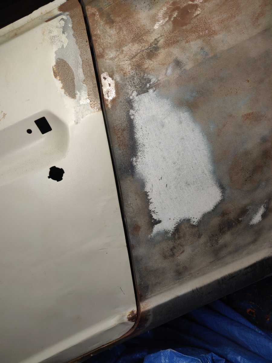

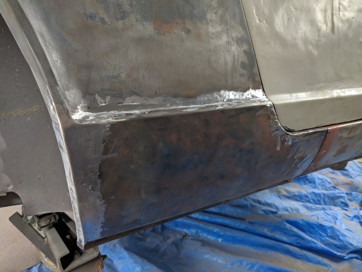

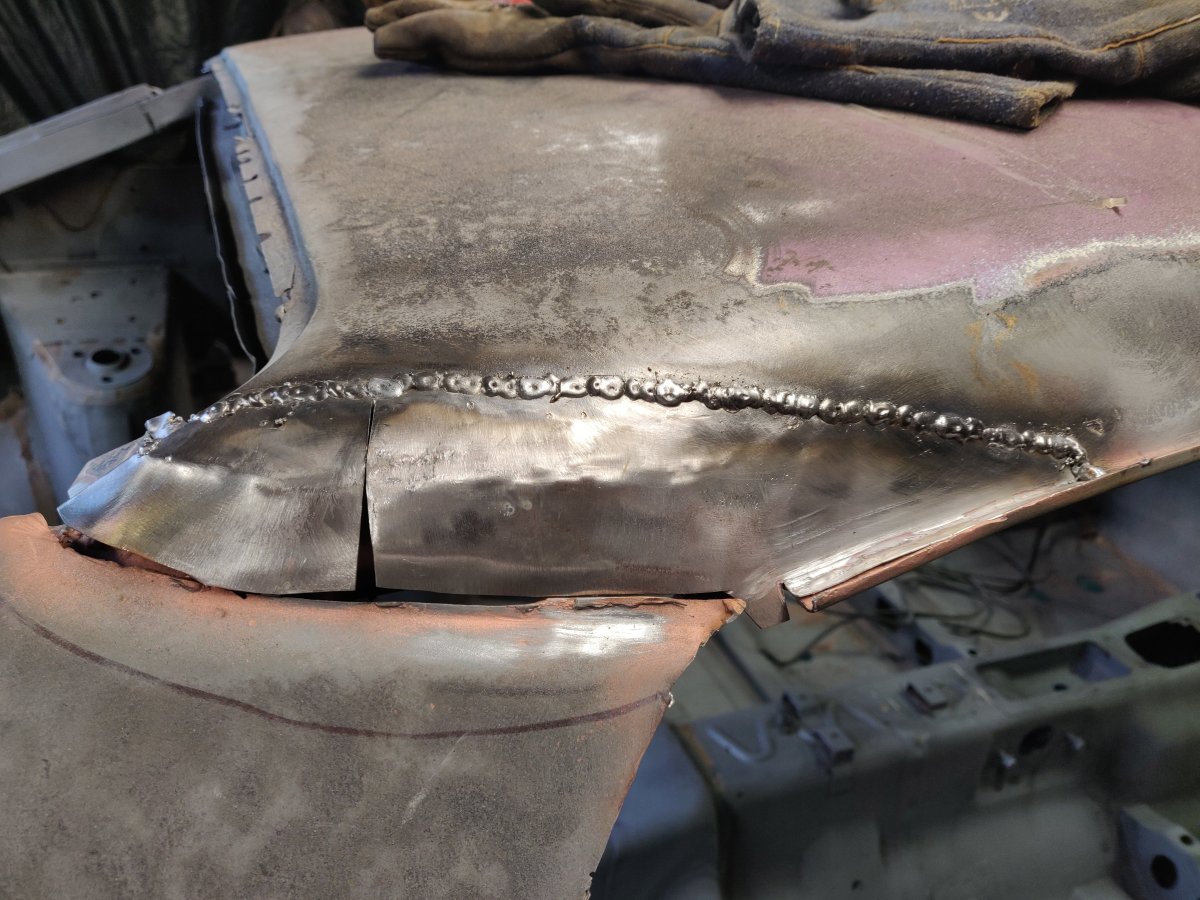

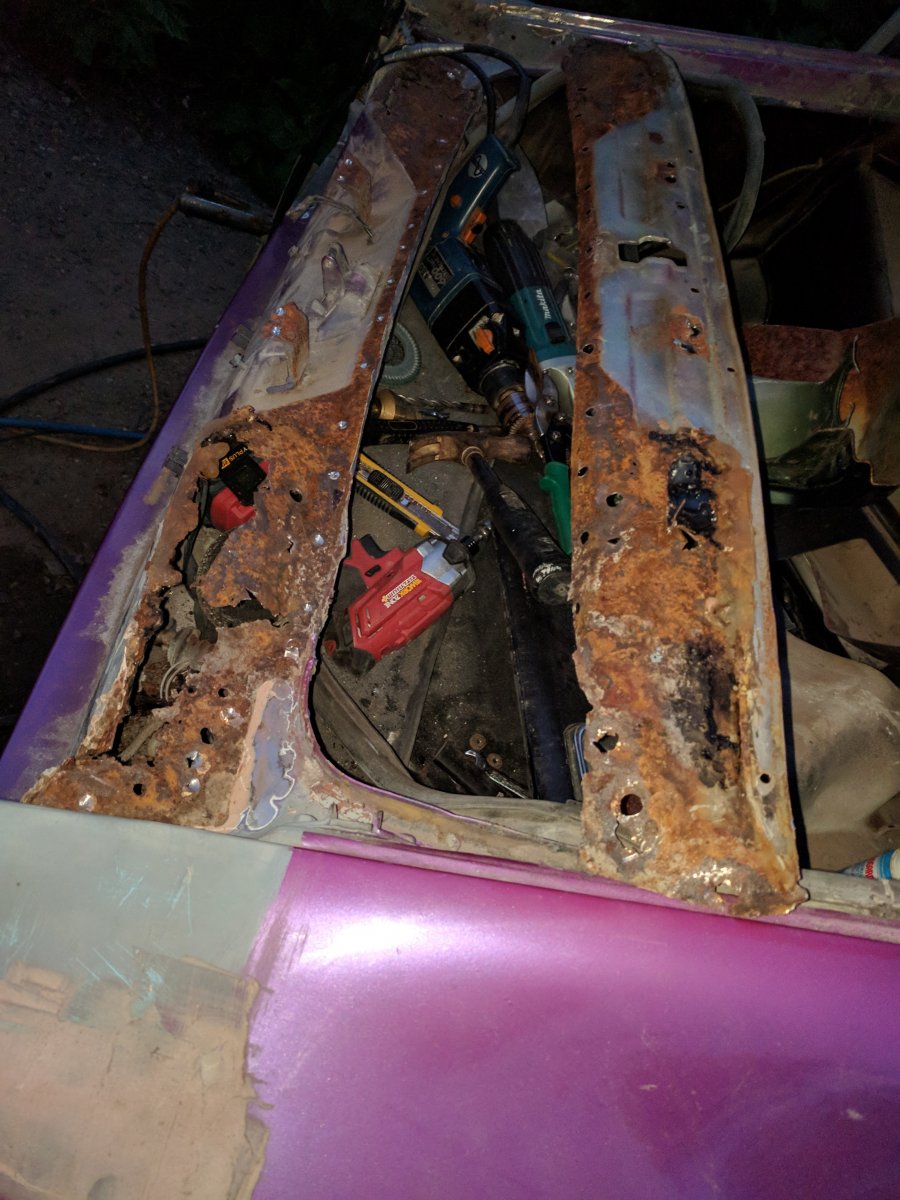

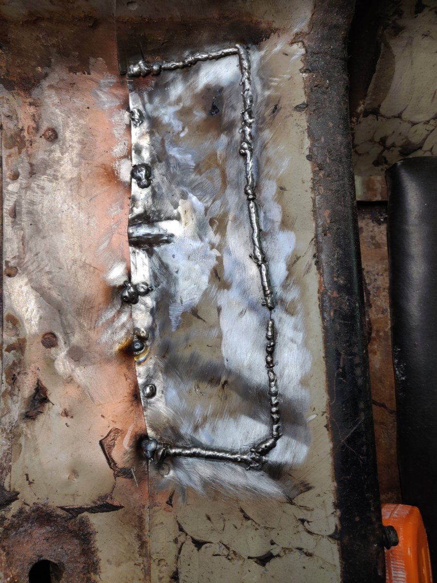

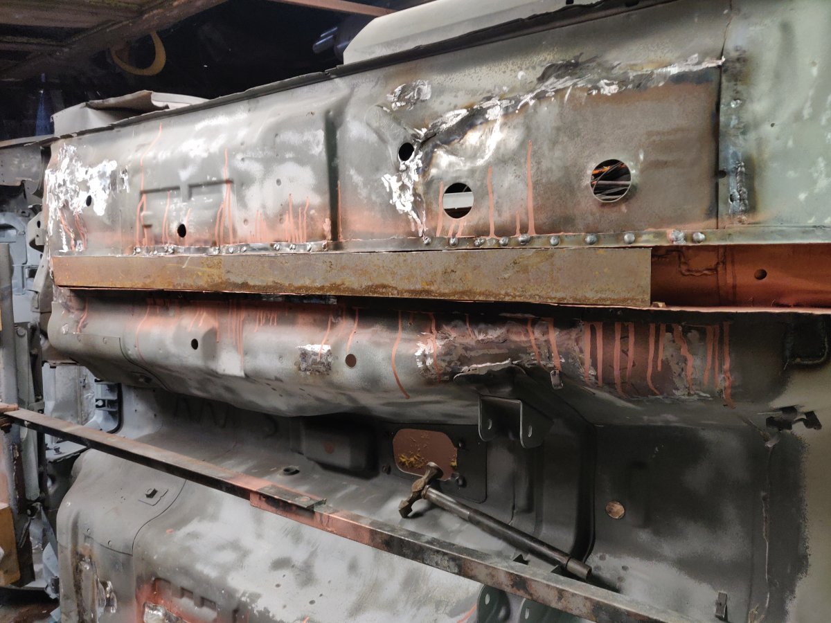

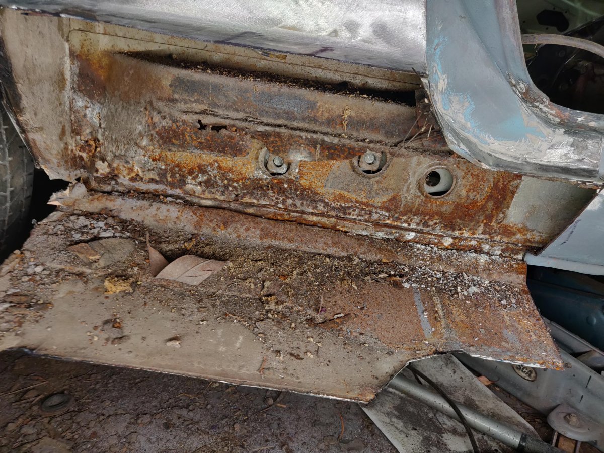

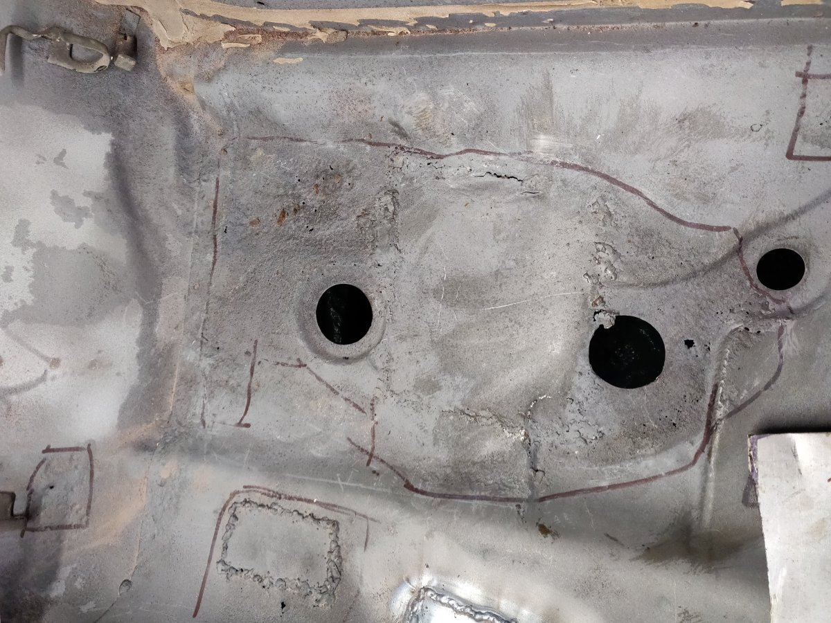

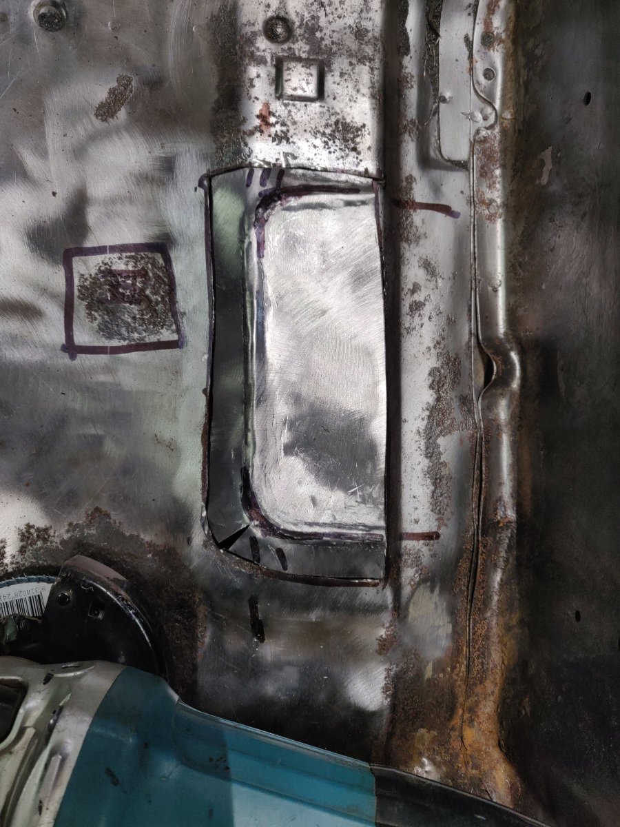

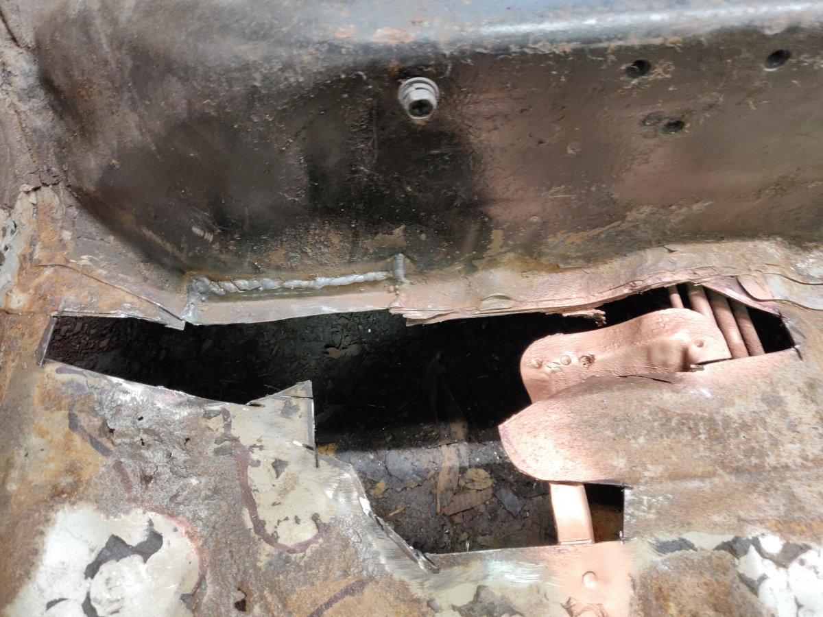

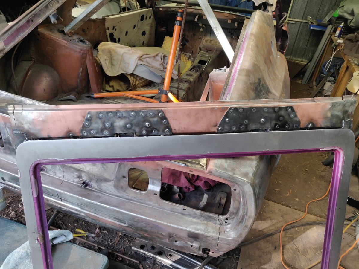

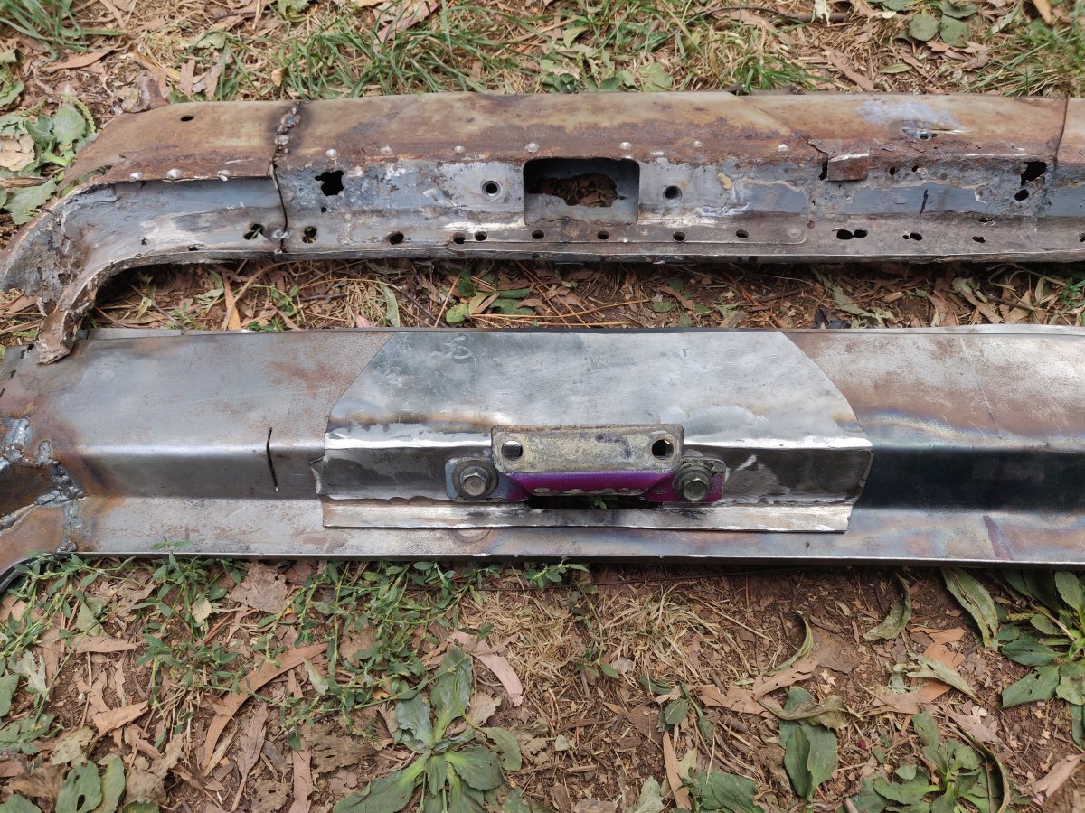

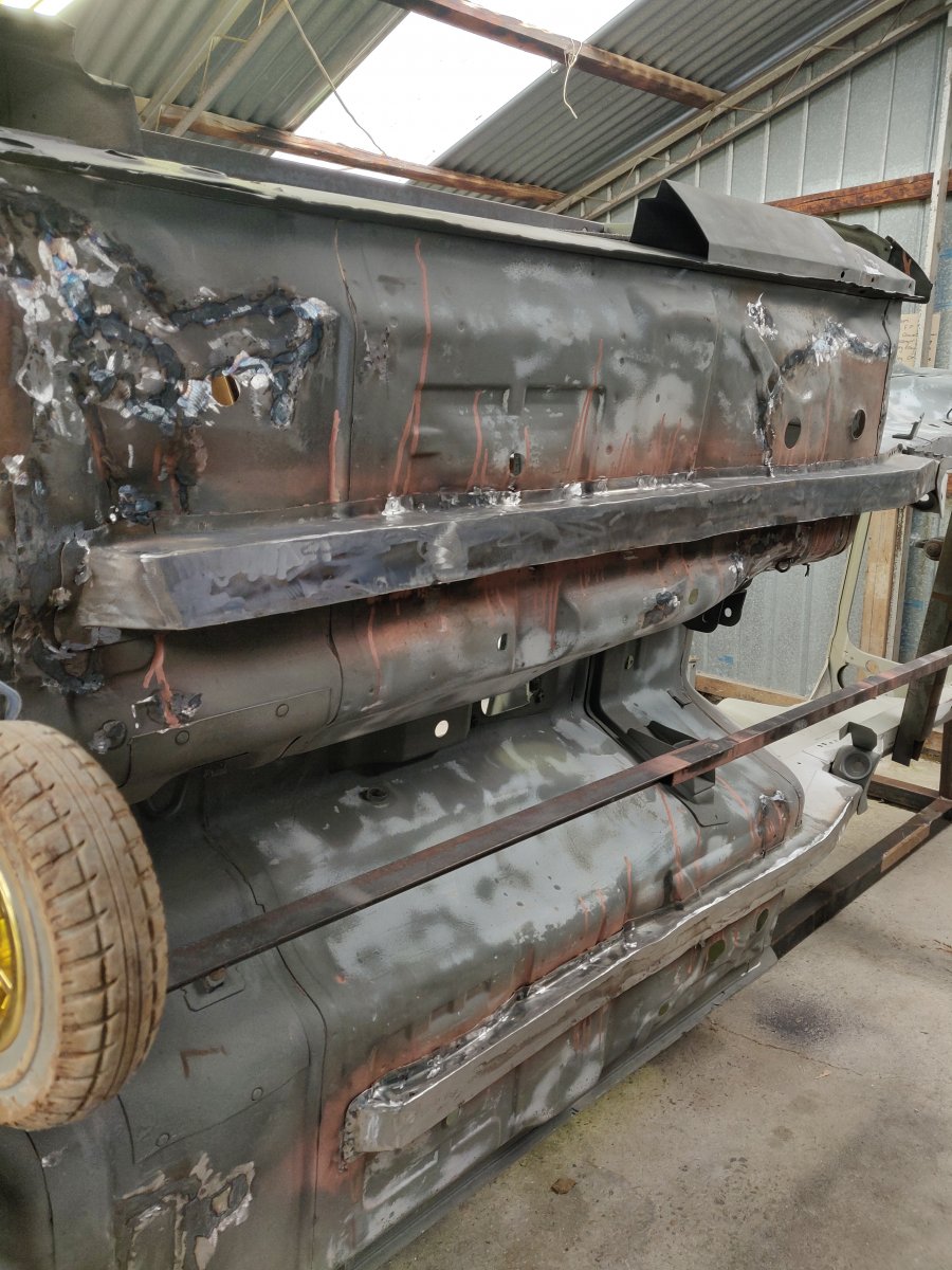

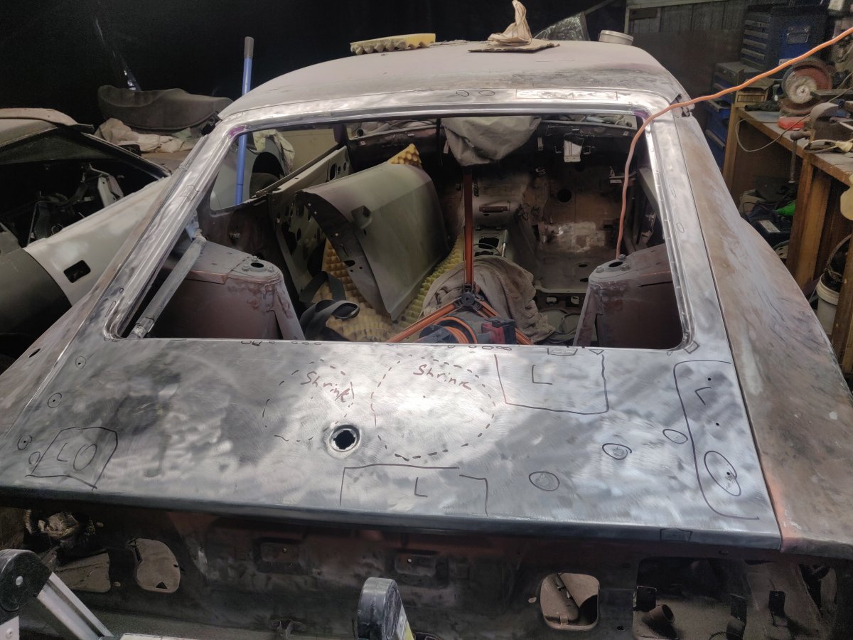

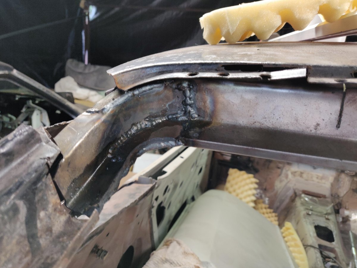

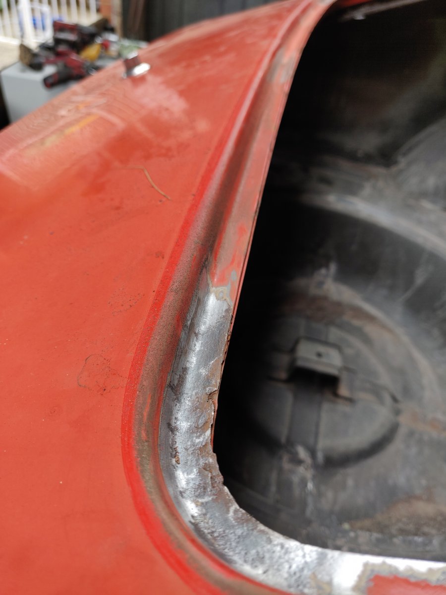

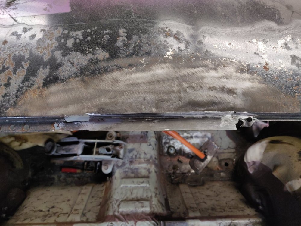

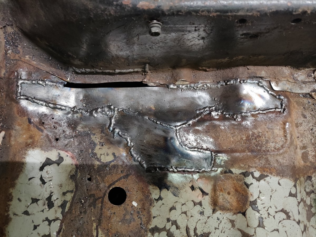

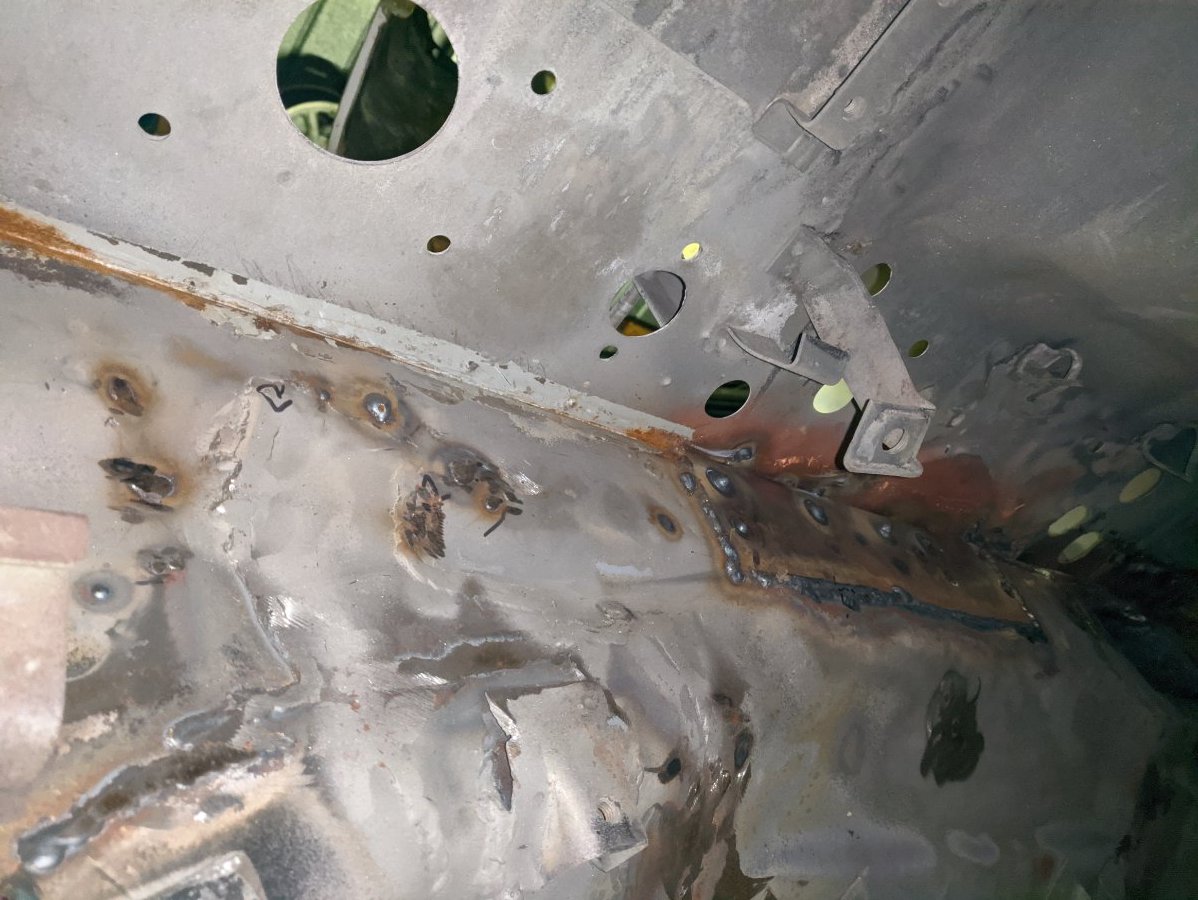

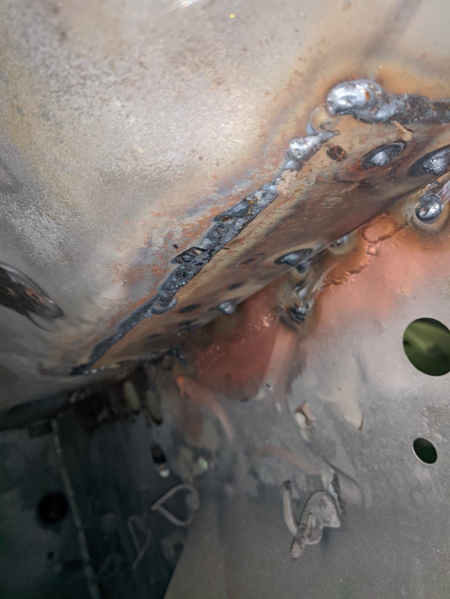

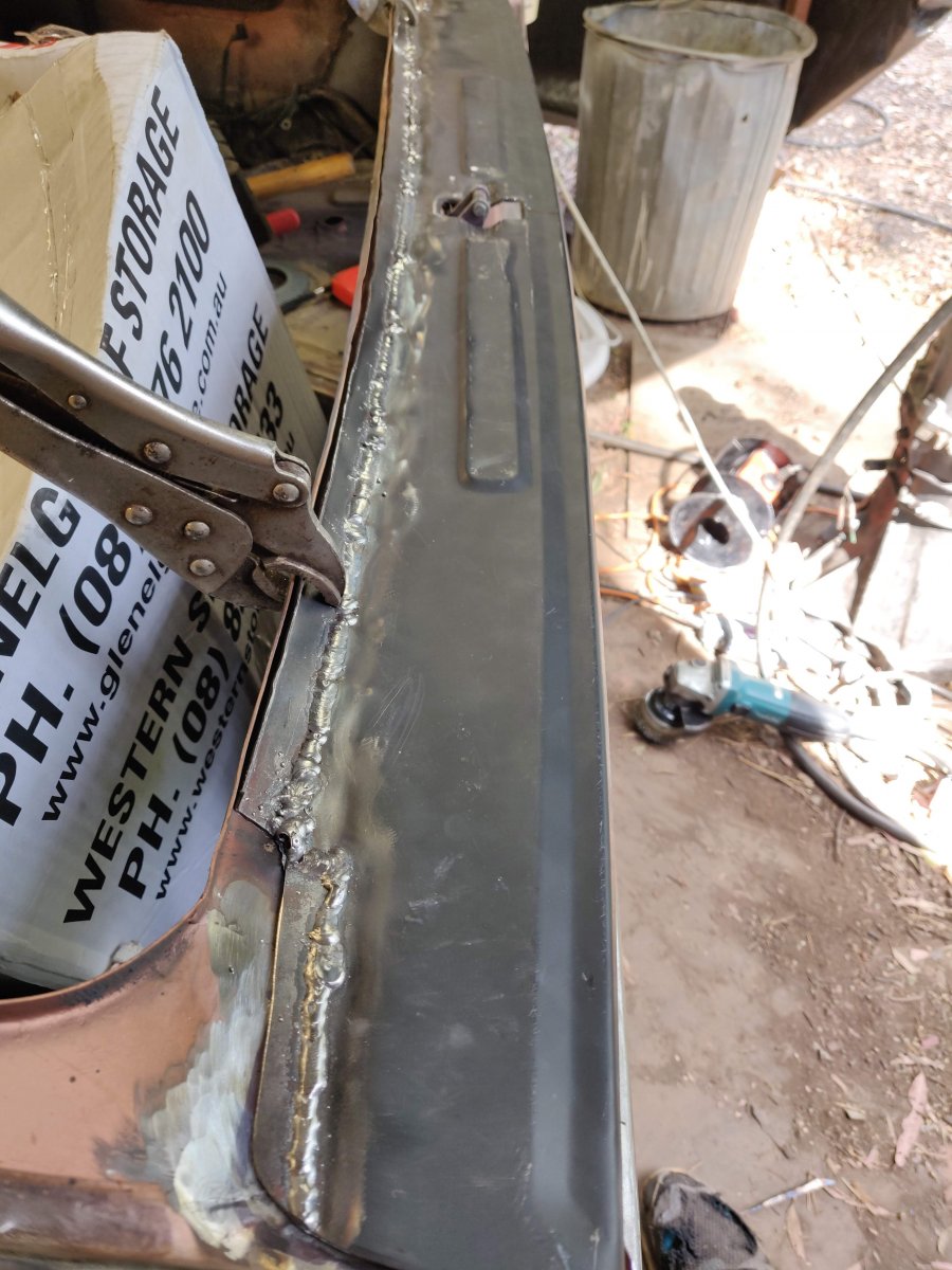

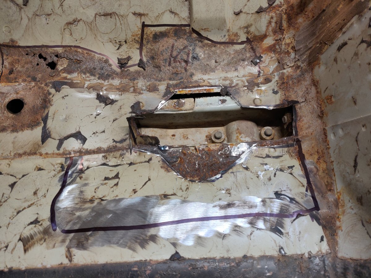

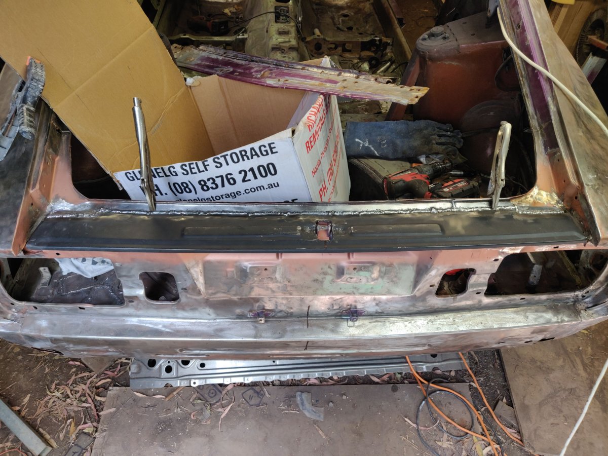

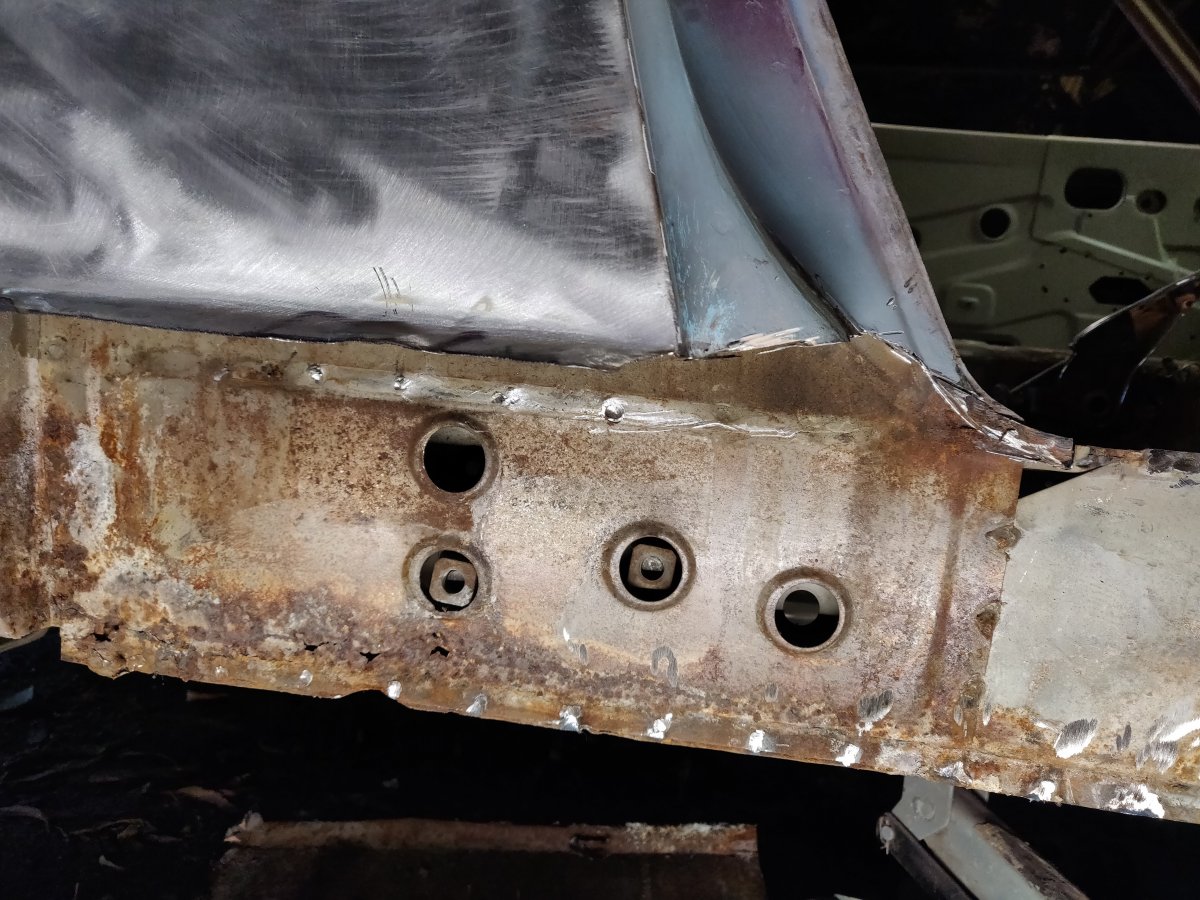

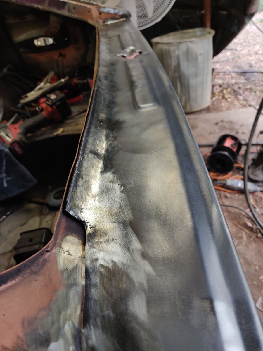

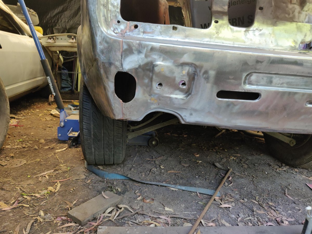

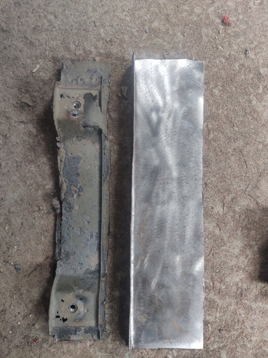

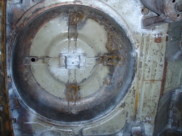

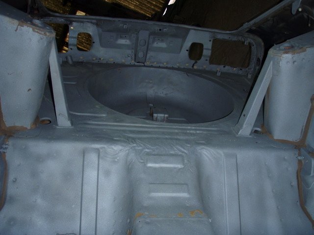

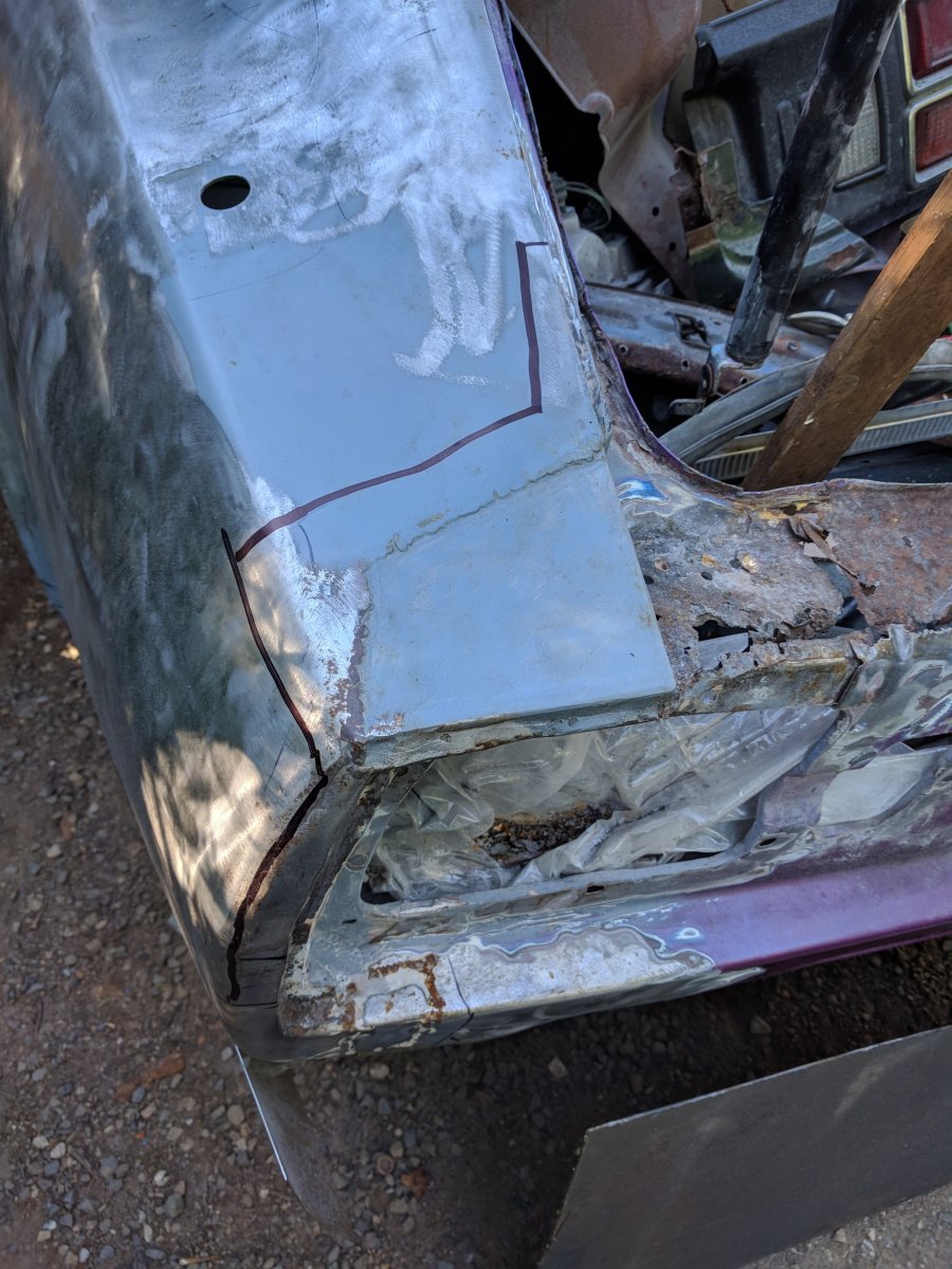

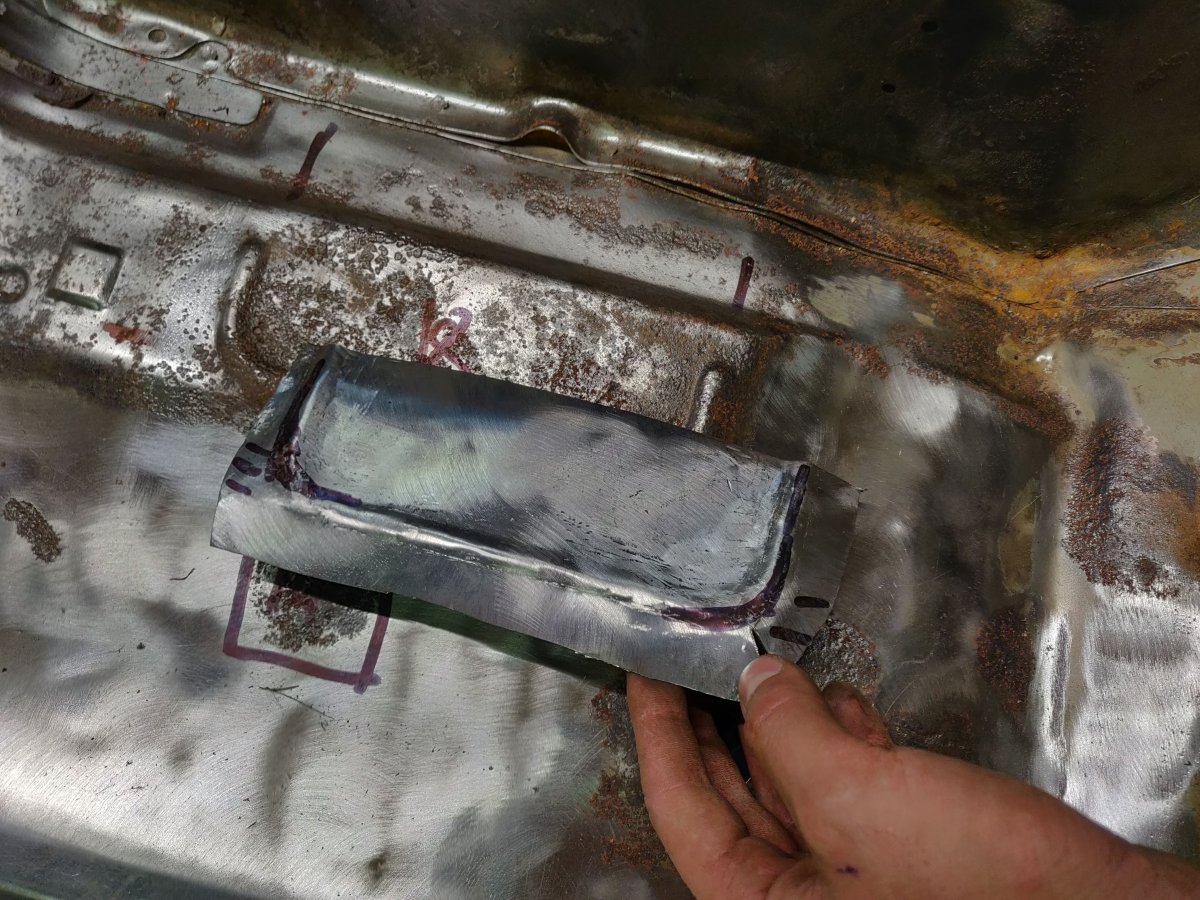

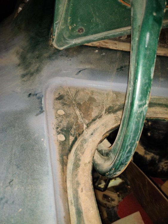

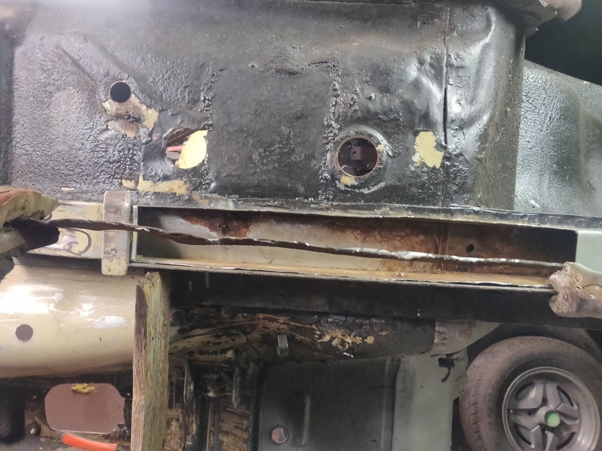

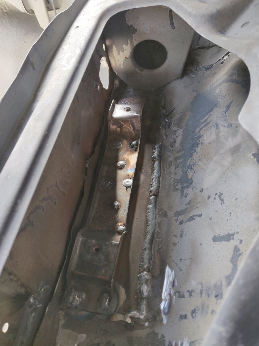

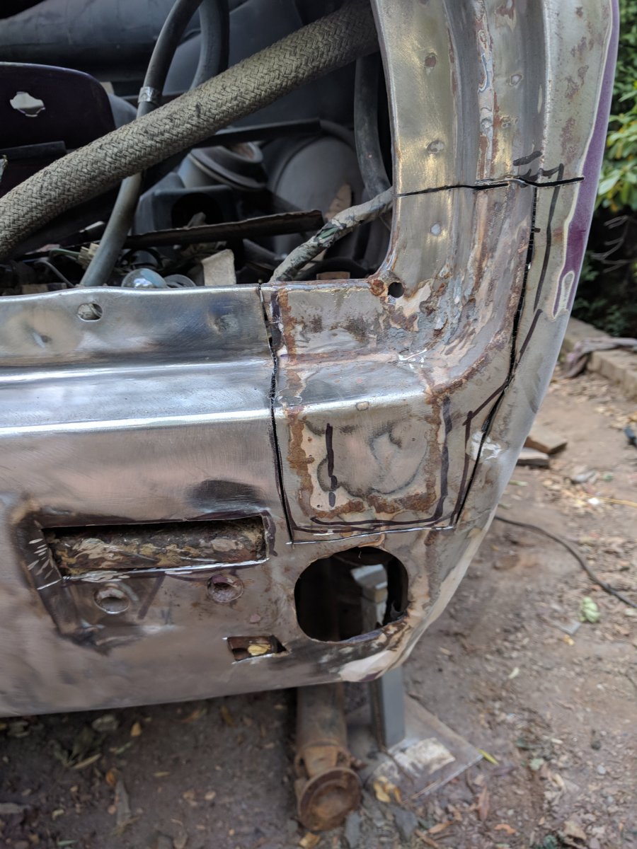

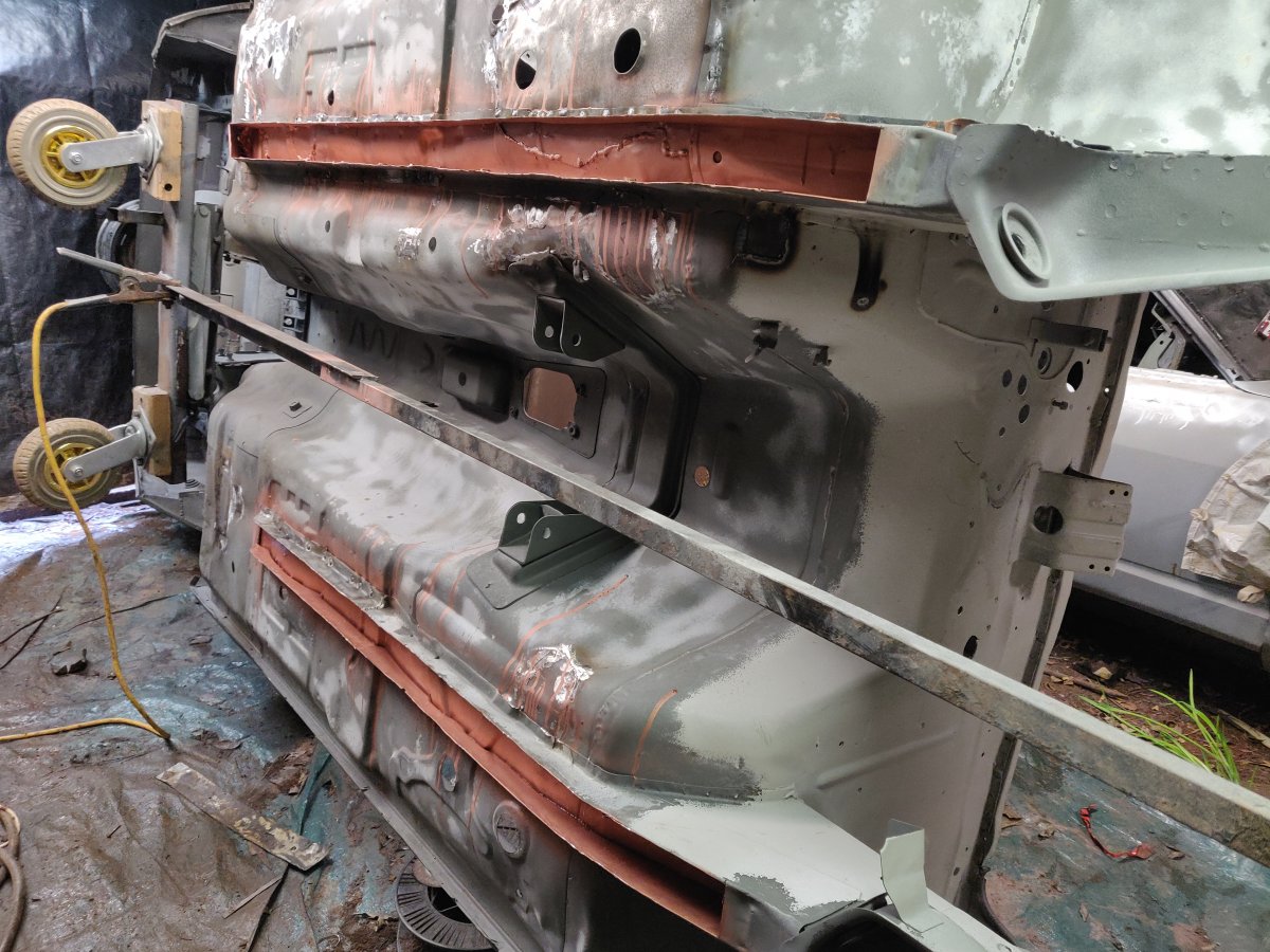

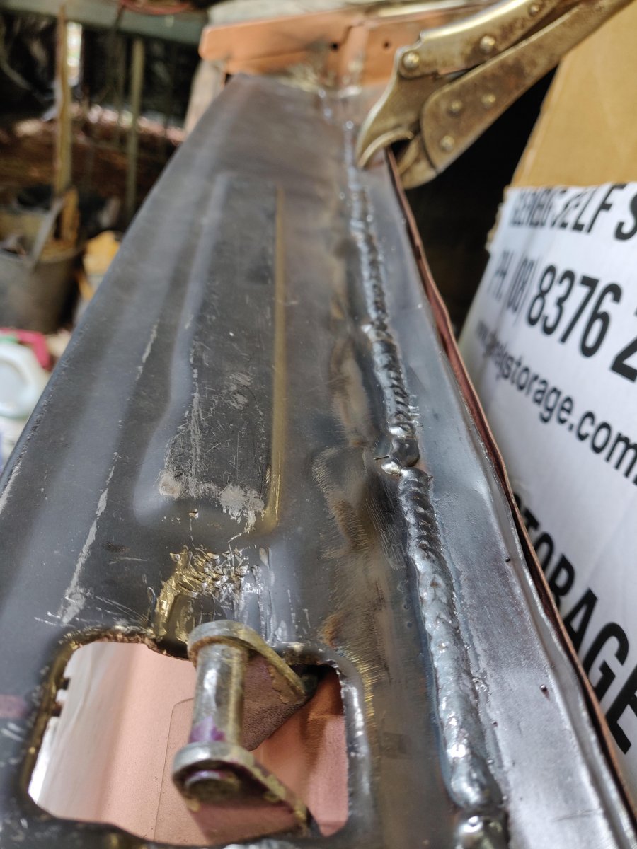

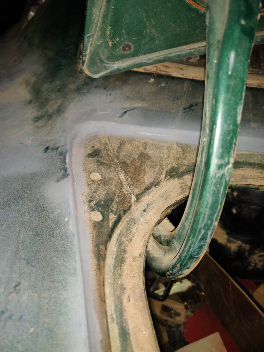

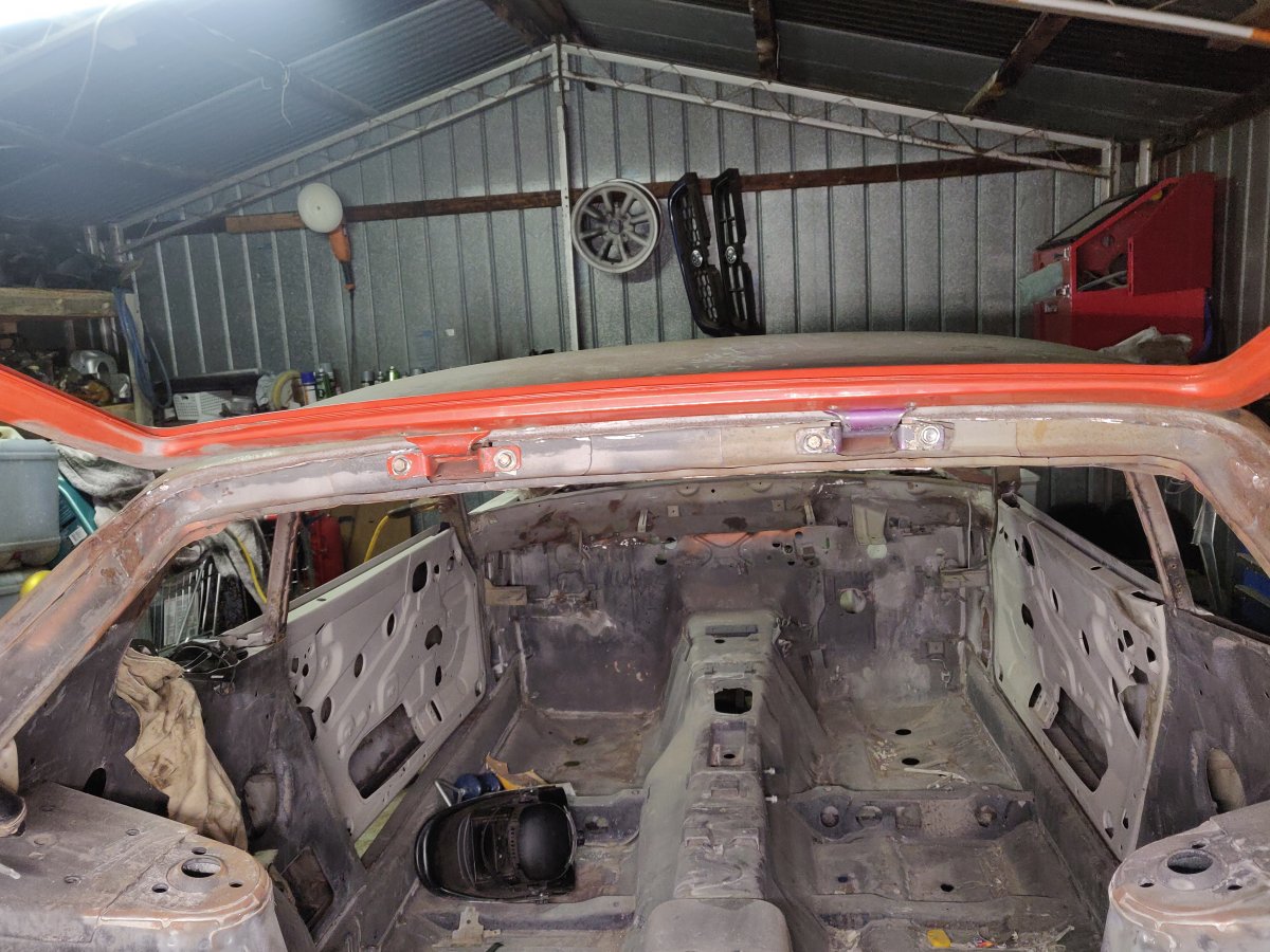

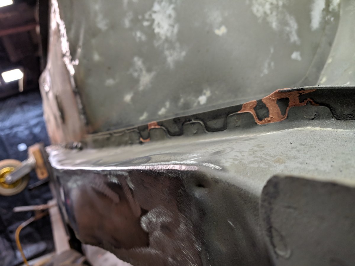

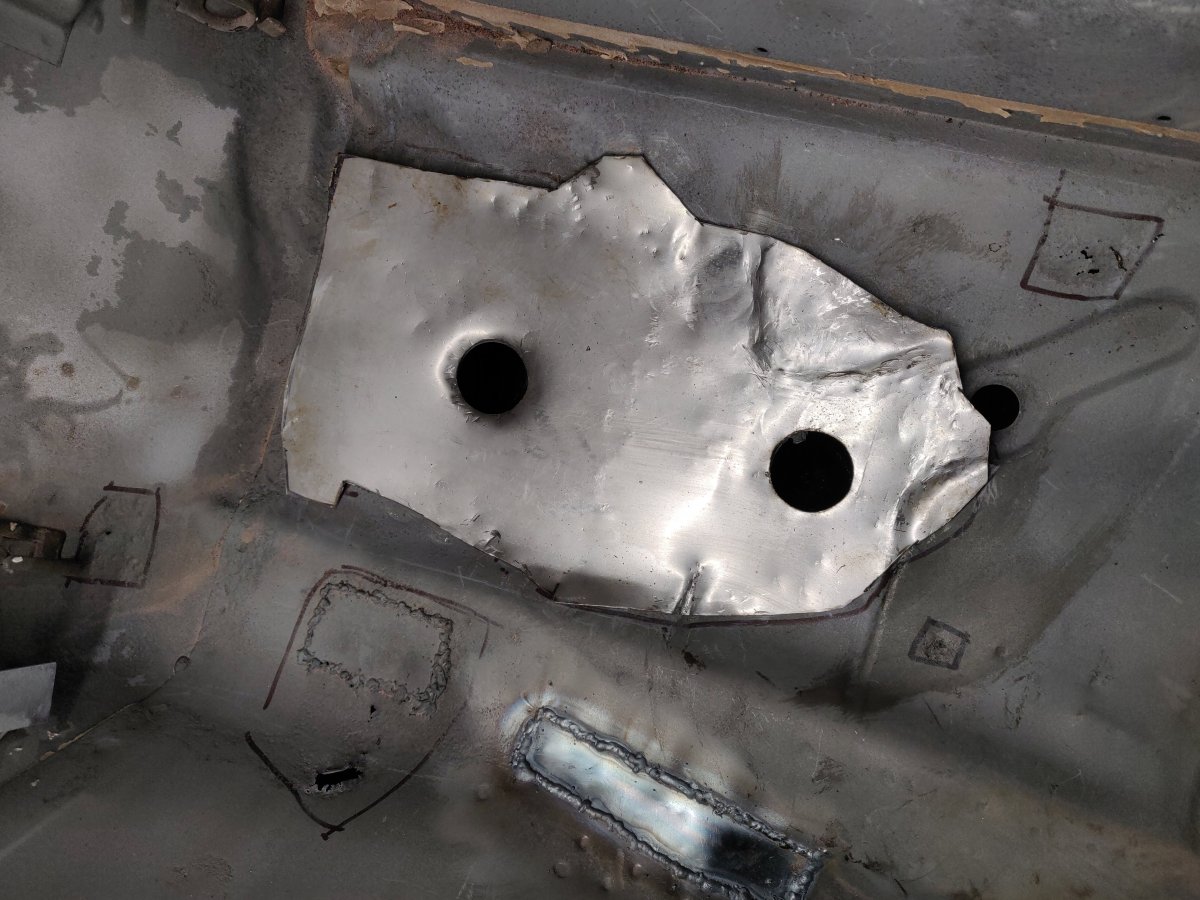

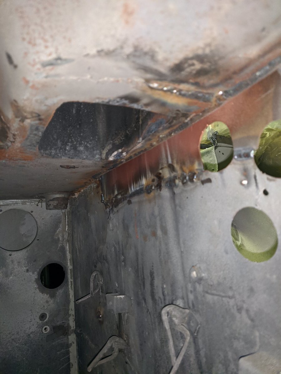

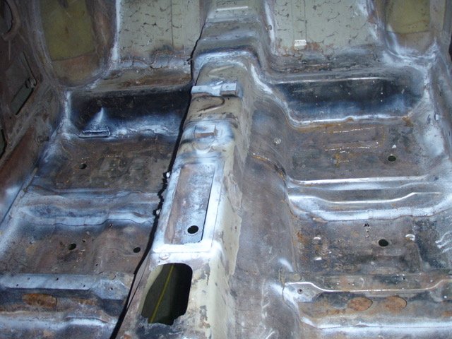

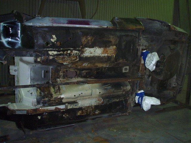

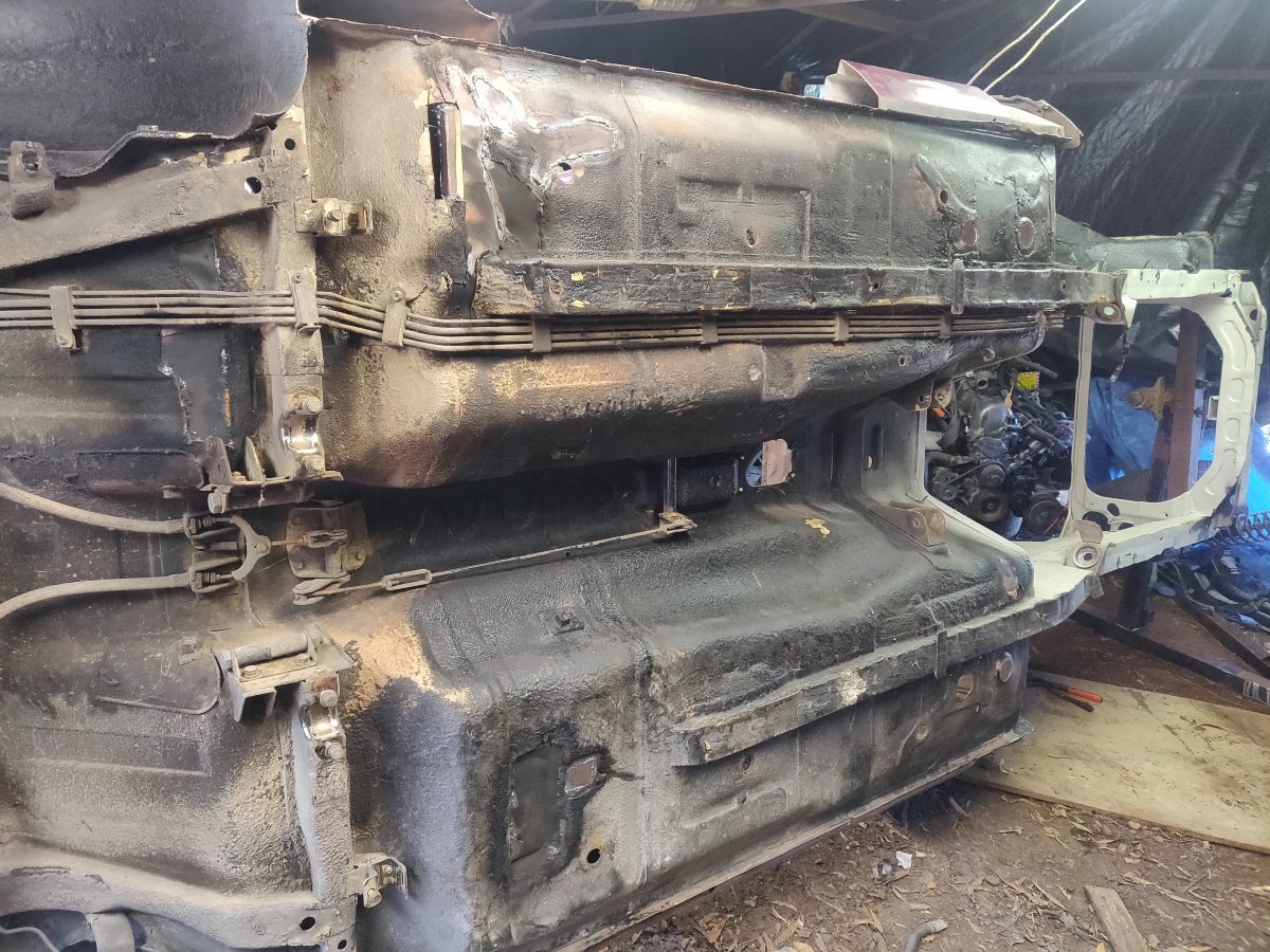

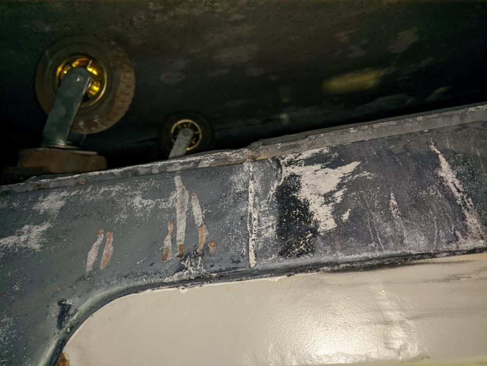

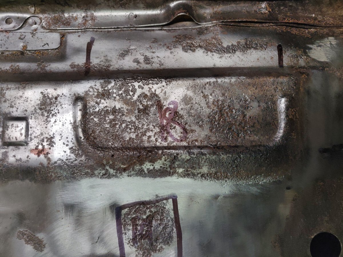

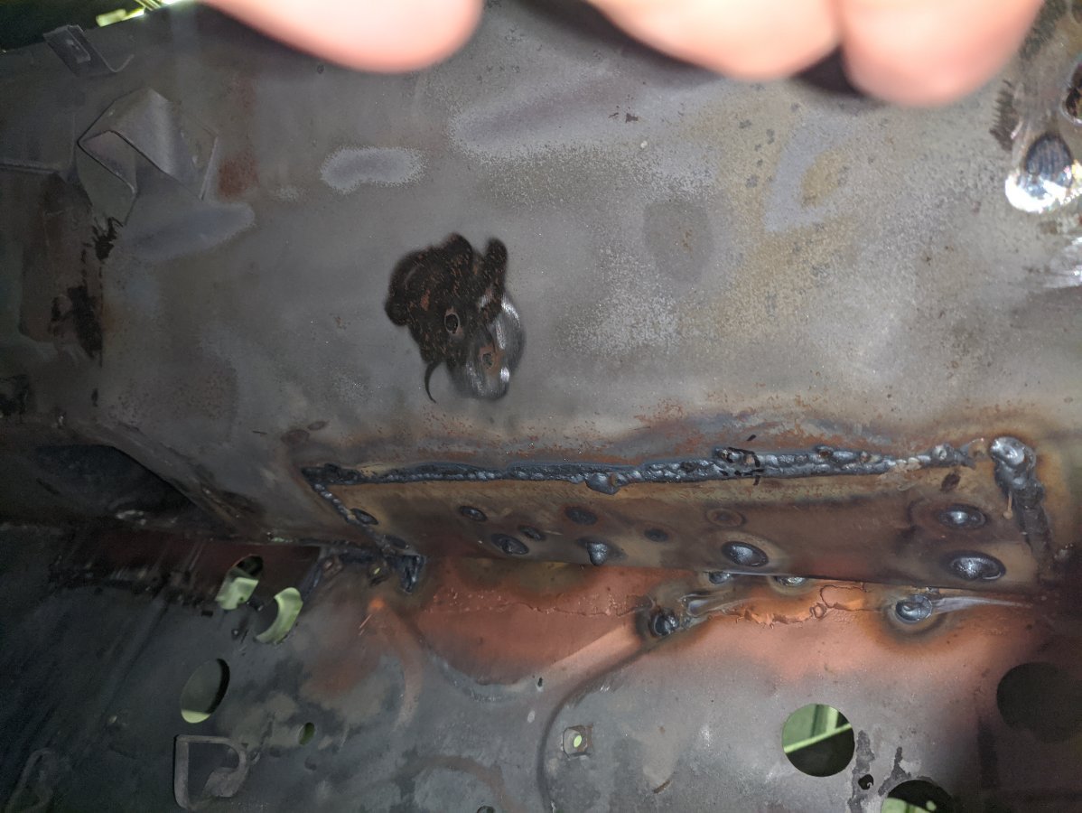

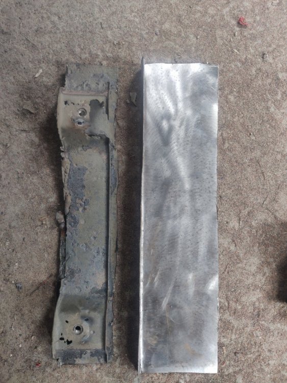

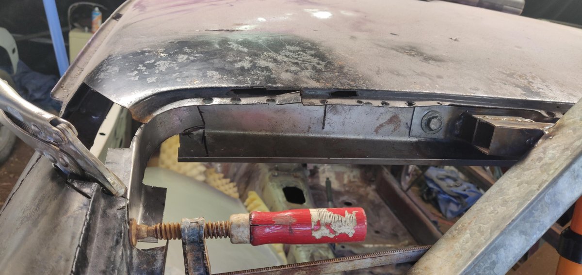

  13. Continuing on from my last post, floor pan patches. Plenty of little rust spots to patch! Cut open the drivers side dogleg and sill area, about what I expected. Little bit of panel beating to get the dogleg repair sections up to scratch (still needs some work but getting there) The replacement rear slam panel. I picked up a 240z section from rare spares and modified it to work on the 2+2. I just had to add a lip to the front of it as well as clearance the latch dimples. Plenty of weld thru primer! All welded on. Overall super happy with this repair. Considering how bad it was I'm stoked! This is it before... Now for the most difficult repair I have undertaken on the car. The rear hatch mounting has some serious design issues on the 2+2's, they collect moisture and rot out, if you have even small holes or just rust scale up here I can almost guarantee that if you dig into it you will discover how fu**ed it is. I tried to source a rust free section but after looking at around four cars I wasn't able to find anything that was in good condition. I even had a look at restored 2+2's, original 2+2's etc etc. and they all have this issue. I only know of two other people who have actually done this repair so there is little documentation on it. If you are attempting this repair it is important that you build up a jig that bolts into the hatch mounting points and then triangulates down to the strut towers (or somewhere that is sturdy) This is so that once you have a repair section you will be able to line it up correctly. I started by folding up the rough shape, taking the average measurements from the entire length as the panel is not evenly shaped. I then began to heat and curve the section, this would be made easy with a shrinking and expanding tool, unfortunately I don't have access to one (one tool I really want to buy) Then I make up the strengthening plates and weld them on (with nuts on the back for the hatch to bolt to) The corner sections are welded on as well as the end pieces. Lots of test fitting with the hatch. Small repairs to the roof skin, avoiding putting much heat into it as the roof is the last panel I want to warp! All primed, ready to go in! Turned out great! Waiting on a replacement hatch (as mine is fairly rough) so that I can perfectly line up the roof skin and weld it in place. Considering the difficulty of this repair I am super happy with how it came out, it still needs some adjustment to get the hatch fitment spot on but nothing major! Rear subframe and suspension out, as well as the engine and front crossmember Made up a quick rotisserie using scrap that I had lying around, cost me nothing to build except some welding wire, gas and cut off wheels. The underbody was what I expected for the most part, the underfloor supports are dented and scraped but not too badly rusted, A bit of rust here and there but nothing too serious. I was more worried about how badly they were dented (I want this car to be pretty underneath as well!!) The underbody sealer and stoneguard was shocking to deal with, started to strip it but I decided it wasn't worth my time, and so I decided to get it sandblasted! Also got the inside of the floorpans done (I had already chipped off the sound deadning) I decided to go with a automotive sandblaster as he was local and super knowledgable, normally doing concourse stuff but also the occasional budged blast like mine. Chris is an amazing guy who knows what he is doing in the automotive stripping world. NO WARPED PANELS HERE! He does charge a bit more than your average cowboy with a sandblaster but his knowledge and can do attitude makes up for it! His website is http://yvblastclean.com/ (Yarra Valley Blast Cleaning) Came out amazing, quite a few pinholes and other rust spots surfaced as expected. A few before and after photos. I got stuck in a bit of a drizzle when heading over there, hence the surface rust on the before shots. Also I must note that he was doing a quick job for me to save costs, hence the seam sealer left and little bits here and there. Got her home, did a quick repair on the roof and drivers side window line. Back into the floor pan patches. Re-doing the first repair I ever did. I remember coming home from the xmas bbq and getting stuck in with my gassless mig, good fun! Lost some motivation after my trip to japan and getting busy (and the huge number of little patches I still had to go) so I decided to get my mate over and smash out all the little patches! Got them all done in a day! Thanks Matt!! If you're ever loosing motivation, call in reinforcements for a day and get a heap done, certainly worked for me! My plan with the underfloor supports was to cut the bottom section off (as it has bits of rust and is seriously dented) and weld in some nice flat sheet metal. Ended up working out great! The whole underside is complete as is the interior (other than the old under-dash repair I did ages ago which needs some attention) On another note me and my mate Matt decided we needed a car trailer, though we weren't about to go out and drop 2 grand on one! Nope, we bought what was essentially a POS old trailer and completely rebuilt it, including new draw bar, extended bed, new brakes, hubs, tool box, full electric system with electric winch and lights. All in I think it was around $1400 including rego, and about 6 days of solid work with two people. Was a heap of fun building, practiced some welding and we have ended up with a mad trailer! I mounted the winch in a way that it could be quickly removed as well as rotated 90 degrees and 180 degrees, this is because my driveway is fairly steep and muddy and the old commodore isn't always able to pull it out from the bottom of the driveway. I am easily able to flip it around and use it to pull the trailer up the driveway! Going back to uni next week so I probably won't get as much done over the next 6 months but I'm hoping to have her in primer and be a good way through the filling and panel beating stage by the end of the year. I will hopefully also be bringing her to the Xmas BBQ in her unfinished state! Cheers guys! Looking forward to finishing these bloody rust repairs! The end of them is near! As always follow me on Instagram for the latest, New username too! Driveway_Datsuns https://www.instagram.com/driveway_datsuns/ BONUS PHOTOS FROM JAPAN (INCLUDING STAR ROAD, HISTORY GARAGE, TOYOTA MUSEUM and DAIKOKU FUTO PA) Was just verifying the lack of an L series! Loving the purple!
