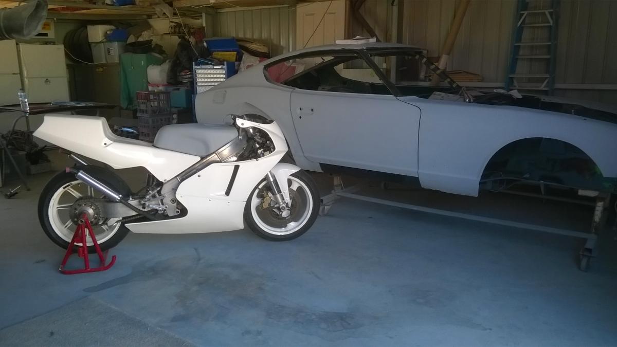

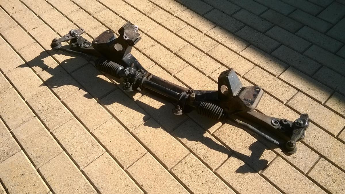

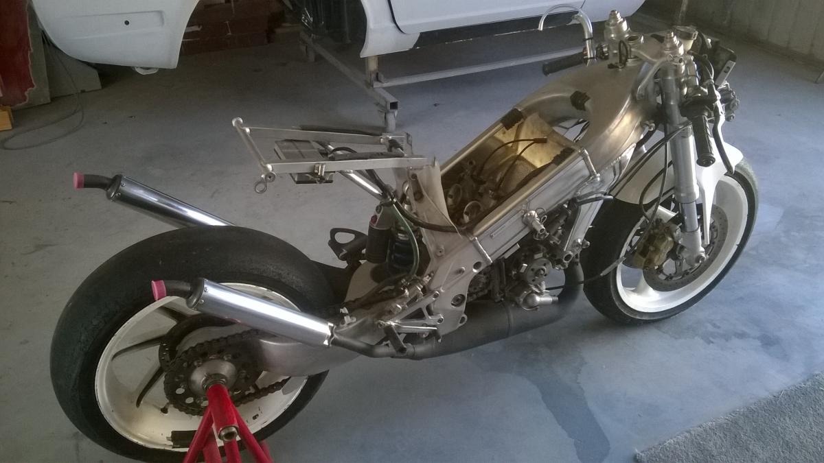

jeff43 Posted April 24, 2016 Author Posted April 24, 2016 Hi All, haven't been getting much done on the Zed of late. Did manage to get the steering rack/front cross member and LCA assembly degreased ready for disassembly. Still dirty but a far cry from what it was - 45 years+ of road grime takes a bit of degreasing. I will complete the degreasing after disassembly. My old fella had to have surgery to remove a very large lump from his chest - the vet bill sure hurt the Zed restoration fund. So while I have been playing nurse to him, I got on with a smaller shed task and gave my Honda 250GP race bike a bit of a clean as it has been getting covered in Zed restoration dust etc. She is now parked so as to avoid her getting dirty again. We shall see how the wife likes that! gav240z and George 2 Quote

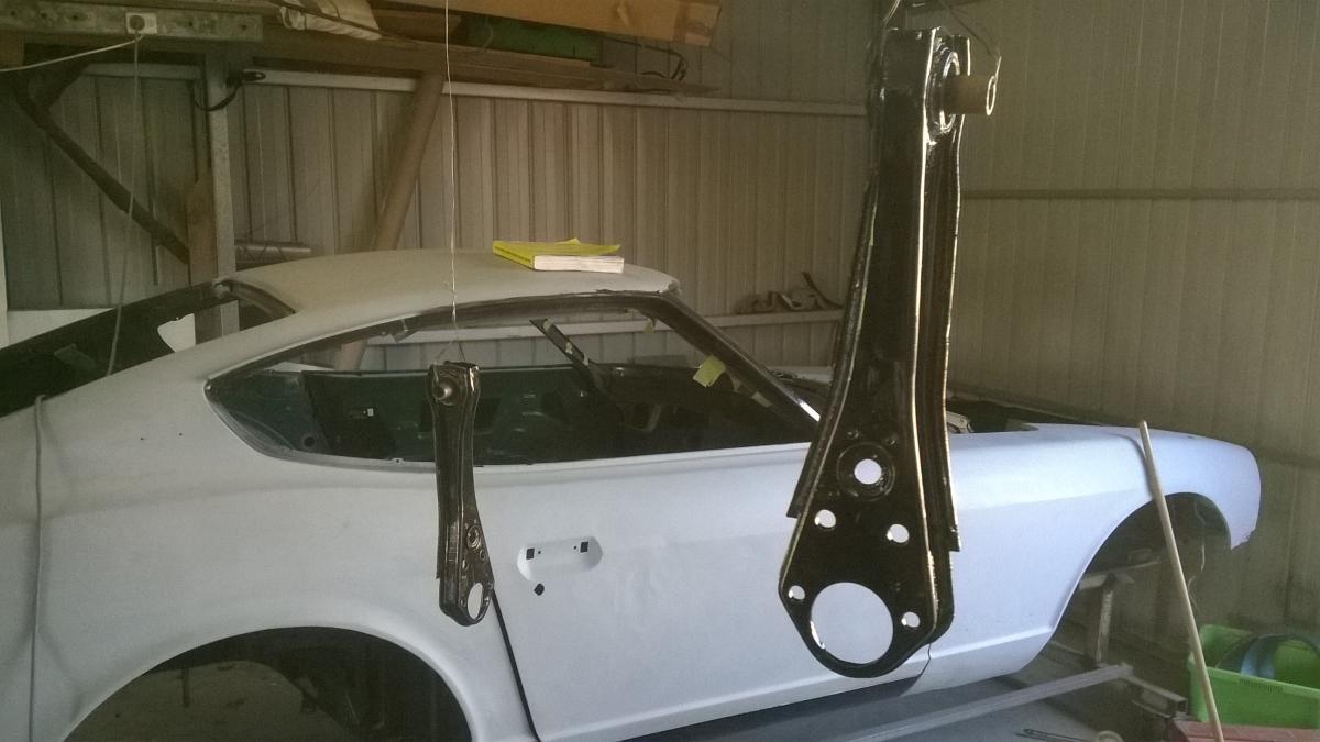

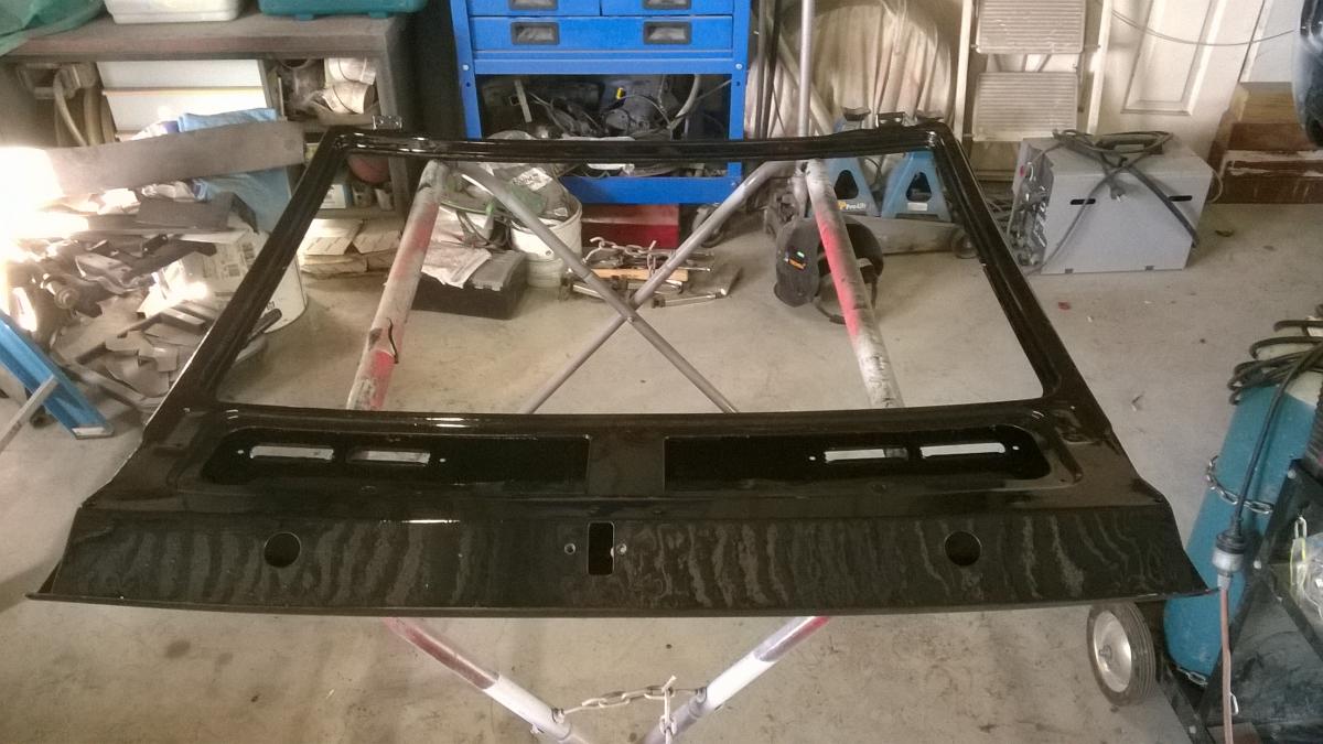

jeff43 Posted May 15, 2016 Author Posted May 15, 2016 Small update, finally got a bit of time in the shed today. For all that love there pets, "Champ" is doing really well, almost back to normal. So I finally finished painting the hatch inside and out. I cutout some rust from the bonnet and treated the area's underneath with some KBS rustseal. I have been working on suspension components as well - degreasing, sand blasting and painting with KBS rustseal. Front LCA got there first coat today as well. I will let the pics do the rest of the talking. George 1 Quote

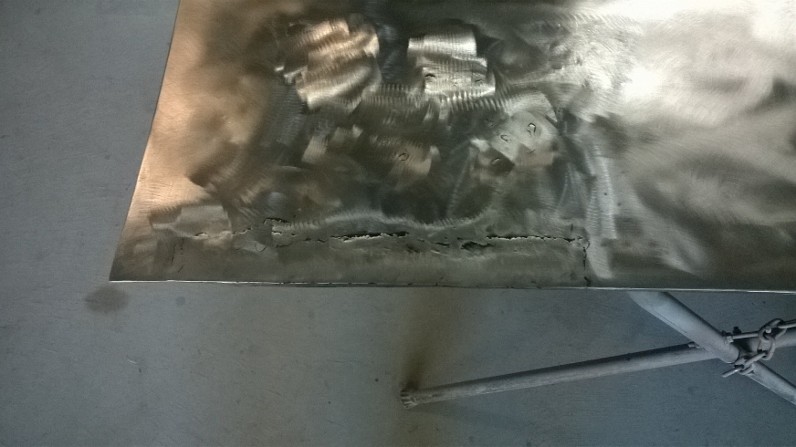

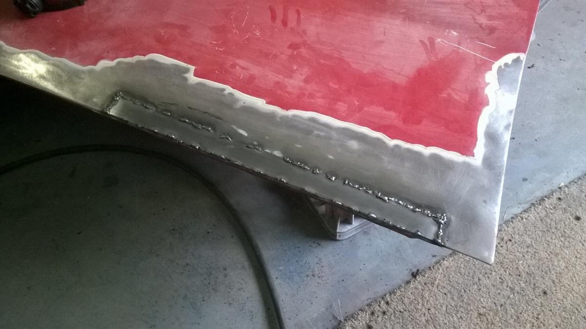

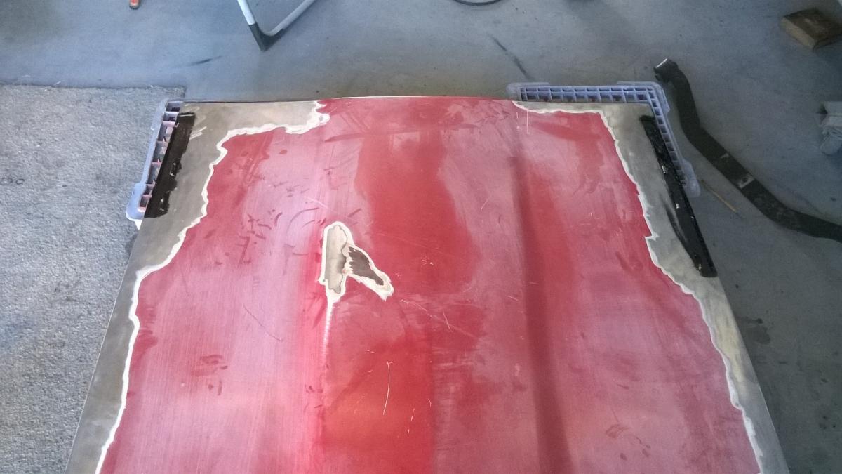

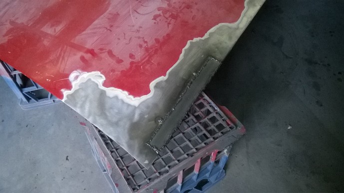

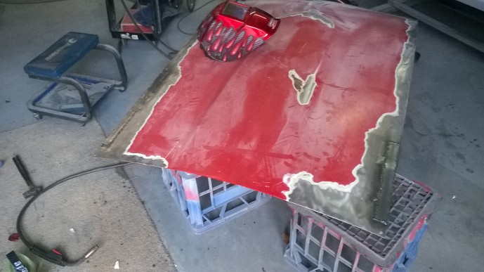

jeff43 Posted May 23, 2016 Author Posted May 23, 2016 So got a few hours in the shed on Sunday. Working on rust in the bonnet. I have cut out 2 sections and wire wheeled the area underneath before treating with KBS rustseal. Then made up some new metal and welded them in. Just need to finish up the welds and grind back then finish stripping the bonnet and get it in undercoat. Hopefully I can get that done this weekend. Then I will be away with work for a couple of weeks. I should be well motivated when I get back. Cheers Jeff Sirpent 1 Quote
Administrators gav240z Posted May 23, 2016 Administrators Posted May 23, 2016 Weird spot for rust, usually it's the leading edge. I've already unpicked the frame and skin on mine and plan to paint the inside edge with KBS rust seal. I'm a fan, it's really thick and durable. I hope after all this work our cars last forever! . CBR Jeff 1 Quote
jeff43 Posted May 24, 2016 Author Posted May 24, 2016 Hi Gav, Yes it is a weird spot for rust, having said that I have seen a few rust done the sides in that spot. So far the rest of the bonnet looks to be really good. This bonnet is off a 2+2 and the rust in that area had just been bogged over so that probably hadn't helped. I would love to just get a Carbon fibre bonnet but can't afford that. I hope after all this work our cars last forever! . That's the plan Gav. If it lasts my lifetime I will be a happy man. Glad you like the KBS rust seal. Cheers Jeff Quote
Brabham Posted May 24, 2016 Posted May 24, 2016 Good work Jeff, my 2+2 bonnet had rusted all along the edges in a similar spot, although one side was a lot worse than the other for some unknown reason. After I use up my supply of POR-15 I will be switching to the KBS, since it is Australian made, I imagine they are both a similar composition though. Cheers. Quote

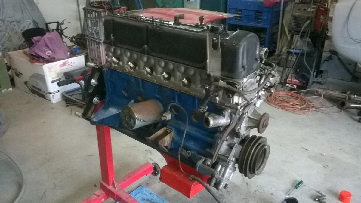

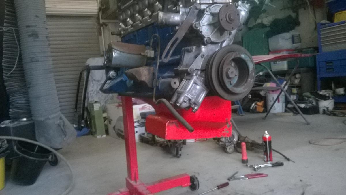

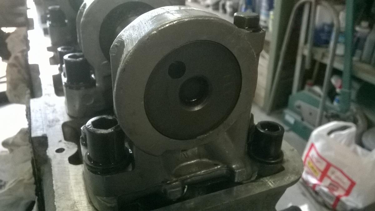

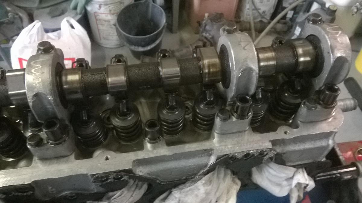

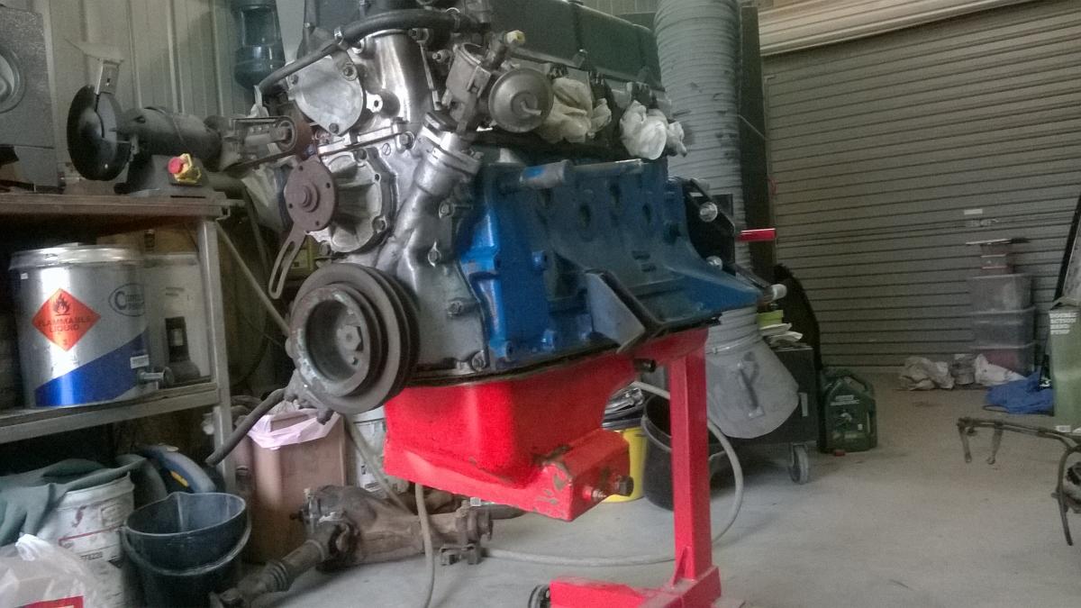

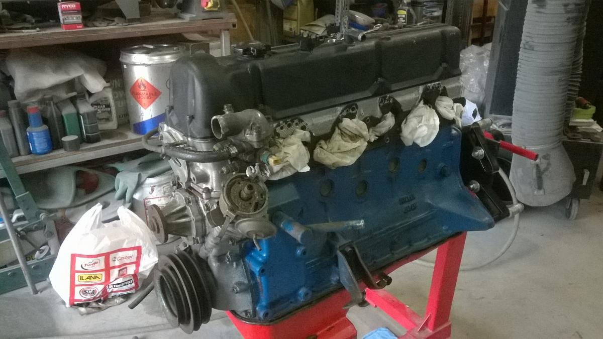

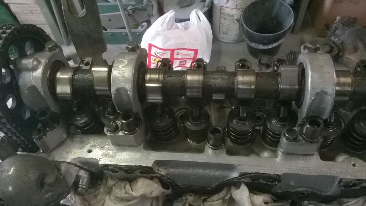

jeff43 Posted May 29, 2016 Author Posted May 29, 2016 The pup is doing well thanks Jeff. My L28ET arrived this weekend thanks to a mate that picked it up from Melbourne for me - I owe him some beers. I gave it a quick degrease and check over as It was an ebay sight unseen deal. Looks to be a in reasonable condition. Other than giving it a detail I will run it as is mechanically. As always I will let the pics do the talking. mspecr 1 Quote
Sirpent Posted May 29, 2016 Posted May 29, 2016 Should provide some fun, whats the longer term plan Jeff? Quote
jeff43 Posted May 30, 2016 Author Posted May 30, 2016 Should provide some fun, whats the longer term plan Jeff? Hi John, This is a bugdet build so initially I will run this engine as is with a decent intercooler, rb30 cas distributor, microtech lt-8 ecu, 3" exhaust, probably stock everything else. Tune it and see what we get. The motor is a bit of a bitsa n42 block (dished pistons), p90 head with an "E" cam. Has a modified larger capacity sump (looks like a winged keel - very fast). Doesn't look to have done a lot of work since a previous rebuild, I don't believe it has run for quite a while. In the future if it runs alright I will look to upgrade the turbo, injectors, throttle body and maybe add some compresion to gain some performance under the curve. Looking to do some hill climbing and super sprint type motorsport. So looking for response and torque more than outright power and must be reliable. I don't expect to have the money to upgrade the drivetrain initially so trying to keep power down around the 150-175 rwkw at the most and hope not to brake anything. Hopefully my mature driving style will help. Cheers Jeff Quote
Cozza Posted May 30, 2016 Posted May 30, 2016 That sounds like a sensible approach Jeff. Safe and affordable for the short term but providing options for down the track. I like it. Keep up the good work Mate Mick Quote

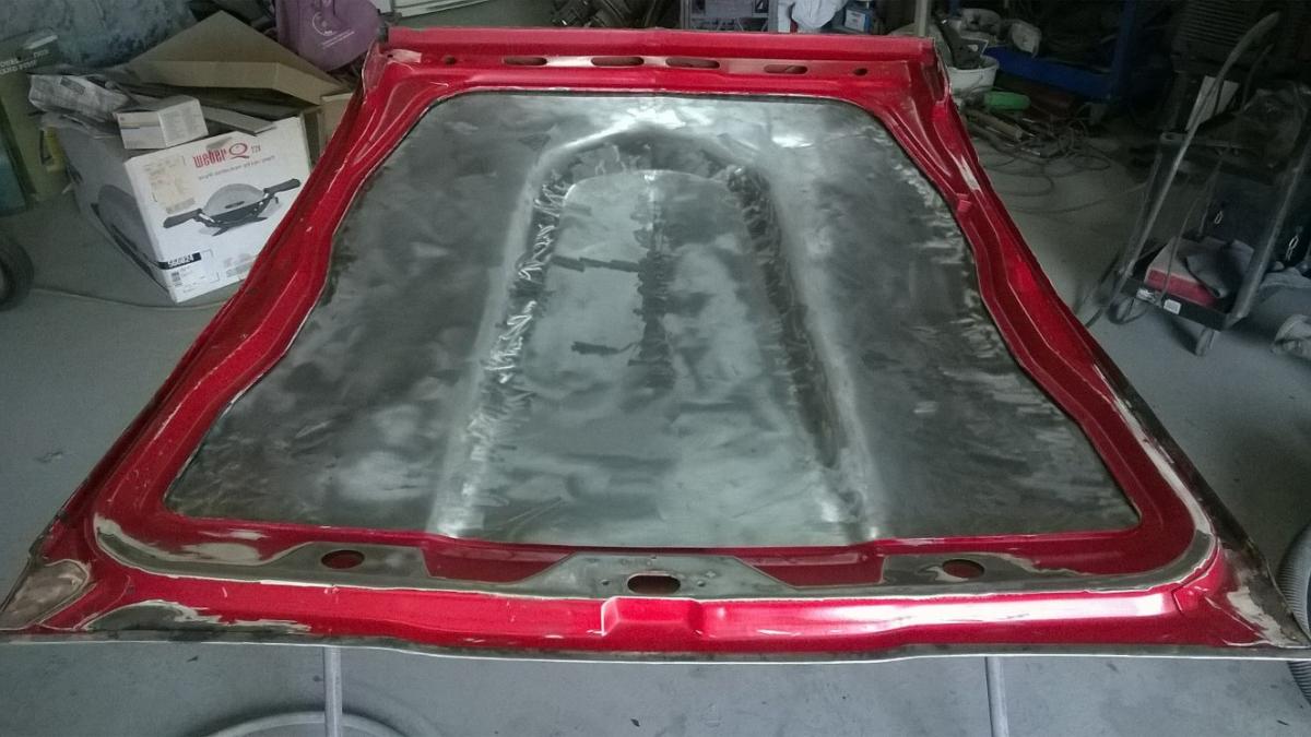

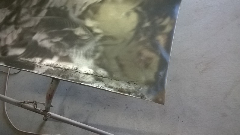

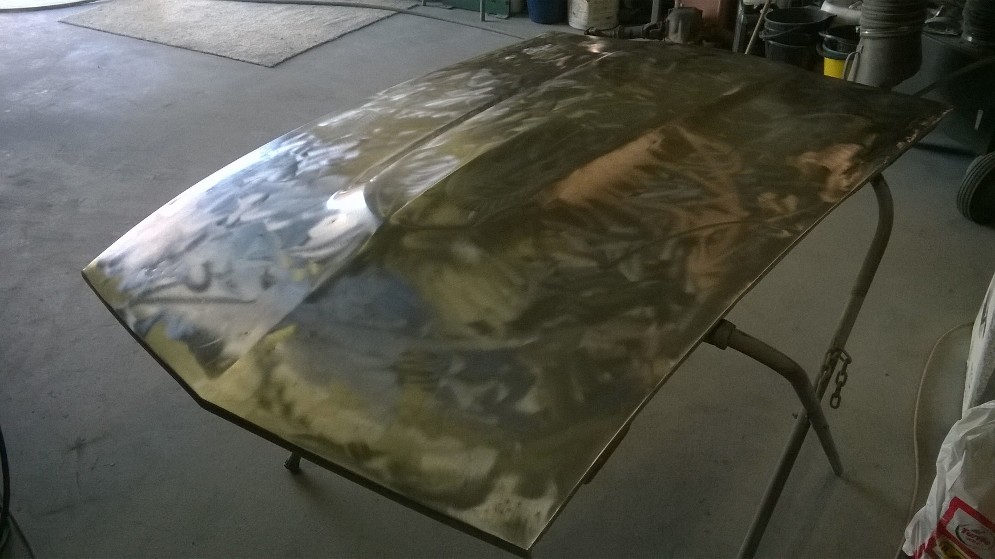

jeff43 Posted August 8, 2016 Author Posted August 8, 2016 Hi All, It has been a while. I got some hours in the shed yeasterday afternoon and the weather was nice in Adelaide for a change. Finished up grinding some welds back on repairs to the bonnet and finished stripping all the paint from the top of the bonnet. still got some work to do shrinking an area where I got a bit of warping during the welding process. Not looking forward to stripping the underside of the bonnet at, could be time to bring out the paint stripper. On an interesting side note, this is not the original bonnet of this car but the original colour of this bonnet is 907 green the same as the original colour of the car - just a bit ironic. Cheers Jeff George and gav240z 2 Quote
CBR Jeff Posted August 8, 2016 Posted August 8, 2016 Welcome back Jeff. Underside of the bonet is not going to be one of the most enjoyable jobs considering you won't see it very often the work for reward doesn't balance. On the other hand you see the top of the bonet every time you look at the car. Hope your car work life balance gets back more to the car side again soon. Jeff. Quote
jeff43 Posted August 8, 2016 Author Posted August 8, 2016 Thanks Jeff, definetely trying to get the balance back thats for sure. The underside of the bonnet is not very rewarding for the effort but it must be done. I wish I had have bought a brand new bonnet back when Nissan still had some available, looking back now they were an absolute steel (no pun intended) A carbon fibre bonnet is very enticing right about now, but even if I did lash out on one I know I would still like a steel bonnet as well so best just get on with it. Quote

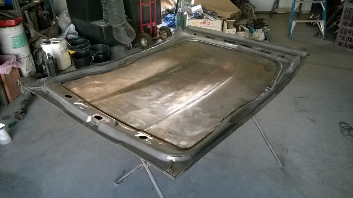

jeff43 Posted August 14, 2016 Author Posted August 14, 2016 So not much to show from the weekends efforts. Got the big easy section of the inside of the bonnet striped of paint, going to farm the hard bit (frame section) out to a sand blaster to save some time. I want to get this bonnet locked up in primer in the next few weeks. Other than this I spent some time working on the inside floor area getting it ready for paint but nothing photo worthy just yet. gav240z 1 Quote

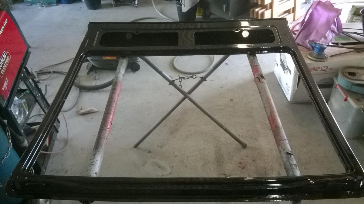

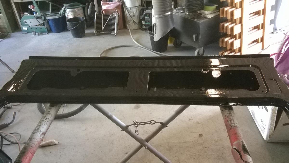

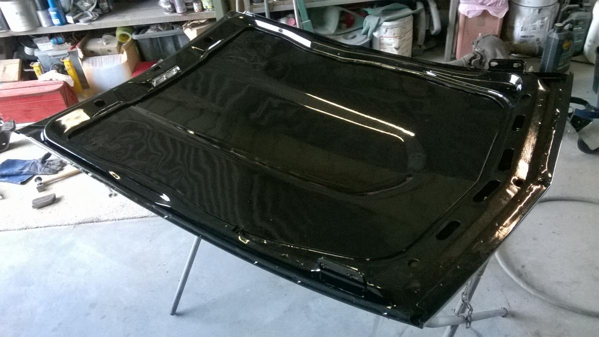

jeff43 Posted August 26, 2016 Author Posted August 26, 2016 So I had my bonnet underside frame sand blasted, saved me a heap of time, well worth it for $50. Then I painted the underside in KBS rustseal. Now ready for some undercoat top and bottom. I hope to get that done over the weekend, stay tuned. Cheers Jeff (J2) Quote
