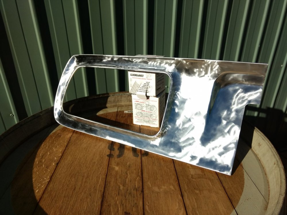

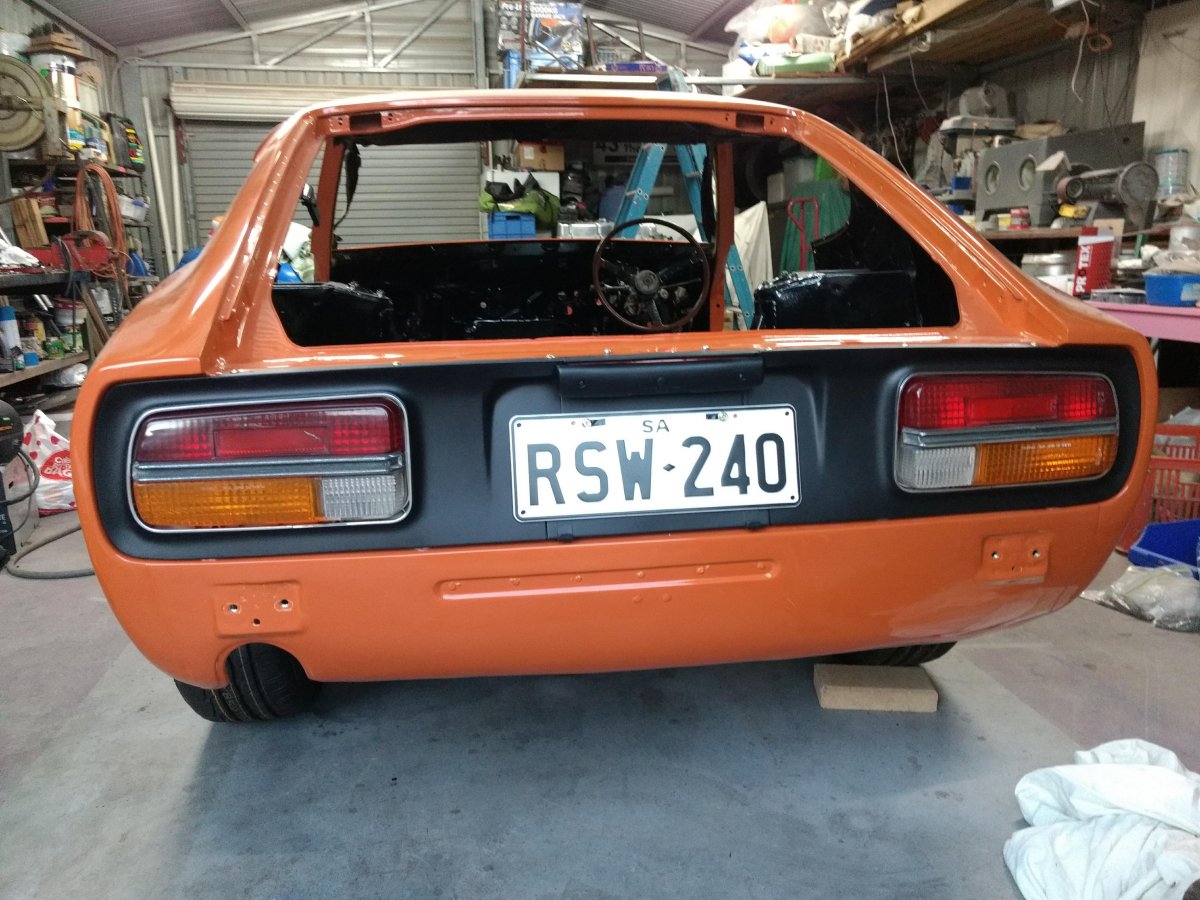

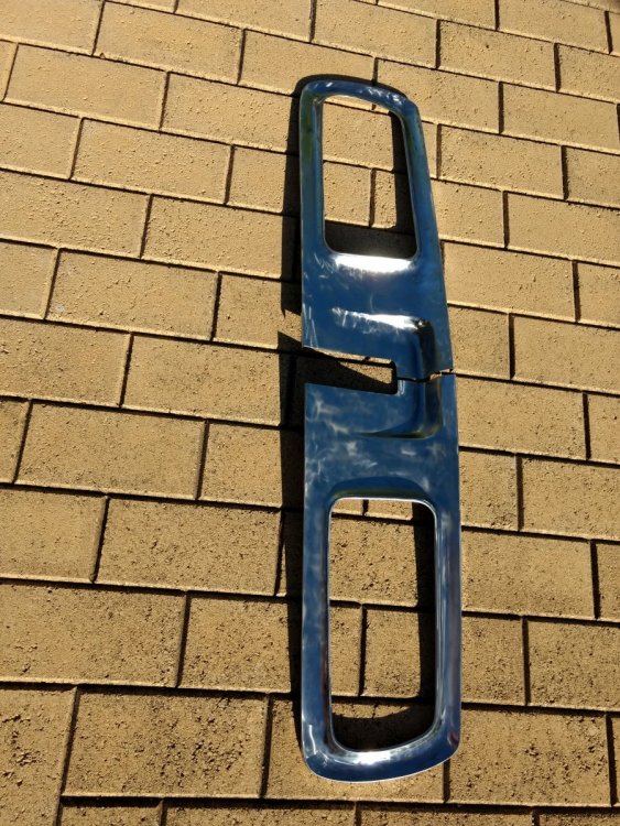

jeff43 Posted January 5, 2019 Author Posted January 5, 2019 (edited) Anyone like the polished metal look for the tail light surrounds (trim). Edited January 5, 2019 by jeff43 Quote

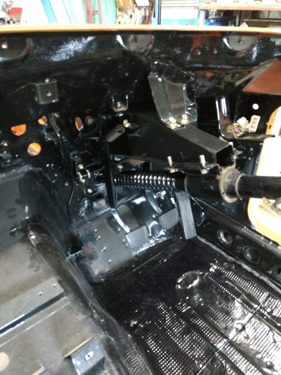

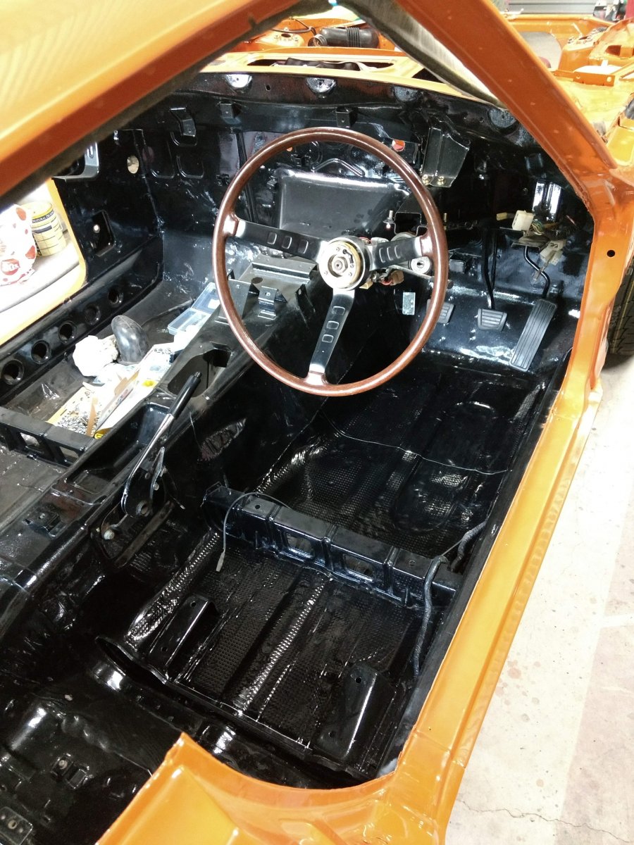

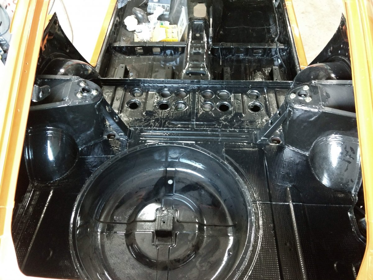

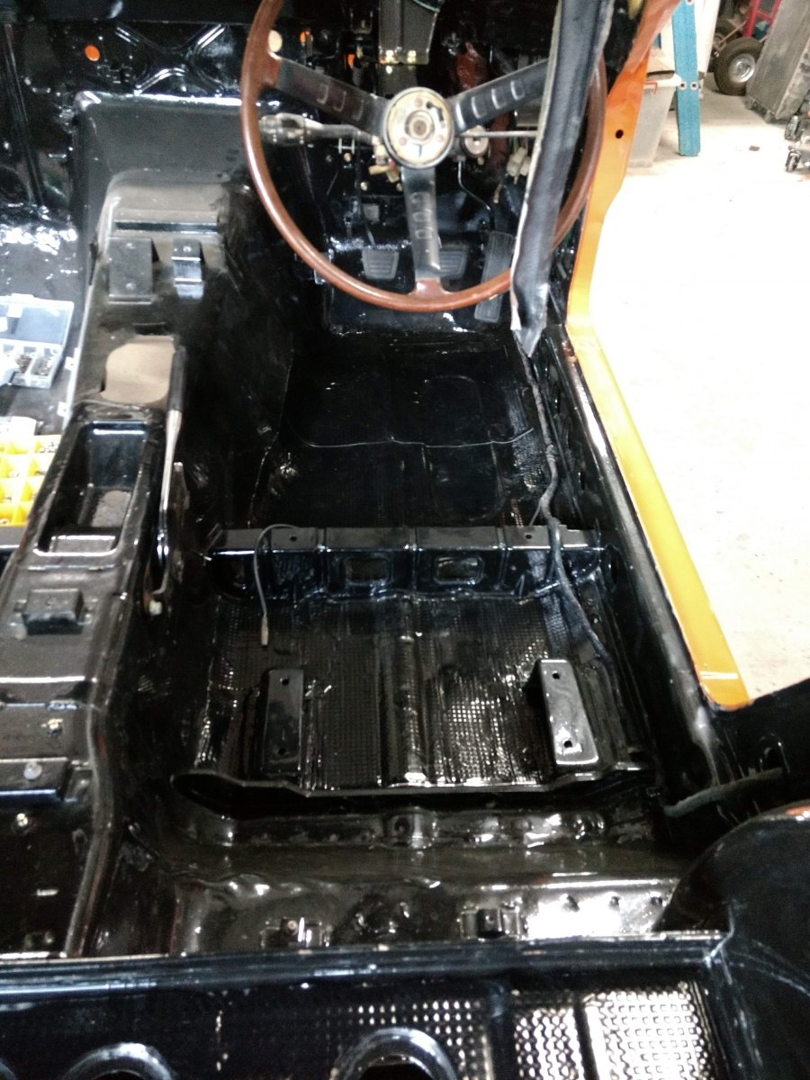

jeff43 Posted January 9, 2019 Author Posted January 9, 2019 I have been able to get a bit done this week. The engine bay is looking a bit busier, voltage reg, inspection lamp, fuel filter bracket, coil mount bracket and steering coupling all fitted and connected. Most of the sound deadening is installed, I have used Carbuilders OEM black. The steering wheel and pedal box are all fitted, as is the tail light trim panels, number plate light etc. Got a new number plate for Xmas as well. Cheers Jeff George and JDM-TOY 2 Quote
JDM-TOY Posted January 9, 2019 Posted January 9, 2019 @jeff43 nice progress mate, the black sound deadening looks clean in plane black, it makes it look OEM. Keep it up your inspiring me to put my Z together once the body is done. Possibly save some money too jeff43 1 Quote

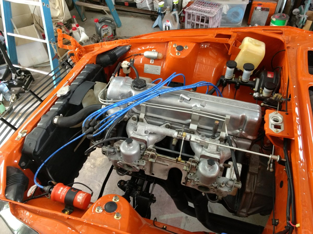

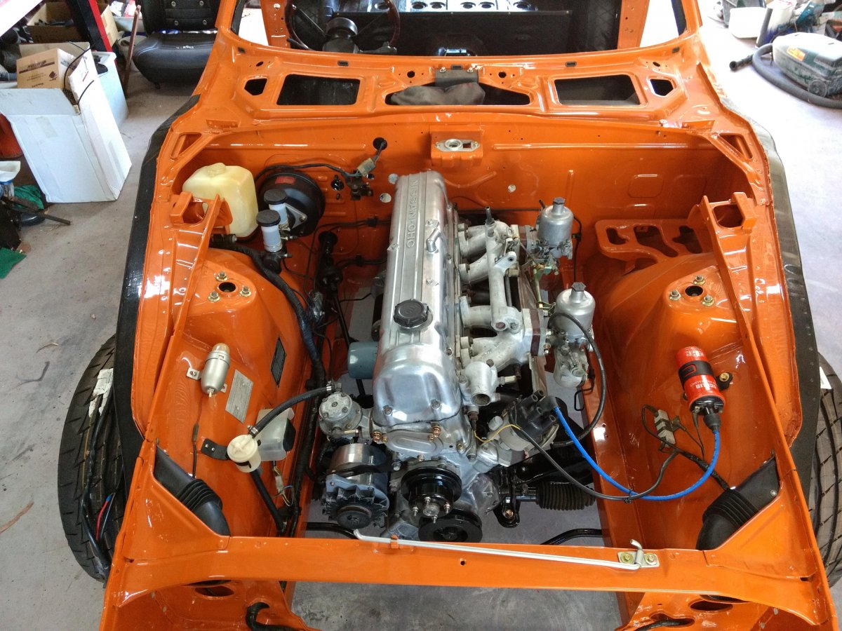

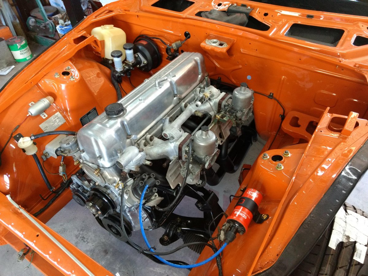

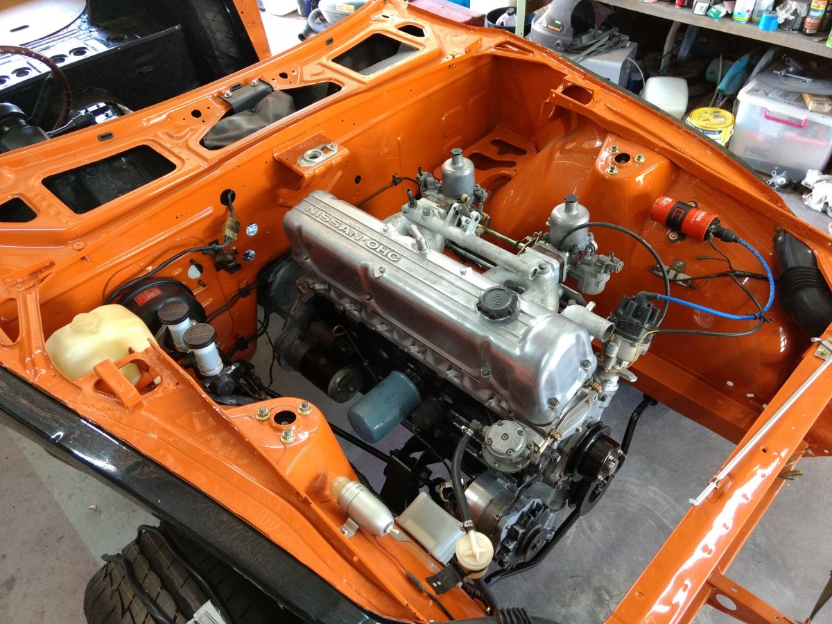

jeff43 Posted February 9, 2019 Author Posted February 9, 2019 So my mate Vorn came over this morning and gave me a hand to slip the engine and gearbox in the car. All went smoothly and for the first time in 7 odd years there is an engine in the bay. This is the original L24, I will get the car driving with this engine and then in the next year or so I will sort out the L28 out and slip it in. Check out the pics. Cheers Jeff AndBir, blu260z, George and 3 others 6 Quote

jeff43 Posted February 9, 2019 Author Posted February 9, 2019 1 hour ago, JDM-TOY said: Hey mate well done on the progress. Do you have any major plans for the L28? Thanks, pretty happy with the progress and thanks for the interest. So I have an N42 block, P90 head, setup as turbo as it stands, I'm not sure what it was out of, but it had a front sump. So I will either keep it turbo and set it up for drive ability over out and out power or I may change it to NA with either 280ZX fuel injection manifold and aftermarket ecu or ITB's or triple carbs. Not yet decided - I keep changing my mind. Cheers Jeff Quote

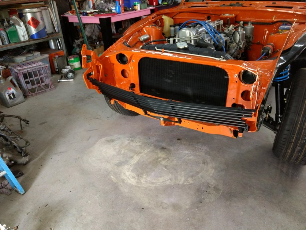

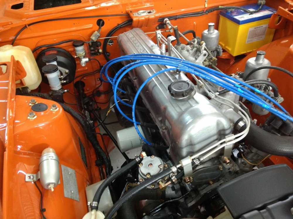

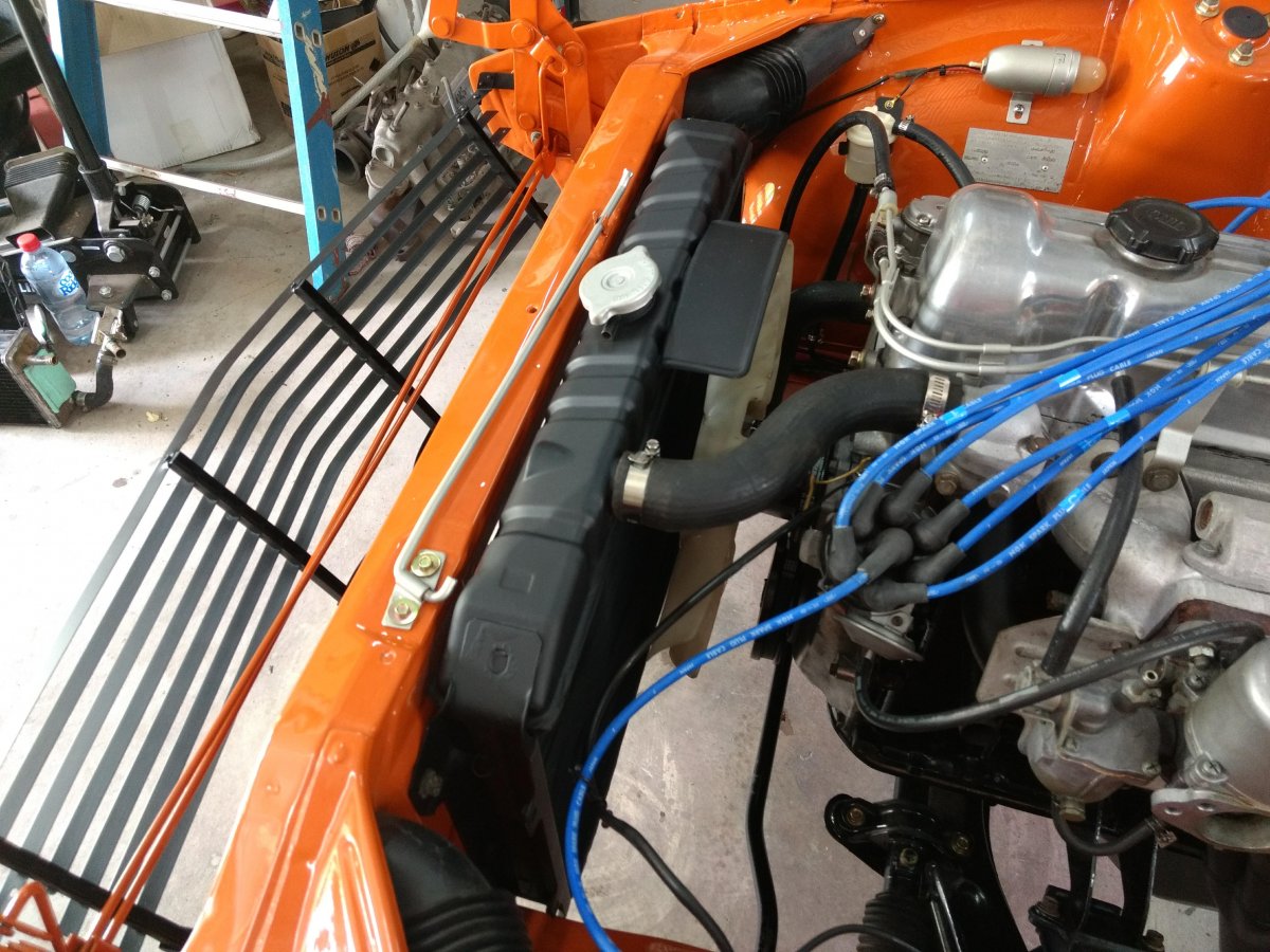

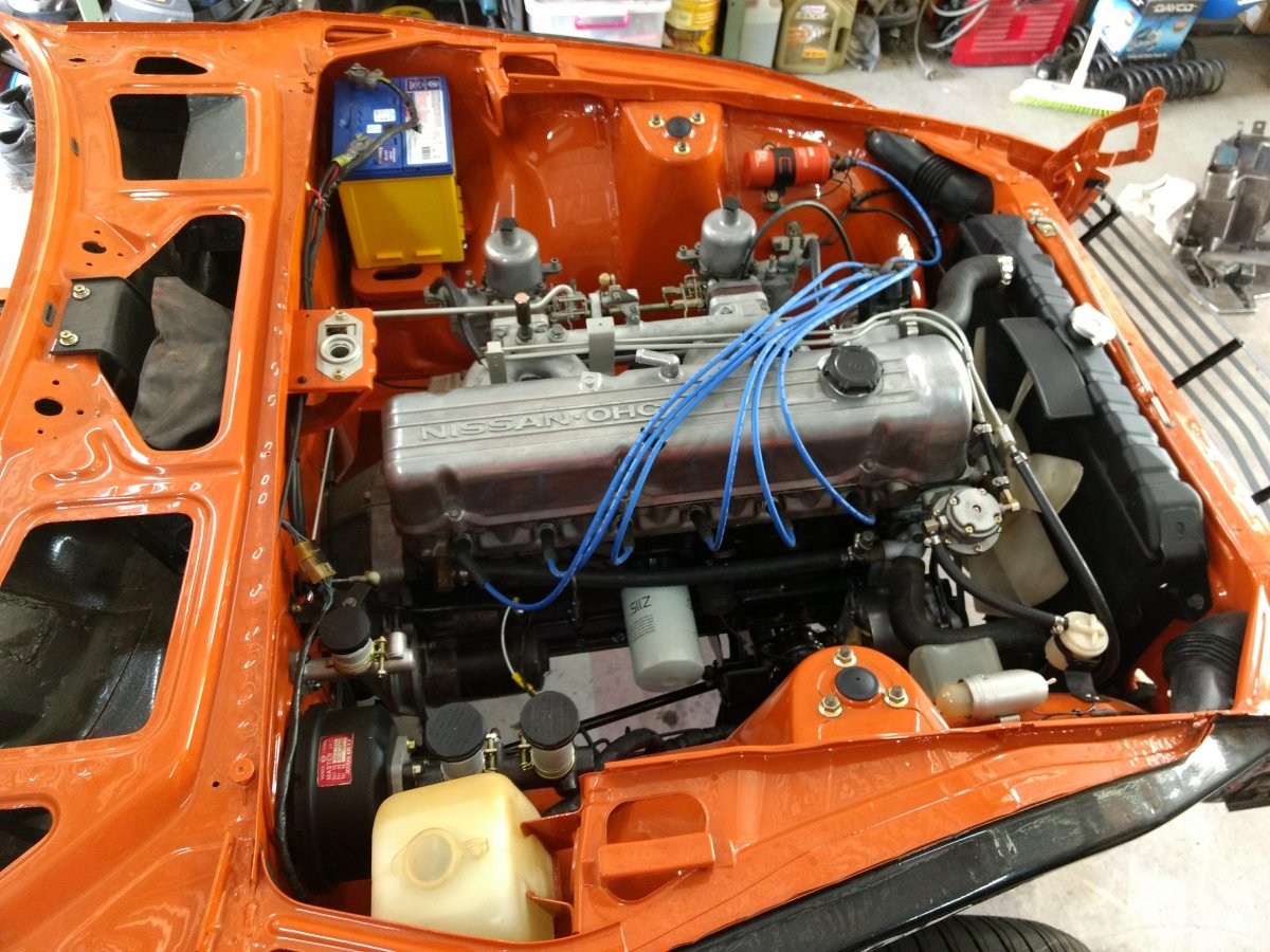

jeff43 Posted March 12, 2019 Author Posted March 12, 2019 Some Progress from the weekend. I have been doing some detailing of parts in the engine bay. The radiator has been painted, the grill painted. The clutch has now been bled and adjusted. The distributor drive has been setup correctly now and engine timing set and carbs tuned by ear. I'm pretty happy now with how the engine bay looks and the way the car runs. The starter motor still needs detailing. Now if my painter could just get all the hanging panels back to me and my weatherstrip kit would arrive then we could move on to making her look like a complete car. Patience is a virtue!!!! Cheers Jeff GongZ, George, KatoKid and 4 others 7 Quote
