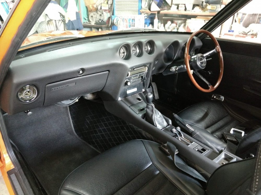

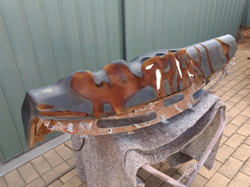

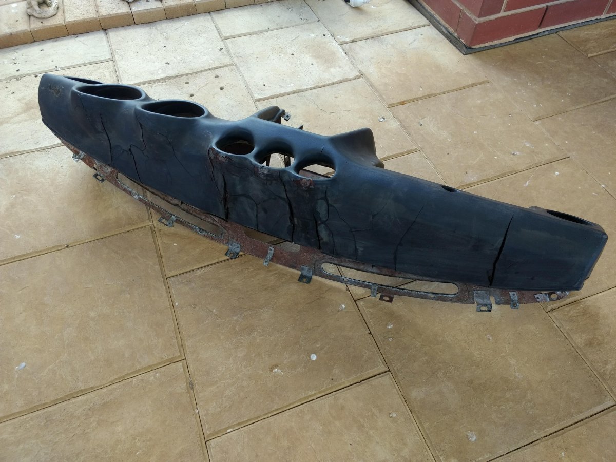

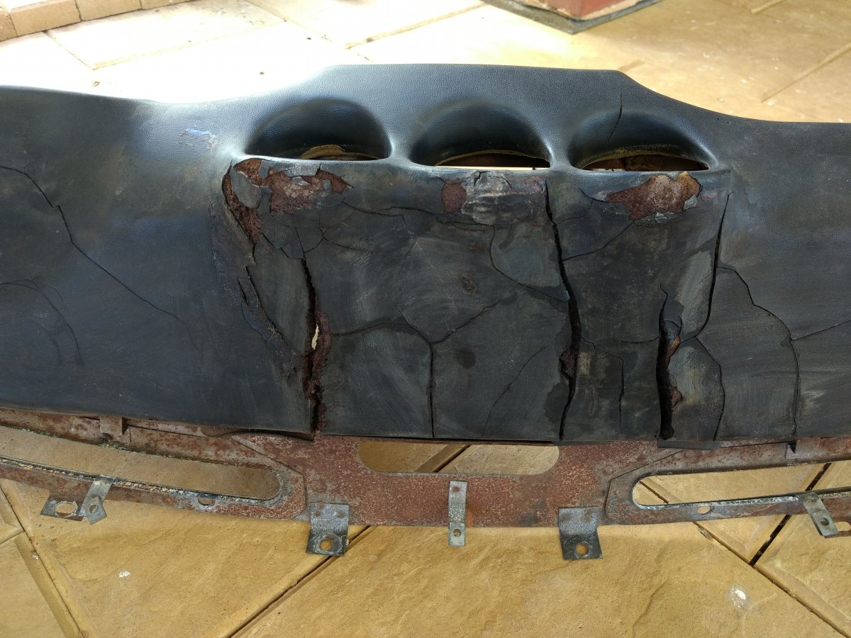

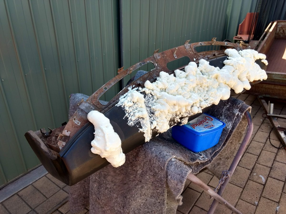

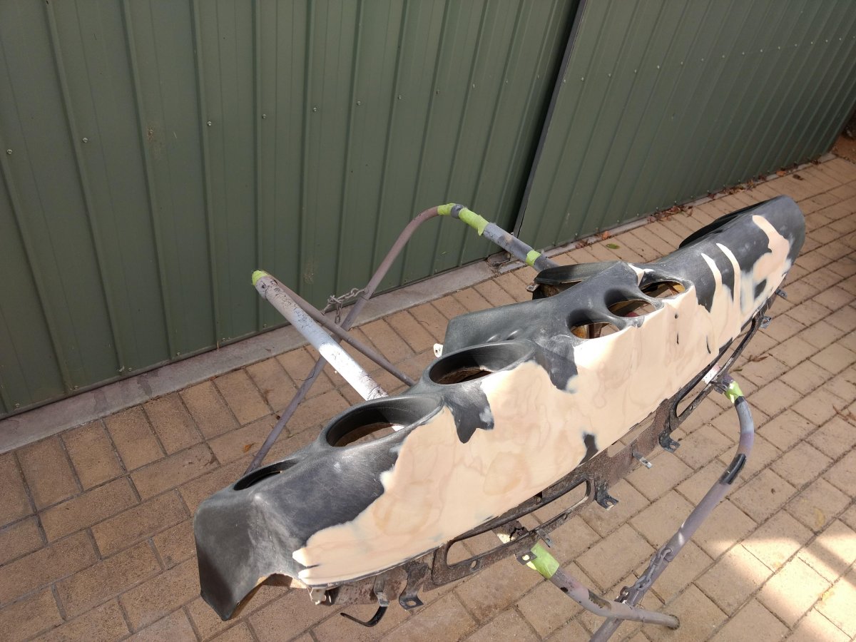

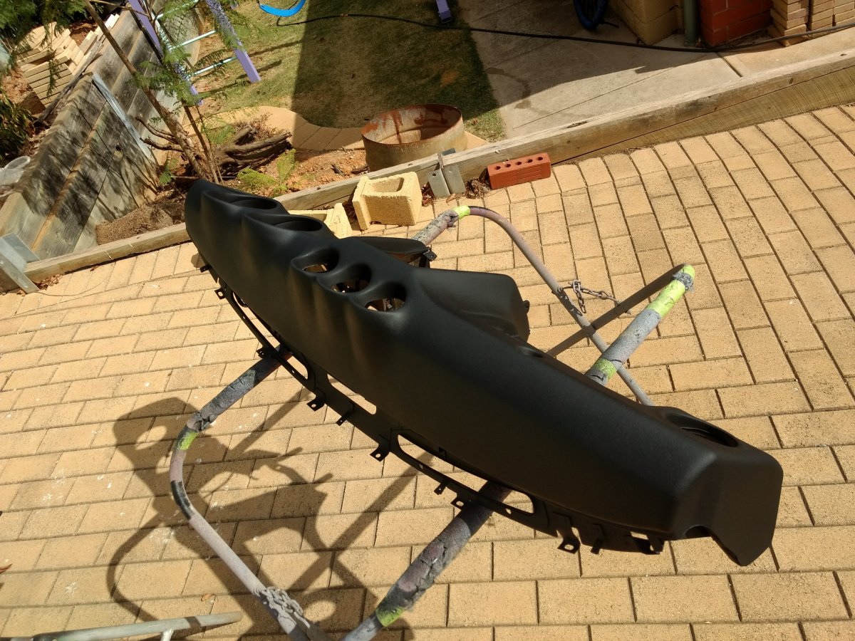

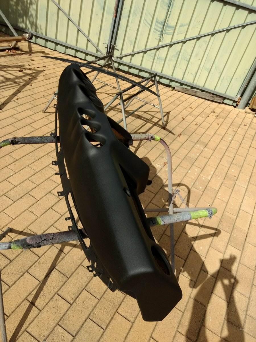

jeff43 Posted April 22, 2019 Author Posted April 22, 2019 Dash repair. Before pics, repair pics and end result pics. Very happy with the end result for $70 and a couple of days work. CBR Jeff and JDM-TOY 2 Quote
Ponyo240z Posted April 22, 2019 Posted April 22, 2019 The dash looks fantastic. What sort of spray did you decide to use? Quote
jeff43 Posted April 22, 2019 Author Posted April 22, 2019 1 hour ago, Ponyo240z said: The dash looks fantastic. What sort of spray did you decide to use? Thanks, really happy with it. I used Dupli-Color Bed Armor, the finish is rougher to the touch than the original vinyl finish but does look good all the same. Ponyo240z 1 Quote
JDM-TOY Posted April 22, 2019 Posted April 22, 2019 @jeff43 seriously mate dash looks amazing. great work champ. Quote
jeff43 Posted April 22, 2019 Author Posted April 22, 2019 3 minutes ago, JDM-TOY said: @jeff43 seriously mate dash looks amazing. great work champ. Thanks, I think it will look even better when it is back in the car later this week as this is one of the last things I need to fit before I can take her for a drive. Better get the Go Pro charged up! JDM-TOY 1 Quote
JDM-TOY Posted April 22, 2019 Posted April 22, 2019 1 minute ago, jeff43 said: Thanks, I think it will look even better when it is back in the car later this week as this is one of the last things I need to fit before I can take her for a drive. Better get the Go Pro charged up! Mate that Bed Armor will never crack, good idea. Quote
jeff43 Posted April 22, 2019 Author Posted April 22, 2019 1 minute ago, JDM-TOY said: Mate that Bed Armor will never crack, good idea. I hope it never cracks again, time will tell JDM-TOY 1 Quote

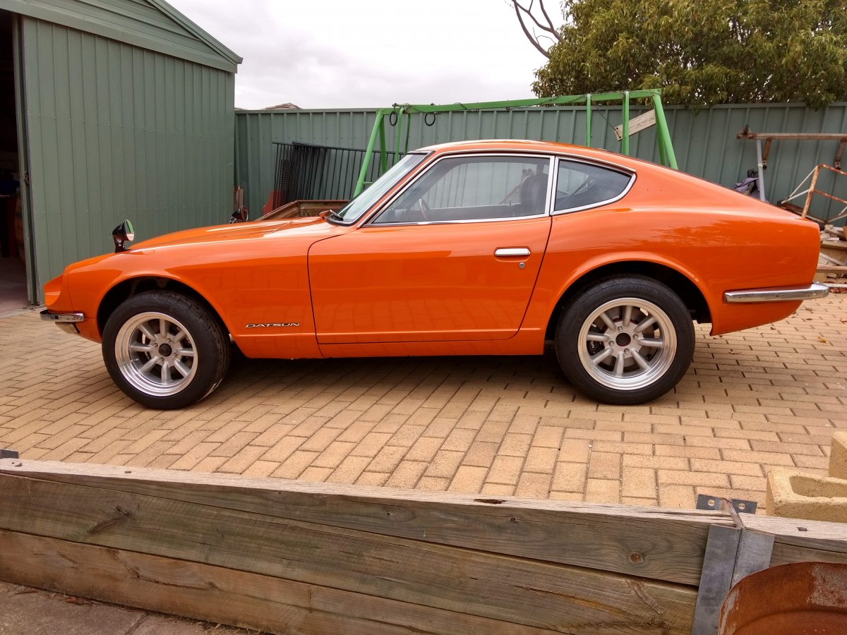

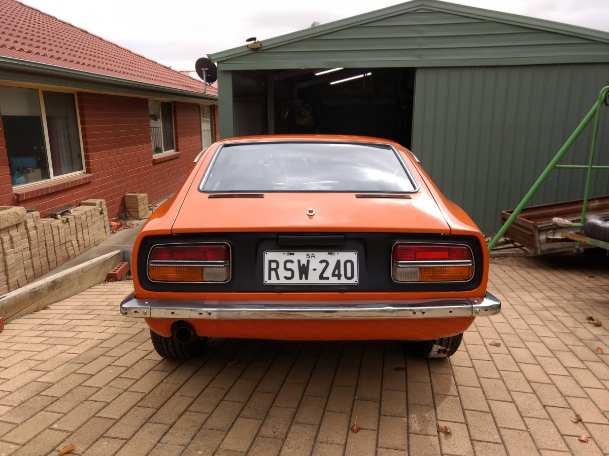

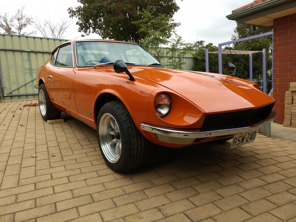

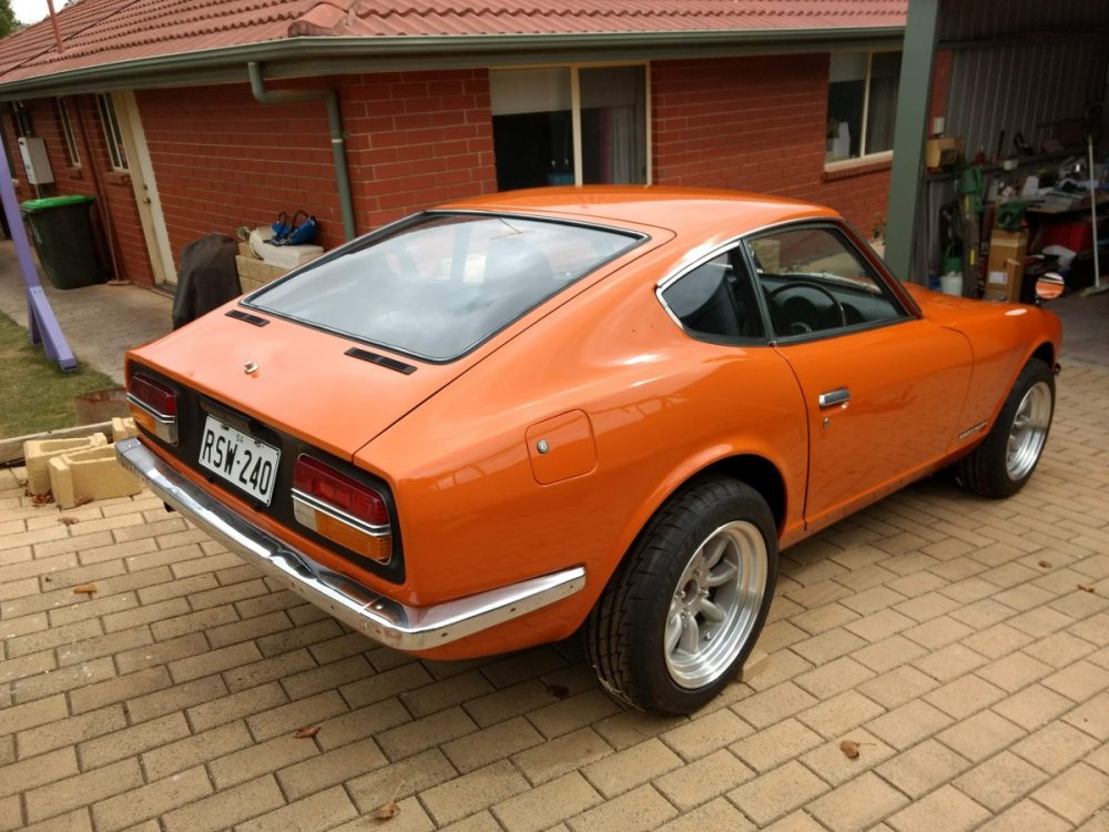

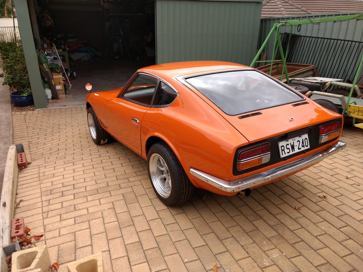

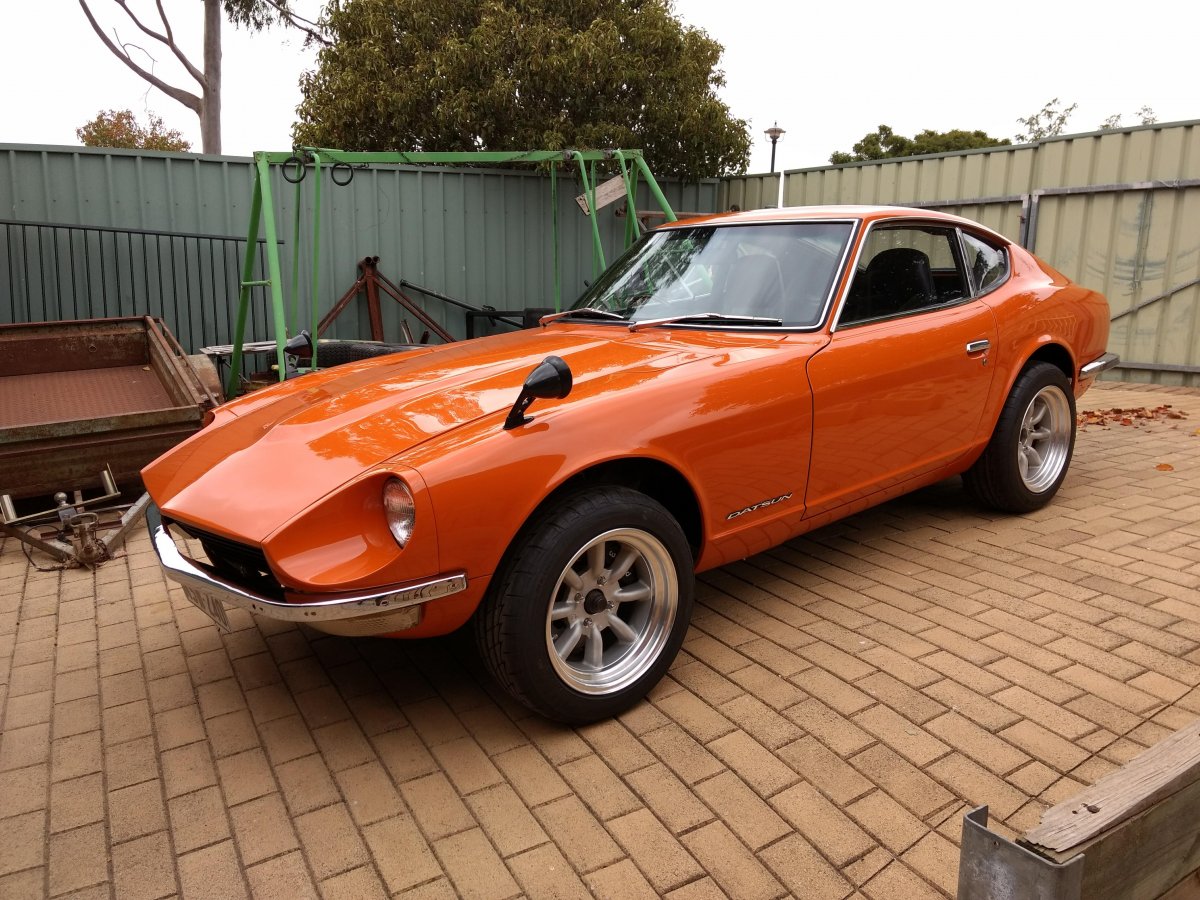

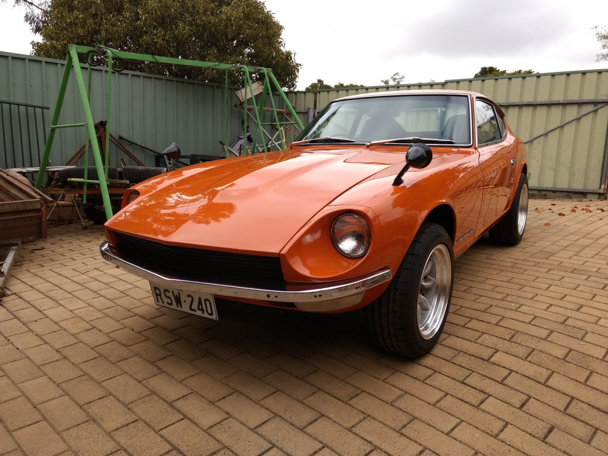

jeff43 Posted April 26, 2019 Author Posted April 26, 2019 Pics galore, this morning I backed her out of the shed under her own steam for the first time in about 13 years. She is all back together except the horns as they still have 49 yrs worth of filth all over them and the pillar badges which are with my mates son for him to airbrush touch them up. First shakedown drive around the block will probably be tomorrow so stay tuned for a quick video. After a few drives I will then do something about the ride height, angle grinder fitted with a cutoff wheel at the ready. Cheers Jeff AndBir, CBR Jeff, blu260z and 1 other 3 1 Quote
JDM-TOY Posted April 26, 2019 Posted April 26, 2019 @jeff43 She's a not bad ehh. Very nice mate, what a great feeling ay. jeff43 1 Quote
jeff43 Posted April 26, 2019 Author Posted April 26, 2019 Yep great feeling, just details now, some real mirrors, some new bumpers, get her to sit right etc. Nothing a bit more time and money can't fix. JDM-TOY 1 Quote
jeff43 Posted April 26, 2019 Author Posted April 26, 2019 I have had a quick drive around the block, sorry no video yet @George. She drives pretty good straight of the bat with an eye ball wheel alignment. Brakes need to bed in yet, but they seem pretty good too. I must say it pulls pretty good for a stock L24 too, pleasantly surprised. Nothing like your LCR monster @cbrjeff. Video soon!!!! The Go pro is mounted in the car for later when my wife gets home from work and I'm relieved of childcare duties, hopefully before it gets dark. George and CBR Jeff 1 1 Quote

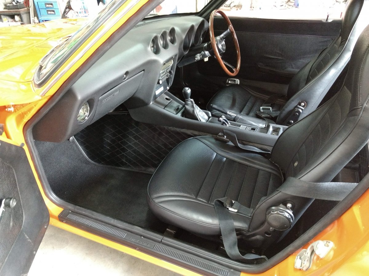

Riceburner Posted April 26, 2019 Posted April 26, 2019 Love it Jeff. Geez the dash came up a treat and that color really makes the chrome/stainless pop Quote

jeff43 Posted April 26, 2019 Author Posted April 26, 2019 46 minutes ago, Riceburner said: Love it Jeff. Geez the dash came up a treat and that color really makes the chrome/stainless pop Thanks, yep really happy with the dash and the colour. THe ride height is the only thing really playing on my mind. When I get the stance sorted, I will be happy. Quote
