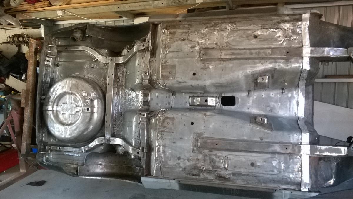

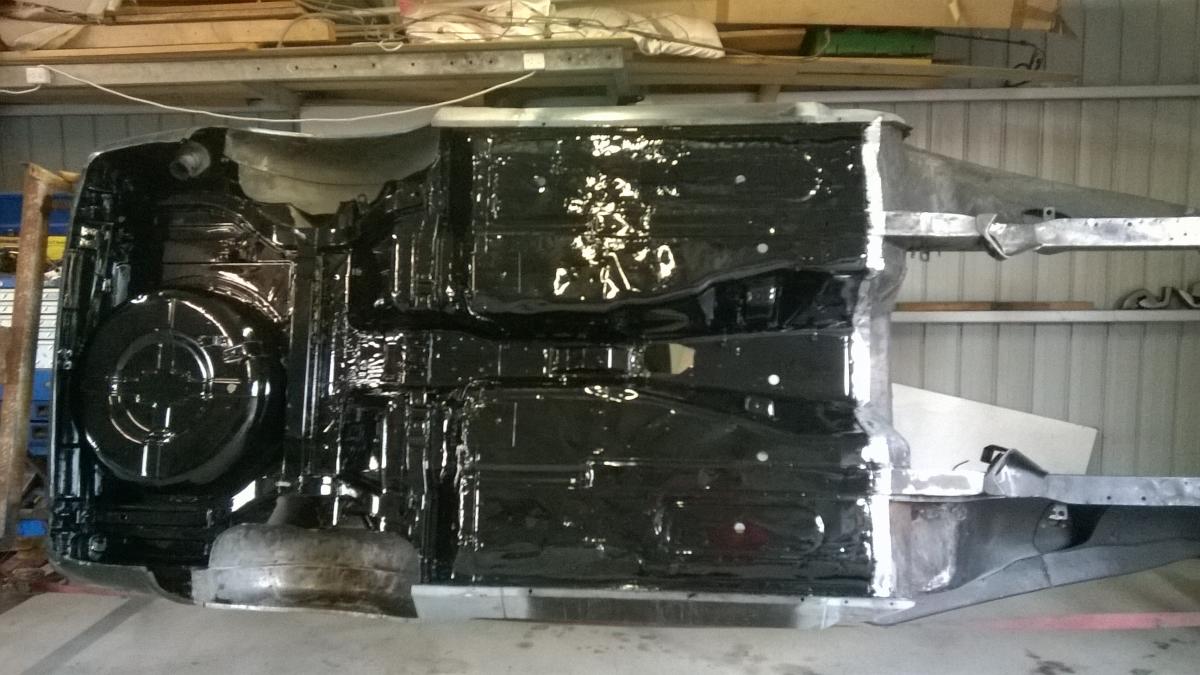

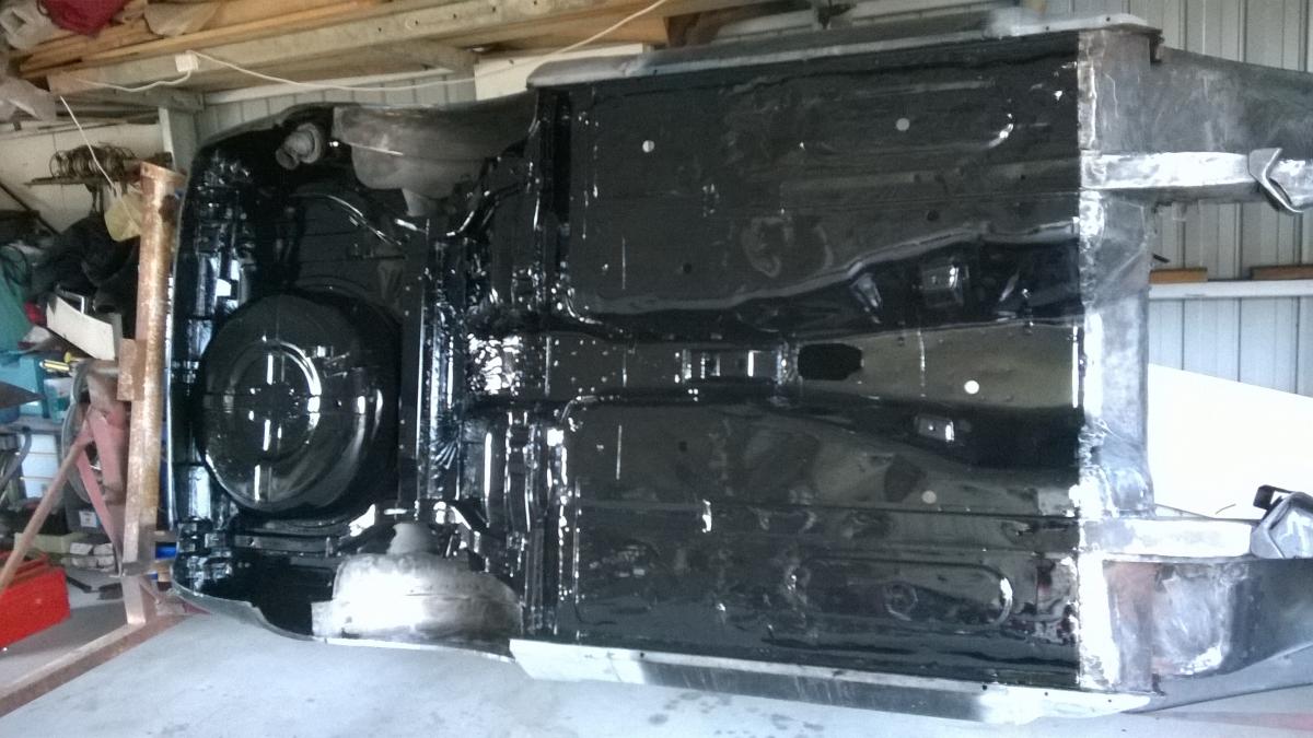

jeff43 Posted January 13, 2016 Author Posted January 13, 2016 Awesome work Jeff, good to hear the old shell is being saved as well. Keep at it. What other damage did the other early shell have? Cheers Thanks. The other early shell was Mossy's first 240Z (There is an old build thread on it). It had some damage to the drivers side footwell/firewall area - creased impact type damage and the rear wheel arch's on the rear quarters had been butchered for old style moulded flared guards. Nothing too bad. Mossy had already put new floors in and done most of the slam panel repair. The guy who got it from me was a panel beater by trade who had a very rusty 240Z and he planned to use his rusty one for the bits to sort Mossy's one out. Jeff Sensational work, great to see the level of prep and execution in this build ;-) Cheers John Thanks John, Coming from a guy with as much experience as you have that means a lot. It is a lot of work and I find it hard to stay motivated. The feedback from other members is really good for keeping the motivation going. I was so motivated that tonight I ducked out to the shed and quickly sorted the underside of the floor out!!!!! No seriously, I started prepping the underside of the floor about Mar 15 and finally painted it late Sep 15. I had a bit of paint left in the jar so I painted a few loose parts that I had already sandblasted and were ready to go. CBR Jeff 1 Quote

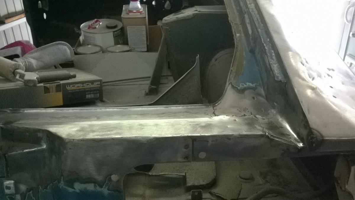

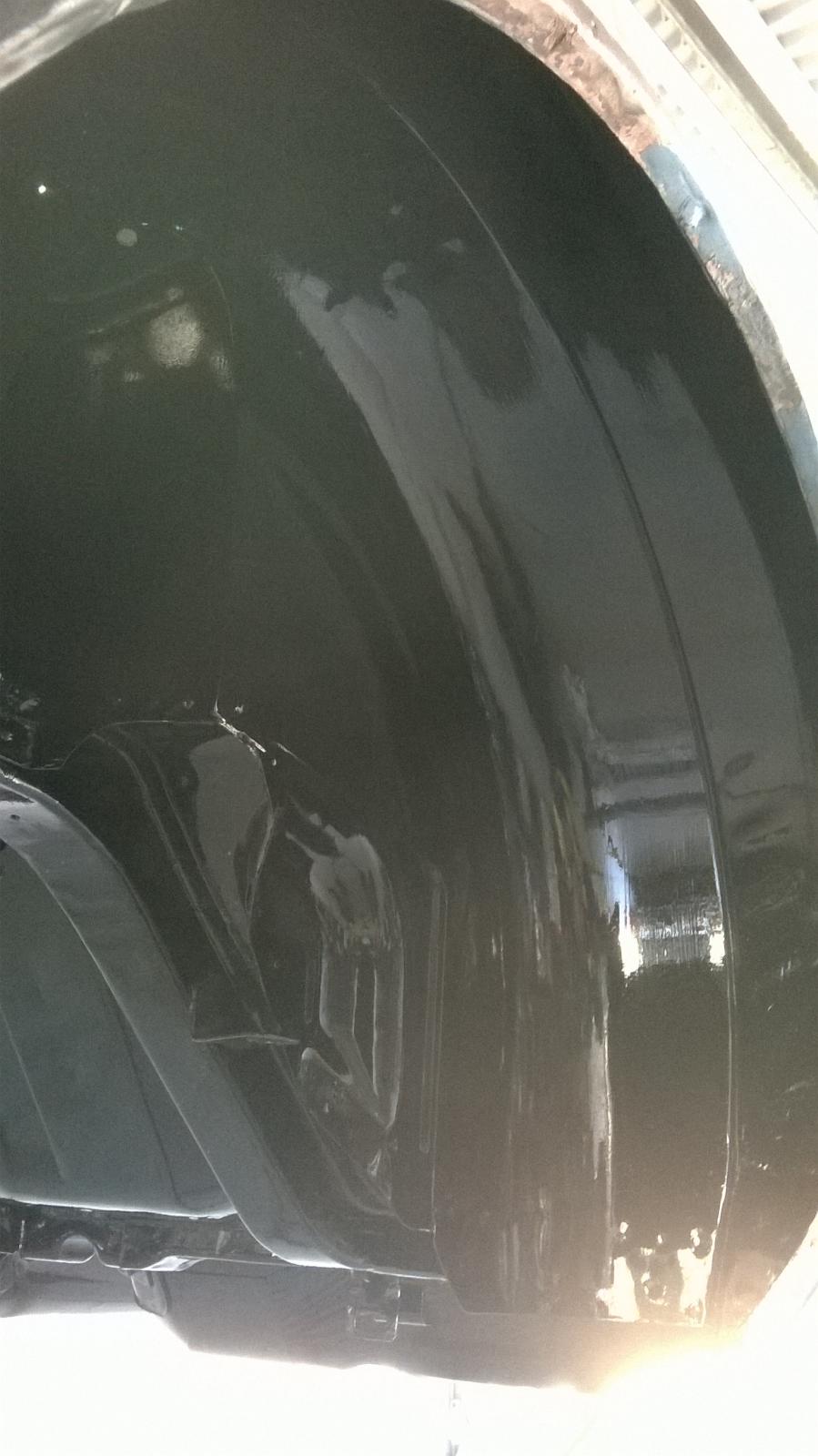

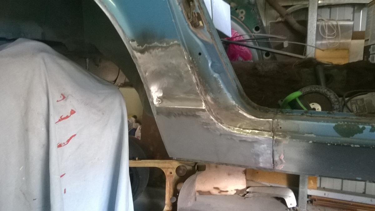

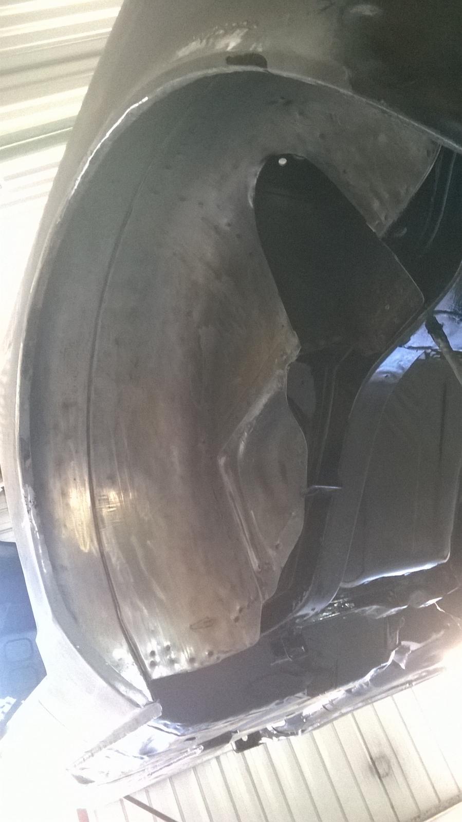

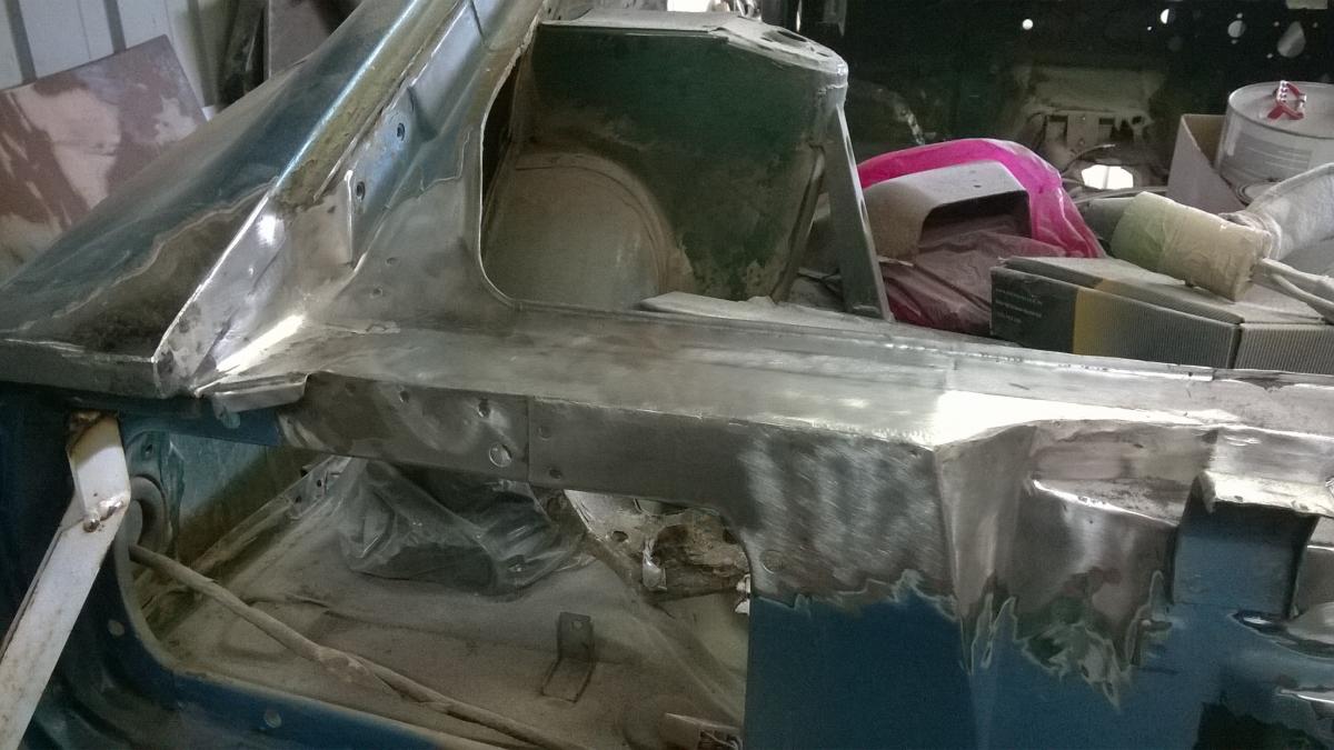

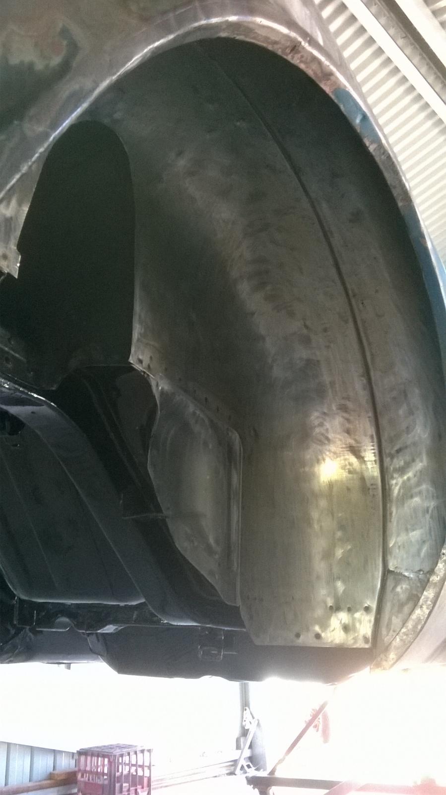

jeff43 Posted January 20, 2016 Author Posted January 20, 2016 Next I had to finish up the rear inner wheel arch areas left and right as I didn't do them when I did the floor (That was a big enough job as it was). Here is an assortment of the usual repairs to doglegs and the hatch slam panel. Andrew_L26 and gav240z 2 Quote
Andrew_L26 Posted January 20, 2016 Posted January 20, 2016 Wow just wow. I don't think there is anything I like more then a really clean BLACKKK underside *.* Quote

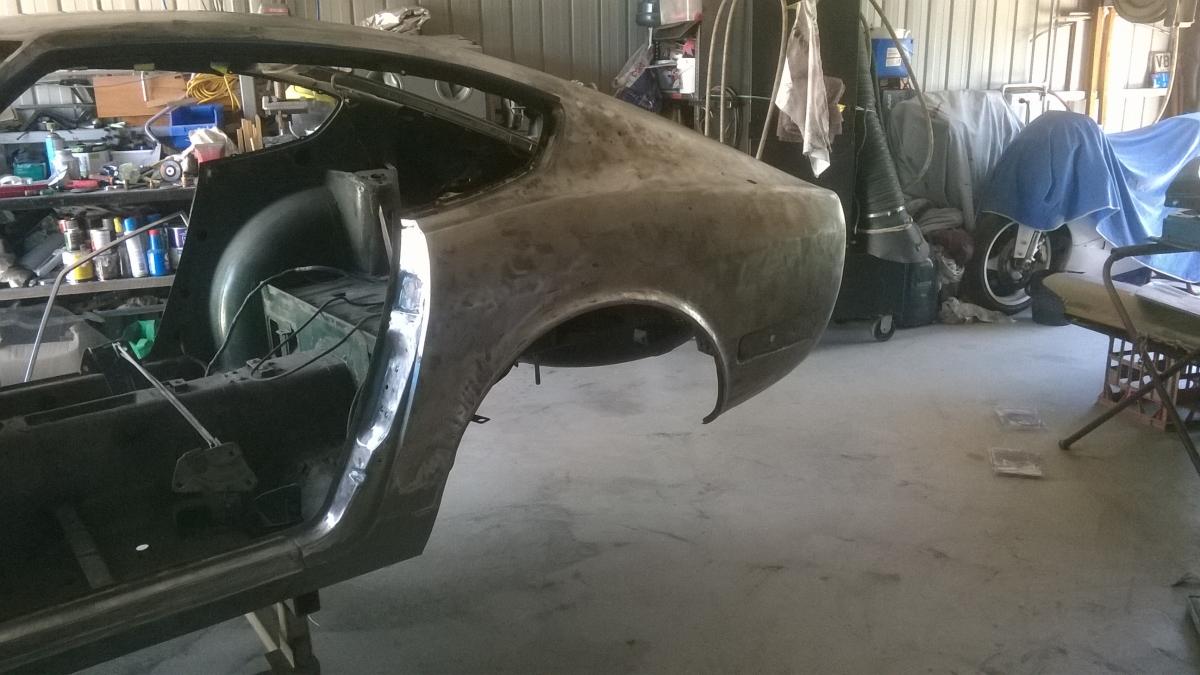

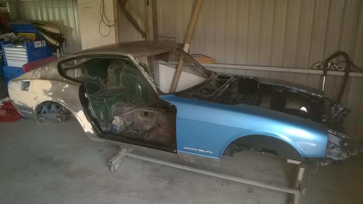

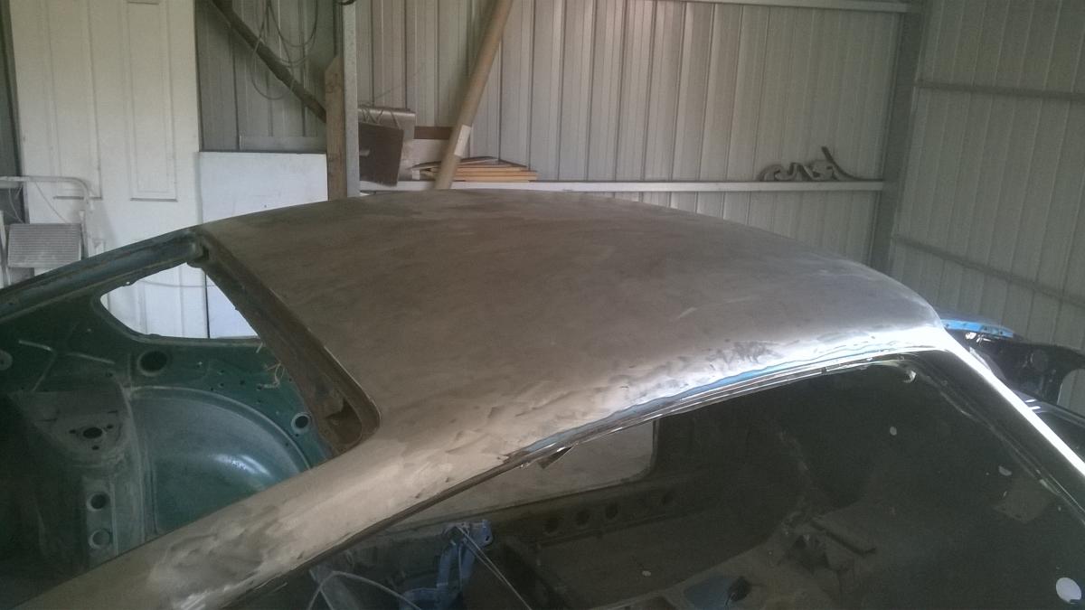

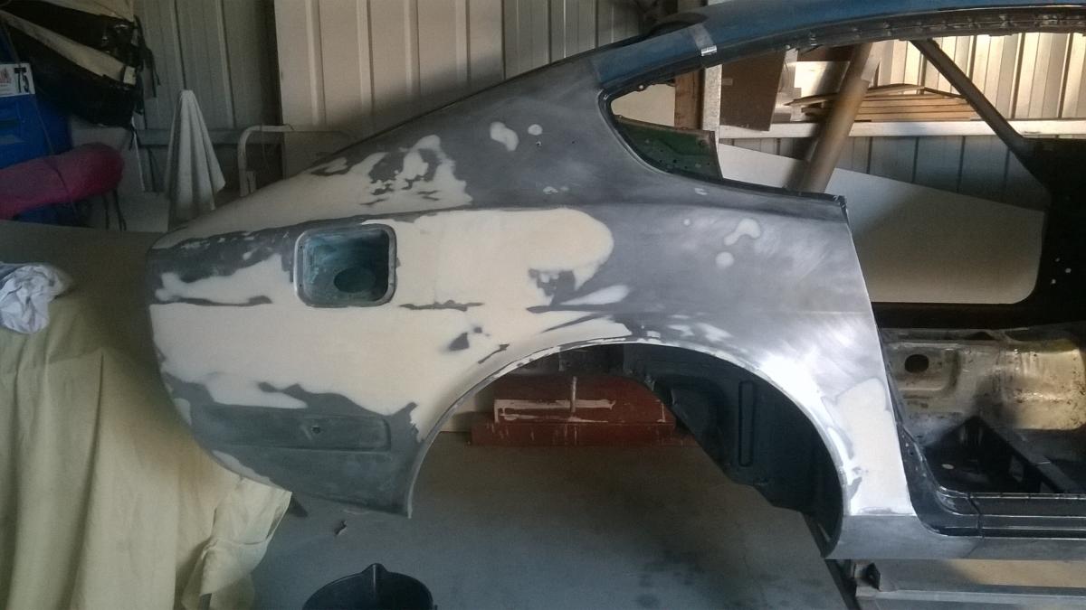

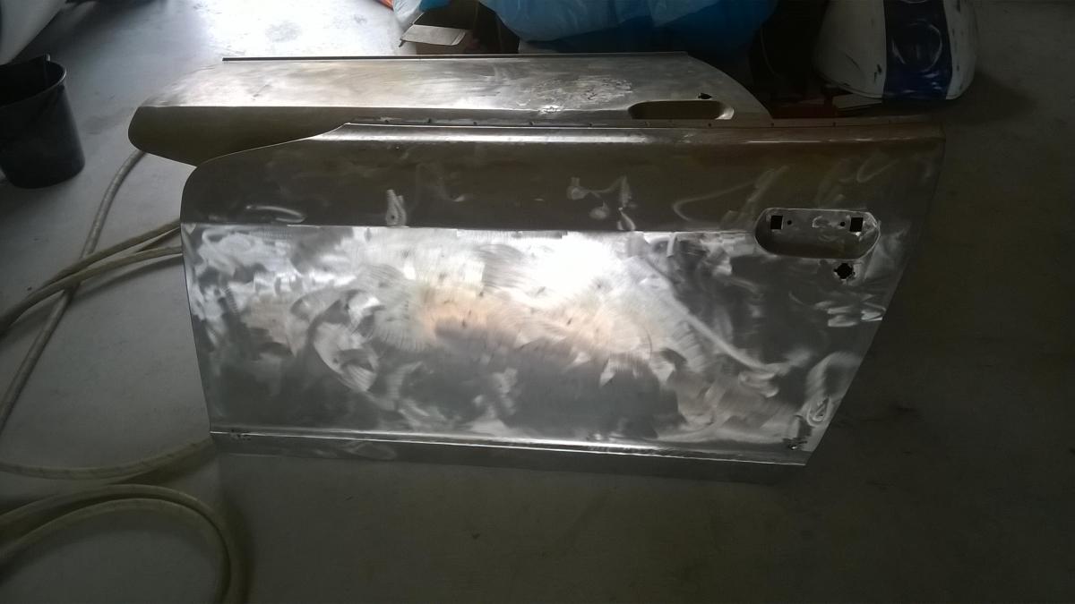

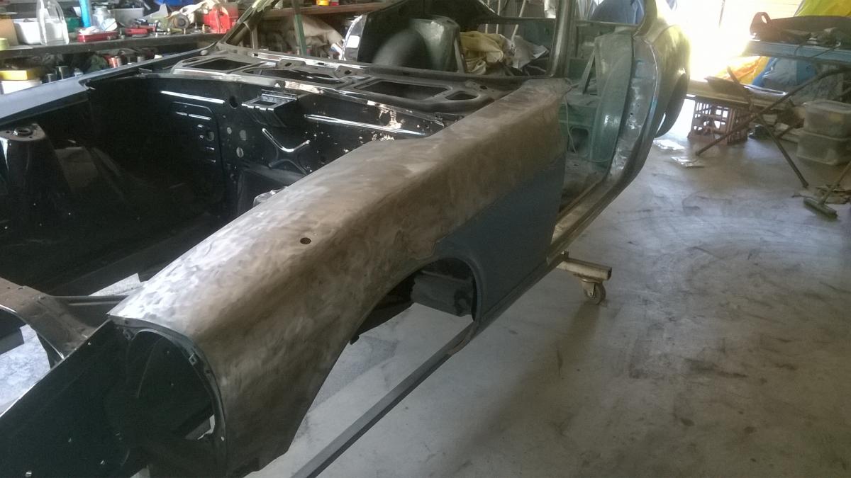

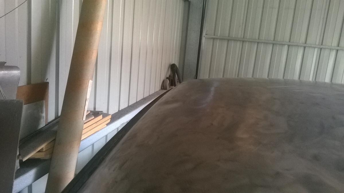

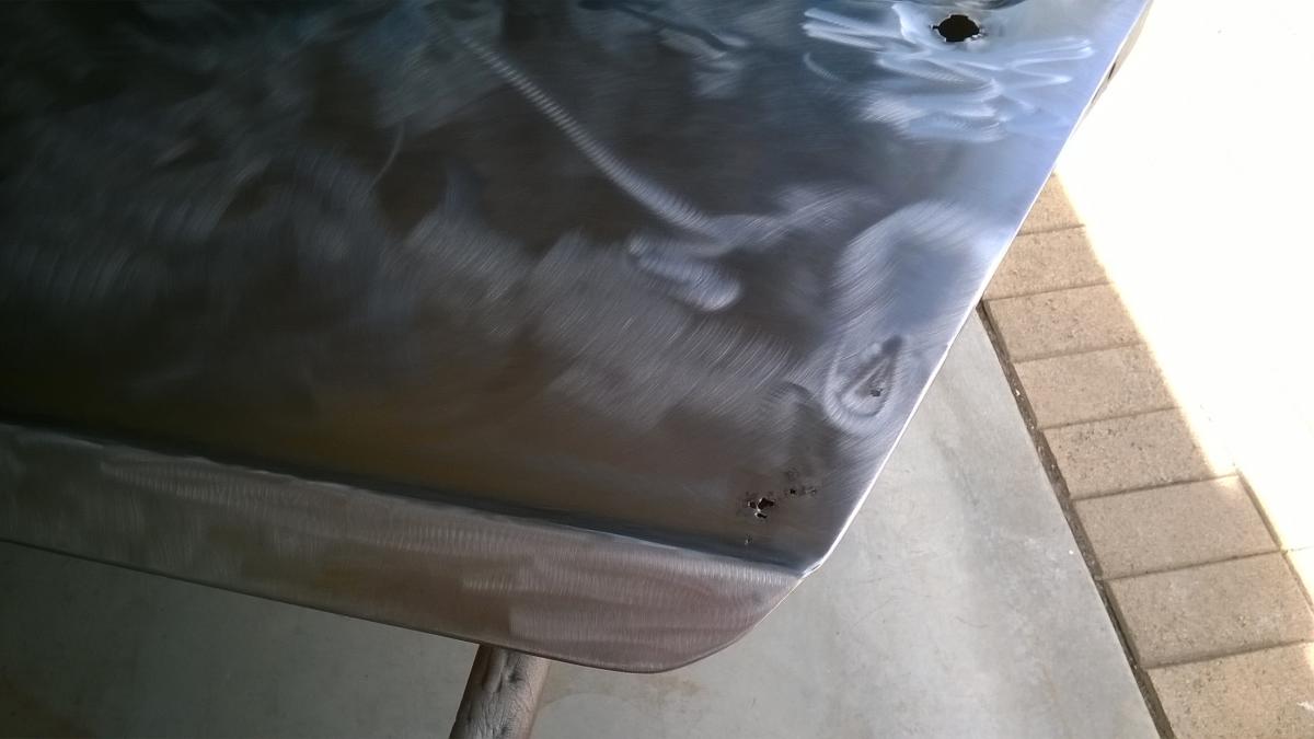

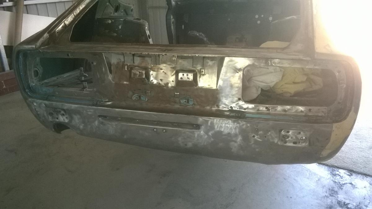

jeff43 Posted January 27, 2016 Author Posted January 27, 2016 Well this build has now caught up with real time now, so the updates will be slower to come in the future. The car is finally out of the roti, makes it a lot easier to move around the shed now on it's wheeled trolley. The rear quarter has been taken back to bare metal and is being prepped for primer. I have been trying to decide on either getting the car professionally painted or painting it myself. I got a quote a few weeks ago and I am leaning towards getting it done professionally. The workshop I have been talking with wants the car delivered to them completely back to bare metal, this will save me some money. So over the last few weeks I have been madly trying to strip all the paint from the car. So far I have found one small dent in the roof on the passenger side, a previous repair to the rh front guard and some small rust in the passenger door. Not to bad all in all. mother240 1 Quote
Administrators gav240z Posted January 27, 2016 Administrators Posted January 27, 2016 The dent in the roof should be easy enough to repair, the doors look amazing and the skins would be worth saving. Apart from that front end stack looks like it was a really well kept example. Lucky you! Quote
jeff43 Posted January 27, 2016 Author Posted January 27, 2016 Thanks for all the "likes" and encouragement, it certainly helps the motivation to keep going. The dent in the roof will be easy to sort, it was just bogged previously. I was pretty happy with the overall condition of the body so far. All in all it is very good for a 46 year old car. In 240Z terms this one is almost "rust free". Cheers Jeff Quote
