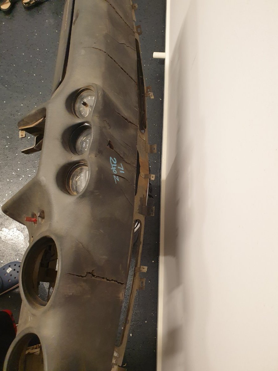

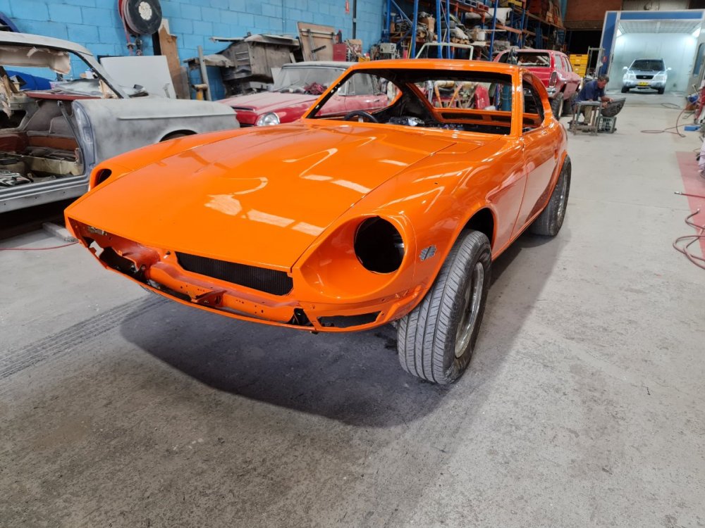

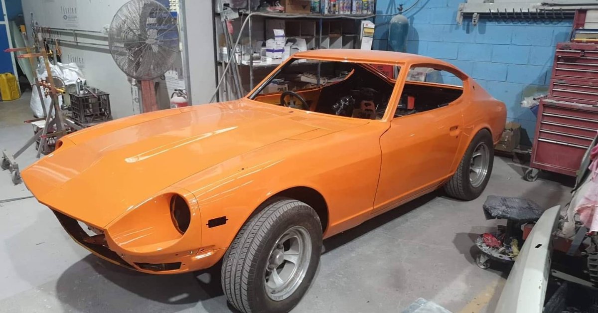

JDM-TOY Posted October 16, 2020 Author Posted October 16, 2020 (edited) So Beautiful cant wait to put all the parts back on. Edited October 16, 2020 by JDM-TOY Quote

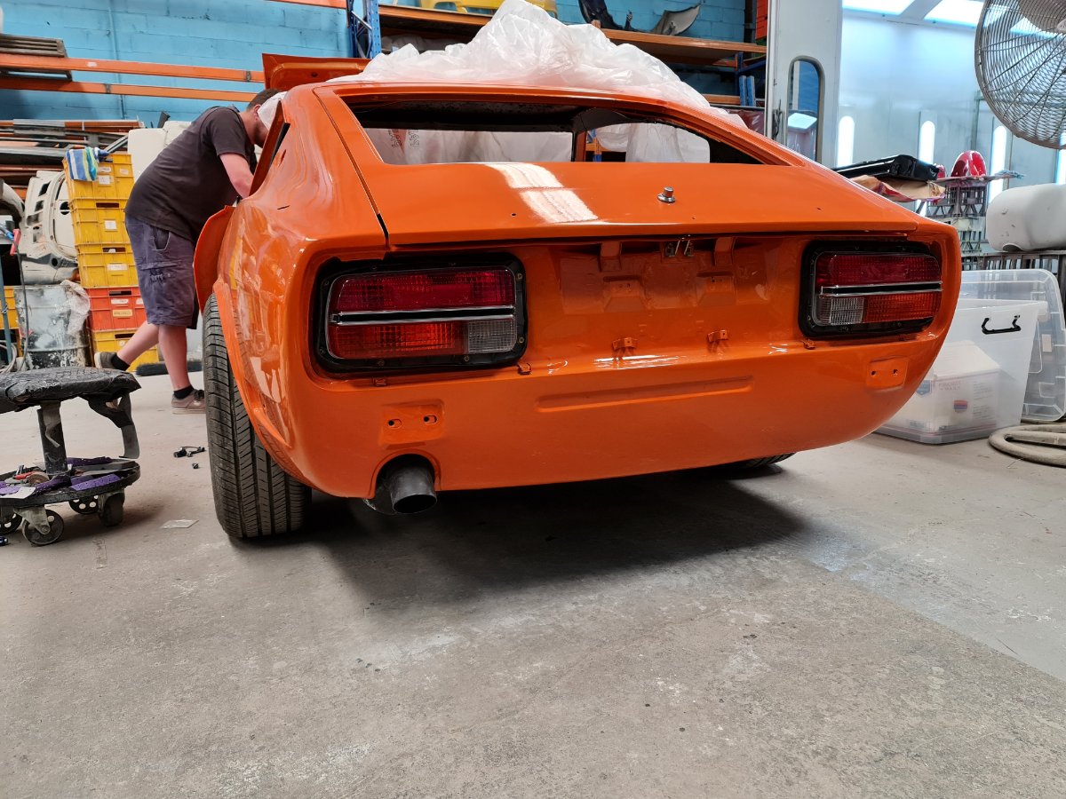

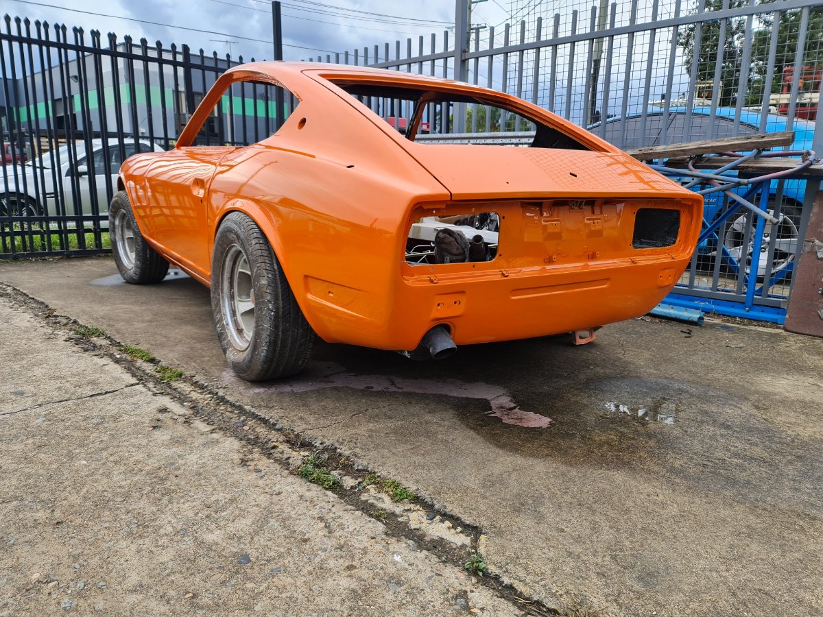

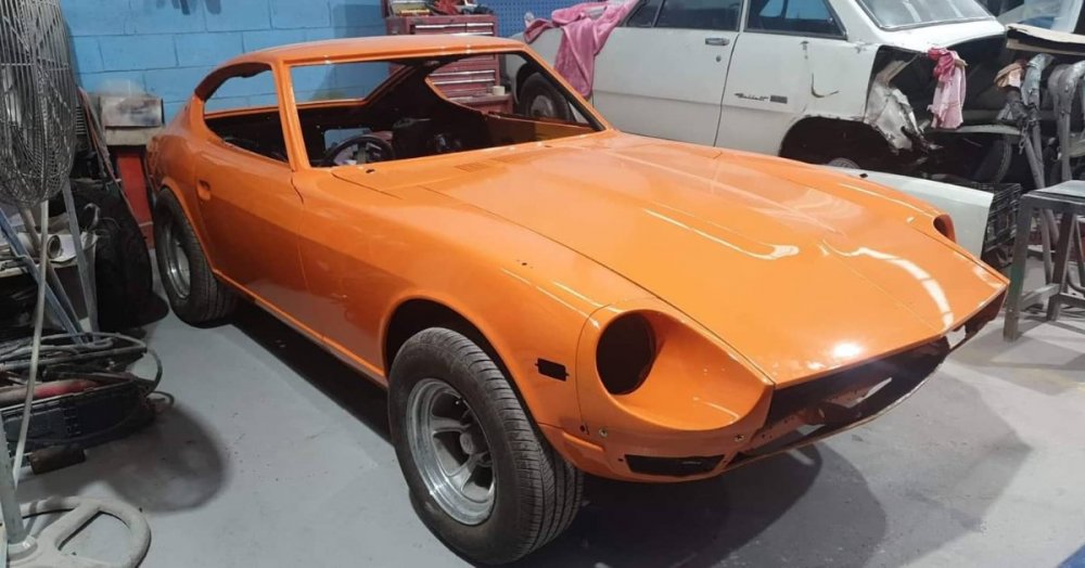

JDM-TOY Posted October 23, 2020 Author Posted October 23, 2020 Hey Guys Small update on the build I have not been out to see the car in person but I am little annoyed as after viewing the pictures of the car on my computer I noticed that there is a colour variation in the panels as they did not look different on my phone when I received them. I spoke to the panel beater and he said he will need to paint the whole car again with every panel on the car as he had previously painted the car separately. This build has become very frustrating, Not sure if anyone else has had these same issues with restoration shops Anyways moving on.... So, in one of my previous post I had put up a picture of my dash that I had the Dash Dr repair and had all the gauges calibrated and the clock serviced. After some discussions with a few people regarding the old technology from the 70's that we would have issues getting the correct readings in the old gauges. I decided to get a Haltech IC-7 Display so that it would match up with the Haltech Elite 2000 and everything new going into the car so that I don't get caught off guard when I'm out driving the car. Since I had had my dash repaired, I could not find it in me to cut it up to install the IC-7 so I sourced another dash from Carlos at Sports Classics to have the IC-7 moulded and recessed into the centre of the original 240z dash replacing the original gauges. After the IC-7 has been moulded in I will send this dash over to the Dash Dr to do a full repair on it so that it is vacuum sealed as one piece Has anyone attempted to try this before? Quote
C.A.R. Posted October 23, 2020 Posted October 23, 2020 (edited) 5 minutes ago, JDM-TOY said: I have not been out to see the car in person but I am little annoyed as after viewing the pictures of the car on my computer I noticed that there is a colour variation in the panels as they did not look different on my phone when I received them. I spoke to the panel beater and he said he will need to paint the whole car again with every panel on the car as he had previously painted the car separately. This build has become very frustrating, Not sure if anyone else has had these same issues with restoration shops He dun goofed. That's not how you paint a car... Edited October 23, 2020 by C.A.F. gav240z 1 Quote
JDM-TOY Posted October 23, 2020 Author Posted October 23, 2020 1 minute ago, C.A.F. said: He dun goofed. That's not how you paint a car... Im sick of telling someone who apparently knows how to do his job, how to do his job. So now the whole car will get rubbed back and painted again...... Is this acceptable ? Is he expecting to charge me for his time to repaint the car? Quote
C.A.R. Posted October 23, 2020 Posted October 23, 2020 12 minutes ago, JDM-TOY said: Im sick of telling someone who apparently knows how to do his job, how to do his job. So now the whole car will get rubbed back and painted again...... Is this acceptable ? Is he expecting to charge me for his time to repaint the car? That is something you will have to discuss with him. gav240z 1 Quote

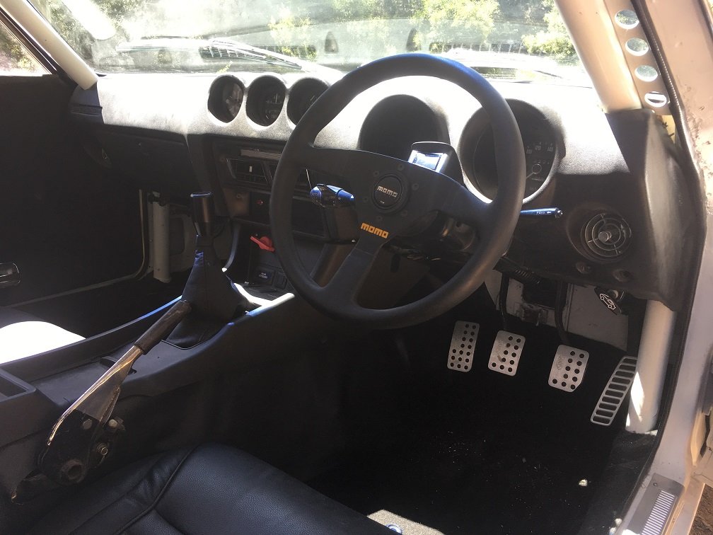

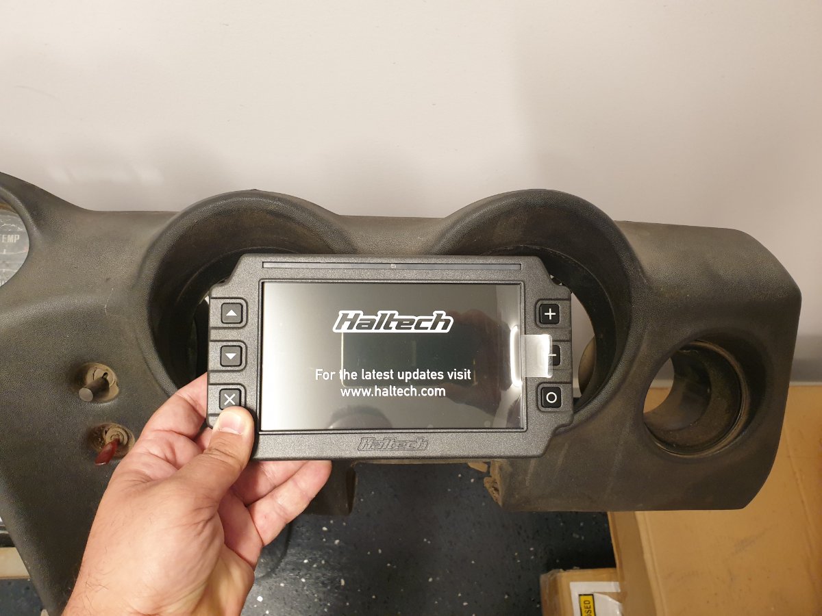

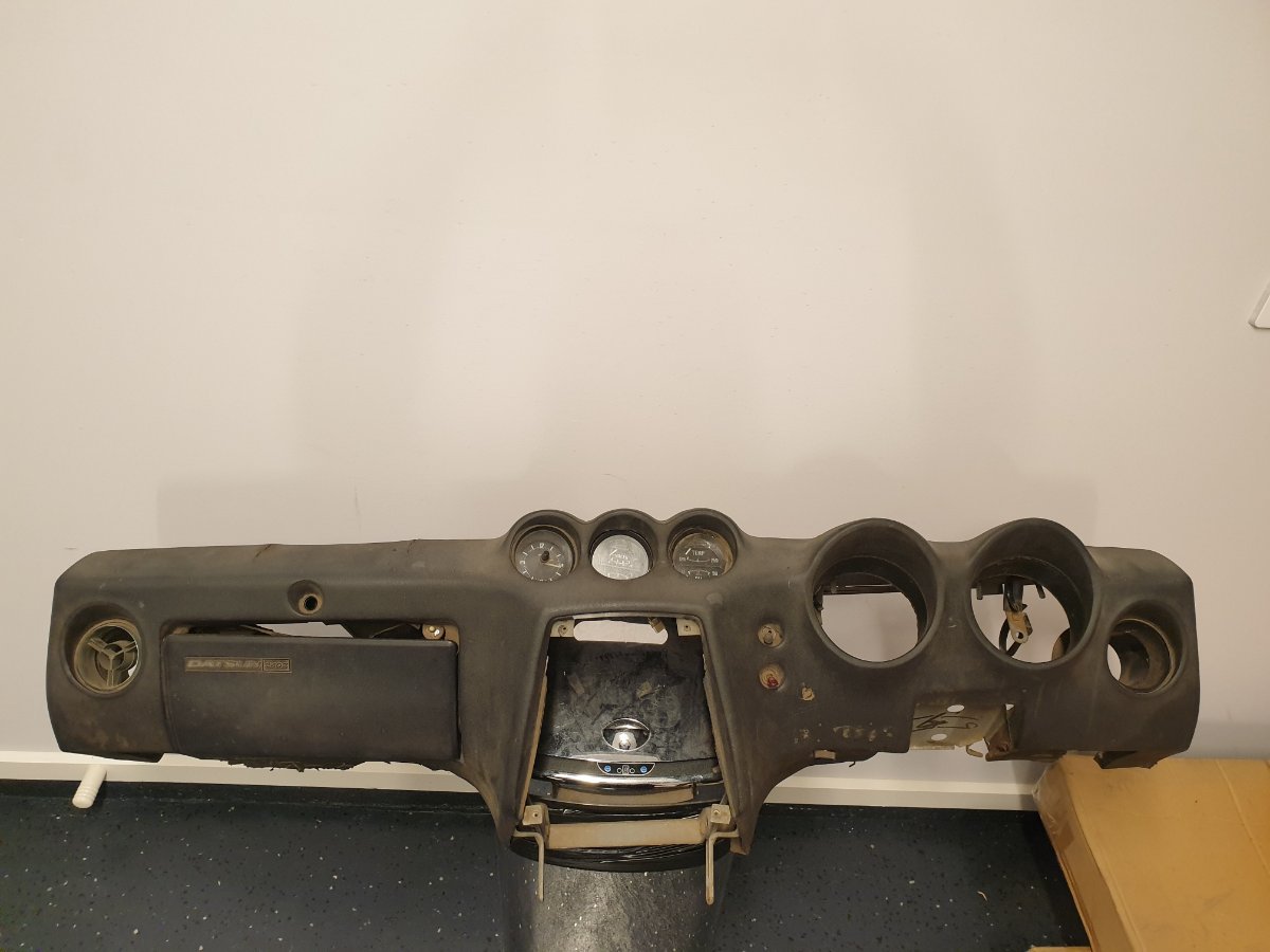

GregTas Posted October 23, 2020 Posted October 23, 2020 1 hour ago, JDM-TOY said: So, in one of my previous post I had put up a picture of my dash that I had the Dash Dr repair and had all the gauges calibrated and the clock serviced. After some discussions with a few people regarding the old technology from the 70's that we would have issues getting the correct readings in the old gauges. I decided to get a Haltech IC-7 Display so that it would match up with the Haltech Elite 2000 and everything new going into the car so that I don't get caught off guard when I'm out driving the car. Since I had had my dash repaired, I could not find it in me to cut it up to install the IC-7 so I sourced another dash from Carlos at Sports Classics to have the IC-7 moulded and recessed into the centre of the original 240z dash replacing the original gauges. After the IC-7 has been moulded in I will send this dash over to the Dash Dr to do a full repair on it so that it is vacuum sealed as one piece Has anyone attempted to try this before? I'm running a Haltech Elite 2500 in my car. RB25. I put original sensors on engine so the factory gauges work. Surprised to hear "regarding the old technology from the 70's that we would have issues getting the correct readings in the old gauges" There is no reason why this would be the case. Because I'm running the RB25 I had to remove the speedo drive to get the gearbox in the tunnel without chopping it. So the speedo signal comes from a pickup on the front wheel. Speedo signal into ECU. I then used the OBDII output signal on the ECU to drive a display. This is the unit in front of my steering wheel. It can display any engine signal you want. I have mine setup to display water temp in degrees, battery voltage and speedo. About $50 on ebay. I feel this is more subtle an in keeping with a 1970s car than a big display. Although looks like you've already bought your display. JDM-TOY 1 Quote
JDM-TOY Posted October 23, 2020 Author Posted October 23, 2020 51 minutes ago, C.A.F. said: That is something you will have to discuss with him. Unfortunately. What protections are there for consumers in this situation lol Quote
JDM-TOY Posted October 23, 2020 Author Posted October 23, 2020 @GregTas Yeah already committed but that OBDII is a good idea, Priced well too GregTas 1 Quote

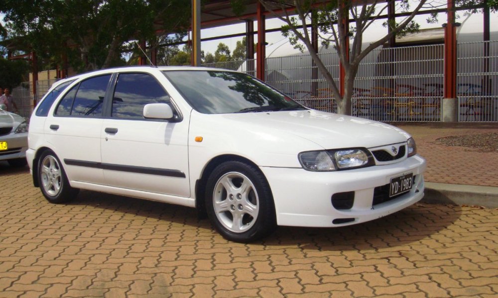

JDM-TOY Posted November 11, 2020 Author Posted November 11, 2020 (edited) Hey Guys Been a little sidetracked with a new toy that I recently purchased. The 240z is still getting painting sorted so been on the back of my mind. Hopefully will head out to check out the progress in the next week. So many wouldn't know that im a true Nissan Pulsar fan who had the privilege of owning a 2000 N15 SSS for 14 years new off the dealership floor till a P plater rear ended me into a FWD. Only had 64000ks on the clock and was a mint example. Anyways fast forward 2020 and I managed to find a 1990 N14 Nissan Pulsar GTiR chassis number 308 in Ivory White (Umbrella Edition). Currently running 290KW at the wheels so been trying to take it easy. I have been monitoring the current JDM car market and everything seems to be going up in value. Looking at the early Honda Integra Type R models currently selling for 40k, S15 Sylvias 40k+, R32 80k for a ok one and also the crazy R33 and R34 prices. 7 months ago I paid a broker to import a GTiR from Japan but after 7 months of searching and only one coming up every 2nd month in bad condition and selling for 30k+ I decided to look local and found this unadvertised mint example. Let me know what you guys think Edited November 11, 2020 by JDM-TOY CBR Jeff and gav240z 2 Quote
Administrators gav240z Posted November 11, 2020 Administrators Posted November 11, 2020 Nice score. Best condition 1 I've seen in a while. Seen a lot of average projects in rough shape .. Quote
JDM-TOY Posted November 11, 2020 Author Posted November 11, 2020 41 minutes ago, gav240z said: Nice score. Best condition 1 I've seen in a while. Seen a lot of average projects in rough shape .. Thanks Gavin Yeah I agree. I have seen some bad examples over the past few months. Rust, roll cage, missing interior or broken, not running, needs paint, no umbrella lol Quote

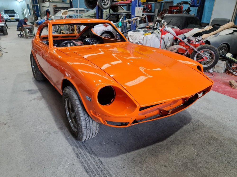

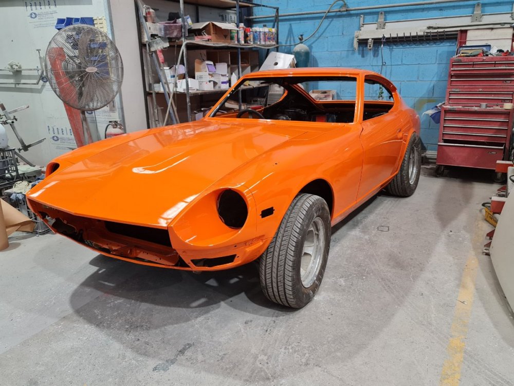

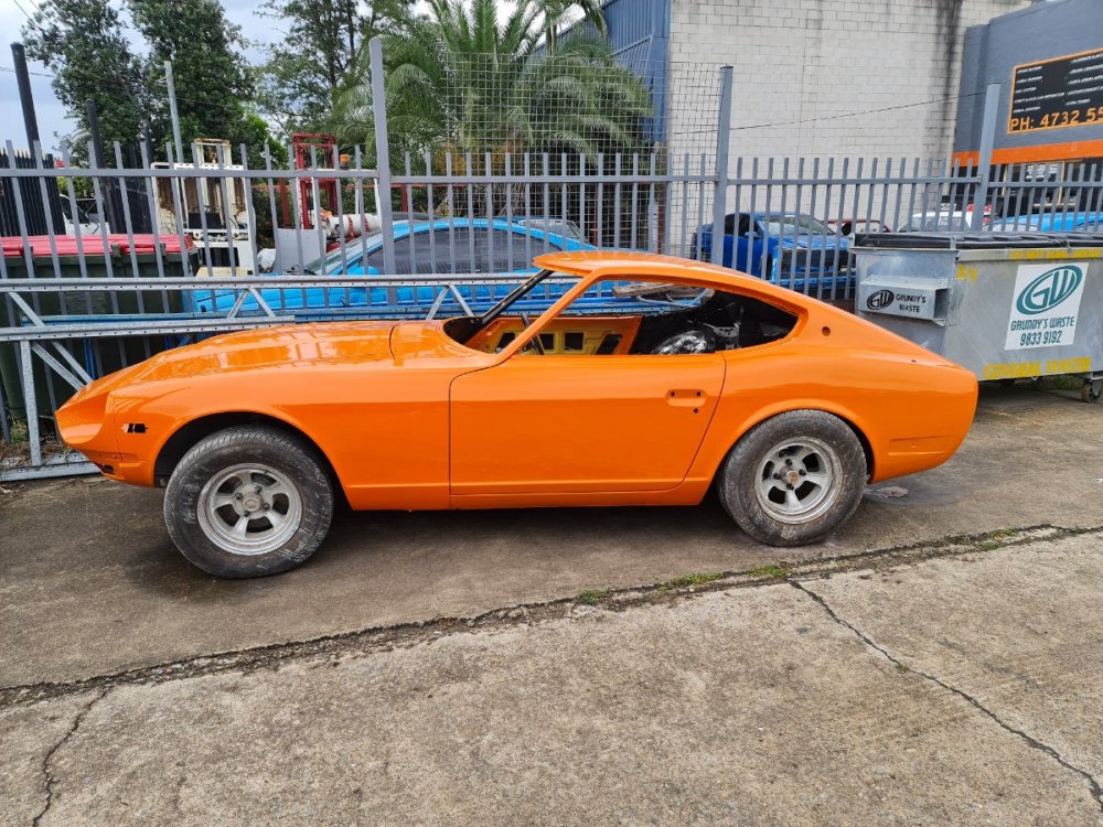

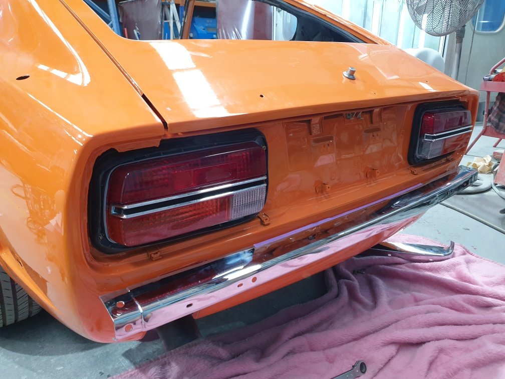

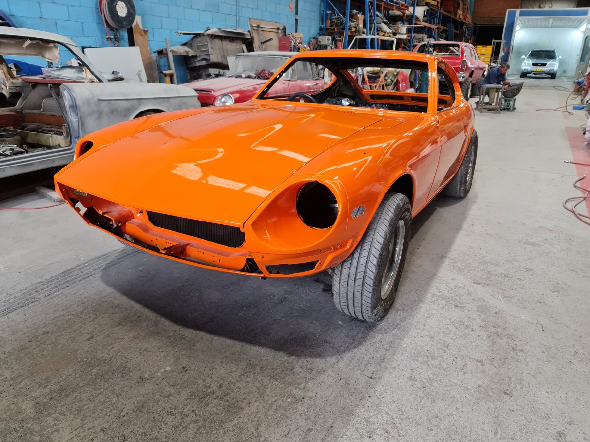

JDM-TOY Posted November 12, 2020 Author Posted November 12, 2020 (edited) So finally after some deep and meaningful discussions with the panel beater he finally painted my car again. The car was painted today with all panels on it so it will be one colour I HOPE. I haven't seen it yet but I will be going in tomorrow with my grumpy face to see the car. Hopefully the video I put up is clear. Nope video did not work. Will post up some pictures when I head out there tomorrow Edited November 12, 2020 by JDM-TOY gav240z 1 Quote

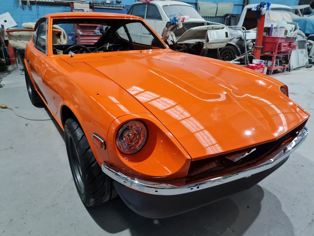

JDM-TOY Posted November 13, 2020 Author Posted November 13, 2020 Hey Lads I headed out to the panel beaters today and the car came up pretty well . I just wish he could have done it properly the first time. But anyhow Will start putting her back together again next week. Fingers crossed OdinZ 1 Quote

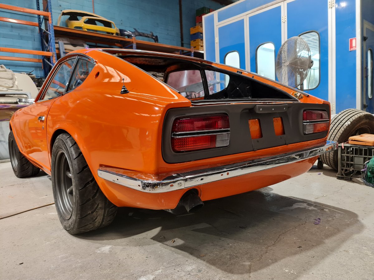

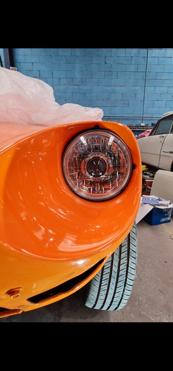

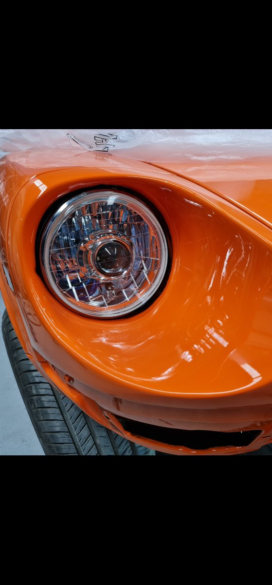

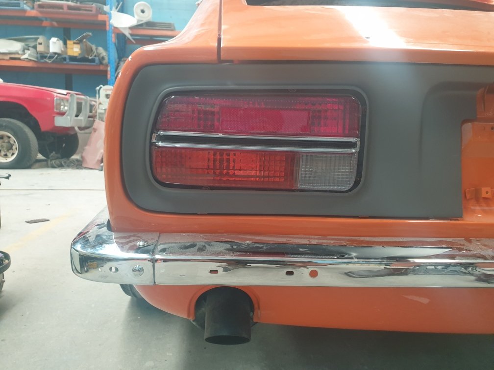

JDM-TOY Posted December 7, 2020 Author Posted December 7, 2020 (edited) Hey Guys Finally car is coming together. I previously had purchased Dappa Headlights and fitted them up. They look nice on the car but the passenger side gap look smaller than the drivers side (not wired up yet). Anyone have this issue?? What is acceptable "gap wise" for the Headlights?? The tail lights were a straight fit from JDM Car Parts. Look amazing and high quality. I found a company in Penrith Old Auto Rubber that sells full rubber kits for the 240z. I purchased new door rubbers, boot rubbers, window rubbers and everything fits well no issues. Hopefully car should be out of the panel shop before Christmas hahah or New Year Edited December 7, 2020 by JDM-TOY 240ZBUILTBYME and OdinZ 2 Quote

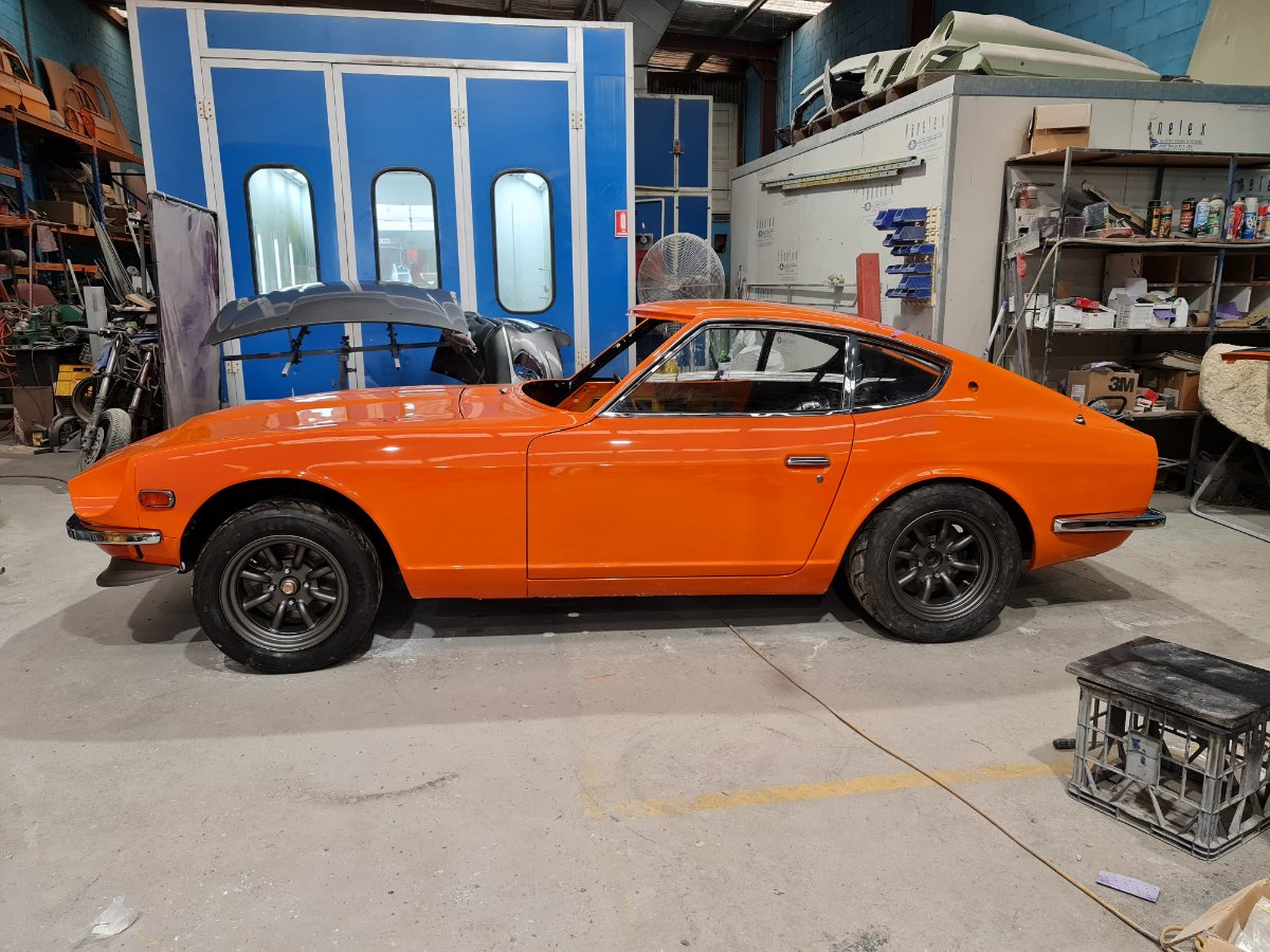

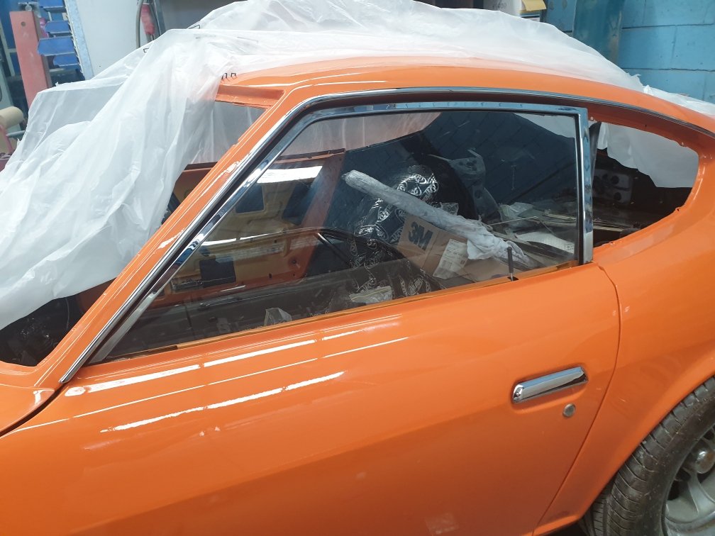

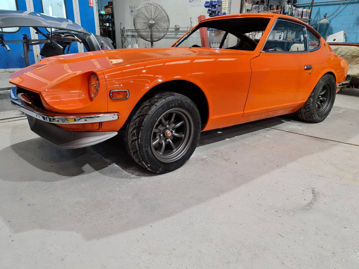

JDM-TOY Posted December 18, 2020 Author Posted December 18, 2020 Hopefully will have this bad boy in my garage in a few days. Fitted all the new rubbers around the car. Still need to source some missing rubbers from overseas. Fitted the Watanabe wheels and adjusted the front coilovers to lower the front but will need to take out and chop the sleeve so the car will sit lower. The rear has plenty of room to lower. Anyone had this issue before? Ponyo240z, gav240z, jeff43 and 1 other 3 1 Quote
