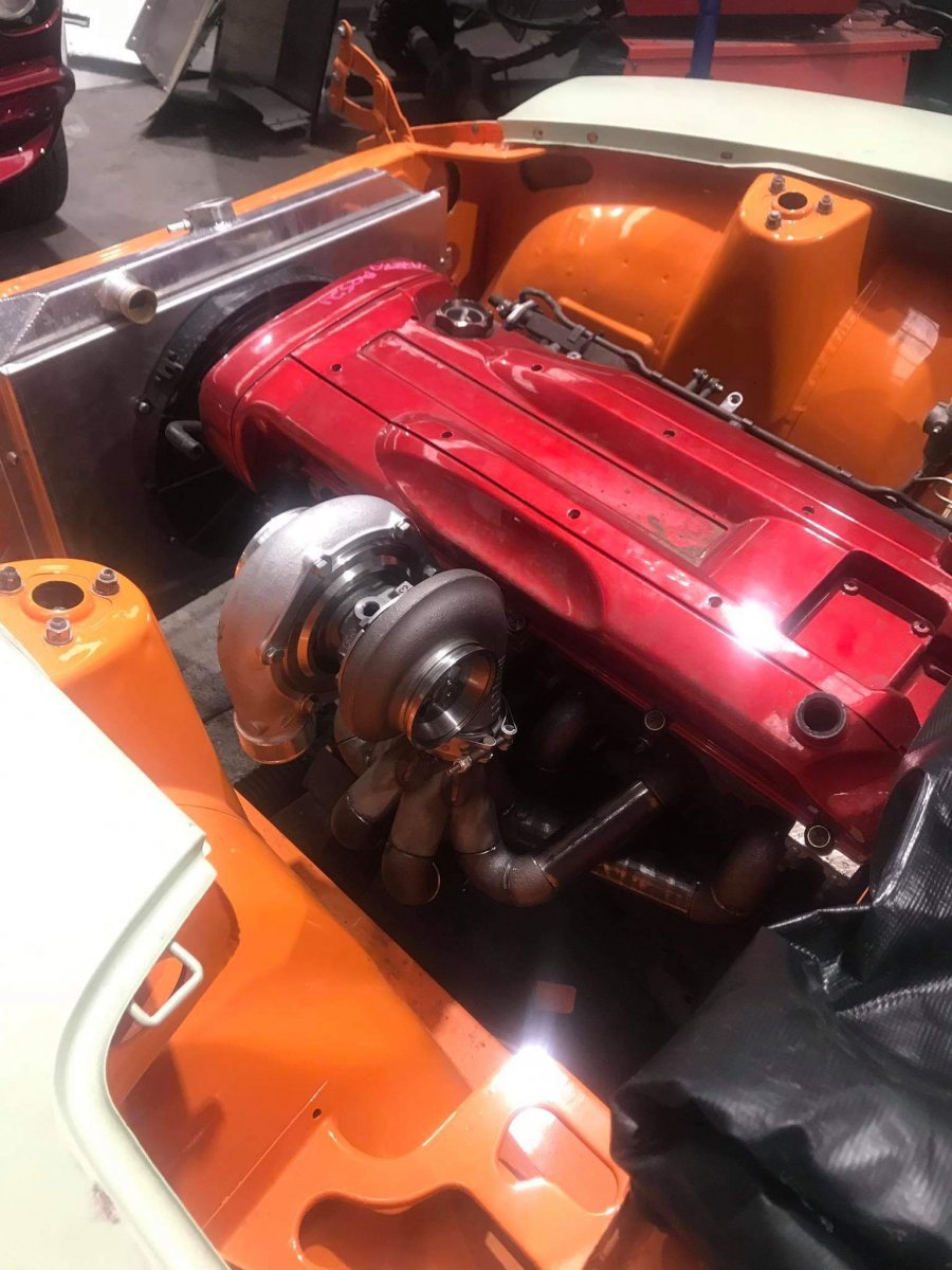

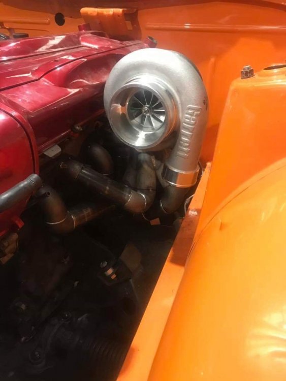

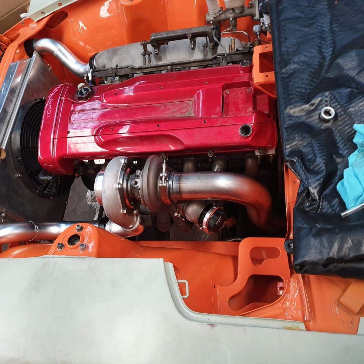

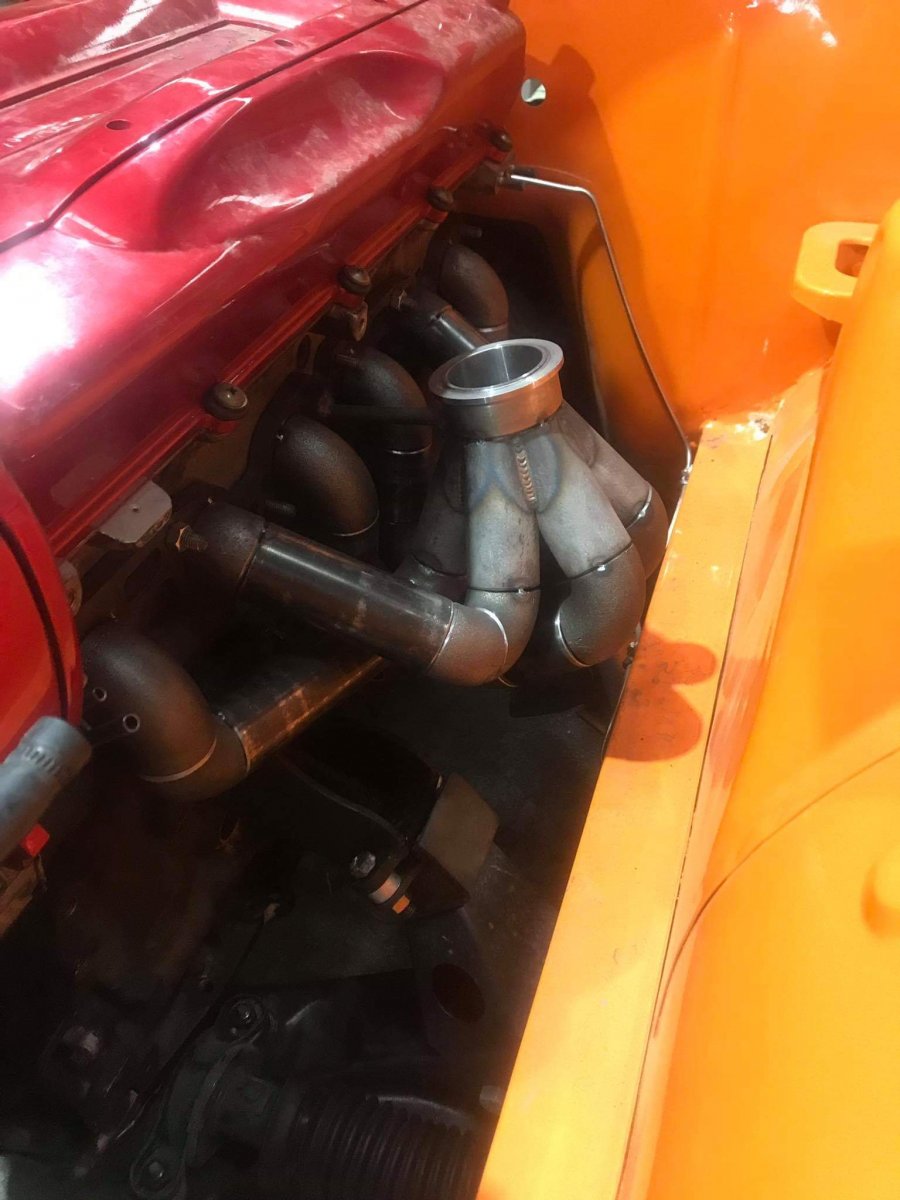

JDM-TOY Posted July 6, 2019 Author Posted July 6, 2019 Box of tissues needed Progress on the fabricating turbo manifold and dump pipe. I decided to Go with a Garrett Gen2 GTX34/82R due to its mid to top range power, no lagging needed. With a built engine could get 500kw of power which im my mind is too much for this car, not that it doesn't deserve it . gav240z 1 Quote
Administrators gav240z Posted July 6, 2019 Administrators Posted July 6, 2019 Who is making the manifold for you? Looks like a work of art. What did you do with the old twins? Were they R33 or R34 twins? Quote
JDM-TOY Posted July 6, 2019 Author Posted July 6, 2019 7 hours ago, gav240z said: Who is making the manifold for you? Looks like a work of art. What did you do with the old twins? Were they R33 or R34 twins? Hey Gavin Its Mick at Race Solutions he is the fabricator at the shop. When I purchased the engine I didn't buy the twins, they were R33 twins. gav240z 1 Quote

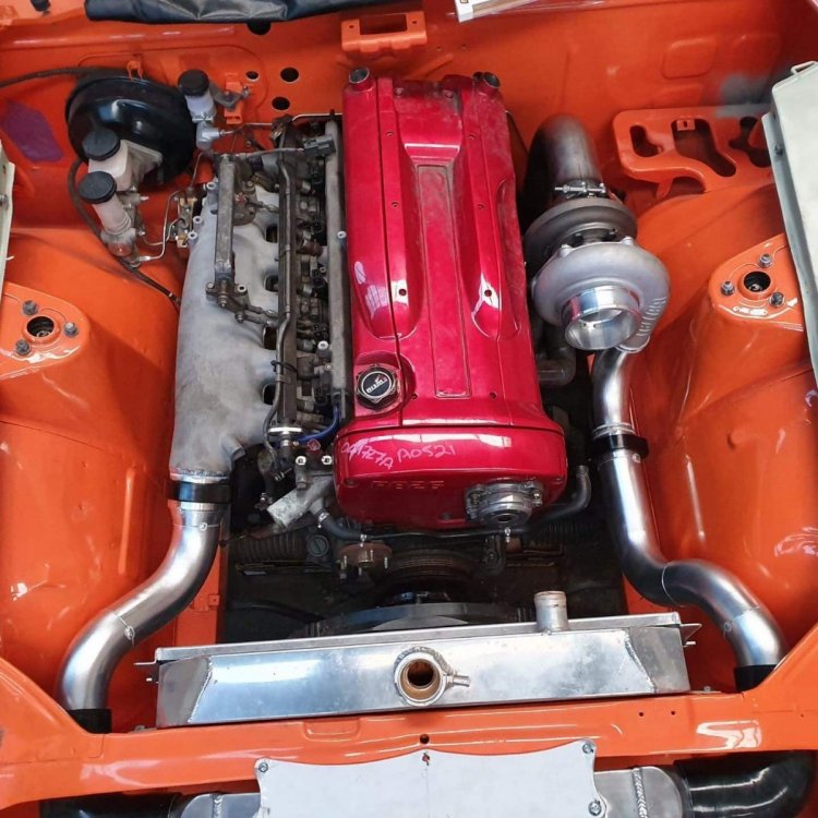

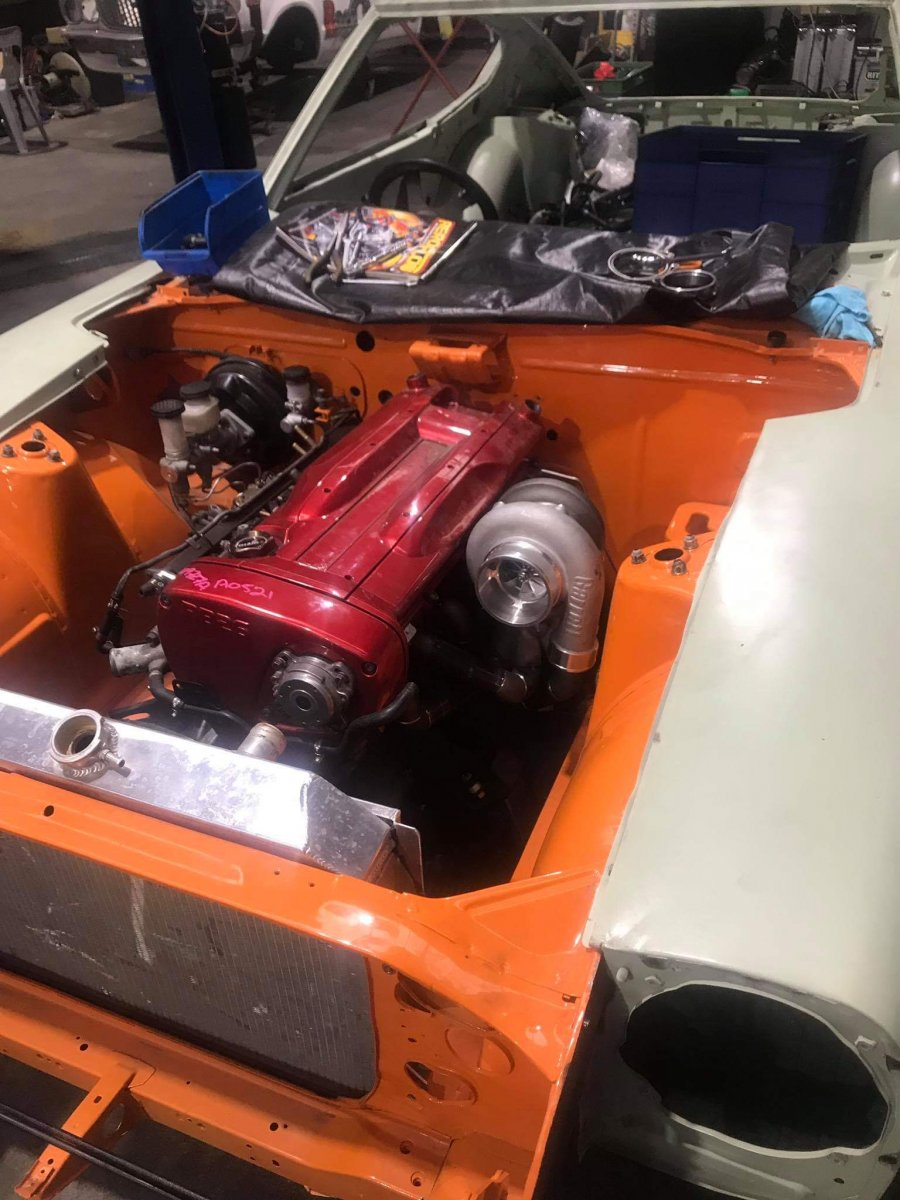

JDM-TOY Posted July 15, 2019 Author Posted July 15, 2019 (edited) More progress on the S30Z Front mount, intake piping, manifold, dump, Westgate all welded up and ready to get pulled out and get powder coated black and ceramic coating, including throttle body powder coated black. Also will get the radiator powder coated in black. Blow off valve to be fabed up when everything gets taken out so it can be hidden somewhere underneath the piping. So moving forward tomorrow the engine will get taken out and the shell sent to get some small body work done on the front guards and then prepp for paint. Also need to get a clutch stop fabricated up so my leg doesn't go through the firewall lol. I have asked the guys at Race Solutions to replace the oil pump, rear main seal replaced, timing belt replaced, rear head oil drain installed and some other bits and pieces to ensusure the longevity of the RB26. So we test fitted the R33 GTST front and rear breaks to SW brackets and all was well. We also fitted the 15x8 Watanabe wheels and we had good clearance on the front caliper and wheel but had issues with the rear caliper touching the inside of the wheel spoke. It was the Nissan lettering that was touching the spokes. Might need to machine the lettering or figure something out. But definitely will not machine the wheels. Happy Restos Guys Youhan Edited July 15, 2019 by JDM-TOY Quote

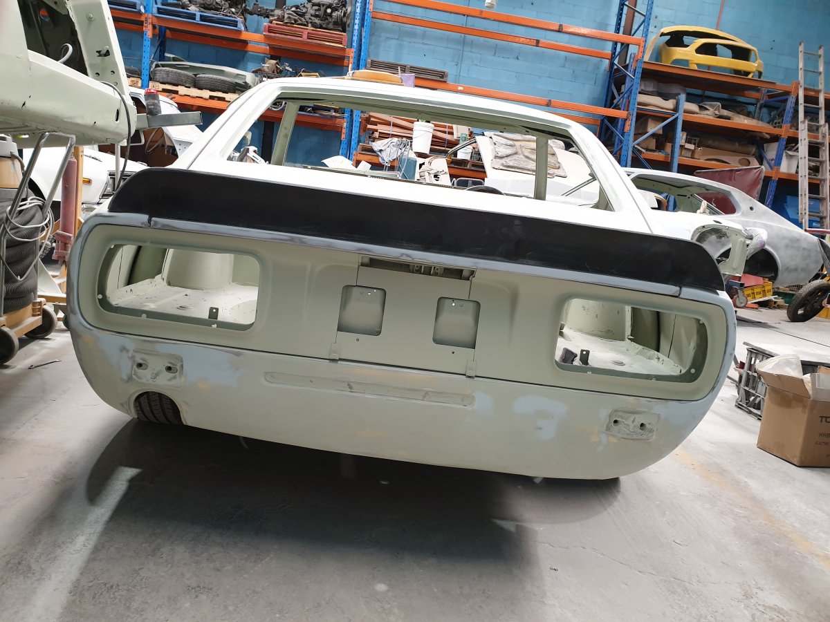

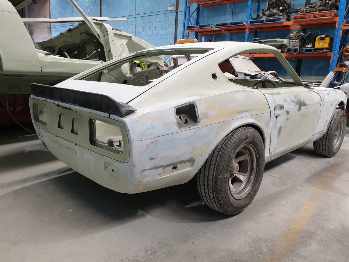

JDM-TOY Posted August 12, 2019 Author Posted August 12, 2019 (edited) Some more progress pictures of the S30z. Finally mounted up the Motorsport rear spoiler and really happy with the fit. The only issue we had was the rear hatch lock cutout was off centered and couldn't align it with the lock. Might need to make some modifications. All panels have been aligned just need to mount up the front valance and lip. The car will be ready for highfill, finally. Edited August 12, 2019 by JDM-TOY Quote

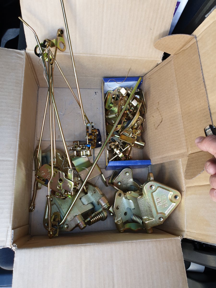

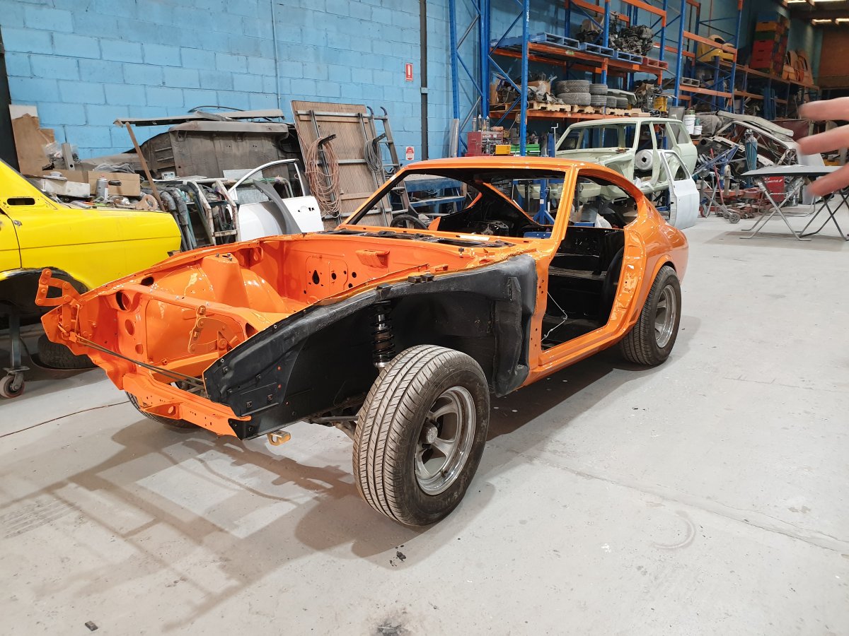

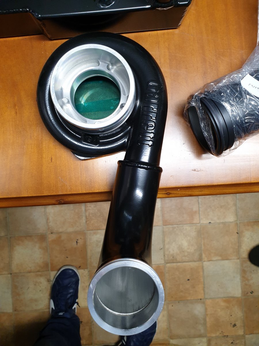

JDM-TOY Posted November 13, 2019 Author Posted November 13, 2019 Hey Guys Been a while now waiting for my car to get painted. Its been blocked down amd hopefully will have the inside of the cabin painted in black this week and then the shell after that. Have been organising small things like getting all the cooler pipes, radiator, intercooler, manifold, turbo housing, rear housing and dump pipe all coated in black. Will definitely look sexy when put together. Heading there on Friday and will take some pictures to post up. Also took all the door, hatch hinges and latch mechanisms and door lock mechanisms, bonet locks and stay and got them enamel coated gold. Just small details that I think will make a difference. I keep telling myself soon, soon, soon, ahhhhhh taking so long, soon soon. SERENITY NOW! Quote
CroS13 Posted November 13, 2019 Posted November 13, 2019 Where did you take all your stuff to get plated? and how long did it take? Not really going to go back to the place i took my stuff to. I only had a small painting cup worth of parts, and it took them 6 - 8 weeks to do. Rudi. Quote
Cozza Posted November 13, 2019 Posted November 13, 2019 Wow that gold enamel coating looks much better than the zinc passivating I’ve had done. I like it!! Where’d you get it done and how was the pricing? Quote
JDM-TOY Posted November 14, 2019 Author Posted November 14, 2019 Hey @Cozza @CroS13 Thanks guys I had them done at Elite Plating at Smithfield, NSW. Took less than 2 weeks and Chris charged me $120 for the lot. https://www.google.com/search?q=elite+plating&oq=elite+pla&aqs=chrome.1.69i57j0l3.5082j0j9&client=ms-android-samsung-ss&sourceid=chrome-mobile&ie=UTF-8 Quote

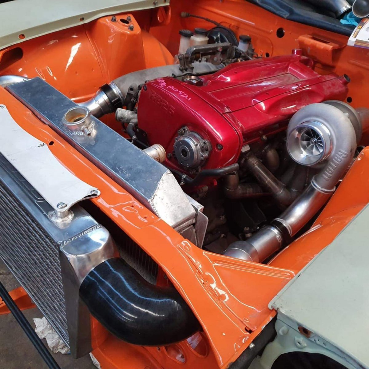

JDM-TOY Posted November 22, 2019 Author Posted November 22, 2019 (edited) Hey Chaps Picked up all the powder coated pipes, radiator, intercooler and turbo housing a few days ago and man everything looks mint. Just a small glimpse for you guys. Ill put more pictures up when everything is assembled in the engine bay. Edited November 22, 2019 by JDM-TOY Quote

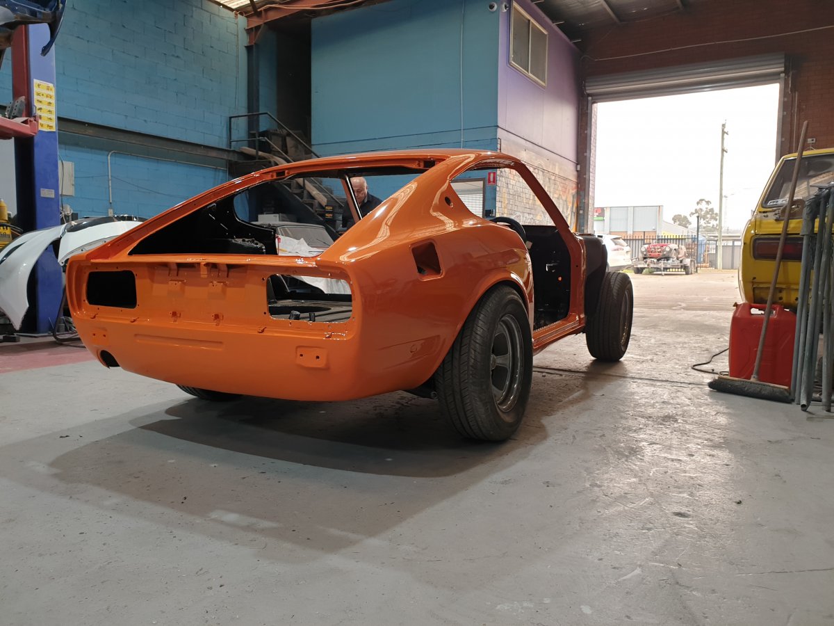

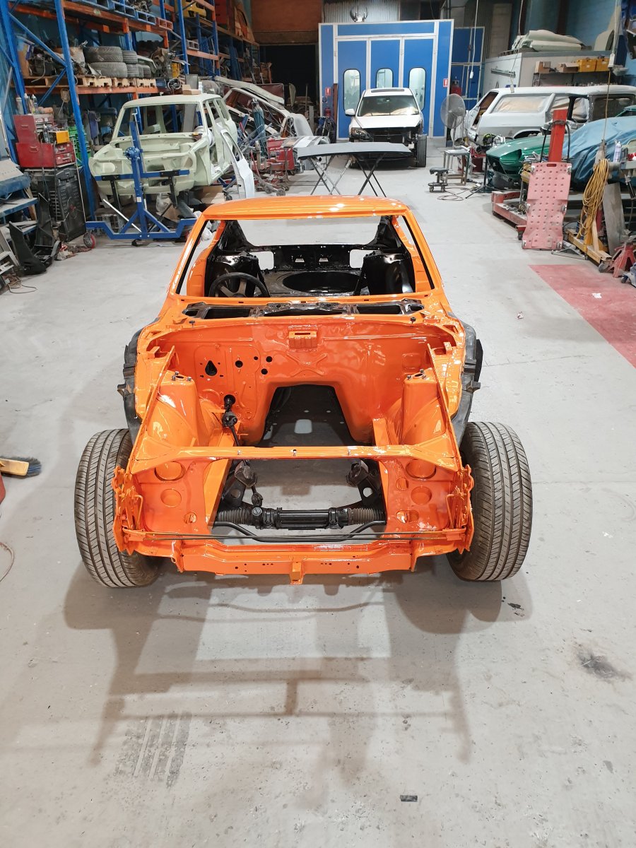

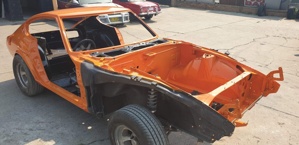

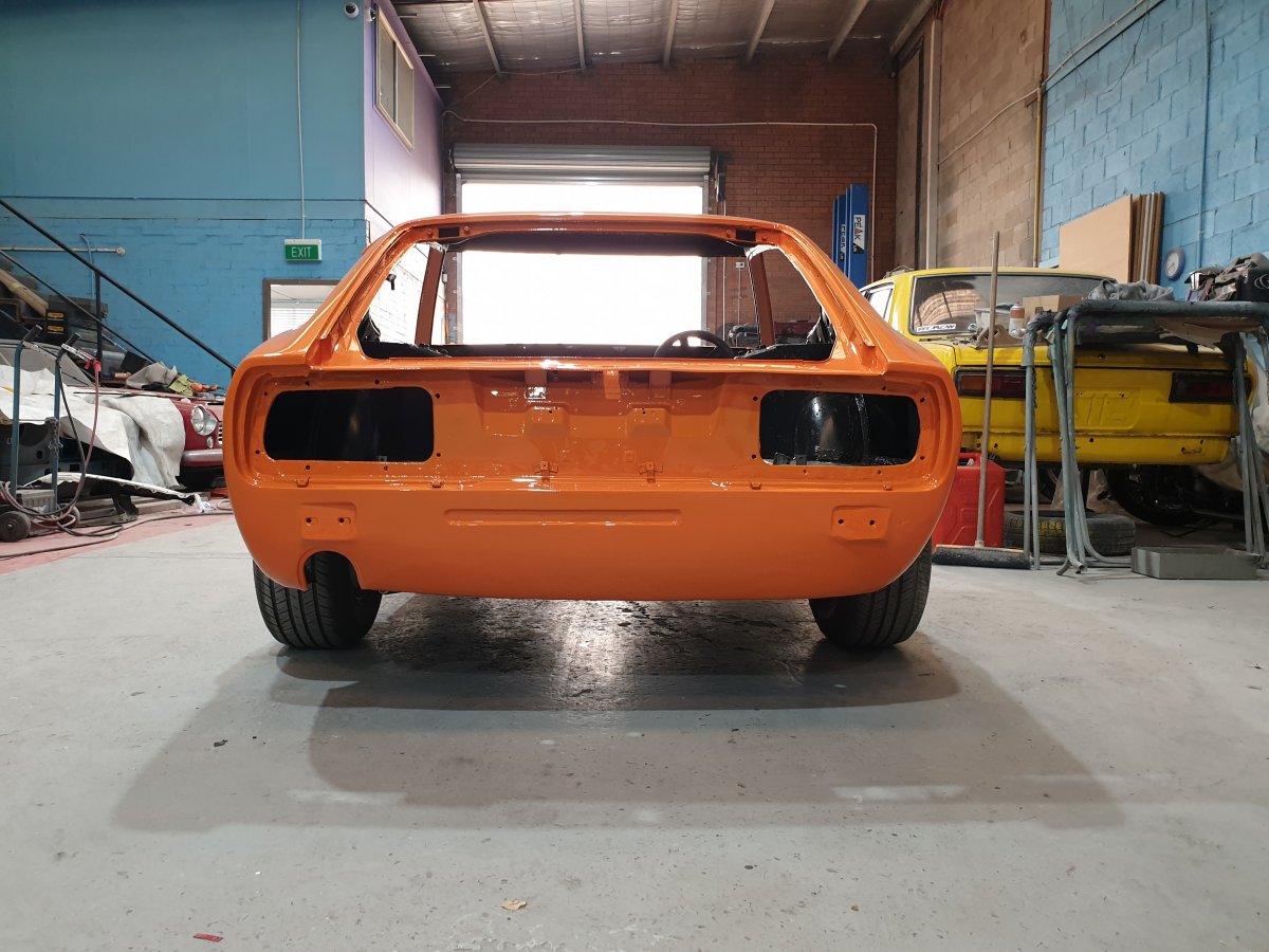

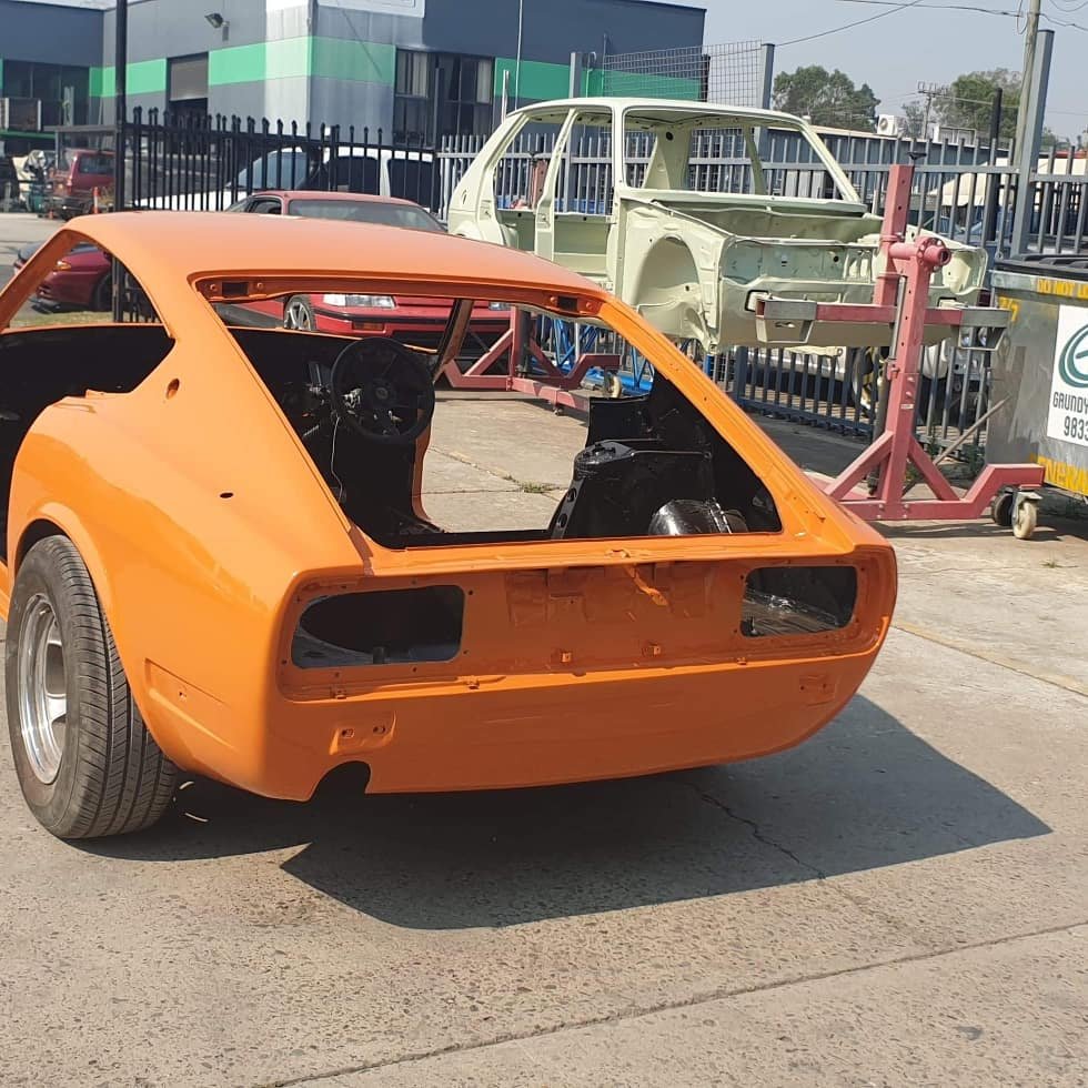

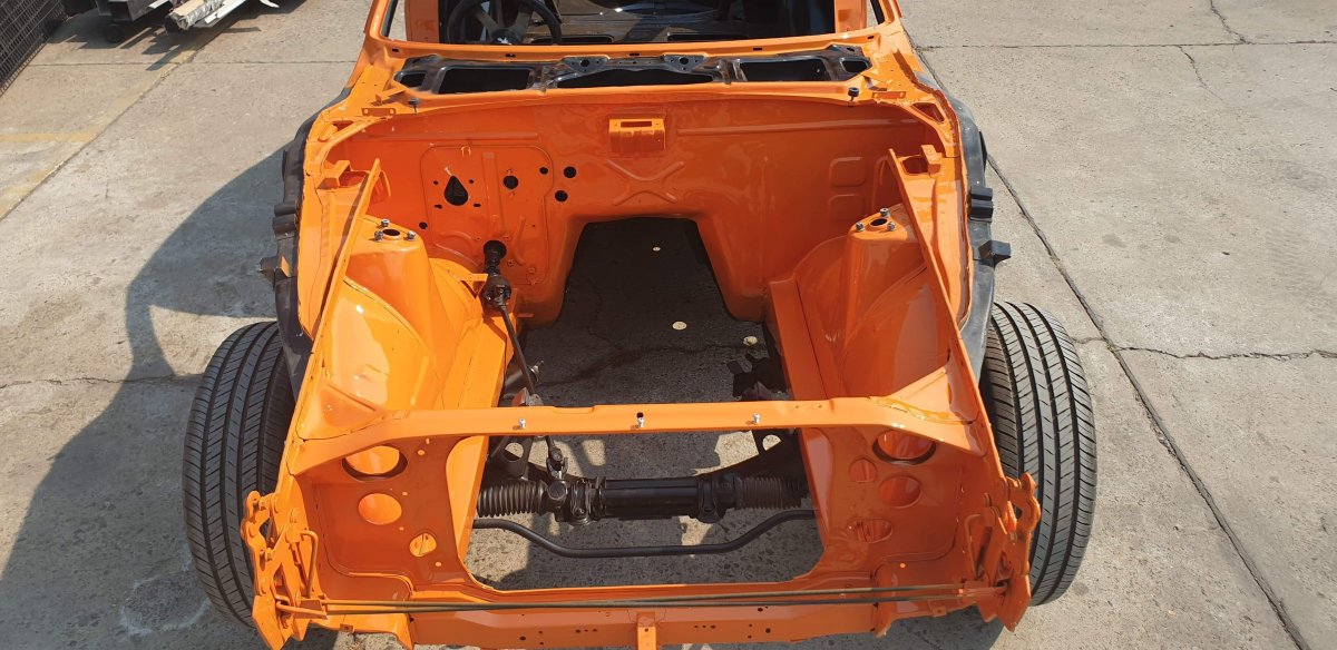

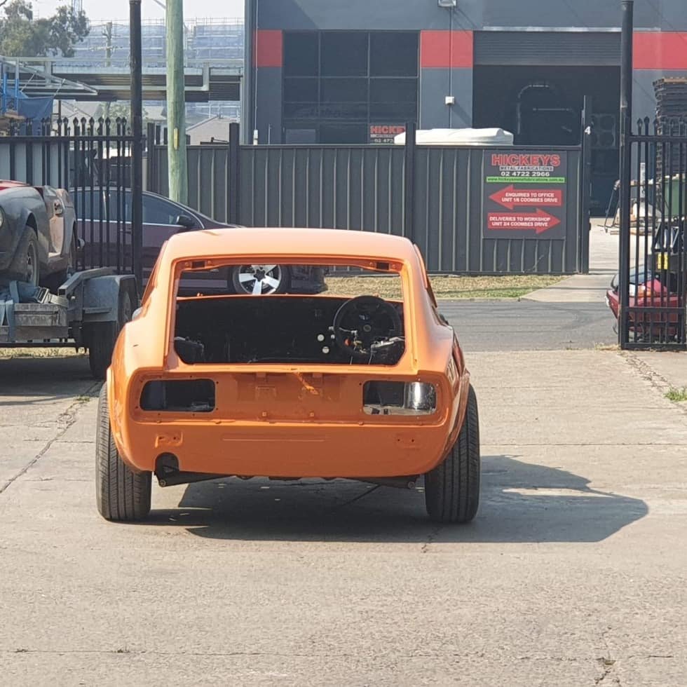

JDM-TOY Posted December 19, 2019 Author Posted December 19, 2019 (edited) With great joy I would like to post these pictures up. Haven't seen the car in person, heading out there later this afternoon. Cant wait to change those ugly wheels Enjoy Edited December 19, 2019 by JDM-TOY ScottyD, OdinZ and George 3 Quote
Administrators gav240z Posted December 19, 2019 Administrators Posted December 19, 2019 I like the ugly wheels OdinZ 1 Quote
JDM-TOY Posted December 19, 2019 Author Posted December 19, 2019 (edited) 6 minutes ago, gav240z said: I like the ugly wheels You can pick them up after I slip on the Watanabes lol Edited December 19, 2019 by JDM-TOY OdinZ 1 Quote
OdinZ Posted December 19, 2019 Posted December 19, 2019 Looking good! 27 minutes ago, JDM-TOY said: You can pick them up after I slip on the Watanabes lol and bring them to Melbourne! haha JDM-TOY 1 Quote
JDM-TOY Posted December 19, 2019 Author Posted December 19, 2019 Seriously if anyone wants them you can take them. I dont have the space at the new place Quote
KatoKid Posted December 19, 2019 Posted December 19, 2019 Looks great. Has the dune buggy look with the offset of the ugly wheels! gav240z, JDM-TOY and OdinZ 3 Quote
JDM-TOY Posted December 19, 2019 Author Posted December 19, 2019 It does look like a dune buggy loll. Thanks Dave, will look better once put back together under a clear sky Quote
Administrators gav240z Posted December 19, 2019 Administrators Posted December 19, 2019 1 hour ago, OdinZ said: Looking good! and bring them to Melbourne! haha Probably fit the 2+2 better anyway. Especially in the back. On a serious note I may be able to bring them down with all the other crap I have to move interstate. So if you really do want them, we can probably work something out. JDM-TOY 1 Quote
JDM-TOY Posted December 19, 2019 Author Posted December 19, 2019 3 hours ago, gav240z said: Probably fit the 2+2 better anyway. Especially in the back. On a serious note I may be able to bring them down with all the other crap I have to move interstate. So if you really do want them, we can probably work something out. Sounds good Gavin, when you planning on moving? Quote

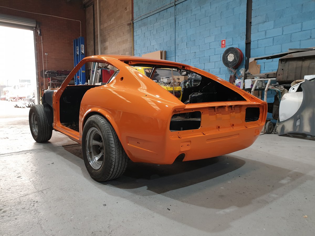

JDM-TOY Posted December 19, 2019 Author Posted December 19, 2019 (edited) Some more better pictures Paint looks really nice except for a small section of paint run on the rear passenger quarter next to the bumper moulding and a few dust particles on the edge of the roof on the passenger side. Edited December 19, 2019 by JDM-TOY Quote
