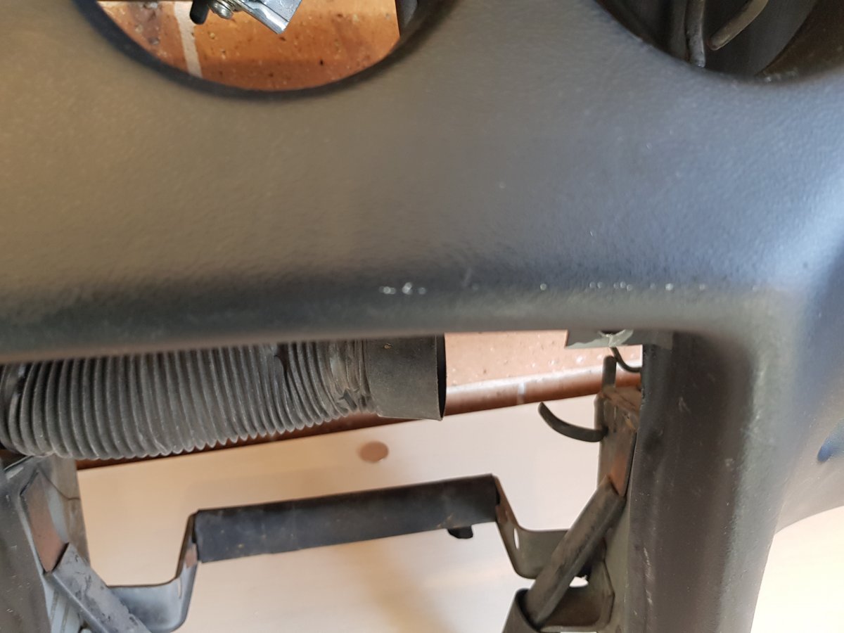

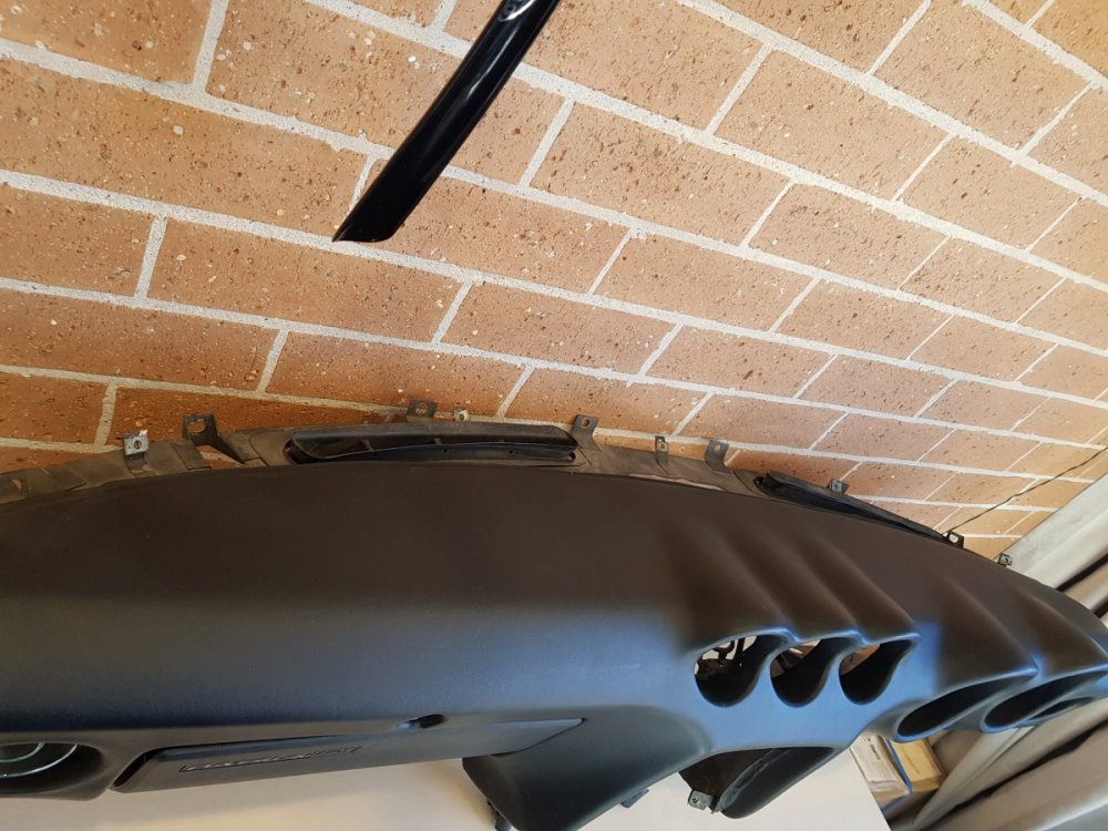

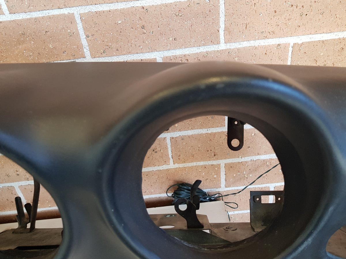

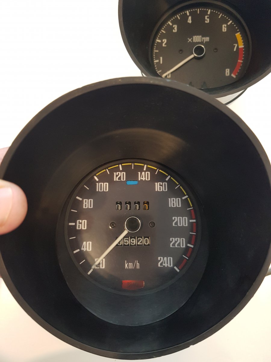

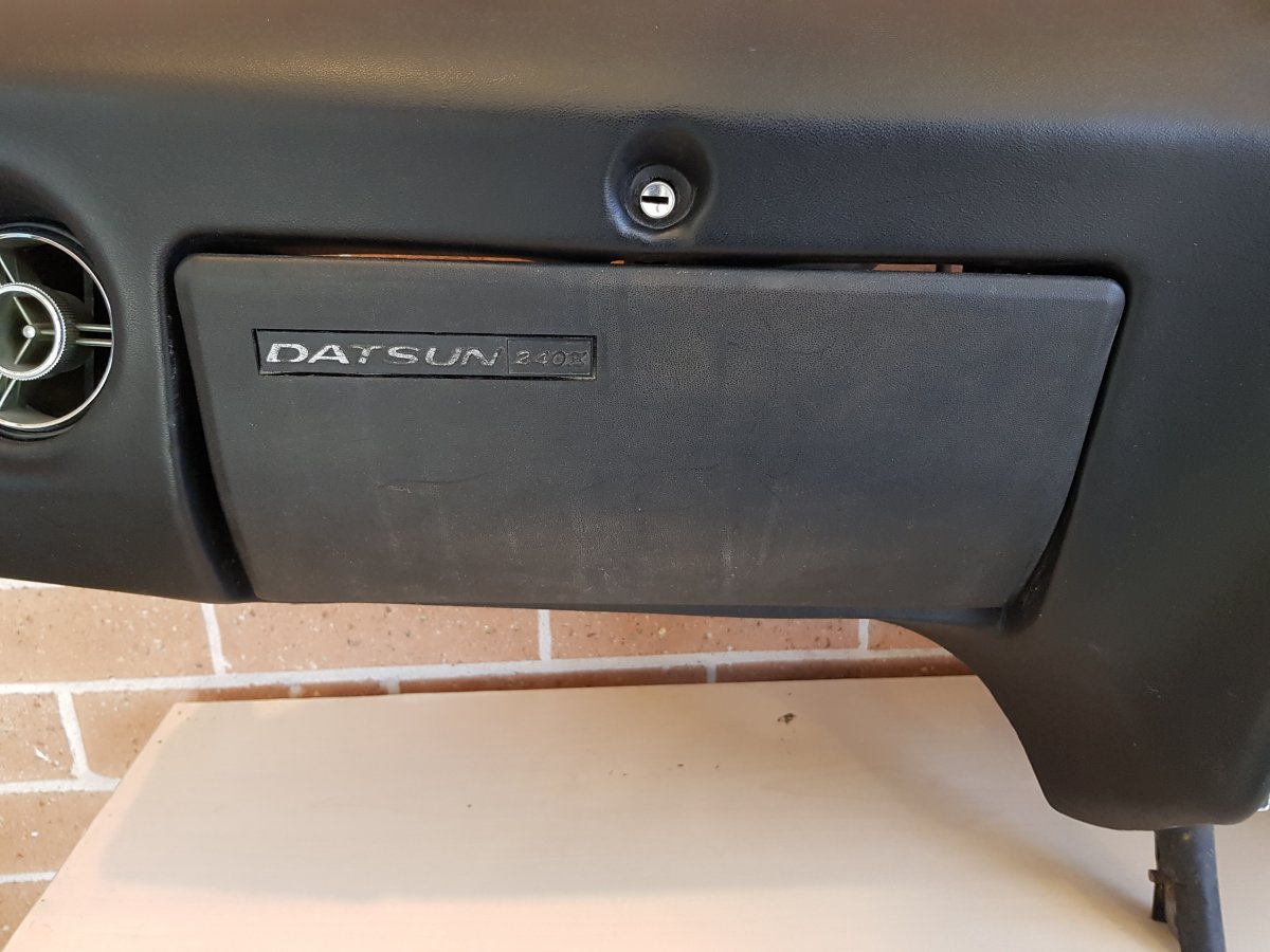

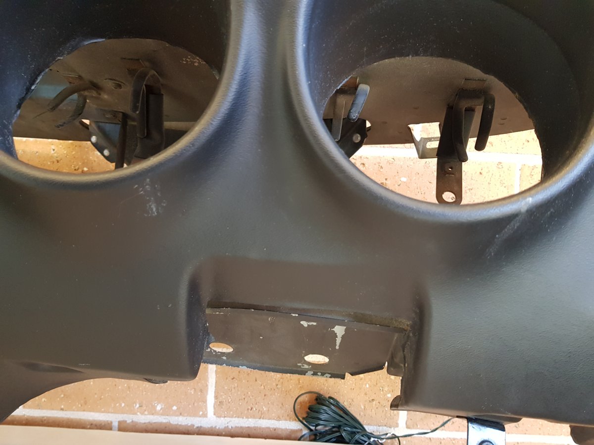

JDM-TOY Posted September 17, 2018 Author Posted September 17, 2018 (edited) Hey Guys Been a while since my last update. Finally got all my guages from AttSpeed Instrumens full calibration, had the clock fixed, had the rev tacho circuit changed to adapt to electronic distributors and the speedo face changed to Km/h. Also picked up all the under dash wiring and rear wiring picked up from Pro Wire. All cleaned up and taped up, not brand new but cleaner than previously. Not sure what I will do with the dash, its not cracked but some small blemishes. Keep it and reskin later or get it done now. I got a quote from a guy in Melbourne for $650, I think it was the Dash Dr. Edited September 17, 2018 by JDM-TOY OdinZ 1 Quote
Retro Z Posted September 17, 2018 Posted September 17, 2018 I'd sell your Dash for around $500 or swap it and then reskin a cracked one as you get charged $650 regardless by the dash dr for a good or bad one. JDM-TOY and OdinZ 2 Quote
mossy Posted September 17, 2018 Posted September 17, 2018 If you sell the dash try ebay, I sold one on ebay about 8 years ago and got over 1k for it. JDM-TOY 1 Quote

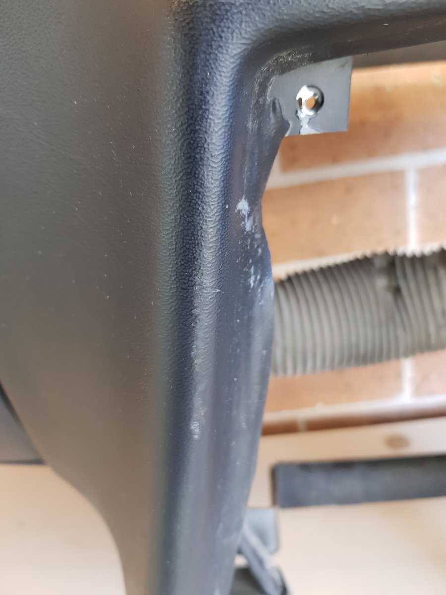

Administrators gav240z Posted September 18, 2018 Administrators Posted September 18, 2018 Got photos of the blemishes? You might be able to cover them up with a bit of black vinyl spray? JDM-TOY 1 Quote

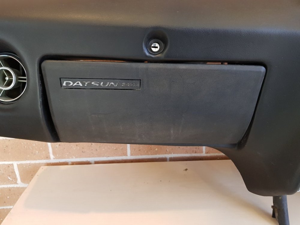

JDM-TOY Posted September 19, 2018 Author Posted September 19, 2018 (edited) Thanks @Retro Z @mossy @gav240z In general the dash is in pretty good condition other than the glovebox lid faded and the blemishes. I spoke to Karl who does interiors in Kings park in Sydney and he also mentioed that he can spray the dash with a vinyl spray. Im not sure if that will hold up and become sticky over time. I have a new glovbox badge so that going anyways. Cheers Youhan Edited September 19, 2018 by JDM-TOY Quote
Retro Z Posted September 20, 2018 Posted September 20, 2018 The vinyl paint works well and does not go sticky overtime. I used a stain black vinyl dye to touch up my dash and console and it blends in well with stock finish of the dash. JDM-TOY and gav240z 2 Quote
Administrators gav240z Posted September 20, 2018 Administrators Posted September 20, 2018 2 minutes ago, Retro Z said: The vinyl paint works well and does not go sticky overtime. I used a stain black vinyl dye to touch up my dash and console and it blends in well with stock finish of the dash. What he said, vinyl paint is 1 of the easiest to apply going around and it will cover a lot of those blemishes easily. Along with the glove box door. That dashboard looks to be in beautiful shape, has it already been re-skinned? Just make sure you use plenty of oil and wax removal on a cloth all over the dashboard (hopefully nobody went liberal with armour oil or similar on it) and then tape up the areas you don't want to get over-spray on and go for it. For the lid you can use a heat gun to revive the plastics (remove that faded look) but be really really careful not to over heat it. In fact I would probably practice on a spare if you have 1. Here is some photos (not the best) of when I restored my FD RX-7's rear storage bin divider panel. https://photos.app.goo.gl/f7PT6ZWH4BK86GDP9 There was quite a few scuff marks on it and some light fading, I used the heat gun to help improve it, but the final photo is after black vinyl paint. I'm not sure why it has that fish eye mark on the plastic (it wasn't the heat gun) but once installed in the car you can hardly see any marks on it. Photos (with flash) tend to highlight the flaws more so than the naked eye can see it. I would have shown you when you came around the other day if I knew about the dashboard before that. You can remove the "DATSUN 240Z" emblem from the lid (it's glued in) and can get the plastic chrome re-done on the inlay if you really want to give it pop like new! If you decide you still want to go down the re-skin path let me know? I may be interested in that dash for my 71 240z - since I want the patina look! Quote

Moderators PB260Z Posted September 20, 2018 Moderators Posted September 20, 2018 On 9/17/2018 at 3:04 PM, JDM-TOY said: Hey Guys Been a while since my last update. Finally got all my guages from AttSpeed Instrumens full calibration, had the clock fixed, had the rev tacho circuit changed to adapt to electronic distributors and the speedo face changed to Km/h. Hi Ben at AttSpeed did the tacho on my bus, great guy - not the cheapest but first rate work. JDM-TOY 1 Quote
JDM-TOY Posted September 20, 2018 Author Posted September 20, 2018 @PB260Z I agree, great guy. Very easy going and honest. He did my RA23 Celica guages a while back before I changed them to VDO cockpit guages. As you said not cheap. Quote

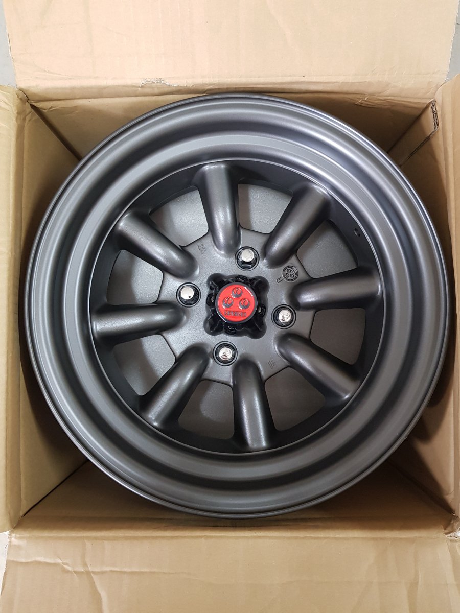

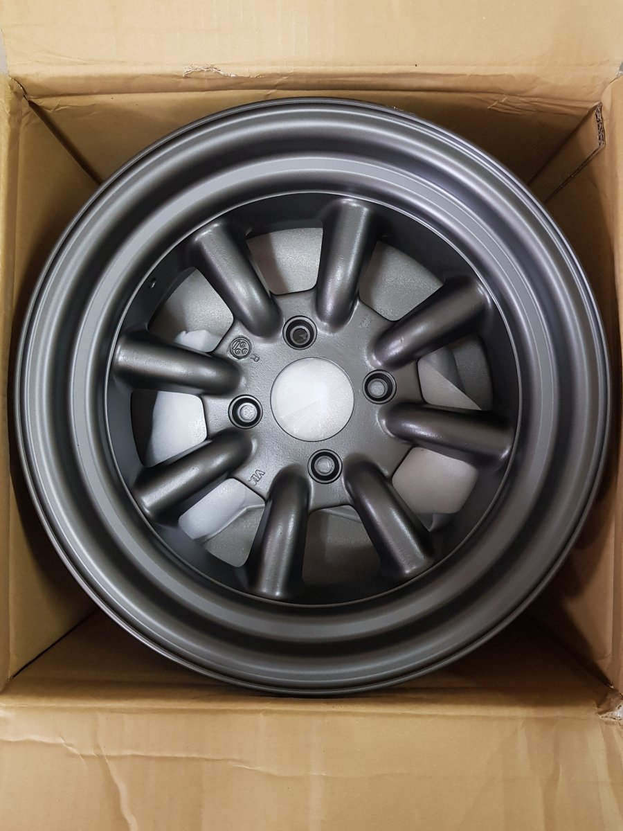

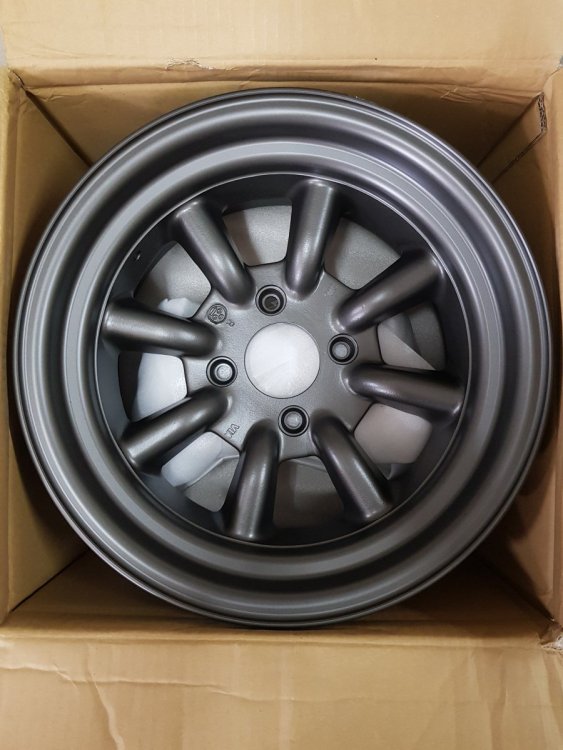

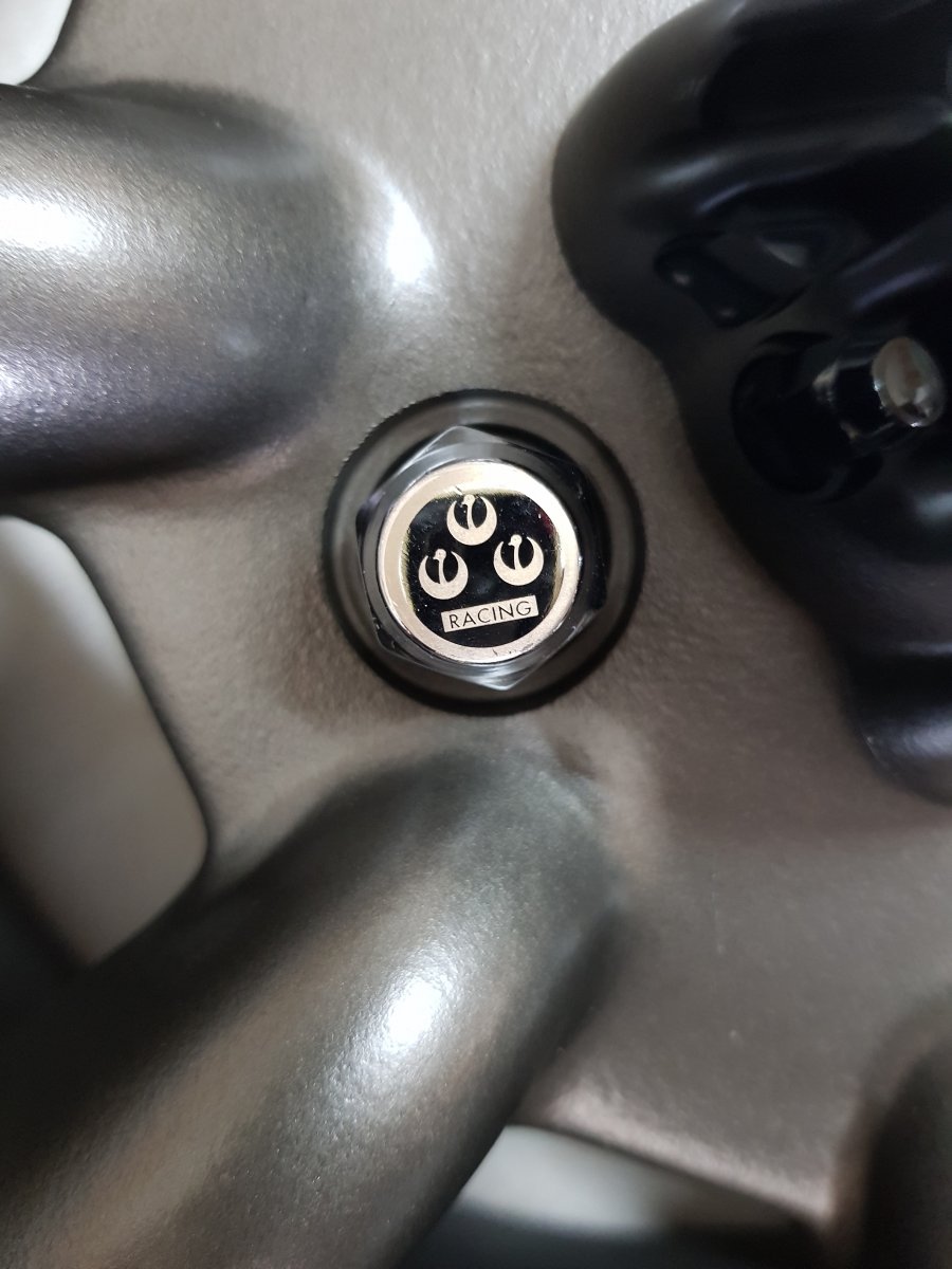

JDM-TOY Posted October 11, 2018 Author Posted October 11, 2018 Hey guys been a while since my last post. The car is still at the panel beaters and to be a little honest im getting annoyed with how long its taking to get my car done. I know these things take time but the shop has been quiet and they arnt taking insurance work so that the restos get done. But my car is still sitting there with the majority of rust work done and other cars are getting priority. I gave them a dead line but at this pace it looks to be next year. Anyways on the upside I finally recieved my Watanabe R 15 x 8 +0 wheels from Japan after 7 months wait, but definitely worth the wate. I cant get over the detail on the nuts with the falcon symbol on it. Its all Porn to be honest, happy I waited this long. So I will take the Toyo R888R off the steel wheels and transfer them to the Watanabes. And definitely wont be using the centre caps or nuts, their too nice to get damaged or stolen. gav240z, Ponyo240z, Zedhead and 1 other 3 1 Quote
Administrators gav240z Posted October 11, 2018 Administrators Posted October 11, 2018 Nice wheels, wish I could afford a set! Very very few panel shops are good at keeping on track time wise. Quote

theremm Posted October 11, 2018 Posted October 11, 2018 13 hours ago, JDM-TOY said: And definitely wont be using the centre caps or nuts, their too nice to get damaged or stolen. I'd recommend using the nuts. They have a swivel type base which prevents burring of the wheel when you tighten them up. Did you get a set of lock nuts too? Besides, you bought them and they look good, so may as well use them. If they get stolen they can always be replaced JDM-TOY 1 Quote
JDM-TOY Posted October 12, 2018 Author Posted October 12, 2018 1 hour ago, theremm said: I'd recommend using the nuts. They have a swivel type base which prevents burring of the wheel when you tighten them up. Did you get a set of lock nuts too? Besides, you bought them and they look good, so may as well use them. If they get stolen they can always be replaced Hey champ, good point on using the nuts. Na I didn't get any locknut but I can order some. theremm 1 Quote
