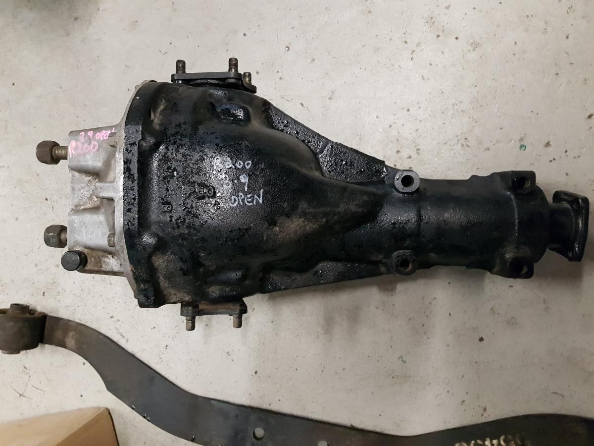

JDM-TOY Posted June 5, 2018 Author Posted June 5, 2018 Hey guys Still building, Picked up a R200 diff 3.9 ratio and a mustache bar today from Sports Car Classics. Once the car is done I will definitely take it to Jason from Gear Exchange in Smithfield and get a LSD put on. But for now keep it standard. Should have the suspension all sorted out hopefully by Friday to get the car off the rotisserie Cheers Youhan Quote

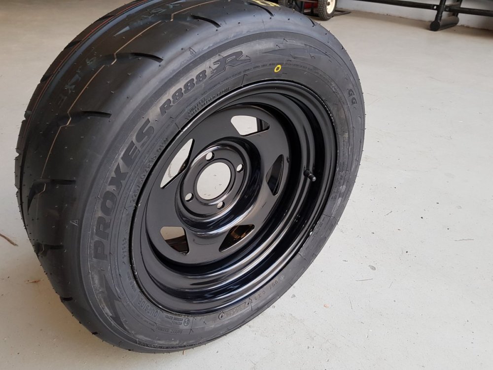

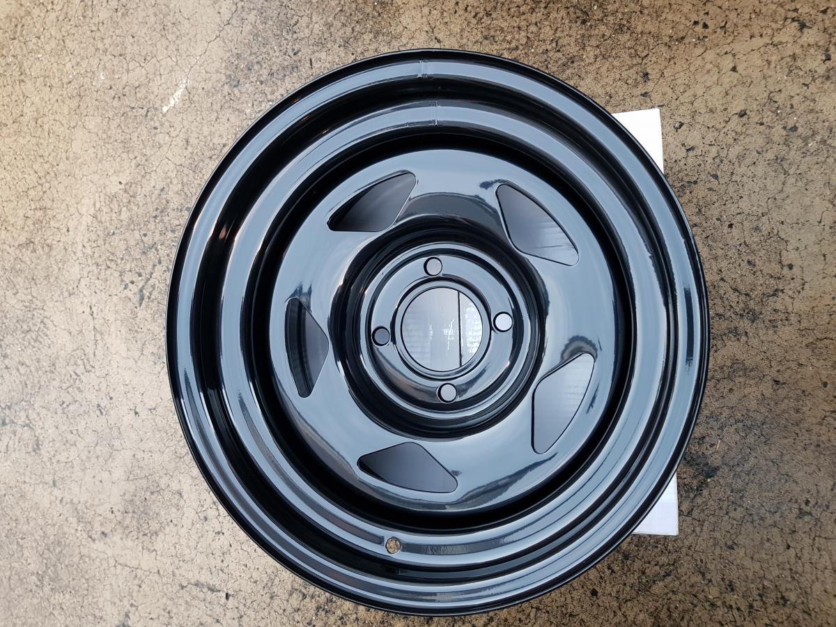

JDM-TOY Posted June 9, 2018 Author Posted June 9, 2018 (edited) Hey guys Small update, picked up some 15 X 8 0P star steel wheels for the Dato. I ordered a set of RS Watanabe 8 spoke from Japan and its been 2 months and no wheels yet. Thought to just get these steelies to get me by for fitment and rolling of the guards. I also Spoke to Steve the technical manager at Toyo and he said that the R888 R in a 205/50/15 would sit well on these wheels and also the Watanabes. So I put in a order for those too. Bilstein are taking there time to deliver the shocks I ordered. Not sure when they will arrive. Edited June 9, 2018 by JDM-TOY Quote
Moderators PB260Z Posted June 9, 2018 Moderators Posted June 9, 2018 Hi Great choice of rim size. You could fit 225/50 on that rim size as well, but clearence becomes an issue. I currently have 15X8 - 0 with 225/50/15 all round. I will probably be changing to 205/50/15 on front when I next change tyres. JDM-TOY 1 Quote

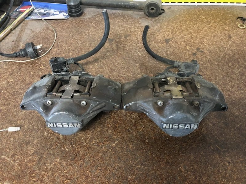

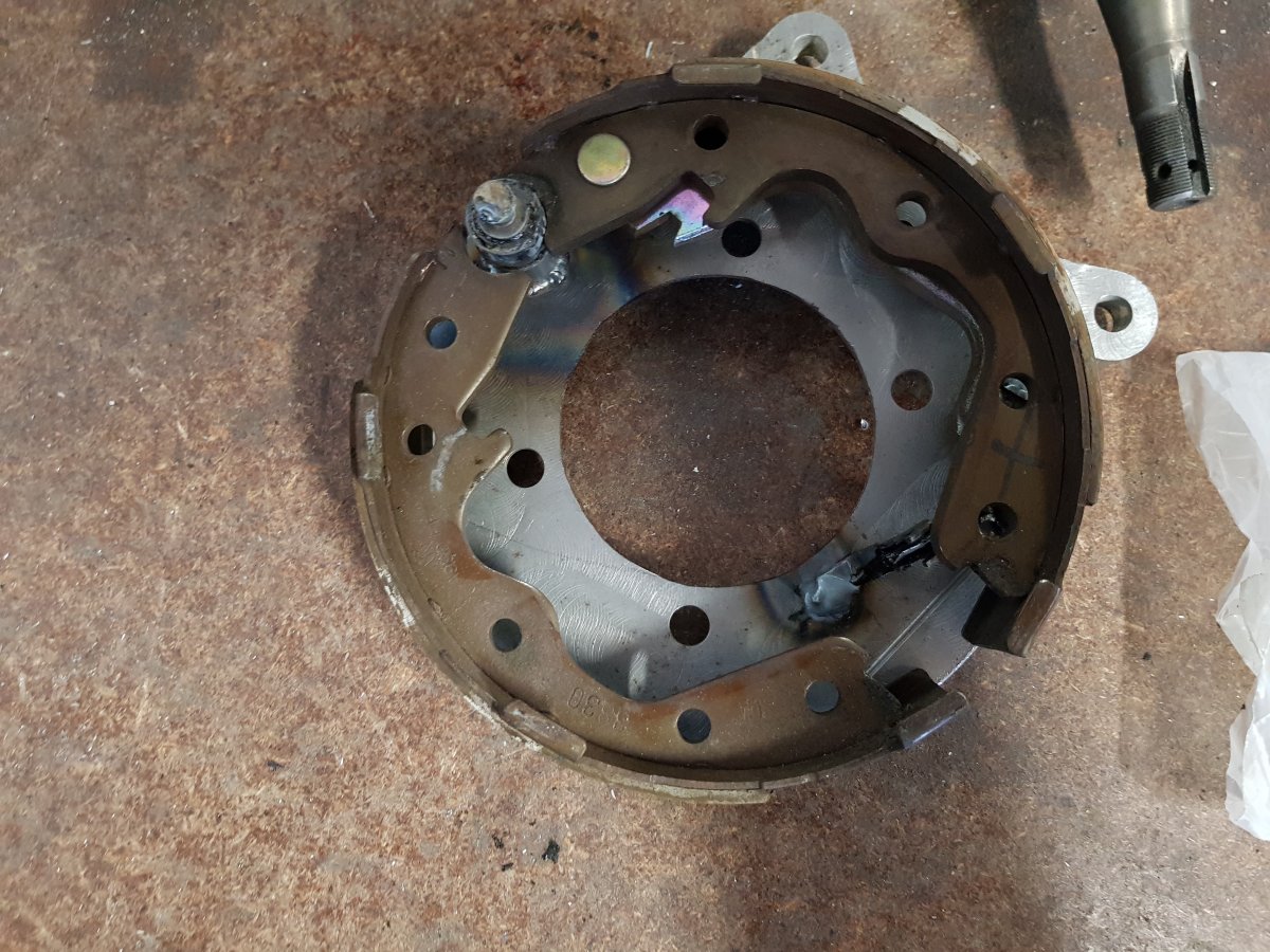

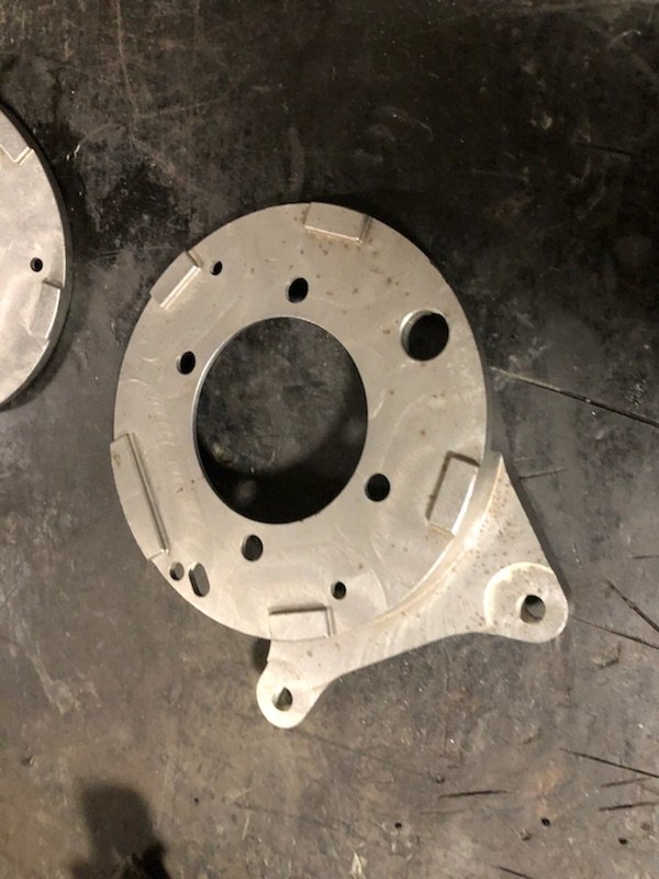

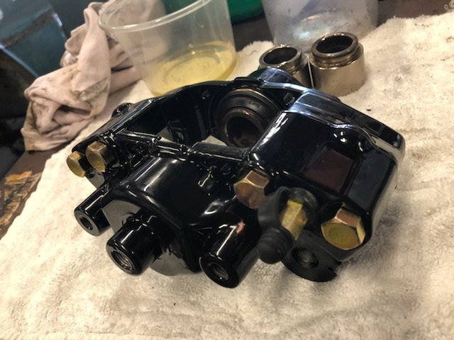

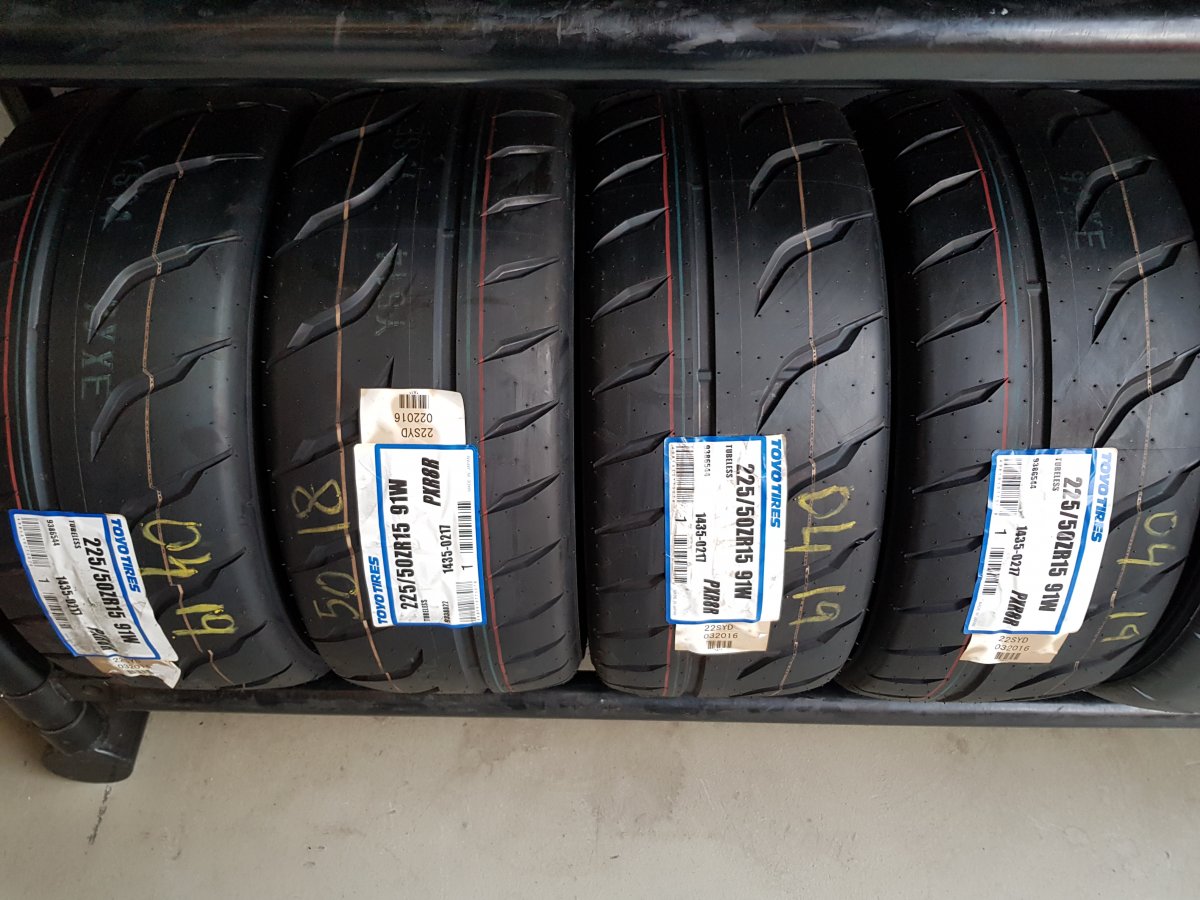

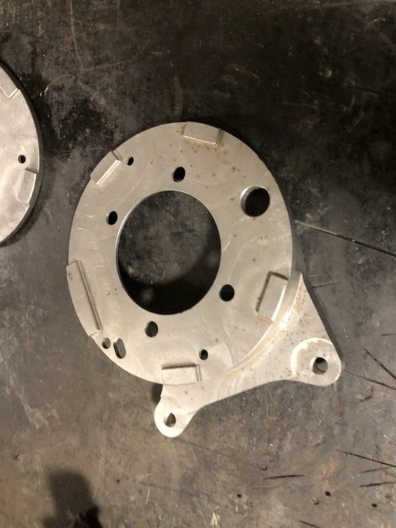

JDM-TOY Posted June 21, 2018 Author Posted June 21, 2018 (edited) Hey Guys been a little slack on updates. Picked up the Toyo R888 R on Monday and I must say they look quite nice. Cant wait to get them on the Watanabes and on the car to compare to the R1R's I had on the Celica. Also been working on the rear break conversion, picked these backing plates from SW Motorsport and I must add that they definitely put a hole in my pocket. Need to get them coated. So the plan is to run R33 GTR calipers front and rear with a 4 stud. Need to powder coat the calipers and get them rebuilt. Better to do this now so we have no issues later. Also have had the strut sleves adjusted for the coilovers. Waiting on getting them back from the powder coaters, I got them to powder coat them in Bronze. Rear end painted and new bushes so whould be good once together. Happy Restorations Everyone Edited June 23, 2018 by JDM-TOY Big fingers on a small key pad is no good KatoKid and RAP260 2 Quote
JDM-TOY Posted June 22, 2018 Author Posted June 22, 2018 Sorry Guys forgot to add pictures of the calipers. PB260Z 1 Quote

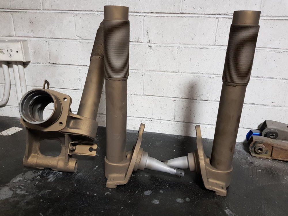

JDM-TOY Posted June 23, 2018 Author Posted June 23, 2018 (edited) I think im having second thoughts on the bronze, looks dirty and dusty. What do you guys think?? They look different in different lighting.... Edited June 23, 2018 by JDM-TOY Quote
Moderators PB260Z Posted June 24, 2018 Moderators Posted June 24, 2018 10 hours ago, JDM-TOY said: I think im having second thoughts on the bronze, looks dirty and dusty. What do you guys think?? They look different in different lighting.... Hi To be honest, I am not convinced, - what colour will the rest of hardware be ? - how does it look in a low light situation (like under a car)? But... as I have always said, “It is your car - build it the way YOU want it” Cheers PB Quote
Administrators gav240z Posted June 24, 2018 Administrators Posted June 24, 2018 If your paint job is going to be flat black sure, if not it looks like it's an inbetween phase colour. Like it's not finished. Quote
JDM-TOY Posted June 24, 2018 Author Posted June 24, 2018 3 hours ago, PB260Z said: Hi To be honest, I am not convinced, - what colour will the rest of hardware be ? - how does it look in a low light situation (like under a car)? But... as I have always said, “It is your car - build it the way YOU want it” Cheers PB The rest will be all black with enamel plated nuts and bolts. Yeah im getting turned off now, black would be a nicer look. 1 hour ago, gav240z said: If your paint job is going to be flat black sure, if not it looks like it's an inbetween phase colour. Like it's not finished. Yeah I agree, ill get them redone Thanks Guys Quote

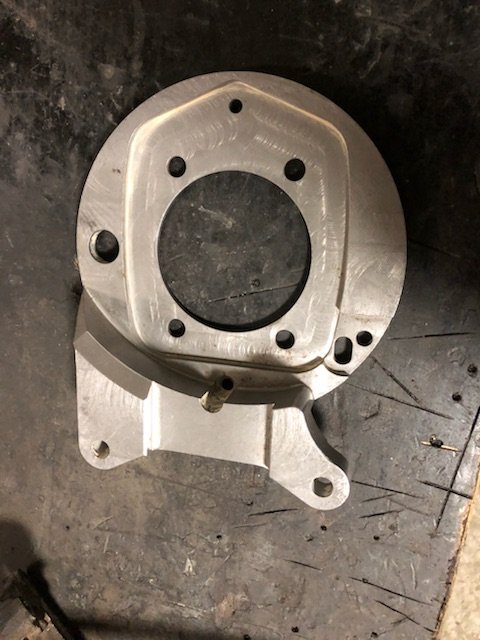

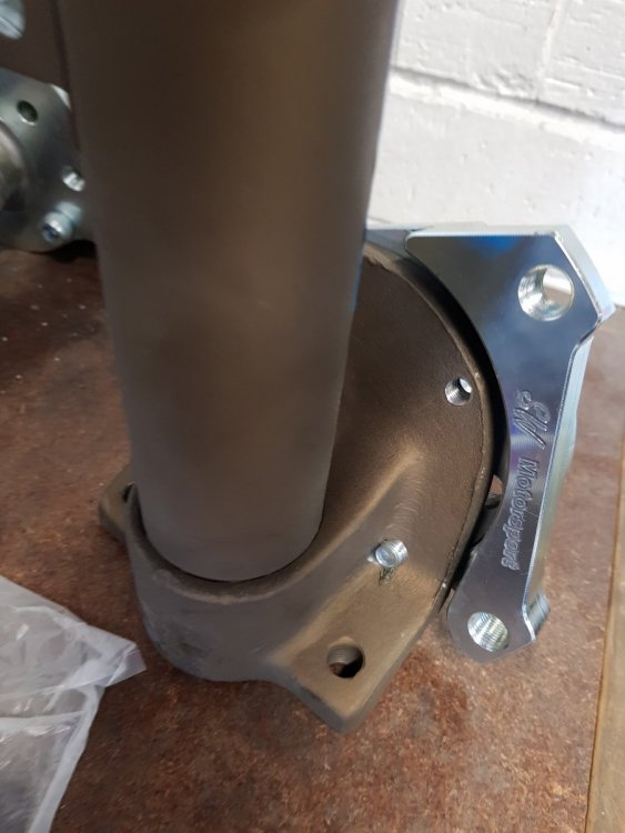

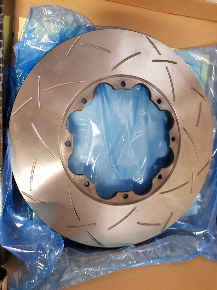

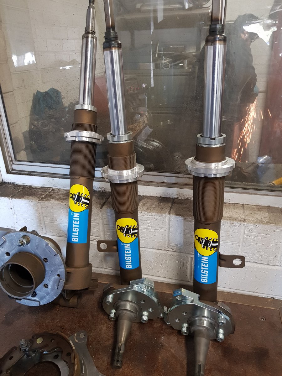

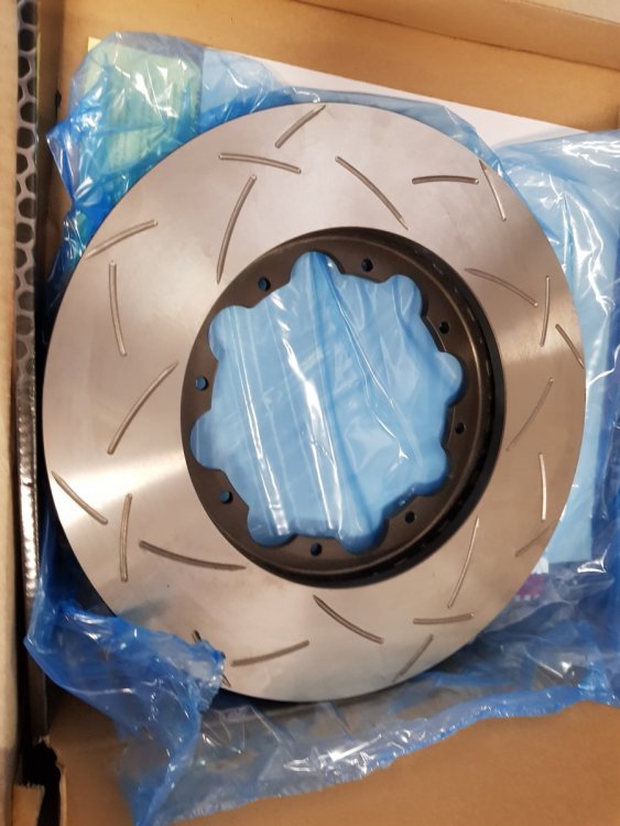

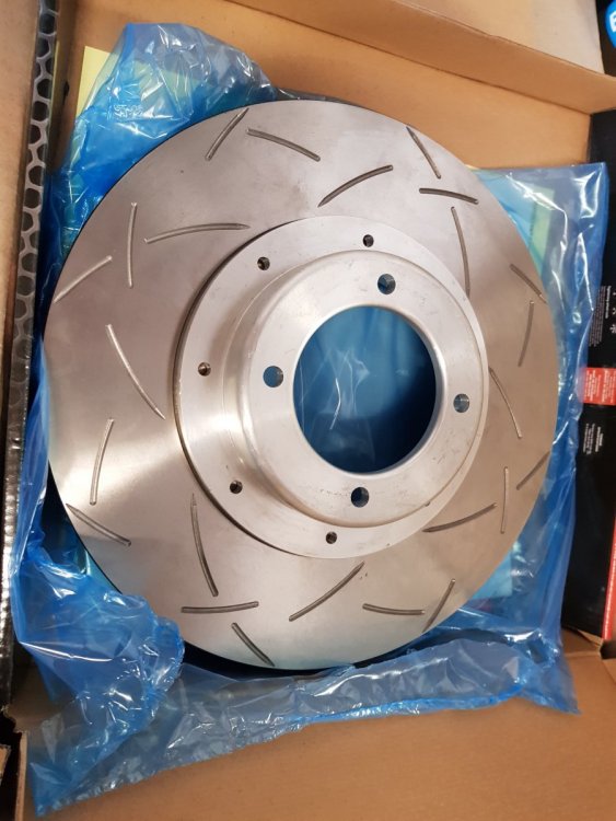

JDM-TOY Posted July 11, 2018 Author Posted July 11, 2018 Hey Guys Been a very busy young chap but the car still remains on the rotisserie. Basically been trying to sort out all the break components amd get parts from different people who have a lot of stock on back order. Today I managed head out to SW Motorsport to get the front caliper brackets, break discs (slotted& vented), aluminium hats, hat bolts, front break hoses, axel nuts and rear wheel bearing sets. Ill take some pictures of the caliper brackets soon I just want to know one thing, when will all this spending stop loll... RAP260 1 Quote

HKSZ Posted July 12, 2018 Posted July 12, 2018 Do you have to cut the old caliper mounts off the front struts and redrill for the SWR mounts? Quote
JDM-TOY Posted July 12, 2018 Author Posted July 12, 2018 21 hours ago, George said: The spending will stop when you run out of money. What brand are the rear wheel bearings? Haha yeah it seems that way ay George. Ill get the brand for you as I misplaced the box. Ill check again tomorrow 1 hour ago, HKSZ said: Do you have to cut the old caliper mounts off the front struts and redrill for the SWR mounts? HKSZ yeah old caliper mounts get shaved off and you need to redrill the holes on the strut. But Stewart said that once his mounts have been fitted the struts need to be swapped from side to side. Apparently so the R33 caliper fits Quote
HKSZ Posted July 12, 2018 Posted July 12, 2018 Yeah I've got these on a 240K strut I imagine zed bracket is the same Quote

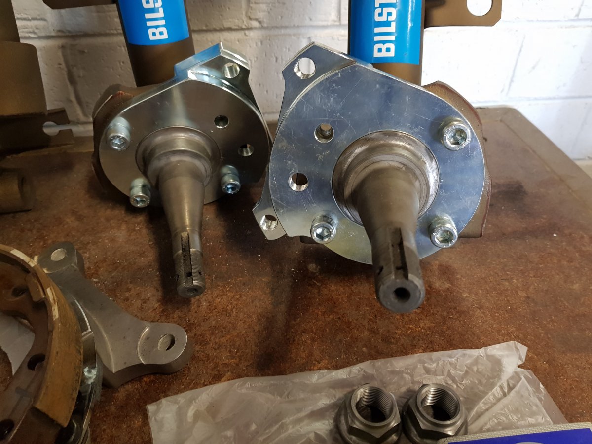

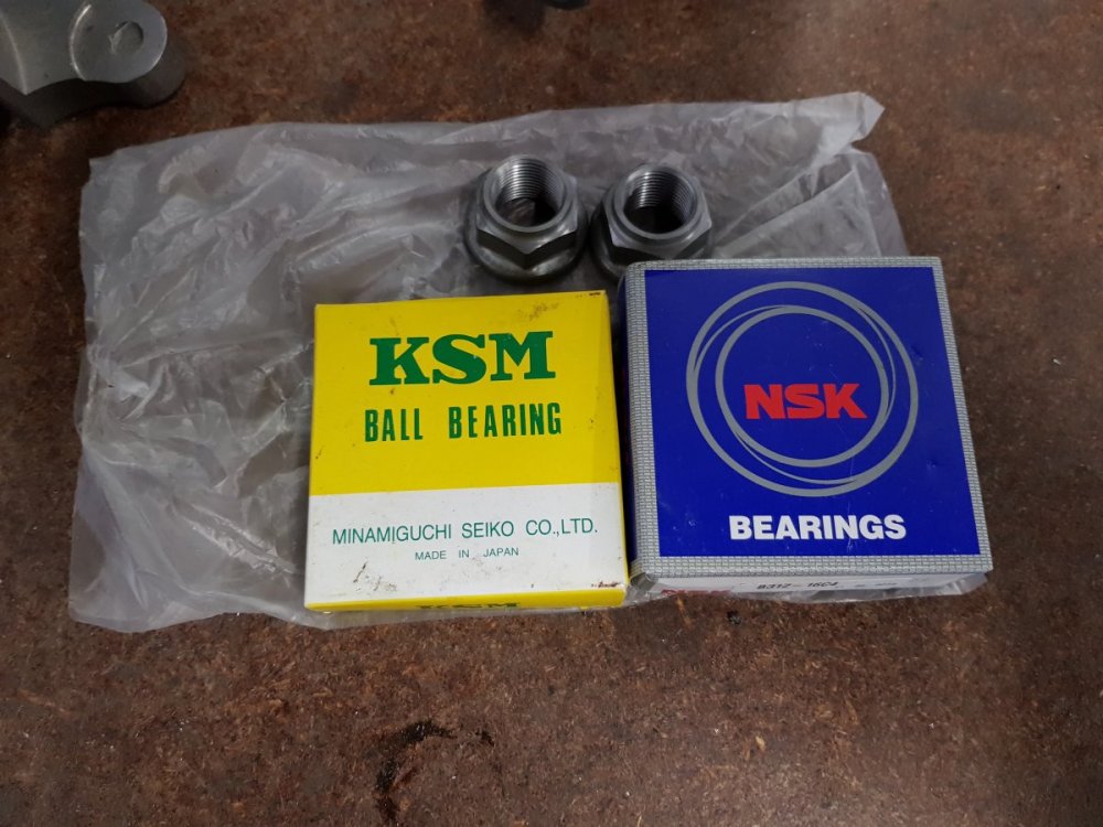

JDM-TOY Posted July 13, 2018 Author Posted July 13, 2018 Hey @George this is the brand for the bearings both made in Japan. @HKSZ this is the SW brackets I got. The existing caliper brackets have been shaved off so need to get the struts coated again. So I have decided to leave the struts in the smokey bronz colour as its starting to grow on me. Should have it all complete in the next few days George and RAP260 2 Quote

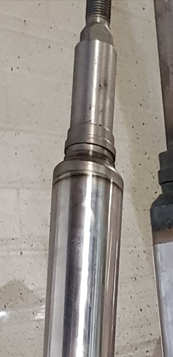

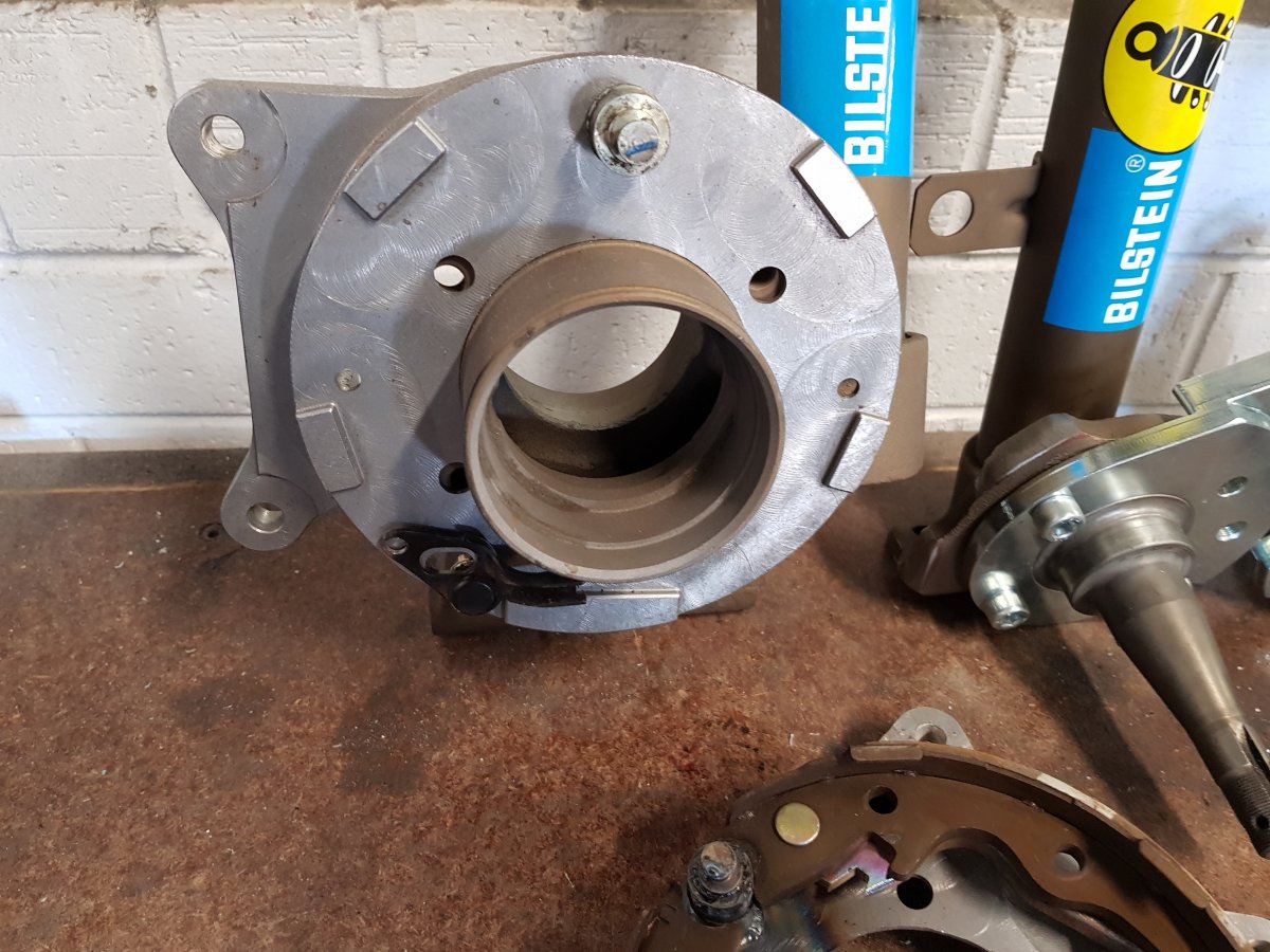

Riceburner Posted July 13, 2018 Posted July 13, 2018 Looking good, keen to know more about the bilsteins. Did you section the struts or use any spacers? I don’t mind the bronze, it’s a change from the black everything on all the mechanical parts. I’ve thought about doing the yellow chromate on struts, similar to the Ohlins S30 ones without the price tag. Quote
JDM-TOY Posted July 13, 2018 Author Posted July 13, 2018 (edited) Hey @Riceburner yeah the yellow would look nice even in matte yellow. Im using the factory S30 strut tops and I got some spacers made for the shock top. Not a great picture but I will take a few more and put them up. Youhan Edited July 13, 2018 by JDM-TOY . Quote

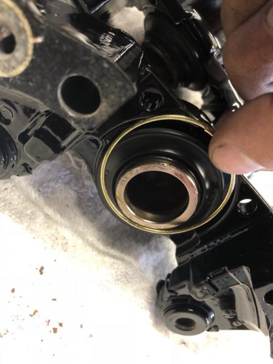

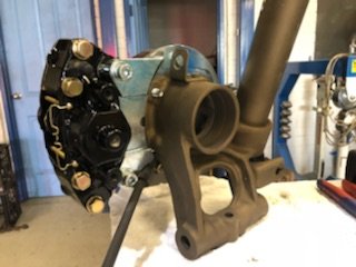

JDM-TOY Posted July 27, 2018 Author Posted July 27, 2018 Hey guys Making progress on the breaks, got the calipers back from powder coaters and had all the bolts and clips cadmium plated, also got a new seal kits. The SW brackets are spot on and look better than I thought. Had a heap of mucking around with fitting the hand break shoes and making them work with the springs and cable but got that sorted. Looking more complete KatoKid, RAP260 and 260z blues 3 Quote
