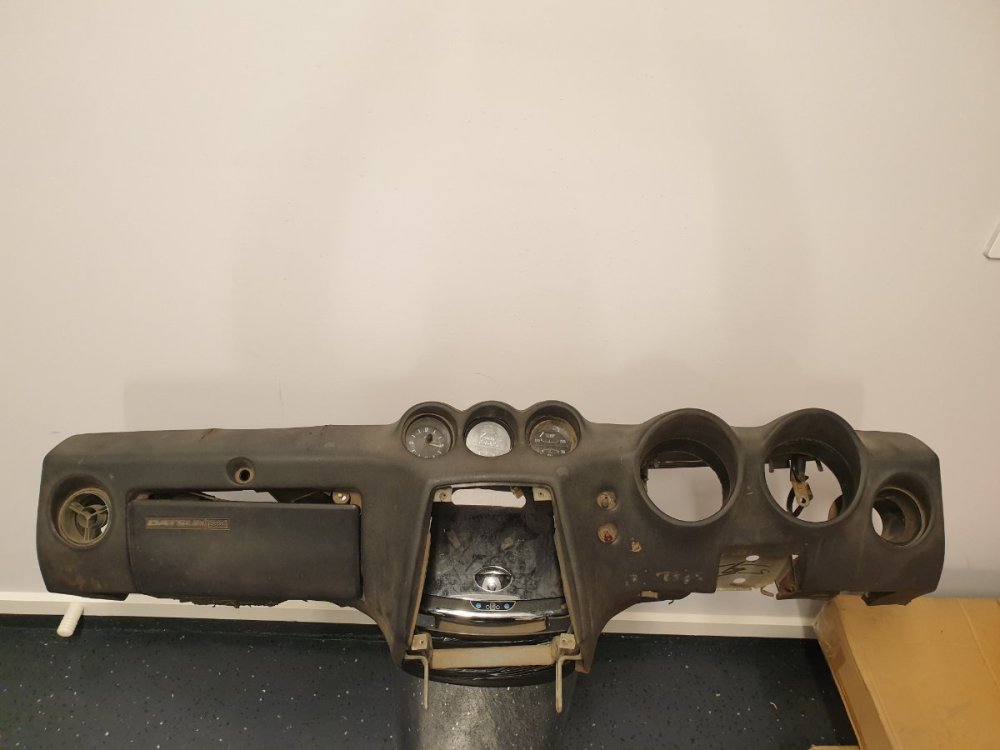

C.A.R. Posted November 11, 2022 Posted November 11, 2022 On 11/10/2022 at 10:36 PM, JDM-TOY said: So been busy trying to sort our all the fuel, brake and turbo lines on the car and fitting the front and rear calipers and have come across a issue with the rear set-up. Fuel, brake and turbo lines all look good and hidden, quite happy with the work. Im using the SW caliper kit to suite the rear R33 GTST set-up. The kit has been mounted well and the disk, caliper fit and rotate well with no issues. So the issue I have is that when we put the disc on we noticed that the centre hub is flush with the disc and that when we put the wheel on the hub does not extend into the centre of the wheel. Its just hollow and the weight of the car will be sitting on the studs and not on the hub, causing the distribution of weight to be on the studs. Wheels are Watanabe 15 × 8 zero offset, Tyres are 225/50/R15 Issue two is when we put the wheel on the wheel wont spin as it catches onto the real caliper. We can sort of solve this issue with spacers but I might run into another issue of having the wheel sticking out and hitting the inner guards when hitting a bump. I might need to machine inside of the wheels but I really dont want to head down this path as they are brand new wheels and I dont want to damage them in any way. Has anyone in the group had this issue? And what options are out there without changing my wheels Youhan If you bought the kit from Stew, talk to him about your concern. JDM-TOY 1 Quote

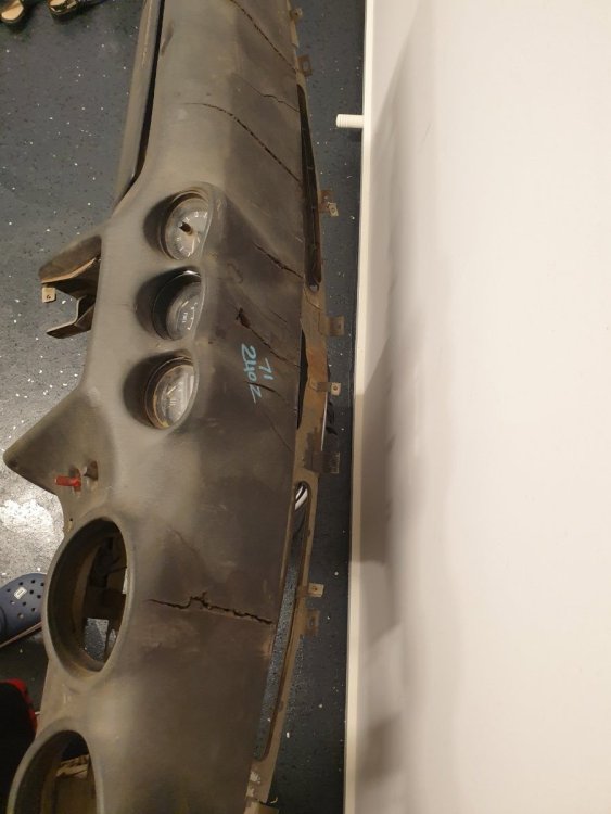

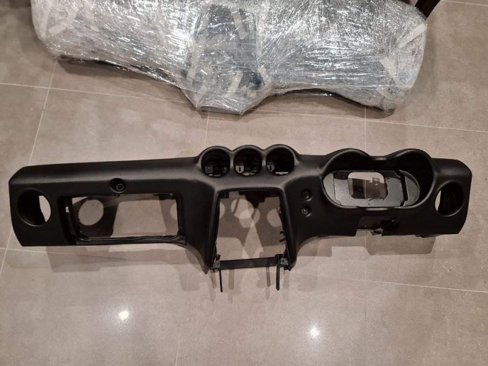

JDM-TOY Posted November 16, 2022 Author Posted November 16, 2022 Dashboard is heading down from Dashboard Dr, looks amazing. Big difference from the broken dash it was Not sure why the photos are upside down 240ZBUILTBYME 1 Quote
Millerman Posted November 16, 2022 Posted November 16, 2022 Dash looks great mate. Do you mind me asking what they charge for the redo of it? Guessing its all done with vacuum forming? also who did you use for the dash transporting? Thanks Dan Quote
JDM-TOY Posted November 16, 2022 Author Posted November 16, 2022 3 minutes ago, Millerman said: Dash looks great mate. Do you mind me asking what they charge for the redo of it? Guessing its all done with vacuum forming? also who did you use for the dash transporting? Thanks Dan Thanks mate, Dashboard Dr charged me $1,100 for the full resto, I had Concept Garage do the Ic7 insert. I used Ego for transport from Sydney to Melb with insurance was $105 Quote
Millerman Posted November 16, 2022 Posted November 16, 2022 3 hours ago, JDM-TOY said: Thanks mate, Dashboard Dr charged me $1,100 for the full resto, I had Concept Garage do the Ic7 insert. I used Ego for transport from Sydney to Melb with insurance was $105 That seems very reasonable all round! JDM-TOY 1 Quote

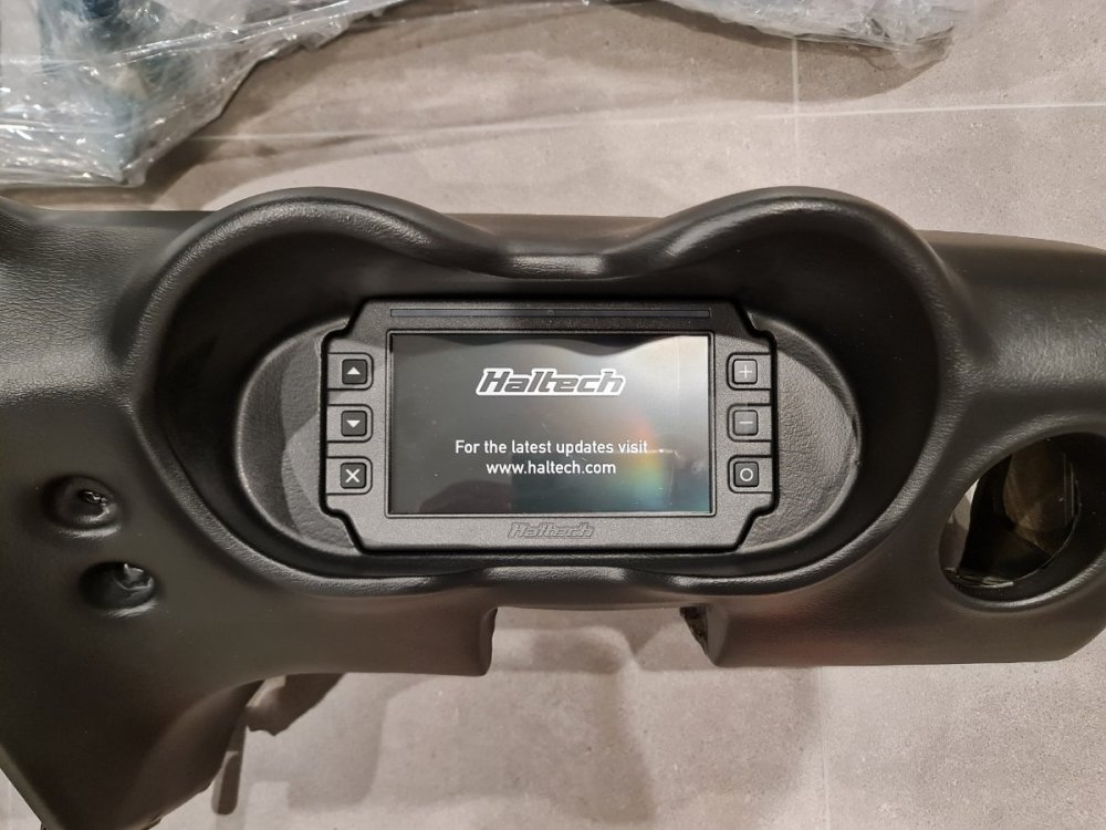

JDM-TOY Posted November 25, 2022 Author Posted November 25, 2022 Dash areived today, quite happy with the finish. Has some imperfections at the inner glove box section but will be hidden once the glove box door goes on. iC7 fits quite snug and now looks complete. I wasn't sure how it would look when finished and Im suprised how well it looks complete Millerman, 240ZBUILTBYME, sexual_sushi and 1 other 4 Quote
