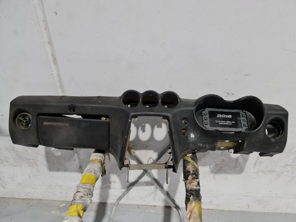

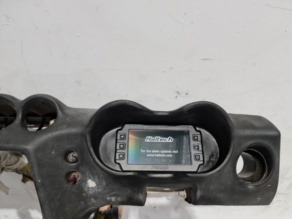

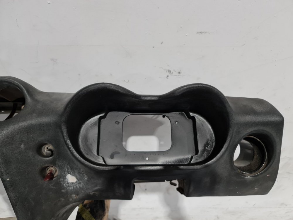

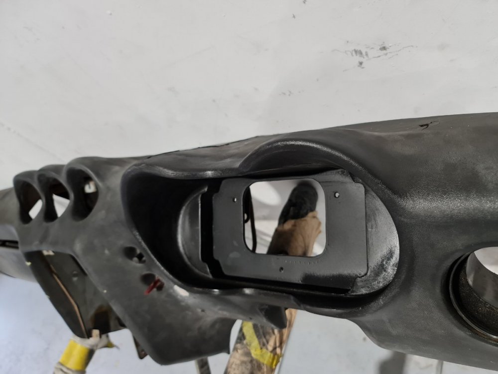

JDM-TOY Posted June 3, 2021 Author Posted June 3, 2021 Hey Guys Finally after 8 months of waiting I have picked up my modified dash to mount up the Haltech IC-7 dash. Danny at Concept Garage did a great job on the styling to make sure the dash retained the signature curves of the OME dash. Just a little modern with the Haltech IC-7 going into it other than the OME cluster. I know that its not to everyone's taste but with all the electronics going into the car I wanted to make sure everything was in sync. I have still kept the original dash and it on display in my man cave. Still need to send it off to the Dash Dr to refurbish and reskin in the factory look vinyl. Will probably send the dash after the lockdowns are lifted. Other than that progress has been slow due to work commitments but will start installing the brakes, tailshaft and a few other things to get it ready for wiring. Giddy Up! 240ZBUILTBYME, hmd, 77260Z and 1 other 4 Quote

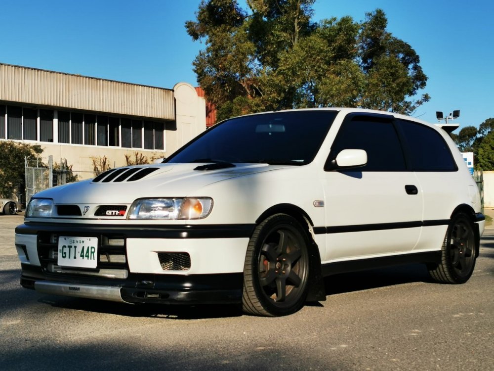

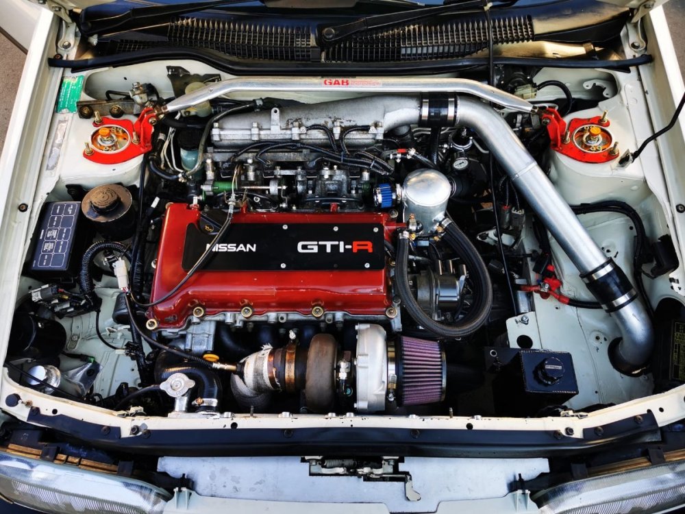

JDM-TOY Posted September 8, 2021 Author Posted September 8, 2021 So been a while since posting on here about the 240z but been busy with my other little toy the GTiR Pulsar. A few weeks back I was happily driving when I decided to hit it in second and blew the turbo. Investigations found that the turbo was oil starved. Took the car to Just Engine Management had the boys tinker with the car, replace some bits and pieces, get High Spool to rebuild the turbo and run a new tune on dyno Quite impressive 279atwKW, the car drives amazing compared to the old tune the car had and it actually sounds more aggressive. Gave it a good hit on the way home and first, second gear wheel spin and sliding. Craziness I need to control Will need to get that pod filter extended away from the turbo and fix up gutter rash on the rear passenger wheel VID_243721106_063854_147.mp4 CBR Jeff, 240ZBUILTBYME and Millerman 3 Quote
GregTas Posted September 8, 2021 Posted September 8, 2021 (edited) 280kW is a good effort out of a 2 litre. How much boost to get that? E85 or 98? Edited September 8, 2021 by GregTas JDM-TOY 1 Quote
JDM-TOY Posted September 8, 2021 Author Posted September 8, 2021 6 minutes ago, GregTas said: 280kW is a good effort out of a 2 litre. How much boost to get that? E85 or 98? 26psi on E85 could get more if I upgrade the injectors from 1000cc to 1200cc and upgrade to a Haltech Elite which I have but saving it for the 240z. Spending never stops Quote
GregTas Posted September 9, 2021 Posted September 9, 2021 14 hours ago, JDM-TOY said: 26psi on E85 Thought it boost would be quite high and E85. I was getting 270kW out of my RB25 at 16psi on 98 fuel. Now running 18psi, so probably about 280ish. JDM-TOY 1 Quote
JDM-TOY Posted September 9, 2021 Author Posted September 9, 2021 17 minutes ago, GregTas said: Thought it boost would be quite high and E85. I was getting 270kW out of my RB25 at 16psi on 98 fuel. Now running 18psi, so probably about 280ish. Thats quite good for 98 but the RB25 engine is bigger than the Sr20det Quote

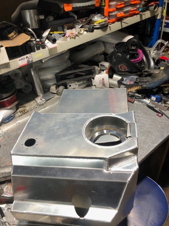

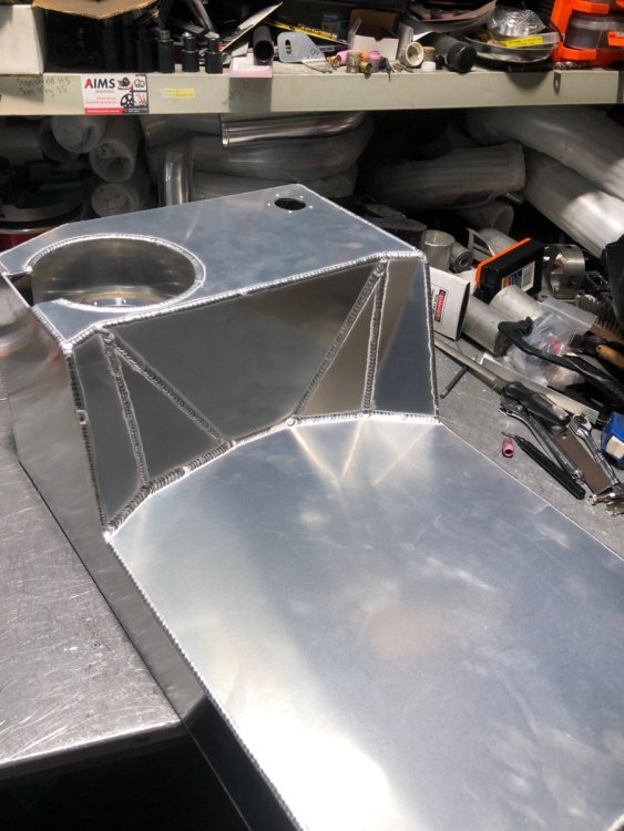

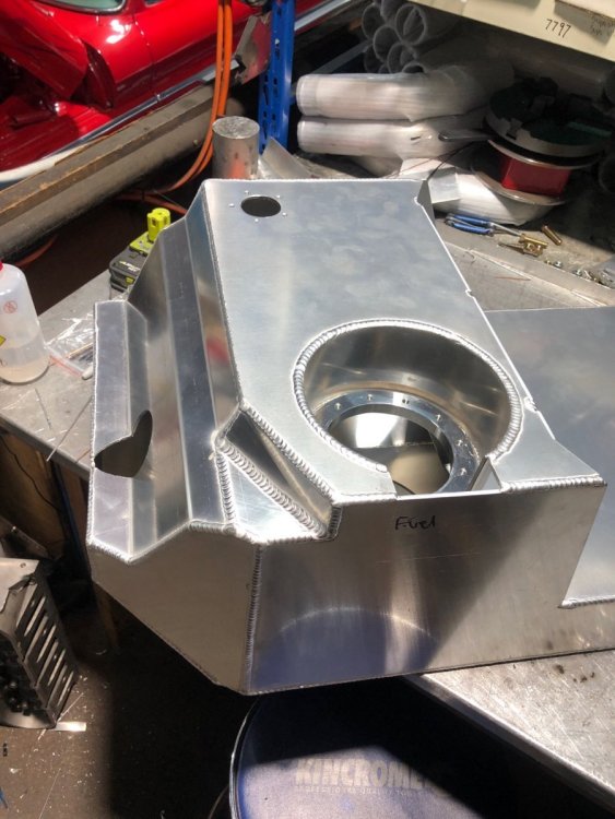

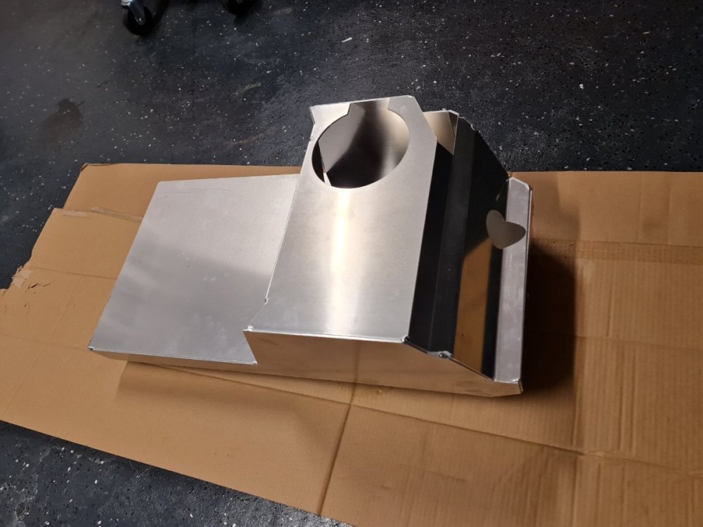

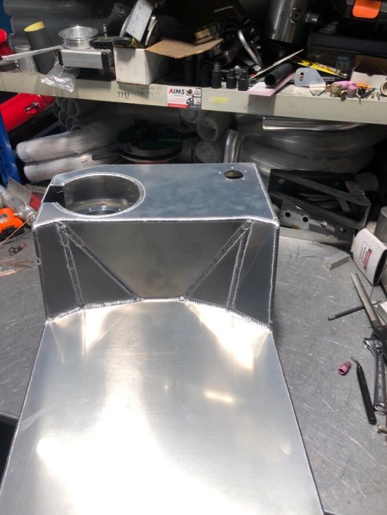

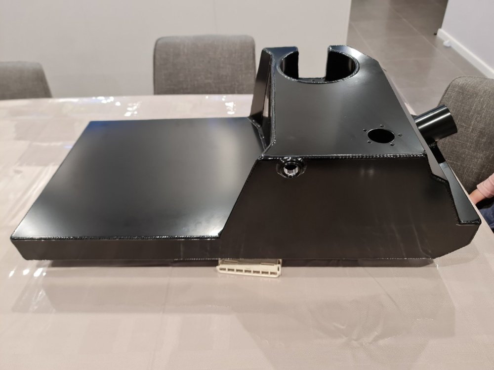

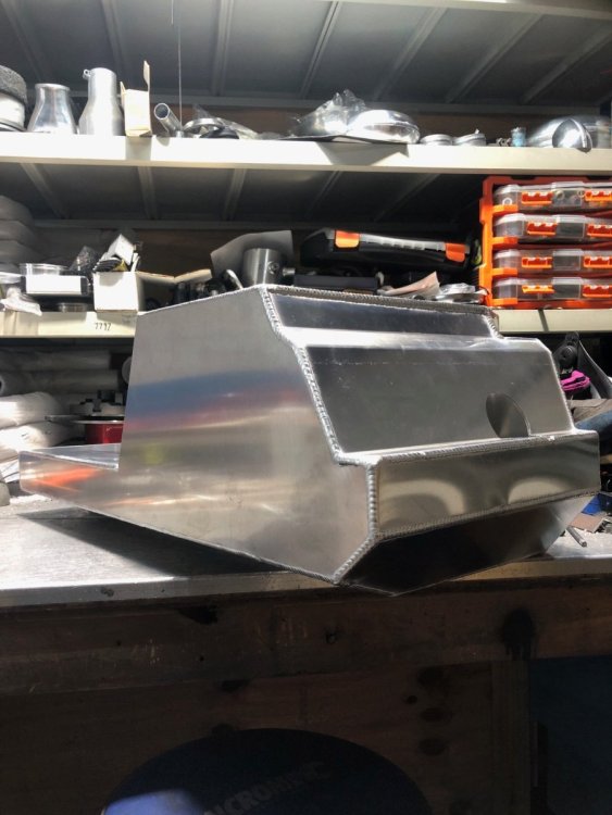

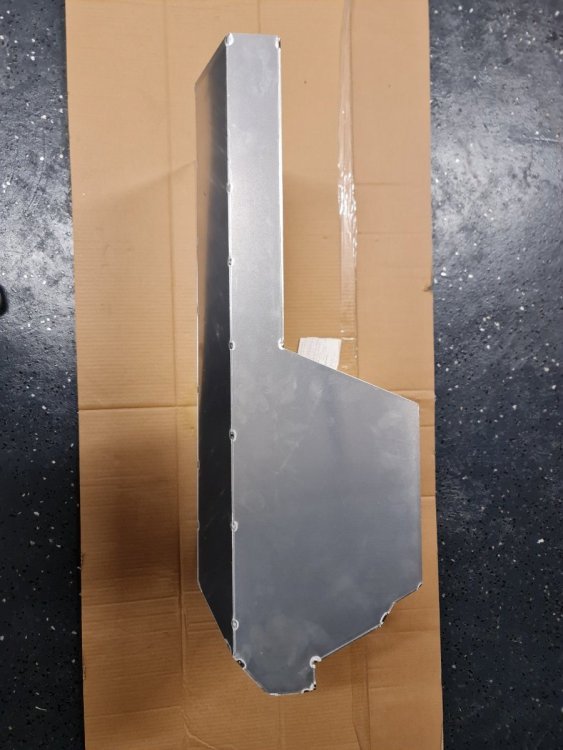

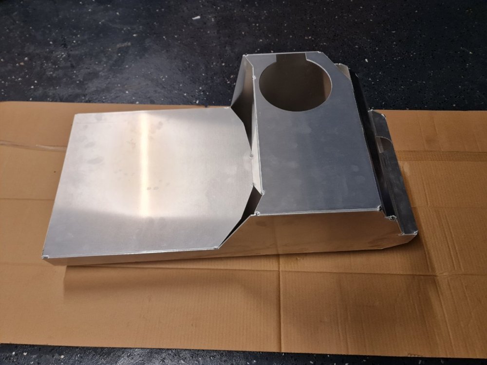

JDM-TOY Posted June 29, 2022 Author Posted June 29, 2022 Hey Guys Been a slow journey trying to get things sorted on the 240z, mostly waiting for a spot to open up at Croydon Racing to take the car in. I finally decided to get a custom fuel tank made up to replicate the stock, damaged rusted tank. I had issues cleaning and fixing the old tank and I didn't see the point of buying the reproduction tanks selling online. I took the old tank to Chris at Castle Hill Exhaust in Sydney and he designed and fabricated a new aluminium tank. New internal punp, new sender, new lines will definitely make things easy moving forward. Some pictures of the new tank. Still needs to put in baffles and weld it up once pump and sender have been test fitted. When we fit the tank I will take fitment pictures and put them up Quote

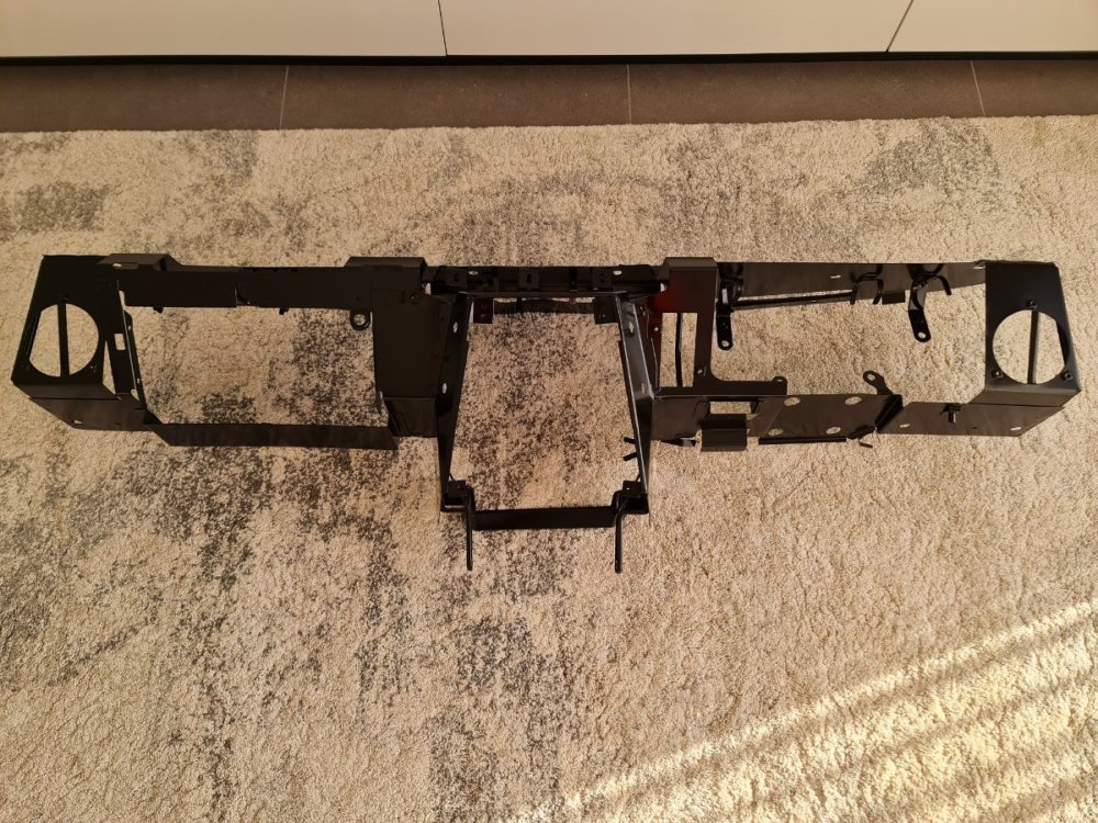

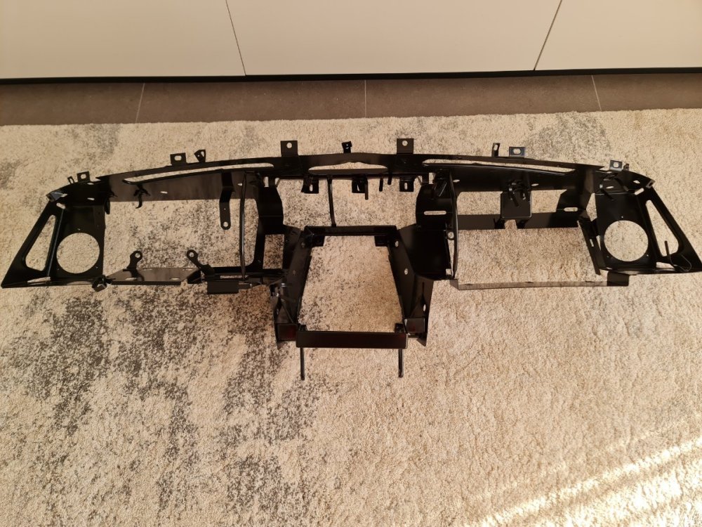

JDM-TOY Posted July 8, 2022 Author Posted July 8, 2022 After some inspiration from @ND240Z I sent the dash frame to get bladted and powder coated. Going to fix the dash pad on the frame and send it to the Dash Dr in Melbourne. Apparently 8 week wait gav240z 1 Quote
JDM-TOY Posted July 15, 2022 Author Posted July 15, 2022 (edited) Just some quick progress photos of the new fuel tank Edited July 16, 2022 by JDM-TOY sexual_sushi, Agno and 77260Z 3 Quote

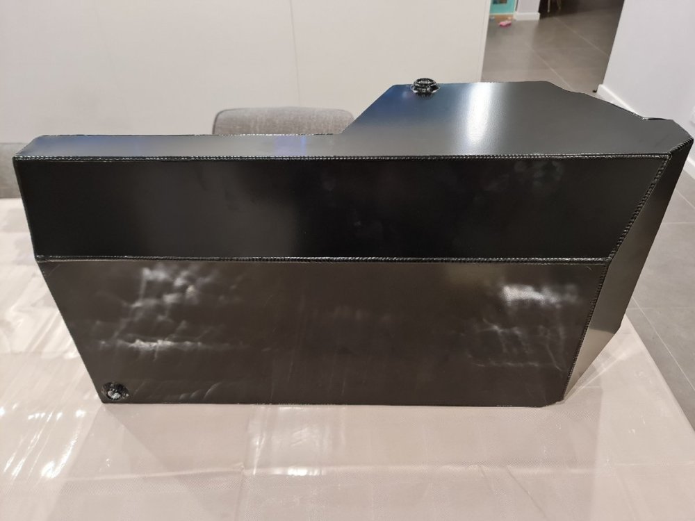

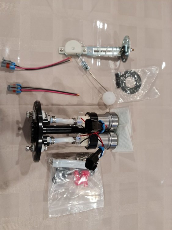

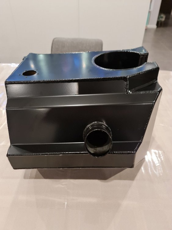

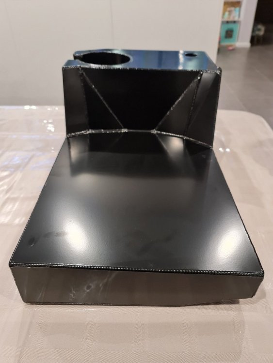

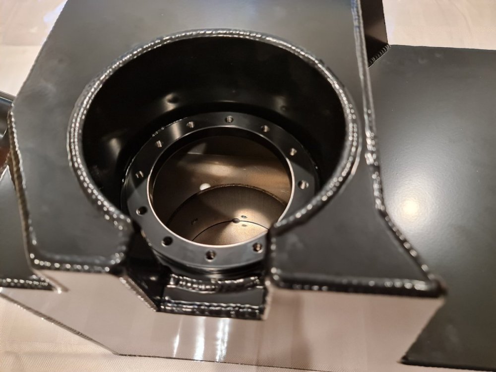

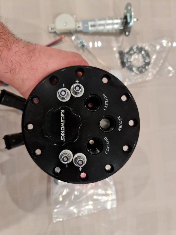

JDM-TOY Posted August 2, 2022 Author Posted August 2, 2022 (edited) Hey guys Just got the tank back from powered coating. Going to have the tank straps made up when the car is getting the lines done back at the shop. So the set up is a Raceworks twin fuel cell, two 460 pumps with new sender to suit. Link: https://raceworks.com.au/catch-cans-tanks/hangers/single-twin-fuel-pump-hanger/ Waiting to have all new fuel lines, turbo lines, water lines, catch can lines, wiper lines and brake lines all sorted. Have a few cars ahead so expected to get started in 5 weeks or so. Its amazing how everyone is backed up with work lined up The whole set up was done by Chris from Castle Hill Exhaust. Very reliable and honest guy would highly recommend. He mentioned he will be joining the forum to put more details up if anyone wants a new tank made up. Happy restorations Edited August 2, 2022 by JDM-TOY ScottyD, 77260Z and 240ZBUILTBYME 3 Quote

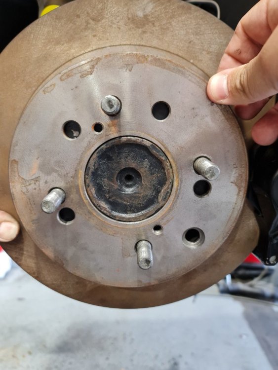

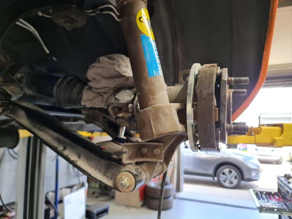

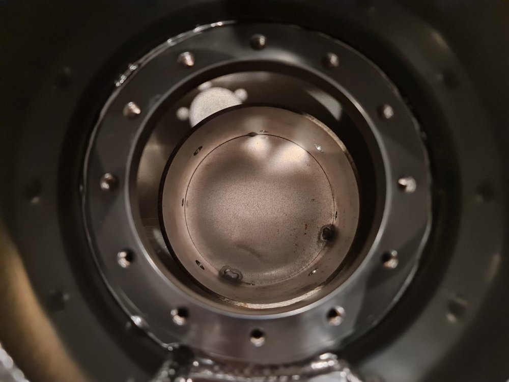

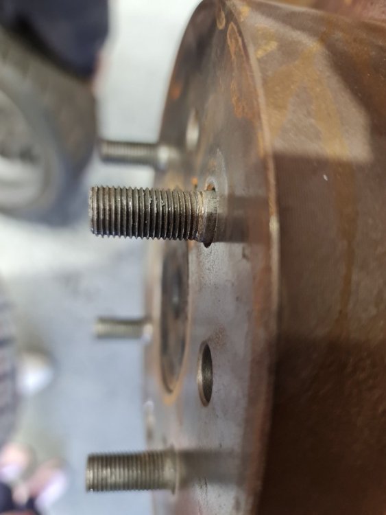

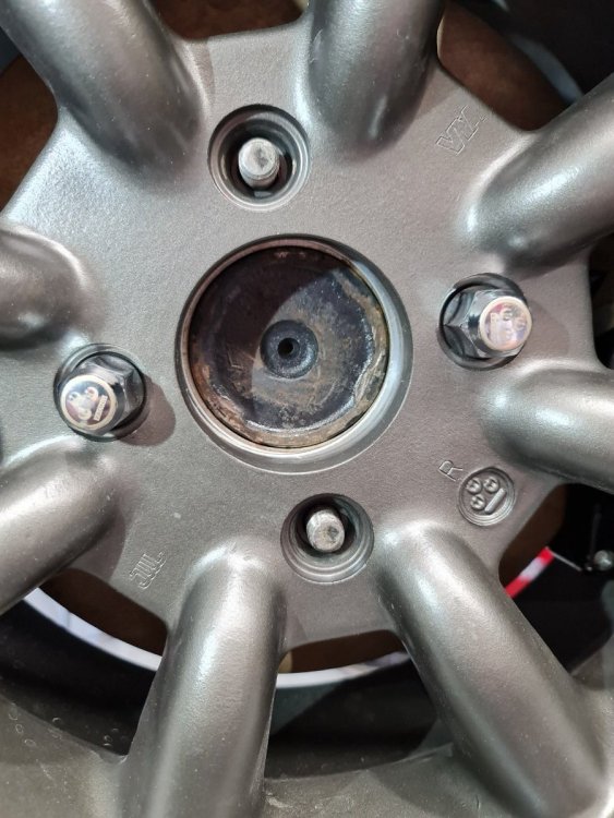

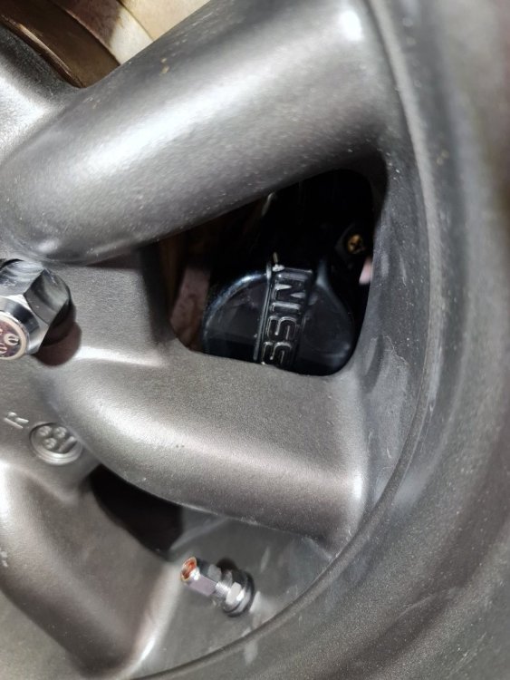

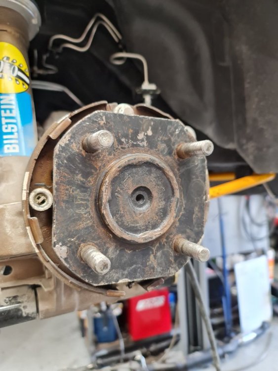

JDM-TOY Posted November 10, 2022 Author Posted November 10, 2022 So been busy trying to sort our all the fuel, brake and turbo lines on the car and fitting the front and rear calipers and have come across a issue with the rear set-up. Fuel, brake and turbo lines all look good and hidden, quite happy with the work. Im using the SW caliper kit to suite the rear R33 GTST set-up. The kit has been mounted well and the disk, caliper fit and rotate well with no issues. So the issue I have is that when we put the disc on we noticed that the centre hub is flush with the disc and that when we put the wheel on the hub does not extend into the centre of the wheel. Its just hollow and the weight of the car will be sitting on the studs and not on the hub, causing the distribution of weight to be on the studs. Wheels are Watanabe 15 × 8 zero offset, Tyres are 225/50/R15 Issue two is when we put the wheel on the wheel wont spin as it catches onto the real caliper. We can sort of solve this issue with spacers but I might run into another issue of having the wheel sticking out and hitting the inner guards when hitting a bump. I might need to machine inside of the wheels but I really dont want to head down this path as they are brand new wheels and I dont want to damage them in any way. Has anyone in the group had this issue? And what options are out there without changing my wheels Youhan 240ZBUILTBYME 1 Quote
