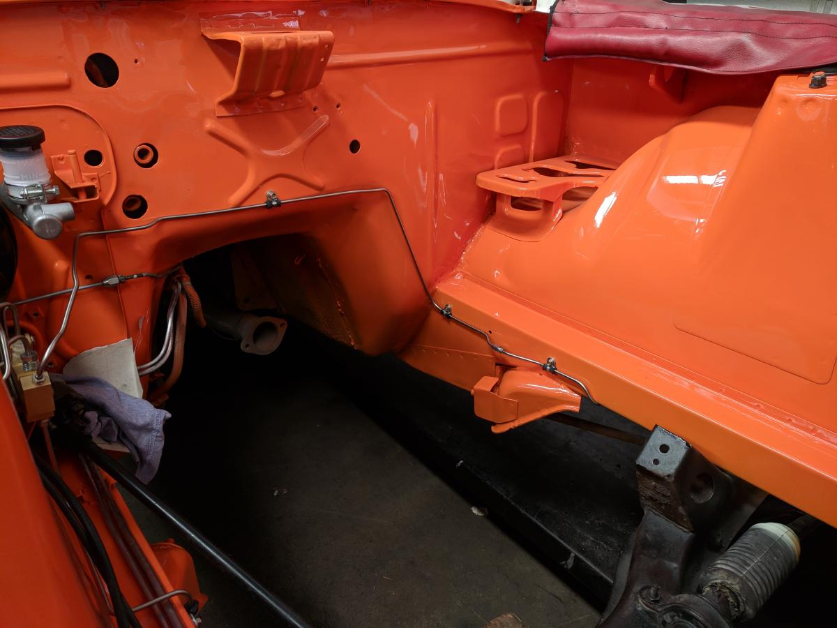

JDM-TOY Posted November 15, 2017 Author Posted November 15, 2017 (edited) Hey guysSmall update on this buildHad Ray from Mobile Brake Solutions out yesterday to run new stainless steel brake lines. Should be back in a few days to finalise the fuel lines once the engine is in.Also I'm going to remove the X member and steering arm and get them sandblasted and powder coated black. Also, will clean up that rubber on the firewall for the steering arm, looks ugly painted in orange.Cheers Edited November 15, 2017 by JDM-TOY Ponyo240z 1 Quote
