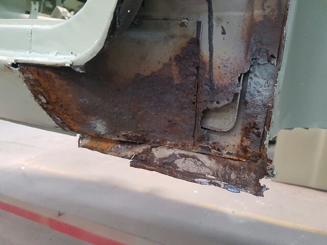

JDM-TOY Posted March 1, 2018 Author Posted March 1, 2018 (edited) Recieved a few pictures today of the doors today after being blasted and epoxy primed and It seems that whoever did these dodgy repairs had a pop revit fetish. I wonder what it looks like underneath that "repair" plate. Edited March 1, 2018 by JDM-TOY Quote
Administrators gav240z Posted March 1, 2018 Administrators Posted March 1, 2018 It looks like what you think it does.. HomeBuiltByJeff and JDM-TOY 2 Quote

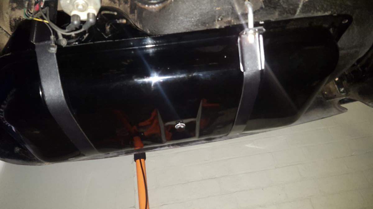

d3c0y Posted March 1, 2018 Posted March 1, 2018 With the fuel tank, I took mine to my panel beater and got them to spray it in gloss black 2 pack looks great. JDM-TOY and gav240z 2 Quote
JDM-TOY Posted March 1, 2018 Author Posted March 1, 2018 With the fuel tank, I took mine to my panel beater and got them to spray it in gloss black 2 pack looks great. 20171105_161019.jpg 20171105_161047.jpg Actually thats a good idea. Do you mind if I do the same. The finish on mine is poor Quote

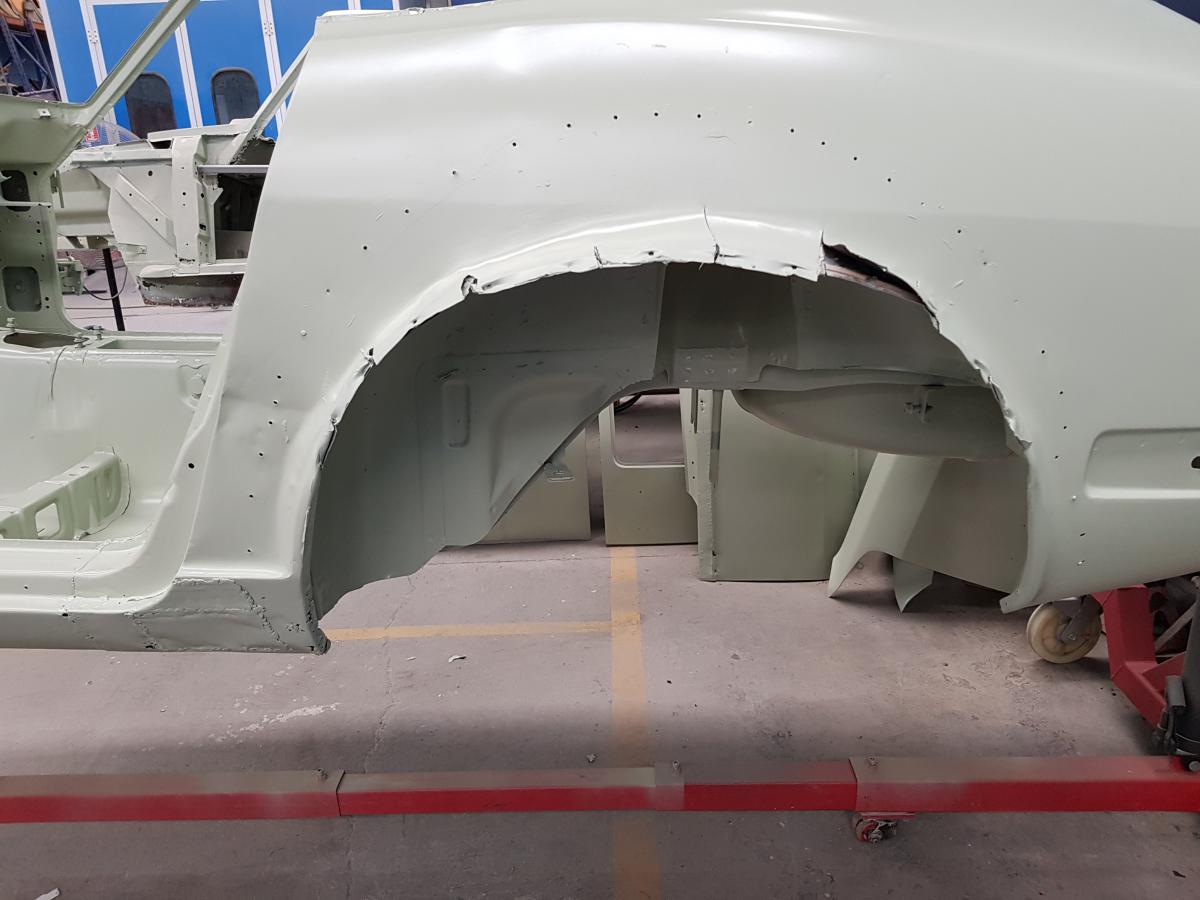

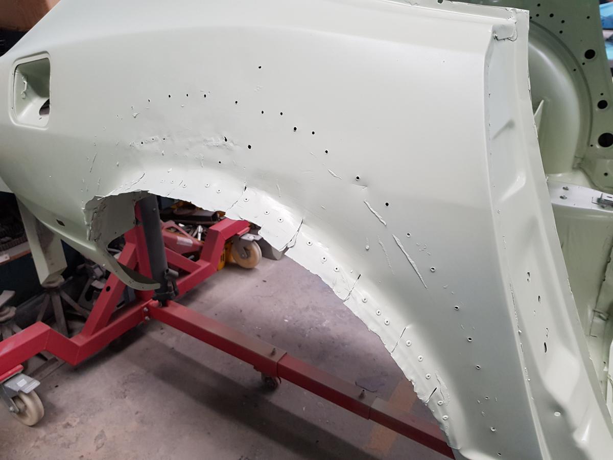

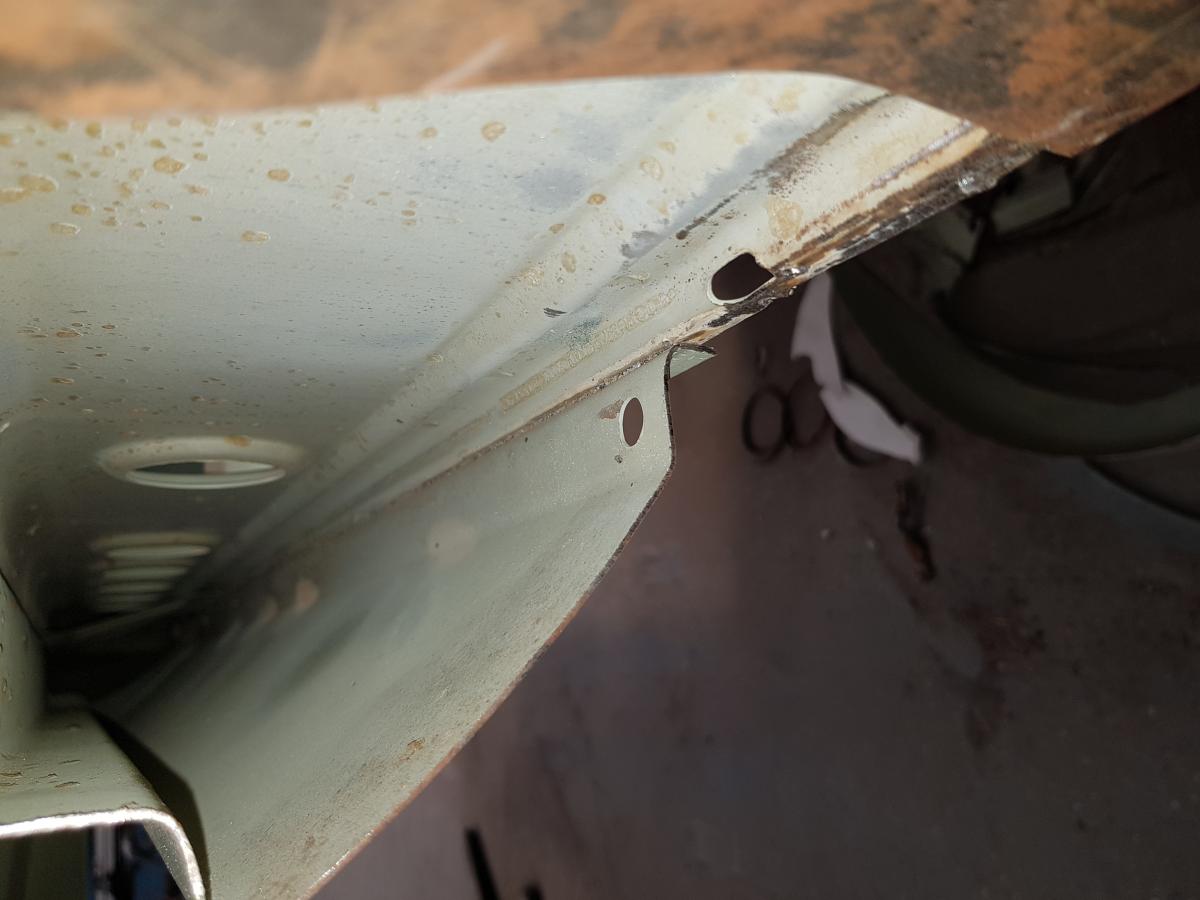

JDM-TOY Posted March 7, 2018 Author Posted March 7, 2018 Hey guys Visited the old girl today to check out the body after the media blasting. Rear quater had previous damage, floors are mint, under car was really clean except some small dents, sills are perfect and the rear guards need obvious work. I have picked two outer and one innder repair panels (not from warren) but will need to order one left inner from MSA. Slowly but surely its coming together. CBR Jeff and gav240z 2 Quote
Administrators gav240z Posted March 7, 2018 Administrators Posted March 7, 2018 Glad to see you're staying positive. Quote
JDM-TOY Posted March 7, 2018 Author Posted March 7, 2018 (edited) Glad to see you're staying positive. Yeah its expected to see rust or body damage on a 46 year old car. Im just happy its not as bad as I thought it would be. Better get it done properly once and enjoy for years. Edited March 7, 2018 by JDM-TOY Quote

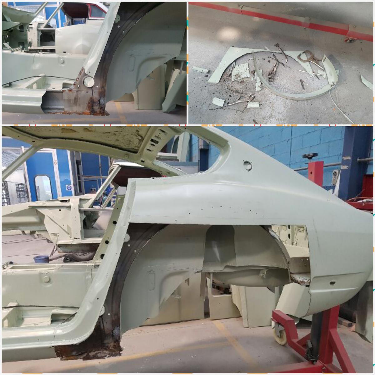

JDM-TOY Posted March 20, 2018 Author Posted March 20, 2018 (edited) The Build Progresses Just an update on the build. Had the rear inn and outer wheel arch cut out all the way down to the dog leg and in up to the boot inner wheel arch. Had some rust built up in the lower dog leg that will also be repaired. I really want to open up that sill panel to see whats happening inside Just waiting on some parts to arrive from MSA and Tabco. Seriously I spent over $1600 in just shipping costs from the US. From MSA I purchased new reproduction tail lights part number 33-1168A. New Datsun reproduction Competition Steering Wheel part number 50-3157. Fairlady 432 Style Rear Spoiler part number 50-1611. Rear Emblem Fairlady Z part number 31-1120. And some rear quater glass weather strips for inner and outer part number 34-1010 & 34-1011. Inner wheer arch repair panel part number 30-7308. Hopefully should be in late next week Edited March 20, 2018 by JDM-TOY Quote

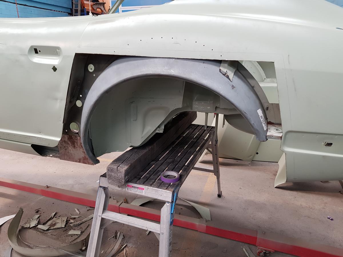

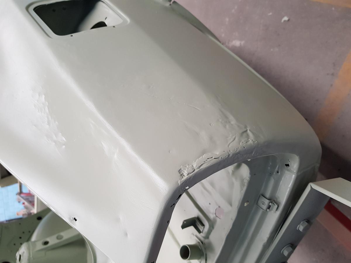

JDM-TOY Posted March 22, 2018 Author Posted March 22, 2018 Hi Guys Just a small update I think the Rust gods have been kind to me as we cut open the passengers sill and found no rust inside, I couldn't believe my eyes. So the inner replacement guard has been tek screwed in place and aligned. Had to put the passenger door back on to align the inner and outer guards. The small issue we had was that the outer replacement panel was kind of wonky and on a angle so we had to fold and cut it down from the inner dog led section. Also hat to align and cut the panel to make it sit straight on the rear quarter. Probably will have this section finished next week some time but I think I will need to get a new passenger door skin from Rare Spares but not cheap through their Ebay store https://www.ebay.com.au/itm/Datsun-240Z-260Z-Left-Hand-Door-Skin-Rare-Spares-Adelaide/332577050708?epid=1476235454&hash=item4d6f231054:g:CBYAAOSwEEBaMD5p Has anybody used their door skins on the restoration project?? gav240z 1 Quote

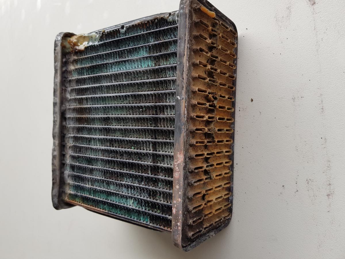

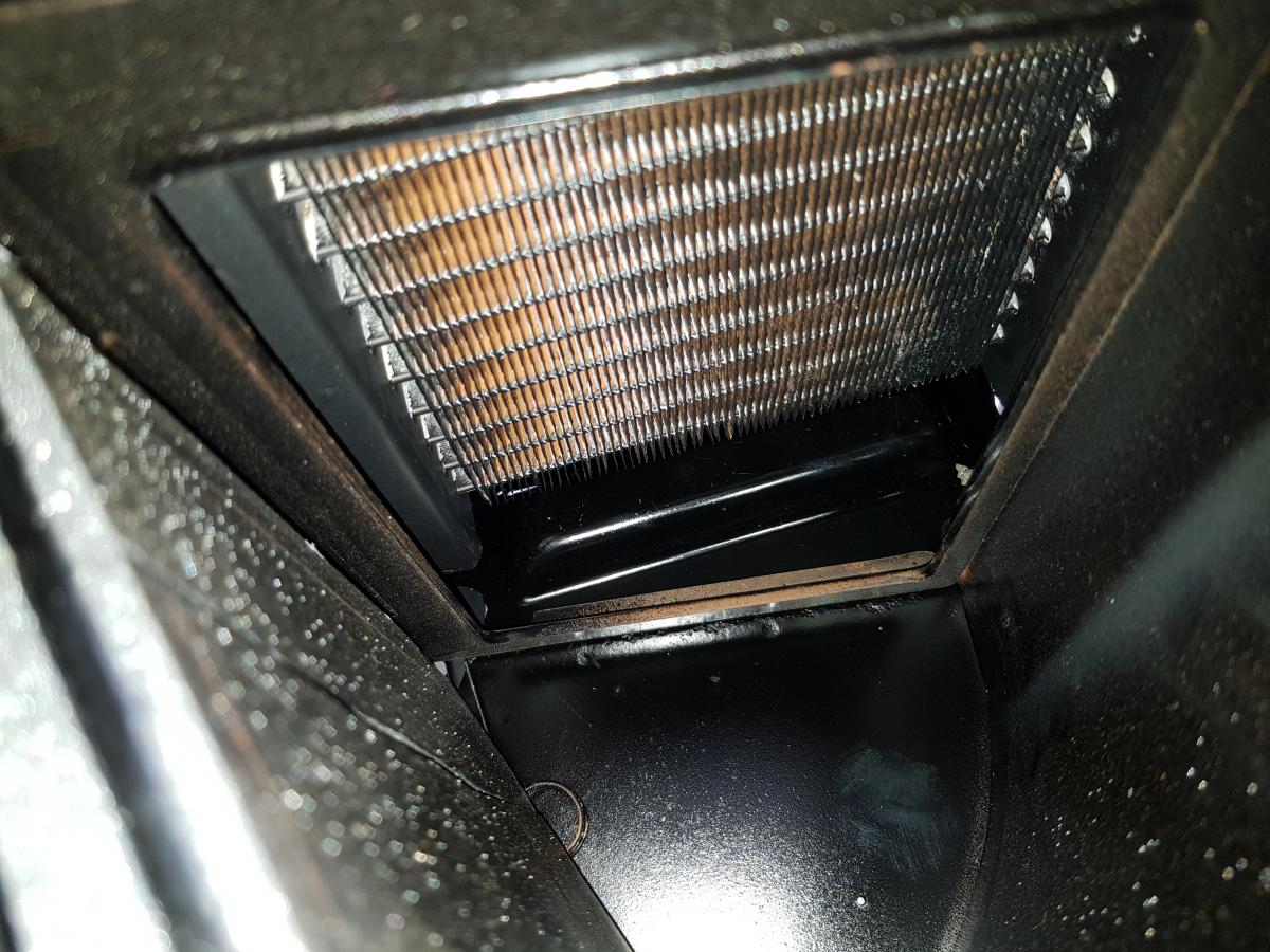

JDM-TOY Posted March 27, 2018 Author Posted March 27, 2018 Hey guys just an update. Picked uo tge reconditioned heater box with a brand new core. Had it fully sand blasted, painted, taps replaced and core replaced. Not bad for $450, just need to source some new heater hoses gav240z 1 Quote
AndBir Posted March 27, 2018 Posted March 27, 2018 ....., just need to source some new heater hoses Not sure if you're after the short internal ones or maybe these from Warren : https://www.ebay.com.au/itm/Datsun-240z-260Z-Inlet-Outlet-Heater-Hoses-Selling-As-A-Pair/332597248696?hash=item4d705742b8:g:Rp0AAOSwsFVatto4 Quote
