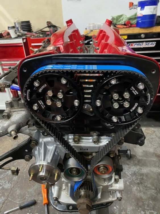

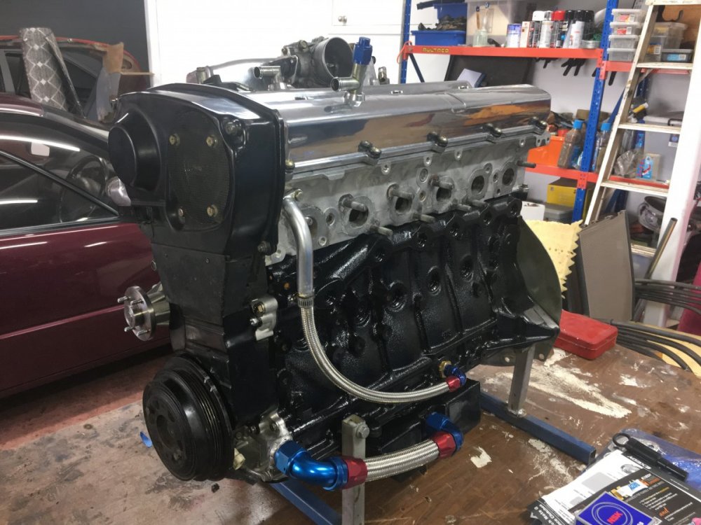

JDM-TOY Posted March 4, 2020 Author Posted March 4, 2020 Hey guys Been a while since my last update. Had to wait a while to have work done on the RB26 engine. Replaced the standard oil pump with a Nitto High Flow pump due to the power upgrade. I really didn't want to starve the engine from oil so we put in a head drain and connected it to the sump. New timing belt, water pump rear main seal, new metal intake and manifold gaskets. New twin plate clutch to hopefully sustaine the high HP. Eneine should be in soon, will put up pictures as it progresses. Yada Yada Yada gav240z and jeff43 2 Quote

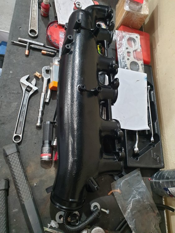

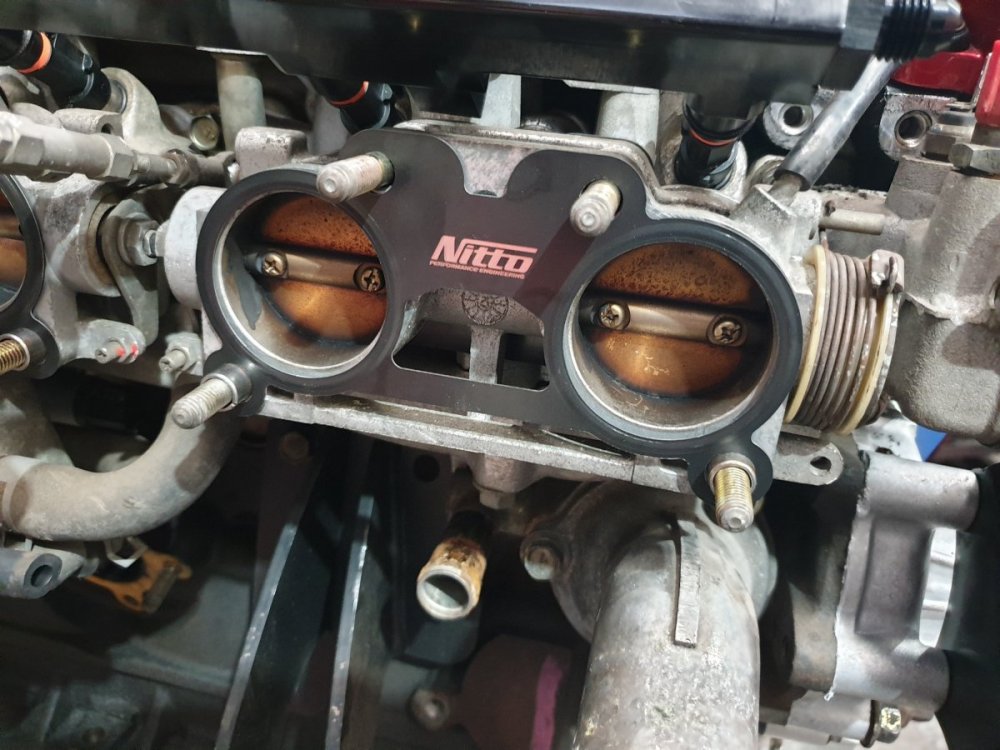

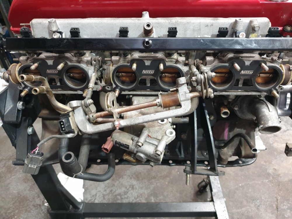

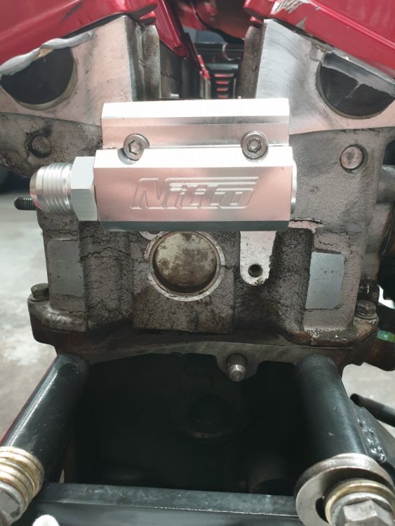

JDM-TOY Posted March 9, 2020 Author Posted March 9, 2020 Hey guys Just some pictures of the Nitto gaskets for the intake side and Nitto oil head drain. Also had the factory intake powder coated. Quote

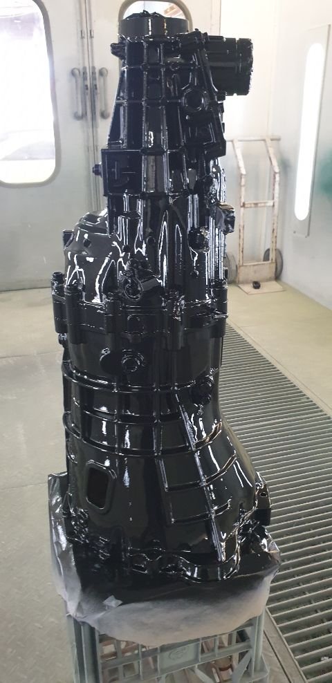

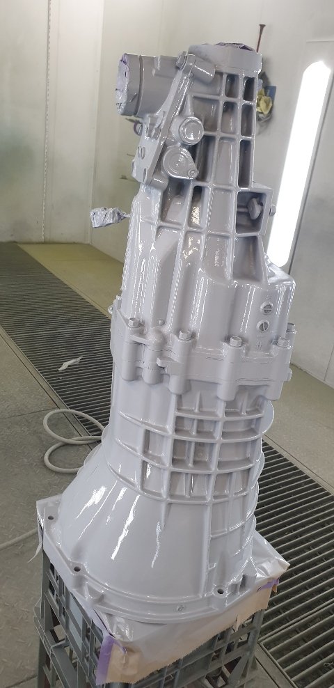

JDM-TOY Posted April 29, 2020 Author Posted April 29, 2020 Hey Guys Hope everyone is doing well Been a month or so since my last post, been quite busy work wise. Also been waiting for the running gear to get put in the car and its taking longer that I expected. Spoke to the guys next door to were my car is and they just keep putting off doing the work to m car, its a little frustrating waiting. I wish I had the tools and equipment to put it together at my place but due to having no working area or tools its just easier to get someone to do it for you. Also have paid cash for all the work that has been done and all the purchases the guys have bade just dont understand Since the running gear was sitting at the workshop I took it in and gave it a good clean and gave it a good lick of saturn black. Looks quite nice after the paint dried up just needs to go in the car now lol. So I as I wait I have been looking up different LSD options for the R200 and I'm tossing between a Kaaz two way or a OS Giken and I wanted to see what experience some of you guys have had and if there is any feedback on the two products. Thanks guys, hopefully wont be too long but an considering taking the running gear elsewhere but other than SW dont know anyone reliable Quote

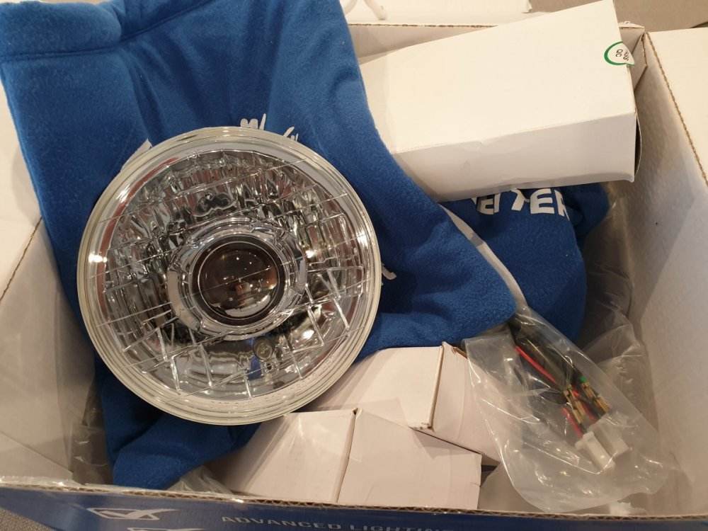

JDM-TOY Posted May 22, 2020 Author Posted May 22, 2020 So over the past few months I have been umming and Ahing over upgrading the factory headlights I decided to purchase a Dapper Lighting HID kit upgraded from the factory globe's. 1x Projector Kit Relay Harnesses (V1/V2) 1x Dapper Lighting 7" Classic V1 1x Bulb 1x Chrome Base 1x Headlamp Protection Covers I will update with install pictures once the cars getting put back together. But from what I could see Dapper make quality upgrade kits Quote

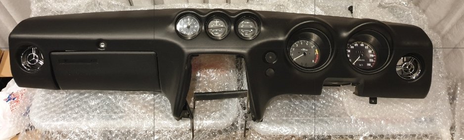

JDM-TOY Posted June 3, 2020 Author Posted June 3, 2020 (edited) Hey Lads Just a few updates I recently had sent the 240z dash to the Dashboard Dr in Melb to get a re-skin and was surprised at how honest Alan is. The dash was really faded and it had some deep scratches and some of the skin had been damaged but nothing major. Alan called me up and said that he didn't want to re-skin the dash and that he would do a quick repair and give it a coat of paint. This guy could have charged me $600 plus and just done the quick repair. The dash arrived the other day and it looks like its been re-skined and the glovebox lid looks amazing. Very nice to know that there honest people out there. So was busy tonight trying to get the centre three gauges in and in this cold weather I broke a sweat trying to squeeze them back into place. So after some failed negotiations with the dash I decided to give my old friend Vaseline the opportunity to do his job. Not even 5 mins and the gauges had slipped in place and at this point in time I asked myself why I didn't grab that container in the first place. The worst part was the wife's look after the first failed attempt and even after the second successful attempt. A while back I had purchased new side air vent inserts and I gave the vents a good clean and inserted the new chrome inserts. Im having a issue with finding screws that screw into the rear of the dash to tighten up the vents. I was wondering if anyone know if there is a screw kit that I can use for the dash and its bits a peaces as currently there are 10 different screws that I have in a bag that was holding everything together. I have purchased a complete nut and bolt set for the car but I need a screw kit/set if there is one available Giddy Upp! Edited June 3, 2020 by JDM-TOY theremm, brent012, gav240z and 3 others 6 Quote

JDM-TOY Posted June 4, 2020 Author Posted June 4, 2020 10 hours ago, CroS13 said: But when you got it back it looks like he re skinned it anyway? So what did the repair end up costing? and how much was it to post down there and get back and who did you use for that job? Can't believe that shop is mucking you around so much aye. Rudi. Hey Rudi Yeah I was surprised at how nice the dash came up too. I thought he would have made a mistake and re-skinned it but the invoice said repair on it Shipping each way was $56 each way with insurance. I used the website Trans Direct and put the recieving addresses as a business otherwise it was calculating the costs at $130 each way. The dash re-skin cost is about $600 but he only charged me $120 Re: The mechanics and panel beater, yeah not happy about this situation. I wish I had the tools and some help and do it at home, would have been good but it is what it is and I have learnt from it for sure. Cheers Youhan Quote

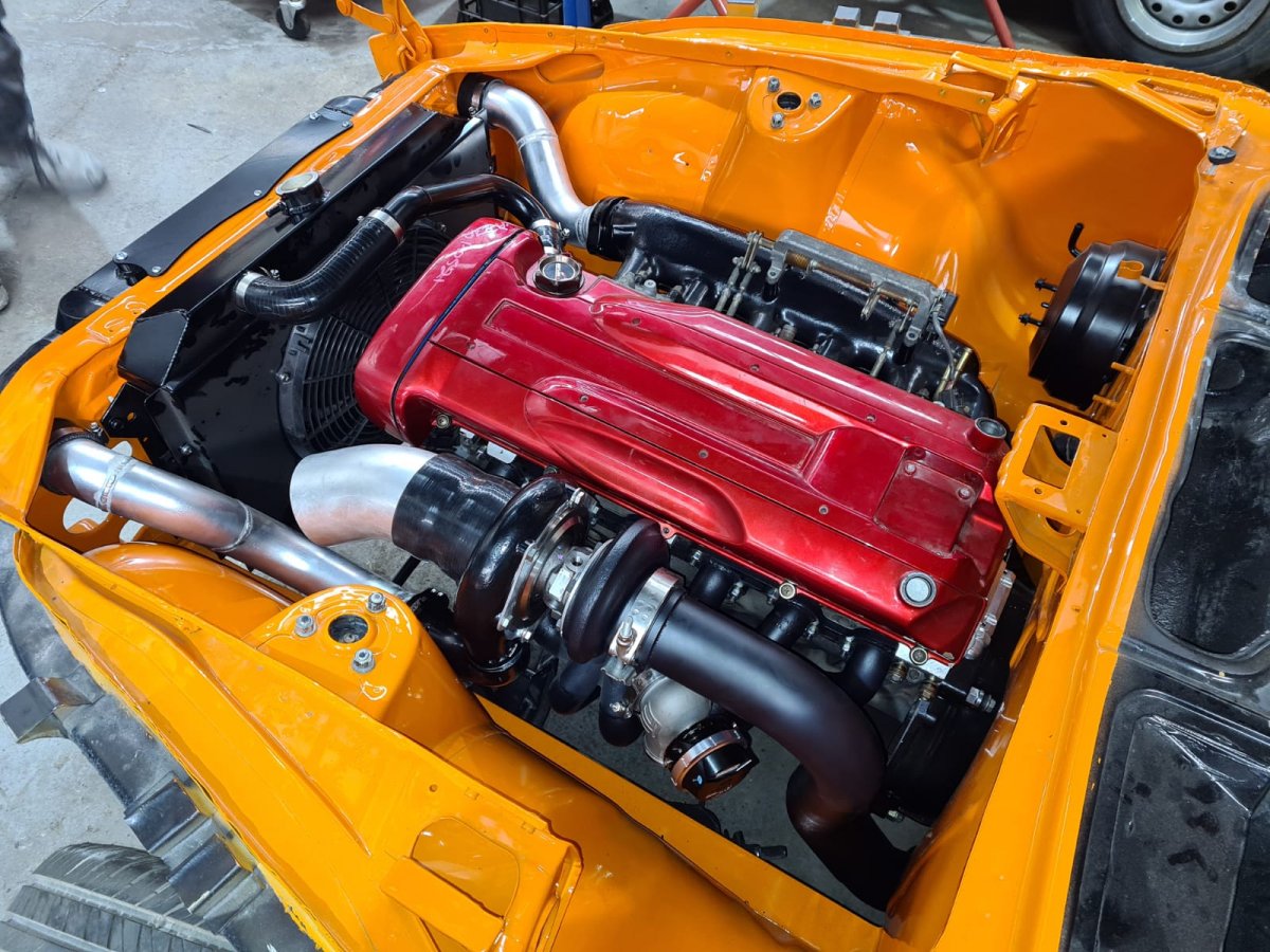

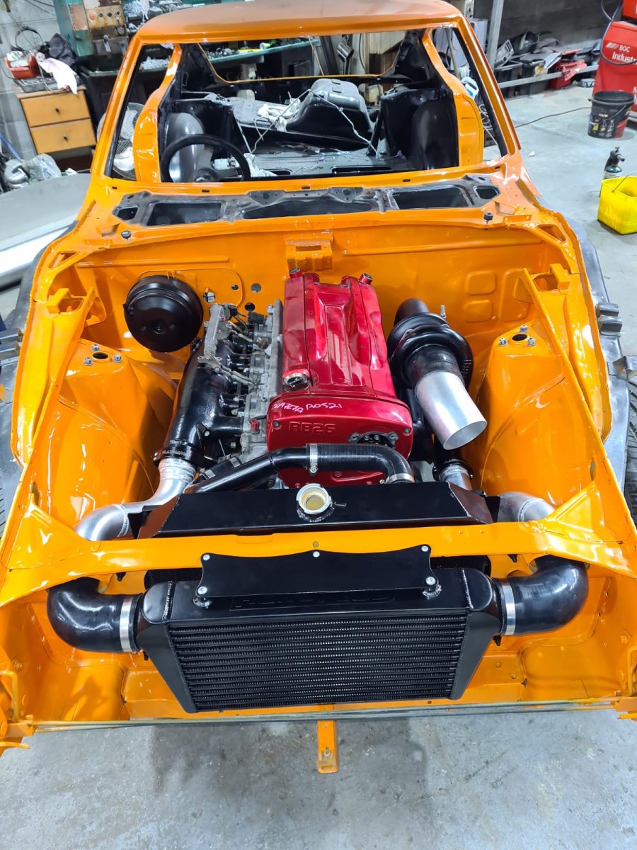

JDM-TOY Posted July 22, 2020 Author Posted July 22, 2020 (edited) Hey Guys Small update Finally 9L oil sump is done and cooler, radiator fitted. Ill put up some more pics as the come Edited July 27, 2020 by JDM-TOY ScottyD and theremm 2 Quote
JDM-TOY Posted July 23, 2020 Author Posted July 23, 2020 More pictures of it coming together KatoKid and CBR Jeff 2 Quote

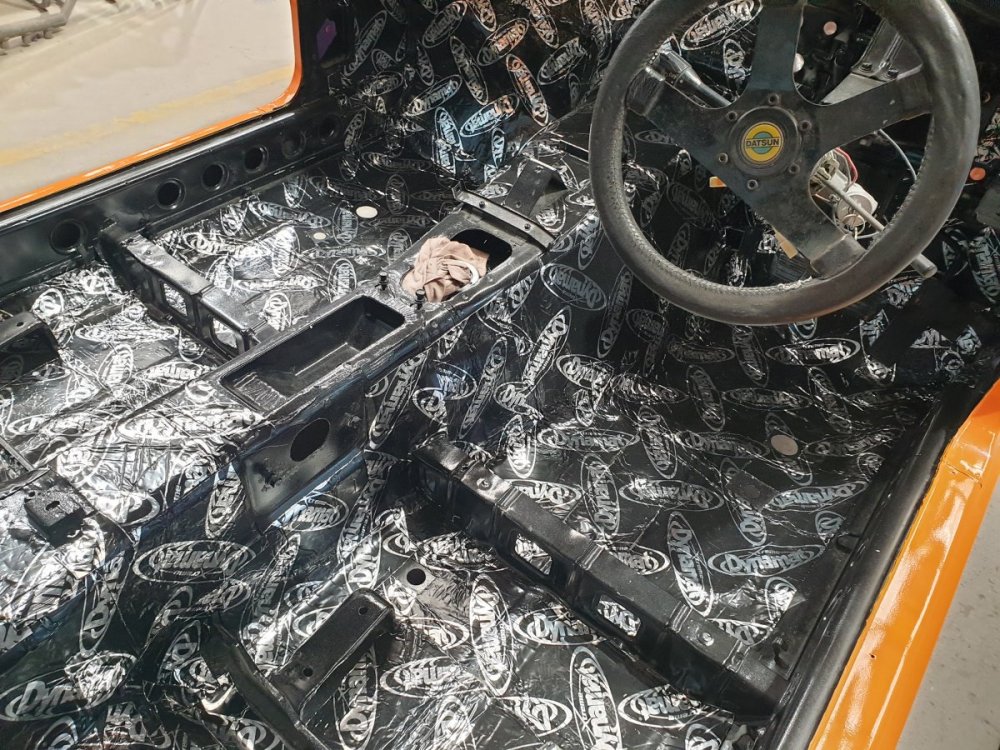

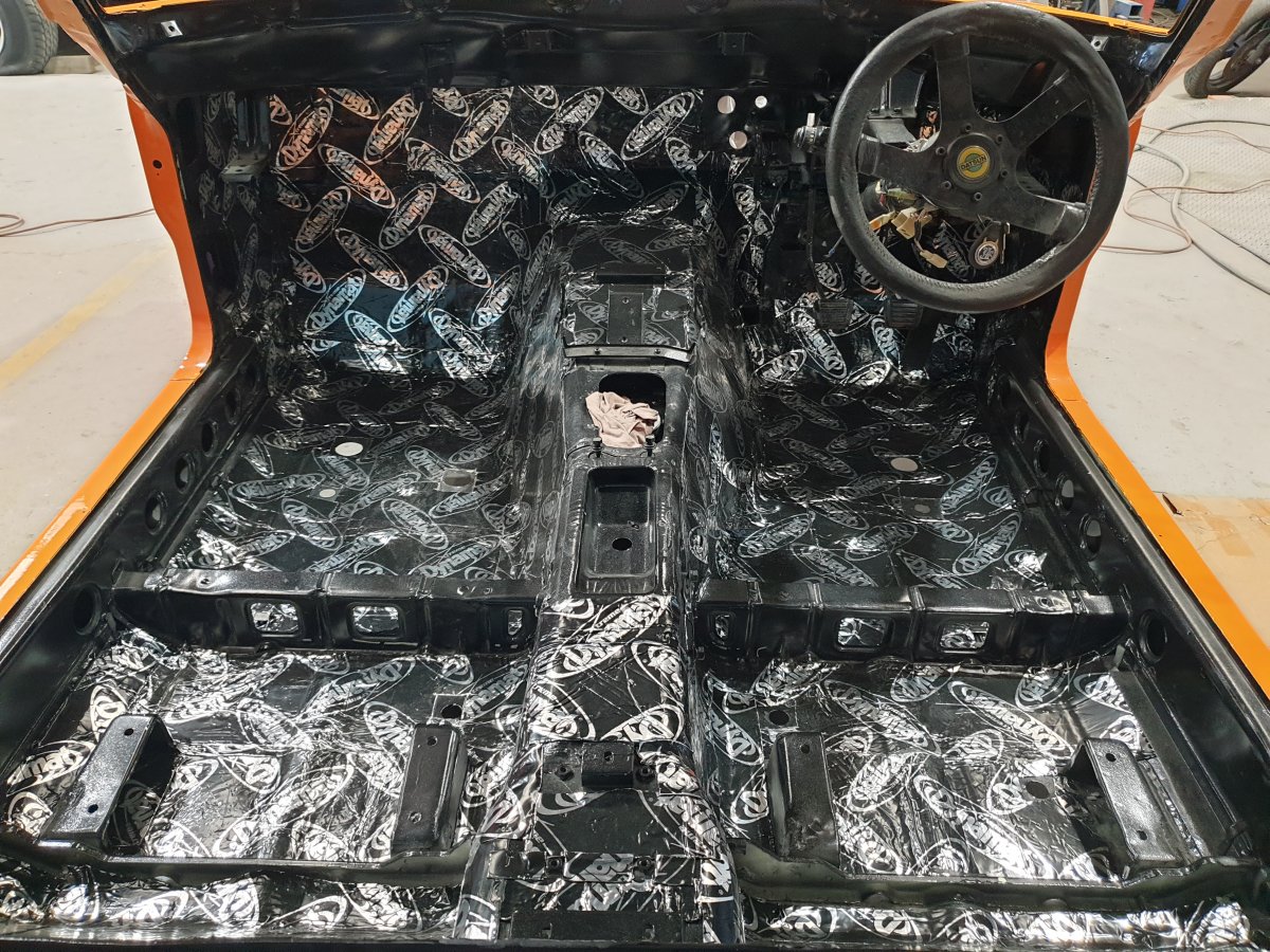

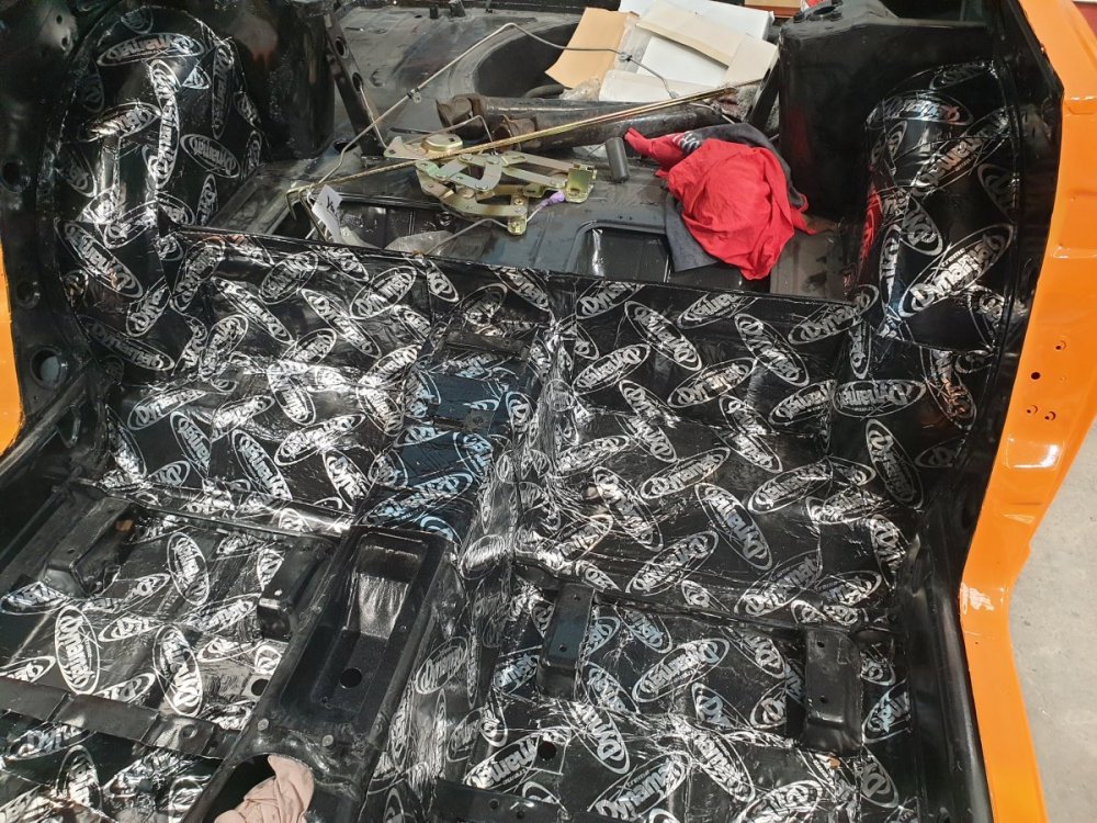

JDM-TOY Posted October 8, 2020 Author Posted October 8, 2020 Finally made some time to install the sound deadener in the 240z. One of the easiest jobs to do but time consuming and annoying being on your knees most of the time. Tomorrow the panels, doors amd hatch will get painted so hopefully by Monday the car will come together. CBR Jeff 1 Quote

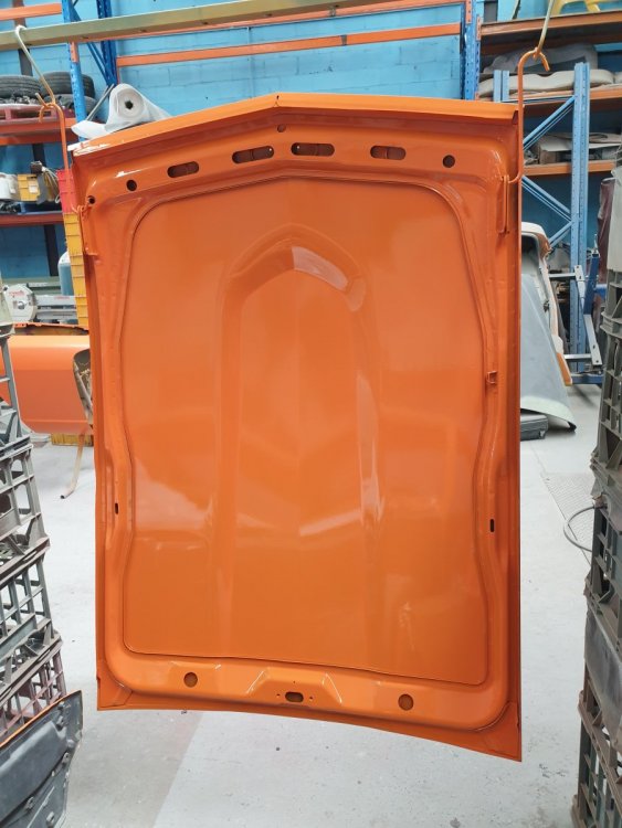

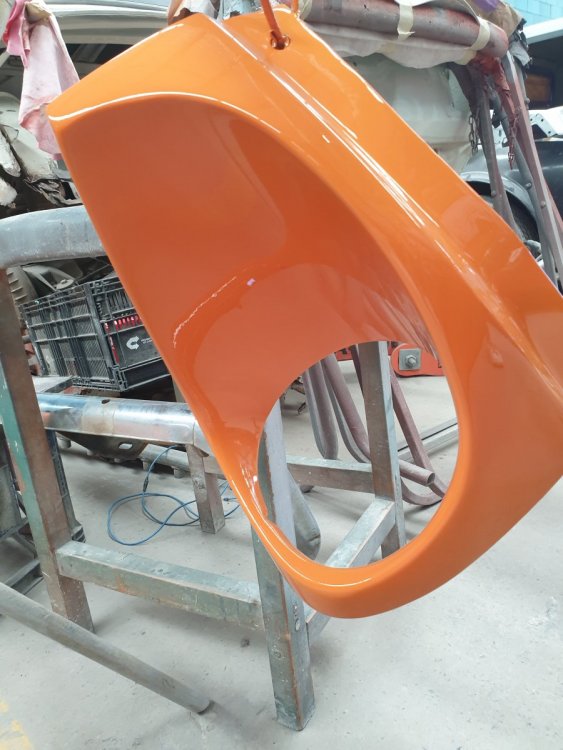

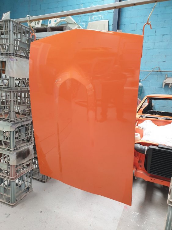

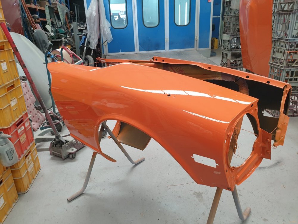

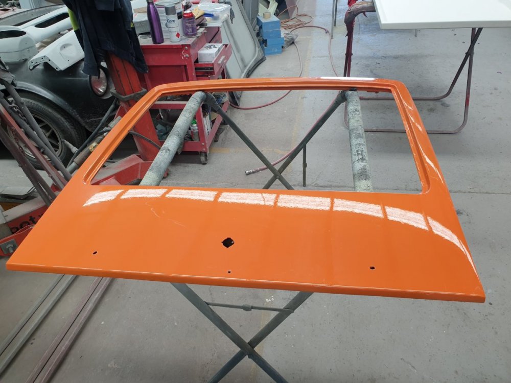

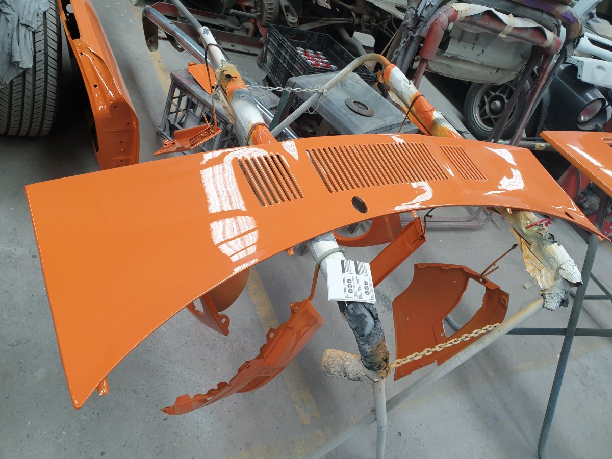

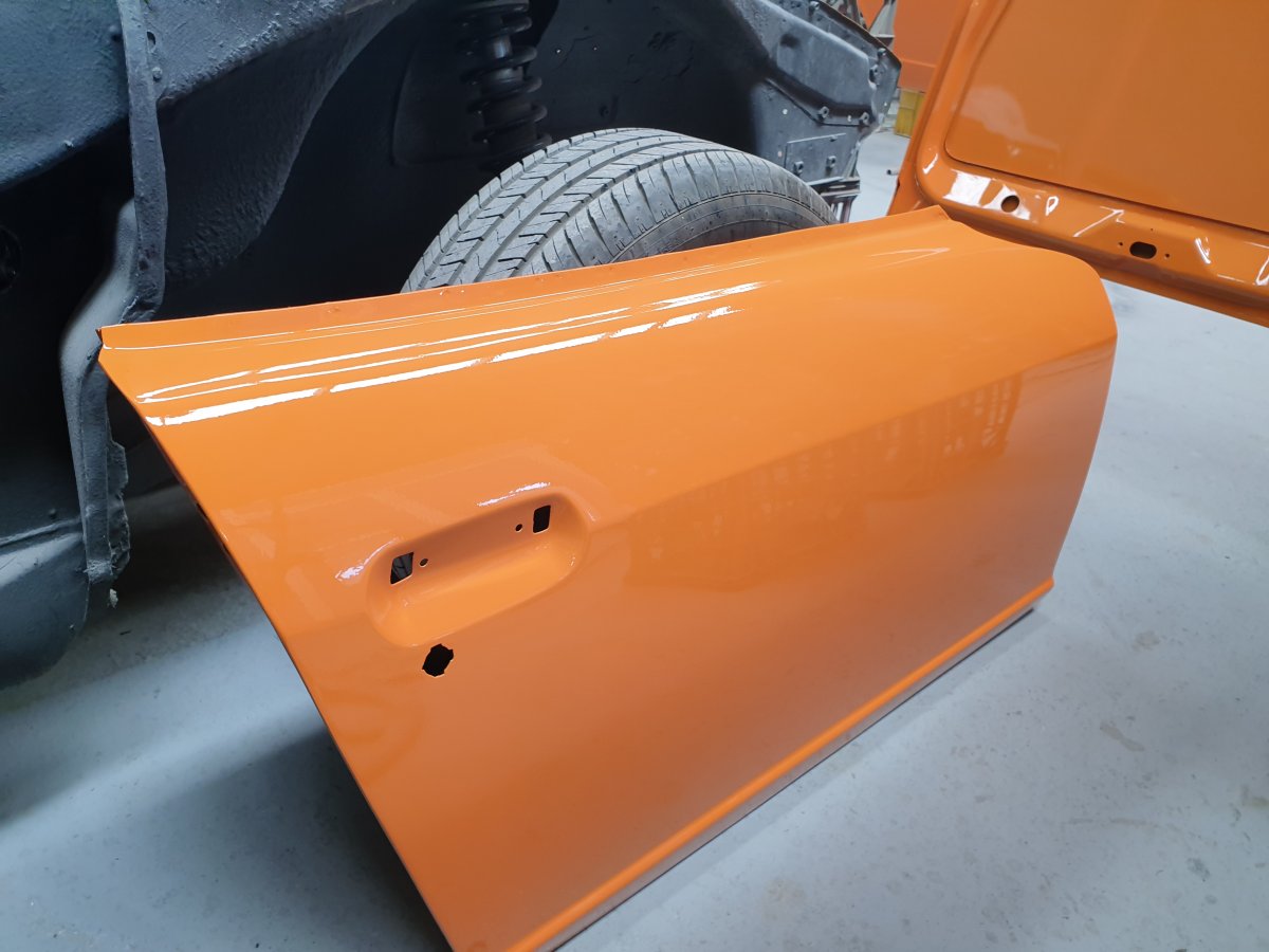

JDM-TOY Posted October 13, 2020 Author Posted October 13, 2020 Finally progress on paint work. Panels should be going on to the car tomorrow so should have more pictures to come. Giddy Up Ponyo240z, gav240z, Bruce and 3 others 6 Quote
