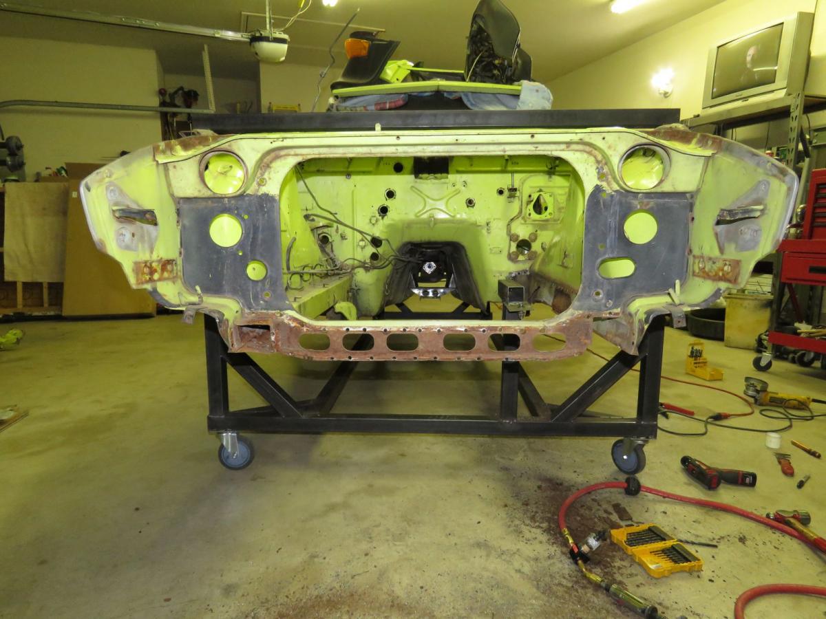

Ledge Posted November 11, 2016 Posted November 11, 2016 Epic job guys, it lives again! So many great builds on here at the moment! George or Paul, what bits were salvageable of #19's shell, was it the floors and front cut? What sort of man hours would you have in body repairs before paint? It could give people a rough idea of costs if another early chassis car comes up in the future. Also, after grafting the donor body shell onto #19 is there a jig or template to make both the old/new body line up to one another correctly? Please understand lads the panels are free sitting with rubber blocks for transport. so with the latches etc on they will be perfect. Gareth we used as much of 19 as we possibly could, entire floor front to back, except aftermarket pans under seats, just like any other Z restoration. Firewall and some of the cowl area. front inner guards. but we used aftermarket rails. Parts of the rad support. The roof rails etc were from another car. The 1/4 panels were new old stock. So to be honest there is a lot more of the actual 19 than you would have thought. Cost wise, well every car is different, every owners requirements are different. We have done 2 HG style Monaro's in the last few years. 1 was 30k the other is 90 and still going. I told George from the start this car was not financially viable to save. He was adamant that it was worth it. So it has cost substantially more than a normal rusty Z as you could imagine. We have a chassis jig for the Z yes. we have since put another early car on it and it lines up well within factory tolerances. George will be getting a visit in the next few weeks. I'm sure he is as excited to see it as I am to get it to him. Has been an epic restoration to this point and someone has a lot of work to do. Cheers Lads Ponyo240z 1 Quote

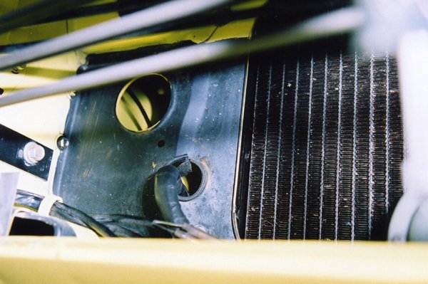

Administrators gav240z Posted November 11, 2016 Administrators Posted November 11, 2016 Stunning work, and great commitment to restore this car. Originally was the radiator support panel matt/satin black and the plenum chamber gloss grey? Nick The front of the radiator support was hand brush painted satin black so colour didn't bleed out through the front of the engine bay and past the grille. But it was only ever painted up sort of half way. Not the best photo (but I can find a better 1 if you want? Actually here it is: http://www.classiczcars.com/topic/42150-what-color-did-datsun-paint-the-front-of-the-radiator-support/?do=findComment&comment=379433 Not sure what you mean by plenum? Quote
CBR Jeff Posted November 11, 2016 Posted November 11, 2016 Plenum chamber is the section under the cowl at the bottom of the windscreens. The plenum was a light grey I think. Jeff Quote

NickF Posted November 12, 2016 Posted November 12, 2016 Thanks Gav/Jeff So those were the only areas not in body colour. Nick Quote

George Posted November 14, 2016 Author Posted November 14, 2016 (edited) Can anyone confirm if this is the correct paint pattern for the radiator support panel? Edited November 14, 2016 by George gav240z 1 Quote
Administrators gav240z Posted November 14, 2016 Administrators Posted November 14, 2016 Yes that's what I've seen on multiple S30Z's. Groundhog 1 Quote
NickF Posted November 14, 2016 Posted November 14, 2016 Thats ok, plus the bit thats missing also the torsion bars are black Nick Quote
