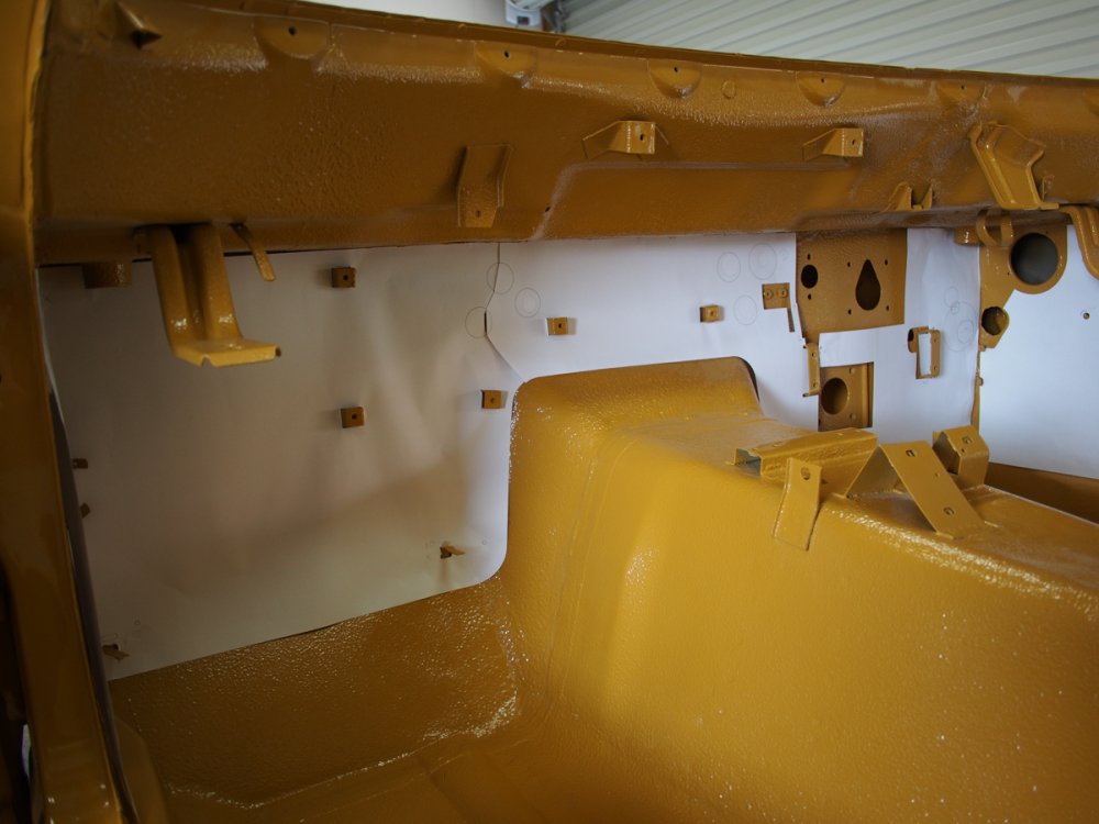

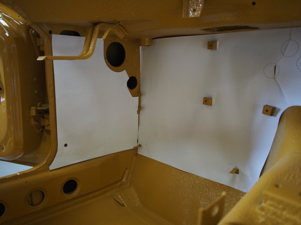

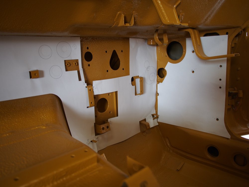

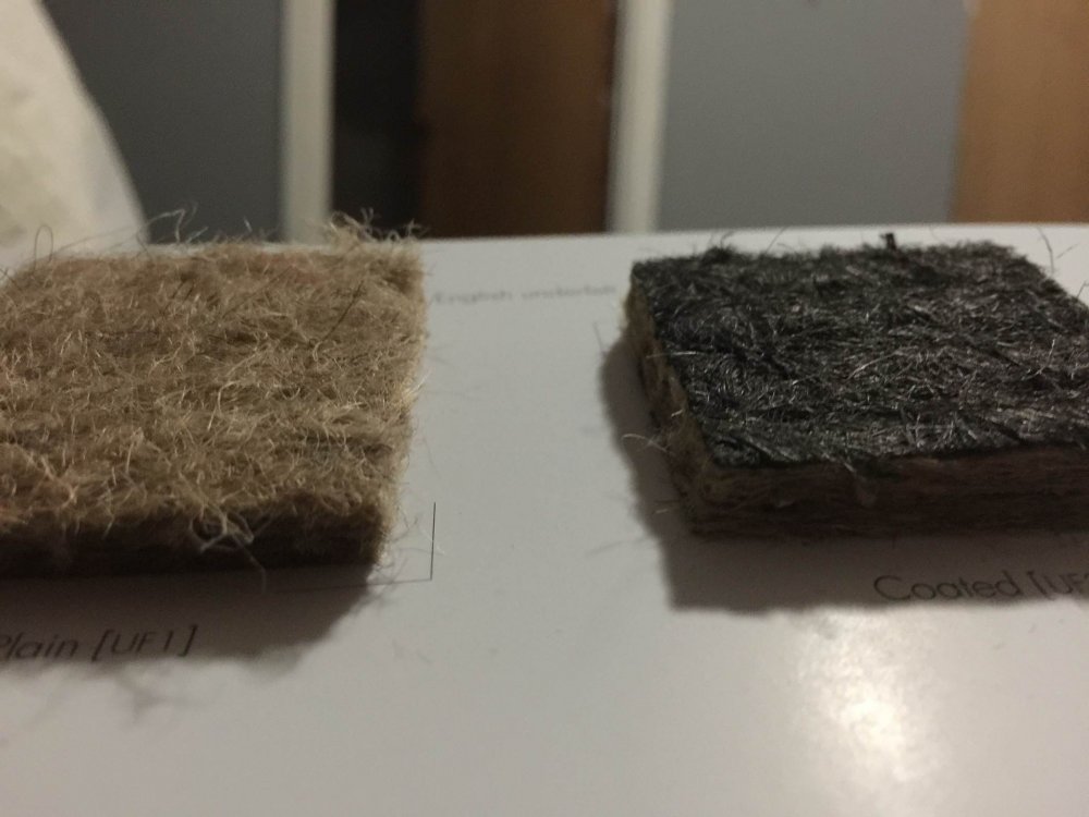

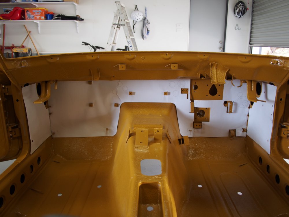

George Posted December 4, 2016 Author Posted December 4, 2016 These templates are the work of a forum member. They are a work in progess, although very accurate thus far, and it's up to him as to when, if and how they are released. There are tunnel templates as well. I'm almost done with the trial fit and will post up details another day. They look great as well. I'm having some trouble finding a suitable material to use for the firewall. If anyone knows of something ideal that looks like and does the job of the original firewall insulation please let me know. I only need the black boardlike material to which I'll be attaching the jute insulation. lightmaster240z, gav240z and mspecr 3 Quote
KatoKid Posted December 4, 2016 Posted December 4, 2016 Hey George. I've got the original board with jute backing that's in pretty decent shape and includes the tunnel. As recognition to the effort and commitment you have put into this they are yours for free if you want to pay freight. David George 1 Quote
George Posted December 4, 2016 Author Posted December 4, 2016 That's too kind of you David. Many thanks. You've kind of ruined my little detective adventure... but I'm sure there will be many more part-hunting-adventures to come! I'll send you a pm. Quote

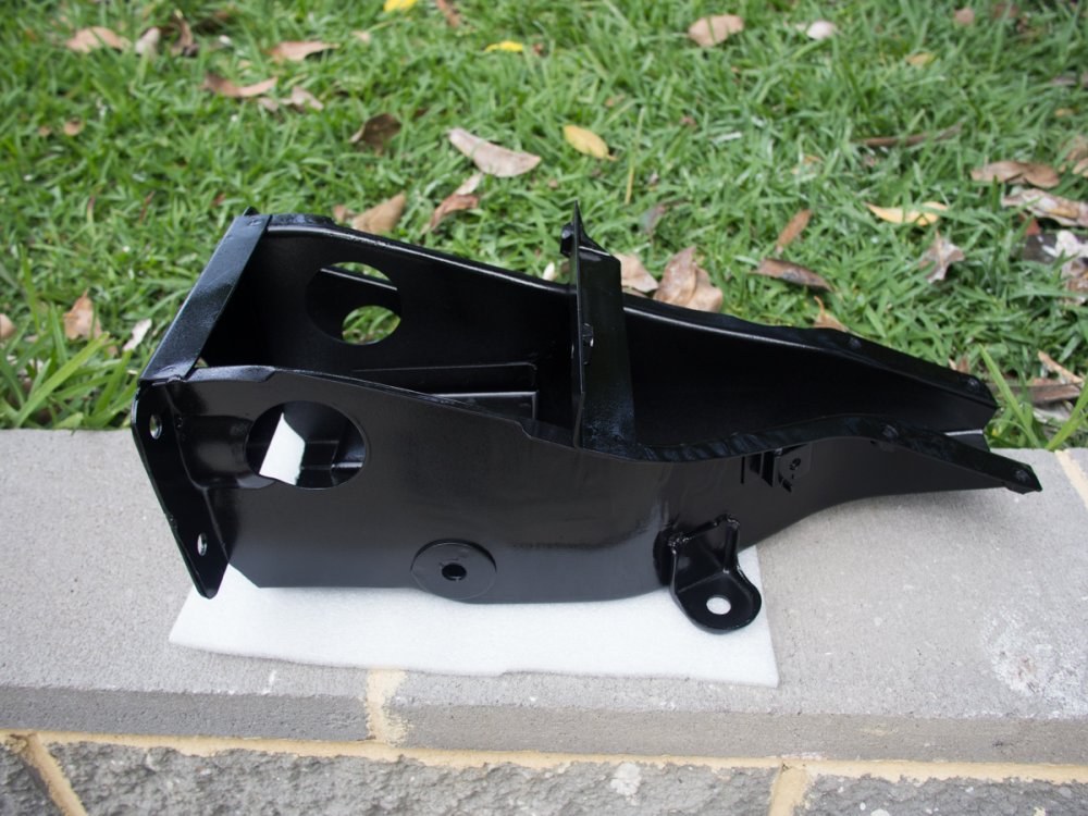

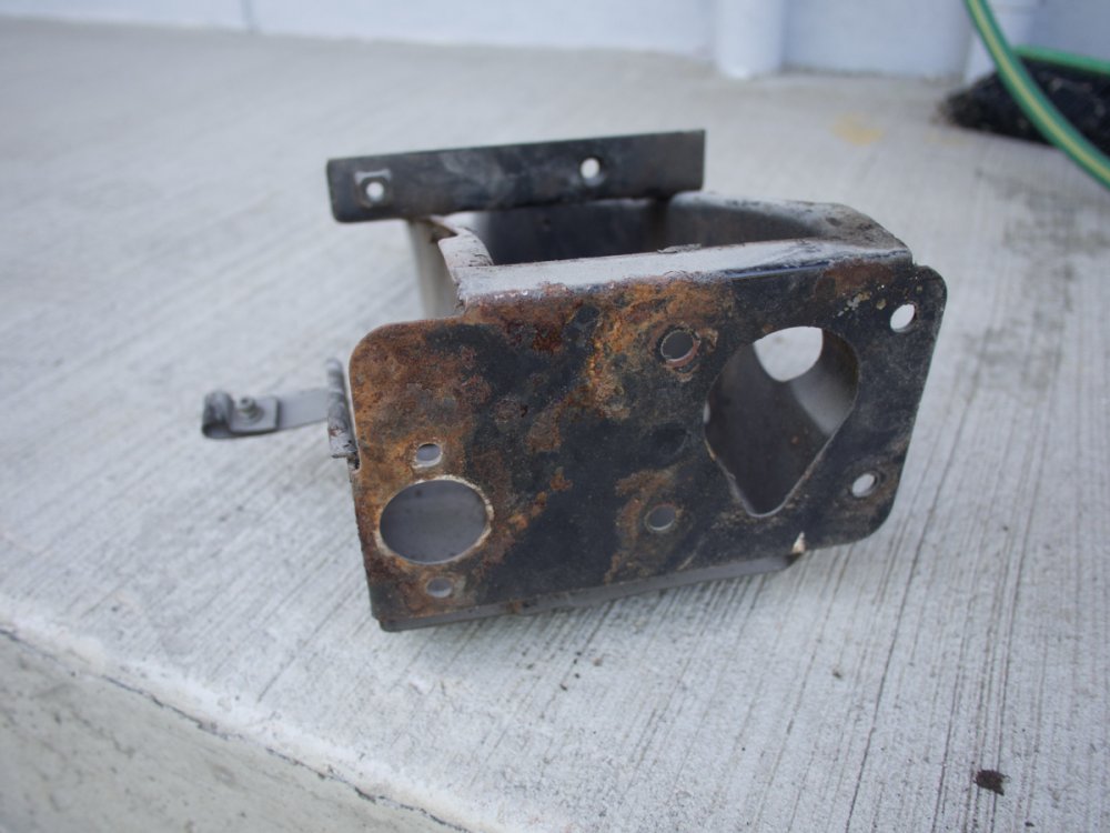

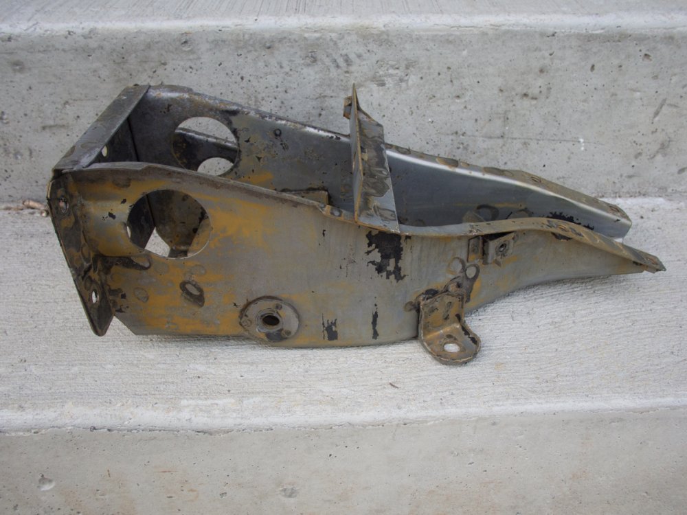

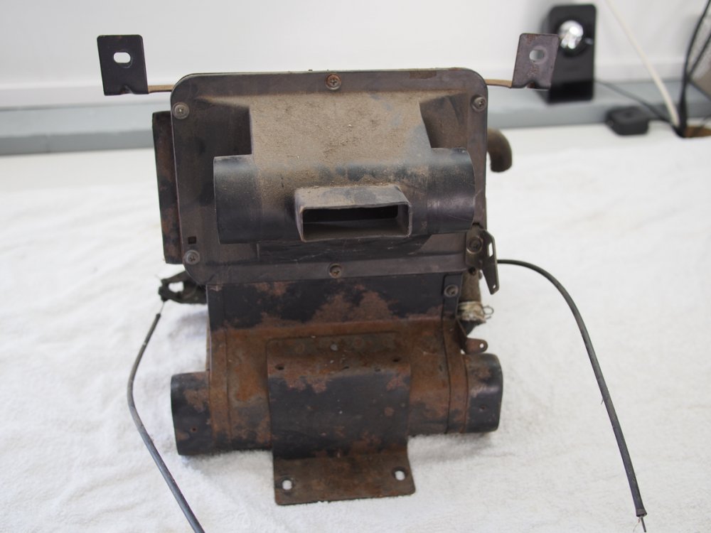

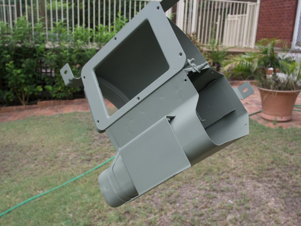

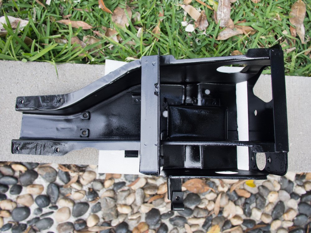

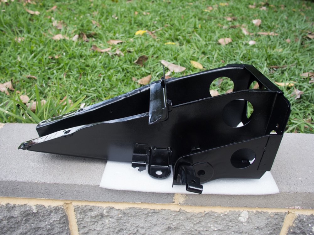

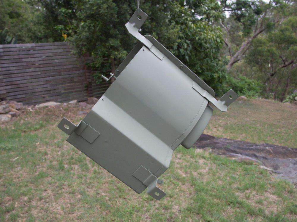

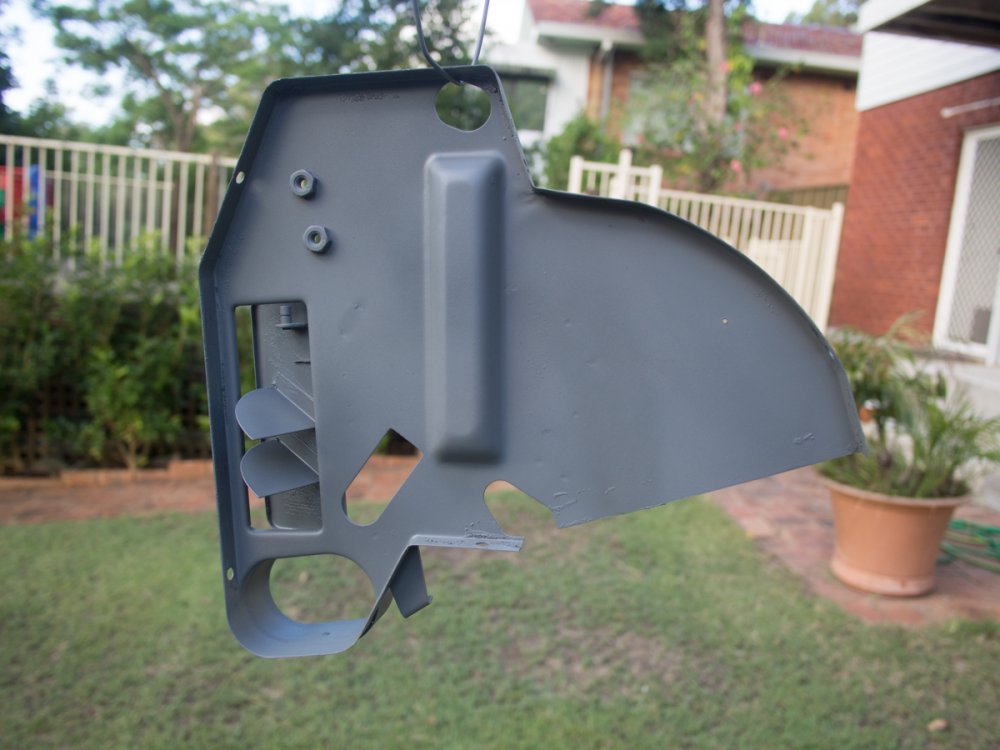

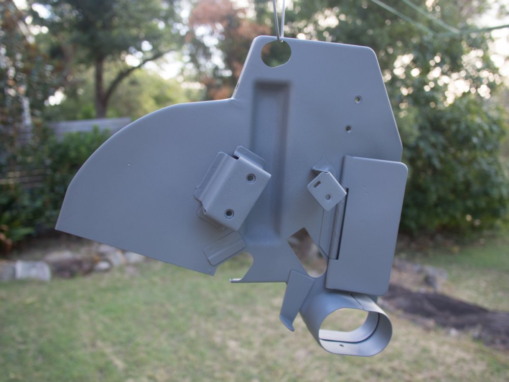

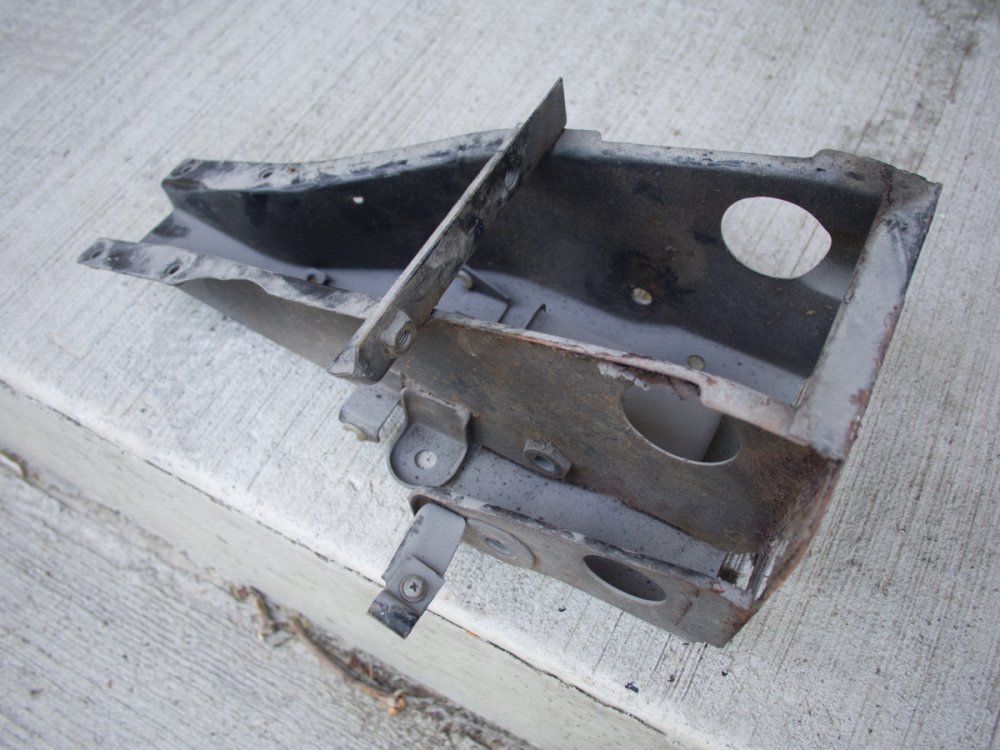

Administrators gav240z Posted June 23, 2017 Administrators Posted June 23, 2017 Hey George did you paint the heater box and pedal box using spray paint? I feel like KBS rust seal is a good product and you may be able to sponge it on? It dries very hard too, so it's scratch resistant, to be honest though I'd probably take it to a powder coaters and have it done that way myself. Quote
George Posted June 23, 2017 Author Posted June 23, 2017 (edited) Thanks all. Rudi, can't believe you still have those photos! Seems like a lifetime ago. And, where are the dozen or so previous chapters? Paul gave me hundreds of photos of twisted metal porn. He's one sick puppy that Paul. One day, or few days, I'll have to go through them and document that side of things. Hey George did you paint the heater box and pedal box using spray paint? I feel like KBS rust seal is a good product and you may be able to sponge it on? It dries very hard too, so it's scratch resistant, to be honest though I'd probably take it to a powder coaters and have it done that way myself.I used epoxy enamel gloss paint and I'll be sticking with the same throughout. I had considered powder coating and although it seems very effective my preference is to stick with paint. I did try a satin paint on the pedal box but it scratched with little effort. The gloss is much tougher, especially given enough time to dry in this cold weather. Just wish I had an oven I can bake some of these parts in! I will try to bake the suspension components that take a battering. Edited June 23, 2017 by George Quote
