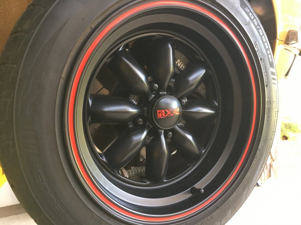

KatoKid Posted July 28, 2018 Author Posted July 28, 2018 (edited) Something that I've meaning to do for a while.....the front wheel bearing caps stand too proud for the XXR wheel centre cap to fit over the top so I got Rob from Robco to make up a Delrin spacer for me. Its a press fit bit I will glue them as well. Came up pretty well . Edited July 28, 2018 by KatoKid OdinZ, RAP260 and dat240z 3 Quote

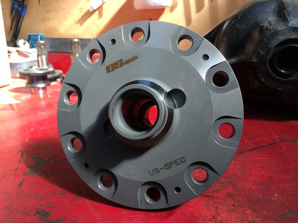

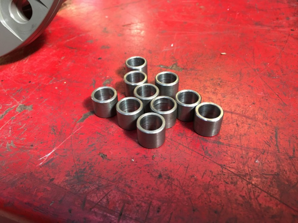

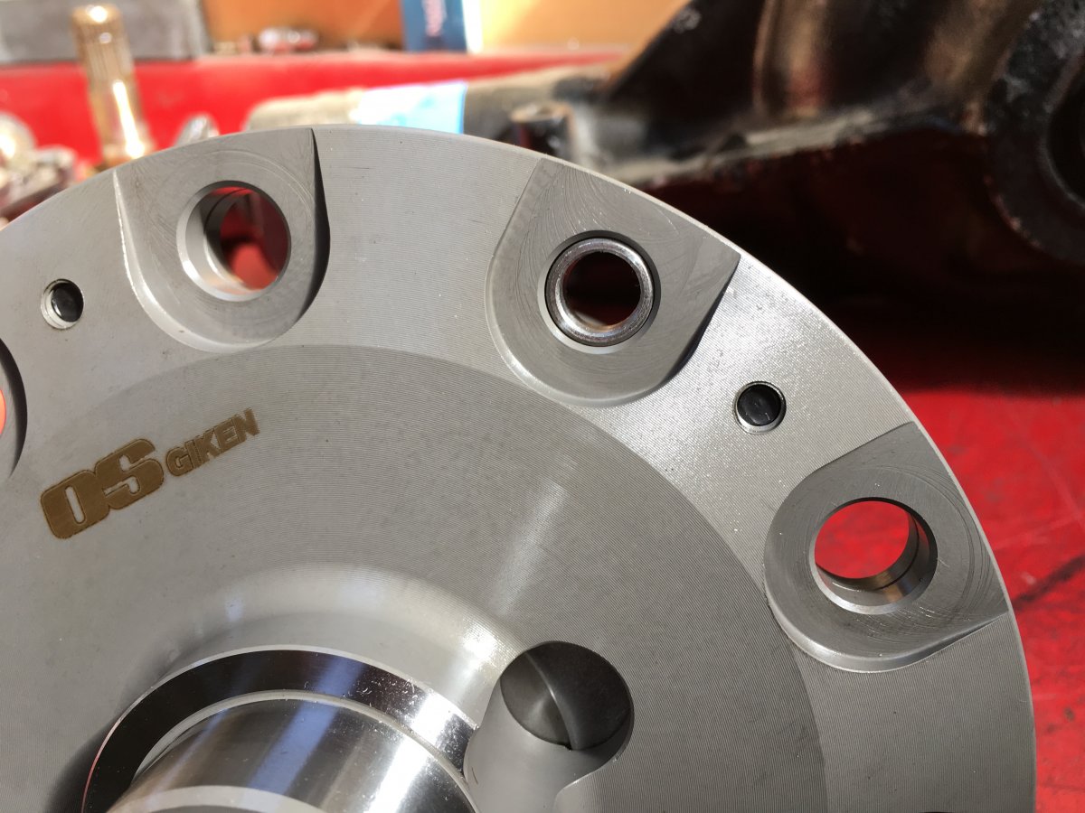

KatoKid Posted October 12, 2018 Author Posted October 12, 2018 (edited) My long awaited and badly needed LSD has arrived! I had a KAAZ 2 way in the car when first completed but it was too aggressive for a road car for me. I did some research and was close to going with a Quaife gear type LSD but read that they single wheel when suddenly unloaded and were a bit unpredictable so kept coming back to OS Giken Supalock. The OS Giken website no longer lists a Supalock for long nose R200 but a bit of interweb trawling found this: https://whiteheadperformance.com/product/os-giken-super-lock-lsd-limited-slip-differential-unit-long-nose-r200-ns046-ha-datsun-240z-260z-280z-280zx-nissan-300zx-z31/ Whitehead insisted that they do fit the long nose R200 so I took the plunge. The LSD is for the US spec S13/S14 240SX and looks like it will fit but has 13mm bores for the crown wheel bolts (not the normal larger 12mm bores of the later R200's). If you have a 12mm bolt crown wheel you need to buy the Nismo S15 crown wheel bolts that are 12mm with a 13mm shoulder....or if you have a 10mm bolt crown wheel like me you need to buy 10mm- 13mm sleeves from SW Motorsport or have some turned up. Edited October 12, 2018 by KatoKid C.A.R., dat240z and 260DET 3 Quote
Riceburner Posted October 12, 2018 Posted October 12, 2018 Fanboi #3 here, they’re great! So quiet you won’t know it’s there. Are you gonna have a go at setting it up yourself Dave? Quote
260DET Posted October 12, 2018 Posted October 12, 2018 Hmmm, anyone use one of these OS Giken LSD's for racing? 1, 1.5 or 2 way? Quote
KatoKid Posted October 13, 2018 Author Posted October 13, 2018 11 hours ago, Riceburner said: Are you gonna have a go at setting it up yourself Dave? Nah G man. I've searched everywhere for a new 3.54 ring and pinion with no luck. My diff is a bit noisy on coast so I don't want to do anything to aggravate it so will give to the "experts" to set up. OdinZ 1 Quote

KatoKid Posted November 18, 2018 Author Posted November 18, 2018 (edited) Have done a couple of 100km on the OS Giken LSD and can confirm the awesomeness. Not a sound from it and cruising around you would think it was an open diff but when you get on it, it tightens up very quickly, smoothly and predictably. Expectations exceeded. Not a cheap option but worth the pennies. Very happy to have picked up the award for best car at the Melbourne Datsun Day today. Thanks to CSA for putting on a great event and good turnout from the #viczcar gang. Edited November 18, 2018 by KatoKid CBR Jeff, Enzo, Linton and 5 others 6 2 Quote

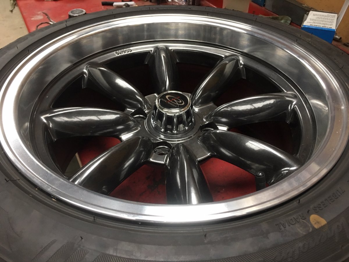

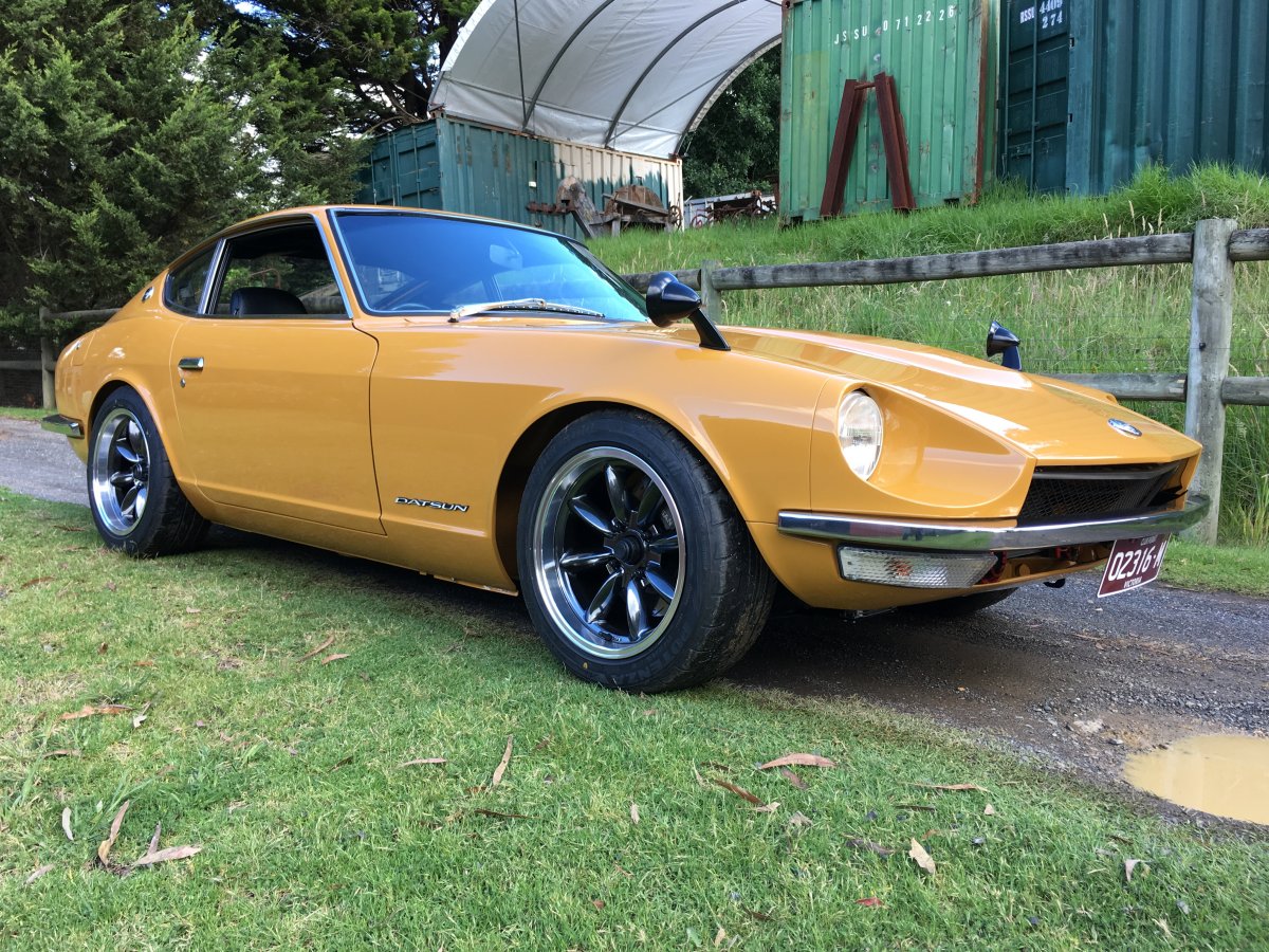

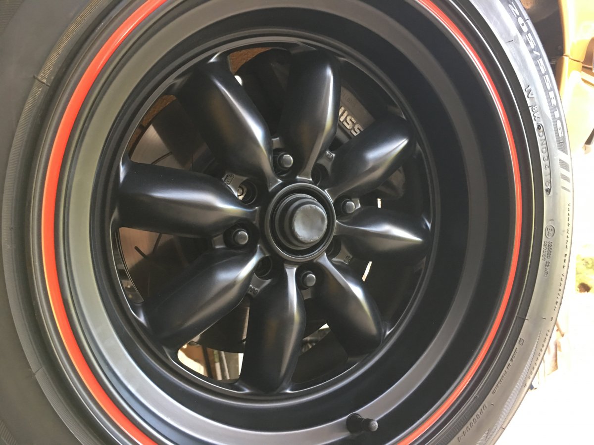

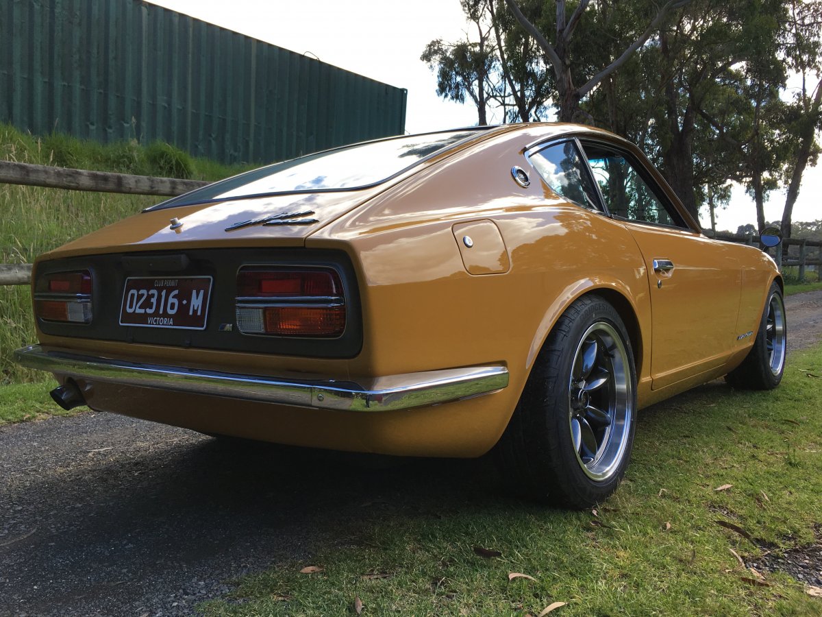

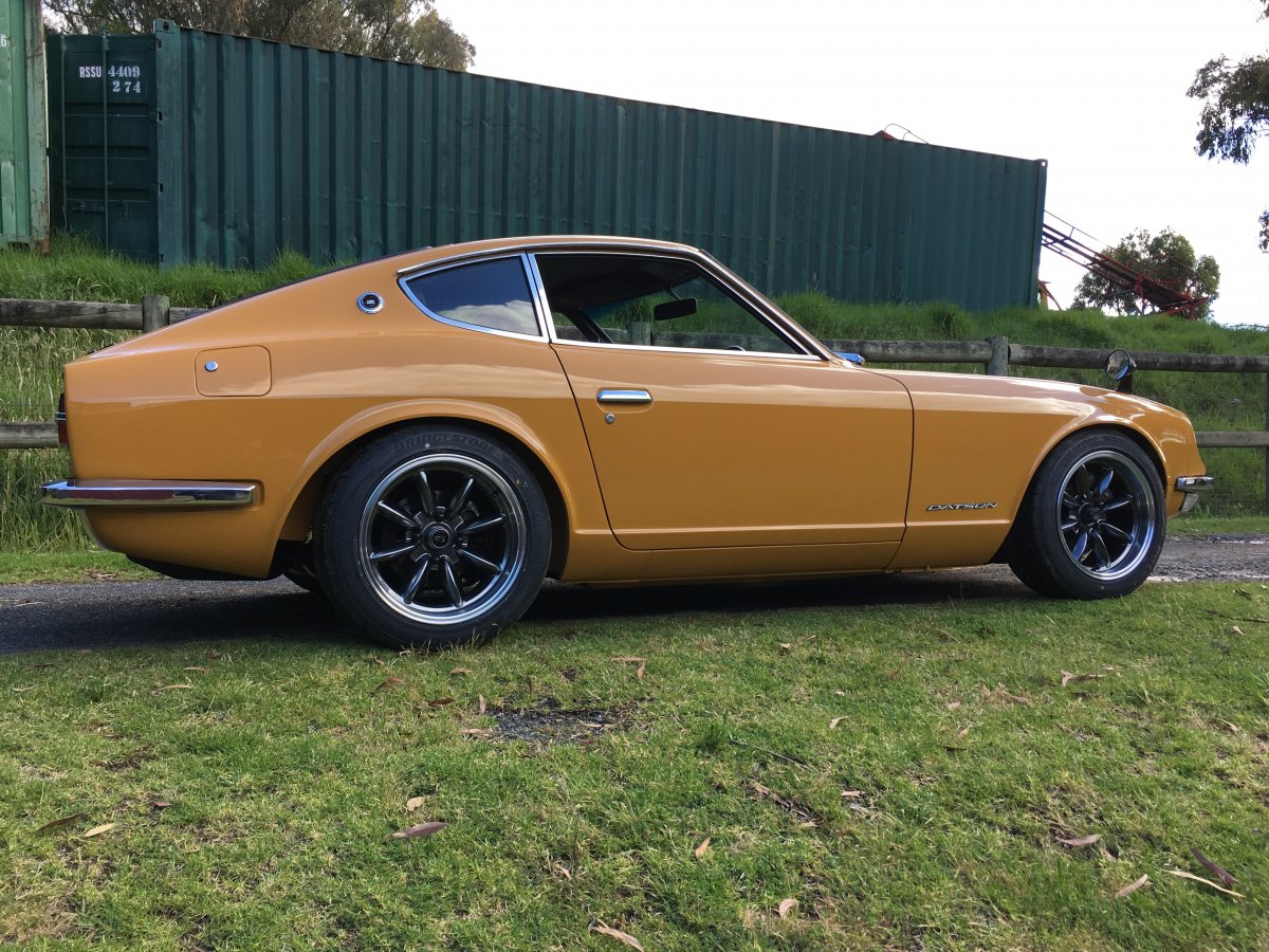

KatoKid Posted November 25, 2018 Author Posted November 25, 2018 (edited) Just to be clear, I do love all black wheels and always will......but after 12 months of trying to convince myself I've realized that they just don't work on my car. Not sure why, they just don't. So....new wheels and I'm happier now. The polished lip does the job and ties in with the chrome on the car and the hyperblack centers works with the mirrors. 16 x 8 same size as before Rota Rb - R Hyperblack. XXR's are for sale. Edited November 25, 2018 by KatoKid Enzo, GregTas, GongZ and 2 others 4 1 Quote
GongZ Posted November 25, 2018 Posted November 25, 2018 38 minutes ago, KatoKid said: Just to be clear, I do love all black wheels and always will......but after 12 months of trying to convince myself I've realized that they just don't work on my car. Not sure why, they just don't. So....new wheels and I'm happier now. The polished lip does the job and ties in with the chrome on the car and the hyperblack centers works with the mirrors. I agree - they look great - they make your magnificent car look even more magnificenter! Quote
theremm Posted November 25, 2018 Posted November 25, 2018 Nice wheels! I love black wheels but personally wasn't a fan of the red detailing around the lip. The new ones look good though Quote
Administrators gav240z Posted November 26, 2018 Administrators Posted November 26, 2018 I have to agree, the red detailing wasn't to my liking. However I also think the style of wheel is important. I just love the contrast of Safari gold and black wheels. I find this look hard to beat. Of course Topy's are probably not an option with the M3 engine, but I do like the just rolled off the show room look. Another Watanabe car/Safari Gold combo. @HS30-H Alan's Z432-R Replica with Kobe Seiko (Wide) mags. We should all be so lucky! It really does look fantastic. I think the Z432-R's should have been this colour instead of 918 personally. Quote
KatoKid Posted November 26, 2018 Author Posted November 26, 2018 Thanks all. I agree Gav, the contrast of Safari gold and black wheels is great but I am happy with the new wheels for sure. David GregTas and gav240z 2 Quote

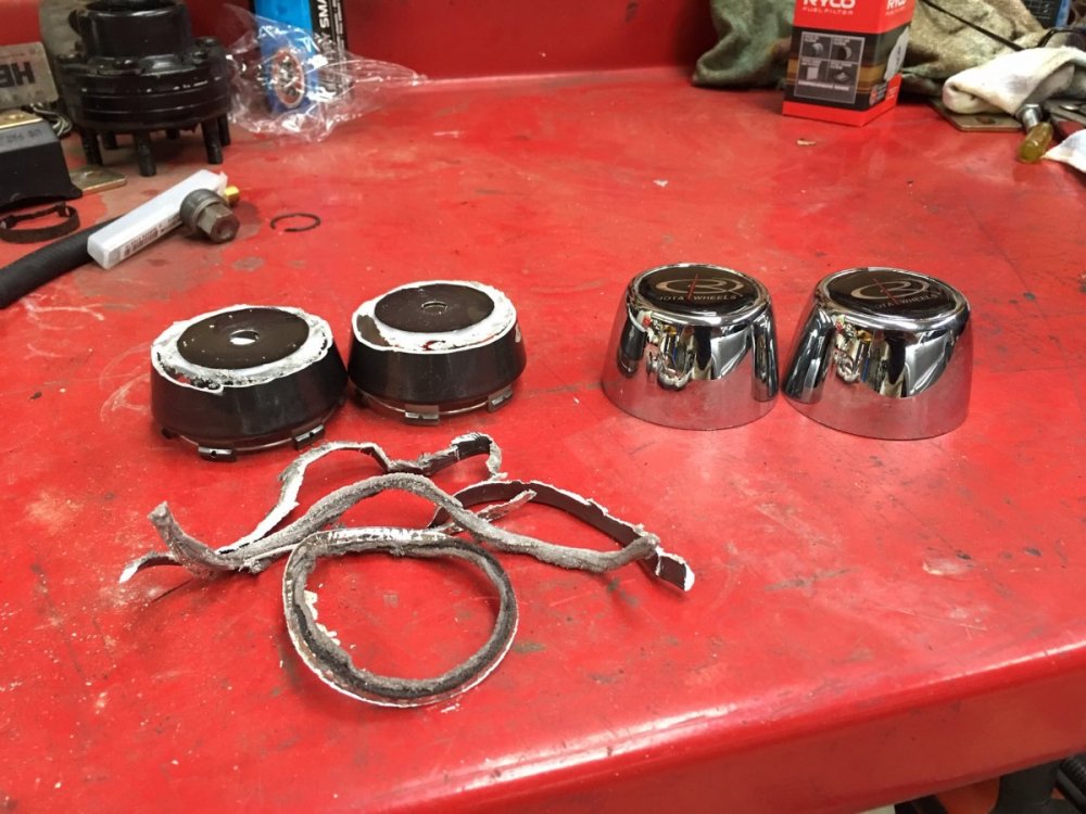

KatoKid Posted March 30, 2019 Author Posted March 30, 2019 So, shitty day meant quality time in the shed..... Same as the original XXR wheels the standard centre caps on the Rota's don't fit over the front wheel bearing caps. I sourced some generic "Speedy Wheel" centre caps there were a kind close fit and then cut them down to fit and have glued them on with urethane sealant. By pure luck the Rota emblem was exactly the same size as the recess in the new caps but meant hacking with the grinder to remove the lip on the original Rota caps so I could get a knife edge blade under the Rota emblem and remove them without damaging. Came up pretty well. C.A.R., OdinZ and Hardman 3 Quote
