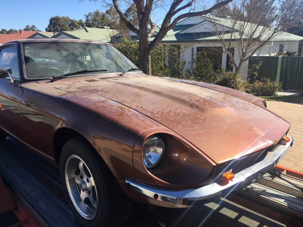

Wags Posted October 19, 2018 Posted October 19, 2018 (edited) Here is my project journal for the restoration of my 73 Datsun 240z. The car was bought by my dad in 1974. The original owner bought it only to find out that his partner was pregnant with his first child. Needless to say, the 2 seater had to go. My dad was the lucky new owner and bought it with less than 1000miles on the clock. My dad and his 240z were inseparable. So much so, that my brothers and sister more or less grew up in that car. He loved that car from the first time he drove it and he still talks about it. It was his pride and joy and almost became a friend he could journey with and rely on. As time went by though, it got a bit sad as family and life got in the way. It slowly became a bit unreliable and it was stored. However, when I was 16 the car had a very light fix up (to a mechanically drivable state) and a new coat of paint applied to the outside (external only) and it was re-registered. I drove the car for 10 years. I learned to love and rely on the z the same way that my dad did. It became a friend and companion who it just loved having around and going on adventures with. It taught me how to drive...I swear it has a soul. This went on for quite some time until I moved to Canberra and the Canberra winters got the best of it and it was retired into a garage...until now. So after much research and deliberation, I put myself on the waiting list for Classic Auto Fabrications. I wanted Locky Fowler to do this project. I spoke to many people but I just wasn’t convinced that they were right for this job. I had always dreamt of doing the z up and so I wanted the right person with the credibility and the passion to do the job and do the job well. I didn’t want to simply apply makeup to a pig. So here we are, the car is now down with Locky and the restoration has begun. As a side note, so far, Locky has been fantastic. The guy is pedantic and fastidious and he doesn’t miss a trick. I have no regrets about having him at the helm of the project and les Collins racing rebuilding the engine, gearbox and diff. This is one mean team I’ve got on this job. So I hope my pride and joy, that means so much to me and my dad, brings you all joy as you follow this journey with us. i have named the car ‘darby’ in honour of him. I owe him so much. Be safe, thank you, Jon Edited October 30, 2018 by Wags theremm, dat240z, RAP260 and 2 others 5 Quote

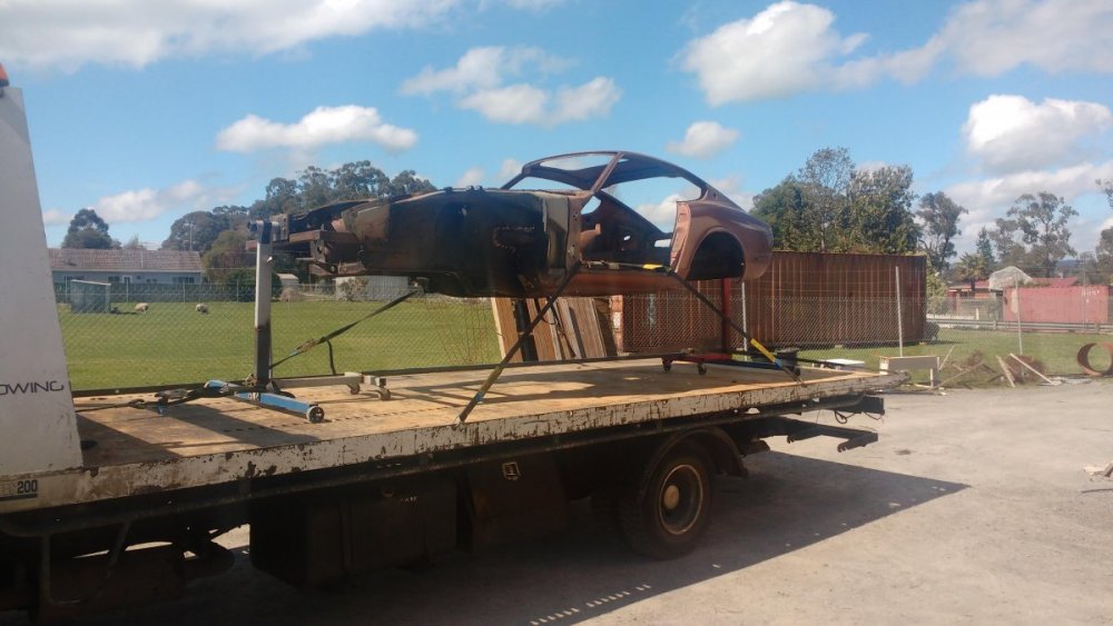

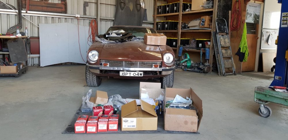

Wags Posted October 19, 2018 Author Posted October 19, 2018 (edited) And it begins...car bound for Locky Fowler at CAF with the cabin stuffed full of parts for a brand new interior and other parts. Edited October 20, 2018 by Wags gav240z 1 Quote

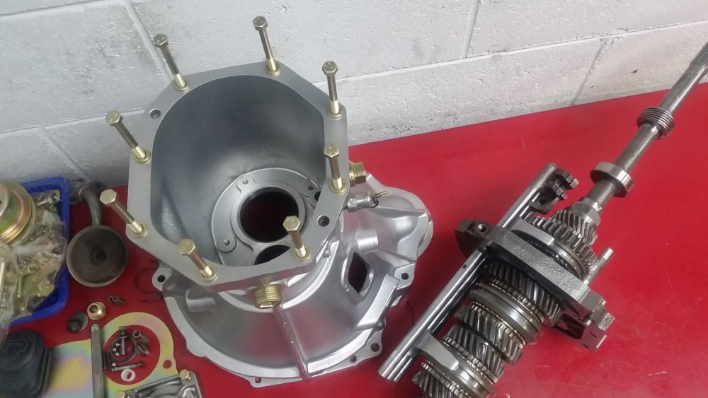

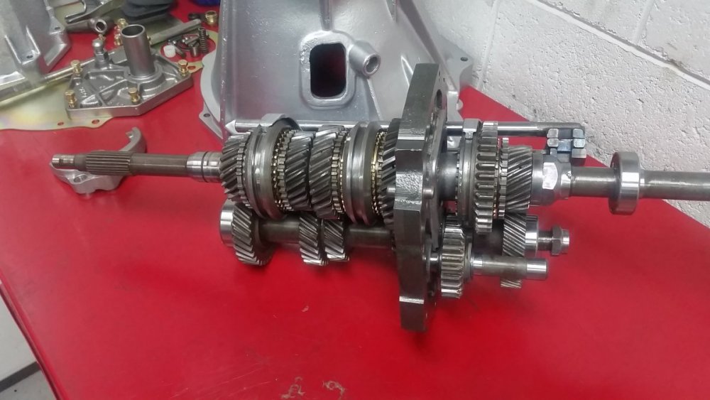

Wags Posted October 28, 2018 Author Posted October 28, 2018 (edited) Gday Jeff, thanks for the kind introduction. And yes, it would be rude not to go for a cruise and a cleansing ale one day soon...Pencil me in for that! Yep Locky and Les seem like a great team. I had to wait for a spot to come available for quite a while to get my z in with Locky (which to me is a great sign of quality workmanship and a business in demand) and I couldn’t be happier with the work so far. Below are some pics from Les of my gearbox: At this stage les is doing the following: (and this will be it...no more mods or my budget will blow out) short throw conversion on the box performance cam triple webers itg 3 in 1 for the carbs custom clutch bore out the original engine to 2.8L engine compression set to run on 98 octane. And that’s about it. my Koni yellows have arrived as have my new chrome bumpers, and a new hood is on the way to Locky as we speak. Thats all for now guys. jon Edited October 29, 2018 by Wags C.A.R. and CBR Jeff 2 Quote

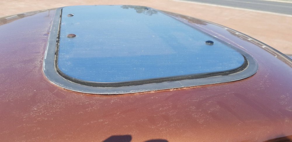

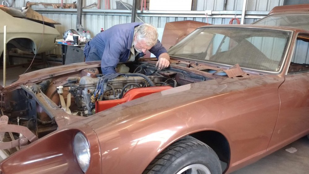

C.A.R. Posted October 29, 2018 Posted October 29, 2018 (edited) In early 2017 (I think it was) Jon got in touch with me about tackling the restoration of 'Darby Brown'. A few email's backwards and forwards between Jon and myself resulted in a specification of the build set, along with a reasonable budget - and aside from Jon being responsible for organizing the replacement parts - we were asked to deliver 'Darby Brown' as a restored 'turn key' Z. Jon's wish list was to have a near concourse 240Z with excellent paint and panel - along with deletion of the horrid sunroof - and new black interior. Upgraded suspension is a must and enough grunt under the bonnet to get him into trouble. Les Collins Racing has been tasked with the drive-train refurbishment and upgrades - more on this as the build progresses. In September DB arrived at our workshop to begin it's restoration. My overall impression when it arrived was is that it's a Z that is tired, but that it has also been well looked after. Minimal rust: both doglegs, both floors, hatch slam panel, door bottoms, guard bottoms and the sunroof - although a few things inevitably appeared once it was media blasted... Edited October 29, 2018 by Léon OdinZ 1 Quote
C.A.R. Posted October 29, 2018 Posted October 29, 2018 A few more photos pre tear-down: Glorious brown! The Dash has already been re-skinned. The dreaded sunroof complete with rust bubbles showing: New parts! Quote

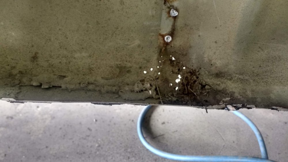

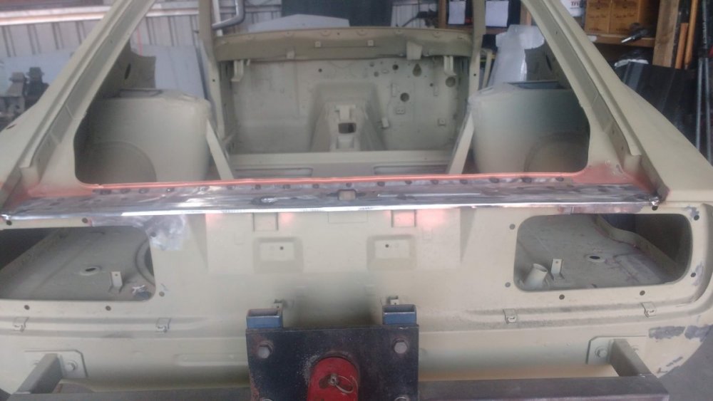

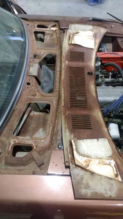

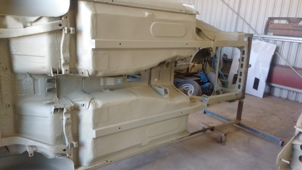

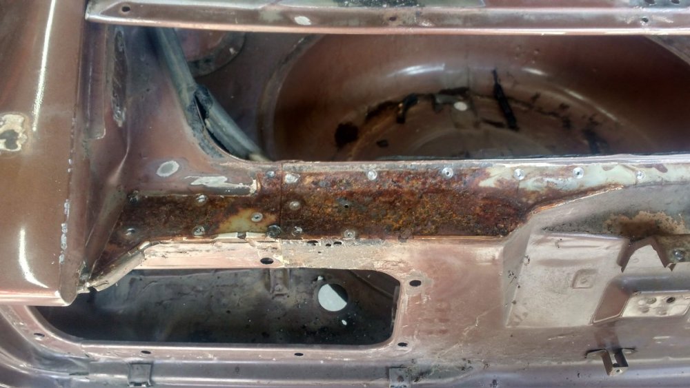

C.A.R. Posted October 29, 2018 Posted October 29, 2018 (edited) So next came the fun part - tear-down! I was very surprised to find the scuttle panel had never been removed - the original foam insulators pads were still in place! Thankfully no serious rust on the scuttle, but the panel had been eaten by the rust... Next Andy (who is ex-Nissan) gave me a hand to strip the rest of DB down: It may sound unnecessary, but we took a sold 8 days to bring the Z down to bare body and mount it on the rotisserie. This is because EVERYTHING was bagged, labeled and stored away so it wouldn't get lost. But eventually we ended up with this: At which point I decided to remove the hatch slam panel as things were looking rather suspect underneath it... And this is what I found: A couple of days later, the body-shell, panels and major suspension components were sent off to be media blasted: Edited October 29, 2018 by Léon OdinZ and KatoKid 2 Quote

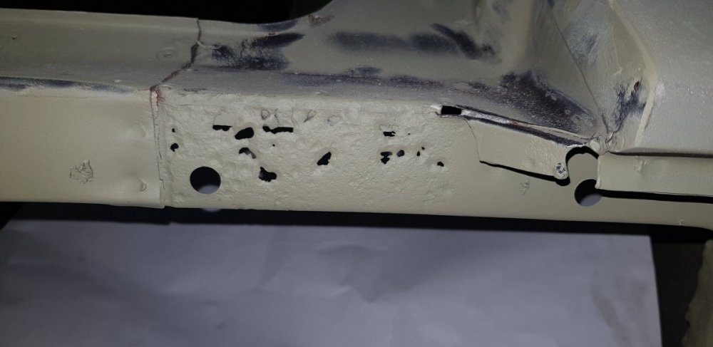

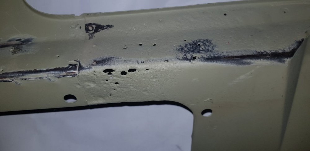

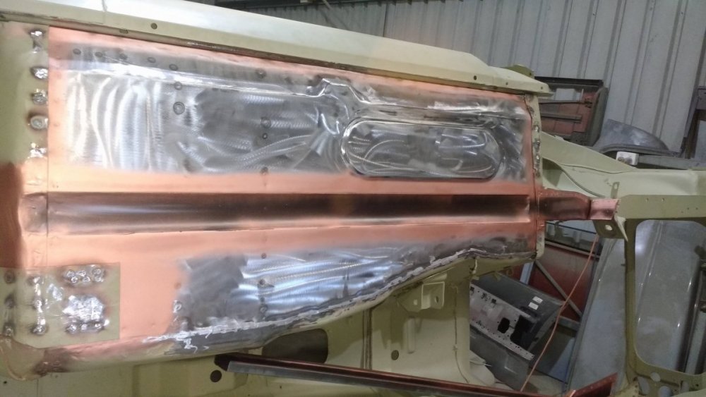

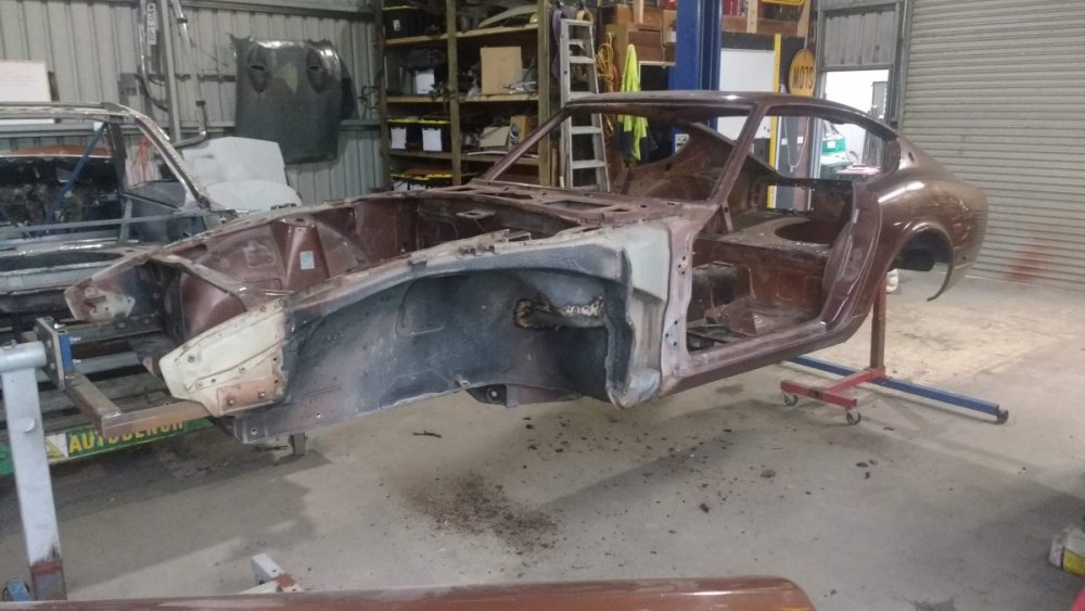

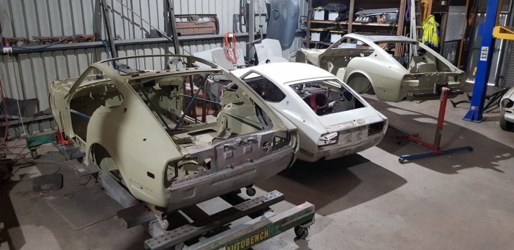

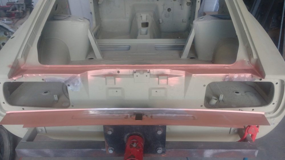

C.A.R. Posted November 6, 2018 Posted November 6, 2018 So, with the shell, panels and parts back from the blaster, DB was moved in beside the other Z's. A few other things showed up after blasting: Large long dent in the LH sill. Rust pin holes in the innder guard under the battery tray. Top's of the sills had rusted through in spots. LH Dogleg had been badly repaired previously. RH Dogleg had pin holes on the bottom edge. Rust and dents around the sunroof hole. Floors and rails are stuffed. RH door is very sad (dents and rust holes) Guards have been poorly repaired. Hatch has a few pin holes. Lots of parking dents! Overall, I was pretty happy, and I'm looking at having all the rust repairs finished before Christmas. So, without further ado, I decided to start at the back and tackle the tail light / slam panel: After the repairs, it was all given a coat of PPG Epoxy. Next, the doglegs... OdinZ, AndBir, Riceburner and 1 other 4 Quote

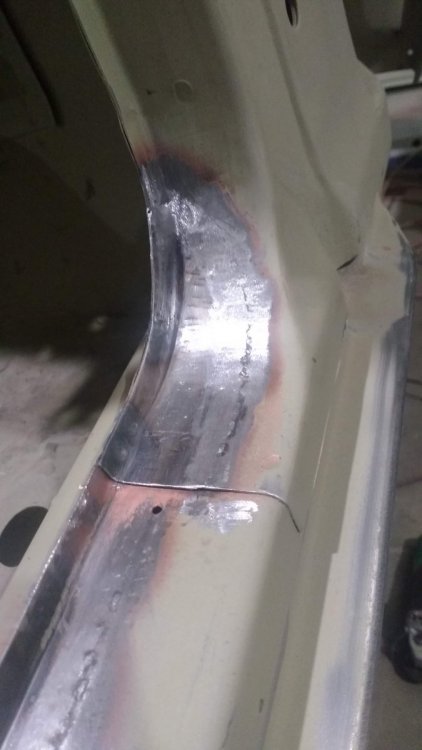

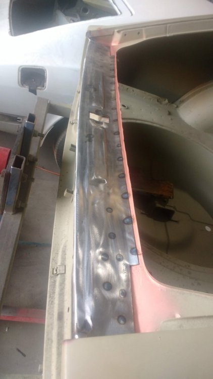

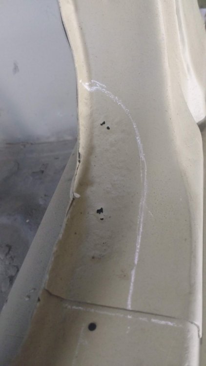

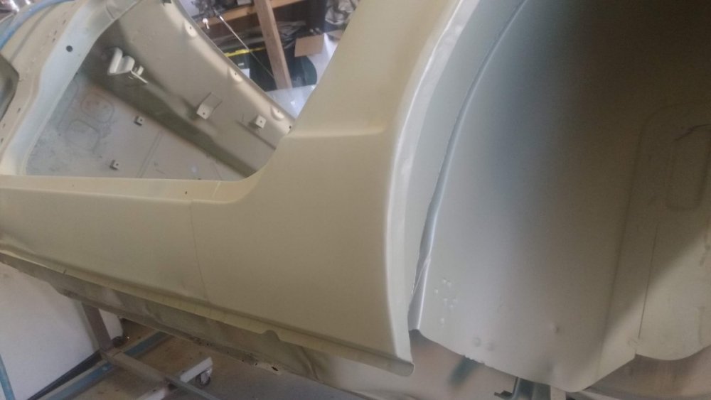

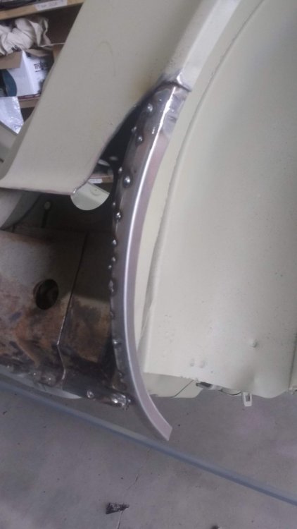

C.A.R. Posted November 11, 2018 Posted November 11, 2018 So, next I started on the LH Dogleg where there was a previous poor repair. The main area of the dogleg was perfect, but the repair around the edge of the arch lip was far from good... The fact it had rusted through the inner wheel arch, made me think all was not well behind, but I was pleased to find that the sill under the dogleg was in great condition. OdinZ, Enzo, RAP260 and 4 others 7 Quote

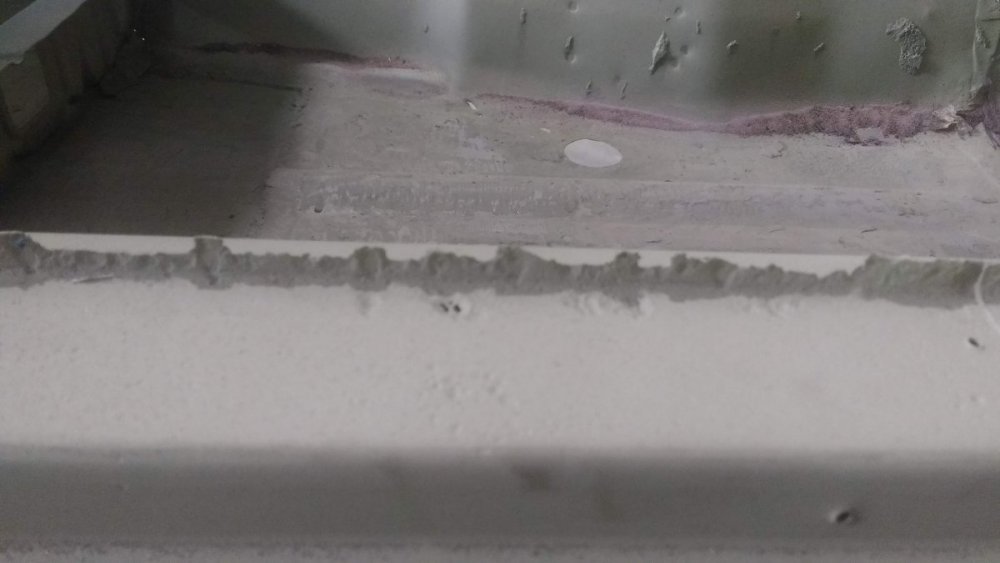

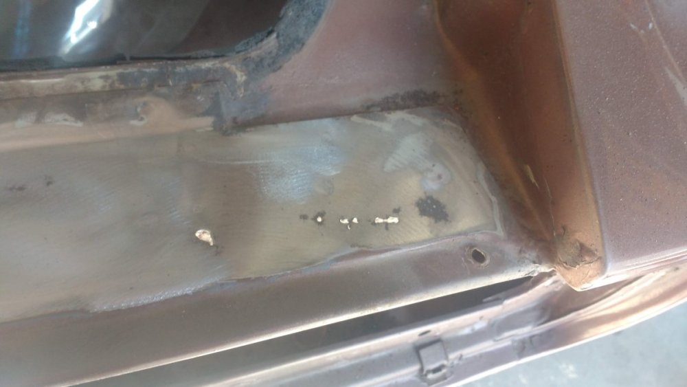

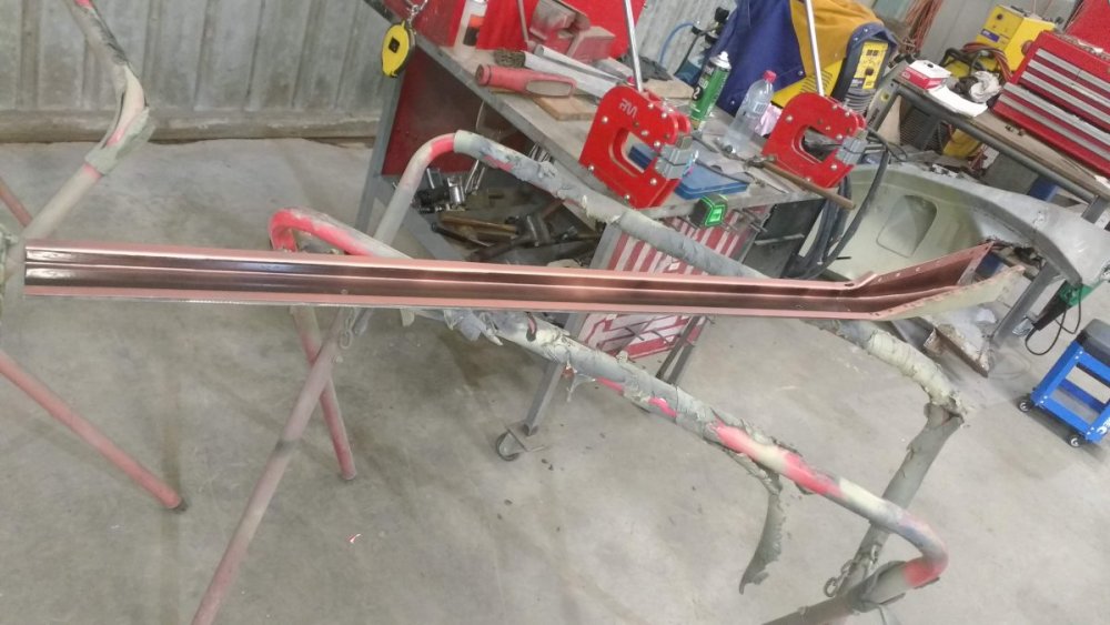

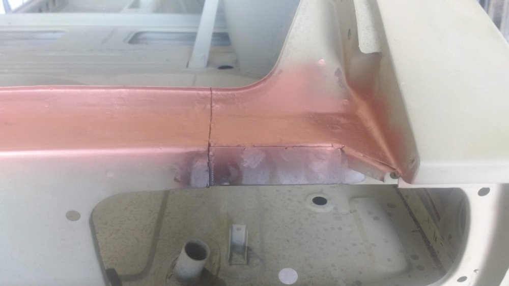

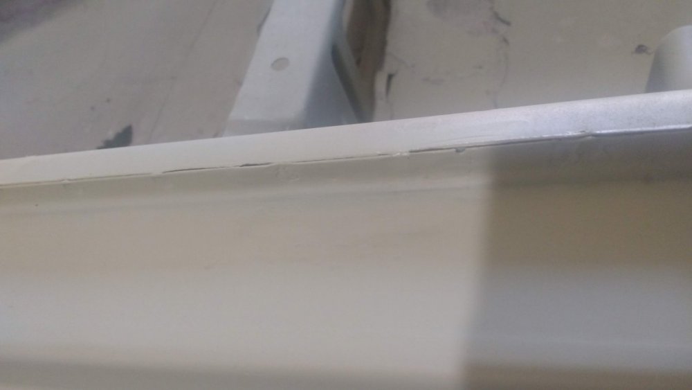

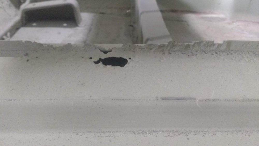

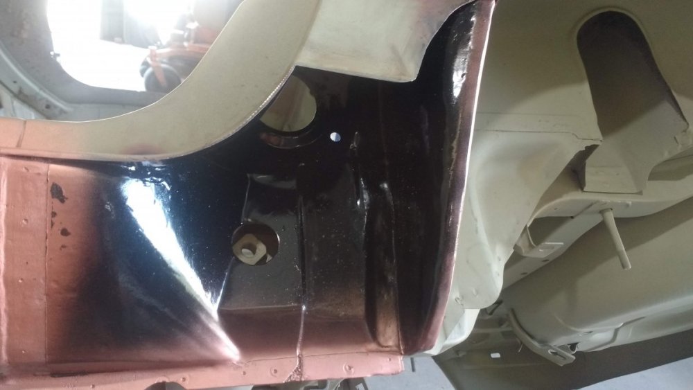

C.A.R. Posted November 12, 2018 Posted November 12, 2018 With the LH dogleg done, it was onto the to of the LH sill / door step: lightmaster240z, theremm, gav240z and 1 other 4 Quote

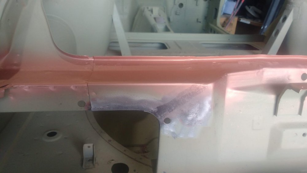

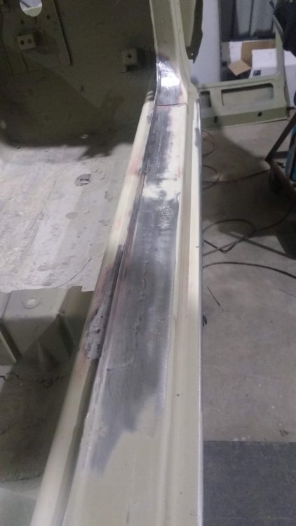

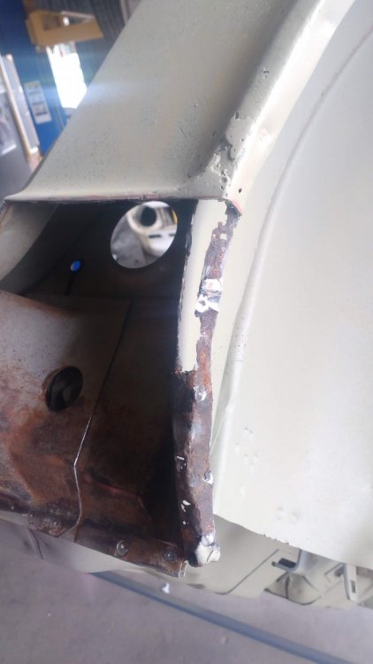

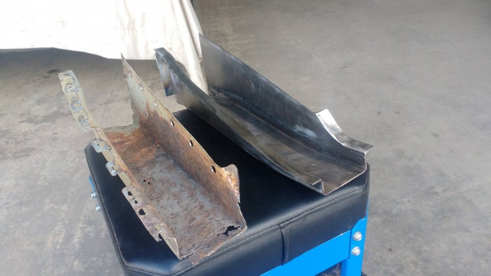

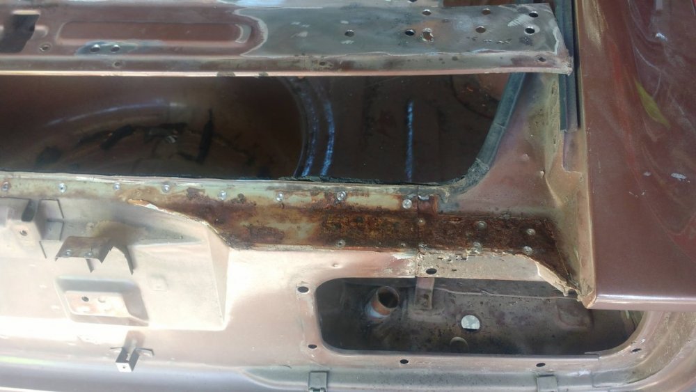

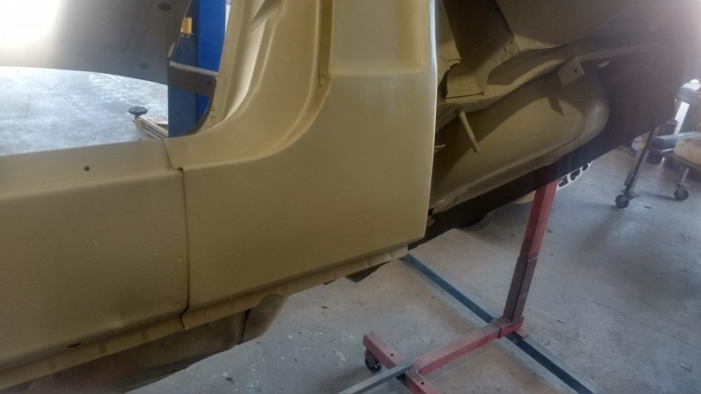

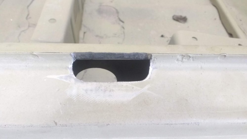

C.A.R. Posted January 29, 2019 Posted January 29, 2019 I've been a bit slack in updating this build (mostly due to another project that snowballed...), but repairs to DB ARE progressing. Next up was the bottom of the RH A-post top of the RH sill. Quote

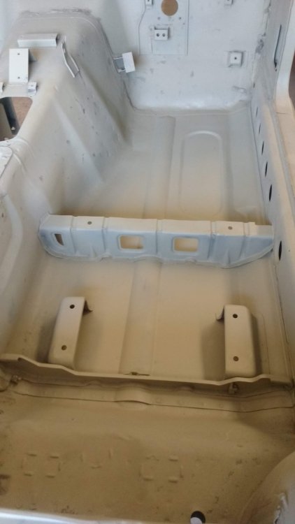

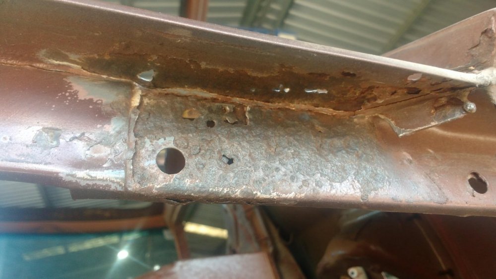

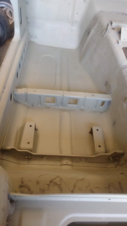

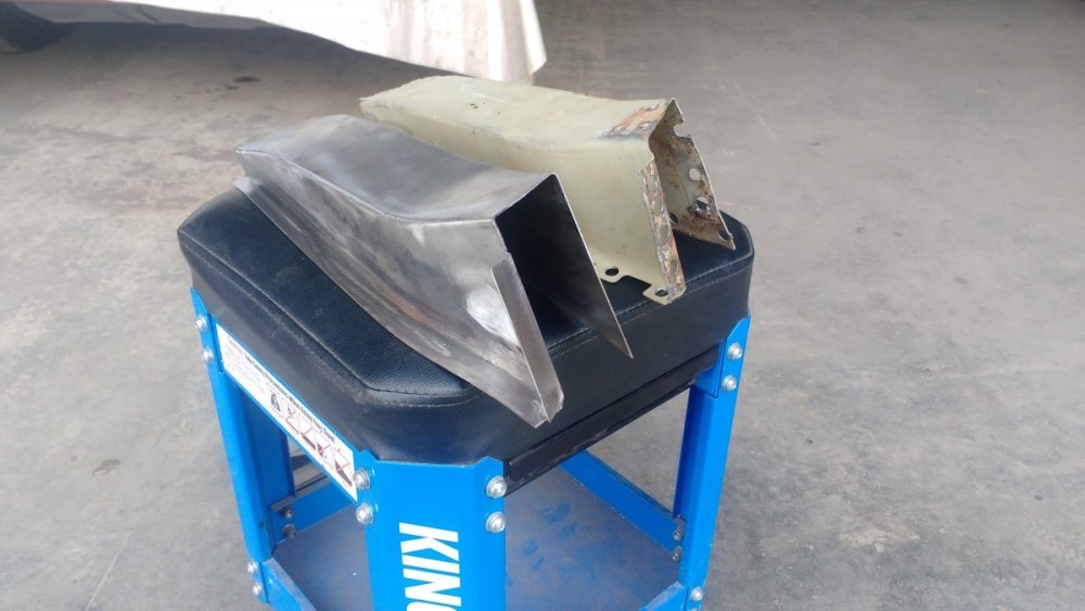

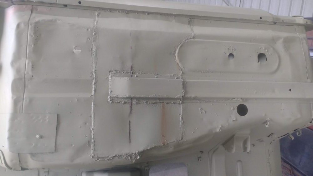

C.A.R. Posted January 29, 2019 Posted January 29, 2019 (edited) Following this was the replacement of both floors. The last 45 years had taken their toll on the floors and the 'patch jobs' done sometime in the 90's wasn't holding up either - new floors & rails it was! This was under the RH seat mount! Installation of the floors is timing consuming as the RS pans are not perfect, but I managed to get them fitted to an acceptable standard. Biggest problem with the floor rails that are supplied by Rare Spares with their replacement floor is that they are too shallow and not wide enough to match up with the rail as it comes down from the radius rod mount. My solution is to make my own: One problem that did rear it's ugly head was that the RH rail section where it meets radius rod mount was badly rusted. I removed it, media blasted it but found it to be too far gone After some head scratching my only recourse was to remake it: Thankfully the LH rail was salvageable after media blasting & getting coated with KBS Rust Seal. Floors are now completed and I'm quite pleased with the result. Now they just need a bit of straightening where the weld join meets the tunnel. Edited January 29, 2019 by Léon CBR Jeff, PeterAllen, JDM-TOY and 5 others 8 Quote
Administrators gav240z Posted January 29, 2019 Administrators Posted January 29, 2019 So much better than the floor pans before! Nice work making the gusset section of the rail that goes just below the firewall. Quote
Wags Posted January 29, 2019 Author Posted January 29, 2019 Wow that is some great work Locky! Really admire you tenacity and commitment toward the quality of this restoration! Great stuff mate! Quote

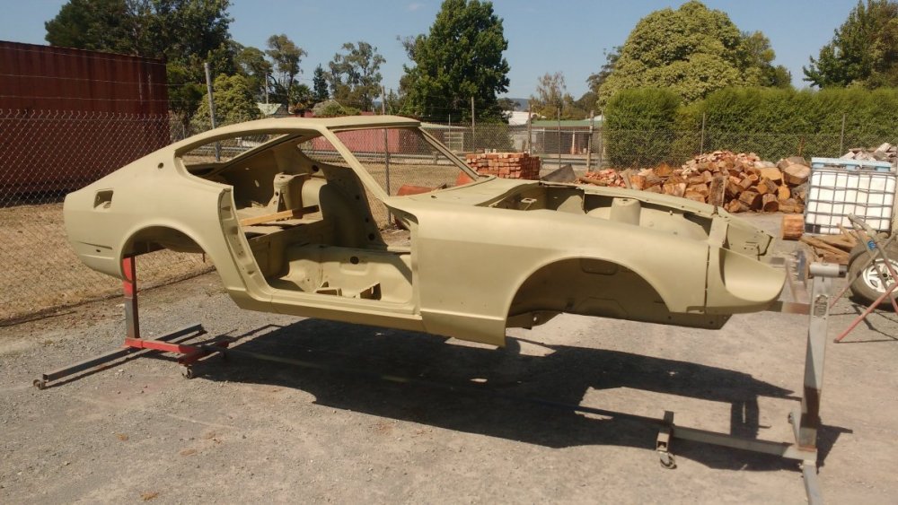

C.A.R. Posted March 1, 2019 Posted March 1, 2019 Rust repairs are nearly complete and I have a bit of panel beating to do. Last on the list will be dealing with the sunroof hole. I have a plan for this so watch this space... PeterAllen, KatoKid, JDM-TOY and 2 others 5 Quote

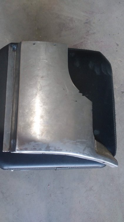

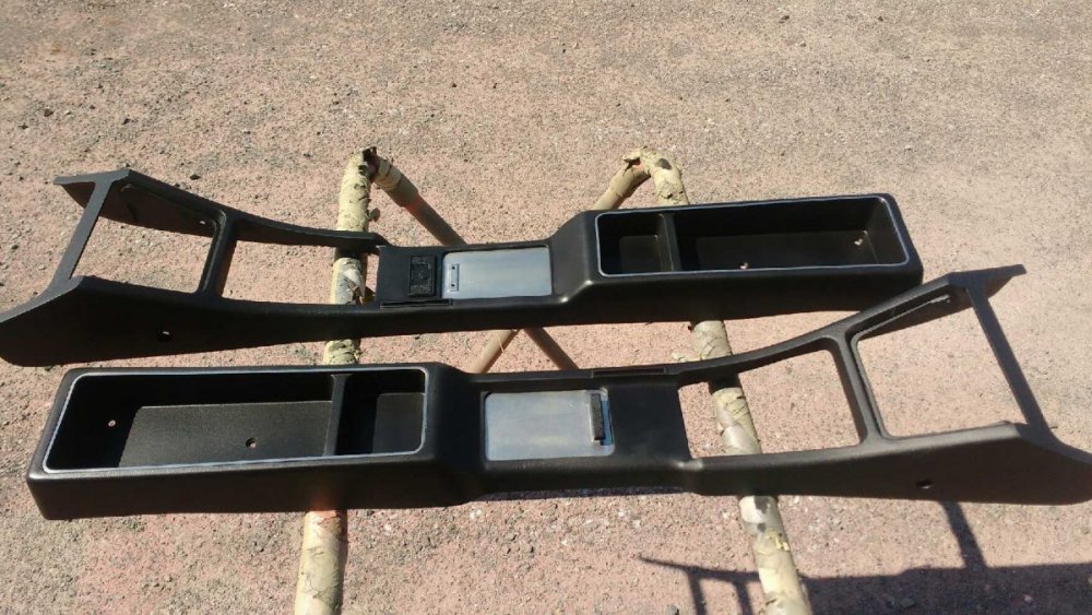

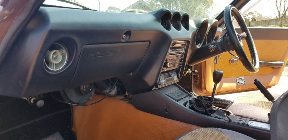

Wags Posted April 2, 2019 Author Posted April 2, 2019 Got some pics of the repaired console from Locky the other week. Looks sweet as a nut! OdinZ 1 Quote
